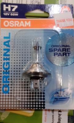

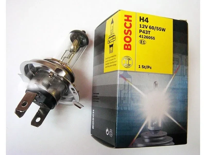

May I know what is the reason for the headlamp bulb to fail so easily? Not sure is it worth it to replace it at Proton again.

QUOTE(RattleSnaKe @ Aug 3 2015, 12:27 PM)
headlamp bulb meaning the bulb inside the car light? The bulb i've changed before cos failed once but only once so far.
SportyHandling
post Aug 3 2015, 01:09 PM
623 posts
Joined: Jul 2013
Mine fused 2-3 times. According to the Proton guy who replaced the light bulb, it is due to the use of the "Auto-light" feature that caused the bulb to fail. He advised not to put the lights on Auto mode if you want to preserve the bulb.
I changed the light bulb at the Proton service centre. When the bulb failed within 6 months, replacement of the new light bulb is free of charge. It is stated in the invoice in that the warranty for the light bulb is 6 months from installation.
The mechanics at my regular SC said changing the wire harness would solve the problem.

QUOTE(SportyHandling @ Aug 3 2015, 01:09 PM)
i also found out is becos of this auto light function too.. becos if auto-light, the car when dark around 5.30pm like tat the light will on already, summore early morning u start car, indoor, also the light will on.. and imagine u start car with the lights on. then on and off on and off, filament sure not so good one. If is LED is ok becos LED actually on and off all the while in a very fast manner, naked eye cannot see, maybe 1sec on and off 300 times like tat..

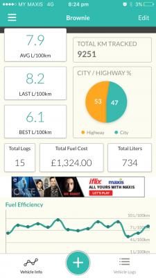

FC sharing..
Driving only in Penang - Average 13L/100km
2x more than my previous Kelisa... but handling, comfort, safety cannot compare lah

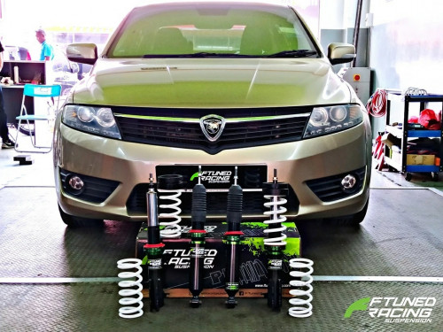

ZeroHavoc
post Aug 10 2015, 05:19 AM

QUOTE(ZeroHavoc @ Aug 10 2015, 05:19 AM)
any user here use sport spring on their car?
can give rev?
Stock spring already very high spring rate. Or are you looking for a firmer shock absorber?

ZeroHavoc
post Aug 10 2015, 09:27 PM
103 posts
Joined: Nov 2013
QUOTE(mengsuan @ Aug 10 2015, 10:06 PM)
im new to this, but people say if im using standard abs with sport the abs will kong easily am i right?
mengsuan
post Aug 10 2015, 11:08 PM
9W2NNS
Staff
10,459 posts
From: Puchong
QUOTE(ZeroHavoc @ Aug 10 2015, 09:27 PM)
That's what I heard too.
Why not adjustable right away? You get handling and also your required lowered look, without sacrificing longevity. Also a higher spring rate to avoid hitting your fenders. BC Racing or AR Racing, both available for Preve.
If more budget, then F tuned. Check out their work here. https://www.facebook.com/media/set/?set=a.6...72423739&type=3

post Aug 11 2015, 06:57 PM
103 posts
Joined: Nov 2013
QUOTE(mengsuan @ Aug 11 2015, 12:08 AM)

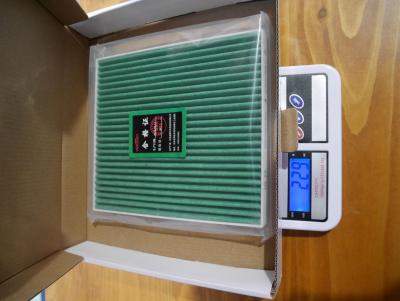

hbgoh57
post Aug 17 2015, 08:02 PM
804 posts
Joined: Dec 2010
QUOTE(SportyHandling @ Aug 14 2015, 11:18 AM)
Thanks for the information. So it is the problematic gearbox of the CVT that causes the loud sound. I thought the sound is coming from the engine.
Was planning to drive the car for another 2 years before I sell it for something else but it might be sooner than I thought after all these recent hiccups. I was told that the gearbox replacement may not be completed in 2 weeks time and may drag up to 1 month. Can't afford be a slave to the car although fortunately I have another backup car in the Ford Focus, which the clutch fix is also due very soon.
So whats the status of your gearbox?really kaput?and what is your car mileage now btw?
alexander3133
post Aug 17 2015, 08:06 PM
1,716 posts
Joined: May 2006
From: JDT
QUOTE(:3mushy:3 @ Aug 17 2015, 07:08 PM)
I suggest you to call Proton Careline, perhaps there are changes to the CFE package, before you go and bombard your SA.
Maybe Proton changed vendor from Ecotint to this brand, seeing there's a tag saying it's an approved vendor.
Not sure if they have changed the package for the CFE version.
I took my car to service center to service, while waiting for service to complete, I took a look at some unsold Preve CFE parking at the sales branch there, I noticed that some of those cars has EcoTint label/paper hanging at the windscreen rear mirror. I would presume that those cars some together with EcoTint film, because I saw some instructions on the label/paper if not mistaken.
TS:3mushy:3
post Aug 17 2015, 08:11 PM
<--~(--+<[o]>+--)~-->
4,723 posts
Joined: Apr 2008
QUOTE(alexander3133 @ Aug 17 2015, 08:06 PM)
Yes mine came with it and a warranty card with serial number. You should just call the Careline and find out.
alexander3133
post Aug 17 2015, 09:03 PM
1,716 posts
Joined: May 2006
From: JDT
QUOTE(:3mushy:3 @ Aug 17 2015, 08:11 PM)
I have no much confident with this tint. Past experience speaking that the Proton Persona that I drove before for six years has this Safetint installed. The problem I had with the tint was, the tint started to have very obvious waves like pattern and bubbles, on the third year.
I did not bother to claim any warranty on that film and decided to change to other brand's film.

TS:3mushy:3
post Aug 17 2015, 10:04 PM
4,723 posts
Joined: Apr 2008
QUOTE(Quazacolt @ Aug 17 2015, 10:00 PM)
ecotint on my inspira after 1 year+ is still in good condition.
so far so good la
Err he was referring to the Safetint, not ecotint.

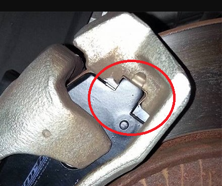

Hello there all preve sifus. My preve turbo recently make a loud squeaking noise whenever I brake at low speed. Anyone encounter the same thing? My car mileage is only at 12k. Shouldn't be worn out brake pads right? Thanks
TS:3mushy:3
post Aug 19 2015, 09:01 PM
4,723 posts
Joined: Apr 2008
QUOTE(garrysiow @ Aug 19 2015, 08:42 PM)
Squeaks are fine, due to thin rust formation that will usually go away in time. This is normal.
However if it screeches then it could be a serious problem.
garrysiow
post Aug 19 2015, 09:03 PM
1 posts
Joined: Nov 2011
QUOTE(:3mushy:3 @ Aug 19 2015, 09:01 PM)
Thanks for the reply. Is there anyway to remove the squeaking noise? It's quite embarrassing to drive around especially in indoor car park due to the echo sweat.gif
TS:3mushy:3
post Aug 19 2015, 09:21 PM
4,723 posts
Joined: Apr 2008
QUOTE(garrysiow @ Aug 19 2015, 09:03 PM)
What else? WD-40 of course smile.gif but do not spray on the brake pad, bad idea.
Or if you want more assurance, you can buy specialized spray or grease at any accessories shop, Eneos should have the product.
This post has been edited by :3mushy:3: Aug 19 2015, 09:23 PM
garrysiow
post Aug 19 2015, 09:30 PM
1 posts
Joined: Nov 2011
QUOTE(:3mushy:3 @ Aug 19 2015, 09:21 PM)
Oh thanks for the tips smile.gif . So I just spray wd-40 at the surface of disc brake that's right behind the rim?
TS:3mushy:3
post Aug 19 2015, 09:45 PM
4,723 posts
Joined: Apr 2008
QUOTE(garrysiow @ Aug 19 2015, 09:30 PM)
Yes, but very little. Mind you the purpose of the brake is to stop the wheels.
However I highly recommend you to just wait it out and let wear and tear solve the issue on their own.
ben3003
post Aug 20 2015, 12:40 AM
10k Club
10,859 posts
From: Sarawak

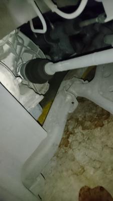

An update on the broken gearbox of my Preve Turbo. Have collected the car and driven it since yesterday. The noise from the gearbox is now louder, and also there is an additional (extraneous) whirring sound when accelerating the car around 2,000RPM with moderate force on the pedal. Not good . Will need to check with Proton whether the new gearbox needs time to break-in. At any rate, I do not think the weird sound from the gearbox will disappear with time. If the sound persists within the next few days, looks like I need to spend some time at the service centre again.
On top of that, there is now rattling sound somewhere on the left door of the car.

Guys, this noise is not normal. It is not the CVT whine or aeroplane sound which I can regard as normal. The sound I am getting now is something like a pipe releasing gas or liquid sound when you step on the pedal. The sound is something that is "additional", and it is not the CVT sound.
With the previous gearbox, the sound is different, and it happens only when you accelerate from standstill. With the new gearbox, the sound comes up when you accelerate from RPM2000. When the RPM is around 2000 and I step on the pedal, I will hear a noise that sounds like gas release from a pipe.
I was hoping that with the new gearbox, I will now have a completely new car but looks like I am now driving a partially defective car. Also, there is now rattling sound from the left door which previously wasn't there. The perils of leaving the car at the service centre for prolonged periods (2 weeks). Bad.
I am now trying to get the service advisor and have attempted to call him 3 times but couldn't get him on the line.

Just a quick update. I got my car to the service centre today and they detected the hose to the Turbo engine to have a tear. The sound is due to the leak through that hole. They replaced the hose. After I drove the car out from the service centre, I then got a new problem. The vibration in the car during moderate acceleration is now very strong. The whole dashboard of the car is vibrating when the car is doing moderate to hard acceleration. I can feel the vibration everywhere in the car on the dashboard and steering wheel.
On top of that, the alignment of the steering wheel has gone out. The steering wheel felt a bit loose as well.
IN summary, basically the condition of the car has deteriorated considerably after the gearbox was replaced. The car's performance (before the replacement of the faulty gearbox) is much better than after the new gearbox was installed onto the car.
From this experience, I would think that any major component replacement or upgrade may get the car into a worse state or condition instead of a better shape. Even if you have got a new component installed onto the car, ie. new gearbox or maybe new engine, it is not guaranteed that the condition of the car will improve. It may get considerably worse.
Even if there is warranty for certain parts, I would think it is a better bet that one does not encounter any problem with the car that may require a warranty claim on the part(s). It may just get your car into a poorer state with many frequent visits to troubleshoot the "after-effects" of the change.

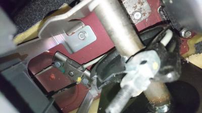

post Sep 2 2015, 10:15 AM
Joined: Sep 2015
Hi sifu, I just got a new preve turbo and I am currently facing some issue. When I park my car where gear in P sometimes I can't shift my gear out of P and need to restart car 2 times then OK. Currently its happen 7 out of 10 times I park my car. Any sifu hare face the same issue. BTW I will send the car to service centre

QUOTE(redbird @ Sep 2 2015, 10:15 AM)
Probably your brake switch has a problem. The gear lock needs to sense the brakes being pressed to release.

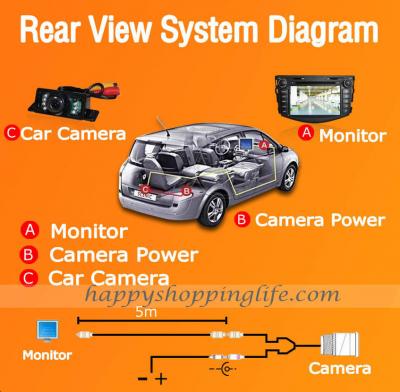

I would like to ask the forum's opinion on adding a reverse camera for the car, should I buy the one the showroom suggested (RM450)? or is there a cheaper way to add a camera and still keep the warranty for everything installed on the car?
Also, we are getting the CFE because we heard that the IAFM+ feels underpowered.
Would it be better to get the IAFM one if we wanted a quieter car?
Is there an alternative to adding a reverse camera on the IAFM+ Preve without spending too much as well?

if CFE, just need spend another 250~300 for adding reverse camera on your original HU. If IAFM+, either change whole HU which is expensive, or adding external view monitor on rear view mirror or whole external unit.. Range around rm200. I would recommend for the turbo version if you are afford it. showroom/proton will not help u to add reverse camera one, most likely is your SA help you to install at outside vendor.. If u lazy to find the accessories then let him settle everything for you..
Hi ChuanHong,
Thank you for your insight.
The SA quoted me RM450. And I thought I should go with him to avoid warranty issues.
You think it would be safe (Warranty wise) to get it outside?
I don't mind going outside to get it done cheaper. Need to find somewhere in PJ to do it.

Any installation will, or should, void the warranty, even done by authorised SA. But I've heard if it was to be done by Proton Glenmarie, warranty won't void.
However, most of the times SC will not care for the reverse camera installation because it does not involve any wire cutting and the HU already has the socket, just plug and play.

QUOTE(:3mushy:3 @ Sep 7 2015, 11:50 AM)
If you can, fork out some extra budget to get the CFE, just for the more powerful engine. I suggest test drive both units until you're satisfied, because every so often you can read that they regretted not getting the CFE version just to save a few Ks.
Preve CFE it is then.
Well, to be safe then, might as well ask the SA to install it. Since the showroom also has a service centre, will go back to them for service and such.
The reverse camera will be auto right? As in when I engage reverse, then it will automatically show the camera. Would suck if it is the kind where you need to switch it on the player to see whats behind.
Thanks mushy.
Thanks mushy.
Depends on model, but all I've seen so far are automatic type.

QUOTE(ZooK @ Sep 7 2015, 01:15 PM)
Thanks mushy.
Yes, automatically shown when you engage reverse gear.

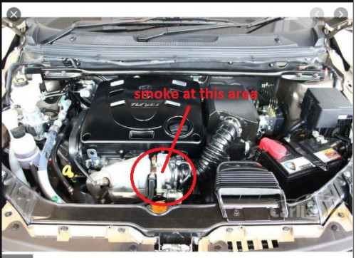

SportyHandling
post Sep 7 2015, 02:48 PM
623 posts
Joined: Jul 2013

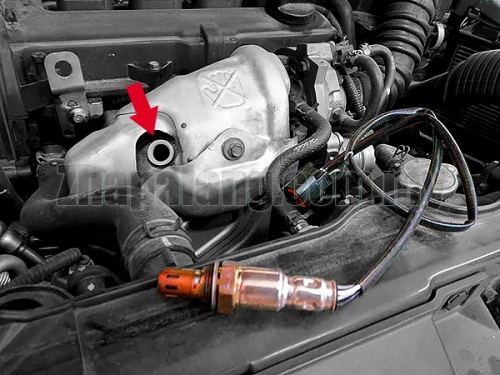

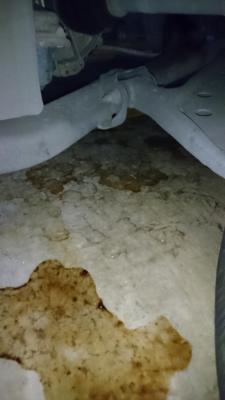

Does anyone know if the Preve Turbo shares the same pipe as this one in the Suprima? Any idea what is this pipe?

QUOTE(SportyHandling @ Sep 7 2015, 02:48 PM)
based on the squarish silver thing it is a water coolant hose for oil temprature. but based on the leaking it is lubrication leaks and i dont think it came from that hose must be from some where else..
if i could recal,l one of our preveian have the same kind of oil leaks problem..
Since suprima engine same as exora bold and preve cfe yes it share the same thing....

i believe this is wat they say the oil cooler tube thingy. it is a recall according to our sarawak prevoc member. Urs is leaking? How u took this photo? i heard it is at the bottom of the car.. need to go underneath only can check ka?
SportyHandling
post Sep 7 2015, 10:24 PM
623 posts
Joined: Jul 2013
QUOTE(sapekman @ Sep 7 2015, 07:25 PM)
Okay thanks for the information. Was told there was oil leak but not sure where does it come from. Not good if it's the same as the Preve Turbo. If that's the case the Preve will have potential to leak as well.
SportyHandling
post Sep 7 2015, 10:25 PM
623 posts
Joined: Jul 2013
QUOTE(ben3003 @ Sep 7 2015, 09:15 PM)
The car is a Proton Suprima, not Preve. It is a company car, not my car. The photo was taken by the mechanic at the Proton Kuantan branch. One of my colleague drove the car and it broke down on the highway with smoke coming out from the front bonnet.
ben3003
post Sep 7 2015, 10:28 PM
10k Club
10,859 posts
From: Sarawak
QUOTE(SportyHandling @ Sep 7 2015, 10:25 PM)
oh ok. By right suprima and preve engine, 90% at least smile.gif 1 of the cause would be reving very high speed for prolonged time, maybe 1-2hrs 150-160km/h and above. I am not sure whether new oil cooler tube would do or not, but hopefully proton can solve the problem.
SportyHandling
post Sep 7 2015, 10:33 PM
623 posts
Joined: Jul 2013
QUOTE(ben3003 @ Sep 7 2015, 10:28 PM)
That is one possible reason. My colleague is a slow driver though as his driving speeds rarely go above 130km/h. Maybe some of the drivers before him had abused the car before.
Some photos of the car (without the smoke) :-

Just received the Purchase Requisition of the Proton Suprima's faulty parts (leaking hoses).
Hose with part number PW 812789
Hose with part number PW 812790
Clip with part number PW 812314
Does anybody know what are these hoses?
yes. if not mistaken its engine oil hose and coolant hose
