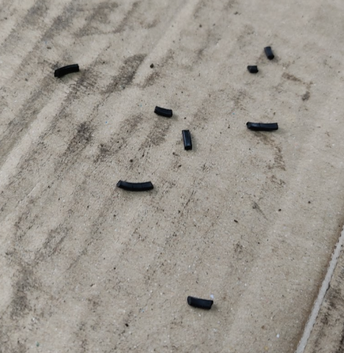

Radiator hose tip broke engine overheat with buzzer warning. No steam or smoke. After cooling half Hour pour 3 liter Water thru main cap hole..the reserve tank still has some water.fit back the hose with hose clip on remaining unbroken radiator tip..drove to cose. Temperature was back to normal during the 10 min drive.need until tomorrow for repairs
.hope no damage to gaskets, turbo etc. July 12 28000km. So others please insist on the Radiator tip upgrade in your next service or better still don't wait any longer.

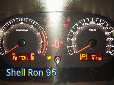

post Dec 6 2014, 09:08 AM
2,429 posts
Joined: Feb 2007

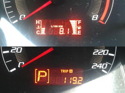

I think Shell isnt the best friend to Exora.

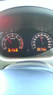

Previously i was on several fill ups of Petron. Then few days ago, with my fuel gauge still remaining 2 bars left, my father took it for a drive, and fill up RM 80 worth of Shell.
Just FYI, after i last filled up with Petron, i reset the Average Fuel consumption, took it for a drive to Klang to and fro, and was using the highway (including speeding up to 130km/h) . I did encounter some traffic jam in Klang and slow speed driving (finding car park). I had covered about 120km before the tank was filled up with Shell.
when it was last with Petron it was still showing around 10.6l/100km, but after just a short 25km drive of the recently filled up Shell, now its showing 11.1L/100km cry.gif . I didnt reset the fc meter either.
(I took photos of the trip meter and the avg fuel consumption before this incident happened)
And furthermore yesterday when i took it for a drive nearby, without triggering the turbo boost and driving as gently as possible, with the aid of the Instant Fuel Consumption reading, the moment i reached home and turn off the engine, the fan started running blink.gif
Previously with Petron, it didnt trigger the fan on gentle drives. And the fc seems to has gotten worse (from 10.6l/100km to 11.1l/100km) with gentle drives
Now i know that if one were to frequently drive with the turbo boost activated, it will activate the fan. However yesterday i was driving real gentle, doing max speed only 65km/h.
So i could only comment that Shell does bring some noticeable effect to Exora's engine.

I used to always pump Shell (because of bonuslink laugh.gif). But since earlier this year I have been trying out other petrol brands just to see how its like..
For me, I find that Shell, Petron and BHP give about the same fuel consumption figures. Only Petronas consistently gives not-as-good fuel consumption figures.
However, my reason for disliking Shell is that I find it makes the car vibrate a little more than usual compared to BHP or Petron.
Currently trying out Caltex after hearing many good things about it. Just filled up my EB with Caltex RON95 yesterday. Will try it out for a few tanks and see how it is brows.gif

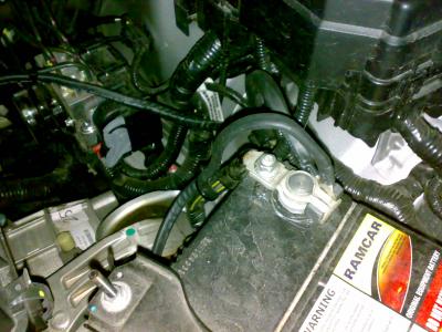

Mean...making my own copper cable & connect between the engine top mount to batt(-Ve) terminal. Does feel the engine is much lighter during morning start-up. icon_rolleyes.gif

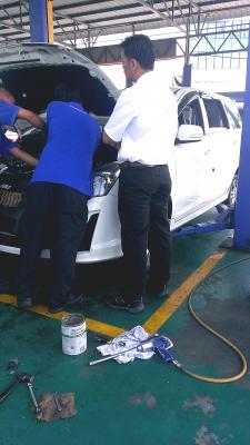

Ontop of that I DIY for my engine grounding & can feel my EB is much easy/lighter during crank start.  icon_rolleyes.gif
Just done my appointment check today @ Pg SC, after communication with wecare (mail). Fix some minor issues as below:
1) Reset the wiper, as stop in middle
2) Tighten the lower arm as minor sound passing bump
3) Break hose breathing for 4 wheel, as brake freeze (hard) sometime
4) Reverse engine die, Software adaptation done. Asked the foreman to service / clean the engine throttle body, he claimed its only applicable for CPS model.
Will need to monitor to see any re-occurrences.

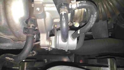

Guys, I DIY 3 point from engine top mount to batt -ve terminal... Do observe the ignition/start is much smoother & lighter. icon_idea.gif
A friend of mine told me, by adding this ground cable to the batt terminal will actually improve the resistance will then improve the potential different. He told me his CRV did observe ~15% fuel improve but I have yet to confirmed, as of now does not seem to see the benefit of fuel save. Only can feel the ignition is much smoother.. thumbup.gif

I DIY from "dual core" speaker cable trim to fit & cover with shrinkable tube & clamp the cable lug by myself.... rclxm9.gif

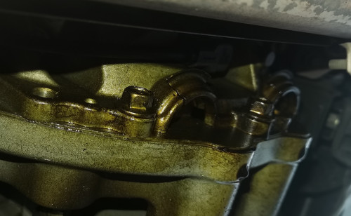

post Dec 13 2014, 11:07 AM
120 posts

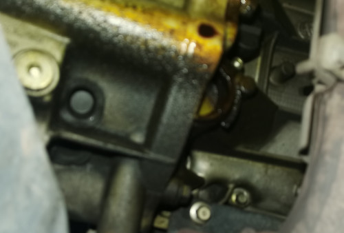

New problem. Engine oil leakage...

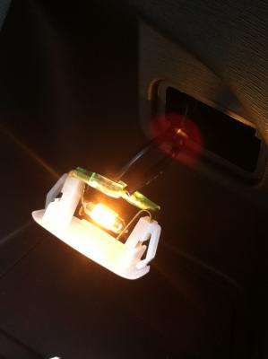

post Dec 13 2014, 05:46 PM
Joined: May 2011

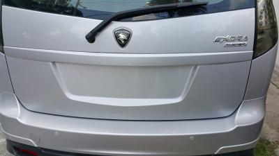

Sharing boot lamp i just fixed for my Bold Std
Attached Image Attached Image

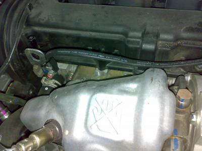

QUOTE(vinorgouki @ Dec 13 2014, 11:07 AM)

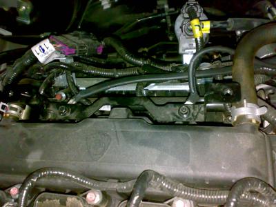

how many km is your mileage?

QUOTE(sKypRiNcE734 @ Dec 14 2014, 05:58 PM)
Yesterday morning filled rm100 97 fuel at petronas.reached champions sports arena@kapar only 1 bar went down.had badminton tournament.after that went for lunch just opposite.after that shoot Back to seremban using e6 elite highway..for awhile slow traffic after that too many cars and the left lane no cars at all but right speeding lane so many cars.my dad decided to cut to left lane and speed up to 180+.revved up to 5.2K RPM.behind was a mercedes C class old model.was with him only speeding all the way to seremban tol.after that reached back home petrol has 2 bars.230km.
Today morning the car could not be started.Meter indicator shows that BATT Sudah kong.i was like lucky it died today and not yesterday.so I chagred the battery and start the car also cannot.waited full charge then start also can't.no choice but to jump start.jump started and then could start.then now i dont know la never start and see.the fan also no more garang sound already..so weak..
How old / whats the mileage of the car already?
vinorgouki
post Dec 15 2014, 10:31 AM
120 posts
QUOTE(V12Kompressor @ Dec 14 2014, 09:14 PM)
55k km. years 2012.

sKypRiNcE734
post Dec 15 2014, 12:18 PM
37 posts
Joined: Jun 2013
From: Earth
QUOTE(SleeplessEyes @ Dec 15 2014, 08:26 AM)
1 year 5 months.it happen exactly at 26692.i used it then today totally flat.

V12Kompressor
post Dec 15 2014, 03:56 PM
No carrots here
2,141 posts
Joined: Sep 2008
From: Muddy Banks
QUOTE(vinorgouki @ Dec 15 2014, 10:31 AM)
55k km. years 2012.
check your engile oil level. is it reducing rapidly or hardly noticed?
leaking top is quite common problem among Campro engines; and being turbocharged i guess the matter is made slightly worst.
vinorgouki
post Dec 15 2014, 06:06 PM
120 posts
QUOTE(V12Kompressor @ Dec 15 2014, 03:56 PM)
engine oil seems fine. not noticeable.
ya, cfe seems got same problem like cps.
need to change gasket and seal engine top.
This post has been edited by vinorgouki: Dec 15 2014, 06:08 PM

QUOTE(trapeze @ Dec 13 2014, 05:46 PM)
Mana beli cover Boot Lamp?
Wiring ?
trapeze
post Dec 16 2014, 12:40 PM
Joined: May 2011
QUOTE(killman @ Dec 16 2014, 12:03 PM)
Wiring ?
Accessory shop or proton service center bro!
sKypRiNcE734
post Dec 16 2014, 09:03 PM
37 posts
Joined: Jun 2013
From: Earth
Proton is changing my Exora CFE"s CVT GEARBOX to a new one.they said there is a major problem it seems.but my car works just fine.so sending it in next week Monday for 26k service and gb change.hmmmmm sad.gif
where you buy it? mind to share? do you install the 12v dc at back?

trapeze
post Dec 17 2014, 11:11 AM
Joined: May 2011
QUOTE(ImAn @ Dec 17 2014, 10:58 AM)
Proton service center or accessory shop oso can find the boot lamp, wiring find from inside. Wanted to install 12V socket oso but yet to find the solution, would appreciate if any 1 here done it on their standard bold and can share here too. tongue.gif

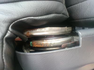

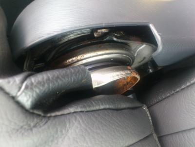

New to this forum. Need help with one of the rear folding seats. I can't pull it up. This is the 2nd time it has happened. First time, I sent it to SC for repairs. Does anyone have this same recurring problem? Anything we can do without sending it to to SC?

QUOTE(sharba @ Dec 21 2014, 10:10 PM)
what did the SC do the 1st time? mine encountered the same problem, the SC changed something because he said something is broken, hence can't pull the seat up. now the problem isn't there anymore.. or could be just because it has been a while I tested the rear seat...
sharba
post Dec 22 2014, 01:58 AM
8 posts
Joined: Jan 2012
QUOTE(imin @ Dec 21 2014, 11:38 PM)
Unfortunately, I did not observe what he did the first time which was more than a year ago. I then left it in the folded position. Only tonight I tried it and couldn't be pulled up.
Did not encounter this.
Need to watch how they fix the problem.

SleeplessEyes
post Dec 26 2014, 11:24 AM
2,429 posts
Joined: Feb 2007
QUOTE(ir5 @ Dec 26 2014, 11:10 AM)
"Shell is the worst enemy for exora turbo. Thats why i got 8.1km/l "
ha?shell the worse enemy?? any solid data to back up ur words/claim? u are using which petrol brand?
Yes I have a screenshot of my FC meter. The FC meter was reset when on the 1 tank of Shell.
Previously was on 1 tank of Shell, so I completed 1 tank at 12.1L/100KM , so now I am trying out 1 tank of Petronas (just filled up yesterday)
Photo screenshot is my phone right now but I can't upload now. (Office PC dont allow USB connections)
This post has been edited by SleeplessEyes: Dec 26 2014, 12:04 PM

As promised, here is my FC shot :
The fuel light was still blinking though.
Now on Petronas update, FC meter showing between 11.3-11.5L/100KM after travelling for about 50KMs, so its not the final figure.

My clocked 27k exora year 2013 appeared CVT light after the ABS sensor faulty caused the whole car stalled and lost power.
Noted that the brake felt spongy and soft when the ABS light on.
Diagnosed with the SC and they said that the CVT light on due to the ABS sensor fault. Had the ABS sensor changed (Front Left) and so far no any light appears.
Immediately the brake stiffen back and whole car felt different.
Another thing, had the cooper radiator nipple changes too. No any coolant or new hose substitute in my case.
The fan of the car, one of the mechanic told me if the fan keep on spinning for more than 6 minutes, then most probably ur set of fan occurs problems and sent to SC for checking.
Yeah they only changed the nipple to metal type. The hose didnt change.

guys, i'm searching for small mirror under side mirror for our EB like picture below. hmm.gif rolleyes.gif
usually saw estima use it. this thing useful to see both lower side of our EB.

post Dec 31 2014, 10:04 PM
Joined: Jun 2013
changed my radiator nipple today. what a shock, the foreman told me that the plastic nipple already got a crack line and may break at any time. so friends out there, better replace yours before its to late. i'm just very very lucky. sweat.gif
This post has been edited by tehsarbat: Dec 31 2014, 10:06 PM

QUOTE(tehsarbat @ Dec 31 2014, 10:04 PM)
Mine already half way melted when it was changed.

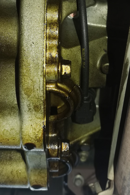

mandrewBelow photos, first one is the half melted nipple. The second one is after it was removed, and a bigger hole was bored. You'll see a copper tip after all is done.
This post has been edited by alexei: Jan 1 2015, 09:57 PM

QUOTE(alexei @ Jan 1 2015, 09:18 AM)
what will happened if it's already broken bro? any sign? temp.will up very2 fast?

QUOTE(ir5 @ Jan 2 2015, 10:58 AM)
if you can detect any lick at the nipple before start your journey, then its good enough so that you can shoot straight to the nearest SC. but its not a ready stock. a normal SC will ordered on demand. i had to wait mine's for a week.
jut imagined if you are on a long journey, in a middle of a night, at high speed and its happened. no sign at all when its going to burst due to high pressure, and when its happened, the temp will raised to the maximum, and its already too late. doh.gif
when this issue brought out, i dare not to do any long distance journey until its already replaced. sweat.gif
temp will go up very fast..it happened to me while going to office the next day after travelling from Cherating to Gombak.
Luckly almost reach office that time.Temp full bar at that time together buzzing sound. Cannot imagine if it happened at LPT.
the plastic receives hot coolant from turbo. If it breaks, the coolant will spill, and so on so forth.

QUOTE(alexei @ Jan 1 2015, 09:52 PM)
Thanks Alexei.
Yes, I could see it is fitted....
Together with that, I also noticed that the other Hoses connecting to the engines are also new.... seems like they have changed that also....

Herosue
post Jan 5 2015, 03:15 PM
Joined: Dec 2014
just check my car seats as it is getting noisier... and noticed that most of the metal are rusted.... and i just got my car 2 weeks back... really disappointed with it..
anyone has similar problem?

QUOTE(Herosue @ Jan 5 2015, 03:15 PM)
Just checked my own EB. Mine seems normal. No rust.

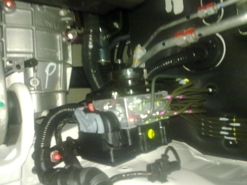

alexei
post Jan 8 2015, 04:15 PM
Biker Mice from Mars
1,879 posts
From: Medan, ID
QUOTE(ir5 @ Jan 8 2015, 02:31 PM)
ABS Sensor replacement? what's the symptom? is it because after hit big hole will sound like..."GRRrrrr" at the co-pilot area?
No need hit pothole. Just normal braking but car doesn't slow down, and get the "GRRrrrr" sound, and you can feel it at the brake pedal. ABS override the braking, and cause it not to slow down.

ir5The "Grrr" sound, comes from the ABS pump. I believe it is located on the left side of the engine bay, which is why it sounds like coming from passenger side. When send to check, ask them to inspect all the ABS sensors.

What's your average fuel consumption now?
I'm getting 10.4L/100km with ODO clocking 250km

Copper tip at radiator after rework.

QUOTE(l3iTi @ Jan 13 2015, 09:38 AM)
Mine is 10.7L/100km mostly city driving. On Petronas and amsoil 10w-40 full sync
10.4 is quite good already. need a light foot to achieve such figure.
my record is so far for mixed driving is 10.6l/100km on Petronas and Petron, but mostly steady highway driving mixed with some city driving conditions to get such figure.
to achieve such good fc, i think you must be constantly off turbo boost driving at constant speed and away from traffic jams.

QUOTE(alexei @ Jan 13 2015, 09:51 AM)
how long u have to wait since you've ordered till it get replaced bro?
alexei
post Jan 13 2015, 03:00 PM
1,879 posts
From: Medan, ID
QUOTE(ir5 @ Jan 13 2015, 02:40 PM)
Think about 2~3 weeks? I think after Paultan announce the thing, immediately they run out of stock.
SleeplessEyesl3iTiMy mixed driving can easily get below 10L/100km. Once stuck in jam, can go up to 12~13.
You need to activate the turbo to get good FC. Trying to stay under 2k RPM will only run the engine at low compression ratio, which means poor efficiency, and a lot of clutch slip.
Read this article: Energy Efficient Driving
I think 'Pulse and Glide' works on EB. That's how I manage below 10.

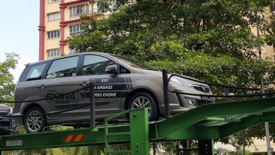

on my way back home just now saw a facelift BOLD on a treller at jalan KLANG-BANTING. black strip on the door and the thing made me jealous, the bumper 3rd brake light.
managed to snap a photo, but can't download. may try again later.
TSYouDontKnowMyName
post Jan 15 2015, 07:33 PM
1,189 posts
Joined: Dec 2009
QUOTE(tehsarbat @ Jan 15 2015, 07:22 PM)

tehsarbat
post Jan 15 2015, 08:28 PM
Joined: Jun 2013
QUOTE(YouDontKnowMyName @ Jan 15 2015, 07:33 PM)
This post has been edited by tehsarbat: Jan 15 2015, 08:31 PM
Attached image(s)

QUOTE(tehsarbat @ Jan 15 2015, 08:28 PM)
multi-spoke rims?
tehsarbat
post Jan 15 2015, 09:24 PM
Joined: Jun 2013
QUOTE(smallcrab @ Jan 15 2015, 08:41 PM)
multi-spoke rims?
tehsarbat
post Jan 15 2015, 09:36 PM
Joined: Jun 2013
multi-spoke rims?
yeah. i noticed different design, and the side mirror painted black. what isit? SV or SE. no notification yet from PROTON. hmm.gif

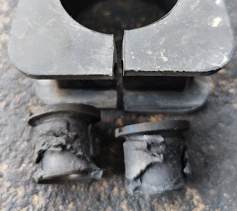

YouDontKnowMyNameI think I figured out the 'tak tak tak' sound during low speed. It's from the front bonnet. I used 3M D-strips to weather seal my engine compartment, and now I don't hear it anymore. It's been 2 days, and I'll report back after observing longer.

QUOTE(alexei @ Jan 16 2015, 09:33 AM)
bro alexei,
care to share some pics which affected area? i also sometime got similar sound at pilot area (right side)

QUOTE(ir5 @ Jan 16 2015, 11:19 AM)
bro alexei,
Use the D-strip pictured to the left, and seal up inside top and bottom of engine bay.
It will cause the bonnet harder to close, but protects the engine bay from the elements.
Inspiration is from this:
2uk3y

QUOTE(2uk3y @ Jan 16 2015, 03:42 PM)
It was COD, but expensive that time. Now LYN got seller, good price.
I'm using the small D, which need two strips. Perhaps if use the big D, one strip on top bonnet enough liao.
Agak 2~3 meter, RM6/meter... cheap DIY.

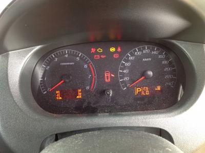

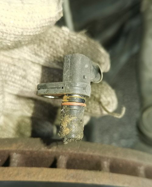

My 2.5 year old EB showed the ABS sign about 3 weeks back, the SC said the sensor no stock. Still waiting ...
Then the brake sign stays on after releasing handbrake, off on the engine, the brake light goes off, but the ABS sign stays on. No effect on braking ability.
Now, the red exclamation light comes on once in a while, and the accelarator pedal has no effect on the car movement. It is the little light under the left circle indicator. Isn't that the indicator for transmission fluid temperature? Off on the engine, the problem goes away.
What to do now?
Sigh ... Going to SC tomorrow ...

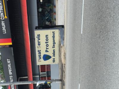

So happen 11km already , so Brought it to Segambut SC and told them about it.
They bleed the brake lines and say problem solved .
But today happen again !
Thinking of going to Mutiara SC, but wanna know from LYN members experience on whats the problem and how it was solved and what to look out for

QUOTE(alexei @ Jan 19 2015, 10:22 AM)
Bro, honestly your understanding is different from what I know.
There are overlap usage of terms of "brake booster". For clarity, brake booster refers to this:
Vacuum assist pump(aka the 2014 model brake booster) refers to this:
How brake booster works
How vacuum pump works
Below are the comparisons:
- Our EB with or without vacuum pump, are only vacuum assisted hydraulic, not electronic.
- With or without vacuum pump, if there is vacuum leak, after several succession of brake pressing, the pedal will become hard and no braking power. Again, when this happens, you have a weak brake because something is wrong.
- Difference with or without vacuum pump, is the feel of 'hardness' when pressing brake. But, doesn't cause lose of braking power.
- When aircon is on full power, it means the aircon compressor and alternator are both loading the engine. This causes the RPM to drop, and the vacuum pressure suffers. This in turns causes the lose of brake power. Increasing engine RPM, or adding a vacuum pump will solve this problem.
Does your unit have vacuum pump? Most likely not. And if you thought you got the 2014 model without the vacuum pump, then you've been short-changed.
The symptom usually means poor vacuum to the brake master pump. Could be caused by air leak. Need to find out problem first.
Installing vacuum pump is not a solution to the problem, but can solve it indirectly.

My EB CVT shows 9.5l\ 100km on the panel. It is too much? Any idea too make it more lower? .
SleeplessEyes
post Jan 21 2015, 01:57 PM
2,429 posts
Joined: Feb 2007
QUOTE(my plumred @ Jan 21 2015, 12:41 PM)
Is it city driving ..or highway driving?
If highway driving, can be better.
But if City driving, it's already good already lo.
Pls remember this is Litre/100KM, not KM/Litre. Lower reading means better FC
You can read the pages here too, I dont mind also sharing my FC.
But City driving and highway driving, alot of differences.
This post has been edited by SleeplessEyes: Jan 21 2015, 01:59 PM

Just want to share my FC:
80% highway = 9L/100km
100% city driving = 14L/100km
This post has been edited by comflash2: Jan 21 2015, 05:20 PM
9.5L/100KM=10.53KM/L.
if 100% city@KL, its more then enough. for 100% highway, it could been better. you can get 11-12KM/L at almost normal speed(140KM/hrs). if it is a mix ride, its just nice.
to get consistent FC(10-11KM/L), i always keep the RPM at 2000-3000 at any condition. from stand still, over taking, going up hill even during cruising. its my personal experienced, but of cause this my weekend car. nod.gif
This post has been edited by tehsarbat: Jan 22 2015, 12:04 AM

Update on EPDM rubber seal for engine boot: May cause higher FC. Need improvement on sealing in front of air intake duct to allow cold air intake.
Update on Torque Pro app: Noticed increased fuel consumption based on calculated "fuel flow rate" during in-gear downhill. What happens when releasing pedal while in D, initially DFCO kicks in to save fuel. Then, the CVT clutch engaging together with ignition timing is retarded, bringing the RPM up to as high as 3k RPM. Followed by increase of fuel flow.
ok, thanks for info. so that mean air not fully go thru intake right? air will go thru gap that created by the rubber. hmm.gif

2uk3yIt's the other way, with the EPDM seal, I believe the intake port is suffocated by having to draw air from engine room.
