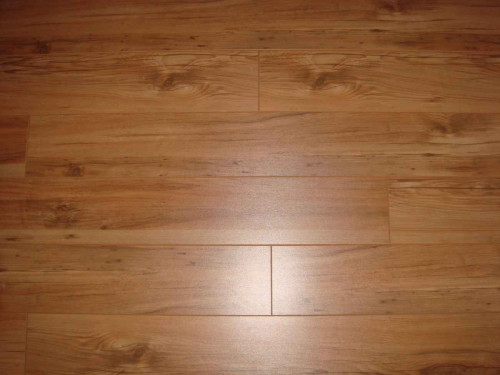

post May 31 2011, 09:07 PM
18 posts
Joined: May 2011
From: KLCC

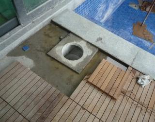

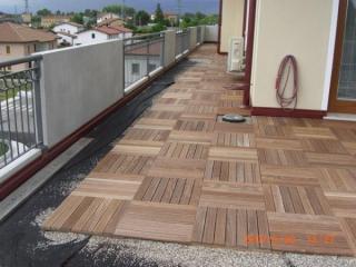

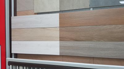

Some ideas for flooring tiles made of timber like this.
easy to install.
smile.gif)

QUOTE(zillaahmad @ May 31 2011, 09:07 PM)
easy to install.
smile.gif)
Hmm....will it gone very fast???
easy to install.
smile.gif)
easy to install, but the sand/ dirt also easy to trap underneath and the wood color also fade very fast yawn.gif

any 1 have balcony floor design. cant get much from google.
Pebble wash with tiles.

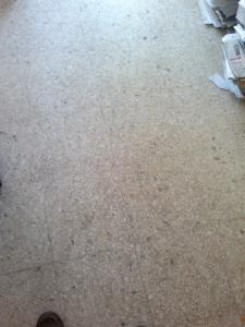

Hi
Anybody knows what kind of tiles these are? ----> just found out that this is quarry tiles.
Are they good? Not sure if I should replace it with ceramic tiles or leave them alone. They were installed on my balcony. Any suggestions?
Thanks

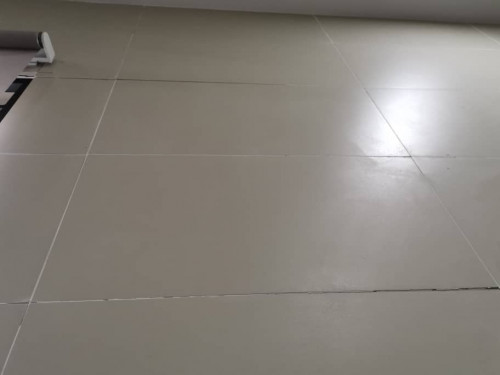

benjaminteg
post Oct 13 2011, 07:17 AM
14 posts
Joined: Jul 2008
Guys,
Need some advise here. My contractor give me 2nd grade tiles instead of 1st grade. Am very upset now. Charging me so expensive yet give me 2nd grade tiles and cheap labours. All the promise like finish tiling in 1 week, chinese sifu and 1st grade tiles all never done. What should I do. Tiling with 2nd grade already half way done. I really don;t like the 2nd grade tiles. Can share some of your thoughts about 1st grade Vs 2nd grade. Thanks.
weikee
post Oct 13 2011, 07:48 AM
10k Club
12,019 posts
QUOTE(benjaminteg @ Oct 13 2011, 07:17 AM)
Guys,
And how do you find out is 2nd Grade?
kelvyn
post Oct 13 2011, 08:28 AM
3,173 posts
Joined: May 2007
Personally, unless I know the contractor well enough, I would purchase the tile myself. At least you will know what's the product you are getting for the money spend.
As for the 1st grade & 2nd grade, this would depends on the manufacturers. Some 2nd grade tiles are just the consistency of the shades or dimensions.
If the tiles have already been installed, to change it will be like throwing them away.

Grade 1 can also be old tiles. And some Tiles manufacture will downgrade the existing tiles from Grade 1 to Grade 2 if put in stock for too long because color fade.
benjaminteg
post Oct 13 2011, 12:36 PM
14 posts
Joined: Jul 2008
QUOTE(weikee @ Oct 13 2011, 07:48 AM)
It printed on the box.
Added on October 13, 2011, 12:37 pmSo any advise since stupid contractor already put in the 2nd grade tiles.
What i worry is it may pop up when time passed.
This post has been edited by benjaminteg: Oct 13 2011, 12:37 PM
weikee
post Oct 13 2011, 01:44 PM
10k Club
12,019 posts
QUOTE(benjaminteg @ Oct 13 2011, 12:36 PM)
Don't think it will pop up, color maybe fade.
bernard79
post Oct 13 2011, 02:20 PM
70 posts
QUOTE(weikee @ Oct 13 2011, 01:44 PM)
Why these contractors using 2nd grade tiles as the cost maybe only 2/3 or maybe 1/2 of the grade A quality. For example, I was hunting for Guocera Sonara series 2x2 procelain tiles and was counter-offered for each piece only 13 rm if compared to RM20+ grade A. I ended up using all NIRO grade A Charme and Wave series for wall and floor (bathrooms and kitchen walls). The table top using NIRO black GMA29 plus white horse grey 2x2 for kitchen floor. The result is quite promising and nice but the damage is close to approximately RM 20K including workwanship which covers total area ~1400 sp feet only.
