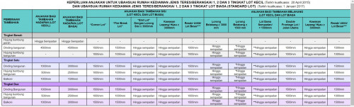

Additional Info:-

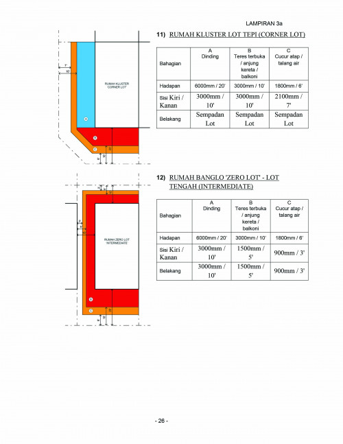

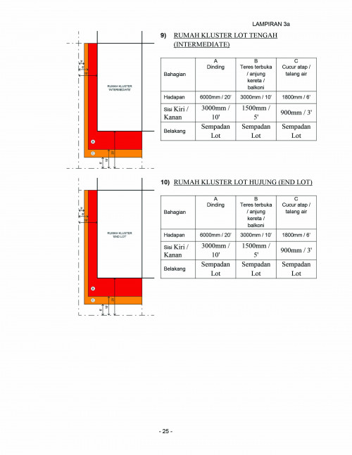

Basic building setback for terrace :-
a) front - 20' clear from wall to boundary (main gate)
b) back - can extend to end of boundary
c) side (corner lot) - 10' clear from wall to boundary
d) side (end lot) - 5' clear from wall to boundary

Yes.if your semi-D extention less than 1000sqft.
semi-D setback (wall) :-
front - 20'
side - 10'
back - can extend max to boundary (if ur house 10' clear backlane)

the setback is applied to both 1st and ground floor for front and back?
This post has been edited by seong22368: Feb 9 2015, 04:33 PM

Yes.building setback applied for both ground & 1st floor.but roof eaves depend on which Majlis your submission.some Majlis 3' clear and some 5' clear

Q : What is building setback?
A : Building setback is maximum extension allowed by the Local Authorities

QUOTE(haikalraihan @ Apr 13 2015, 11:13 AM)
Sorry to not answer all your PM.quite busy lately.
There are some popular questions into my inbox.
Q : How long the approval will be obtained?
A : 1-2 weeks depends on Local Authorities
Q : Can house owner use their own Tong Roro?
A : Yes & No. For DBKL & MBSA area, house owner needs to use their registered contractor but MBPJ, house owner can use their own Tong
Q : How much is the penalty to be imposed if renovation started without permit / approval?
A : 10-20x from processing fees. Example; Processing fees : RM500, Penalty : RM500x20 = RM10k
Q : What are the difference between Standard Book & Architectural Plan?
A : Standard Book only for basic extension without flat roof.
Q : Internal renovation also needs approval plan?
A : Yes if there are new internal structure (brick wall / beam)
Q : Awning installation does require a permit?
A : No
Q : What is CCC?
A : CCC is Certificate of Completion and Compliance
Q : Can house owner add more floor for intermediate terrace link house?
A: Yes can

TShaikalraihan
post May 6 2015, 10:45 AM
106 posts
Joined: Nov 2013
QUOTE(Bigboyz @ Apr 29 2015, 10:24 AM)
Hi, got a question. I bought a sub sale house which was extended but no permit. If I submit my plans now will I still kena the penalty?
Yes.sure kena penalty.10-20x from processing fees.depend on local authorities.
QUOTE(Antzfield @ Apr 29 2015, 12:16 PM)
Thank you so much for sharing and clarification.
In the midst of preparing for renovation including extension, these info surely very useful  rclxms.gif
No problem.
QUOTE(ahpoo @ Apr 29 2015, 03:39 PM)
if change window type and do internal wiring need approval from MPAJ?
No need but window size must be same or larger for ventilation & lighting.

kinggerrard
post May 6 2015, 04:45 PM
198 posts
Joined: Jul 2013
QUOTE(minhwa @ May 6 2015, 03:44 PM)
i didnt think too much abt permits until i read your posts a few times.  i am in jb, and most people here dont talk abt permits, or go the kawtim way.  you are right, better to go the proper way.
but, i have already given the go ahead to a masonry guy to build a 6' side and back walls.  do you think it is reasonable risk to just let this go ahead since it is just a simple project?
will this affect my future reno projects when i apply for permits?
If you're doing extension works, should submit the plans to local councils. You can check with JB local council (Jabatan Bangunan) on the standard plans to purchase for the simple kitchen extension works.
SUSsupersound
post May 6 2015, 04:48 PM
10k Club
11,554 posts
Joined: Aug 2009
Do you know that local council has the rights on asking you to redo back to original on top of getting summon?
Trust me, better follow the rules, this is for you to claim insurance when something happens.
If your house caught fire, the wiring is the factor. If insurance company found out that you did renovation without approval, they can use this to reject your claim.

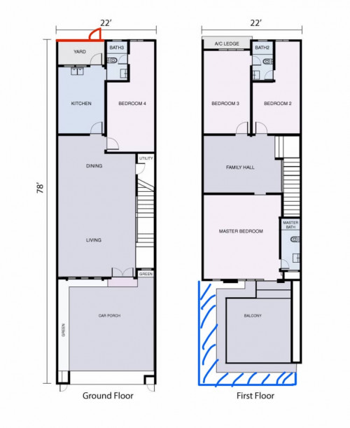

Lets say if I want to extend my Master Bedroom till the balcony only , which in this case involve hacking of the interior wall only, do I need approval from the local council ?

QUOTE(ginko15 @ Jul 14 2015, 01:46 PM)
Yes, consider as extension and u need to hire architect & engineer.

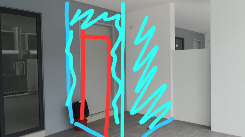

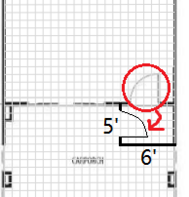

Any known limitation on width of gate for 20' house? MPK informed me that the 'kebuk sampah' a.k.a. rubbish box has to be within the pillar somewhere but according to the standard plan book, the width of the gate can't be more than 10' sad.gif

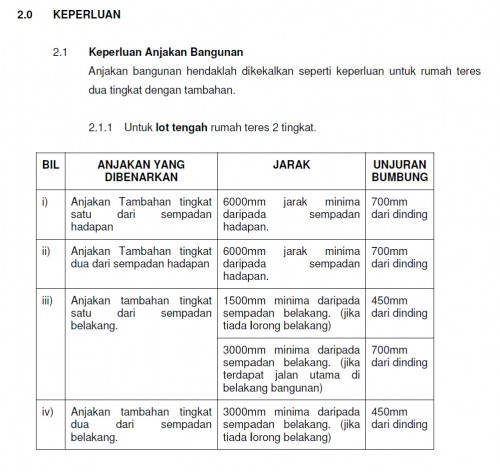

QUOTE(drfauzims @ Jul 21 2015, 12:15 PM)
I have renovation and the setback not following the law. Should I knock back the front wall and side walls to meet the set back and make current room smaller or I just replace with tempered glass? I need architect to submit plan to make it legal.
Cheras DBKL
Yes, u need to demolish front wall to 20' (6.096m) for setback. Or u can make rayuan to DBKL for as-built drawing and pay penalty 20x from processing fees.
QUOTE(kutitata @ Jul 22 2015, 06:48 AM)
I have the same question, what if the semi-d has no backlane but there is a 10' ground at the back before the wall, can we extend max to boundary?
For semi-D with no backlane u can extend only 5' and another 5' reserve for building setback.
QUOTE(Archronicles @ Jul 22 2015, 05:28 PM)
Yes, kebuk sampah has to be within the main gate pillar. if u demolish that box to make ur gate wide, u need to submit rayuan to Perbadanan Pengurusan Sisa Pepejal Dan Pembersihan Awam (PPSPPA).

Archronicles
post Jul 27 2015, 02:24 PM
262 posts
From: Klang
QUOTE(haikalraihan @ Jul 27 2015, 01:18 PM)
Bro, any idea of any known limitations of making the gate wider? And can the Syabas water meter be relocated?

QUOTE(Archronicles @ Jul 27 2015, 02:24 PM)
Yes u can. but u need to submit your rayuan and location plan for new meter to Syabas.

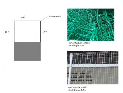

post Dec 28 2015, 05:22 PM
794 posts
Joined: Feb 2010
Hi Haikal,
Would like to check with you, just completed a renovation lately for my new house.
Following is the scope of the renovation:-
1. Building a wall at kitchen backyard(previously is a green colour fencing). No extension at the kitchen. Add roof awning.
2. Plaster ceiling.
3. Additional of power point.
Base on above scope, do I still need to submit for MPK approval? Between my area is klang.
Hope you can revert back, thank you.

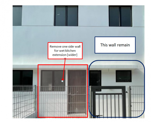

my intention was to extend ground floor backyard for wet kitchen with slab (not roof), so mps requested for plan submission. mps given panel architect and i called one of them. the architect told me why not draw plan for 1st floor as well, in future no need waste money to redraw plan if want to extend 1st floor.
is it possible since i only need to extend ground floor?

extend ground floor backyard for wet kitchen with slab (not roof), mps's panel architect quoted rm2000 for drawing+permit+runner.. is this a good price?
fyi, exclude rm500 for deposit.. so total payable rm2500 (rm500 can take back).

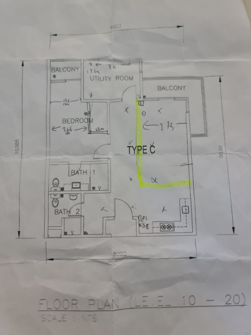

Can I do extension if I live at ground unit of an apartment? I have 6-8 feet of space between my front door and the parking lot. I was thinking about adding a front porch. Is this legally allowed? Is there a basic building setback for apartment? tq

If hack a hole to replace with a door at 1st floor master bedroom so that I can access my balcony (no extension); do I need MBSA permit?
i think is not needed, but better check to confirm.

QUOTE(aarontan78 @ Jun 26 2016, 10:26 PM)
no need unless it is gate and guarded under jmb

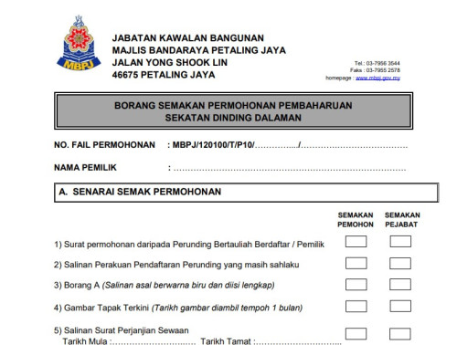

post Aug 10 2016, 04:36 PM
56 posts
Joined: Nov 2008

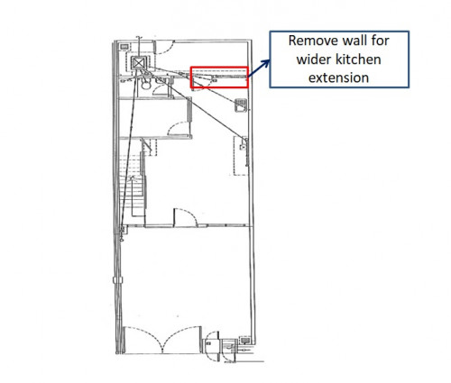

Hi, I have a double storey house (20x60) and want to do a minor renovation.
Internal work doesn't touch the structure. Maybe hacking off small part of the wall due to the window removal at the kitchen else it will fall off cause its attached to the upper beam.
External work at the backyard, remove existing fence. Cover 3/4 of the area with brick wall and rooftop. Another 1/4 area covered with polycarbonate rooftop and anti-climb fence.
Below are the required doc by the MPSJ panel architect.
1) SPA full set with layout plan
2) Previous owner SPA
3) CF
4) Latest Cukai Taksiran Receipt
5) Photocopy of I/C
I do not have the layout plan with me. Previous owner (Second home buyer) doesn't have it in his SPA too. The architect said if don't have then need to pay him another Rm300-500 (I forgot the price) for him to measure the house and draw out the layout plan of the house.
My questions are:
a) Is the original layout plan required for submission too to MPSJ?
b) Do I need to submit plan for the internal as stated above?

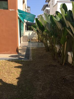

Hi , i'm planning to do renovation for my semi-D (42x80 , build up 32x45) in Klang and the renovation consists of ~
Back extension with flat roof of 7x32
Side extension of awning with level up floor
What kind of approval i need to apply from my local authority (MPK) & how much would it cost me ?
My few neighbour has started their renovation similar to mine & mentioned to me that such drawing plan that MPK would not approve & they have been order to change the renovation in 14days if not kena saman of 50K or 3 years sentence. they got this after MPK officer drop by but proceed anyway. shocking.gif
I need some advice on this issues as i'm thinking to kick off my renovation end of this year.
Thanks & rgds

TShaikalraihan
post Aug 17 2016, 09:02 AM
106 posts
Joined: Nov 2013
QUOTE(kcsy1221 @ Aug 10 2016, 04:36 PM)
3) CF
5) Photocopy of I/C
My questions are:
a) Yes to ensure that house are same as drawing.
b) Yes if there is demolishing works
QUOTE(SimpleGuy16 @ Aug 14 2016, 10:34 PM)
Thanks & rgds
Yes u cant extend 7'. only 5' will allowed because ur balance setback at the back only 15'...15-5=10'

I have a question for extension of front parts of a double storey intermediate link house (20'x70'). Under MBSA jurisdiction. Hope to get advise.
My immediate neighbour started their reno last Saturday. The contractor told us what he is "order-to-do":
A. Ground Floor
Extend front door/living hall area
The new column together with the new wall/door will be 10' from gate.
B. 1st floor
Extend Master bed room.
Yes, the new floor plan will have 2 "medium size" bedrooms instead of one big bedroom.. This also means that, the rooms are above the newly extended GF living hall/main door area.
I am very concernn because this consider major reno works. And it involves "my column" (our sharing column).
The contractor says he will not "touch" the existing column but to add new one to support the additional loads of the new structures. Not doing "machine piling". Will manually tie the new column next to the existing one.
Question 1: The new column will stand alone?? How is its support? I think new one needs to be tied to the old one, yes? Hence, sure will affect my house structure, yes?
Question 2: The contractor mentioned he is pending MBSA's approval. I doubt if he has submitted the proposed new floor plan, this reno will still get an approval.
I have briefly browsed through the MBSA's extension guide lines. Found that:
a. New wall to gate must be at least 20' distance
b. new column to gate needs at least 10' distance
c. 1st flr can be extended as balcony purpose only, not ROOMs.
Their reno plan actually not following the rules!
Am I correct?
Question 3: Let's say, they submitted a "follow-the-guidelines" plan and got their permit for reno, but in the facts, they are doing a "not-follow-rules" reno, what can i do now? What will MBSA do?
Question 4: If the final renoworks are the "not-follow-rules" version, how do i make sure "my column" is still safe/not weakened? Can i request my neighbour to give me a architect's dwg?
I could be selfish by causing hickcups in neighbour's reno process. But this is affecting me, my family and my home. I am trying very hard to protect these all.
Hope you stilll generously comment here. Pls correct me if i am wrong. I wish you tell me "no dude, that reno is a small issue and not to worry about".

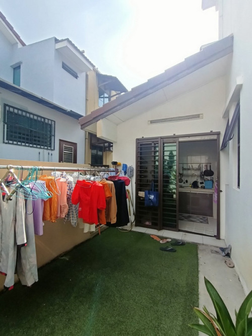

Dear all,
Please help -- i have a semi-d in PJ. We are about to extend the back to add an utility room, but the management office have said we need to apply planning permission from MBPJ.
Attached is an image of the backyard. After extension, the space between the wall and the backyard fence (shared fence with our back neighbour) will be 3ft.
My contractor doesnt know how to do apply permission from MBPJ.
Does anyone have recommendations on someone who can do the drawings and submissions with MBPJ asap?
thanks a lot.
Attached Image Attached Image

QUOTE(Plas28 @ Sep 16 2016, 11:46 AM)
Dear all,
thanks a lot.
I'm actually planning to extend my backyard also but what is the allowable minimum space required between the back wall and the back fence for a Semi-D?

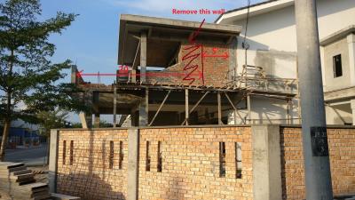

QUOTE(solame @ Aug 17 2016, 02:39 PM)
A. Ground Floor
B. 1st floor
Am I correct?
Yours sincerely,
Solame
Question 1 : Your assumption is correct. Whether it will affect the structure or not in a negative way, nobody can tell as it will depend on the load that is imposed on the existing structure. Usually the original design will have a factor of safety so in most cases with additional loads (new column), it may be ok if the loads are not excessive. If excessive then there will be settlement.
Question 2 : Not sure, but from what I observe, most private renovations do not go through the proper channel with authority submissions. Some cases are even shocking, a 2-storey converted to 3-storey, a whole new floor added. I am not sure if it this one has gone through the proper channel.
Question 3 : MBSA can come and inspect and issue a fine if it is proven that the guidelines are not in compliance.
Question 4 : Subject to argument with your neighbour. I think the relationship with your neighbour will be severed with this, but if you feel strongly about it then go ahead.
* As a note, if your neighbour wants to do this properly, he does not only need to engage an Architect and Contractor but also a professional engineer to do the design of the new foundation and make sure everything is safe and in order.

i have a question i hope you can help me out. i was planning to extend my kitchen; extra 5 feet. and i have engaged with 1 of the architect from the mpaj. i realised he had drew the window smaller than what i told him and is not at the right location (i wanted it to be at the middle instead of 1 sided). now is it fine to do reno with slight different from plan (just changing to bigger window)? would i be inviting trouble with mpaj if they come to check? or should i just ask the architect to redraw (i assume there willbe new charges)?
thanks..

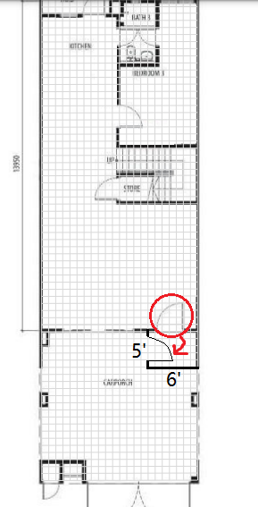

Was thinking to renovate my master bedroom on the 1st floor only and came across this informative page, thank u so much. I live in USJ, Subang Jaya and planning to extend the masted bedroom. Anyone here got good recommendation for drawing & submission of architectural plan for MPSJ? as also renovation guy? Thanks in advance.

QUOTE(echoesian @ Sep 19 2016, 01:04 AM)
If there is no lorong behind the house then you'll need a setback of 5ft from the boundary.
thanks..
Slight difference in window size and placement should not be an issue and won't need you to resubmit.

Dear All Sifu
My uncle would like to extend his zero-lot bungalow to the back boundary.
currently there is a set back 10ft. However, due to the approval guideline from MBPJ saying that there must be a set back of 10ft.
Do anyone know is there any other options we can sort it out?
thank you very much

Anyhow what do you guys think?
Thanks
This is consider a major renovation. So naturally you will need a proper procedure for approval. MBSA is quite stringent.
You have to engage architect AND structural engineer to design for the load, and submit for approval.
The current structure for the part you are saying is designated to carry only the ground floor and roof load. Existing roof beam cannot carry the load of another two storeys of concrete, furnitures and live load (humans).

We recently bought a sub-sale 20year old end lot terrace house. Situation is that ex-owner has lost the CF.
We can tell from the original plans given that extension has been done to the back of the house (all the way to the boundary line).
How do we go about getting the CCC and will we get fine? Is there some 'waiver' given if we have just taken over the house and show that extension was done by previous owner?
Appreciate recommendation from those who know of persons/architects I can contact for quotes on how to get this done. My house falls under MPPJ
Also, need advise on setback.
My house has a 5ft side garden. Is my understanding correct that I must leave this 5ft as garden and cannot extend all the way to the end of the boundary?
I am asking because my nieghbour (mirror unit) extended the 2nd back half of the house all the way to the boundary.

This afternoon I went to a client's place at BU terrace house area, saw the end lots are mostly done to the boundary...means like wall - 10ft road - wall... maybe you can check with MBPJ see if they have standard plans. Just go to the annexe building first floor and have a look at the standard plans on display...otherwise ask them.

Just curious. Planning to do extension [ground floor only] at the back of the house [Semi-D, no road at the back].
Neighbor houses done similar renovation [they did both ground and top floor].
I went and asked them regarding their planning and permit application. They mentioned that most of the owner in that area did not apply for one. They told that if Majlis personnel come and check or anything just pay fine and it's done [though so far no issue, been 12 years since they did renovation]. Talked to two more neighbor, same response [though one got fined RM300 and that's it].
My question is supposedly we want to do extension but it's not going to be allowed, is it safe to continue as per what the neighbor did? If it helps, location is Kluang, Johor.
Layout of the house as below:
Blue Line = Property Edge [Fences etc]
Red Line = Built Up Size
Green Line = Planned Extension [About 7-8 ft wide]
Orange Arrow = The road in front of the house
Any help is appreciated.
Thank you.
Reubs

You should do it the legal way. Sooner or later the town council they'll come chasing.
This happened in my area:
http://www.thestar.com.my/metro/community/...urther-delayed/
StarMetro reported (“Chance to legalise illegal renovations”, Feb 18) that from March 1, MPSJ was giving houseowners a one-year grace period to submit their plans.
This means those who have not submitted renovation plans to the council are exempted from the penalty, which is 10 times the processing fee.
Property owners will still have to pay the plan processing fee, which ranges from RM100 to RM1,000 depending on the extension, and compound arrears.

2. Titles on floor
3. install a 3ft grill on top of the wall
4. Awning to cover up the whole area

hi, need some help plan to extend kitchen
5ft from backyard witin boundary of 24x75 with concrete
flat roof only groud floor intermediate lot double story house.
can i use mbsa standard layout for apply permit?
so can save some money no need hire people draw. can i draw myself?using autocad?

Hi, just want to share DBKL new guidelines for terrace house extension and renovation
#GARISPANDUANDBKL #PEMUTIHANDBKL
Ramai yang bertanya tentang Garispanduan Ubahsuai Kediaman Rumah Teres dan Program Pemutihan yang dijalankan oleh DBKL.
Untuk program pemutihan DBKL memberi peluang kepada pemilik yang sebelum ini tidak memperolehi kelulusan untuk submit pelan permohonan dan mendapatkan permit. Tertakluk kepada undang-undang kecil bangunan. Pada dasarnya kesemua tambahan yang berada didalam lot pemilik akan diberikan permit setelah membuat submission pelan.
Jadi kami sediakan link (pautan) untuk anda sebagai rujukan
Garispanduan DBKL by LukisPelanKL
(3D Perspektif) https://goo.gl/dbdQkJ
Link Download Garispanduan DBKL
(Lot Kecil) https://goo.gl/2frWkb
(Lot Biasa) https://goo.gl/EGWhzz

may i know if condo balcony want to reno by adding a door (to close of the aircond compressor place by the developer which is an eyesore) need dbkl approval? condo mgmt says since its related to facade nees dbkl to approve else can get fine when obtain strata title later on. any advice sifus

Would like to know the below renovation for my masterroom balcony, it is need approval ?

I recently bought a single storey terrace house which is considered an end-lot as it is next to a lane. The previous owner has extended the back portion and the side portion of the house. I am not sure if the extension has the proper approval and whether there was a CF or CCC.
I am planning to change the whole roof of the house replacing it with mild steel trusses and new roof tiles and will be replacing the fencing around the house with new brick wall on the side and front of the house.
My questions are as such:
1. Is there a way to check whether the previous extension has the proper approval and CF/CCC obtained?
2. If there is no proper approval, can I get an architect to help submit drawing with the existing extension in place to DBKL and then get the architect to issue the CCC?
3. If anyone can provide such services kindly do PM me as well.
Thanks in advance for any replies to my questions.

I am planning to do a kitchen extension for my Double storey Cluster house in JB.
Would like to ask for contact of architect that can help with the permit application to MBJB?
Thank you in advance.

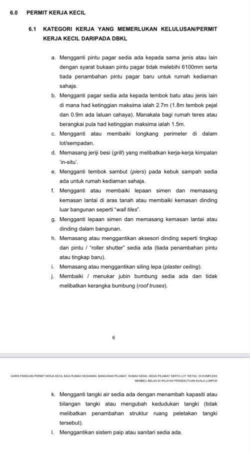

For renovation of houses under DBKL's jurisdiction, you may download from DBKL bangunan's official website. Attached link below.
http://www.dbkl.gov.my/index.php?option=co...atid=53&lang=en
hten
post Dec 19 2018, 09:07 PM
22 posts
Joined: Jul 2016
And this is for MPSJ
https://ocps.mpsj.gov.my/cms/documentstorag...%20Kediaman.pdf
hten
post Dec 19 2018, 09:10 PM
22 posts
Joined: Jul 2016
As for MBPJ, there's a standard pelan setara for standard renovation at RM100 per plan.
If is a customised plan/layout, then the usual procedure of engaging an architect applies
Attached link below:
http://www.mbpj.gov.my/sites/default/files...nduan_sem_2.pdf

Hi sifus, for mbpj if I want to change the width of my gate to a larger size. Would I need approval for this or I can just do it ?

mephyll
post Sep 6 2019, 12:47 PM
428 posts
Joined: Sep 2017
Refer to Post#1
this apply to 1st floor as well?
i plan to extend the master bed room as per attached.
Authority fall under Majlis Perbandaran Selayang
For building wall the setback (from the front boundary) for Ground floor and first floor has to be 20'. If it is a balcony the allowance will be 10'.

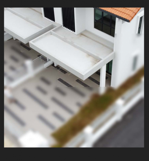

Hi, I'm in trouble.
My house first floor have 25', but i've extended until left 16'.
Now the MDKL ask me to remove it, they said only allowed to 20' only.
I'm planning to remove it soon, but just wonder is there any way to not remove the pillar (the 4' door there).
I saw your comment said "If it is a balcony the allowance will be 10'"
May I know what you mean balcony allow will be 10'?
can you provide me an image as example? I'm not sure how the balcony look like.
Based on my image, do you think is there any way I can remove without removing the pillar?
This post has been edited by hendry91: Oct 7 2019, 04:34 PM

hendry91
post Oct 8 2019, 12:07 PM
110 posts
Joined: Jun 2015
QUOTE(jason5443 @ Oct 7 2019, 05:27 PM)
How did it trigger MBKL? Can we extend the car porch to main gate?
I've no idea, suddenly kena saman.
my kampung alot people over extend, some even "fully extend". But nothing happened to them. If kena saman, can easily settle without remove it too.
But now new government, new style, keep asking me to remove.
Before I extend, I didn't know must left 20', if not I won't extend over.

QUOTE(hendry91 @ Oct 8 2019, 12:07 PM)
You didn't employ any architect isn't it? Or else you would have avoided all these hassle.
For MDKL I have no idea how much of extension to be allowed for the balcony, different authority have different standard. Some don't allow to extend out from the 20' feet setback, meaning the balcony have to had 20 setback and cannot beyond that, some allows 5' potrusion from the 20' setback, some allows 10 feet potrusion from 20' setback. So I cannot answer your question because I do not know what is MDKL standard. basically for all authority other than DBKL, terrace house extension for front facade have to had 20' setback to the wall (for internal space, bedroom etc) for Ground floor and the upper floor.
hendry91
post Oct 8 2019, 03:52 PM
110 posts
Joined: Jun 2015
QUOTE(jychook @ Oct 8 2019, 03:25 PM)
I did, but my floor plan didn't include the first floor bed room.
I just ad-hoc, plan to update the floor plan later if get caught. But didn't know must left 20' doh.gif
hendry91
post Oct 8 2019, 04:12 PM
110 posts
Joined: Jun 2015
Sorry, actually I'm not understand what you meant.
But never-mind, can you comment based on the image below?
Currently my build like this. 16 feet left
But the MDKL officer told me if I change to 20 feet, then acceptable. Like the image below:
Is that true? the only way I can do is remove it like the second image?
This post has been edited by hendry91: Oct 8 2019, 04:15 PM

QUOTE(jefflim1981 @ Oct 12 2019, 02:37 PM)
Any guide line for cluster link house at Bandar rimbayu area
It is under MPKL (Majlis Daerah Kuala Langat jurisdiction. This IJM Bandar Rimbayu development is free hold and having individual title so you may renovate it. Guideline follow MDKL guideline.
Thanks

QUOTE(jychook @ Oct 16 2019, 11:00 AM)
Thanks
I saw much owner extension like my floor plan, can you share the legal extension guideline
jychook
post Oct 16 2019, 06:48 PM
60 posts
Joined: Oct 2011
QUOTE(jefflim1981 @ Oct 16 2019, 06:12 PM)
my advice to you is to engage an architect and let them advise you on the allowable design parameters. All local authority has different sets of allowance and limits on renovation and extension. I have not done any MDKL project before, so I cannot advise you on this matter. A further enquiry is needed to check with MDKL. You can check with MDKL JAb Bangunan. Thanks

Hi I would like to do a simple kitchen extension 4' x 24'. Please PM me for submission to Majlis Perbandaran Sepang. Thanks!
https://pictr.com/images/2020/05/02/5Dgm26.md.jpg
