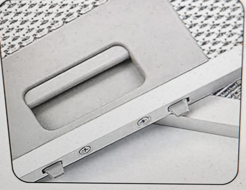

1) A good filter system with oil cup
Here is a comparison between aluminum mesh filters vs pyramid shape filters
I will update more info everyday, do not have time to explain everything in one day.

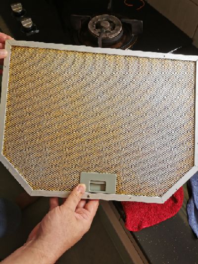

Attached Image Attached Image

Well as shown we cook a lot and we used to have rinnai hood with mesh filter. Previously bought it bcoz rinnai is a famous brand and also made in japan, the flat mesh also looks nice and i do agree hood with oil cups are ugly. For someone who actually used both type i would say mesh is a big no no. Not sure how many of you here actually used both types before? Belum cuba, belum tau . . Btw wei kee u working for jf? C u always promote for them

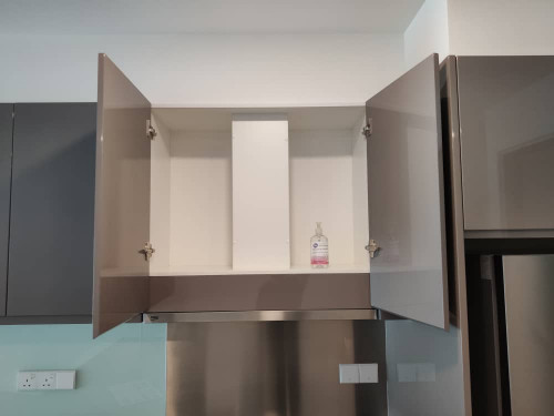

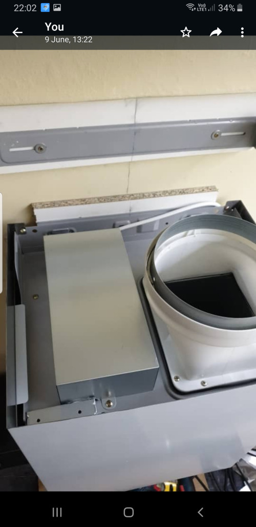

Just got an Rh-993CT from jf home in puchong together with a stove.good service, recommended to those interested in rinnai products.
However, one of the cabinet makers say they cant hide the hob in a cabinet due to lack of ventilation might damage the hob. Seems logical but is it true?
weikee
post Dec 29 2013, 06:16 PM
10k Club
12,019 posts
QUOTE(aztechx @ Dec 29 2013, 05:49 PM)
You got the recycling or with ducting?
aztechx
post Dec 29 2013, 07:35 PM
~Aviation Freak~
3,854 posts
Joined: Mar 2006
QUOTE(weikee @ Dec 29 2013, 06:16 PM)
I got the one without ducting. Any idea if it can be concealed in a cabinet?
weikee
post Dec 29 2013, 08:09 PM
10k Club
12,019 posts
QUOTE(aztechx @ Dec 29 2013, 07:35 PM)
The cabinet need to have ventilation, if not howbtge sucked air flow out?

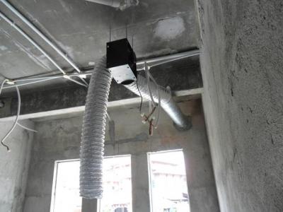

QUOTE(weikee @ Dec 29 2013, 08:09 PM)
I was thinking of a hole on top of the cabinet with the shape of the chimney.any alternatives i can consider?
weikee
post Dec 29 2013, 09:39 PM
10k Club
12,019 posts
QUOTE(aztechx @ Dec 29 2013, 09:10 PM)
Sound workable, or put cabinet door with small small holes.

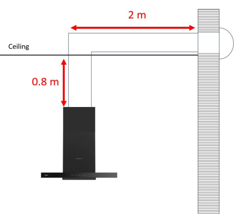

hi guys.. is it true that hood's ventilation cannot be more than 10ft?

QUOTE(Like a Bause @ Jan 27 2014, 12:49 AM)
the suction power needed to be how much onwards? my kitchen i think needed 13ft.. would there be any problem if the hose is too long than usual ?
The longer it goes the performance will drop. When the manufacture do the specification, they test on certain length. Just list straw long mean harder to suck.

QUOTE(weikee @ Jan 27 2014, 07:40 AM)
i see.. do you know roughly how much the suction power is needed for the length lesser than 15ft ? for those below 10ft, i guess would be at 1000AF right ?
another question, will there be any oil clog in between the hose if it is too long? any other issue would encounter if using it in long run? unsure.gif

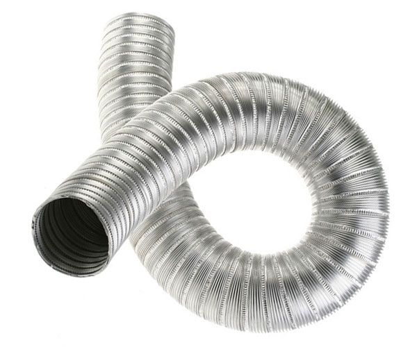

XAM MAX
post Jan 27 2014, 12:10 PM
150 posts
Joined: Mar 2013
From: xam max kitchen 018-221 5022
Good example to make people easy to understand the theory.
If install the flexible hose more curve will influence the performance as well.
This post has been edited by XAM MAX: Jan 27 2014, 12:14 PM

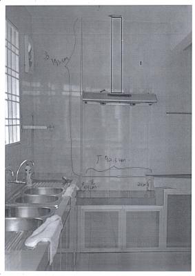

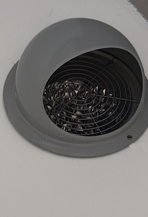

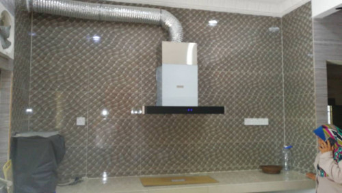

Noticed in my area most houses use fans like those pictured...

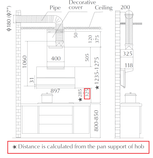

Hi all sifu ... I plan to buy Fotile hood EH10BQ , I got 1 question .. my contractor told me that the original ducting hole not good and some say that Fotile ducting hole are very good no need change ... which one is true ? should i change or using back the original... Pls help thanks ....
TSzheilwane
post Mar 3 2014, 09:47 PM
4,184 posts
Joined: Jan 2008
From: Builders Hardware Enterprise 0362572412
QUOTE(davidlim_iphone @ Mar 3 2014, 09:34 PM)
Standard ducting is 6" diamaeter but FOtile is 7". If u r planning to get EH10BQ den u must use Fotile hose
davidlim_iphone
post Mar 3 2014, 10:01 PM
43 posts
Joined: Feb 2014
QUOTE(zheilwane @ Mar 3 2014, 09:47 PM)
So it means no need hear what my contractor say , just use original hose ...MMmmm by the way can you share the price for install Hood + make 1 7" hole ... Thanks tongue.gif

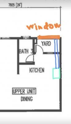

Hiii,
I need to install the cooking hood & hod for my 1 room apartment where the kitchen has no window with limited space. As it is for renting, I am not intend to put in too expensive items.
May I have the expert's advise? : )

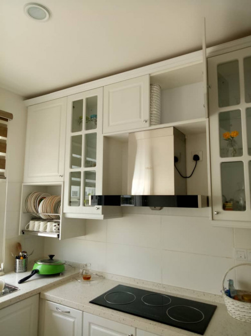

Doraemon11
post Mar 10 2014, 11:11 AM
530 posts
Joined: Jul 2008
I need HELP from all sifu here plssss!!
refer my pic ... my oven just allocate at the bottom of the hod gas pipe.
The gas man told me i cant allocate this way as the oven heat will melt the gas pipe ... very dangerous. shocking.gif
Is what he said true??
Any solution for me??
do u kno any radiating material which i can use it as divider to avoid the pipe directly sense the heat from oven??

Kevin Chan
post Mar 10 2014, 11:14 AM
1,997 posts
Joined: Oct 2013
QUOTE(Doraemon11 @ Mar 10 2014, 11:11 AM)
drill a hole on the dividing board and pass the hose over the hole. settle. rclxub.gif
weikee
post Mar 10 2014, 11:40 AM
10k Club
12,019 posts
Can't recall how the build in over design, if the heat are ventilated on the rear, the heat can harden the gas hose.
I saw you have a plug point where your gas tank locate, isn't it dangerous? imagine gas leak and your plug point spark..
Doraemon11
post Mar 10 2014, 12:47 PM
530 posts
Joined: Jul 2008
QUOTE(weikee @ Mar 10 2014, 11:40 AM)
i believe there are ppl installation as the same way oso... some may just exactly the bottom of the hob like below.
aaronpang
post Mar 10 2014, 02:03 PM
Cat Exterminator
1,979 posts
QUOTE(Doraemon11 @ Mar 10 2014, 12:47 PM)
Depends some countries, home owners have to use rigid copper piping, so the risk of melting is not there.
TSzheilwane
post Mar 10 2014, 05:51 PM
4,184 posts
Joined: Jan 2008
I got customer install that way as well, so far no problem. Try turning on the oven then lift up the hob and feel the temperature inside of the cabinet. I bliv it wont b too hot as the hot air is blown infront of the oven not rear, if it is too hot wont the wire of the oven melt as well? If really hot, may b use insulation like air con to protect it
Is the plug for the oven? it looks like a 13amp plug while most ovens require 15amp

weikee
post Mar 10 2014, 06:26 PM
10k Club
12,019 posts
QUOTE(zheilwane @ Mar 10 2014, 05:51 PM)
Got customer install that way doesn't mean is safe.
Doraemon11
post Mar 10 2014, 06:38 PM
530 posts
Joined: Jul 2008
about the plug i will look into it later... thank for reminder
My bro teach me use aluminum foil to cover up the open area there to isolate it.. does this work?

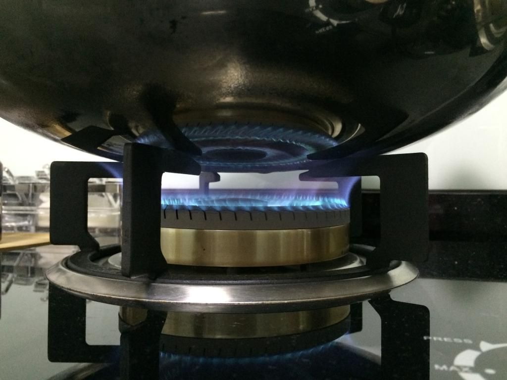

TSzheilwane
post Mar 24 2014, 09:37 PM
4,184 posts
Joined: Jan 2008

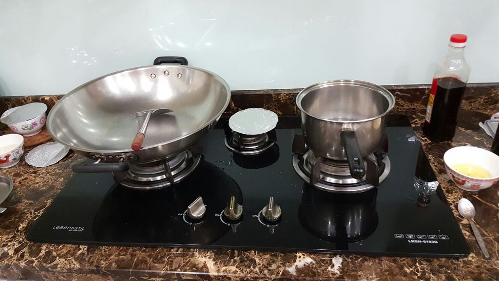

QUOTE(BuFung @ Mar 23 2014, 10:16 PM)
Any of u guys can advise on the rubine prado2B? Choosing because it size small enough for my kitchen existing hole...
Thanks.

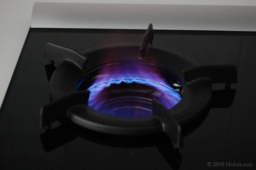

Flame is strong enough, value for money. Here is a comparison i recorded. Top left burner is Rubine prado 2b
This post has been edited by zheilwane: Mar 24 2014, 09:38 PM

Hi all sifus , wanan ask bout recirculating ( ductless) vs ducted hood.
I stay in a condo so i have no way to drill a hole for the duct , and the window is quite far away ( at least 10' to the window, even more if i place the hob further). If i choose ducted hood , i will have to build plaster ceiling or cabinet to hide the ducts.
So , I am considering to use recirculating hood . Certainly i know that the functionality of it is lower since air is released back to the room , but how bad could this be? would a recirculating hood appears to be close to useless?
This post has been edited by jasmine0085: Mar 26 2014, 05:44 PM

Ofcoz having one is better than not having anything. Recirculating hoods help to remove airborne grease and reduce odor. Ofocz, a ducting one is much better as it could reduce more odor, suck out heat, lesser maintenance and etc.
This post has been edited by zheilwane: Mar 26 2014, 08:26 PM

So in a situation where ducting would need to run more than 10ft, which is better: recirculating or ducted?

QUOTE(azleena @ Mar 26 2014, 10:10 PM)
Still duct, i got customer using Fotile EH10BQ with 15ft and he say it performing well.

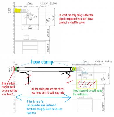

Guys usually what is the standard practice for making the hole for the duct hood?
I know that its gotta be center of our hob.
My tabletop height till ceilling is 6ft, also the hole gotta be 7inches right?

post Mar 29 2014, 07:26 AM
1,140 posts
Joined: Oct 2011
Hey guys my setup of things for the hood and hob is something like this
Is it ok? any error?
Actually i worried that the cover of the ducting hood will clash the socket no. 1, thus making the hood not going to be center of the hob.. and if the mosaic has been fixed, my choice of hood would be limited to compensate that socket.
I ask the wiring guy earlier to just put wire for the hood and the power switch for it somewhere close to normal power socket. His reason cannot do like that is because later maintenance hard, quite weird i saw other forumers what they did is just ready the wire for hood and the power switch for the hood at different location far from the hood itself..
What i need to fix since today they going to mosaic it.. is it the position of the no 1 switch?
This post has been edited by soR: Mar 29 2014, 07:35 AM
weikee
post Mar 29 2014, 08:09 AM
10k Club
12,019 posts
QUOTE(soR @ Mar 29 2014, 07:26 AM)
I put mine in the center / slightly offset to the center of the hob.
soR
post Mar 29 2014, 09:25 AM
1,140 posts
Joined: Oct 2011
QUOTE(weikee @ Mar 29 2014, 08:09 AM)
The hood?
weikee
post Mar 29 2014, 09:34 AM
10k Club
12,019 posts
QUOTE(soR @ Mar 29 2014, 09:25 AM)
The hood?
Sorry typo error. Yes hood. Actually you don't need a socket just wires. And the on/off switch is at the lighting switch there.

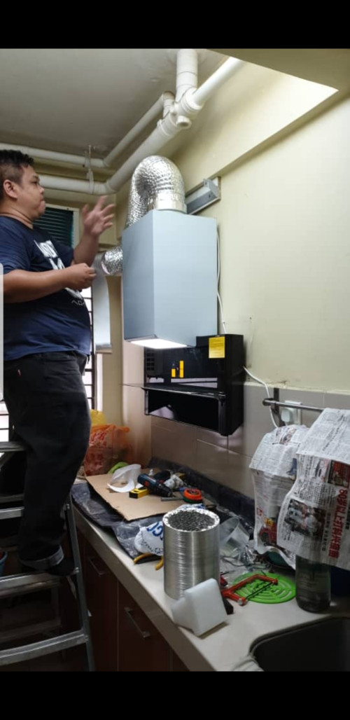

TSzheilwane
post Apr 14 2014, 09:48 PM
4,184 posts
Joined: Jan 2008
QUOTE(zoe33 @ Apr 14 2014, 01:11 PM)
does purchasing from builders include installation of hood and hob as well as the duct pipe?

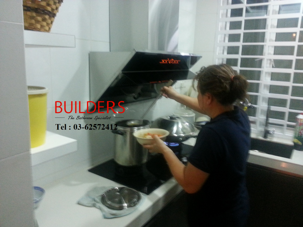

We only sell as FOTILE does not provide installation but if u need some1 to installer we can recommend our installer.
Here is our my installer install for my house
zoe33

Having recently received the keys to our first house (in Ipoh, lot size 20 x 70), my wife and I are planning to do some minor improvement work with our limited budget to make our home a functional a comfortable living space. Attached is an amateurish floor plan I attempted to draw using a the free (non premium version) of MagicPlan app available on Play Store.
In a nutshell, we do not plan to break/build any walls and, at the moment, the following list is an approximate idea of what we intend to do:
1. Grilles + Awning for Laundry Room
2. Wiring + Additional Lighting and Power Points.
3. Plumbing (adding outdoor faucet and washer outlet)
3. Kitchen Cabinet (bottom only with simple open top racks)
4. Kitchen Appliances (Hood+Hob+Oven) --> the reason I am posting here.
After browsing through Builders Hardware FB and Xammax.my, I went to visited two Fotile dealers in Ipoh and was given the following preliminary quotes:
Dealer 1:
Recommended Rubine strongly, saying the price is much lower than Fotile, and suitable for small families who do less cooking (my wife and I both hit 30 this year and do not plan to have children in the medium term).
Package: Rubine Sapphire hood (1000m3/hr) + Rubine Prado hob + Rubine IA6 oven = RM3188
Not much effort was made to push Fotile, and the response we got was that Fotile would cost at least another RM1000. The dealer was friendly and seemed well versed with various questions though she denied being the owner of the business. She also introduced us to another promotion Cabana sink + faucet + dish rack for RM599.
Installation of all appliances is free of charge, but we will have to find a contractor to drill a 6" hole for exhaust ducting outlet. Before we left, she reminded us that prices will increase next month (don't know if this is just tactical or real).
Dealer 2:
This dealer also does interior design and kitchen cabinet. Owner (or senior staff) sat at the counter and basically ignored us (maybe she assumed us to be another pair of young punks). However, the young girl who attended to us was generally able to answer our queries and gave us a cost estimate (both for appliances as well as KC).
Package: As advertised in the Fotile March-May 2014 catalog. Fotile EH10BQ hood + Fotile GFG86201 hob = RM2700, which about RM500 less than the catalog price. As for oven, it is a PWP deal - Fotile KES6003A = RM1998 with no further discount. So total price for Hood + Hob + Oven would come to RM4698.
I showed her my floor plan (U shape kitchen) and she made a quick calculation for KC (bottom only, solid wood, granite top) = Approx RM8k . If we opt for chipboard+melamine coating, it will be approx RM6k.
Dealer 2 also provides free installation.
If you have visited Builders Hardware FB or Xammax, there seems to be a world of difference in price and products available. My wife and I are now discussing whether to get these from Ipoh (free installation + after sales service but at a higher price) or to order online with better price/product options but without installation.
How difficult/dangerous is it to leave installation to another person? Should I get these items from Ipoh dealers or KL via online purchase? Appreciate your kind advice on any related matters, too. Thank you.

Hob - usually installed by kitchen cabinet people. You need to buy the hob first, so that the KC people knows what size of hole to cut out in your granite or melamine top.
Oven - usually kitchen cabinet people will help you install.
(If it is a built-in oven - then it needs to be installed in a kitchen cabinet. Cannot stand alone)
But you will want to pull a new wire for oven.
Check with your KC people where will the oven be, and ask them where to put the wire point.
Hood - this one can get independent installer.
Most shops who sell hood don't do the installation, but will recommend an installer.
No sure how easy to get in Ipoh. Also check the fees.
Check with your KC people where to put the hood. If no wire nearby, has to pull a new one.

Standard market price for install cooker hood is
RM150 for recycle type hood ( meaning will not do duct out, only will use the charcoal filter to filter the smell, and the air will blow back into ur kitchen, if u do recycle one, u have to change the charcoal filter frequently depends how heavy u cook, normally one filter can tahan up to 9 - 12mths )
RM300 - RM350 for duct out ( hack hole on wall, then install the hose for hood, then smoke blow out! )

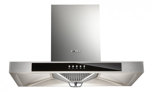

eve1231
post Apr 28 2014, 09:53 AM
1 posts
Joined: Jan 2010
May I know what's the performance wise for Fotile CTS9004? It seems to be the highest air flow among the range of Fotile's hoods but there's no review at all.
This post has been edited by eve1231: Apr 28 2014, 09:54 AM

QUOTE(eve1231 @ Apr 28 2014, 09:53 AM)
just installed cts9004 two weeks ago and so far so good. 3 levels of exhaust fan speed and noisy if I am using the level 3 (max) speed. I was using internal circulation hood previously and after changing to this, yes I can see the improvement as my floor doesn't have the oily stain after cooking and my mosquito netting is still clean. My kitchen does not have any exhaust fan and depends on this CTS9004 to recirculate the air; and it is effective as the kitchen temperature stays constant and, the cooking smell is not that significant compare to my previous hood.
not sure if this helps

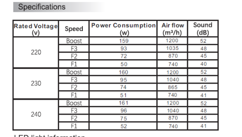

Guys, usually what's the recommended suction power for hood? 1000m3/h and above?

GAG series is a newer version of GFG, they look alike but GAG claims that the flame power is extremely strong. Actually i tested GCG (3.8kW) n GFG (4.0kW) they are equally strong and stronger than some other brands with higher kW will test out, GAG later. However, maintenance wise GCG is a one piece removable burner, hence it is ezier to clean as per photo shared by sovietmah previously

Based on our experience, every new model of FOTILE hob will have something new in term of specification and burning technology and always a breakthrough technology from its previous model. rclxms.gif

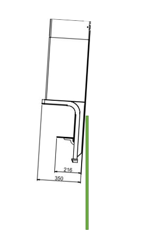

Hi. May I ask the safest lenght of the hood from its switch?
I bought eh10bq + gfg86302

Anyone can recommend reliable installer for installing fotile hood? Tqvm. My kitchen has existing exhaust fan hole ready and no hacking in required.

QUOTE(moonbat @ May 6 2014, 02:14 PM)
switch should b located away from your hood, i bliv u are asking about the wire point. Wire point should b around 1350mm above your table top.
Why not call the salesperson, they will have their own installer and the price usually is ard RM 250.

Hi Zheilwane, i have make appointment with contractor to site survey the hood installation tomolo ... i just measure i found out that from table top to hood is only left 50cm.. is that still acceptable? Thank you.

actually u can install it higher, cover up the existing hole and hack a new one. Most probably your hood's chimney will b able to cover the current exhaust hole, so u don have to tile it

Hi Guys,
If i leave in condo and my kitchen is inside with no near excess to outside, would it mean that i cant cook anything dramatic? smile.gif like frying stuff etc?
I have no idea how to vent the smoke out. Is there such thing as a 'powerful' hood that doesn't vent smoke out?
TSzheilwane
post May 13 2014, 09:30 PM
4,184 posts
Joined: Jan 2008
You can consider getting Rubine Rosemary Hood, this model has strong suction and can install either as ducted or recycle.
Eoma
post May 13 2014, 09:36 PM
Elite
4,603 posts
From: PJ
I'm planning to use my Lebensstil LKCH-9200DAP hood as a ventless/re-circulating system. Good idea ?

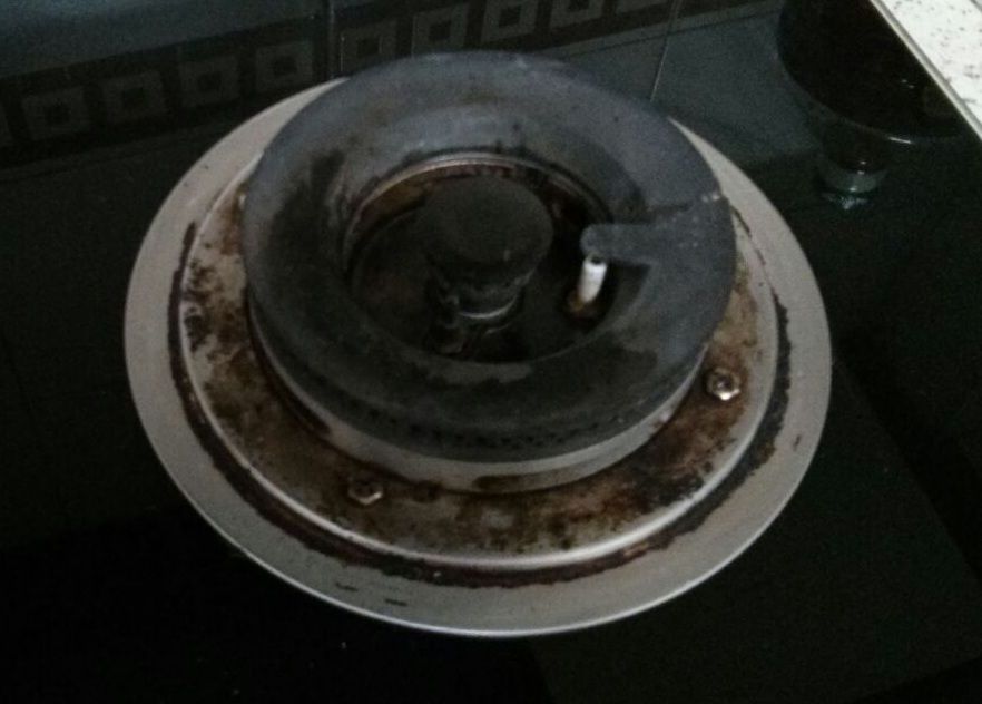

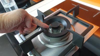

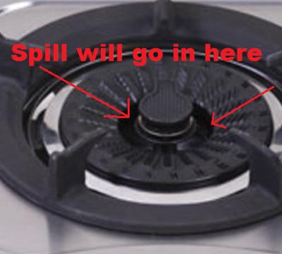

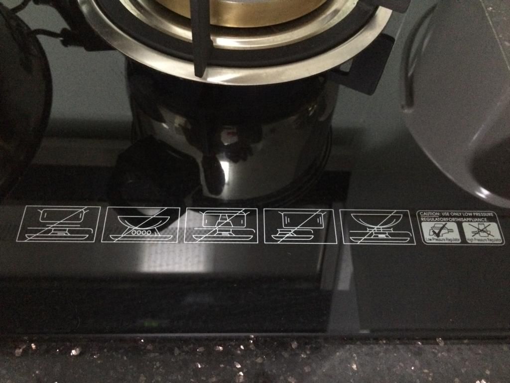

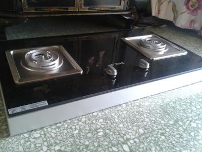

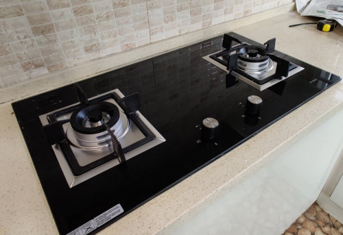

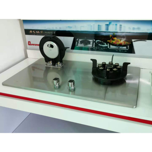

Hi mcloudteo,

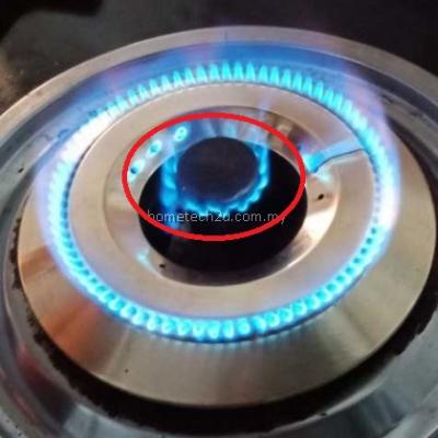

We used to have a gas hob with stainless steel and we find it difficult to clean away the stain as per photo, nd to use special cleaner and scrub.
I m using GCG 90301 as well for 6 months and it was OK but one day my grandma left a wet pot (after washing) on the hob for it to dry overnight and it rusted. Most hobs nowadays will provide cast iron wok support for better duribility but never ever ppl complain it rust as when we are cooking the flame will burn away all the water and without water it will not rust. GCG series burners are made of cast iron as well, it shouldn't rust unless there is water on the burner. However, if it did rust there is an easy and proven method to remove it as below
Burn the burner as per my photo for 5 minutes, leave it to cool down for minimum 30 minutes. The flame will burn away the rust and after it cools down, jus get a piece of cloth, add a little olive oil and wipe away the rust (rust should turn blackish and could b wiped of easily without scrubbing) I cleaned it once and til now it looks OK. Why olive oil? recommended online but i did try normal cooking oil on another burner it works fine as well. Jus a thin layer will do.
Do not leave wet pots on the hob for any brand as it could clog up the nozzles, cause wok support to rust and may b cause ignition pin to spoil faster.
This post has been edited by zheilwane: May 14 2014, 09:18 PM
Kelifu
post May 15 2014, 10:56 PM
444 posts
Joined: Jan 2011
QUOTE(zheilwane @ May 14 2014, 09:03 PM)
Hi mcloudteo,
as per the picture, u turn the burner set up side down and burn it, after that the rust stainless steel will be easy to clean away shocking.gif ?
is it gonna work or i will burn my stainless steel to black col and the stainless steel never come back?
TSzheilwane
post May 16 2014, 09:43 PM
4,184 posts
Joined: Jan 2008
QUOTE(Kelifu @ May 15 2014, 10:56 PM)
Normal burner heads are made of alloy while Fotile, ONLY GCG series burners are made of cast iron which is very HEAVY DUTY smile.gif As the burner head is made of cast iron, hence it is black in color and u do not have to worry it turning black. Silver burner heads are made of alloy will eventually have black spots (burned stain) and they are very hard to clean.
Do not burn your normal burner head as per my photo, the silver part will turn black and the burner might deform as photo below
Here is a photo of my Fotile GCG90301 before and after cleaning (BURNING) and coating with a thin layer of olive oil. Dont really have to use olive oil if u cook frequent as the oil will wear off fast. The olive oil is to make the burner look shining black like brand new.
This post has been edited by zheilwane: May 16 2014, 09:58 PM

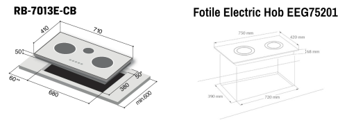

1,685 posts
From: Bandar Puchong Jaya

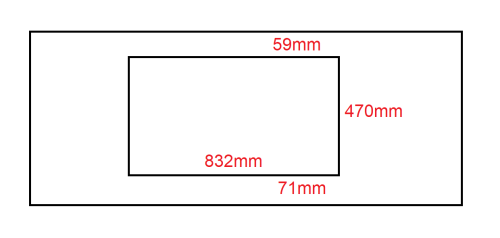

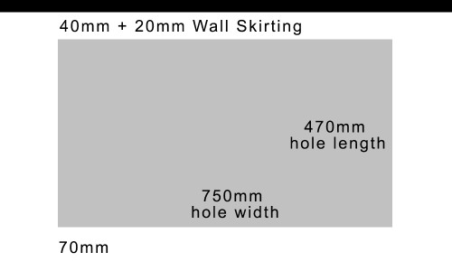

Hi there, my current existing gas hob hole is about 33 inch x 18.5 inch (838x470mm) do you think is safe to use 860x500 size? Will it be enough to support it?
TSzheilwane
post May 18 2014, 11:09 PM
4,184 posts
Joined: Jan 2008
QUOTE(MtV @ May 18 2014, 09:34 PM)
Better follow the actual cut out size as the glass might break if u have heavy pots on it.

I have a Rubine MCH-LAZIO hood which comes with a 3 pin plug. However when my contractor pull the wire for me to install the hood..there is only 2 wires - red and black. Is that normal? Then where am I suppose to connect the green (earth) wire if I don't want to use the3 pin plug?

QUOTE(zheilwane @ May 18 2014, 11:09 PM)
I see, what is the safe margin clearance ? 20mm from each side? To ensure it support well enough?
Have to get those with 900 x 500 gas hob?

QUOTE(gingerman2408 @ May 18 2014, 11:45 PM)
Earth is important, ask your contractor to correct it. And make sure he actually add back the earth not putting a dummy earth wire.

QUOTE(weikee @ May 19 2014, 03:08 AM)
Yea, that's what my dad told me too. But the contractor told me for hood normally all no earth wire rclxub.gif
I will request him to add the earth wire

QUOTE(gingerman2408 @ May 19 2014, 10:44 AM)
Can run without earth, when it fry can may also fry the human too.. Especially when spill over soup.

That make me wonder, is he tapping from another power socket or direct from Circuit box?

QUOTE(weikee @ May 19 2014, 10:49 AM)
From another power socket right next to it. Any problems with that?

QUOTE(gingerman2408 @ May 19 2014, 01:39 PM)
Yes, If you are sharing, you risk burning the internal wires. Electric hob can go up to 4000 watt and more depend on model, and normal 2.5mm wires won't be able handle that load. If you loop you need to know what is being shared, some house share same wires for few socket.
You need to know your Hob max current requirement, and its recommendation wires size.
Assuming you have hood too, and from your information, I assume he also loop the same wires for hoob.
Good luck.

I just checked my new hood. Came with a two prong Euro plug....no Earth also.
My 6000W (total) Induction hob dont even come with any instructions on using what kind of plugs or wiring requirement. Best to connect straight to wire or go thru a plug better? Plug and socket at least can turn off the mains

QUOTE(idoblu @ May 19 2014, 04:01 PM)
Wow, 6000Watt? I hope you have minimal 6mm cables to support. And No socket can handle 6000 Watt. You need a heavy duty switch that can handle minimal 30Amps.

QUOTE(zheilwane @ May 16 2014, 09:43 PM)

QUOTE(MtV @ May 19 2014, 12:09 AM)
If you do not follow the cut out size, most probably the glass will be resting on table top inside of the metal base. Therefore, if u cook a lot and the pot is heavy, the glass might break.

Do you have suggestions for gas hobs with continuous pan support? Something like this. icon_question.gif
A
Or even this
B
Personally, I'm not a fan of flimsy looking pan supports. Plus I'm a really clumsy person so I need the additional support.

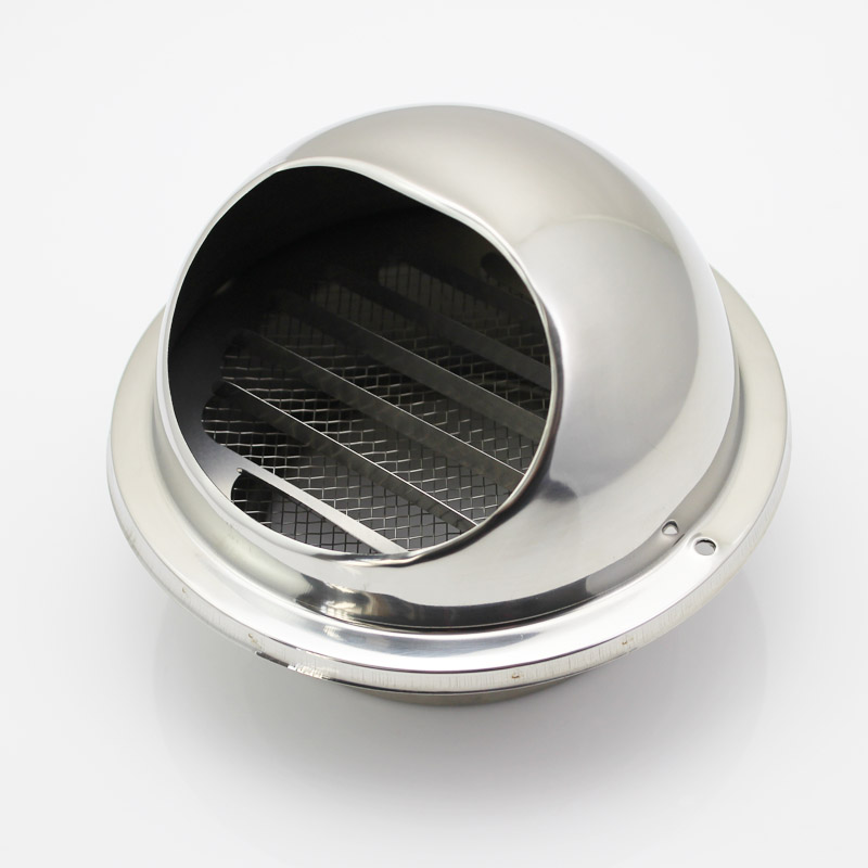

QUOTE
where do you guys buy the ducting and wall cap?
need 150mm/6in diameter hose
And do you ever have any cockroaches climbing inside? even with the wire netting, I think its not fine enough to prevent them from entering sweat.gif
This post has been edited by idoblu: May 25 2014, 06:11 PM

normally you can get from the shop where you bought your kitchen hood.
Need your opinion, based on my attachment, can I closed this plug and pull the wire to the top for my kitchen hood? without hacking the wall? (ignore the dirty tiles blush.gif )
cause i planning to put aluminum sheet behind as backsplash
This post has been edited by MtV: May 29 2014, 10:01 PM

QUOTE(idoblu @ May 25 2014, 06:06 PM)
any kitchen appliances shop u will get the hose and wall cap... which brand of hood u buy doesnt come with all that rclxub.gif , just curious... geh boh a bit

QUOTE(Kelifu @ May 29 2014, 10:46 PM)
But I bought it at the warehouse sale. Not sure if they come with it but I doubt it.
I know my old Fotile hood came with a set of plastic hose and metal wall cap. I still have them.

You found your wall cap yet? I don't have cockroaches but mosquitoes, can see a few stuck on the mesh every time I remove for cleaning. My main concern is birds nesting in the hole opening but so far no such incident yet. Having cap is a good idea.
The netting very small holes only?
This post has been edited by idoblu: Jun 1 2014, 10:51 AM
The mesh I'm referring to are those that was installed on the hood, after awhile oil will accumulate therefore need to wash constantly. My air outlet don't have anything to cover that's why I'm a bit worried birds will start nesting.

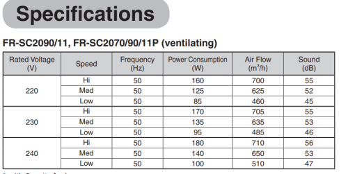

Panasonic has one with an oil filter. I might put that to use in conjunction with the hood
Double exhaust
This post has been edited by idoblu: Jun 1 2014, 12:36 PM
I was looking for this thing too, whatchacall "wall cap"? Is it a proper term?
Cost me RM80 just to get an additional plastic ducting, my hood only provided a plastic ducting, no wall cap. Might source somewhere else.

The one that says Kitchen Fan
http://www.panasonic.com/my/consumer/home-...lating-fan.html

Here is one of the reason why most of our customers prefer FOTILE GCG 90301 over other hobs. If you would like to know more just drop by my showroom to have a look at the actual product and for us to explain the details such as Flame area coverage, maintenance, durability, wok support design and Etc. When looking for a good hob, dont just look at flame power have to look at other factors as mentioned above, a good Hood as well, not just suction power is important.

Your comparison on your utensils only. Some people will have bigger some will have smaller. I have much bigger wok, looking at the photo I don't think it can even use the 2nd burner if using that burner.

well this wok size is suitable for 6-8 persons which is quite the standard size but ofcoz there are bigger one. However the wider hob size 900mm of GCG 90301 is the maximum size already as a standard hood size is 900mm. I actually took home a GAG unit and put it in my house for testing so i could compare them better.
What is the best way to understand a product other than using it yourself which i believe end users could not do this. There are many other photos/videos on comparison but you need to drop by my showroom to view them, wont b uploading online.

My guess you don't cook much. That wok for 6-8 person? Seriously go try vegi that 8 person see how much it overflow. If that not enough try fried rice. Practically, I don't know who will use a wok coking and at the same time use the small burner the same time.
Anyway, I am not a fotile hob fan. Rinnai hob so far still be best performance especially the inner flame, introduce to few of new home owner and they never complain.
Hoob, fotile is good, but not the cleaning part.

well during Chinese New Year, grandma and aunties came to our house, we use the same wok to cook, that is why i say it is sufficient, we only have one wok at home, i don think ppl will waste space and keep many size of wok in their house. Well, i do the observation while my mom does the cooking.

That's your definition of the size for 6-8 peoples. Other may not. Some maybe smaller so the other model if hob will be sufficient too right?
My wok good for 6 people, and is already bigger than the wok you shown.
