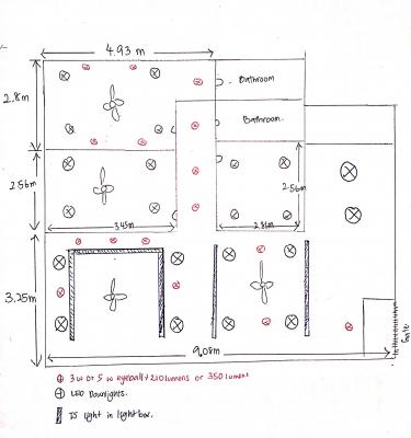

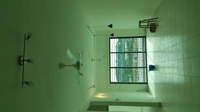

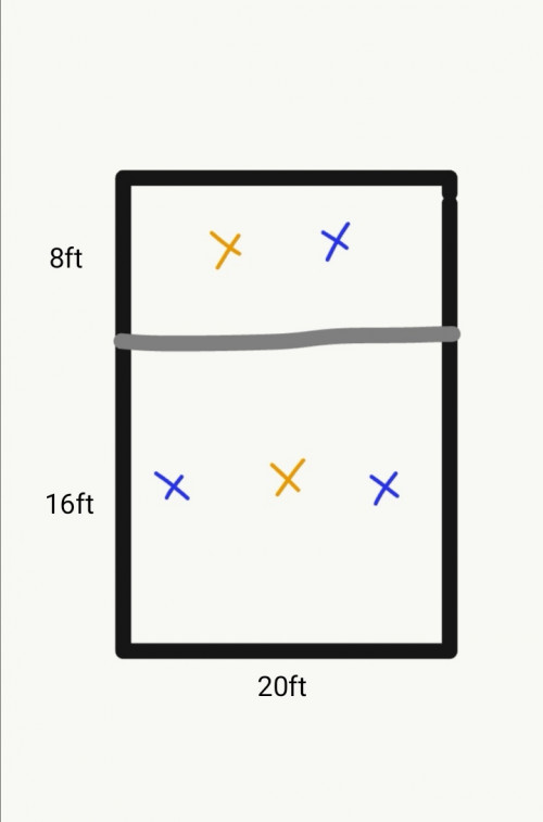

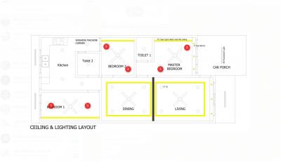

Since I will be re-doing the wiring at my house, the contractor asked me to mark out the spots where I want my lights to be. Currently, the house is using flourescent lights, and I plan to switch to downlights (those embedded into the flat plaster ceiling - i do not plan to do those L Box and stuff like that, just a plain flat plaster ceiling).
I read somewhere that the rule of thumb is to have the lights 1m apart from the wall & about 1.5m - 2m apart for each light. Is there any truth to that?
Also, any recomendation on what lights to use/not to use?
I have a high ceiling living room that goes up to the 2nd floor (those who have seen the 1.5 story USJ house would know what I mean). Instead of using chandeliers, is there an alternative to iluminate my living room? Suggestions/share of experiences are very much welcome!

Better for you to have a rough idea where you want lights and go through it with your contractor..

play with dialux software to do 3d simulation

You can also speak with the plaster ceiling fella and ask him for his recommendations.

Added on July 6, 2010, 3:30 pm@vinluv & tinkerbel - i would discuss with my contractor, but I was tryin to do some research myself first. especially from LYN forumers whom have plenty of constructive opinions....

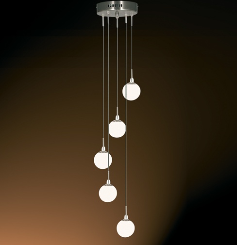

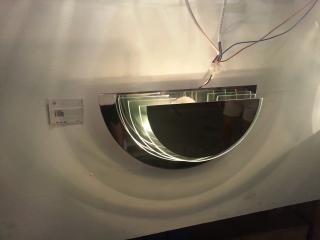

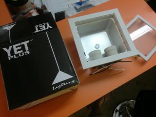

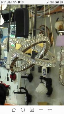

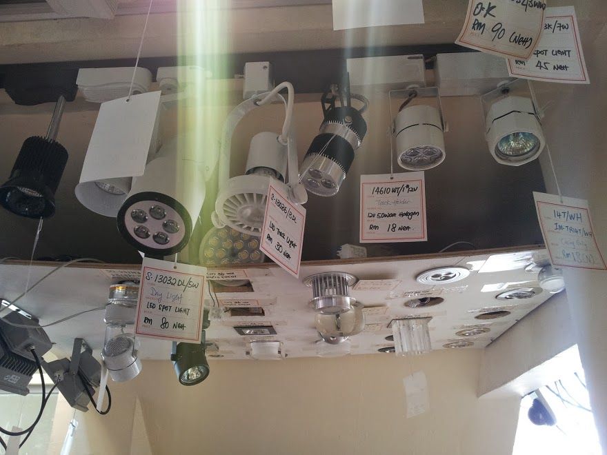

went light shoppin this weekend, so many choices of lights, even for downlights - there's the square & circle ones, with one bulb or two...gosh.....
anyways, one of the sales person suggested that i use something like this for my high ceiling...
wonder if it will look ok with really long wires dangling from two stories high? hmmmm

now i'm planning to put 5pcs downlight at the living hall (size around 16ft X 16ft) + L-Box with T5 only above TV cabinet area, ceiling height around 11ft to 12ft. i attached my downlight grid location with the square type 6" i plan to put. plan to do wiring to control:-
(1) 2 bulb side of fan + 1 bulb center of bulb (1 switch)
(2) 2 bulb on side of the centre bulb (1 switch)
Added on July 16, 2010, 4:09 pm
QUOTE(koled_anie @ Jul 14 2010, 10:35 PM)
any sifus can help to comment on my setting?
This post has been edited by koled_anie: Jul 16 2010, 04:09 PM
Attached Image Attached Image
antzan
post Jul 16 2010, 10:39 PM
185 posts
Joined: Mar 2008
Any window or liding door?..where is your main door?...if middle d/light above sofa maybe you can change to projector light with 2 lights (360 degree turn)...then myb you can have show centre piece on the centre sofa table if all off except these light...
your front 2 d/light near tv - as 1 switch...then above sofa 1 switch..projector light - 1 switch...your L box - 1 switch...fan 1 switch..plus if u add the remote..hehehe...nice lor...you can make it cozy mozy...haiya..bestnyaaaa...just my personal opinion...peace to all...
koled_anie
post Jul 16 2010, 11:14 PM
84 posts
Joined: Jun 2010
From: Penang / Kulim
how about this one, the yellow color is the projector light 360 but only 1 bulb each...others down light color showed the switch combination control... rclxub.gif
antzan
post Jul 17 2010, 05:44 PM
185 posts
Joined: Mar 2008
ok..what color is your wall?...is there any L box?...any window?...as certain color wall does have effect upon color of the bulb...same make the wall pale ..some make it wow...
living hall guest n family hall have the partition 'Fung shui'?....location of the sofa?...
Ensure your fan using the 60" type w 5 blade...if not..haiya....

here my living n dinning area for your view n comment...house nearly complete..already delay 3months..
TSkathlynn
post Jul 24 2010, 08:53 PM
264 posts
Joined: Mar 2010
QUOTE(antzan @ Jul 24 2010, 05:22 PM)
shud take a night shoot, so can assess the brightness

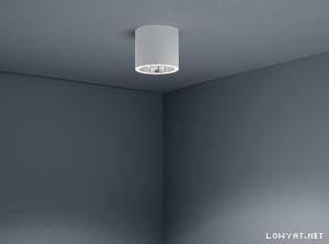

QUOTE(cnystore @ Dec 17 2010, 12:39 AM)
put the surface downlight ... no need plaster ceiling ......
How does this thing look?
This post has been edited by ozak: Dec 17 2010, 10:39 AM
koled_anie
post Dec 17 2010, 11:30 AM
84 posts
Joined: Jun 2010
QUOTE(ozak @ Dec 17 2010, 10:33 AM)
LED bulb is not really save or efficient. Many will get con or confuse with the always compare the watt bulb with the LED bulb.
The true comparison is the watt/lumens of the bulb output. LED till now is not higher lumen than energy saving bulb.
The last I saw 5.5watt LED bulb cost RM115. Not china brand but toshiba japan.
Added on December 17, 2010, 10:39 am
like this i guess......
alesi616
post Dec 17 2010, 03:45 PM
810 posts
Joined: Mar 2008
QUOTE(koled_anie @ Dec 17 2010, 11:30 AM)
They call that 'milo-tin' downlights??
cnystore
post Dec 17 2010, 04:57 PM
1 posts
Joined: Dec 2010
yes, tat is ... it is white or black or grey ...

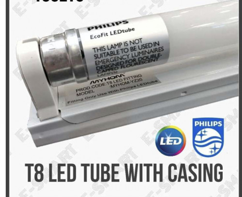

Anyone know where I can buy cheap and reliable T8 LED tube light? Sorry....in Klang Valley

Finally, after few months waiting my living hall almost completed!! Later to put T5 on all the L-Box rclxm9.gif
This post has been edited by koled_anie: Feb 17 2011, 11:55 AM
SnoWFisH
post Feb 17 2011, 05:33 PM
2,250 posts
From: Penang / Bentong, Pahang / Genting
QUOTE(koled_anie @ Feb 17 2011, 11:28 AM)
koled_anie
post Feb 18 2011, 07:54 AM
84 posts
Joined: Jun 2010
QUOTE(SnoWFisH @ Feb 17 2011, 05:33 PM)
yup, lucky i put sensa 5. if put K14Y9 then will look much more smaller than this......hehehe.....but the sensa 5 holder looks quite short compared to K14Y9 holder. any way to lower it down a bit? anybody knows?
got appoinment with KDK tech to do balancing, it's wobbling a bit....maybe can ask them how to lower it down a bit since d holder too short... sweat.gif
This post has been edited by koled_anie: Feb 18 2011, 08:35 AM
SnoWFisH
post Feb 18 2011, 09:37 AM
2,250 posts
I have that problem too with my Sensa 4, even the baby fan's holder looks longer compared to Sensa 4. But overall very satisfied with Sensa 4 and my baby fan. Not sure whether the baby got new version or not, I realized my baby fan at speed 1 also quite powerful already sweat.gif . I put it at my dining, even the table cloth (3ft x 6ft) is lifted a bit when the baby fan is activated at speed 1 shocking.gif .
numbertwo
post Feb 18 2011, 11:00 AM
1,784 posts
Joined: Mar 2009
From: PJ lamansara... :D
the fact is we don't get much air pumping down by the blades if the hook is too short...especially if you are placing the fan inside the plaster ceiling...
koled_anie
post Feb 18 2011, 02:55 PM
84 posts
Joined: Jun 2010

my living area is about 18ft x 15ft and light truss plaster ceiling (L-box). if i install white T5 inside the light truss, is't bright enough if i don't install anymore white downlight?

Need to buy 22 downlight holder by end of this month. I prefer the square one rather than the round one simply because it looks nicer. But one problem is the square one need to install 2 bulbs, 22 x 2 = 44 bulbs... although I'm not switching on all of them most of the time, but it will also cost a bomb in my electric bill....
Anyway suggestions? My ceiling height is around 8.5 Feet, if inside the square downlight i just install 1 bulb will it be bright enough? How many watts should i use?
Thanks...
Thanks...
u can still put 1 bulb instead of 2 bulb use higher than 18w...i'm doing that, so far quite happy with it. only kitchen i put double as my wife would like kitchen to be as bright as possible...but i'm using only 12w bulb x2 for each downlight... try to save as possible as can rclxms.gif

spotted this light from wiselite.
is it good? RM28 per pc.

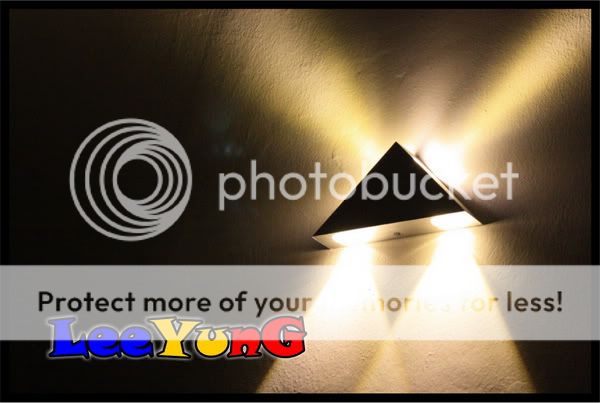

LED can last 24/7 but not for the driver unless you are providing DC source directly then there will be no problem with that. The driver is basically used to convert the AC to DC and hence powered up the LED, each LED consumed 0.02mA only, therefore LEDs are very durable one, only the driver is taking part in the fault, the driver you need to ask the shop for recommendation.

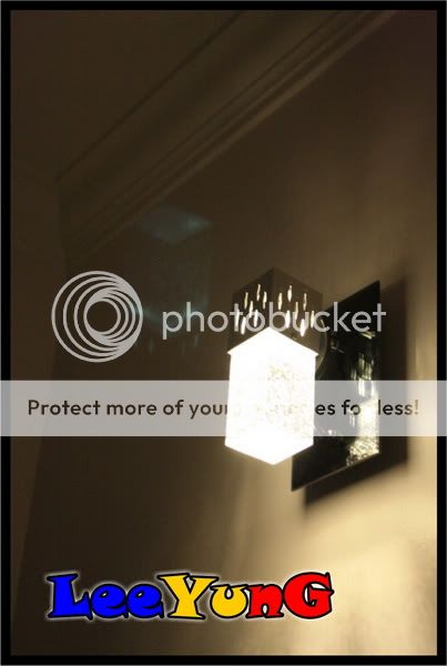

Just to share out my 3Watt LEDs as well, I only on every night (12hours +- per day) biggrin.gif the triangle one is 4Watt while the cube one is 3Watt
All photos took with the following setting
f/5.6, 1/125 Sec, ISO1600, exposure bias: 0

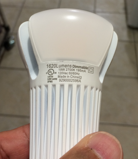

Added on February 17, 2012, 9:41 am
QUOTE(saigetsu @ Feb 17 2012, 09:22 AM)
i tot the bulb is plug and play... fuu..  like e14 size led bulb... simply screwed in and ok d.
some sort like this
This post has been edited by leeyung: Feb 17 2012, 09:41 AM

leeyung
post Feb 17 2012, 10:04 PM
1st LYN Pioneer Genuine Marimo Seller
885 posts
Joined: Sep 2008
QUOTE(weikee @ Feb 17 2012, 01:22 PM)
If this is direct replacement of normal halogen bulb, is still inside.
QUOTE(ozak @ Feb 17 2012, 01:41 PM)
That is normally a 12VDC halogen bulb or 12VDC 3watt led. This require driver or power supply.
This is not halogen bulb, it is a Q-RAYâ„¢ LED Bulb model MR-16, my friend is using this, illumination wise, ok if treated as eye ball,

YET & JSE are china oem products. these are sold very cheap in lighting shops like Top Ten, Avalon, etc. we are also electrical shop, but we normally don't recommend these in our projects. YET have many variants, let me know what is the model, and I can ask whether can reduce further the price. I guess the JSE bulbs they give you are the screw head bulbs, which at those prices, quality is compromised. if you want lasting bulbs, you should use PLC tubes with external ballast. but the total price is much more.
YEt BY-360
6 inch aluminium frame down light(square shape).
You have any square shaped down lights with PLC tubes? what is the price like?(with or without bulbs)?

dear forumers,
anyone seen this type of pendant before ?
I found ten-gro selling something similar which I really like .. in sets of six and purple in colour.
however they are out of stock .. there are green colour available but not really nice
I tried searching in other shops near that area but was not able to find something similar..
If anyone knows where I can purchase this, please let me know.
Just trying my luck in case anyone while shopping around spotted these before.
thanks

Before you go to shop, do not purchase those LED recessed light where the LED is visible on the recessed light. Get those that are frosted, so it does not look so obvious. Also, the newer version has a very slim profile less than 2 inches thick instead of those with huge heat sink.
Don't go for the type below if you want an aesthetic look and feel
Go for the type below instead. They have various sizes, round, square and rectangular. I chose the rectangular one instead.
Another thing is, if you notice the casing is white colour, so it is fits nicely on plaster ceiling where it looks seamless. However, do not it is alot more harder to remove the recessed down from the plaster ceiling compared to conventional down light where you only need to replace the bulb.

However, for my living hall, I installed 4 LED recessed light with day light but I don't have the actual picture.
This post has been edited by dchk: Mar 13 2012, 02:17 PM
jayjay11
post Mar 15 2012, 10:37 AM
88 posts
Joined: Mar 2012
dchk
Thanks for sharing the photo. It looks great

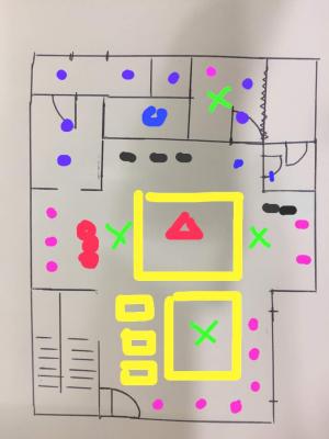

Hi guys, I have a 24 feet X 15 feet living hall, total size is 360 sq ft.
I wanted to build a L Box surrounding the living hall which will form a shape of rectangle, the wiring man suggested to install total 16 downlights at the L Box area. My questions are:
1) Is 16 downlights too many for a 360sq ft living hall?
2) If the number of downlights is 16, should I use 4" or 6" downlights?
3) What wattage should I use for the bulb if there's 16 downlights? go for lower watt?
Please look at these pictures to get an rough idea of my wiring layout.

QUOTE(Kingsman @ Mar 19 2012, 01:14 PM)
It also depend on how height is your ceiling. 16 down lights will be just nice for the distance 4ft. I would say 4" with 14/18watt will be enough but if you prefer brighter then should go for 6" smile.gif
Anyway it also depend what type of down light you are using, with glass/frosted glass, LED, LED panel .....
