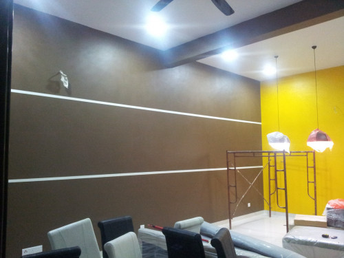

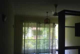

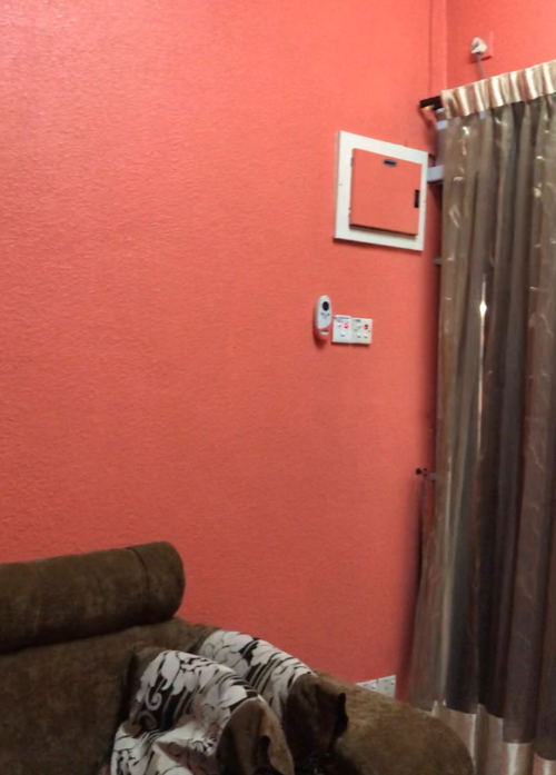

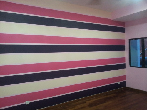

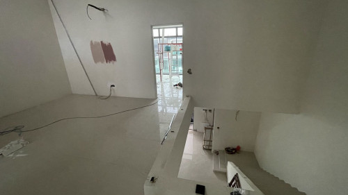

guys...just to share, i started painting this room last night....
i been using matex rm35-45 (special colors)... value for money & easy to paint, no need mix water, whack 2 layer its good. (i update pictures if got time) for normal use its ok lah, worth painting.
then i try Federal Paint (this paint is a real pain in the ass) poor quality... its a waste of money & afford. the color is white & cost rm25 for 7liter. now i fully avoid this brand.
satin glo, nippon .. 1st time i try this paint, its totally different . The quality the color... the mood, unusual...
i buy 4 cans @ 5liter after discount (5% +)
i buy at the shop i know many years, last time i ask cincai doscount.
now i push then for discount, they give more.. (you have to push then they give)
ended i pay RM 400.00 .
this is the room picture im painting now, it will have 3 different color ... all satin glo.

All I can say is Matex is the easiest-to-paint emulsion paint in the market..The reason is the amount of powder is the most in Matex. Therefore, it is the easiest to paint..
Federal Paint..A company which doesn't really prioritize the quality..They might not have the right formula to produce paint..Enough said..
The market of paint is not the same as 10 years ago..One tip for you, try this method if you want to lower the price..Tell them(paint shop) that you asked from somewhere else(another paint shop) that they are selling at a cheaper price..Not too much la...Like the price they are giving is 100, you tell them you can get for like 95..But as far as I know, Satin Glo doesn't costs that much..less than 100..Do you mind telling me which shop you went?

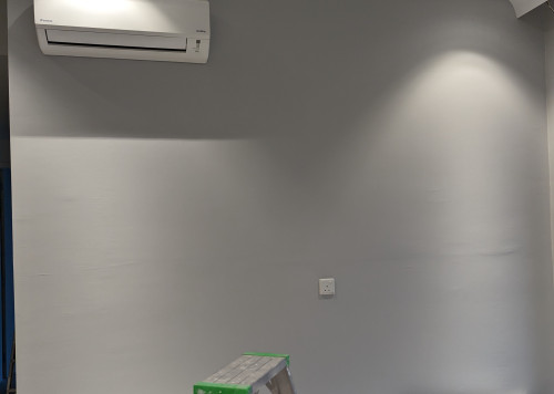

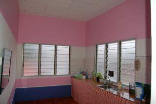

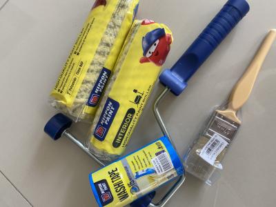

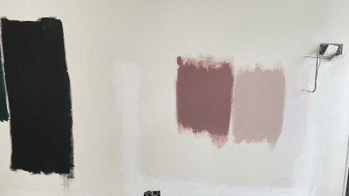

what a sunday .... some pictures for all...
so far this is my favrouite roller (recycle but performance best) got for rm5 each.
The green (2nd color) 1st coat.

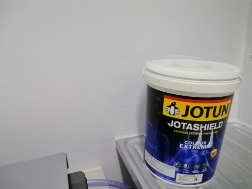

Wat do u mean by recycle roller ? I tot every roller can be wash and use to paint different color of paint ? Am i rite ? laugh.gif

lazy to wash bro.. that fridge already kong. (air tight so the paint will not dry) laugh.gif
the hardware fella told me boleh recycle. some roller bulu become lesser when wash. icon_rolleyes.gif

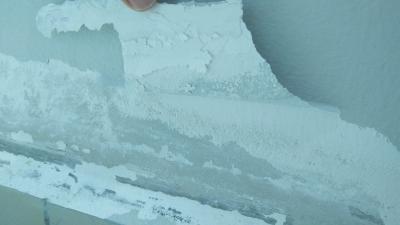

I think the door quality is poor, surface very rough. They haven't clean the door yet, full of cement stain/dusk. I oso headache now.. duno how to clean all the thing. rclxub.gif Anyone hire profesional cleaner to clean ur newly completed house ? hmm.gif How much to clean double story terrace house ?

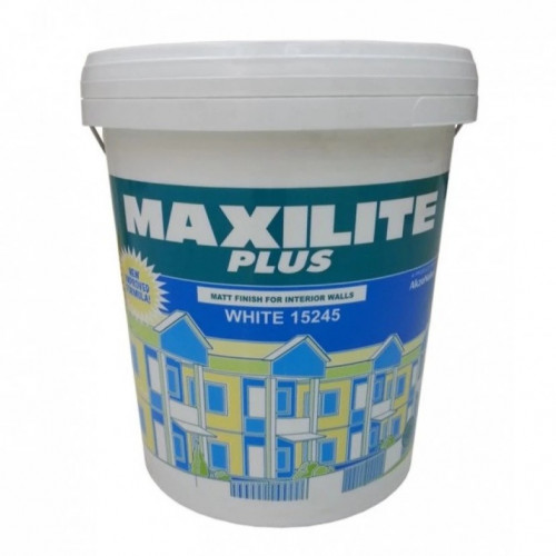

2. Normally, for plaster ceiling, a normal emulsion paint will do..below are some of the brands that I'd recommend
Pacific NewLite(a very new brand..and if you trust me, try to look for this brand..as far as I'm concern, it is as good as Maxilite although all the emulsion paint are almost the same..
Dulux Maxilite
Jotun Jotaplast
KCC Koreton plus
Sissons Masonry Emulsion paint
Nippon Matex

..if i were you, the problem here is making the poor door look nice & acceptable..
i would kau-kau clean with a mircofiber cloth, then scraper off the cement or debris ..
do this when door is dry & carefully, or else your scrapper will scrap off some door chunk. after scrap, then sand paper it, then smooth it. masking tape the knob... wolla
apply under coat (if needed) then just paint with brush or roller... no need spray wan lah..
doing the base is very important, take your time & afford. the end result reflect on it.
if you hire ppl to paint, they one shot will do all the cleaning for you..from toliet to back door yard, roof, tangki, etc.
make sure you hire the right fellers & better to be there to instruct & look2 see2.
if you not there they just whack wan.
if you look at the whole picture, i also pening dunno where to start to clean..
plan nicely, clean bit by bit, section by section. i normally start of with area less use then last is toliet. icon_rolleyes.gif

FYI, Maxilite is a normal emulsion paint which after a few months, you'll find that your wall is chalky or powdery..

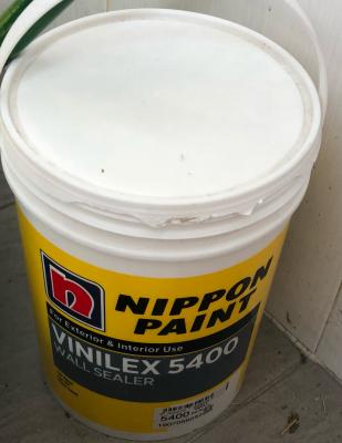

trdcelica.. what is the purpose of sealer?
when to use it.. and under what condition warrants the use of sealer?
sorry.. another noob question..
trdcelica
post Dec 29 2009, 09:38 PM
122 posts
Joined: May 2009
QUOTE(morpheuzneo @ Dec 29 2009, 03:01 AM)
The sealer's function is to make the paint last longer. For instance, your exterior wall will last for 7 years with the application of sealer but your wall will only last for 4-5 years without the application of sealer. In other words, the sealer is the undercoat or primer for wall.
And also, the color retention on the wall will be better with sealer..
If you found out that there are moisture in the wall(patches of water mark), you'll need to apply sealer to prevent the moisture from escaping off the wall..another way is apply normal emulsion paint(cheap emulsion paint) ..I already explained this in the first few pages if I'm not mistaken..

1 painter quoted me (interior only) RM2.5k for Maxilite paint (including grills). He said that all paints are the same bla bla.. saying that it's all marketing gimmick the odourless etc..
Another painter gave me an indicative RM3k-RM4k for ICI Pentalite (interior only)..
Another friend said that labour for Indonesian worker would be RM500-Rm600 for the whole interior house.
1) Wondering if Maxilite paint would cost up to RM2k for the interior painting alone without labour costs?

1. Of course Maxilite won't. Calculate it yourself. An 18L Maxilite costs RM60-63. A 7L costs 30-33..
2. Depending on the conditions. These info can be found behind the can of paint.
It will be cheaper if you buy the paint yourself and hire some Indon painter to paint.

Added on January 12, 2010, 1:08 pmjust bot the paints yesterday...i think a little bit on the high side...what u guys think?
1) Pentalite 'Amazing' 1L can - RM35
2) Pentalite 'Brilliant White' 5L can - RM100
3) Supreme 'O'Keefe Grey' 5L can - RM120
4) Pentalite 'Twilight Sky' 1L can - RM25
5) Maxilite White - 20L can - RM60
didn't know paint prices can be so high...but still cheaper than what was quoted to me by the reno/painter guy which was RM700 for 1000sq ft area (ceiling & walls) using Maxilite only.
will begin paint works tomorrow...hopefully able to complete by mid next week....
This post has been edited by daryl.k: Jan 12 2010, 01:08 PM

I bot Maxilite 20L - RM60
ICI paint for wooden door & alu (metal) - Satinwood (satin finish) or Gloss Finish - around same price as Pentalite

Got a problem here & need some help. I was trying to clean my exterior wall yesterday by hosing with tap water. But some of the paint flakes peeled off around the gate pillar area and exposed some very bad mold under it. I think the mold has grown under the paint but I could not remove all the paint as the water pressure from the tap is not strong enough.
So is it necessry for me to remove all the old paint before painting with new one? Or is there any undercoat that I can use without removing the old paint, but will 'kill' the existing mold which is hidden under the old paint?
Thanks

usually ppl remove old paint...

My master room's theme wall.
Normal walls - light purple.
Theme wall - Full wine.

QUOTE(jason1986 @ Nov 1 2010, 12:55 AM)
Hi guys, my rented house now look like shit. Thinking of repaint it as i will be moving in for own stay.
Can i use Matex white colour to paint the whole house first and then use Jotun Strax to paint on the colours?
Matex is the cheap one. RM60+ for big tong, 18 liters i think.

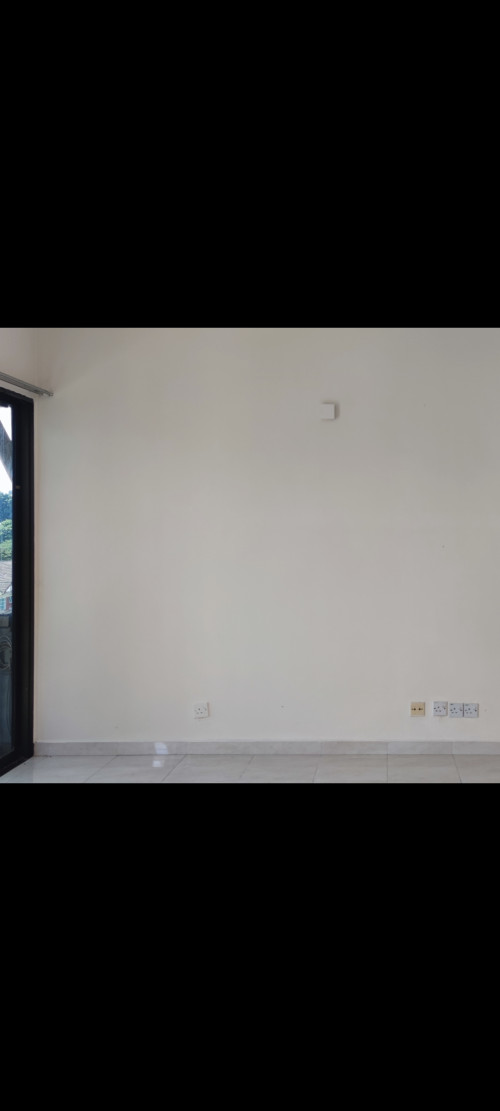

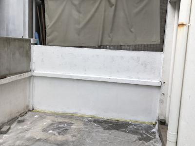

I normally matex it all white, my best choice coz I budget..
once it goes white, the color will stand out.
bro ... where you get RM60 (pls let me know, wanted to buy for new condo) icon_rolleyes.gif
Attached Image Attached Image

painted by MYPAINTER PAINTING SERVICES TOO.. !! LOVELY COMBINATION.

No bad...any photo that captured direct hit by sun light or white light?

my contractor told me that use ICI Maxilite (white) - interior wall, i said what if use Pentalite? he say, what is the point, if only white color, you can't see the difference...
is that so?
