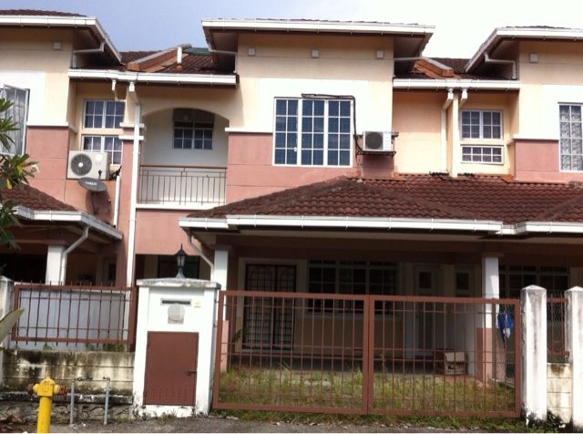

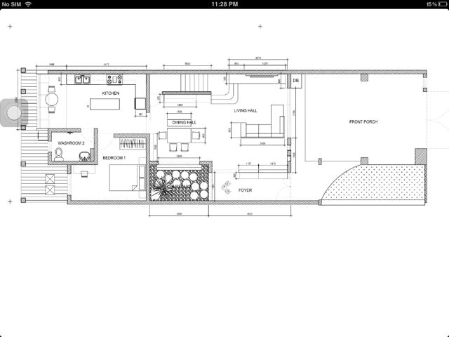

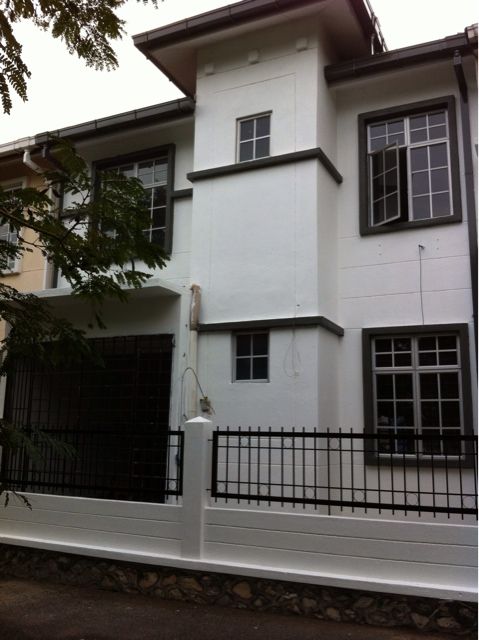

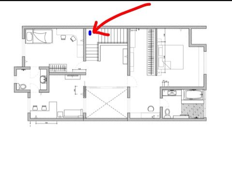

I've been following this forum since many months ago and I really find this forum so interesting and informative with all sorts of useful topics and sharing on renovation matters. Now, here I am to share my renovation journey as well with as much details as I could. I also appreciate your inputs and suggestions along the journey as I'm kinda noob in some reno matters and lacking of experiences. smile.gif
Bought an intermediate dsl in PJ, a gated and guarded community, 24x75 with original build up 2350sqft. Got the key quite some months ago but it was not having much progress earlier mainly delays especially from the drawing, permit application and sourcing process. It was also delayed for 3 weeks as I decided to wait till the lunar 7th month is over before the reno starts.
It is not a major make over where it won't have obvious change on the front facade. The structural change is only the push-out of kitchen extention, push-out of master bed room's balcony to make space for bigger bathroom and knocking down the side pathway wall to rebuild it like an entrance to the living room, hence the main door will be shifted over to the extention of the side pathway...
Note: The drawing was actually done before decision to some changes on the actual reno. The actual kitchen layout has been slightly changed where the location of hood/hob and the sink has been reversed. Furthermore, the main entrance to the front foyer has also been extended.
Will also knock some walls to open up extra windows at first floor to the indoor courtyard.
This was the earlier plan to have a separation partition for wardrobe but I've changed my mind now to have only one simple row wardrobe in order not to jeopardise the overall spacious master bedroom.

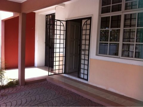

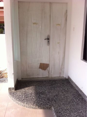

Will move the main door to the corner to make use the pathway as entrance hall.
Gonna knock this wall down to make entrace to the living room, will rebuid part of the wall with sand block and vent block to give a raw and rustic touch.

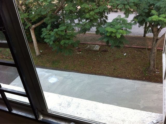

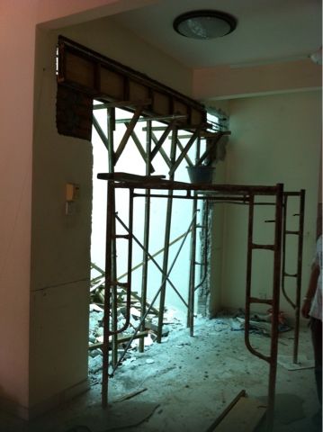

Gonna take away this balcony at master bedroom to make space for bigger bathroom.

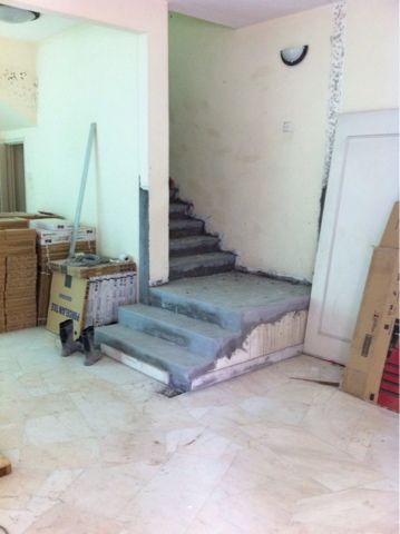

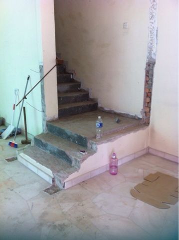

Will knock down the wall panels at the staircase so that the living room will look bigger and to have a brighter staircase.

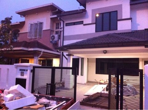

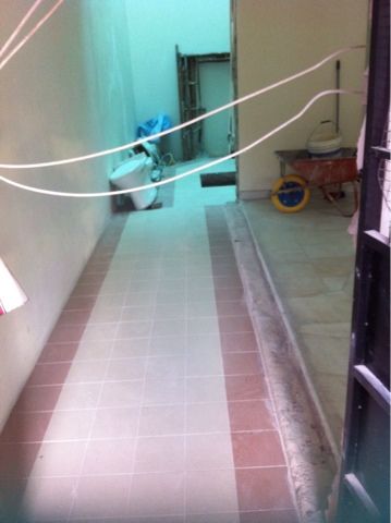

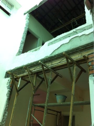

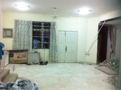

Work started last 2 days and this is what it looks likes now.
Will knock the kitchen wall later when approval from mbpj comes out. However I will only extent the kitchen but not the entire back yard coz I do not want the ground flr room to be wasted as most places that I've seen with the extention will have very dark room. I will reserve the room for the elders if they happen to live with us in future. So, they can still enjoy very nice green view from their window.

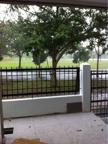

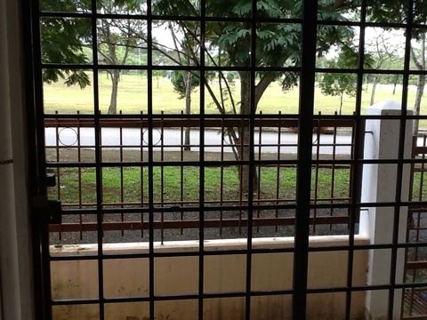

Moreoevr, I will like to reserve the back yard for cloth-drying and also might plant some herbs there.. tongue.gif
There is a very nice big park at the back of my hse. Hence I will very much want to make a nice place here to yum cha while enjoying the green view and breeze.

I'm not sure how much you believe in feng shui.
For the master bedroom where your bed is, there is a big poison arrow pointing at the bed which is not so good for feng shui.
You can move the bed elsewhere or at least ask your contractor to try to round off the edge if possible.
But if you don't believe in these things, no need to worry.

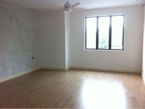

I've actually changed my mind too...but i just leaving it as it is on the drawing...i'm too, feeling kinda 'uncomfortable' for the bed to face the wall corner...hence decided to make the wardrobe a simple one row so that i can re-position the bed to the other wall panel (legs facing bathroom).

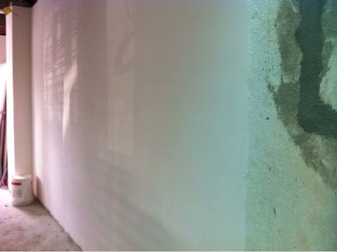

Gonna get the contractor to do the cement-looks plastering on the wall which the bed-headboard against.

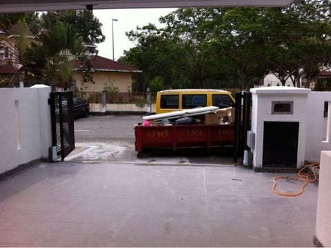

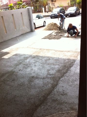

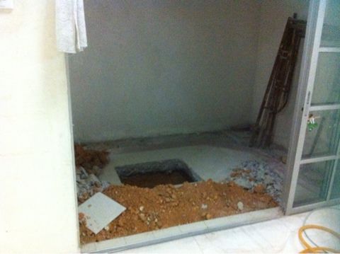

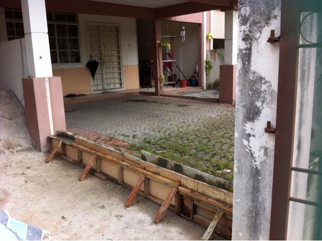

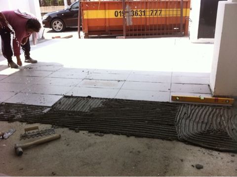

Today's progress:
All bricks at the front porch has been taken out except those under the bin.
All bathrooms' tiles and WC has been dismantled.
Most broken tiles and parquets at site has been cleared up and trashed into the bin.

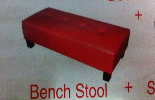

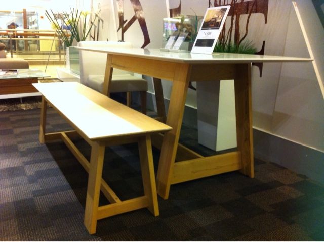

Bought this quartz top table and bench last month, but did not take their matching cushion chairs. Will be matching it with some knock-off kennedy chairs instead..
The bench and table base are made of solid songkai wood and I love it so much. Love the clean line and light natural colour. I'm getting this bench as I feel it very comfortable if i would like to sit on it to do some works...i like to lift my legs up and cross sitting at home sometimes... tongue.gif
Besides that, few kiddos could be squeezed into one bench when we have dinner with frens with kids.
This post has been edited by maxxon: Sep 9 2013, 10:36 PM

Wow, the table look nice, you have a top view?

Haven't got one with top view unfortunately but i borrowed one from google search. tongue.gif

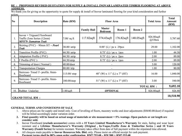

I've actually chosen some of my basic furniture like books cabinet, beds and sofa...just normal range, nothing premium on those... smile.gif
Those cost under my main con is around 120k including demolishing and wet works (inclusive brc base for kitchen ext and front porch), tiling workmanship, plaster ceiling, electric works, plumbing, painting with material, and mbpj submission.
I sourced the others like windows/doors, (including sliding and folding doors), laminate flooring, alarm, grills, main gate, tiles, lights, switches& sockets, pest, kitchen cab, wardrobe, etc.

Now that I've looked back on the plans, there's definitely a poison arrow from in the master bedroom. Doesn't that mean the ground floor bedroom also has one too? So does bedroom 3.
TSmaxxon
post Sep 10 2013, 12:01 AM
773 posts
Joined: Dec 2010
QUOTE(OneMoreDay @ Sep 9 2013, 11:49 PM)
I've changed my planning on the master bedroom position before i post this topic actually... It is a poison arrow in the original drawing as the bed in master bedroom is too close and facing direct to that wall.
Where as for bedroom 2 it will be avoided when I put a wardrobe there. It is a guest room btw.
For bedroom 3, the impact is not so much as it is a distance from the sofa and i can put a plant there to fade out the 'sha-chi'. It will be our study/working cums upstairs tv room.
Im not utilizing the room downstairs at the moment. However, it can be avoided with just changes on bed positioning.

QUOTE(maxxon @ Sep 9 2013, 11:02 PM)
Very elegant and nice but yet simple...

QUOTE(cdspins @ Sep 10 2013, 12:21 PM)
Thanks, I've actually walked thru not less than 15 shops before I get the dinning table that i like...i love this table and bench at first sight really. I get this from Cellini. smile.gif

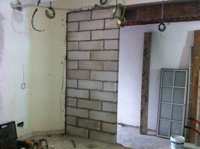

post Sep 14 2013, 03:37 AM
773 posts
Joined: Dec 2010

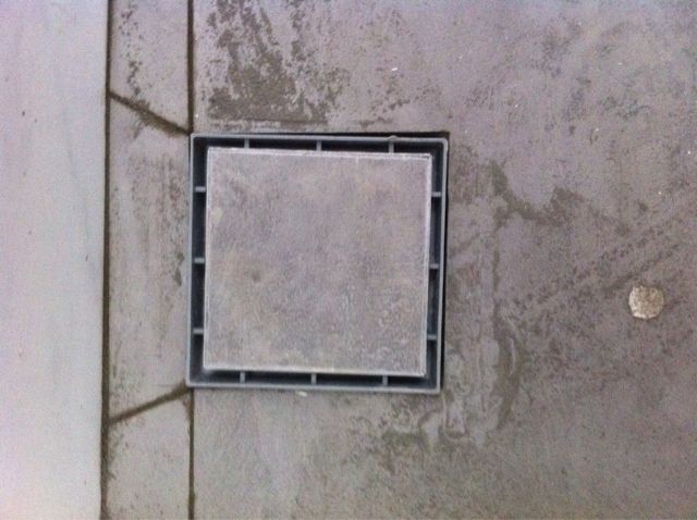

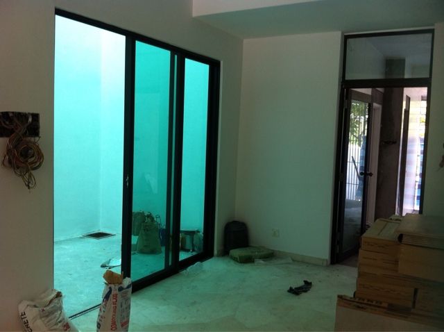

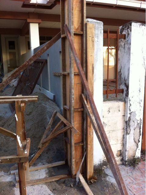

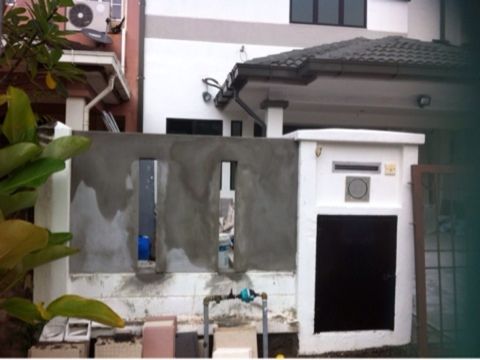

Haven't been updating the progress much these 2 days due to ongoing demolition works...demolition is almost done except for 2 openings at 1st floor to the courtyard and 2 external walls which pending the local council's approval. Btw, following are some updates and I'm going to Ga Hing in Old Klang Rd tomorrow with my contractor to buy the tiles..and perhaps some other fittings..
The wall at the side pathway has been taken down and it really makes the living room looks much spacious! However, i will later build a partial wall to make an entrance foyer from there. I see quite a number of my other neighbors also take the wall down but they are utilizing it as part of the living room. Some even take the indoor courtyard away and make more built-up space. I wouldn't want the same as I actually love the layout having an opened indoor courtyard and the sideway as an entrance foyer so that it wont't feels so 'intermediate'...(as we still can't afford a Semi-D)
Moreover, the house and space is actually more than enough for just 2 of us living in there... We still do not know whether we are gonna get kid...if god's willing we will also not going to have more than 2 kiddos... smile.gif
The contractor helped me to dig a hole thru the concrete part in the courtyard so that i can plant a tree there...will then cover the remaining area up with lots of white/grey pebbles. So it will be kept very clean and zen. However, i'm gonna get the contractor to dig more into the right hand side coz i feel it will look much better than this...
This post has been edited by maxxon: Sep 14 2013, 03:42 AM

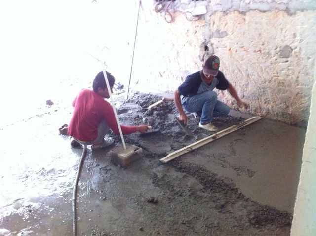

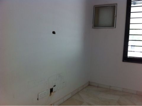

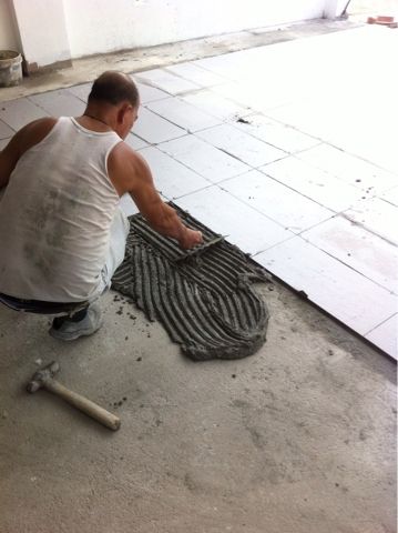

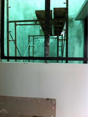

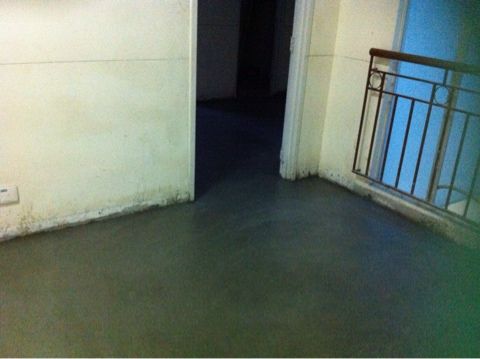

The contractor has done the water-leveling marking on all the perimeter walls at 1st floor...so, i think they are gonna level the floor soon..
I'm gonna remind the supervisor as I afraid they might forgotten that I want a big opening from the family hall outlooking to the courtyard and another additional window in master bedroom opening to the courtyard too...

Be careful of tree's roots. Tree fern is nice.
http://en.wikipedia.org/wiki/Cyathea_cooperi

Is there enough light to plant a tree ?
Another option is to do a rock gaden with indoor plants.

Tree fern doesn't need too much light. In fact it thrives under some shade.

Yup, that's my concern too...i will pop round to the nursery one day to get advice from the expert on which plant probably most suited my place and has less impact as of root concern... Worst case i might just plant it in a giant/oversized pot and the hole could be covered up with a plywood and will have the same concept again, lots of pebbles to cover the entire area...i do not need any small plant or grass here as I will have them out at the front yard...
Tree fern is one of my liking but i just afraid that it will overgrown and shoot very fast up above the roof... as I wonder it can be trimmed....Then, I will hardly see my green leaves... tongue.gif

I actually plan to plant this fig tree if possible after I check the root concern with the gardening expert later...reason being:
1. first of all I just love the feel of tranquility that it gives. 2. it is the least maintenance decor plant which need minimal light to live..hence many ppl plant them indoor..
3. The fallen leaves will be easy to be picked up as they are all in big pieces.
4. I can trim it down to avoid overgrown...
5. In feng shui aspect, it's good to have bigger leaves plant indoor to withold good qi and wealth elements, while plant withslim and pointed leaves at outdoor if ones intended to blockout certain bad qi..

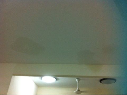

post Sep 20 2013, 01:48 AM
773 posts
Joined: Dec 2010
I really like to ask if anyone can share their experience who has came across this situation which I'm not sure whether it's a normal thing to happen during renovation... After the leveling work at first floor when the cements are still wet...i observed there are quite some water patches and some water dripping thru the ground floor's ceiling...is this what it supposed to happen?

QUOTE(maxxon @ Sep 20 2013, 01:48 AM)
This should not be too big of a problem because flooring in living rooms, kitchen and bedrooms are usually not waterproof. Your contractor could have been mixing the cement on that level thus water leakage happened.
The leveling on first floor is a regular room and not toilets am I'm correct? If it's toilet above the leakage then you need to get it verify because there's flaws in waterproofing.

Talking about my initial plan to plant a tree in the courtyard...i'm so upset that I need to call it off. sad.gif
I went for a ba-zi reading 2 days back and my ba-zi chart does shown that wood element should be avoided as it clashes with my main earth stars which will also affect my health and that's the main reason i decided a 'No' to the ground-rooted tree...Hence, I've no choice but to get my contractor to fill up the hole again....
However, i will still want to cover up the whole courtyard with stones and pebbles. Then, i gonna plant the fig tree but it will just be in a pot this time so that it wont be overgrown...

QUOTE(Xccess @ Sep 20 2013, 02:14 AM)
Yup, the dripping was observed only at the non-bathroom area. I have seen them doing the flood-test in those bathrooms the other day to test water proofing...

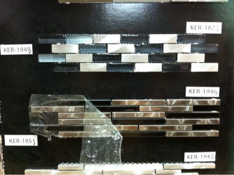

I've also ordered some mixed-material kinda mosaics for the bathrooms' feature walls but they rang me that they are out of stock on the designs on second and third pic... sad.gif
So, i went 'window-shopping' here today in hometown and found something else which I pretty like them too... They are more 3D textured and mixed with aluminum. Took the pic and gonna search for it when I return to KL later... tongue.gif

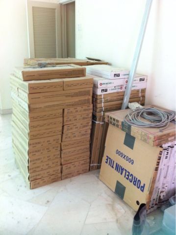

All tiles except for the designs that are out of stock as mentioned will be coming in tomorrow! Yeah, can't wait to progress further! biggrin.gif

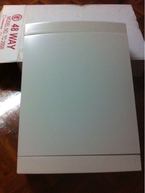

I think I've forgotten to share the very initial part where I applied for the electric supplies from TNB and upgraded it to 3-phase. So, here it goes-
The house was original with the single phase but the 3-phase wire is already there right before my db meter. I went to apply a new account and asked for a 3-phase upgrade at TNB. The staff then introduced their registered electrician to handle my case. I decided to engage that recommended vendor although my contractor can do it because I presume it should be faster as they were recommended from ppl inside, hence they should have the lobang and connection to make things move faster.
Of cource I'm kinda correct and lucky, I got everything settled and the electric supplies in less than a week.
For sharing purposes, the following are what I have been charged for:
1. Technical adjustment and electrical make good for 3-phase upgrading (ELCB, DB, Main switch, etc) - RM1100
2. Submission cost payable to vendor - RM800
3. Payable to TNB:-
a) Connection charges - RM300
b) Meter Deposit - RM480
c) Stamp duty - RM20
It all comes up to a total cost of RM2700, included deposit.

That first mosaic is gorgeous! And the last one with the aluminium! Want! drool.gif

Those are my fav too! Love the mix materials instead of boring stereotypes... The upper mosaic in the last pic is also mixed with aluminium but just flat pieaces unlike the bottom ones with 3D waves. Hope I can find them soon. wink.gif

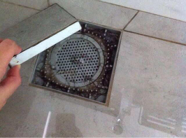

No worries. Same thing happened for mine.
Once it dries up no problem.
Unless you flood it in future then it will happen again as it is not waterproofed.

Thanks.... I think I'm the only one gotten freak over these water dripping... Hahaha~

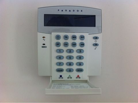

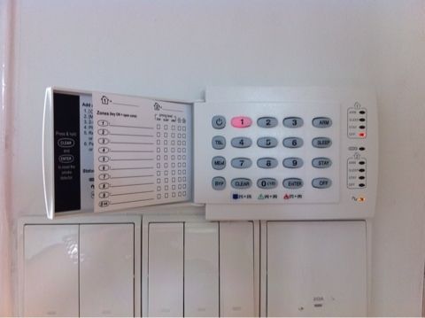

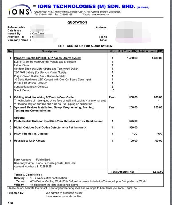

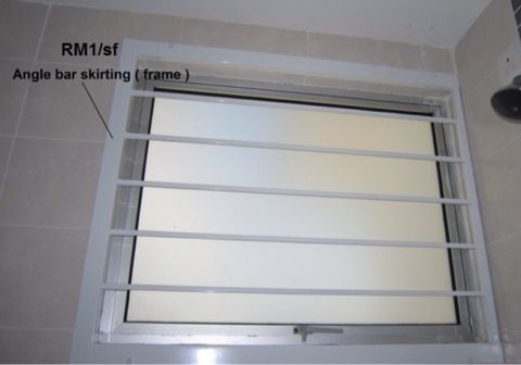

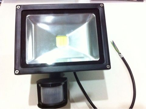

Talking about home security, I think alarm system including motion detectors should becomes a must nowsaday even in a g&g community. I'm also gonna install the security door, but that will only for main front door. It will be a full height folding door at the kitchen so that the whole kitchen area can be opened up from wall to wall.
Personally, I do want it grill-free or even gate-free just like the house that I used to live in UK years ago, but I do not feel secure enough to do it here in Malaysia given the high criminal and break-in rate... So, I will go for grill and will even install a set of collapsible scissors grill next to the folding door at the kitchen. The scissors grill and the folding door's frame are gonna be in black to give a modern+vintage touch...
I saw there's another thread there discussing about grill or no grill... I think that is pretty much a personal preference...based on individual's lifestyle and priority-weighing. For me, I do like natural breeze sometimes as I'm not a person who likes to stay in a closed environment with 24hrs air-conditioning. So, when I open up my windows or folding door, I do not want to be shocked by any 'uninvited guest' in the house. For example, if I open up my back folding door, with locked scissors grill, I have no worry at all to sit in the living room and watch my tv...this is even more of a concern if ones has kids at home.

Renovation progress has been steady but slightly slow as there were only 2 workers assigned for my site from the beginning. I've request more workers from the contractor so that things could be sped up, in order to meet the dateline of moving in latest by end of Nov. Hopefully I could get more work force soon.
Following are some updates as of the 20th day:
- BRC wire mesh is ready for the front porch footing. As you can see from picture below, the part for soil and planting has been made smaller so that the car porch has more width space especially when we park 2 cars side-by-side. It gives a wider walk space so that we do not need to step on the grass.

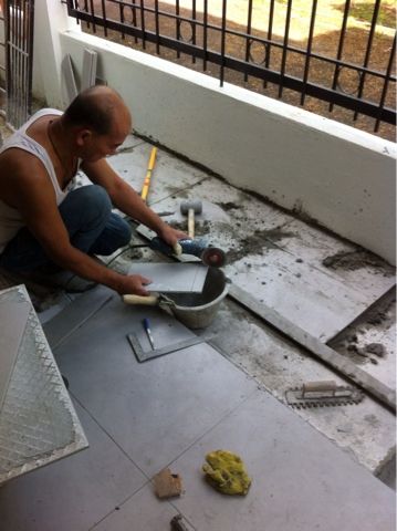

- Tiles has arrived but yet to see the tiler. Contractor said the tiling sifu has pretty tight schedule... sad.gif
Hope he can secure a time slot for me very soon and I do hope he get me a good sifu with good workmanship coz i'm pretty particular on the tiling quality. I will definitely vomit blood till die if the tiling job is not good... sweat.gif

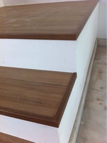

- leveling work for 1st floor and stairs was done. I don't plan to install any glass or railing for the staircase stepping down. Will just do the laminate (without riser).

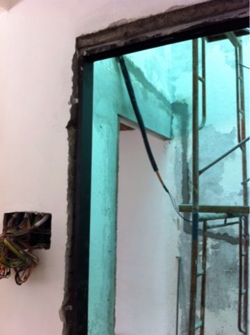

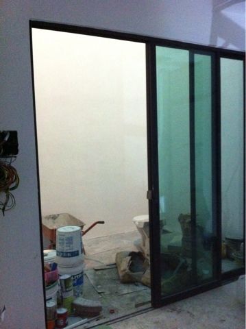

- The old sliding door at courtyard has been taken away and the contractor suggested to hack the upper part, making the opening 1 foot higher, and it actually turns out better with such higher opening. Will do BRC roof slab for each opening to the courtyard to avoid splashing of rain..
- New opening at 1st floor family hall and master bedroom.

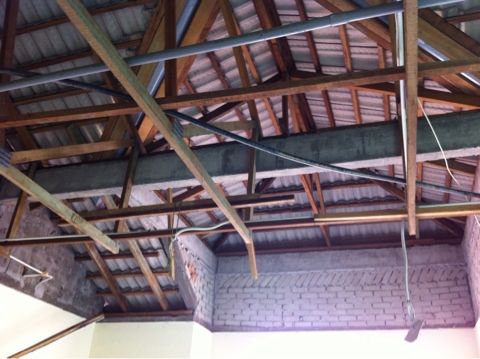

- The ceiling at 1st floor has been all removed to receive new plaster ceiling later.
- Kitchen wall has been hacked away. Can't wait for the kitchen extension work.

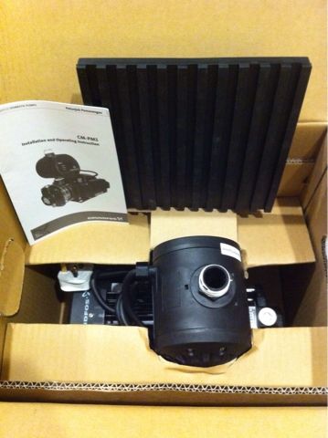

Thanks for the offers but the plumbing works are gonna be done by main con..found a pump installed by previous owner, will test it out if it still works well. For the water filter, I have bought both the in and outdoor filters from Nesh in a fair..

No problem it must Be More than RM 3k you brought from Nesh right ?. Well I carried the same system but also to offer wash tangki at RM 1770 inclusive auto backwash.

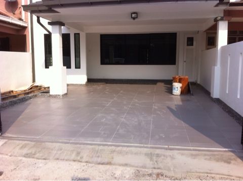

The BRC footing for car porch is now done. It will be finished with pebble wash & tiles later.

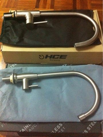

I've bought my indoor & outdoor water filter from Nesh during Homedec last year Oct. The Indoor filter has been installed right away at my current place while the outdoor's will only be installed in my new place later.
I paid RM4608 for the indoor Qoozo series (Ozonation + filtration system) & the membrane outdoor pre-filter. I remembered I was their last customer the very last day of that Homedec event, who has won away the big prize of their lucky draw, a standalone Qoozo mini worth RM1798. This Ozone system combines with the faucet to allow instantaneous fusion of water and ozone that creates water that purifies, sterilizes and deodorises.
There are so many types of water filtration system in the market and I was so confused when I was introduced to Elken's RO water, Amway's E-spring, Alkaline water, etc. I've listened to each brands selling their products giving the pros of theirs and explaining the cons on others competitor's. So, I realised that there will not be a perfect system because each products has its flaws.
Thus, I decided to choose a basic one with affordable price, not too expensive kinda annual maintenance and good filtration. Will avoid RO and Alkaline water at the moment due to its controversial findings. I just need basic and clean water. The ozonation system from Nesh is just an extra features which I can use it to wash vegetables and meats.
It's a table top filter but it comes in such a cute penguin design. tongue.gif
The penguin filter comes with ozone system which can be used to wash vegetables and meats.
The buttons for different ozone usage.

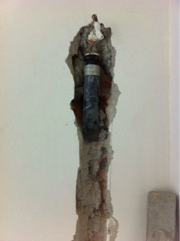

- Checked the in-coming water pipe. It is PVC pipe all the way from the front yard, so no need to change the pipe. (Contractor suggested to check the in-coming pipe if it is PVC or steel. If it is of steel type and found rusted, will need to replace and lay new pipe, otherwise no point of installing the outdoor pre-filter with rusted in-coming pipe)
- Building wall for new entrance. Gonna have a window there to bring sufficient lights into the foyer. We've forgotten to specify what types of brick to be used for our reno before we begin, but I am happy to find out that they are giving me these solid red bricks. smile.gif
Checked the cement which the mixture is of satisfactory too... We are kinda cautious on this as we have seen quite a number of friend's house with those terrible cracked lines on the walls after renovating.

Wiring works has been started couple of days ago.
This is the wiring for 2 power sockets located at both side of my bed, which I'm going to use them for the table lamps. However, I've requested the electrician to adjust the distance from current 6.5' to be parted further abit more than that. Reason being that the king size mattress is already 6' and the bed frame will normally take up a few good inches from there. I'm worrying that the bed frame will clashes with the socket.
Besides that, I've also requested it to be relocated to abit lower height so that I won't feel such uncomfortable, thinking of the 'electro magnetic' thing flowing just right above my head.... blink.gif

QUOTE(maxxon @ Sep 20 2013, 04:04 AM)
For the bathrooms' feature wall, I've found another vendor who has ready stocks for both mosaics above (ST-7058 and MOSWEN).
Nevertheless, will check with Ga Hing again in case they get their stocks already for ST-7058 because GH is selling cheaper at RM48/sqft, while this vendor is selling RM52. If GH is still out of stock, I've got no choice but to get it more expensive... doh.gif
I'm not feeling like giving up this mosaics despite the steep price as I kinda love its mixed materials.
For the MOSWEN mosaics, we have changed our mind after viewing the samples installed in the bathroom at the other vendor's place. We just do not like it anymore seeing it on the wall with white grouts. shakehead.gif
After all, we manage to find a real cheap alternative from Super Ceramic to replace this. It is just RM11.80/ea after discount for 1'x2'.
Instead of 3' width feature wall, we gonna change it to 2' feature like picture below. Coincidentally, they have this samples in the showroom which is very much similar to our colour match. I don't think you can see very clearly from the pic but the texture is quite nice and it should be easier to maintain with such minimal grouts.
As for the stainless steel strips mosaics shown in previous post (It is a mistake that I thought it was aluminium strips), I've found the vendor but they insist to sell it in full carton (11pcs/ctn). It is also slightly pricey. Thus, I dropped this choice.

Wetworks:
Bathroom in master bedroom has been pushed out to the balcony.
There will be a long stretch of top hung windows in the bathroom. It is purposely made to be narrow to avoid intruders...
The new extended main entrance is up. I'm placing a casement window there to bring in lights for a brighter entrance foyer. In between the window and existing beam will be a fixed glass panel. The glass to be installed there so that people couldn't hide themselves out of sight there to break my main door. Btw, I'm gonna install a 5' x 7' security door in white colour.
The front facade has another slight changes where I've taken out the existing door and made the window bigger measuring 12' x 5'H. After the discussion with the vendor, i will most probably going for a sliding window instead of 6 x normal casement windows. Reason being I know myself very well that I'm a super lazy bug who hate the daily tasks of opening all the window panels one by one. Sliding type will definitely makes my life much easier... whistling.gif
grills and awning at rear of the house have been taken down and to be proceed with the rear extension.
Grounding for beam and manhole relocation.

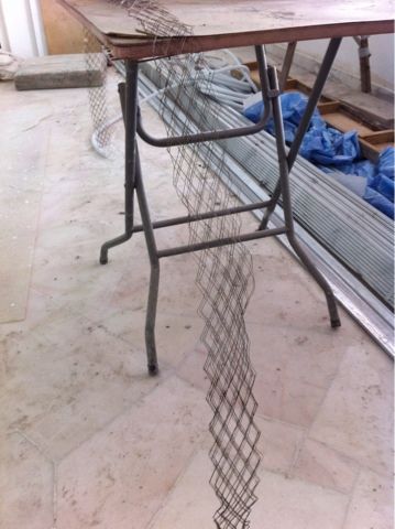

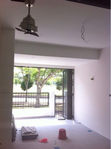

Plaster ceilings for ground floor and first floor are up except for kitchen, pending for the extension works. Down light holes will be cut later by wiring contractor.

Why your power point cables coming from bottom?

The room is at the upper floor.....btw, is that the common way to do?

Nope, all have to drop top to bottom, that is standard.
