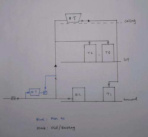

Would like to ask LYN forummers' opinion on which Grundfos pump to use for my house..
My house is a 3-storey terrace with 4 bathroom, 4 water outlet each.
All bathrooms and dry kitchen's water is supplied from the water tank on top of the roof.
My problem is that the water pressure is pretty low on the 3rd floor.
I would like to install water heater in all my bathrooms.
I haven't decided whether I should install 3 water heaters with DC pump or Grundfos water pump & water heaters without DC pump.
Local kitchen accessories supplier recommended me CH2-50PT for RM16XX.
Therefore, I would like to ask your opinion whether CH-PT or CH-PC or any other Grundfos model which able to solve my water pressure problem. Or just water heaters with DC pump?
Thanks.

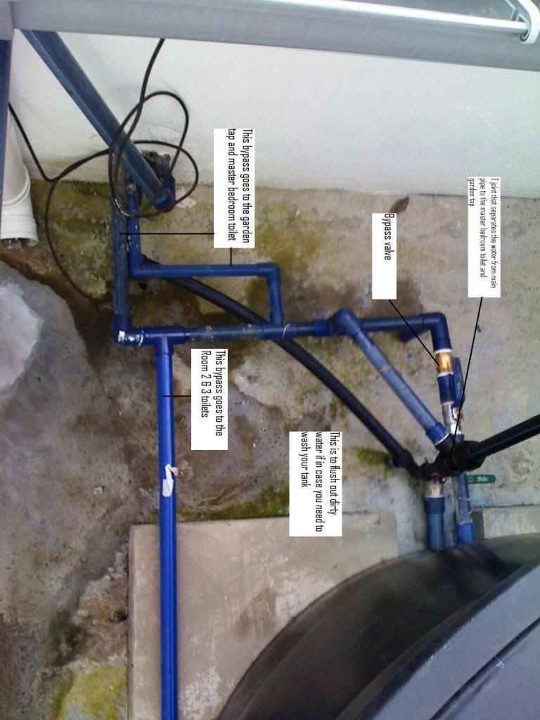

I got a question. I have 2 bathroom upstairs and running direct water from meter. So if one bathroom flush the toilet, habislah cannot take shower in the 2nd bathroom. I am thinking of installing grundfos but told by plumber that me house is >10 years old so afraid the piping might not tahan and leak or burst. Told better to change pipe. Pipe either outside the wall which looks ugly or kena hacking wall and tiles.
You think plumber is correct?
JinXXX
post Apr 15 2011, 01:15 PM
2,516 posts
Joined: Feb 2007
From: Uarla Umpur
QUOTE(maul @ Apr 15 2011, 10:34 AM)
yup....
usually is like that... one.. unless u take measurement of the original pressure , cause you said direct...
then set ur pump to be similar.. then should be no problem.. usually the leak will be at the joints/fitting areas...
its always a 50/50 risk.. thats why is best to get the right pump that gives the right amount of pressure..
else will bocor here and there...
Direct from source usually the pressure are very high. My current house is double story, the direct pipe to top floor is very strong.
Some house get weak pressure because the incoming pipe already got build up inside. Or installed sand water filter which some brand (older version) reduce the pressure to ensure the tank don't burst.

I am concern dont know where bocor and after down stair ceiling start having stain. Experience once when I renovated my toilet. Idiot contractor told me no need water proofing. Then start seeing stains on ceiling downstairs. Called him and came once to fix but didnt stop . Subsequently dont pick up phone. Have to call another contractor and told have to re tile with water proofing. Almost double my cost.
So coming back to waterpump, seems its true and only way is to change pipe...

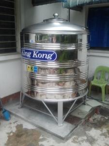

King Kong water tank is the best and i would b able to offer good prices

QUOTE(zheilwane @ Jul 27 2011, 10:37 PM)
king what ? got url/website ?
nvm found it
http://www.honesteel.com/tiki-galleries.php
just curious why you say king kong is the best ? when compared to deluxe ?

just look at the photo and you can tell the difference. Deluxe and most of the brands in the market has only V leg stand while King Kong has V and I leg stand, more solid and durable.

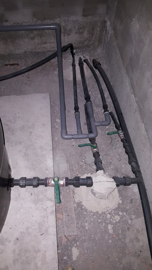

zheilwane, i'm using a CH-PT pump. If i switch off the power no water flows down anymore. Why is it? it was installed by my contractor during my house reno last year. Possible to rectify this issue?

is ur water tank located on ground floor?

QUOTE(zheilwane @ Jul 31 2011, 12:42 AM)
The water tank is in roof (2 1/2 storey) and the pump is just located beside it.

QUOTE(singhwa @ Jul 31 2011, 02:45 PM)
It is impossible then. Water should flow through the pump even u did not turn on the pump. You will nd 2 snap some photos and show me or get ur plumber to check on the piping
sl2007
post Jul 31 2011, 09:58 PM
285 posts
Joined: Jun 2010
Not mistaken the plumber has installed a Non-Return Valve at the outlet connection....

QUOTE(sl2007 @ Jul 31 2011, 09:58 PM)
dont see a problem with that, unless its faulty la.. *my opinion*....

QUOTE(zheilwane @ Jul 31 2011, 09:10 PM)
Zheilwane, the installation is similar to the link u provided: http://www.youtube.com/watch?v=DNVlxcF0t3s. except the water pump is diff. i will snap the photo for u by this few days.

This is the high level water supply plan for my new 2-storey home in Johor Bahru. Appreciate if any one of you could have a look and comment.
I have also contacted zheilwane to ask for his associates or friends in JB who is familiar with the Grundfos pump and could help me with the installation.
zheilwane
post Oct 2 2011, 12:25 AM
4,184 posts
Joined: Jan 2008
From: Builders Hardware Enterprise 0362572412
Just a quick question, where did u purchase the pump from? The seller cant help u? You should really buy from some1 who is professional and could give u good advise. For example, if ur plumber has done the piping as per ur photo, you will have some problems after the installation....
a) The most important thing, you need to install PVC unions as per grundfos requirements.
b) If cold water is boosted by the water pump while the hot water is using water tank's water, your hot water pressure will b much weaker than the cold water. So, when u r showering, you will feel the water is not hot enough as u r getting more cold water than hot. Therefore, the tank's outlet should go into your pump then split to ur heater and down to your bathroom. By doing this, you will have same pressure for both hot and cold.
c) The pump by pass is wrong. Imagine u r using 8-10" rain shower but ur pump is out of order, so you will b using the pump by pass. However, the water supply is from the tank, do you think u will have sufficient water pressure to power up the rain showers? You should do a main water by pass instead.
Here is how the installation should look like
Hope that answers ur question
This post has been edited by zheilwane: Oct 2 2011, 12:38 AM

post Oct 2 2011, 01:04 AM
37 posts
Joined: Jan 2005
Hi zheilwane
That has helped clarified a lot. I did not expect you to make correction on the diagram. Thank you for going the extra mile to help.
I have not purchased the pump. Grundfos Malaysia directed me to a Johor Bahru dealer (Dataran Tenaga). In a brief phone enquiry I found out the company apparently does not provide installation service. They are saying most plumber would be able to carry out the installation. I need to check this out further when I visit them in person.
Added on October 2, 2011, 9:49 amThe Grundfos CMB 3-5 comes with integrated non-return valve. By that I presume in the event of power failure to the pump, the direct water bypass would not be able flow from pump outlet to pump inlet and subsequently flood the roof top tank. Is my understanding correct?
This post has been edited by leekb: Oct 2 2011, 09:49 AM

QUOTE(leekb @ Oct 2 2011, 01:04 AM)
Hi zheilwane
ahhaah took me 30 minutes to edit the diagram... gonna charge u for consultation hahaha.
Yes, Grundfos CM and CH pumps do have a non return valve. So, water will not travel from the outlet to inlet.
Unfortunately, i do not have a branch in Johor and we don provide delivery service upto Johor. However, if you are interested with Fotile Hood, hob + oven, just PM me as FOTILE could provide FREE delivery service throughout west malaysia.

would like to thank this forum/topic for all the wonderful discussion on pump/tanks and etc..
and here is my big ass tank to solve all my water problems until LAP/syabas off the main
thanks to zheilwane for his customer service..
BIG ASS TANK IS BIGGGG

Very big, you put it on the ground floor? what happen to Syabas? is your area frequent water disrupt?
yes its on ground floor, cause single story , no "upper-cement" slab/platform place to place it..
my place its LAP , piping too old, and full of shit/rust/sand/soil what ever, water pressure damn low... need about 5 mins plus to fill my toilet flush

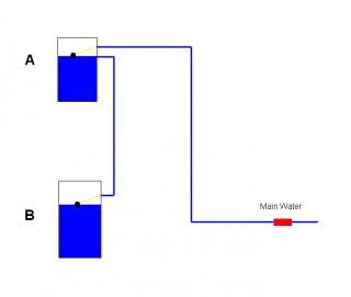

hey guys just a dumb/curious question
let's say i got 2 tanks..
1 on the roof(100gal) and the other on the ground floor(500gal)
how do i let my roof tank fill up first before filling up my ground floor tank..
i can't pipe the roof tank to fill the ground floor tank, cause that will cause all the water to fill the ground floor tank which leads the roof tank to be empty most of the time...
ozak

Why cannot? Just pipe out from the roof tank. Put a ball shutoff for the ground tank. When fill up, the ball will shutoff. The main pipe continue fill up the roof tank.
zheilwane
post Oct 14 2011, 09:36 PM
4,184 posts
Joined: Jan 2008
Never tried this before, but i guess this should work. Why u wanna do so?
The main will fill up the top tank first. WHen water level reaches the top level, it will flow down to the ground floor tank. Once the ground floor tank is filled upto the infill valve level, the water will stop. Hence, the main water will continue to fill up the top floor tank until it reaches the max level which will then turn off the infill valve and stop the water from entering the top tank.
This post has been edited by zheilwane: Oct 14 2011, 09:45 PM
JinXXX
post Oct 14 2011, 10:02 PM
2,516 posts
Joined: Feb 2007
From: Uarla Umpur
QUOTE(zheilwane @ Oct 14 2011, 09:36 PM)
oh damn.. didnt thought of that... hmm yeah... this method could work...
thanks, damn why didn't think of that,,
Added on October 14, 2011, 10:03 pm
QUOTE(ozak @ Oct 14 2011, 09:29 PM)
cannot cause the top tank will be drained first..
so like zhen said.. need to have an outlet that is higher... smile.gif then the main outlet of the top tank smile.gif

QUOTE(JinXXX @ Oct 14 2011, 10:02 PM)
Eh.. Your ground tank always empty?

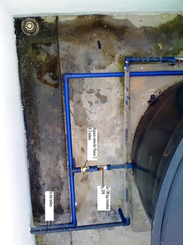

Zheilwane,
Looking at the piping plan below, I think my plumber had made the same mistake. My rain shower when using cold water is stronger, but when I use warm water drawn from a water heater tank, the pressure drops.
My 1-year old pump just spoilt, and all the taps in the First Floor baths are down to a trickle (not so trickle, but water is super super slow).
My pump is set up outside my house, I was told this is better because of easier access for repair or maintenance. I have a switch next to the pump, I supposed when it is time to change the pump or to repair, etc, one just need to switch off. I dont have any shelter, other than for the eaves of the roof.
I was advise that I shld have a switch inside the house, so I could just switch on the pump for bathing purposes.
Currently, my pump 'wails' every now and then, as it powers the 2 bathrooms and every time I turn on a tap or flush the toilets, the noise goes..
Any advise?
QUOTE(zheilwane @ Oct 2 2011, 12:25 AM)

Few things you need to make sure
01) Pump is sitting on a secure surface
02) Pump is sitting on the anti vibration map
03) The outgoing pipe from the pump need to be fully secure. My contractor actually screw / nail the outgoing pipe to a wood where the wood are secure to the roof truss.
I am using grundfos, i don't hear hammer sound. Sound sure got when the pump is on, is not loud, and it won't wake you up during sleep

My pump is not a grundfos, as my husband got persuaded by my plumber to fix sthg else. Since it 'koyak' after a mere 1 year, it works out to be more expensive, so my plumber's argument that grundfos is all about paying for brand really fall flat. In my moment of weakness, I let this one go... so it is a costly lesson loh...
My next pump will be a grundfos for sure... but I would like to take the opportunity to correct the plumbing route (if it is still possible??) as water coming out of the boiler has little pressure, and to fix a switch inside the house so I only switch the pump on for showers (an engineer gave this advise lah!!). Of course, I am not sure that the s/s bracket on the exterior wall can house the new pump or not.

Sound like the boiler inlet are not from pump, that is why you get low pressure for hot water.
lizziewong
post Jan 10 2012, 04:56 PM
185 posts
Joined: Jun 2010
QUOTE(weikee @ Jan 10 2012, 04:52 PM)
Yes, I realise this is a possibility after looking at the drawing updated by Zane!!!!!

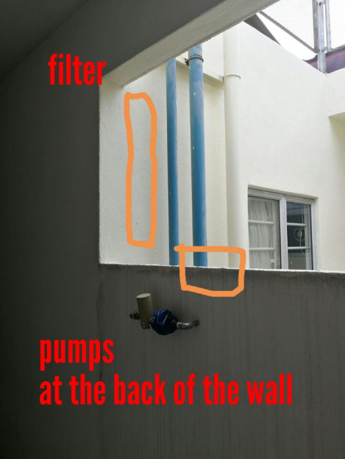

This post has been edited by lizziewong: Jan 10 2012, 04:57 PM
weikee
post Jan 10 2012, 05:05 PM
10k Club
12,019 posts
QUOTE(lizziewong @ Jan 10 2012, 04:56 PM)
I read you also switch on the pump 24/7? Is actually recommend to put the on/off switch inside to only switch on when require.
lizziewong
post Jan 10 2012, 05:11 PM
185 posts
Joined: Jun 2010
QUOTE(weikee @ Jan 10 2012, 05:05 PM)
Yes, the pump was on 24/7. Quite embarassing when one use the WC or wash hands at midnite or later!! My plumber assures me that this is the correct way mad.gif. I was also under the impression that if the pump is not on, there will be no water flowing into the bath taps, etc.
Now I need to do this:
1. install a switch inside the house.
2. Route the piping to let the boiler draw water from the pump.
are these jobs difficult to do?

post Jan 10 2012, 10:27 PM
4,184 posts
Joined: Jan 2008
I guess your plumber mounted the water pump on a wall. When the pump vibrates a little, the vibration will travel down to ur house and the noise is also amplified.
Not very difficult to do the stuff above but due to CNY is around the corner, it will b costly to do so (plumbers will hike up the price).
If you wanna get the problem solved quick, jus drop by my shop and speak to Thomas, he would b able to give some good advise.
http://forum.lowyat.net/topic/1918768/+840
This post has been edited by phoenix69: Mar 10 2012, 12:42 AM

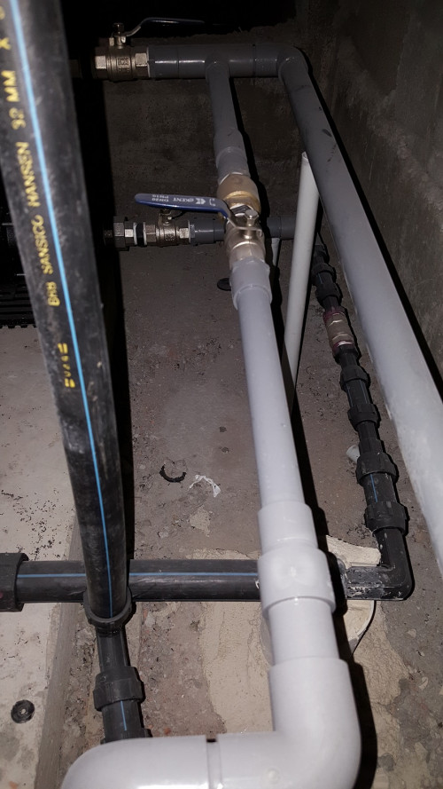

regarding the NRV , how good is the "seal" ?
usually the pump pressure is higher than incoming.. one..
if the NRV seal isn't good.. the meter run terbalik and get no water at all ? or its somehow equalize ?
cause im planning to do a "auto-bypass" for pump when got power trip/no electric..
ozak
post Mar 11 2012, 01:28 PM
10k Club
17,018 posts
Joined: Jan 2005
QUOTE(JinXXX @ Mar 11 2012, 11:48 AM)
My 1 insall since day 1. Never change before.
I install it after the water filter, tap and meter. So when change filter, I have a chance to know is the seal working or not.
Unless you have frequent disruption, if not doing auto things will complicate and cause more problem. A manual by pass is much better, or just have a big azz tank up the roof.

One way valve some day will have problem though you have not experience. the rubber rot, expanded and the spring also. Besides for those with low water pressure from main it somehow reduces the flow and pressure as the water has to push thru the valve/spring to open it. Also, when sands/debris get stuck there the reverse can happen.
i have to change my solar heater's one way valve once every 3 yrs under the hot sun when it leaks or get stucked.Just dont know where the sands/dirt come from and the rubber and spring not working.

It is simple. Look at this pic. Just like pumping car/bicycle tire except that you have to use a (tyre) air pressure guage to check the pressure of the air inside after filling.
Actually you can take the whole tank out after shutting the water supply and take it to petrol station to fill the air and then put back. That is much much work and make sure no leaking at the water inlet.

QUOTE(stevie8 @ Mar 19 2012, 02:49 PM)
I have no video and manual.
thumbup.gif thumbup.gif haha.. that is why i said put a stopcock before connect to the tank, i pump the air at petrol station whistling.gif whistling.gif

QUOTE(skng03 @ Mar 19 2012, 05:33 PM)
A stopcock plus a union = perfect.

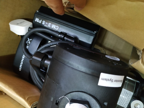

Recently I just bought Grundfos CM3-5PC water pump from Zean. Get my plumber to install it on Thursday & have a chance to test it today.
Here is my experience on this water pump & conversation with my wife after I tested it...
Me  : Oh... I felt so stupid & regret after I bought this Grundfos water pump.
Wife : Why? I tot u said it's good?  hmm.gif
Me  : No! U listen to me... I tested it just now... Now look at my pants...  cry.gif
Wife : Huh? OMG... U pee on ur pants?  shocking.gif
Me  : Urrrr.... No lar...
Me  : Hai...  Becoz of the water pump lar... Just now I opened my water stopcock in my bath room. The water is coming out from the water tap hole (I haven't installed water tap yet) & shooting at me around 1ft long... Where I'm standing 5 ft away from it... Then, I asked my contractor to open water pump to test...  shocking.gif The water just shooting at me directly on my pants...  Damn... I'm standing 5ft away from the water tap hole!!! My contractor & I laughing non-stop...
Wife  : I tot u said regretted buying it?  sweat.gif
Me    : Ya lar... I should have bought this earlier...  tongue.gif
Wife  : doh.gif

here is some interesting info..
http://www.derm.qld.gov.au/factsheets/pdf/water/w8.pdf
when i mentioned ladder..
meaning the output of the pump is not connected directly to the pipes and all, so if there is a shockwave it can travel straight/directly..
something like this...
if you install using 2 step ladder or less the vibration will be captured in the ladder.. area *i read this somewhere can't seem to find it*
so the shockwave will be like "trap/dissipate/won't travel" in the ladder area

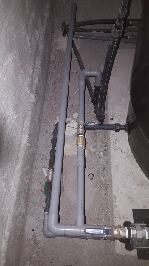

Scissorshand
post May 24 2012, 10:45 PM
1,691 posts
Joined: Nov 2008
Well, when i shifted to my new place, the water pressure was lousy as hell, then i got my contractor to do the bypass to increase the pressure to 3 toilets and also the garden pipe (yes, the water supply to the garden is coming from the tank for my house instead of direct).
The result was fantastic and it cost me RM300 rclxms.gif only. Scope of works incl:
2 pcs of one way spring loaded brass valve,
T joints
high quality PVC pipes
The work took 4 hours to complete incl waiting for the glue at joint area to completely dried up and testing as well. Now am enjoying my daily rain shower and the garden tap pressure is strong enuff so much so i dun need to use water jet pump to wash my car. In addition, i dun use any electricity... rclxms.gif rclxm9.gif
This post has been edited by Scissorshand: May 24 2012, 10:48 PM
KVReninem
post May 25 2012, 12:45 AM
IX
5,369 posts
can you rotate your picture? cos it hard for us to read.
skng03
post May 25 2012, 01:56 AM
1,450 posts
Joined: Oct 2008
QUOTE(KVReninem @ May 25 2012, 12:45 AM)
KVReninem
post May 25 2012, 03:36 AM
IX
5,369 posts
QUOTE(skng03 @ May 25 2012, 04:56 AM)
right; yeah, i`m lazy like you ..i rather see it at readable position than twisting my head clockwise to read. Can you pls twist yr head clockwise pls. smile.gif

QUOTE(Scissorshand @ May 24 2012, 10:45 PM)
T joints
looks like ABS pipes to me

Scissorshand
post May 28 2012, 02:03 PM
1,691 posts
Joined: Nov 2008
QUOTE(ozak @ May 25 2012, 09:09 PM)
Why the plumber never advise such a problem will arise if want to bypass? Can't blame on the owner with less experience.
Well, the bypass is not actually 100% bypass as u can see in the pic there's the spring loaded one way valve which actually allows the water from the tank to flow out to the toilets @ bathrooms doh.gif upstairs. This is to ensure if there's no water supply, the toilets @ bathrooms still has water supply from the tank thumbup.gif .
The toilet downstair which is frequently being used as well gets its supply direct from the tank. Furthermore the tank comes equipped with a drain valve in case for washing the tank.

QUOTE(mhhee @ Apr 21 2012, 06:03 PM)
Wife  : doh.gif

The installation diagram of Grundfos water pump with water bypass. You can get the same as well in Hitachi water pump brochure. smile.gif

You can get Hitachi water pump in Klang too, so far the nearest I got is few hardware shops around Econsave Jalan Kebun, Klang.

QUOTE(mhhee @ Jun 19 2012, 11:23 AM)
RM400 installation is expensive? I tot Zean also mentioned it's around that price? tongue.gif
I also got RM400 water pump installation with direct water bypass after I show my plumber the installation diagram I got from Zean. Before this he quoted me RM300.
rm400 to install the pump only is expensive, imagine just cut off the main pipe from water tank, connect to pump inlet and outlet with few fitting tongue.gif tongue.gif
zean's diagram include additional non return valve / by pass, rm400 is reasaonale

The installation just for the pump of course is expensive but he said additional piping to a semi-d. Of course Ozak is a DIYer anything more than material cost is expensive nod.gif
Puting a tank yes but tank costs money. RM200 maybe but that is a very good idea. I will do that too.

The pump that use in average home here call surface pump or booster pump. It mean to use to boost the pressure water for your entire house. Surface/booster pump cannot run dry as it will spoil the mechanisim inside. It also have a height limit of sucktion in inlet.
So the best way to instal is beside or below the water tank. In this way, the pump inside will alway have water and some small pressure inside for the pump primeming.(Easy start water pressure boost and water act as coolant for the pump mechanical)
If you want to boost the water up to your roof water tank, than your pump must install at the downstair main water supply pipe. Which the main pipe always have water and small present of pressure. But remind you that this kind of installation is illegal if I not mistaken. It can cause your neighbour low water pressure and get complain.
The price of the pump different of course got to do with quality, R&D, reputation, specification and durable. Just like proton car and benz.
Get the brochure or catalog of the pump and compare the specification. Check which 1 you willing to pay.

Got my Pump a few months ago, officially only tested yesterday as I have just filled the water tank with water...CM3-5PC from Zein of Builder's Hardware..
First review, water is super powerful....however, there is a humming sound...I think it's slightly loud..anyone got any insights on the same model ?
Additional Stuffs :
Upon posting this question (tot of just asking around). Zein of Builder's Hardware gave me a call straightaway and ask me to check a few things to ensure that the humming is okay...
Thanks Zein, really thumb's up for BUILDER'S HARDWARE, great after sales service. never expected to get a call...really appreciate it smile.gif
I will go up to the roof and check if the installation is correct as suggested by you and will revert...once again..thank you for the call.....
Hi there, anyone still have the corrected installation pic ?
http://a5.sphotos.ak.fbcdn.net/hphotos-ak-...520736454_n.jpg

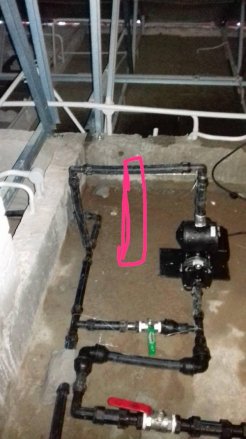

I bought a new house at damai residence kemuning utama, wanted to install the C3-5h model, but very scared later all the pipe in the house burst because of poor workmanship and then developer say no warranty because u add a water pump
