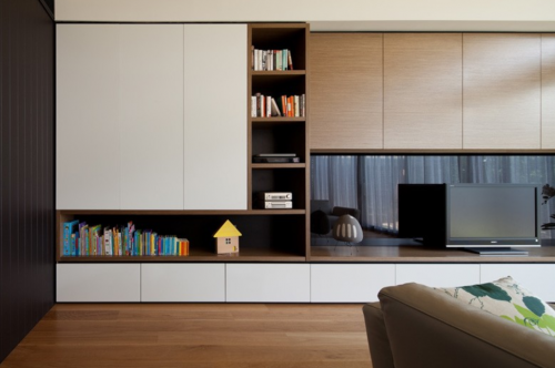

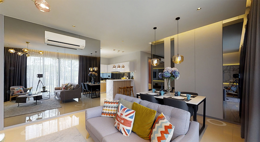

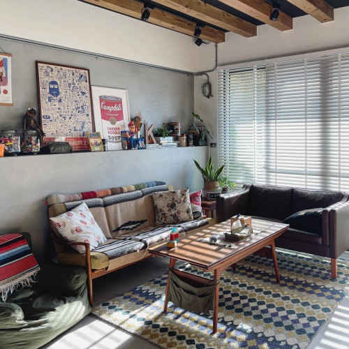

Why not we appreciate some interior design visuals for the starts?

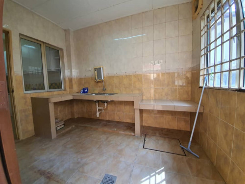

What kind of considerations should we take into account when thinking about the kitchen cabinet layout?

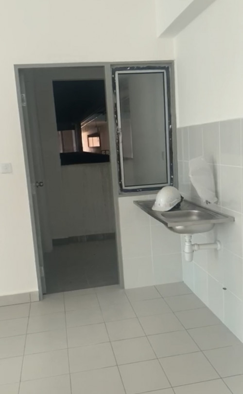

Question:

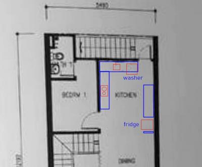

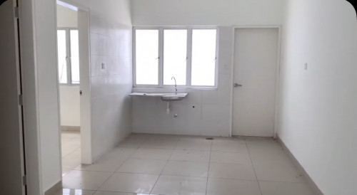

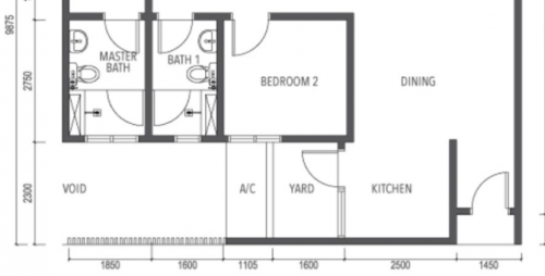

I notice that a lot of houses have their kitchen sink facing a window, but I find that the window grills get rusted easily as it's near a humid area. All those nice design ones don't seem to have grills and it's overlooking nice garden etc. People may say that it's nicer to look out of window as you are doing dishes, but then if your view is merely your neighbour's back alley etc, is it really worth it. When we do dishes, don't we look at what we are washing instead of looking out? Any ideas? Should I place my sink next to the window or not?

There are many things we need to figure out for kitchen cabinet layout, most important we need to ensure our kitchen has the types of different storage compartments we need and secondly the arrangement of these cabinet positions won't conflict with the working flows in the kitchen.
Cabinet layout needs to suit our daily cooking routines, as nobody has the same cooking ways.
Ultimately " Functional " should be the first priority on a good kitchen design!!
This post has been edited by ehwee: May 22 2020, 03:16 PM

QUOTE(Dfuzzy @ May 22 2020, 03:02 PM)
Question:
True on what you have shared, you have the said on where you prefer to put the sink as you are the person who know what is the best position to place basin, cooking hob and fridge ( which are the 3 important elements in everybody kitchen ), and their positions will make you feel comfortable during your cooking session.
So basin at window is not necessary a compulsory thing. It depend on your existing kitchen layout, shape, size and the window position!!
Most people prefer basin in front of window as it is where the brighter area with natural light shinning through. You won't put cooking hob at window side in modern living for sure, yet if you prefer to have a brighter food preparation area, it is ok the put basin on other place to reserve the window area for preparation activities.
So you have the said!

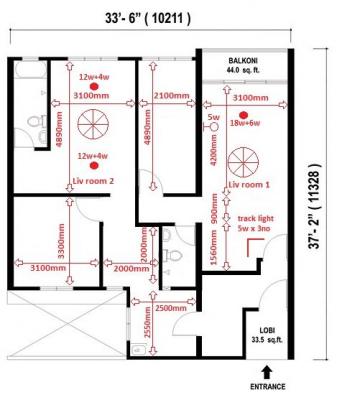

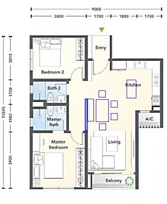

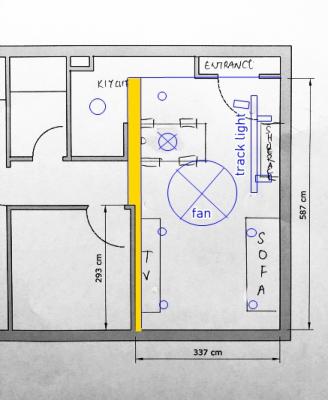

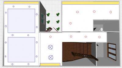

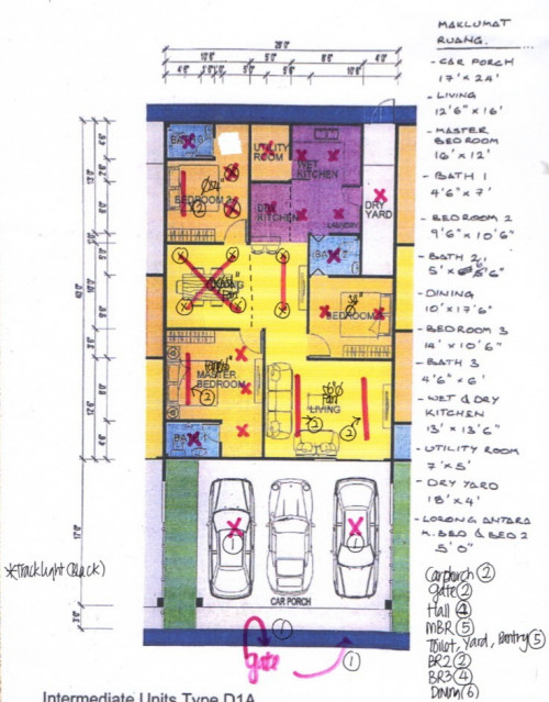

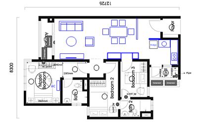

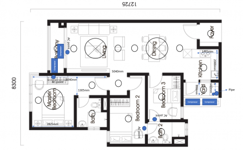

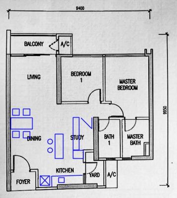

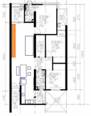

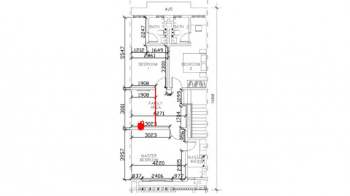

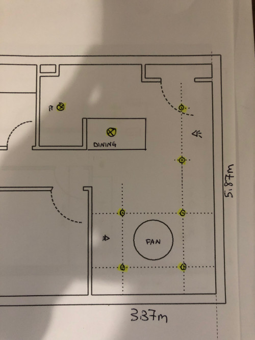

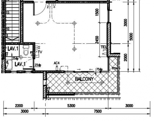

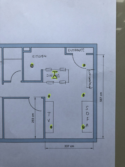

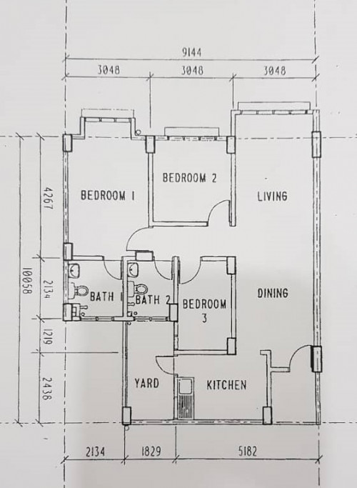

hi, can u help to look at my lighting layout for living room 1 and living room 2? is the lighting provided sufficient to light up the living area?
and i plan to use double colour light, any comment on this type of light? notworthy.gif
This post has been edited by Agent 45: May 22 2020, 05:33 PM

QUOTE(Agent 45 @ May 22 2020, 05:32 PM)
I assume you are having expose slab, if there are no additional plaster ceiling light trough.
It's seems doesn't enough especially on living 1, may be you can opt for ceiling fan that c/w light also, it might help.
How does your supplier thoughts on that since they sell them.....
This post has been edited by ehwee: May 22 2020, 06:11 PM

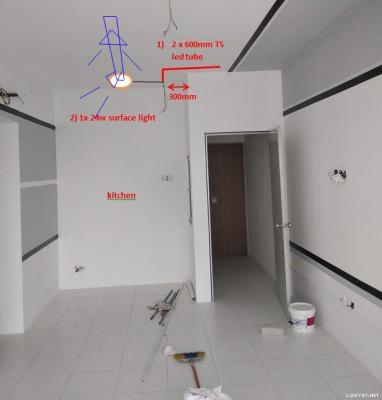

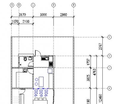

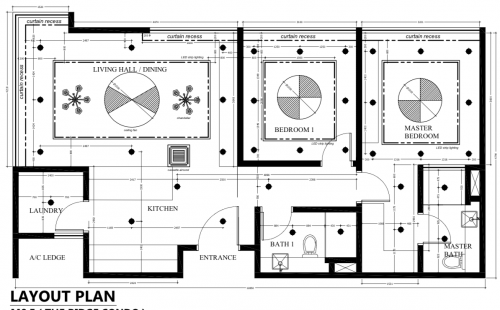

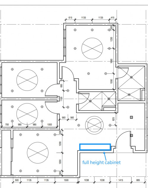

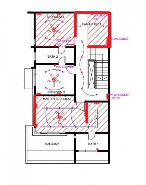

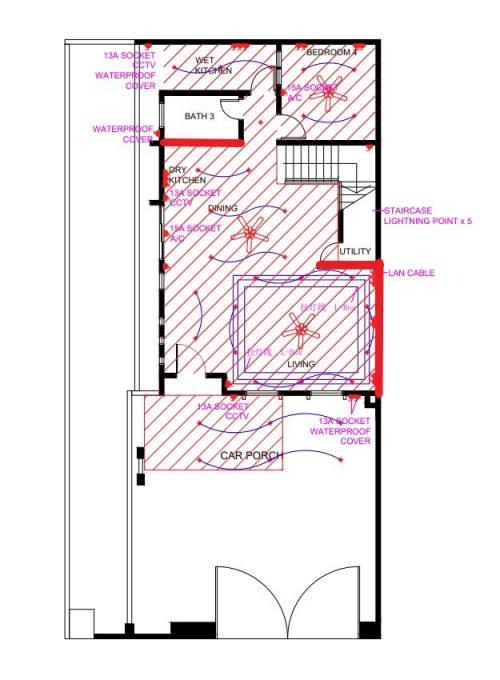

Hi,

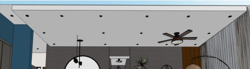

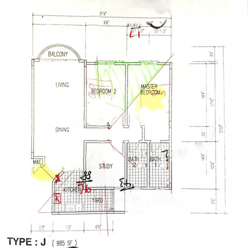

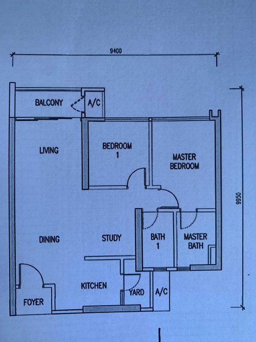

Could please provide your comment on the lighting layout that was provided by one of the contractors. Thank you in advance ya smile.gif

QUOTE(pvd3wseng @ May 22 2020, 10:37 PM)
Hi,
Since you are having both down lights and light trough, it is definitely enough yet may be bit bright for someone else, so depend on your preference.
It also depend on the wall painting color, ceiling height and color and wattage of these downlights.
If your wall has middle to darker paint tone then the overall lighting brightness will appear darker if compare to having white wall environment.

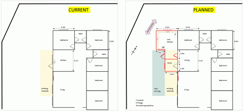

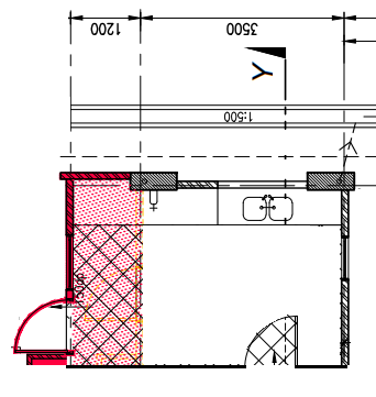

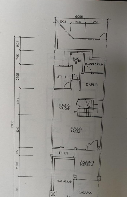

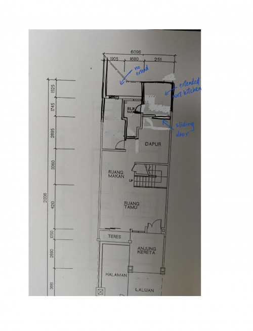

i'm thinking to extend my kitchen out. initial planning is to extend around 11ft (long) x 10ft (wide).
However, the initial planning will cover up one of the septic tank manhole. Contractor advise not to do so just in case there's a blockage in the future.
Due to this, the extension of my kitchen become 11ft x 8ft only which is kinda small.
My question, is it ok to cover up one of the septic tank manhole for a bigger kitchen?

If the manhole position is not right at your new extension wall line and away from your kitchen cabinet, able to access for maintaining then OK.
Hope this help 👍

QUOTE(ehwee @ May 23 2020, 09:16 AM)
Hi,

QUOTE(pvd3wseng @ May 23 2020, 02:03 PM)
Hi,
For the light troughs, can we used LED light strips instead of the T5 LED tube? Since I just want to achieve an ambient lighting for the spaces. Or will it be too dark to live in?
Yes LED strips will achieve smoother gradient lighting effect comparably to t5, If you wish to use them for ambient lighting since your downlights are good enough as the main general lighting source.

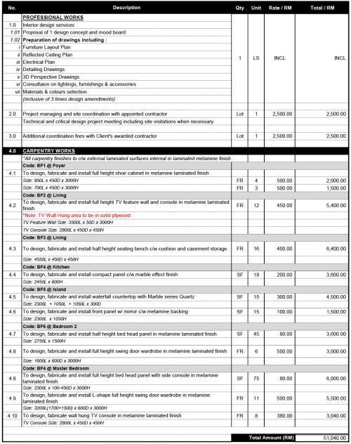

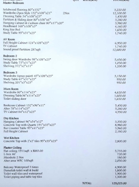

Hi i saw your website,
https://reddotzinteriordesign.com/2016/01/2...-alam-malaysia/
How did this end up to cost 120k?
TSehwee
post May 24 2020, 10:15 AM
Value Our Living Spaces!
790 posts
Joined: Sep 2013
From: Selangor
QUOTE(Archemedia @ May 24 2020, 12:55 AM)
This is a 700sqft soho unit, the owner wished to divided out a single bedroom.
The cost seems high, yet if you analyze what have been done then it will be another story.
As It was not just for standard renovation work like glass wall sliding partition, timber flooring, plaster ceiling, plywood base build in cabinets, m&e, painting works, air con, lighting fixtures, etc. Yet also include all the loose furniture, curtains, dining set, sofa set, bed set and some appliances you can see over the images.
This post has been edited by ehwee: May 24 2020, 10:34 AM

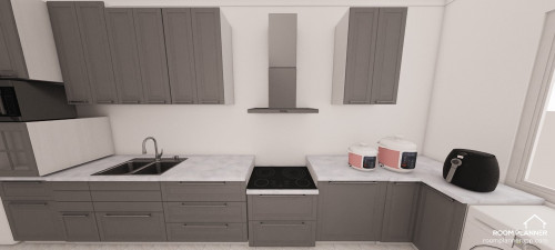

QUOTE(ehwee @ May 22 2020, 03:08 PM)
Would more drawers rather than door cabinets be useful in the kitchen? Which is best for storage?
Personally find that drawers are better because can see everything at one shot / no need to dig around but not sure if it is the most space conscious option

QUOTE(mayonggglyt @ May 28 2020, 09:46 AM)
I would say drawers are convenient for small utensils like forks, spun, cups, cooking pans, etc.
Yet for plate and bowls still better go for door compartments with pull out shelves or baskets.
Or you are buy some transparent containers to store and categorized different items or seasoning sauce if using normal doors compartment with adjustable shelves.

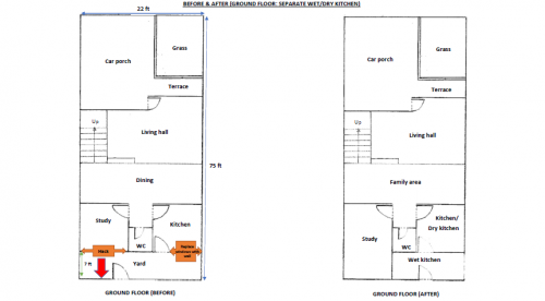

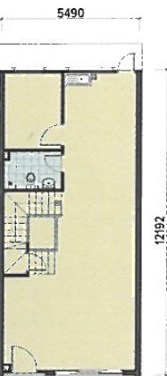

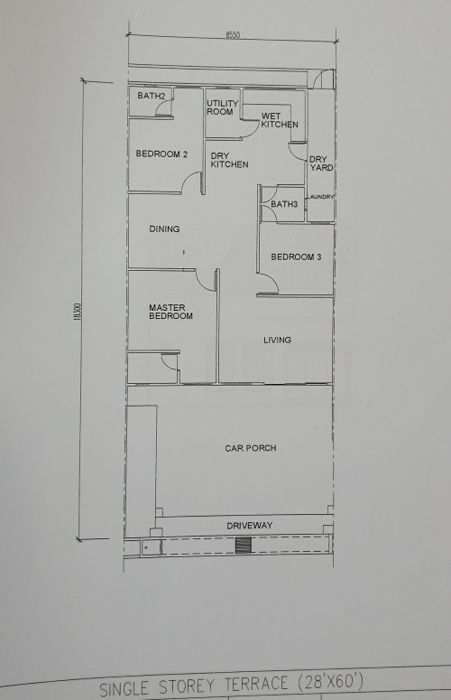

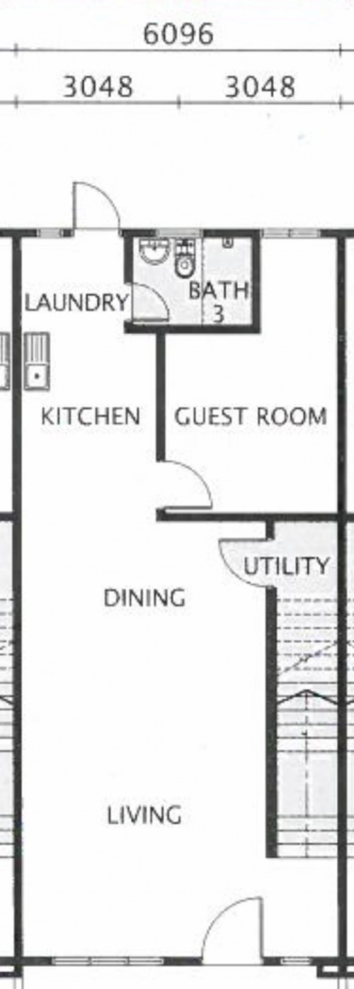

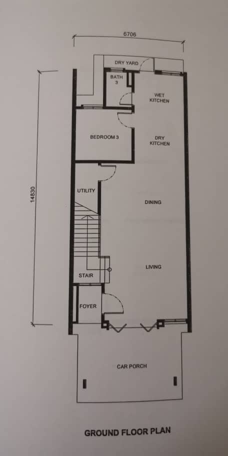

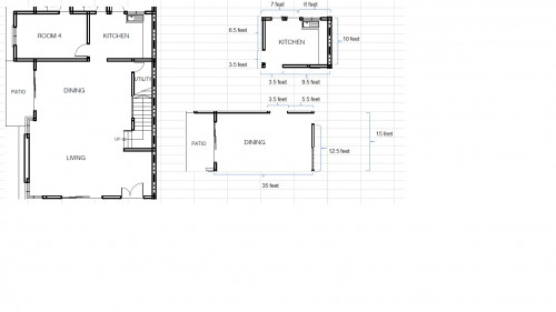

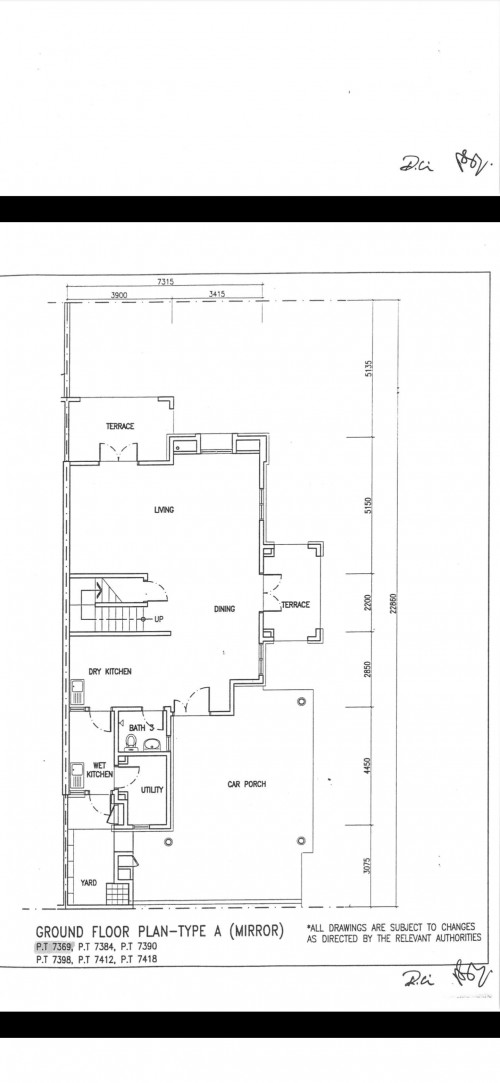

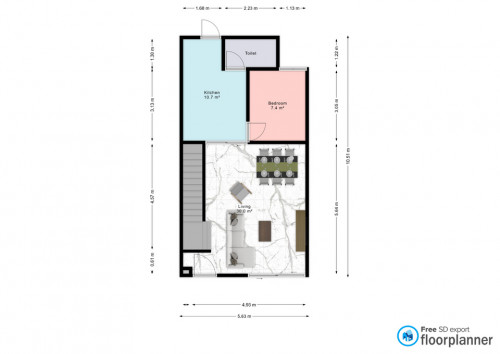

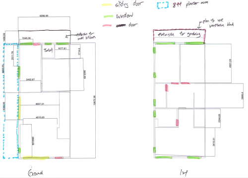

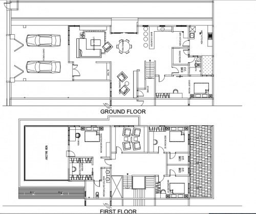

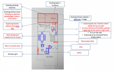

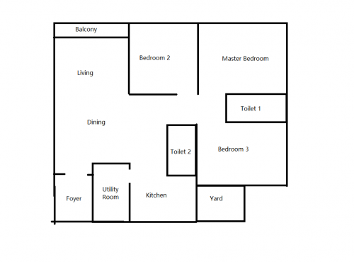

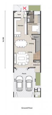

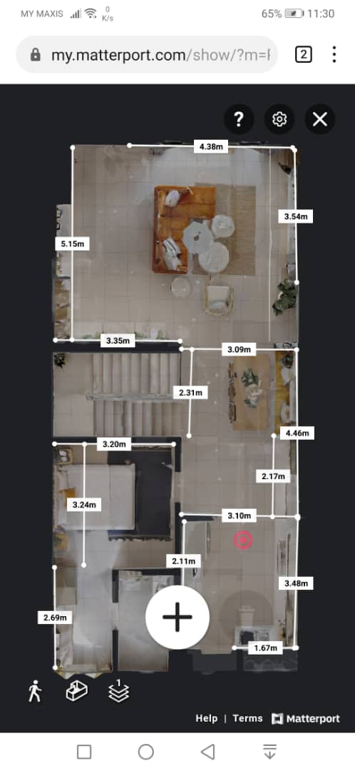

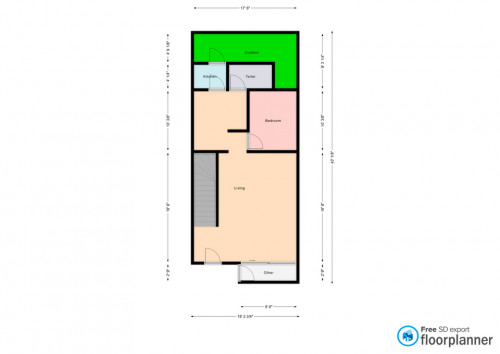

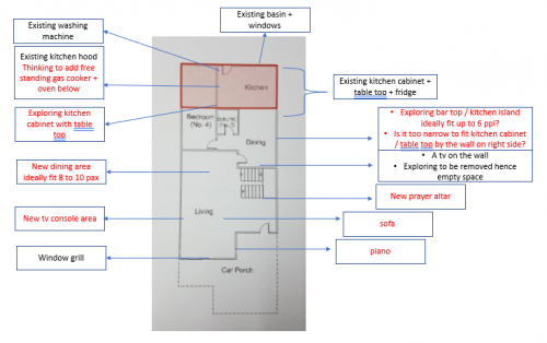

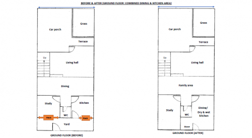

Do u think this is a good layout/arrangement in small single terrace house?
Original
My own plan
Original
My own plan
Sorry chuanhong, I am aware of your post will find my time to think about it and give you some suggestions.
Pls bear some time with me, I am a bit tied up these few days for design works.

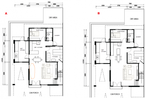

QUOTE(ChuanHong @ Jun 3 2020, 06:33 PM)
Original
My own plan

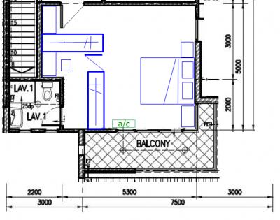

I found the most concerned area for better space planning and full use of available space is the corner where you place your altar cabinet.
Here are my 2 suggestions for you. Instead of having a new brick wall which will cause some awkward and not fully used space behind the wall, you can just do a full height cabinet that can double up as separated wall.

QUOTE(ehwee @ Jun 6 2020, 01:26 PM)
thanks.. so far i have 1 custom made altar cabinet which is about 42inch (nearly 4ft size).. 11ft height.. which i plan to move the god altar from house A to house B (house B will have below 10ft after plaster ceiling.. plan to reuse it.. but yeah.. basically i plan to use behind the altar cabinet as a storage wall with racks to put some items on top and bottom to keep something like vacuum, tables, etc..
but your idea is really good i will try to compare the cost of modified my existing god altar vs having new god altar cost..
existing god altar is fully laminate front, side and back.. looks nice ady.. glossy white.. without the wall, i afraid the space is too big between living hall and behind kitchen.. so i need to discuss with my contractor and see any solution for that..
This post has been edited by ChuanHong: Jun 7 2020, 09:43 PM

If you(1)living area- cool light with some warm white spot light on wall surface
(2)bedroom - warm light with some cool white wall or table lamps
(3)toilet - cool white

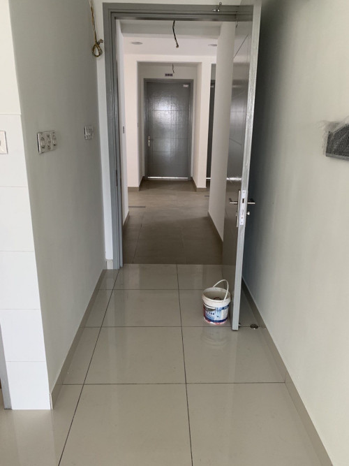

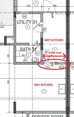

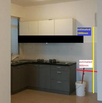

can u advise if which option is better?

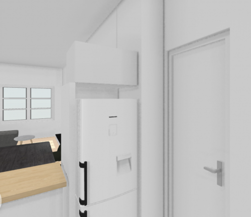

option 1 connect 2 x 600mm T5 led tube in L shape so that it can light up my entrance area
option 2 install only 1 24w surface light, but entrance will be a bit dark?
option 3 track light, it is ok to use track light for kitchen area?
or do u have any recommendation?

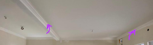

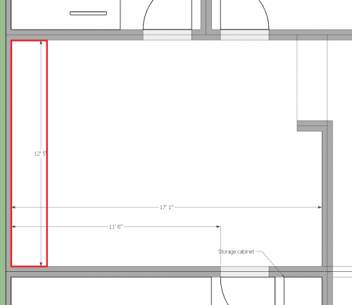

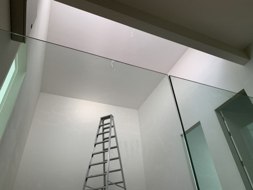

hi, my house developer already installed plaster ceiling for me, but with cornice at the side (refer to purple arrow). However, i prefer a plaster ceiling with right angle/some L box for lighting/or recessed curtain.
Is it possible to do some modification to current ceiling like adding some box at the side part? Will it be alot of work and costly?
Thank you!
This post has been edited by roi: Jun 10 2020, 01:10 PM

QUOTE(Agent 45 @ Jun 9 2020, 09:50 PM)
Yes, I would say option 3 track light is a better choice, can use 2-3 nos of adjustable track lights to light up different spots.
This post has been edited by ehwee: Jun 11 2020, 01:25 PM
Agent 45
post Jun 11 2020, 05:46 PM
934 posts
Joined: Mar 2009
QUOTE(ehwee @ Jun 11 2020, 01:24 PM)
alright thanks, but wouldnt it be a bit dark for kitchen area to use track light? hmm.gif

QUOTE(roi @ Jun 9 2020, 11:02 PM)
Thank you!
Cornice is actually 'glued' to the side of the wall or plasterboard. U will have chance to have a perfect L after u remove the cornice or it's hollow and u need to patch it back with ceiling board/plasterboard to make it perfect L.
It will takes some skill and time for a DIY job and u might not make a perfect smooth line.
Since it is a very minor job I think contractor will still charge 1 day labour to do this.
Hope this helps.
KaLs
post Jun 11 2020, 07:24 PM
148 posts
Joined: Jan 2011
QUOTE(KaLs @ Jun 11 2020, 07:23 PM)
Hope this helps.
Do note you will need to paint and patch back the the area you removed the cornice. Make sure the wall and ceiling paint is still available.
roi
post Jun 11 2020, 10:56 PM
41 posts
Joined: Aug 2009
Hope this helps.
Glad to know that it is not a major job. Thanks!

QUOTE(Agent 45 @ Jun 11 2020, 05:46 PM)
should be ok, suggest go for cool white instead of warm white colour that is brighter and suitable for kitchen.
You can consider having spot light under the top hang cabinet also to light up the kitchen work top.

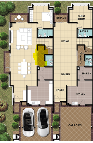

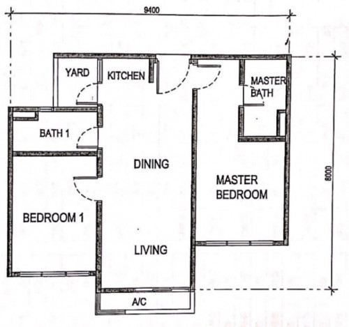

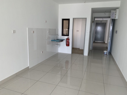

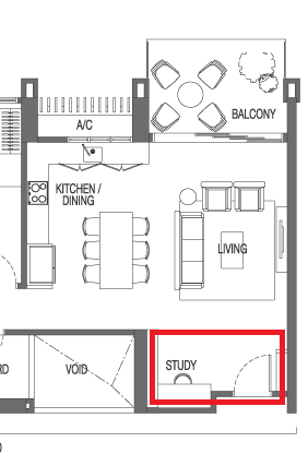

Hi - I have a small area beside my living area which is currently not utilised. I’m thinking of putting like a folding wall wif door there so it will be converted into a small room. Reason for folding walls is so if we hv large gathering or I need the extra space, cn fold it to open up the space. Any design ideas or tips for this?

QUOTE(drbionicle @ Jun 15 2020, 06:50 AM)

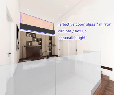

First of all, I think if you wish to have an option to open up the small room occasionally for large gathering, I will suggest you consider hacking partially upper part of the wall between the living and the small room. As the solid wall has block the visual connection between the 2 areas.
Then do a new sliding or fix glass window above 1 meter, this will help to indirectly merge the 2 areas into one so people on both sides can see other others.
As for folding door you can opt for 2 folding glass doors on each sides as shown below:
drbionicle
post Jun 16 2020, 12:33 PM
35 posts
Joined: Nov 2009
Thank you Sir. I asked neighbors bout the wall n some said their contractors told them not to touch it. Will chk further n ask my contractor later. Thanks for ur advise.
QUOTE(ehwee @ Jun 15 2020, 06:50 PM)

post Jun 16 2020, 02:33 PM
1,519 posts

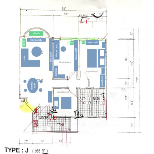

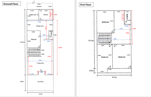

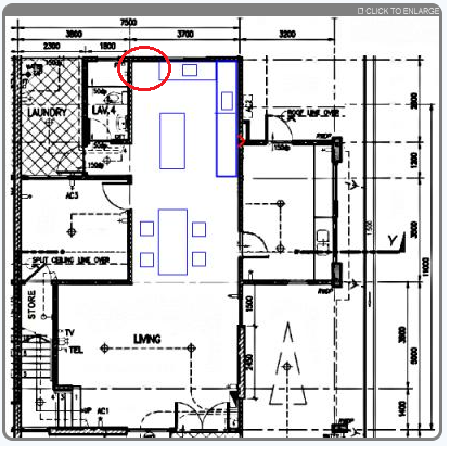

Original
My own plan
If I were you, I will take some space from the toilet and move the wall separating the kitchen and the toilet few cm so that you have about 1 ft space there. Then you can buy a 30cm depth cabinet and put there to be used as pantry.

QUOTE(drbionicle @ Jun 16 2020, 12:33 PM)
It shouldn't be a problem to open a window hole on existing brick wall as long as you didn't touch the columns and beams.
Unless it is a load bearing wall that you can find out from the building management.

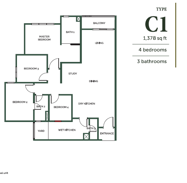

HI Ehwee,

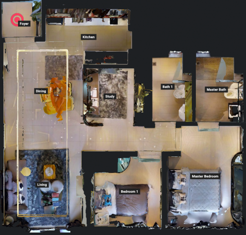

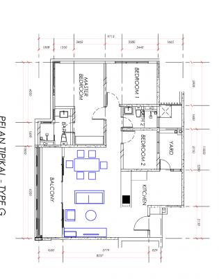

I wonder is it wrong to have dark grey theme for condo unit 1300sqf with 10' ceiling (after plaster)?
Is it not common for most ID do handle this kind of design theme? Please Correct me if i'm wrong so i can learn something new while looking for an ID for this job.
And i really like this kinda of color theme - Dark + Light Grey + Wood + Concrete surface - with right lightings and furniture for it.
1. 4 Bedrooms - 1 going to convert to 2 person 1 table workroom with bookshelf and cabinet.
2. 3 Baths - 1 going to convert to non full length stand alone bathtub.
3. A long living hall to fit 6 person dining table behind sofa.
4. U shape open kitchen. (Beside living hall).

Yes the RM 3.30 / sqft is for flat plaster ceiling only without L box and ceiling painting.
The quotations you received looks OK generally , as it's depend on the actual discussion and design requirements you ask from the contractor.

QUOTE(alexloon @ Jul 7 2020, 03:05 PM)
HI Ehwee,
There is no right or wrong on having dark theme for small condo. Ultimately it's still a personal preference, if you really like cozy, warm living environments, you can definitely choose to have dark painted wall, black tile, grey sofa and warm timber dining table and some nice spot and wall lights.
Dark theme is nice also as long as you comfortable with it. Especially in city region, a dark and cozy home can make us feel more stress free and calm down after coming back home from daily fast and competitive working day!
Most people still prefer bright environment due to several reasons. Examples, bright lighting environment for safer if you are living with older parents. Study and kitchen area are better and workable in brighter light condition. Toilet try avoiding dark environment due to slippy floor and safety.
Other than these places, by all means you can opt for dark theme for living, dining and bedrooms.
Your attached dark theme pictures with warm timber flooring look good, hahaha👋

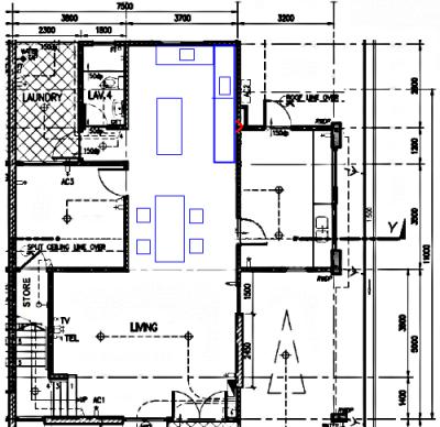

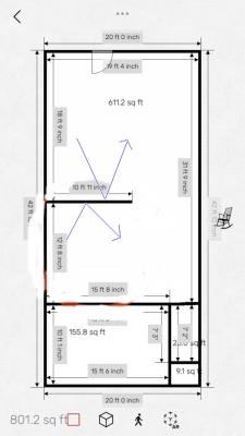

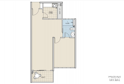

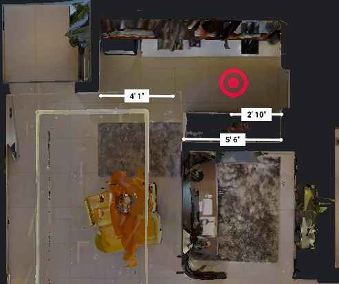

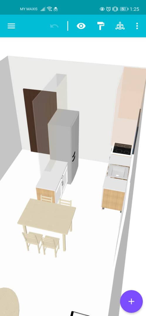

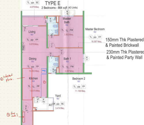

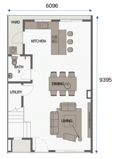

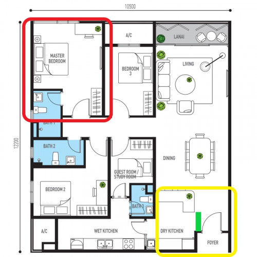

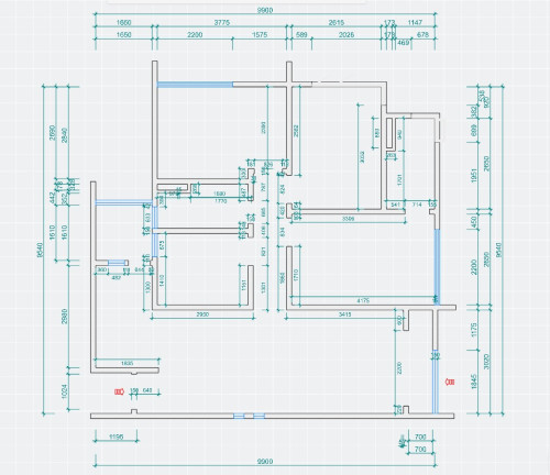

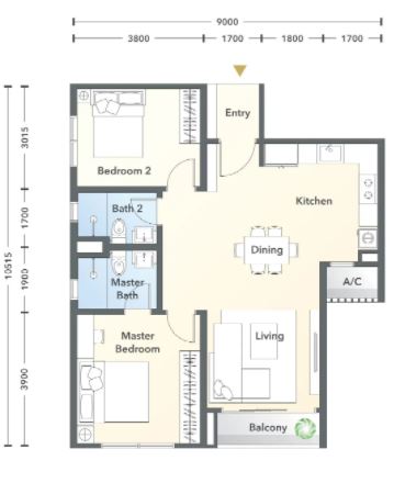

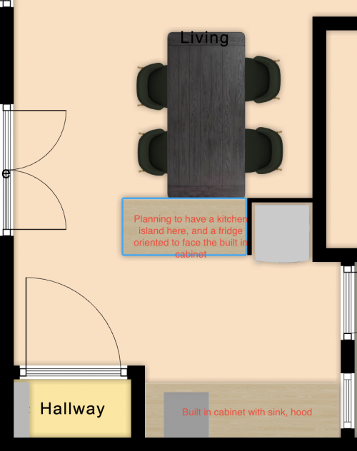

Hi, I hope the question I'm asking is allowed in this thread.
In the layout below, I have trouble trying to arrange my kitchen layout. I do not wish to separate out my kitchen to dry and wet. And here are the spaces/items required:
1) Cooking hob
2) Kitchen sink (1 part large OR 1 part medium w/ 1 part small)
3) Food preparation place (Chop chop chop)
4) Fridge
5) Rice cooker (cannot beside cooking hob to prevent it from being oily
6) Dining table for 5
So I would really appreciate if sifu can give some advice and input on how to arrange all these in the kitchen (maybe can take 1 row (2ft) from dining room and dining table in dining room.

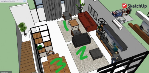

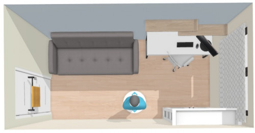

ehwee When i'm doing some drafting on art board, i do realized lighting, furniture color and decoration on wall are critical (for dark theme) and i stop there for half day staring at it... i guess this is where ID should come in and do the magic. Showroom unit and bare unit are 2 different world, it just a walls but is complicated dimensions and now i understand why ID like to put wallpaper, because it make thing easier - which i don't prefer.
When i'm looking for an ID - I do intent to see what items they selected to put on displayed or used in the room (size, color and texture) no matter in 3D or showroom because it does take effect to show what is the taste of the ID in client/visitor eyes. < Anyway, tht's all i know how to look for an ID.... laugh.gif
This is an example work i've done to plan the theme as house owner. Thanks for your time to reply and advice. Cheers~

QUOTE(CasualMax @ Jul 10 2020, 12:36 AM)
1) Cooking hob
4) Fridge
Hmm, most common arrangement for most people will make the yard into cooking area so you will have more working space at kitchen area, something like this.
Yet if you want something different and don't mind little bit of small walkway around the area as a result, this is what I suggest you can consider.
Cheers!
alexloon you can consider make one of the wall timber feature wall, paint the ceiling in slighting darker grey colour, it will look even better, don't you think so??

QUOTE(ehwee @ Jul 10 2020, 06:40 PM)
Cheers!
Thank you so much for your idea and suggestion! Actually I'm looking for layout without using yard as kitchen, but I can imagine some layout using your suggestion with just placing kitchen stove somewhere in the kitchen area instead of yard. Thanks again!

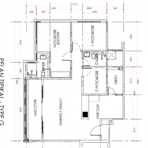

Any suggestion on the living room TV placement? Red wall in attachment is new extension wall. Suppose TV location is on the left side wall going in from main door. but due to feng shui issue, sofas not able to put in the middle of the living room cos sofas backside facing main door.

QUOTE(chaics85 @ Aug 1 2020, 12:26 PM)
Do you seek fungshui Master help on position of TV, some master might indicate specific position for tv also.
If the master said your sofa back cannot facing main door, that means your sofa have to position in a way facing the main door.
That mean the tv have to either put at middle of living area or put at the front of the sliding glass door next the entrance.
May be you can seek master advice whether there is a possibility to shift the main door from right to left side. This way might help you to get a better orientation and position for tv and living sofa arrangement.
This post has been edited by ehwee: Aug 1 2020, 05:48 PM

I dont do extensions. But will do hacking on the dining area. Tend to remove the wall and do open kitchen concept, want to have island in the dry kitchen. Im worried the hacking work will b expensive.

Hi ehwee,

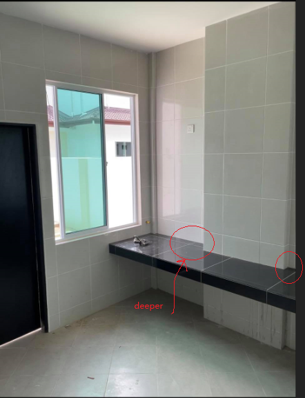

May i ask for advices, i am on tight budget for 40k.
1) i am doing plaster ceiling from living, dining and walkway. I have been quote from rm6k to rm11k.
Which price is right? Without those hidden charge. I send them the same sample pictures.
My ground floor.
Design
2)from picture how can i arrange/add my kitchen cabinet to be an excited place.
3)what is you estimate best tight budget for garden room. Any suggestions?
Thankyou.
I am aware of costing budget discussion.
I do not know if the budget is enough. I am preparing to move in next year.
This post has been edited by ikram_p: Aug 1 2020, 10:28 PM

Please advice on the lighting option for concrete ceiling.
Not planning to do plaster ceiling as we like high ceiling layout. But Most of the wall mounted lights are ugly.
There is a beam dividing dining n living hall area. Is it possible to just install L box without plaster ceiling? Would it help to brighten the living hall?
Hacking internal wall for open kitchen won't be so expensive, just make sure you allow contingency costs for relocation of existing and new electrical wiring and plumbing piping anyway.

QUOTE(ikram_p @ Aug 1 2020, 10:24 PM)
Hi ehwee,
My ground floor.
Design
Thankyou.
6 to 11k just for ceiling on the areas you mentioned seems quite high, not sure about what kind of ceiling and lighting trough design you have, it will affect the cost also.
Do share more about what you need for kitchen and your usual daily work routines in the kitchen, then I can only made some design suggestions for you, pals.
This post has been edited by ehwee: Aug 6 2020, 07:02 PM

QUOTE(cristiano7mu @ Aug 2 2020, 01:44 AM)
If you OK with expose light tracking then you can definitely do a good lighting settings without plaster ceiling.
Yes L box along the wall can be a simple solution, yet you will need many nos of wall flooding lights to get the desired interior brightness you want.
Why not upload some existing photos for your home here so we can figure some igbting setups ideas for you, as different beam structure and position might affect the the way how we can arrange a lighting option for expose ceiling.

This is the layout

QUOTE(cristiano7mu @ Aug 4 2020, 09:49 PM)
This is the layout
Sorry for the delay, quite busy recently.
If you prefer not to have plaster ceiling, then having L box along the dining walls and using track lightings at living area can be a good option.
Can considering having ceiling fan that come with LED light build in too.
This post has been edited by ehwee: Aug 6 2020, 07:03 PM

QUOTE(ehwee @ Aug 7 2020, 11:24 AM)
What are the type of ceiling you prefer actually, there is no best material I would say, it's more to practical vs design vs budget.
L block with design like this. I saw in facebook, i do not know what material they use.
Doesnt crumble easily, long lasting. Thank you

Hi Ehwee, can you give advice regarding the staircase for a mezzanine floor (highlighted in red) in a 1300sf condo?
- position of staircase
- suggestions of the types of space saving staircase that is also safe for children and elderly
Thank you.

this is WPC composite paneling, it is 10x expensive than plaster ceiling, mostly people use this at exterior as it has more water and colour fading resistance character.
you are using this for internal ceiling that's your ceiling cost is high.

10x than normal price... Well theres goes my dream. Back to classic L shape. At least i know the names.

Hi Ehwee,
Trying to get some idea to fit this type of layout. Masterbed room wall is one of the issue to put the cupboard.
Any idea to input? I plan to do plaster ceiling for hall as well,
