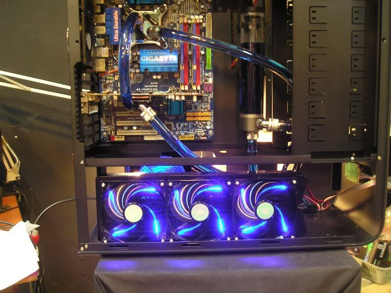

have a look at Here.
home theater liquid cooling system by TT...

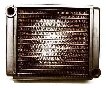

QUOTE(kelvin_hata @ Jul 27 2005, 11:58 AM)
[img]
5*120mm fan
Man. That has got to b the biggest rad around. N it looks damn good too. Imagine that rad with a big pump n the Storm block.

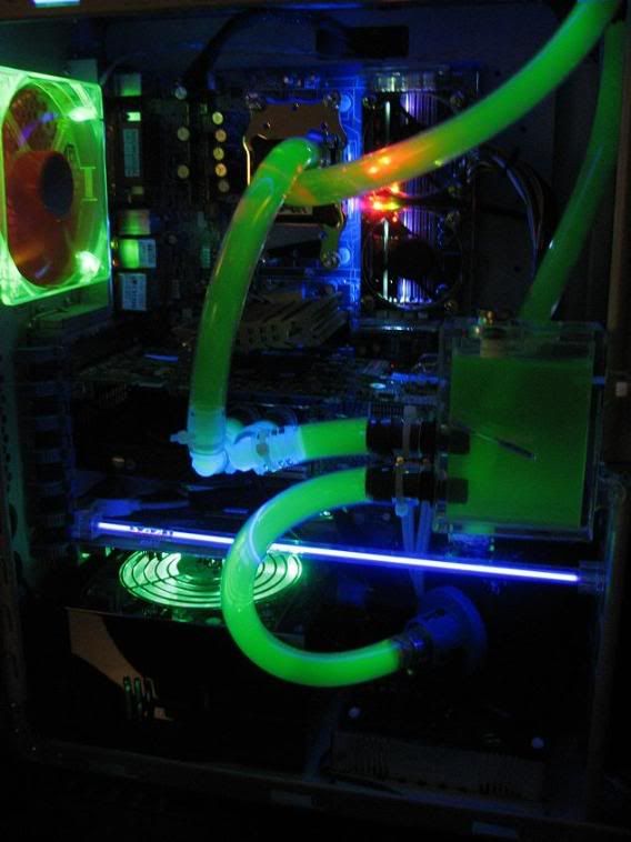

5*120mm fan
OMG this design is so stupid, waste so much of the pressure on goin against the gravity.

QUOTE(AllnGap @ Jul 27 2005, 09:45 PM)
But if the inflow to the rad is from the top, wouldn't that create high pressure outflow at the bottom ? unsure.gif

QUOTE(QUDERN @ Jul 27 2005, 09:47 PM)
both of the inlet and outlet is from the bottom which means it'll still loose pressure to the gravity.
instead of goin vertical, why not go horizontal ?
i think thermaltake is try to sell overrated products again.

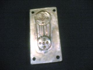

fulamak very dahsyat one waterblock for nvidia 6XXX cards..made of silver n only 3 of it..call it octopus..
saw this in other forum..
http://www.devilmaster.org/modules.php?nam...order=0&thold=0

QUOTE(PowerSlide @ Aug 2 2005, 06:02 PM)
http://www.devilmaster.org/modules.php?nam...order=0&thold=0[/url]
Phuiyoooh. Very nice work of art. But it's a very scary thought with all those joints thereby increasing the chances of leakage. I'm sooooo paranoid of leaks now I'm even thinking of going back to air cooling for good. laugh.gif laugh.gif laugh.gif

I can imagine the massive restrictions interms of flow rates that block is gonna cause in any loop and plus the fact WC'ing the RAM's aren't worth it in the 1st place since DDR3's are relatively cool running

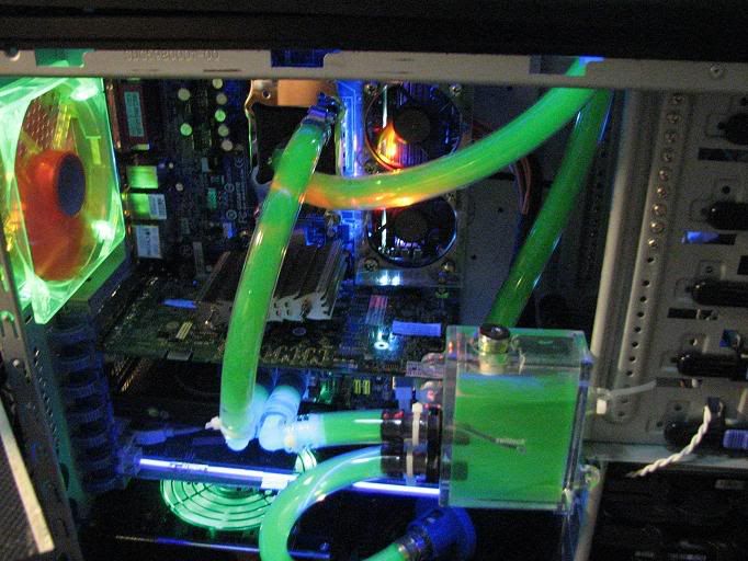

Lookie what I found here. Can you guess what's that installed?
uzairi
post Aug 9 2005, 02:11 PM
Team almostthere
6,744 posts
From: World Wide Web Status: Banned
Who's Storm Mr Sargeant?

QUOTE(almostthere @ Aug 8 2005, 07:25 AM)
Blardy tempting.

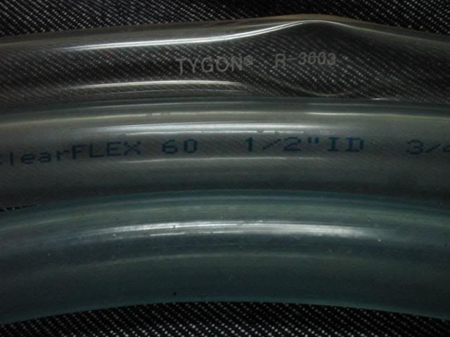

QUOTE(almostthere @ Aug 11 2005, 10:03 PM)
Not to mention all these custom made systems are of 1/2 OD/ID which is still the recommended size compared to Tt's 3/8"
The TT Airbesar is not even running 3/8 ID hose man. The hose is thin like a pencil.

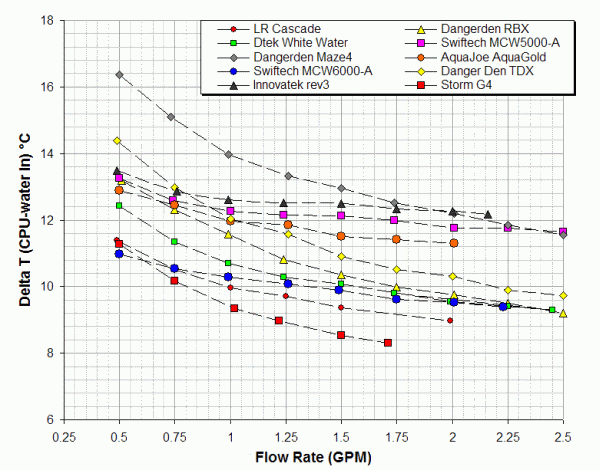

And ianho, I'd suggest you have a look at these charts

QUOTE(almostthere @ Aug 14 2005, 06:00 PM)
Ok, I'm corrected over that matter. And yes, 3/8" not bad also. In fact the Europeans prefer to use that as it's a good compromise between flow rate restriction and airflow restriction if based on what I've seen so far actually. However, Cathar in Xtreme has recommended a new type of tubing which I'm not pretty clear about which is about 3/8" ID but has some property's similiar to TYgon's and has rather a smooth inner wall surface. But I'd bet that sort of tubing would cost a bomb
From this chart, the Eheim 1048 flows the same 94gph as the MCP350 though the Eheim pumps a lot more in free flow. Y? Coz of less Qmax?

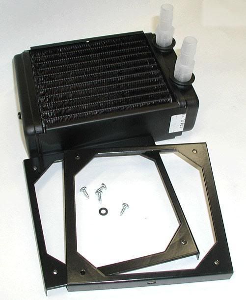

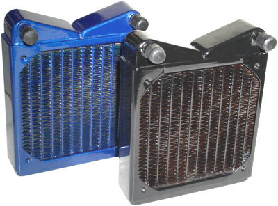

to those who might be interested.... uglyvamp is starting to bring in some H2o stuff....
sneak peek: http://www.vampzone.com/forum/viewtopic.php?t=181
TJye
post Sep 4 2005, 02:43 PM
277 posts
From: SJ
I see that the preview pic of the tripple rad from the link is of a single pass type..... looks promising...

Coolwave 120.2
almostthere

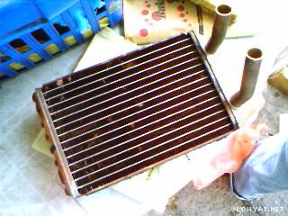

the dd heatcore is costing me more than that and now the DD bulk got tax and a very long delay.....

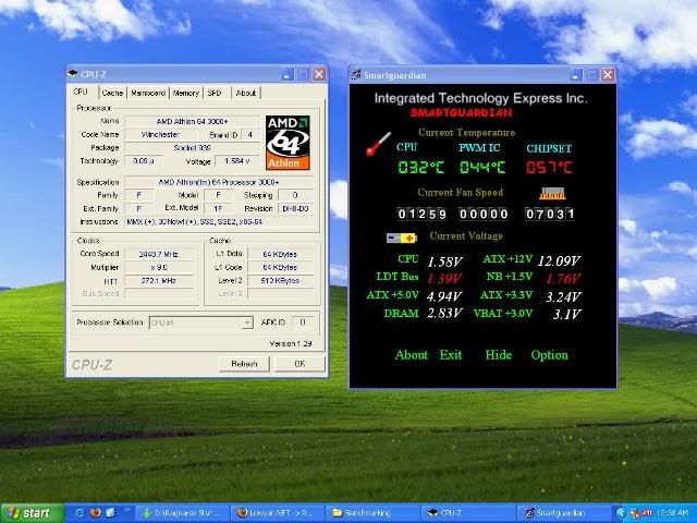

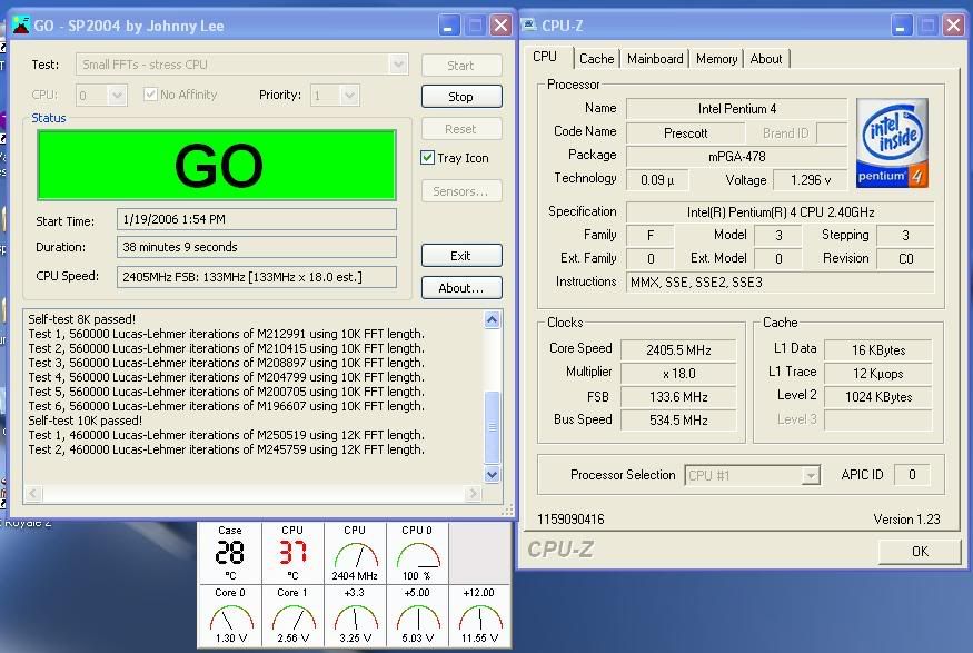

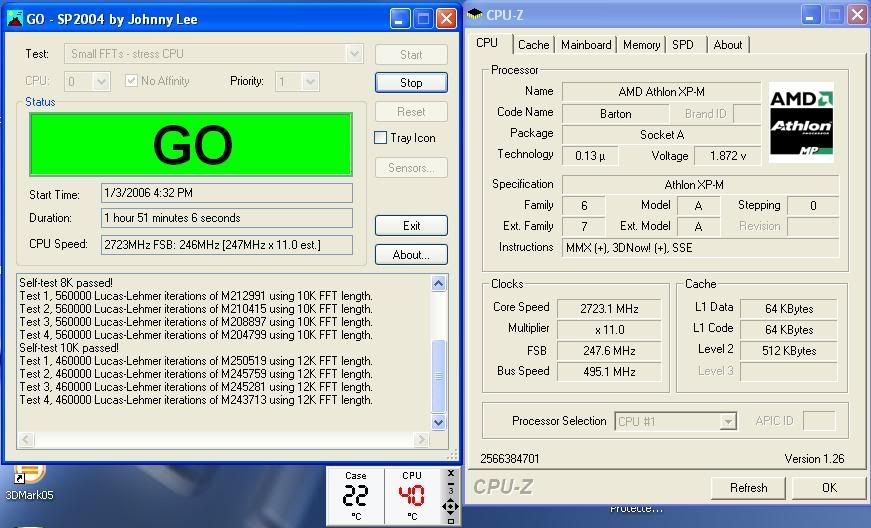

hey guy....juz finish install my whole WC .... MCW6000-64+DD Maze4 Chrome+sanso PMD 311(same spec wif IWAKI R20LT on pressure and flowrate)+Allngap's homemade dual 12cm fan radiator...tat pump coz me so much..japan's pump seems expensive than others...
spec:-
amd clawhammer 512k 3500+ stepping caa2c 0505 ???? forgot
ATI Radeon X800XL
overclock my proc to 2.7ghz@1.6v....VGA keep stock speed
idle temp is 37-38 and full load is 44c while VGA is 37-38 and full load is 40-41C
my temp izit ok??
HolyAk
post Sep 13 2005, 01:27 PM
SR20VE Powa !
1,471 posts
From: "Kap Dong"
26L per min flowrate and 3.5m head pressure seems good,heat dump is 20watt ... but the pump's housing is so hot...magnetic pump seems hot then chapalang water from aquarium shop tat i bought b4

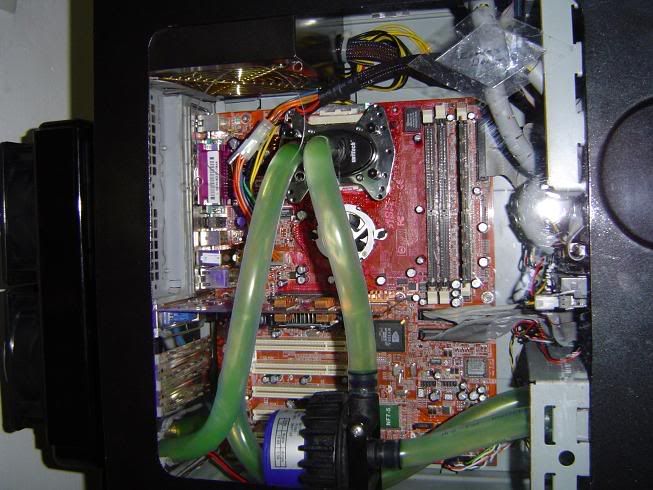

I'm in now...juz fixed my 'wc setup'...i'm on big water from TT...hihihi..el chepo stuff....
but i noticed there is only slight diffrence compare to my hyper 6....but nevermind...it looks cool at nite....UV....

my rig is a mess...pm PCcrazy for details...he know how is the 'inside look' laugh.gif laugh.gif tongue.gif
by the way i'm running the pump on Pwm connector so i can totally switch off the pump when i dun wan to be cool...any problems later if i do that or not???i notce temp increase...Thats great!!!...why u may ask???bcoz i know that actually it workss.... thumbup.gif thumbup.gif
i'm looking forward for VGA and northbridge for my rig...but i will built it through the highway and not those 'jalan2' kampung..playing wif a couple more pumps and add resevoir.....hihihihi...

You want to know why temps increase?It's cos the pump is only working around 7v instead of the full 12v voltage it needs for max efficiency. And for Bigwater, I'd not recommend going major and using it to cool the VGA and the NB too at the moment as the pump has barely enough flow and head pressure to even cope with those stresses

AFAIK, the so called copper is actually a mixture of copper and brass, because brass is so much cheaper than copper. wink.gif
brass is material used in our piping system, like water taps.
i'm not sure about DD's rads thou.
DD' s rad are usually more often then not HWLab's OEM units AFAIK.

brass is a bit yellowish compared to copper. so they look alike.
i dunt think that Coolwave rads are really " copper "
coz if i were the manufacturer, i wont use pure copper also

hihihi...thats why i sengaja put the pump running 1/2 power...to see if any temp changes...just wanna confirm that the water cooling system actually works...
if i would cool down my VGA and NB, i would afix one more kit....and maybe i connect it like this:
resevoir -> pump 1 -> cpu block -> radiator 1 -> pump 2 -> Vga block -> NB -> radiator 2 -> resevoir.... how otai2??? can ahh???

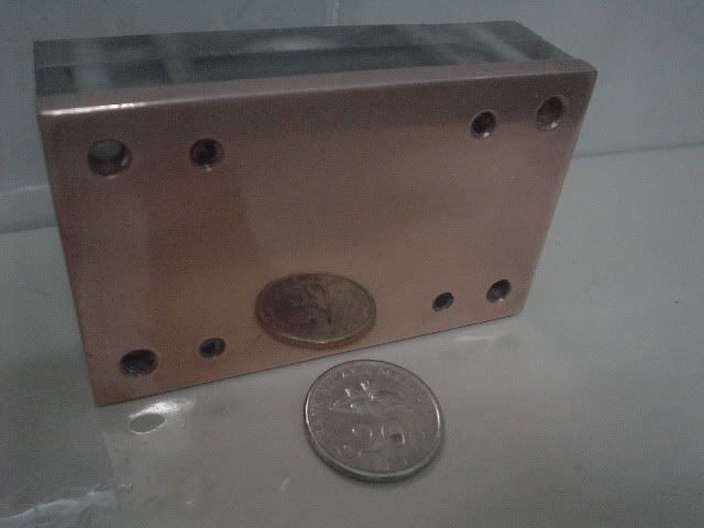

I dunno where to get copper rods or copper blocks
as for milling probably can ask the lab asistance to help abit on it
maybe buy him tea.
I can also do the milling at my uni's machine shop but finding the bars would be the problem (Can amok step in here?). Tapping I'm not sure but once one can obtain those brass barbs it shouldn't be hard to tap the holes. But since it'll be in copper, how to anodise it so it won't oxidise eh?
TJye
post Sep 15 2005, 11:21 PM
277 posts
From: SJ
no idea on anodizing
I go and ask the lab asistance tomorrow on where he get the copper bars or blocks
The tapping can be done I know the lab got tools for this stuff
i've used some of them before

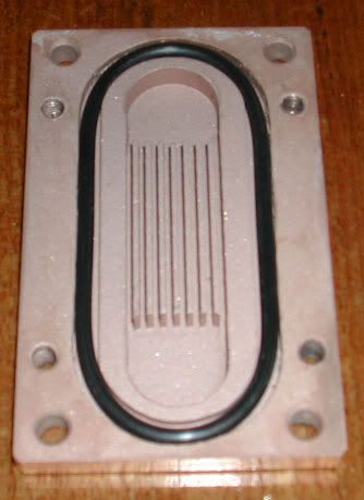

One thing I don't understand is that
what are them using to provide a water tight seal between the 2 peice?
i only see o rings on the barb
This post has been edited by TJye: Sep 15 2005, 11:22 PM
almostthere
post Sep 15 2005, 11:23 PM
Kepala abah ko
VIP
3,773 posts
From: Anywhere lah...as long got Kopi-O
QUOTE(TJye @ Sep 15 2005, 11:21 PM)
I see him milling alot of stuff before
What 2 pieces? I don't get you actually. But if you can fabricate em, mind sharing us a few since one would have to get the rods by the meter and you would have spare lenght. I won't mind paying a bit extra for the effort.
TJye
post Sep 15 2005, 11:26 PM
277 posts
From: SJ
I go and ask and we would share the cost?
no problem on that since we are felow wc enthusiat
The 2 piece is the pic of the inline heat exchanger
the rod would open up into 2 piece? or it was disected by the reviewer?
I was asking if it can be open
how to make it water tight?
almostthere
post Sep 15 2005, 11:29 PM
Kepala abah ko
VIP
3,773 posts
QUOTE(TJye @ Sep 15 2005, 11:26 PM)
It's dissected for us to see how it looks like. Don't worry about that. No way one can make a cross section piece water tight unless there's a washer along the length and a lock nut to secure both ends.

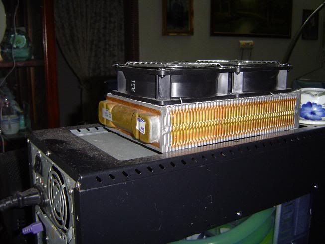

just finish took some pictures of the Vantec Stingray ..
haven tested it yet

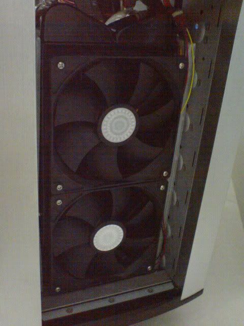

after testing...and testing/...and testing...i found out my max reached temp with this kit is 52c for full load....at 1.625v that is quite medium high i guess....how do i manage the connections in terms of making the water flow much better (quicker)...read at almosthere wc guide i notice he said try to make it shorter...
or do i need to lap the waterblock juz to earn another couple of celsius??? whistling.gif
PeowYong
post Sep 27 2005, 09:21 PM
PeowYong
2,263 posts
From: MMU Cyberjaya, Sandakan
r u using all the tubing that come with the kit?
try to cut the tube shorter so that its just long enough to connect to waterblock, pump and radiator...
no need to lap the waterblock as the waterblock is quite nicely lapped...
lapping it would help but i dont think u will earn another couple of celsius....
1 more thing, installing the rad inside the casing will be better cause the tube can be shorten more...

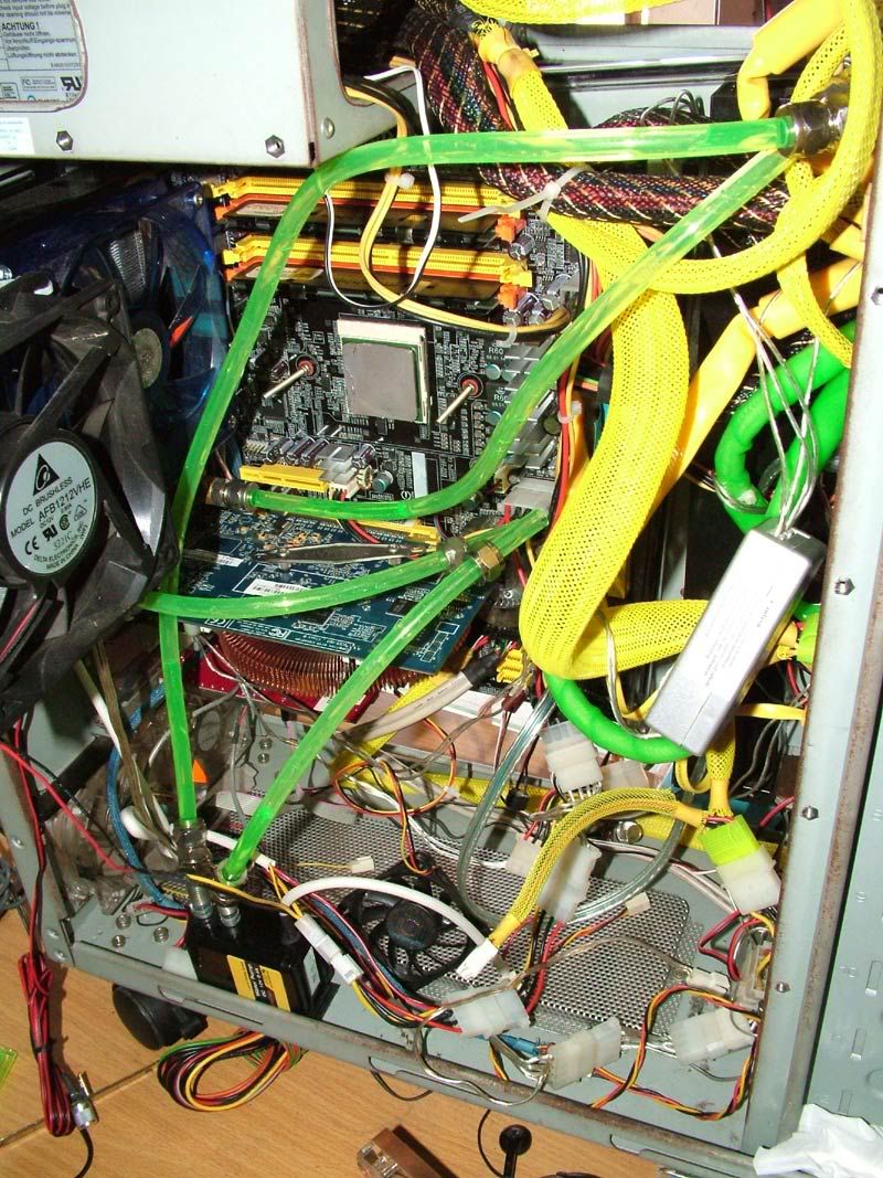

QUOTE(PeowYong @ Sep 27 2005, 09:21 PM)

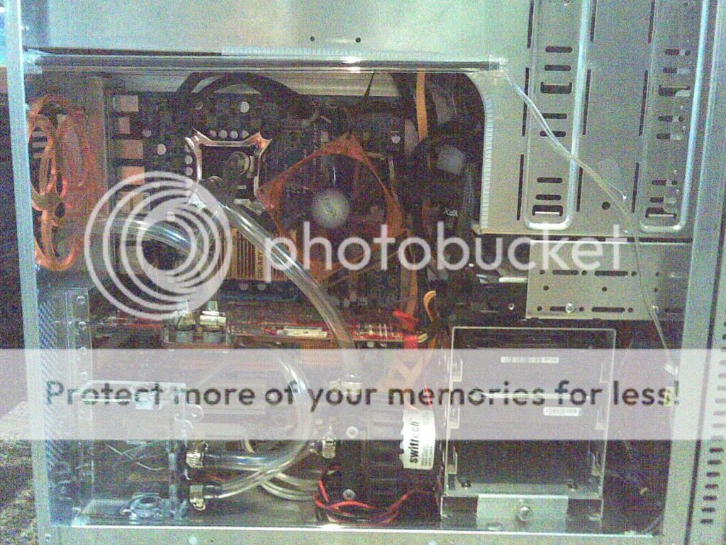

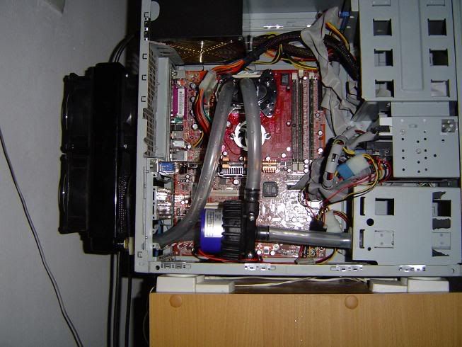

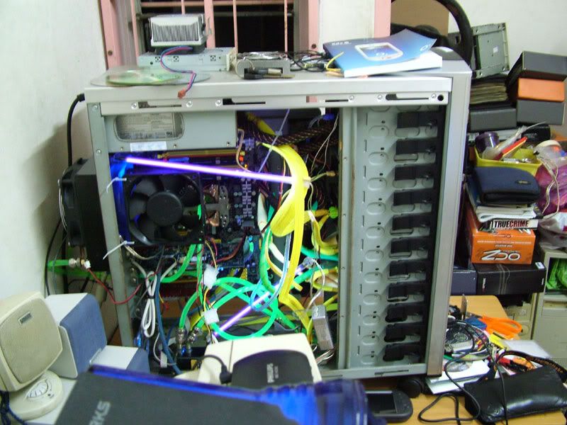

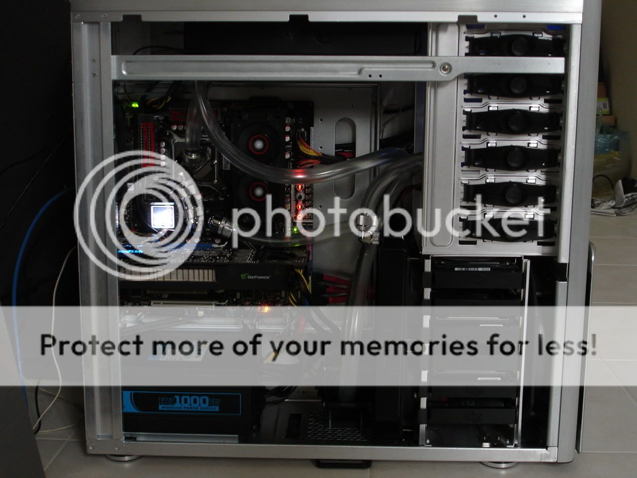

My new setup....
Water block which is decided to open up just now and went for a lil bit of grinding... sweat.gif flex.gif
This post has been edited by antonio_zth: Sep 28 2005, 02:57 PM

Erkkk...bant anotnio....rimas gua tengok PC ko nih...huhhuuh
Anyway if temps don't improve, try converting the Stacker to Semi-BTX which means you flip the whole motherboard pan 180 degrees so that the processor and the radiator kat bawah. That way the pump is very close to the block. You might gain a lot in terms of pressure to supply to the bloock. It's quite easy to do. Just need to unscrew about 12 screws at the motherboard pan's base. IF tak fit flush, just saw the crossmember besi just below the upper PSU slot and it'll fit just nice and won't be noticeable as it will be concealed by the PSU backpanel of the stacker.
And CM punya UV fan? Mak aih, that fan very low cfm laa wei. Dah laaa rad Tt tuh very restrictive. Get that delta I see on the left fitted on instead, sure tak rugi wan

Read that already and as the charts show and Cathar himself has repeated many times, The Aquaxtreme 50Z-DC12 (not 150Z, heat dump too muchand who needs 6m head pressure?) still remains the top dog in terms of performance per heat dump by far as they also included that as a side comparison. After all, it's a Laing MCP600 in the first place

QUOTE(almostthere @ Sep 28 2005, 03:05 PM)
Erkkk...bant anotnio....rima gua tengok PC ko nih...huhhuuh
Anyway if temps don't imporve, try converting the Stacker to Semi-BTX which means you flip the whole motherboard pan 180 degrees so that the processor and the radiator kat bawah. That way the pump is very close to the block. You might gain a lot in terms of pressure to supply to the bloock. It's quite easy to do. Just need to unscrew about 12 screws at the motherboard pan's base. IF tak fit flush, just saw the crossmember besi just below the upper PSU slot and it'll fit just nice and won't be noticeable as it will be concealed by the PSU backpanel of the stacker.
about flipping over aku try last time but something is stuck when i wanted to screw all back together...then i cancelled my intentions and use back ori ATX style...
about the fan i'm still waiting for paycheck then only buy another Delta...the one u saw i for my PWM and Chipset area cooling...which is a must when u run + 0.2v on cpu and 0.1v on the chipset.... thumbup.gif of course la the CM Uv not enuff grunt to blow the radiator laugh.gif ....infront of the rad got the TT fan...so the rad now is sandwiched between 2 slowmo fans.....
i didnt had time to test the temp juz now since not enuff time have to go back office (boss panggil)....maybe tonite try again see got diffrence after lapping or not... laugh.gif
I kno it's will be stuck w/out some modifcation. You have to use a hacksaw and saw off the crossmember just below th PSU hole kat belakang. Then it'll fit flush. Trust me antonio, been there, done that and living with it proudly

erm... antonio_zth, u might wanna try arrange ur cable nicely... the air cant seem to ventilate or move well inside...
antonio
post Sep 28 2005, 07:19 PM
AMD Phenom II & Intel i7 Overclocker
VIP
4,032 posts
From: MSR Headquaters
QUOTE(PeowYong @ Sep 28 2005, 04:09 PM)

haha....antonio_zth rigs will be always known for it's 'lot'za cables' there...hehe just like pak sniper 'GOT NOS' rig....hehe

Antonio. have u ever noticed any improvements in fan stacking? i tried once before one CM aluminium pushing and the TT fan pulling. maybe i got 1 degree diff at the usual fan speed i use. but that could be because of normal flux in temp.
i buy another rad from moderno and well got a 3-4 degree drop and i run fans much slower now. heh happy camper here.
reading from aerogate2 probe as close as possible to the core and with a wad of as5 on it. typical temp now are 10 degrees above ambient (from thermometer on table) during idle, which used to be 13 about.
post temps after ur lapping man. i also curious. the block look ok to me so i lazy to lap it .
I'm still looking for the info on fans stacking coz i heard it is not good....since a hair dryer is using the same concept so it mean it is not advidceable to do so...But i run the suck fan (which is the bundled TT Fan) on very slow rpm...Ive switched the Delta for pushing cool air....
After all the lapping+Delta rearrange+Cable/tubes rearrange i got a low 2c from 53 which is now 51c on full load.....ok lar considered kan....mebbe add another radiator should lower the temps more.,...
