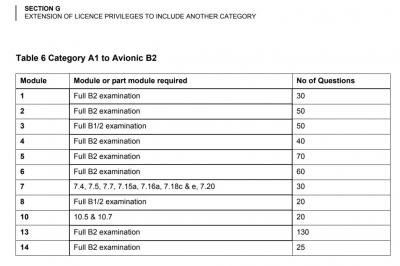

For Bcar, please read the following and download and understand both AN5 - Application For Malaysian Aircaft Maintenance Engineers Licence and AN85 - Approval Of Training Organisations
Extracts from BCAR Section L. Please read and understand the whole requirements.
