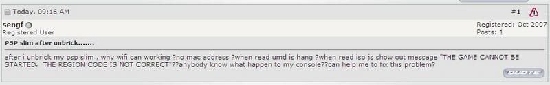

Hi, one of my fren bought his psp slim and brick it on the same day without knowing it.
May i know what is the caused of it because i do not want to repeat his steps.
He bought in the morning. Test ok before back home. When back at his house, he try to turn on the psp. Power green light up for 5 to 10 sec. No display on screen and finally power lights off. I was with my fren when he bought it. No Drop, No firmware flash, and No loading of any games.
I was shock to see this.
I think i saw a post where someone is selling off a brick white psp slim in lyn too. The reason, install theme is the caused. Will it be the same reason where my fren's psp are also having the same fate?
thx

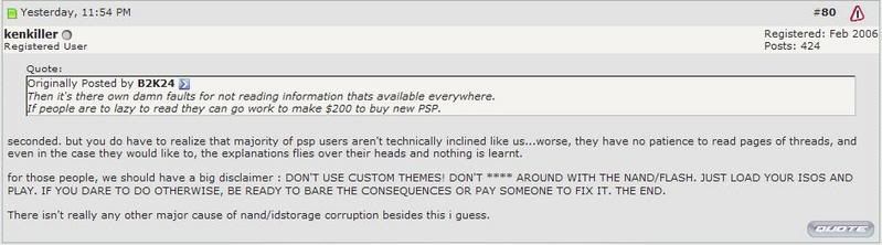

There's a bug actually in 3.71 M33 corrupting the nand flash if you try to write to it via usb connection. Normally people who wanted to mod their themes will try to access the flash0 folder to copy the files there via usb. This bug is due to SONY's new protection scheme on the slims...hahahaha way to go SONY. rclxms.gif
Have you ever heard of nand or idstorage corruption on the old fat? The answer is no. The easiest way to backup your nand flash is by using a Pandora Battery and DA's DC v3. The backup will be named as nand-dump.bin into your MS. It will backup all 4096 blocks of the 64M nand flash.
I've already backup mine thumbup.gif ...how about you guys? Better safe than later crying here to get help.

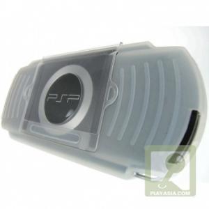

would you guys recommend silicone or crystal?

I'm using a silicone protector. Tried the crystal case but really don't like it seems it becomes a bit heavier...

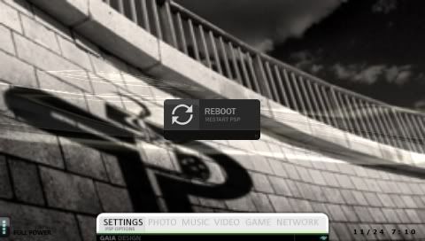

1.how bout changing the theme on 3.71 M33? there is a theme setting where noobs like me can change the theme easily.
2. U mean transfering theme file to Flash 1 folder > VSH > theme will also brick the slims?
I'm having one slim but scare to touch the theme setting after my frens incident. Already into 3.71 M33 ...did not manage to get my nand flash? am i still able to get it?

QUOTE(ben5173 @ Oct 22 2007, 03:41 PM)
As long as you don't touch flash0falsh1 via usb you are safe. You still can make backup of your nand flash even though you already updated to 3.71 M33. The most important is to backup the nand flash while it is still in a working condition no matter on what FW you're on. I did mine on 3.71 M33-2 CFW.

Added on October 24, 2007, 10:34 am
One example what I've been talking about. See that nick..he's a forumer here too.
This post has been edited by tot31: Oct 24 2007, 10:36 AM
bububang
post Oct 24 2007, 10:42 AM
1,739 posts
Joined: Jun 2005
QUOTE(tot31 @ Oct 24 2007, 10:19 AM)
I really doubt it. Yes you can unbrick but after that no wifi, no umd acces and no games. Only can play mp3/mp4. Why don't you try it to prove me wrong. Got balls?
so basically its still the same.. cant fully utilise it for full brick after unbrick using another nand dump..

and this what you can do with your slim if you're screwed

Agree... thumbup.gif I can say 90% of the problem are from those ignorant users. Most of them are the noobies. They tend to think that they know everything without doing a proper research. ooops..i talk too much...hahahaha....

QUOTE(ben5173 @ Oct 26 2007, 02:58 PM)
i guess so. anyway, no one gonna believe that so to prevent mine  brows.gif  from having the same fate. I stop using the custom theme function temporary.  biggrin.gif
Well..i did ask lots of ppl, all of them blame us for flashing the unit. i do not have the expertise to flash. I owned a fat psp before with the same firmware starting from the day i bought it even if there are newer version, i dun care as long as i can play games with it.
when people don't know..... they guess and blame others. Kinda normal practice already biggrin.gif

QUOTE(ticke @ Oct 26 2007, 02:08 PM)
yeah right like the users did nothing....things don't go haywire for nothing u know...
QUOTE(tot31 @ Oct 26 2007, 02:12 PM)
*nagging mode ON*
I would like to disagree with both of you on this issue. I'm not saying that all problems are caused by the users instead of the console. But I am one of the 10% who care about their PSP more than their life. I bought my PSP from Bernard after seeing lots of good opinions on him. But ever since I bought the PSP from him, I've not been a happy customer.

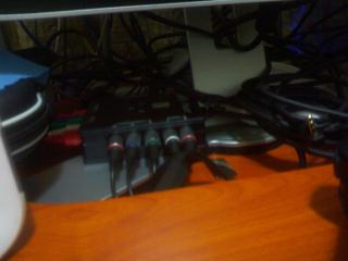

msn83235502
post Oct 28 2007, 01:12 PM
ผู้นิยม
2,862 posts
From: アメリカ
QUOTE(QD_buyer @ Oct 28 2007, 01:10 PM)
Actually I dunno what composite/component only know VGA.. sorry me noob zai.  laugh.gif
My TV is just Flat screen panasonic TV(not LCD) so need to buy what ah? biggrin.gif
composite is the red yellow white cable..
component is the red green blue..
i hope u know vga...
just check at ur tv it got which lobang
if not google may helps u a lot.
This post has been edited by msn83235502: Oct 28 2007, 01:12 PM

iZuDeeN
post Oct 28 2007, 08:35 PM
3,466 posts
From: PJ, Malaysia
anyone know where else to get the silicon skin or crystal case?
in digital mall rm28...

QUOTE(iZuDeeN @ Oct 28 2007, 08:35 PM)
which one is better, crystal or silicon?
Hmm.. For crystal case, I've heard some bad things about it: scratches. But then again, that's for the Phat (old) PSP, ages ago. Not too sure about the latest generations of crystal casings.

bought crystal case for PSP Slim yesterday at sungeiwang for only RM15..
its very good...i like it...

post Nov 2 2007, 12:26 PM
1,739 posts
Joined: Jun 2005
Source
teikwing
post Nov 2 2007, 05:07 PM
Dah Macan?
3,239 posts
Joined: Oct 2006
From: Sydney, NSW
QUOTE(bububang @ Nov 2 2007, 12:26 PM)
Source
is this the same thing? it's kinda cheap. only RM16.79. just ordered one btw. smile.gif
Play-Asia.com : Ultra Slim Guard
This post has been edited by teikwing: Nov 2 2007, 05:09 PM

QUOTE(teikwing @ Nov 2 2007, 05:07 PM)
This post has been edited by bububang: Nov 2 2007, 07:25 PM
Bro, rm17 including postage ?
Cheap ah!

QUOTE(bububang @ Nov 2 2007, 07:24 PM)
QUOTE(waif @ Nov 2 2007, 11:53 PM)
Cheap ah!
One of the store trying to sell me rm60 ~!
yup. it's a silicone case. but the UMD door there is exposed. there's another type one which is around RM50, but it's for phat PSP.
Play-Asia.com : Soft Jacket
which one is the store selling? RM17 is a steal actually. haven't seen one so cheap in local stores yet. biggrin.gif
This post has been edited by teikwing: Nov 3 2007, 12:36 AM

@taeru
First, you must understand the concept of Bricking.
Bricking happens when you mess with the system files in the flash0 folder of the psp. When the files there aren't placed properly or replaced with different(and often) unusable or wrong version files, the PSP will brick. This is because when you start up the PSP, the machine is unable to read the files properly thus, not being able to start it up at all, that is what we call a BRICKed psp.
(of course, it goes more in depth, but im keeping it simple for ya) ^^
Now having understood that, it is clear to you that as long as you only mess with the files that are in your memory stick, it is likely you will not brick your psp.
That is the first precaution. Second is, make sure the homebrew program that are installed does NOT modify the flash0 files when you play them. You will need to take extra precaution when using these homebrews. Make sure for every homebrew you download, READ THE README!! That is the best advice I can give you.
I shall list down homebrews that MAY brick your psp(when handled wrongly):
Custom XMB
Custom Firmware Upgrades/downgrades
Don't think theres anymore than that. Those two are the most important.
Now you should be clear that msn for psp does not brick it no matter how you use it and yes those apps will require a wifi connection.

QUOTE(mzaidi @ Nov 16 2007, 05:19 PM)
Yes, you can unbrick using files from other PSP, but the wifi and the umd drive won't work. The only thing you can do then is play MP3 or view photos on your PSP.
You need the files from your own PSP if you want to unbrick and restore full functionality.
Ok, great. Thanks for the advice there. Guess i really need to back everything up. One more question, this applies to the Slim only or both the Slim & Phat (since this is Slim discussion).LOL...
suffice to say that each NAND is unique on each psp...lor hoh~

Here are some images of me running it with my Dell 2407WFP (if you notice, I tried running Initial D on it)
This post has been edited by Haruji Sora: Nov 18 2007, 08:55 AM
Well that component out for PSP is just there for fun.
Yeah it dont output fullscreen on games, only on XMB/Videos.

QUOTE(Pip_X @ Oct 25 2007, 11:17 AM)
Do not. I repeat DO NOT flash dump to ur psp using another psp dump. It will corrupt the ID Storage.
The correct way to unbrick a bricked PSP slim is to dump the bricked psp slim using dcv3 (yes dump it even it's brick).
And hexedit out the idstorage and combine it with empty dump file before flashing it to the bricked PSP.
Attached is the empty psp slim nand dump (use 7zip or jzip to extract).
Just hex out the idstorage of the bricked psp slim and combine with this empty nand with partition information and then flash back to the psp, then use DCv3 to install 3.17 m33-2.
Caution! If u dont understand what is this all about, plz dun, I REPEAT! DO NOT TRY IT.
I'm not responsible for any further brick for trying the above method.
But this can restore the bricked psp slim with correct id storage.
I quote myself again.
