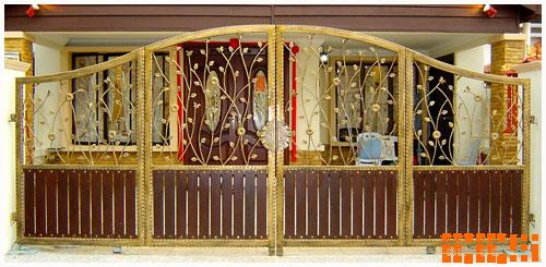

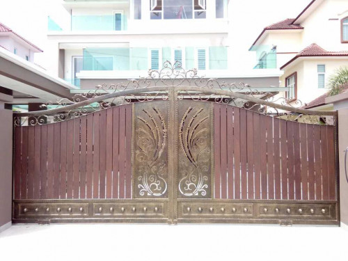

I like the gate below but too expensive...

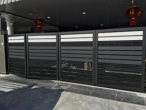

he did the window grille oso of coz...but mine was done by a company called NewGate coz tat time is till dunno this guy...if i know earlier, sure it will b cheaper.
for this guy, based on the gate he install, actually he miscalculate the gate height by 1/2 inch - 1 inch.
if u look at the first photo below, on the left side, the gate abit shorter than the wall, even though abit angry but i still accept it lar cozjust minimal error and mainly i didnt really follow up wif him coz bz working...but if possible, when u engage him, u need to follow up coz when he built the frame and he will take this gate to test it in our house then only send to galvanize n coating...

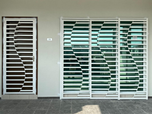

QUOTE(edwardsiow @ Apr 12 2011, 04:14 PM)
this design of grille nice? "S" style...nice if looking from outside...headache...don't know want to take this design or not..
nice.. how do they design it? using paint only?

QUOTE(12FX @ Apr 26 2011, 04:29 PM)
Already asked..this design expensive..don't have much budget on it....
Paint, Galvanise, Power-coated also got..

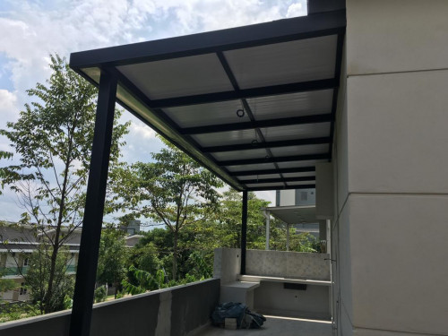

post Jun 22 2011, 01:33 PM
324 posts
Joined: Mar 2011
No installation charge or transportation fee. I opted for powder coated mild steel as my husband didn't like the flowery wrought iron. Quoted RM11.50 per sf for window and RM12.50 psf for sliding door, using flat bar.
Refer pic below.

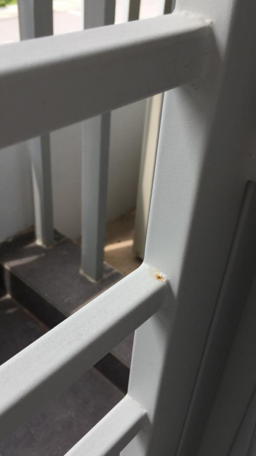

He actually not even recommeding galvanized, because only those knocking will get rush even after galvanized example side door with Lock

Maybe he don't do Galvanized. Proper galvanized metal, it can last long for welded portion need to use good primer + paint (or even some paint now are very good to protect rust) will do.

Maybe...because I'm choicing ICI for the paint. Anywhere, will give a go on Monday so that I could start in place rest of items lol...

Not as strong as galvanized.
We never see lamp post rust right smile.gif is galvanized.

Powder coating is more for the aesthetic while galvanising is corrosion protection. Both function differently smile.gif

12,019 posts
FAQ Galvanized
1. How does galvanizing protect steel from corrosion?
Zinc metal used in the galvanizing process provides an impervious barrier between the steel substrate and corrosive elements in the atmosphere. It does not allow moisture and corrosive chlorides and sulfides to attack the steel. Zinc is more importantly anodic to steel – meaning it will corrode before the steel, until the zinc is entirely consumed.
4. How long can I expect my galvanized steel project to last in service?
Hot-dip galvanized steel resists corrosion in numerous environments extremely well. It is not uncommon for galvanized steel to last more than 70 years under certain conditions. To get a good idea of how long your project will last, see the service-life chart.
This post has been edited by weikee: Oct 30 2011, 10:55 AM

Not just aesthetic. Powder coating do protect from corrosion. If you notice those factory electrical box or db box, the box is coat with this. You can't scratch it off easily.

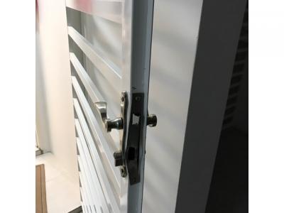

I more worry is the area where the small entry door lock with be rush due to the lock set...

A powder coated meter box.... it has not rusted yet because it is not located under the rain & shine. biggrin.gif

If your concern in on the padlock's abrasion onto the painted/ powder coated surface, why don't you install a mortice lock instead of the padlock. Thus no moving padlock when the gate swings.
This post has been edited by kelvyn: Oct 31 2011, 10:46 AM

Check out the available lock set that suits your requirement. There are some that needs the key to lock, etc...

Sorry. I meant most of time I will in / out from the small door instead of through AutoGate except night time lol. hence will need to ensure the lock area will not get rush if I didn;t do galvanize or powder coated.
I will talk to the contract maybe could in place stainless steel ear lock brows.gif

Just get my grill / gate in place last week...
1.6mm
Now wait for Skylight...
goofy_cupcake

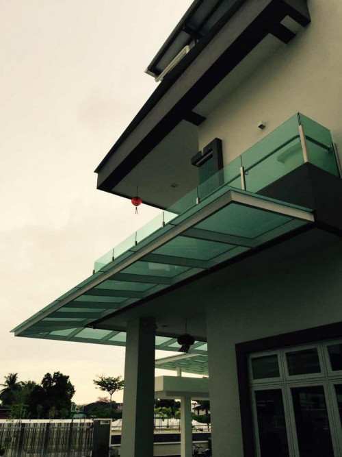

QUOTE(cengkadad @ May 14 2012, 11:56 AM)
where can find a built in grille for windows, sliding door etc in malaysia? got anyone used this before ?
pic  -
This is beautiful. If you know where to get in Klang Valley please let me know too.

QUOTE(lionfish77 @ Jun 7 2012, 03:44 PM)
This is not built in grill. This is called leadlighting. Usually pieces of glass is used to make the whole piece for the window.

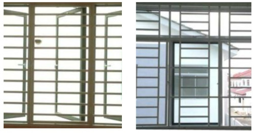

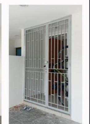

Dear All, need you guys' opinions. Which grill design will u choose if only 2 choices available?
Why white powder coated is more expensive than other colour powder coated? Thanks.

post Oct 9 2012, 10:59 AM
427 posts
Joined: Jul 2006
QUOTE(awdarr @ Oct 9 2012, 01:13 AM)
Prefer the right side one. The left side one looks very 'auntie'.
Not sure bout the white coated price though.
coconutzz
post Oct 9 2012, 11:52 AM
1,109 posts
Joined: Mar 2007
I chose the right side one for windows...and left side one for my main door only..
Reason for choosing right side one is, there are more "bars" attached to the sides, so if they need to cut, i guess they need to cut more pieces ...this is just my opinion... I could be wrong...
craftsnknots
post Oct 9 2012, 12:38 PM
577 posts
Joined: Feb 2012
QUOTE(coconutzz @ Oct 9 2012, 12:52 PM)
I also choose the right horizontal one for the same reason. The one on the left, if they really want to break in, they only need to cut 4 bars (2 vertical bars top and bottom) and they can remove the entire 'grille' and just climb in. if it was the horizontal bars, they would need to cut more, thus taking more time...
coconutzz
post Oct 9 2012, 01:25 PM
1,109 posts
Joined: Mar 2007
But then again, if u have alarm installed, even before they cut any bars..the alarm would have gone off...
so, one more important item is to have alarm installed, though sometimes can be annoying with false alarms...well, just let it blare for a while...at least u will be awake when it goes off rather having awaken by a parang on ur neck
i just wonder on the left picture. seem high floor also still need grill? or malaysia is really really really not safe even if we stay in the cloud?
craftsnknots
post Oct 9 2012, 10:32 PM
577 posts
Joined: Feb 2012
QUOTE(coconutzz @ Oct 9 2012, 03:59 PM)
They managed to disarm the alarm despite not knowing the code? Did the alarm go off?
Nowdays is really bad, even if my alarm goes off, i will let it go until I've checked my house and ensure it's a false alarm....dun really bother if it awakes my neighbours...safety first man..
Yup, they disarm it with some device, police said a few house experienced the same thing. This was in section 11 shah alam about 8 yrs ago..they have 2 alarm,1 for gate 1 for home, imported from germany last time, they disarm the gate with device n the alarm for house was triggered, put parangto her neck n threaten her
Added on October 9, 2012, 10:34 pm
QUOTE(Yamma @ Oct 9 2012, 04:20 PM)
I think for condos on high floors the grilles are to protect ppl from falling out the big window kua, like climbing toddlers n small children
This post has been edited by craftsnknots: Oct 9 2012, 10:34 PM
awdarr
post Oct 10 2012, 01:10 AM
77 posts
Joined: Nov 2011
QUOTE(coconutzz @ Oct 9 2012, 11:52 AM)
Security aside, is right side grill in the pic nicer than left side one?
At first glance, I thought so too but the price for left side is surprisingly more expensive than the right side one.
Added on October 10, 2012, 1:13 am
QUOTE(Shazzac @ Oct 9 2012, 10:59 AM)
So right side is preferred? Then it's not a hard decision as the price is cheaper too (both are white powder coated). I was indecisive because I thought in long run, the right side grill will become boring.
This post has been edited by awdarr: Oct 10 2012, 01:13 AM

QUOTE(awdarr @ Oct 10 2012, 01:10 AM)
Not to say old fashioned but it's the kind of design an older person would choose.

Never mind design like aunty or old people lah laugh.gif your safety is more important.

I prefer the left side, coz my home right now have the same design as the right side and it is abit difficult to open the aluminium window without extra space to manouver. The downside is that it looks kinda old fashioned.

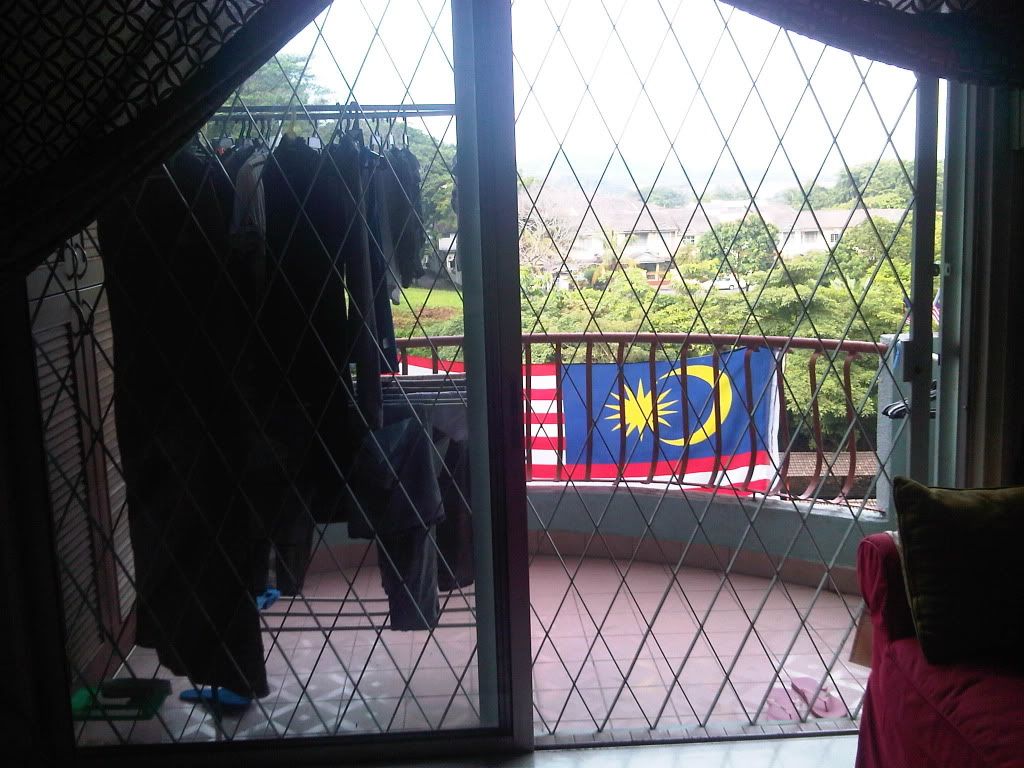

Hi All,
Does anyone know the name of the attached balcony grille and the cost? Thank you.
jovial
post Nov 19 2012, 07:51 PM
carpe diem
2,129 posts
From: Somewhere only we know..
QUOTE(icekelvin @ Nov 19 2012, 04:08 PM)
Hi All,
The vertical ones look like invisible grill
http://www.invisiblegrille.com/
They aren't meant to keep thieves out but just safety for children and pets

Power coated is just a layer of paint and it will still rusty. If want to avoid rusty, go for galvanized.
RM40 psf is very expensive. Normally they will top up RM2-3 for each sqft if you need to do powder coated. If the grill cost is RM10 then powder coated will be RM12.

Understand from my contractor, the workshop that he engaged for powder coat had missed out a step to apply a layer of chemical before coating which can give better protection against rusting in future.

before powder coating that grill.. some workshop do sandblasting for powdercoat last long..
some workshop didnt do sandblasting, powdercoat will terkopak after few years whistling.gif ( will .....but not easily terkopak la)

sandblast or not sandblast.. after powdercoat almost no diff.. blush.gif sandblast work like (undercoat layer for paint)
powdercoating is final process.. how come to hot dip after powdercoat applied... rclxub.gif
