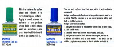

Guys,
For the sticker that will easily peel off, can I use Mr. Mark Setter to increase the adhesiveness? If not, any other alternative? Thanks!

Not sure how to fix after peel off, but I do know how to prevent it. Use Mr.Mark Setter when apply water decals, after that top coat it.
If clear stickers or foil stickers, you wont need Mr.Mark Setter just top coat.

Top coat itself will do the trick?

Top coat just a better or professional name for a clear paint lol... Think logically, if you cover your stickers with a layer of paint, it won't be peel off right? Because it was under the paint unless the paint wear or peel off. Cheers. smile.gif

dip the sticker in water for 5 sec and use cotton bud to press the sticker

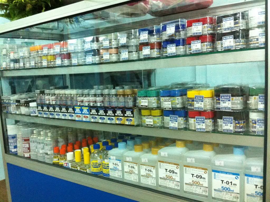

guys. i have a question. where else can i buy acrylic pains?? for now im buying from the tamiya shop at the basement of 1utama. so i wanna know is there an alternative place to source for acrylic paints. i dun mind online seller as well. right now using tamiya la. if u have other brand n cheaper altrnative pls also suggest. thx in adv.

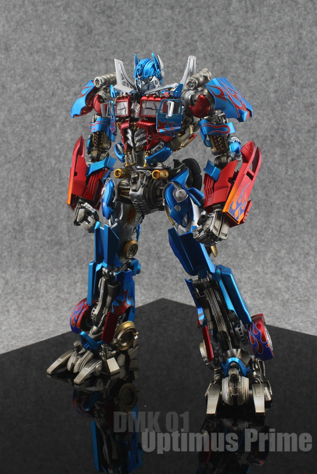

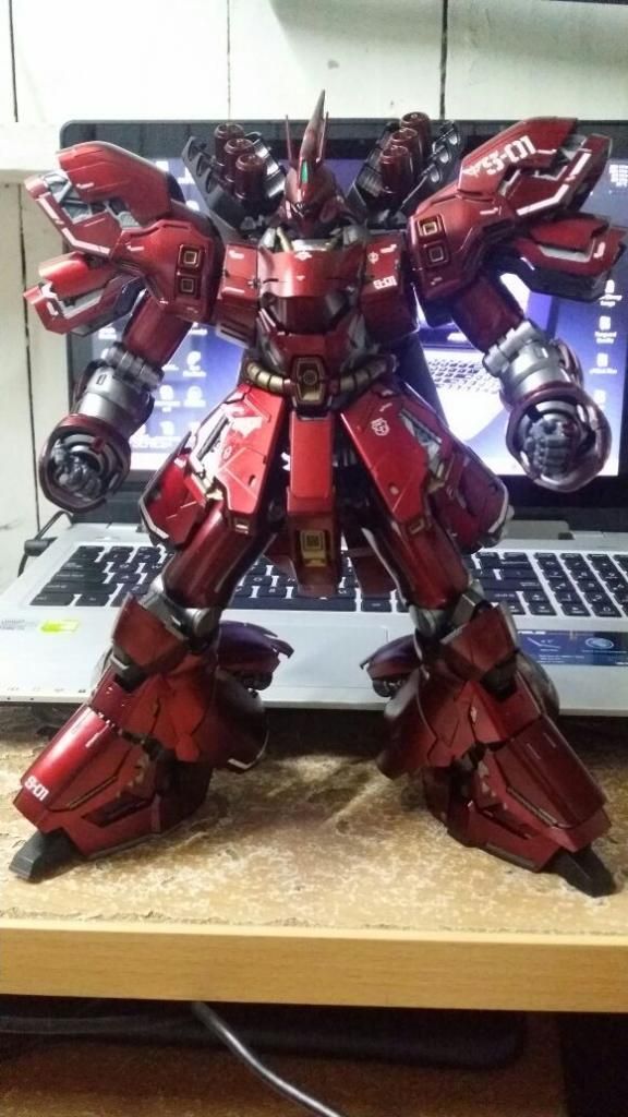

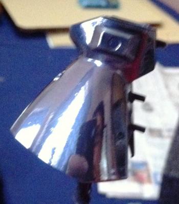

Can anyone recommend brand of spray that have good metallic color?
The one that reflect lights rather than have dots of shinny sparks.
Or that is a effect from mixture of spray?
Trying to get a metallic chrome like red and blue color.
Thanks
limfreelance
post Jul 16 2013, 04:00 PM
343 posts
Joined: Jul 2011
From: Land of SaberLion :3

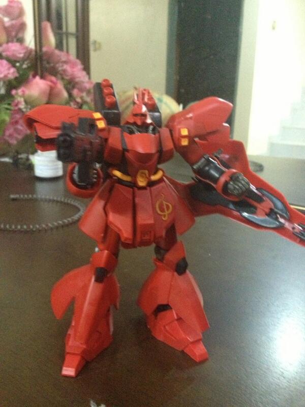

QUOTE(vkcy @ Jul 16 2013, 02:59 PM)
Thanks
u mean candy color??? But the based color u need to coat a silver coating 1st.
vkcy
post Jul 16 2013, 05:06 PM
Joined: Feb 2007
QUOTE(limfreelance @ Jul 16 2013, 04:00 PM)
So if Sinanju i wan it to be the color of R11 as pic, i need to spray a layer of silver coating than cover it with the red?
To make it alike with titanium finish.
limfreelance
post Jul 16 2013, 05:09 PM
343 posts
Joined: Jul 2011
QUOTE(vkcy @ Jul 16 2013, 05:06 PM)
based coat + Silver + Clear red (noted, the more layer of clear red u spray, the more darker the color).

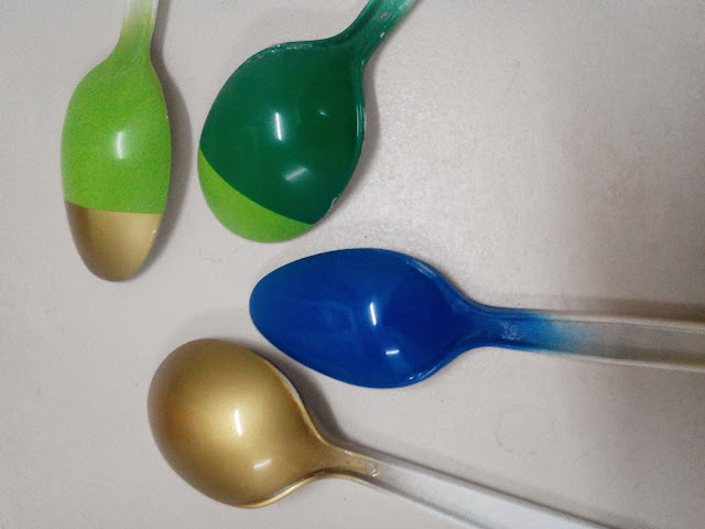

hope you guys can help me out:
currently building the MG Sinanju
-dont wanna use those stickers for the emblem, sleeves etc
-so decided to coat the parts with gold lacquer paint 1st followed by black enamel paint
-use enamel thinner and slowly rub off those parts that needed to be gold
problem is, when i try to rub the enamel paint off, the gold lacquer paint ALSO came off.... shocking.gif
so, where is my error? wrong thinner, shld use another type? too rough when rubbing? insufficient layer of lacquer paint (i coated 2 layers)?

Some people put a layer of gloss topcoat after the gold but before the enamel black.

OK, that's a great idea, but just to confirm that the thinner will have no effect at all to top coats?
and another thing; I already painted all of those parts using the method i just mentioned.
i actually tried this on a dummy first b4 fully implementing, and it seems OK at first, never thought that this could happen cry.gif

Maybe because you use too much thinner as enamel thinner is quite strong. Just use enough to remove the paint and wipe it off immediately.

i used those cotton buds and just dipped the tip of it with thinner and gently wiped across those i areas that i want.
now that you'd mentioned enamel thinner are strong, then i think i shouldn't be 'rubbing' them right? thanks....

If you are using enamel thinner, chances are that it will slowly "eat through" the laquer gloss layer. Its recommended to re-coat the area again after a few tries with enamel thinner. Also, spraying a gloss coat might dull your gold paint if its metallic base.

i'm using metallic gold fyi.
an d i don't quite understand 'recoating with enamel thinner'. please explain more, thanks.

how bout using Zippo lighter fluid instead? it's weaker than enamel thinner but can remove enamel paints
might as well give it a try, at least better than redoing all of them...thanks bro

Metallic paint and gloss coat don't really go well with one another (unless it is a gloss coat for metallic paints). If you apply gloss coat, it will reduce the metallic shimmer as the gloss coat dulls the metallic particles (at least that's how I think it works).
Reverse wash - People normally apply a gloss coat to protect the layer underneath so that when you spray enamel paint on top, the lower layers are not affected due to the protection given by the gloss coat when you clean it with thinner/zippo.
Like General Nic says, use Zippo Fluid instead of enamel thinner. But no matter what, if you keep on using Zippo Fluid or Enamel Thinner over and over again, the thinner will eventually eat through the gloss coat and affect your lower layer of paint.

i tried using not only Zippo Fluid, but also WD40. The latter seems to have less effect on the lacquer layer, but will still dissolve it.
you mentioned that using the Zippo Fluid or thinner over and over again, but with gloss coat in between, i presume it will makes it harder to reach the lacquer layer right?

Gloss coat is a layer of protection. But the continuous use of enamel/zippo fluid willl eat the gloss coat it. Try experimenting on a part - keep using the enamel thinner/zippo on it. You will realise that eventually the gloss coat will come off as well as your paint.

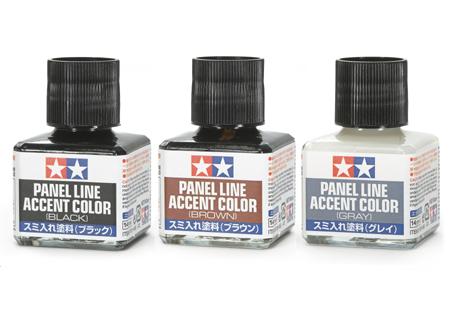

new type of Gundam Marker coming soon
it's like Panel Line Accent in marker form
but if I didn't read wrongly, it can corrode acrylic(water based) paint

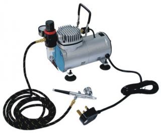

mine, still queuing, a few projects in coming, and also, just encountered this one; a 'broken' air compressor cry.gif

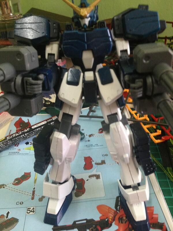

Well, at least it look better then before.

nice~ panel linings will make it even nicer.

By high end set you mean the compressor with tank set ?

Ya... but without spare tank also quite expensive.

You talking about the branded stuff right because china made turtle compressor set just around rm 200.
Just one thing to note even with the tank, it will broke down if under constant heavy use. Like mine broke down a few months ago sweat.gif, now i put a fan directly on it so it cool down faster.

Can anyone advice if my understanding is correct.
I paint silver coat first on a plastic surface than I paint over the silver coat with clear dark blue coat on top of it, I will be able to get a metallic like dark blue finish?
I am thinking of doing a metallic dark blue titan finish for my Hi Nu.
This post has been edited by acestoro: Aug 6 2013, 01:57 PM

Correct... but if u want your silver more bling-bling then can apply a layer of black before apply silver color...

Oh ok thanks bro.. so its black > silver > clear color.
Thanks for advice.. maybe I'll take a spare plastic to test. =)

the silver will shine through, but it's Candy Colour finish, it's like mirror behind coloured glass
real metallic silver will have silver particles in it, hence shinier, will be like metallic paint on cars

thanks bro.. i don't intend to have it super shiny.. I intend to have a white silver as base..
Can you advice does those clear color paint require any thinner or I just paint them over
without adding any thinner.. sorry noob question.. since the paint seem different from normal
paint texture I used..

Guys, I want to paint my red Sazabi become white. After 2nd layer, still look pinky to me. I used normal can spray, brand Anchor.
What should I do?

QUOTE(ayonan @ Aug 18 2013, 05:20 PM)
What should I do?
Use surfacer?

QUOTE(Frisz @ Aug 28 2013, 07:26 AM)
What will happen if I mix it with gundam marker instead? Or buy another brand like Mr. Color?
Enamel thinner only works with enamel paints, which mean any other paint that is not enamel will get clotting regardless of brands.
QUOTE(Frisz @ Aug 28 2013, 03:17 PM)
Which brand? can you list brand that compatible with enamel paint?
Tamiya own enamel paint that in a boxy like glass container like this:
anak kenyalang
post Aug 28 2013, 05:20 PM
85 posts
Joined: Jul 2013
QUOTE(Khai62 @ Aug 28 2013, 04:43 PM)
There, should answer your question. I don't usually goes with enamel. So I don't know any enamel paint brands. Logically, the name itself says enamel thinner, so u should use enamel paint to pair with it.

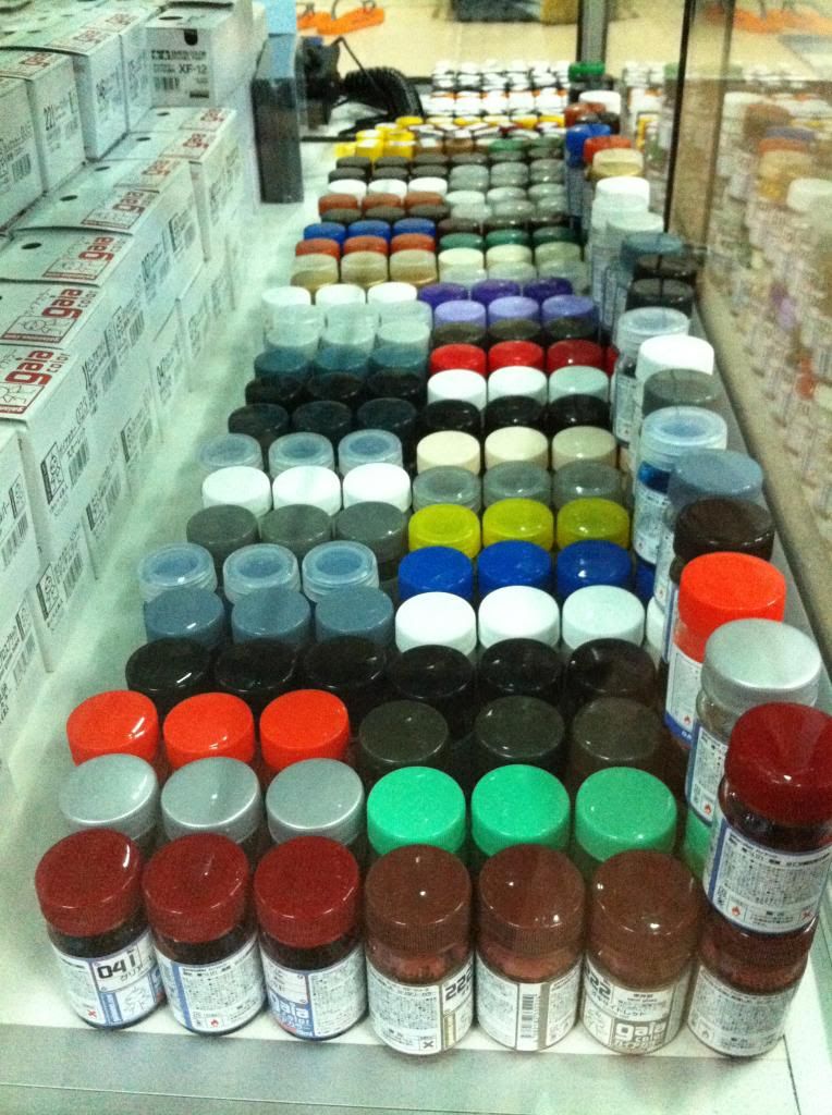

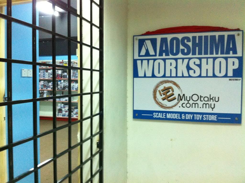

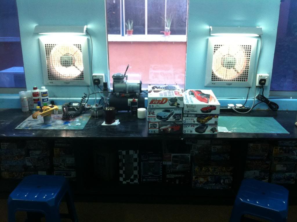

Just wan to share with all modeler, here is MyOtaku At Megan Sri Rampai, if u new to airbrush we do provide training and guidences, Thanks all

QUOTE(KenShin21 @ Sep 24 2013, 01:20 AM)
KenShin21
post Sep 24 2013, 11:19 PM
1 posts
Joined: Apr 2008
just wait my frd future to setup in penang area ~
Highly recommended shop. Been there twice for airbrush service. Clean, comfortable, friendly environment. Lots of paints there. Highly recommended by me! :thumb: :thumb:

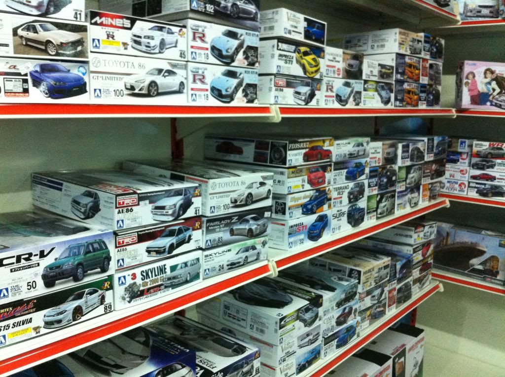

Hi all, recently I felt in love with 1/12 motorcycle kit. But it is very rare to be found in JB area. Did anyone know where I can buy it in KL/JB area? Would be better if they got online store. Thanks!

QUOTE(muserella @ Sep 25 2013, 12:10 PM)
try here

Thanks guys,
Found out the wheel decals are really paint in the neck! I've damaged all given decals for my Tamiya 1/12 Yamaha M1 cry.gif
I just bought a 1/12 Kawasaki ZX-RR recently and did somebody know the easiest method to apply the wheel decals?

Hi guys, I'm quite new to gundam modeling and recently the painted and modded versions of a few kits have realy caught my eye!!! One example is this particular 1/100 MG Sinanju!
I was wondering if someone could explain how this type of paint job could be achieved? Also if it is possible without a airbrush thumbup.gif if not just a simple tutorial would be awesome!
Just bought a brand new Sinanju at Ikano during the fair hope you guys can show me the way notworthy.gif
... a nice setup ...

To all the experienced mode masters,
One quick question which I can't seem to find the answer on google. I'm aware that for panel washing, Zippo lighter fluid can thin the Tamiya enamel paint. But my question is, will Zippo lighter fluid thin those artists' oil paint which you find at art store as well?

QUOTE(harmonixer @ Nov 3 2013, 01:15 AM)
Thanks
As far i remember, Zippo is not strong enough to thin down artist oil paint. Need to use low odour Turpentine to get similiar effect.

QUOTE(Khai62 @ Nov 4 2013, 09:43 PM)
Well you can but the chance paint chipping is quite high unless you using lacquer paints which is the most resistant paint you can get.
I see, thanks for the info. Then i'll just stick with enamel + zippo.

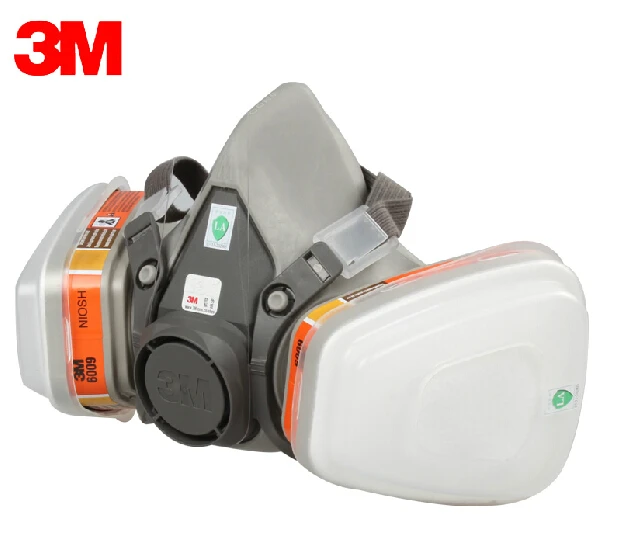

Lacquer
- Very resistant
- Give out hazardous smell
- Mainly for airbrush
- Very quick drying time
I know about ABS become brittle when painted with lacquer issue but so far i haven't have got those problem before.

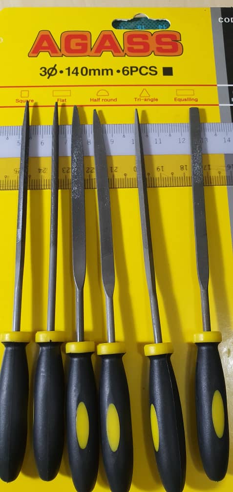

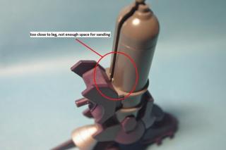

Hi all sifu here,
i have a question to ask regarding some beginner's technique for gunpla-ing.
i tried several methods to remove the nubs of the parts, all of which are learnt from internet / forum tutorial.
all parts are removed with a small gate connected.
1) hobby knife with sand paper. i sliced the gate with hobby knife bit by bit, then when it is flat i lightly sanded it with 2000-grit sand paper.
2) sand paper only. sand it with a lower grit sand paper till it is flat to the surface, then finished with 2000-grit sand paper.
method 1 still leave a visible mark of white outline of the gate.
method 2 deforms the surface of the parts while the white outline is less likely to be noticed.
i wonder what is wrong, i can't achieve the same result as what was taught online. Can anyone give me some guidance on this? could it be my hobby knife not sharp enough? or the slice is not thin enough?
as i dont think i will try method 2 again since it deforms the surface of the plastic. sweat.gif

Try this method:
http://www.pla-zone.com/thread/287/nip-mark-removal-snapfit
But personally i don't really bother to go extra effort most of the time on removing nub marks since in the end of the day you only see it when up close.

actually i did follow the same post, minus the filing, the variety of grit and the tamiya cream, as i only have a nipper, hobby knife & a 2000-grit sand paper.
currently my result is a smooth surface, with a white outline (not a spot) of the nub. So i think painting is the only way to make it totally unseen, huh? sweat.gif

As Khai said.
When u see the white outline, means u have already twisted the plastic n it has already become white. there is nothing u can do besides covering it up with paint. To avoid the white thing, honestly I find it quite a challenge. to make sure one or two is perfectly well is ok, but make sure hundred over parts (For MG), one you made mistke, means u r not getting a perfect score.
Huhu, I can be an @ss....
P/S: looking at your current arsenal, very hard to achieve. i would recommend u get 600, 800, 1000, n 1500 grit sandpaper, if u want finish it with 2000 grit sand paper.... which i think 2000 grit is a little too smooth.

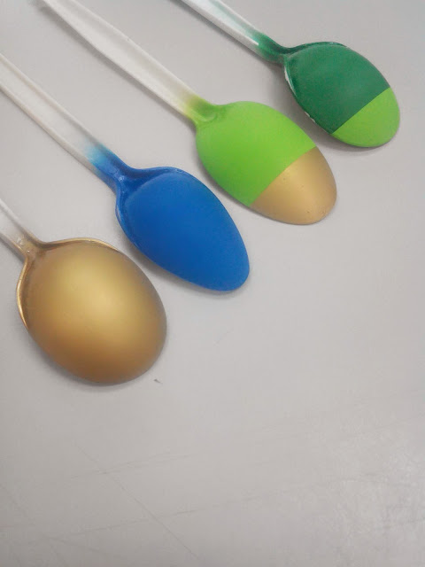

Guys, may I ask some technique regarding spray?
Let's say I wanna achieve a darker tone of same color. (i.e, red and dark red)
For the dark red, can I simply spray a layer of dark grey on it, then spray over the same red to achieve darker red?
Thank you in advance!
blueric94
post Nov 21 2013, 09:51 PM
85 posts
Joined: Nov 2013
QUOTE(Vorador @ Nov 21 2013, 08:29 PM)
No, that wont work.
Most of the sprays usually not transparent, so no matter what colour you use for the 1st coat, when it dries and you spray for 2nd coat, all you see will only be the 2nd coat colour, it will cover totally the 1st coat colour..
I dont think there is any way you can achieve what you want by using spray can, so what you can do is to buy that specified colour, or use hand panting n mix the colours. tongue.gif
shauno
post Nov 21 2013, 10:10 PM
249 posts
Joined: Jun 2006
QUOTE(blueric94 @ Nov 21 2013, 09:51 PM)
No, that wont work.
disagreed. base color will definitely influence how the top color will turn out. that's why people do pre-shading. whistling.gif
Vorador, yes it will work. for a better effect, use a white base for the lighter/brighter red, and grey for a darker red.
Vorador
post Nov 21 2013, 10:35 PM
Blessed !!!
3,494 posts
From: Nosgoth
QUOTE(shauno @ Nov 21 2013, 10:10 PM)
Thanks man, BTW the reason for my question is this:
Also thanks blueric94, you got me. (Yes lazy me are planning using spray can tongue.gif )

im not sure what king od spray paint you use, what i said was based on normal spray can cost around rm6-7. why dont u that on a piece of plastic n see the result biggrin.gif
In my opinion(still based on normal spray can, without any aid of professional tools), your 2nd coat will either thick enough to fully cover the 1st coat, or thin enough to let the 1st coat appear partially, but not uniformly, it means the 1st coat is visible with different intensity on different area. I dont think there is any way u can ensure the exactly thickness of the paint when using spray can hmm.gif

if you want to achieve the same effect as the one pic you've shown, you must mix the color. Layering a dark based and second coat of red will be difficult to achieve since you're using a spray can. Difficult to control the paint flow. If you have an airbrush, this would be a breeze..

yea what Noysan said is correct, expect that result only when you have an air brush biggrin.gif
you better take the proper steps, its totally unworthy if you spoil the appearance of the parts just becz a bit of laziness tongue.gif

Thanks for the advice! But air brush expensive and hard to maintain... sad.gif
nvm let me think abt it biggrin.gif Consider I will definitely do post shading, so I guess it doesn't matter? hmm.gif

Since you are going to do post shading anyway, why dun u just try and see whats the result on a piece of plastic 1st biggrin.gif
I got a box of scrap component (a spoilt BB gundam) will try on that one first~

I suppose hand painting will be hard to achieve what u want. To make it as shiny as mirror, you will need an extremely smooth and flat surface. that means not even one brush stroke or uneven paint should be present. I suggest u use air brush or spray, then it will be easy to make it shiny.

Hi , i have a few questions i would like to ask about painting a model kit .
Firstly , i'm a beginner , just learning to paint my first kit atm and i'm having some issues
First question is , where can i buy Mr Color paints and thinner ? i bought the ones i had from a trip to japan and by the looks of it i dont think i have enough (especially thinner)
Second is , how do i make the paint look less 'shiny' ?
Sometimes its too 'wet and thick' sometimes it too runny :/
I'm using a paintbrush to paint it
This is the picture of the problem i'm having :/
The top row left and middle are too 'shiny' and the rest are the right shade of color imo , that's the shade i want to get
Also does normal thinner work just as well as the Mr Color thinner ?

Which type of paint are u using? lacquer? or enamel? They use different type of thinner
imho, u shud cut the parts out, sand them, lastly only u paint it

On my paint bottle (Mr color) it says metallic , steel , primary , i bought the paint because my model instructions had a paint scheme for the model and recommended colors using the Mr colors numbering scheme so i just foloow

If its metallic color u nid to use metallic thinner

The Best Place for Hobby Supplies in KL is Time Machine @ Berjaya Times Square IT Center Lvl 2....
For Hobby Supplies from Online Stores refer to the following Links below
http://www.jshobby.cc/ - JS Hobby
http://www.myotaku.com.my/ - MyOtaku

For MG kit that has inner frame, how to eliminate seamline of outer armor? I found on youtube are mostly HG kit that has no inner frame, and they glue both parts together only sand it, and then paint it. However with inner frame, the armor cannot glue before hand. How to solve this?

mg usually don't need glue. unless those old ones

Actually I'm trying to eliminate seamlines. Of course MG is able to snap-on without problem, but seamlines are still there, especially outer armor.

Anyone using this?
Will the paint dry up very fast in the bottle? As my progress is very slow, 1 kit take me >1 months to build. So I will only use this accent color not so frequently.
After using, can use Zippo to wash the excess? Since this is enamel. Thanks!

I have this a few month already and still watery and yes you can use Zippo to wash it up since it just a ready made enamel wash solution. Remind me getting the black one since that always sold out. sweat.gif

Nice. If the paint can keep for few months and still watery, this is a good news! rclxms.gif Thanks master Khai62

hi guys! got a question, if i going to paint metallic paint on my kit (inner frame) what kind of topcoat should i be using?
and by referring to this website on method 1, it mentioned that semi-gloss is needed but i only have gloss coat, can that be used as alternative?
http://gunplacore.blogspot.com/2013/04/tut...paints-and.html

if you want gloss finish
use either semi or full gloss

thx, gloss coat will make the metal shines less? that's what i found out from google search though, so nazrul, u tried metallic paint be4? what advise can you provide to newbie like me laugh.gif

spray silver base before put metallic coat on it
and also seal with gloss coat if you like more glossy finish
test on use-throw(is this correct term?) plastic spoon you get on shop
once you satisfy with results can use on real gunpla

Can you guys recommend a good hobby shop selling paints, airbrush, models & etc at fair price in Klang Valley?

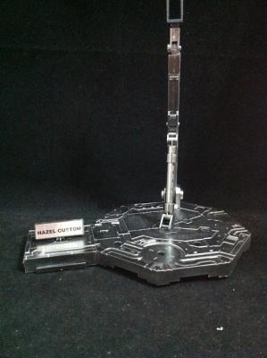

Is it okay if i spray to inner frame and armour using Anchor brand sprays?
Khai62
post Dec 11 2013, 12:06 AM
16 posts
Joined: Dec 2011
From: Perak
QUOTE(IMBeta305 @ Dec 10 2013, 10:22 PM)
It ok just don't spray thick coat on it. Here mine with Anchor sprays.

QUOTE(Khai62 @ Dec 11 2013, 12:06 AM)
http://www.dpiaerosol.com/aerosol3.htm
which type?

QUOTE(IMBeta305 @ Dec 11 2013, 12:23 AM)
the standard spray paint, since only that is available in my area.
This post has been edited by Khai62: Dec 11 2013, 12:28 AM

okay im gona do it exactly as you did,
mind giving me the colour you choose and procedure?
havent paint anything before

QUOTE(IMBeta305 @ Dec 11 2013, 12:43 AM)
For procedure you can view this video
As far i remember i use Anchor flat black (armor), silver (inner frame) and Bosny 20k gold (psychoframe) for the banshee.

QUOTE(Khai62 @ Dec 11 2013, 01:47 AM)
did you prime before painting any of them? ( inner frame and armour)
Khai62
post Dec 11 2013, 12:58 PM
16 posts
Joined: Dec 2011
From: Perak
QUOTE(IMBeta305 @ Dec 11 2013, 10:33 AM)
Not for the innerframe since you won't see much of it anyway and add more layer on it will only make it more likely the paint to chip because of parts will be clashing each other especially when posing.

When doing panel lining, is it OK to use brown panel line color for the colored surface, instead of black? Currently all my models are using gray for white surface, and black for colored surface. In colors like red and yellow, the black panel lining is like a WOW contrast. Replacing black panel lining to brown, to all color surface (including blue, dark blue), would it be better? Any sample to show by sifus?
So far I only have black panel line pen because no time go buy other colours and no time to build as well. But my opinion is,
-grey panel line for white plastic surface or any place you don't want the panel line look too thick or obvious
-black can use on any colour surface but not suitable for dark colour surface(because you can barely see it) or white surface(thick feel)
-brown is for dark surface so you can see the panel line clearer than using black panel line, and it is a good colour for camouflage build or weathering kit.

Haha, thanks for your reply bro. I was thinking to replace all black panel lining into brown actually, to lessen the contrast.

QUOTE(OhNooy @ Dec 26 2013, 08:06 PM)

hi guys, I am interested in buying an airbrush set for beginner. Anyone here have any recommendation for the brand?

QUOTE(syuki123 @ Jan 8 2014, 11:38 PM)
Currently I brought u star brand come with airbrush and compressor with tank. Rm690 Sarawak

hi guys,first time attempt on ab my model kit.all comment and critics are welcome biggrin.gif
btw is there any other way to overcome paint scratch problem like in the 4th pic?i already spray with topcoat but seems like no effect at all.

QUOTE(TongCN @ Jan 17 2014, 10:58 AM)
Are those Krylon can easy find in Malaysia?
I plan to browse some hardware store tomorrow to buy some gold and red spray can but not sure whether they suitable for gunpla or not :\
Any advice ?
I have try Anchor, Bosny and Toa which have no effect on plastic if done correctly. If in doubt, try spray on runner first .
QUOTE(cheokchuanyi @ Jan 19 2014, 06:20 PM)
You can't avoid paint scratches especially for the joints as parts will rub each other and Topcoat is not a forcefield that can protect paint from scratches forever.

post Jan 24 2014, 11:27 AM
343 posts
Joined: Jul 2011

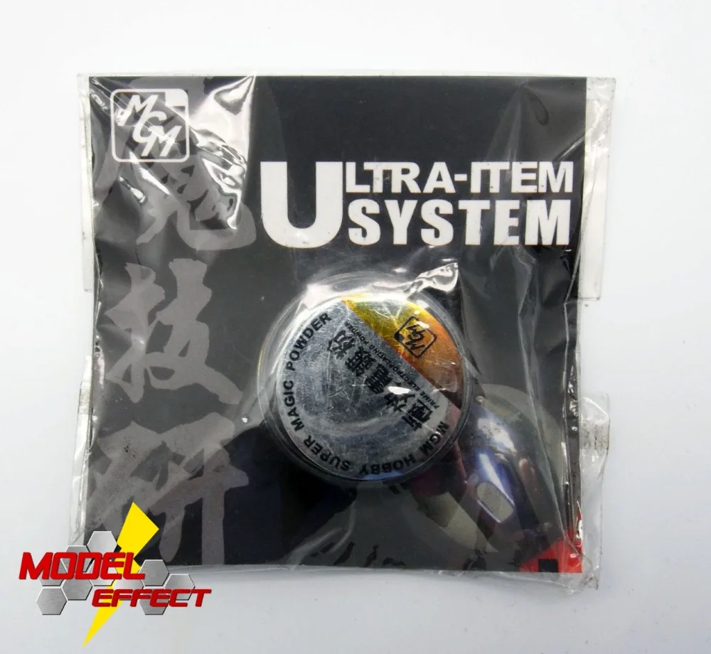

hi
any one have try this??
Kosutte Gin San powder.
1) after done the work, if play the or figure touch the powder, does it defect?
2) if top a clear coat, does it affect the chrome?
thx

simple answer,
1) yes. avoid touching or playing with parts which you have chromed
2) yes. ginsan is the last layer. avoid having anything on top of it already.

2. There are some in BTS like GamersArena (7th Floor), IT Toys (1st Floor IT Centre) or for scale model specific shop Hobby Hq:
http://malaysiascalemodelling.com/index.ph...id=58&Itemid=21

hi all, newbie have something to ask here
i've been using this on my model kits, but it just won't dry.
what's the proper way to use it? i leave the part overnight after paint but it still won't stick.

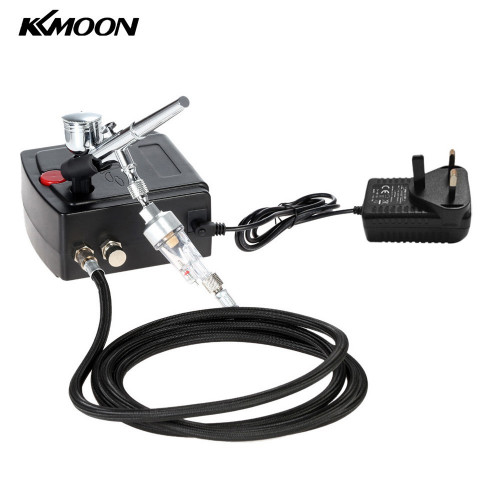

Hi guys, im interested in buying an airbrush and compressor set from china, but im wondering about the power source - i see theyre using some china two pin round plug head - so can I just stick it into those cheap white plastic multi-adapter then plug straight into our local power socket?
thanks..

use wire cutter cut it off and place new 3 pin plug, dont ever use the mutli plug, sometime not cun, u can hear the inside the multi plug got spark...

just buy the universal adapter for it. however read carefully on the input and output power at the compressor adapter before you plug in, china using 220v and our home using 240v. Straight plugin can cause the the adapter to *bye bye* except if the adapter input power showing 220v~240v so it's safe.

hi, can i know this kind type spray. shining pink colour for metal material

form more detail u can read here
http://babahobbywork.blogspot.com/2013_06_01_archive.html

post Feb 11 2014, 05:02 PM
343 posts
Joined: Jul 2011
QUOTE(toa cheng @ Feb 11 2014, 04:55 PM)
tq sifu :3
welcome.
but not encourage u to apply in tamiya 4wd, bcos the paint easi to scar.
surface/based coat> Black /gloss black > Silver (lacque based) > clear or florescent color toner. (if u apply a layer of clear Gloss finish for protection, the color becom dark abit).

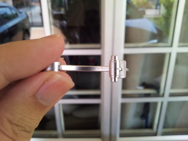

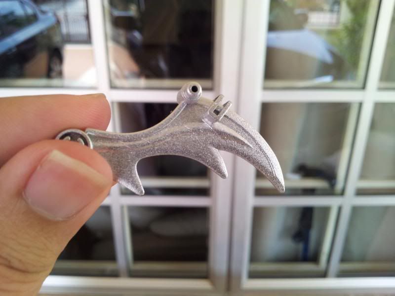

Trying out the spray can but i find the problem below
Side way look clean and silver
But the font part is like old silver and dots
Is it because i spray too much on the front part?

1) u no shake well,
2) i believe your spray can remain 20% paint.
chrome silver is like that when the can start to run out of thinner (inside).

I did shake it well but will try again to see if this is the issue. The spray can is new, so don't think is the issue.
Did ask around and some say i need to wash the runner to have better surface, spray primer to smooth en the surface and lastly someone mention that i may spray too near.
Will test around again.

i actually believe that you're getting that problem because the particles are too big.. were you using industrial spray or hobby spray?

I'm using the anchor spray paint.

anchor has this prob faced by me too.. when just sprayed, it is smooth n shinny.. when it dries, it becomes what u showed in 2nd picture..

QUOTE(bononoz @ Feb 23 2014, 03:41 PM)
Hi, beginner here.. if airbrushing with tamiya acrylics and acrylic thinner, do you need to use a mask for health reasons? what type of mask is suitable?
thanks
I would say good ventilation is more important. But if you're asking, get the sort that can keep vapors out, if you can find them...

Anyone know can this b use to penel line models?
QUOTE(limfreelance @ Jan 22 2014, 01:49 PM)
fuu..i saw ebay sell for rm20, anyone try it bfore??

I not really familiar with car kits but you can refer to this shop and they do postage too.
https://www.facebook.com/myotaku.com.my

QUOTE(Khai62 @ Mar 4 2014, 08:29 PM)

hi, i need some advise...
i have painted my megatron rotf leader class with mr metal iron
to ensure that the color doesnt come off, what type of finishing shud i use?
is it mr hobby super clear? or top coat?
since its metal color, should i get gloss, semi gloss, matt or flat?
thanks
Neofushion
post Apr 9 2014, 10:07 AM
12 posts
Joined: Dec 2009
Best not use any lacquer based gloss or clear coat on the metallic finishes as they will lost their shine due to the metallic particles in the paint being diminished. You can try using an acrylic coat like Future but its a bit expensive.
limfreelance
post Apr 9 2014, 11:28 AM
343 posts
Joined: Jul 2011
normaly for metal effect paint, used lacquer Flat black + Silver. It more stronger.
-hafiz-
post Apr 9 2014, 12:21 PM
4 posts
Joined: Jun 2009
thank you guys

Hi guys
im new in Air Brush
can i know how to fix this problem ?
got some split come out sad.gif icon_question.gif icon_question.gif icon_question.gif
this quite okie
but after that got the problem again

looks like your undercoat is too thick..
thin it more...but not too thin.. just ngam2...
try to get 'milk' consistency ..
BTW can't see your 3rd picture..

common issue for ab.
1) dust
2) shake no thoroughly.
3) your paint dry at the mount of AB if u let it for 1-3min.
to avoid, use cotton butt to clear the ab mount everytime u wanna spray it, then press the spray to spray in test area to let the dot out (do not release the ab button)..... from spray area move it to your car. Do not release the ab button until u finish spray the layer.
let it dry, spray the second layer using the same method.
this method quit annoying, if gundam got dot paint, simply use finger to rub it & respray it.

i use something like this
bought from a fellow LYN..decent and quite cheap set..i've complete 4 1/20 kits and 1 1/72 military kit..can browse and search around.. smile.gif
but can't AB non stop...after 1 hour of 80% us, start to have some funny sounds...so have to stop..continue next day..i reserved around 1.5 ~ 2 hours of modelling per day..so this compressor set quite enough for me... smile.gif
and maybe you can invest for a single action tamiya/procon boy AB... hope this helps smile.gif

post Apr 22 2014, 06:20 PM
564 posts
Joined: Nov 2006
From: JB
i got most of my paints from js-hobby at tmn bukit mewah JB..as their shop is about 5 min drive from my office...nice guy...got BIG stock on paints, kits (Gundam especially), hobby tools..as of the complaints, maybe can call owner directly if got problem to sort things out...

post Apr 28 2014, 07:48 PM
90 posts
Joined: Mar 2009
so today i tried playing around with acrylic paint on some spare parts, and the result was...bad.
although i nv mix with thinner(I know this will make the paint more consistent), but i was wondering whether it could be the paint brush itself since the brush is kinda coarse and rough. my question is whether or not paint brushes have different types like maybe a softer brush or something? some advice needed here
rx330
post Apr 29 2014, 10:50 AM
10k Club
11,808 posts
Joined: Jun 2006
i tot you must mix with thinner? for paint brush, i read before mix with retarder better, it slows down the drying process and lets gravity do its job for the consistent look

i never tried gundam/mecha building..not sure what kind of finish you're looking for...
so not sure if you need to undercoat > silver > clear red > clear coat...or just until clear red
but one good way is to try spoon test..to train sanding and polishing skill
here's my spoon test
undercoat mr hobby 1000 (2 coats) > color paint (4 or 5 light coats) > clear coat (4 or 5 light coats) > sand to flat/matt color > polish

sharing, later gonna paint my optimus prime.
i think i get the alclad chrome + mr metal red Gx 202 & metal blue GX 204 is best for prime scheme. hmm.gif
for more.
http://www.pla-zone.com/thread/811

thanks for the pictures and guides

i tried with alclad chrome and stainless steel
started with mr hobby 1000 primer, then tamiya enamel black and follow by alclad
not as good as i expected, yours look better, whats your method?

try alclad II. it improved version.
btw, i take this photo as reference from here: http://www.pla-zone.com/thread/811

so normally for the black before alclad, you use enamel or acrylic?
i was using enamel, and i notice, its easily chipped off

i encounted problem of using enamel, & from that day on i only use laquer based.
for color selection, i use laquer to mix it out.
metal color easi to chipped off, suggest use a super Clear gloss II as topcoat.

ok, this batch i try using lacquer base gaia gloss black
would the super clear gloss II dull the brightness? i remember reading that it should not be coated, especially for those chrome or polished aluminium

for polished aluminium cannot coat. but after a week the powder also will blow away.
for chrome, if u coat the color become darker, but if u dont coat, the color also defect or sticky when touch.

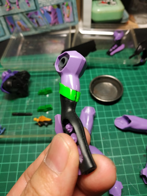

khan_adrian
post Jun 26 2014, 04:19 AM
5 posts
Joined: Dec 2010
Sifu, newbie need help. Why does the part break itself after spraying with Mr Color?

QUOTE(khan_adrian @ Jun 26 2014, 04:19 AM)
Do you spray too close or apply it too thick ?
I assume the part is ABS plastic,
ABS plastic quite weak to any lacquer based paint so paint with risk
you can try acrylic or enamel based paint, its more safer

hi all sifus,is the step below correct if iwant to get sinanju metalic red kind of finishing?
mr.hobby primer 1000->tamiya silver->Tamiya clear red->clear top coat
also how to get the metalic kind of feel like below pic?

QUOTE(ywyap @ Jun 26 2014, 02:44 PM)
clear red tak cantik.
better guna Mr. Color GX202 Metal Red
the more clear red u coat, the more darker, if coat little it look like orange red. mean, one part color dark, one part color light..tak balance.
when color after top a clear gloss, it becum dark also.
Ok. my suggestion only. ya

meaning primer straight skip to metalic red then clear top coat bro?
I am doing ab for volks FSS dark knight and want to get the same effect as attach pic actually. biggrin.gif

no. i prefer DX202 better than tamiya clear red.
u still need to follow the step.
for Clear Red, it is hard to spray it thoroughly & average. Certain part may thick paint & certain part may thin paint.
u can try it at spoon.
just my scent. So far DX metal Color really good. I like the effect.
another example.
good luck.

from my experience on GX metal color, it bright. suitable for bullet effect, metal effect.
example from net.

My airbrush started spitting water every few seconds when I spray. Tried googling and the solution is to drain the airbrush compressor tank. The problem is I can't find the drain valve on my compressor. Any idea? My model is as per attached image.

QUOTE(Haneda @ Jul 14 2014, 08:14 AM)
Yours don't have the tank, just the compressor so most likely the water build up in the hose. What you need is a moisture trap that connect directly to the airbrush like these:
Also check you moisture trap that located below the pressure knob to see if there water build up there.

Thanks Khai62, that make a lot of sense
I have the same problems as you before, I have air compressor w/o tank.I have water filter at the tank plus I added a mini water filter at the airbrush. But I still have water condensation problem, sputtering water after prolonged used of compressor.
My solution, I built a DIY air tank. Now I dont have any condensation issue.

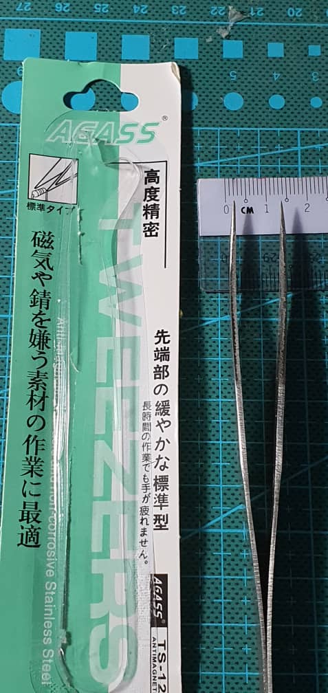

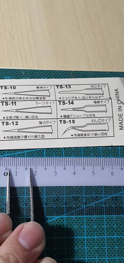

Dear all,
I'm planning to apply decals to my car models, may I know where can I get this tool named "Micro Sol", how much does it cost usually? Thanks.

QUOTE(Speed-Demon @ Aug 8 2014, 06:37 PM)
Dear all,
alternative you can use these
Mark softer
Mark setter

QUOTE('62jaguar @ Aug 9 2014, 09:30 AM)
Mark softer
Mark setter
Thanks for the reply, appreciate it!
