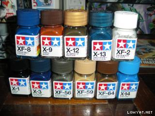

Some Colors Charts and Mr.Hobby Tools and Products.
Tamiya Enamel and Acrylic Paint Chart
Mr.Hobby Products Chart
This post has been edited by VincC454: Jul 16 2008, 03:34 PM

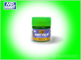

Acrylic color
Bottle cap is flat top.
Some label in blue, but some in purple + yellow.
Color code has a "H" in front, ie : H100.
Usually has "Hobby Color" written on the label.
Those who can recognize chinese word, it has "水性" printed on the label.
Attached Image Attached Image

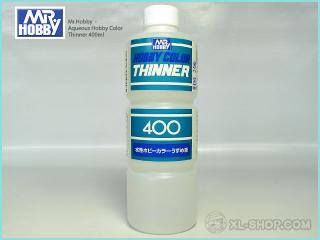

Thinner for acrylic color : Label is light blue + blue. Written "Hobby Color Thinner"
You can also use other brand like tamiya or art shop type, but not recommendable. You can also use water to thin acrylic color. Preferably mineral water or battery water.

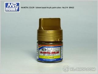

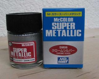

Mr. Metal Color. As the name say, metallic color, with metal particle in the paint.
Mr. Color Super Metallic. A more metallic color than Mr. Metal Color. sweat.gif

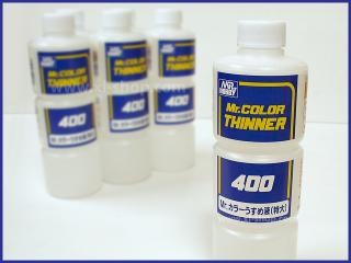

Thinner for all lacquer paint :
Mr. Color Thinner - Normal thinner. Label is blue + yellow. Written "Mr. Color Thinner"
Mr. Color Leveling Thinner - Normal thinner with retarder. Makes your paint dry slower. Label is Yellow + blue. Written "Mr. Color Leveling Thinner"
You can also use other brand like Gaia Note or art shop type. I've tried with Gaia Note thinner, works perfectly fine.
Tamiya Paints
Tamiya got 2 types in general. Enamel and Acrylic.
Enamel color
Bottle is square.
Thinner for enamel color : The color code is X-20
You can also use art shop type, thinner for oil paint. Can also replace with lighter fluid, please use original zippo brand.
