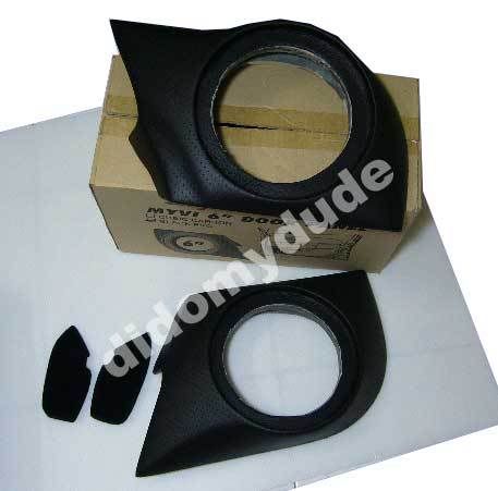

QUOTE(driftmeister @ Sep 28 2005, 11:00 AM)
picture is here

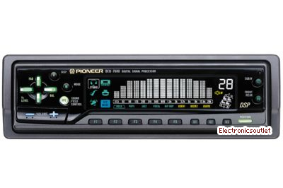

im thinking of getting this unit later to act as the preamp (Pioneer DEQ-7600 Digital Equalizer Processor)
will this thing help in improvng SQ? its seems like an old school thinggy.. but i believe old school rocks! hehe
btw.. this item is really hard to find

I'm using Soundstream XSC.6 (150w) component set speakers for my MYVI rear doors. Never cut original doors. The speakers are actually touching the side of my door causing vibrations & noise.
I want to change the component set to the rear top panel & use my old 800W amp(2 channel caplang brand) to power the component set. I'm afraid if i use this new set up with amp there still might be strong vibrations. The rear panel is a half inch thick plastic material (need to cut to mount speakers).
I also have my old car speakers & player but not sure how to make use of it.I don't know if myvi stock HU power rating is better or worst then, my sony CD player (45wX4). Is it better to xchange the players?
My Sony 2 way 5&1/4 inch speakers can't fit myvi front speakers. (I didn't want to cut the front doors for it). Currently my myvi front is using kenwood 100w 4inch 2 way speakers.
I really need sifu's advice of which is the best way to set this up(wit budget of course biggrin.gif ). Thanks....

This is the fiber panel for the front door:
Do i need to use spacer for it? To avoid the window izzit or for sound quality.
kenlimfornication
post May 26 2008, 05:37 PM
729 posts
Yea, to avoid the window. And if you are using this fibreglass, please ask them to measure properly so that this fibreglass does not block the speakers.
2kool
post May 26 2008, 10:48 PM
8 posts
Joined: Oct 2004
Sorry.. but i don't understand how the fiber panel would block the speaker... do you mean the edge to place the speakers?? Or something else...
kenlimfornication
post May 27 2008, 02:55 PM
729 posts
because when u cut the metal on your door, you surely place your speaker on the metal of the door.
So the fiber only acts as a cover for your speaker, and not as a panel that holds your speaker.
Understand ma?

sifu, i got this pioneer HU n with the cd changer at the back.. the problem is, there is one wire which is thick black in color n connecting the HU n the cd changer tht my dad accidentally cut it without knowing tht wire cable cannot b cut or else the HU n the cd changer will not work..
i tried going to acc shop n they said without this wire cable, they cannot do anything unless i find similar one to replace it..
so i wanna ask sifu here, how much is the thick black wire cable? i heard they said can only buy at pioneer factory, n the price they said around rm200-rm300, izzit true?
im kinda desperate to use the HU as i wan to replace with my current persona default HU which is fm reception is like crap sweat.gif

Thats the CD Changer Control cable.
yes the price is around 2-300. and its not easy to find in accesory shops unless theyre used and the previous owner doesnt want it anymore.
i bought one long ago for my ex-sony player + changer and a second hand 1 costs me around 200 already. and thats after 2-3 weeks of searching accesory shops.
imho, if u can find a way to re-connect the cable (if u know how la) then try it first...otherwise, ur gonna have to go hunting.
good luck.
