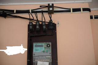

For those interested in finding out about 3 phase wiring, here is some info on the RenoKu.com website.
* Deciding on 3 phase or single phase wiring
* Photos of 3 Phase Wiring
In my opinion, it's troublesome to upgrade to 3 phase wiring later. This is because one needs to carry out internal rewiring for the house.
I think the most accurate way to determine if 3 phase wiring is needed is to count the max load at any one time of all the electrical appliances in the house. If say, 4 air-cons are turned on at the same time, then calculate the combined load. Not sure of the way to calculate this but your electrician will be able to give you a better answer. smile.gif

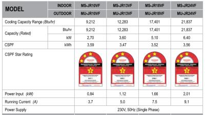

I plan to install 6 air-con to my new house, i wonder single phase electricity can be support or not? Thanks for your kind advice....
brutus
post Dec 1 2009, 07:56 AM
1,743 posts
6 unit of how many HP A/C? are they to be used simultaneously?

this will depend on what kind of a/c and what temp-range. i am running 6 a/c (total load 8 HP), 3 fridges, PC, laptops, TV, dishwasher, oven and some other stuff on sgl phase - no problem. but all electric is inverter/AAA energy rating. all used at the same time. temp range for a/c is 29,28,27 degrees only

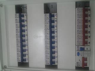

Here is my update thus far. The electrical contractor has replaced my ELCB and Main MCB with 3-phase version (EPS brand instead of Doepke), rewire for 3-phase and in fact removed 2 of my spare MCB to fit into the original box. They did not change the DB box. They also installed 2 additional cutout fuse at the meter panel. All that for rm850, I think it is a rip-off!! Call up the contractor again asking about the 2 missing MCB and missing Main MCB switch. The Main MCB is there but I could not locate the switch. I think it is hidden under the DB faceplate. She said she will ask another electrician to look into it.
I also asked her why the ELCB only shows 63A? She said she applied for 63A and not 100A. I told her if I just need 63A I would not change to 3-phase as it make no difference. Again she said she will check with TNB if still can change to 100A. Called up TNB again asking about diff between 1-phase 63A and 3-phase 63A and was told that 3-phase is better, more stable etc. Not the answer that I want. I think there is no difference as both provides same current. Anyone have different opinion on this?

TheUrbNorm
post Feb 7 2011, 04:36 PM
557 posts
Joined: Apr 2005
Sifu,
Can I know if my house is 1 phase or 3 phase based on the meter box above if you all can tell???
This post has been edited by TheUrbNorm: Feb 9 2011, 12:09 PM
jpaul
post Feb 9 2011, 12:04 PM
486 posts
Joined: Jun 2009
QUOTE(TheUrbNorm @ Feb 7 2011, 04:36 PM)
Sifu,
One
yi_min82
post Feb 9 2011, 12:58 PM
47 posts
Joined: Dec 2006
one

this my design..so far seem save my electricity bill...waiting my next bill.....got 2 DB 3 phase.....more stable......less trip when lightning..Attached File  DB_connector.doc ( 21k ) Number of downloads: 161

weikee
post Mar 14 2012, 10:02 AM
10k Club
12,019 posts
QUOTE(tomjason @ Mar 14 2012, 09:55 AM)
Can you explain why more DB less trip?
Save electric, have you try trip all the mcb or the 3 main circuit breaker, and see if your meter still run. Try it.
tomjason
post Mar 14 2012, 10:07 AM
866 posts
Joined: Oct 2011
normally before this...my area is lightning prone..usually when lightning normally will trip..but now no more trip...before this i put lightning arrestor at DB..the arrestor also kena kilat..now no more arrestor.
weikee
post Mar 14 2012, 10:13 AM
10k Club
12,019 posts
QUOTE(tomjason @ Mar 14 2012, 10:07 AM)
From my humble knowledge. lighting strike not related to the old or new live cables or neutral. Not even related to 3-phases or single phase. Very much on the soil, and earthing. Your rewire may have fix the earthing. It could also be your previous Circuit breaker is due for change.
tomjason
post Mar 14 2012, 10:21 AM
866 posts
Joined: Oct 2011
QUOTE(weikee @ Mar 14 2012, 10:13 AM)
my area is lightning prone area...i observed my old DB was not faulty.....the severity of lightning in my area is few month ago until the outside ceilling of my jiran pecah...
weikee
post Mar 14 2012, 11:01 AM
10k Club
12,019 posts
QUOTE(tomjason @ Mar 14 2012, 10:21 AM)
But it not related to DB, be it you running on Single or 3 phases. More of environment and other factor like soil content of mineral, height of the land area (above sea level) etc...

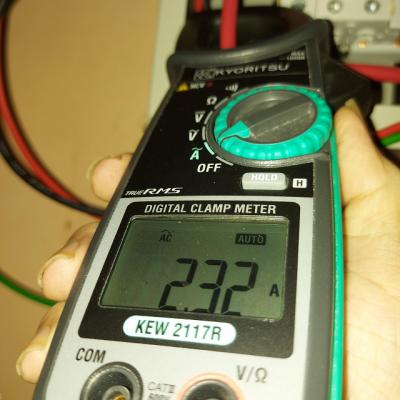

Any electrical background can explain about this. Let's said my house use 60A (limit for 1P right?), for 10 hour. How this translate into lower bill under 3P than 1P.. Does operating near phase limit is more consuming than operate half the limit?
Anyway, to measure the total amp I can just use DIGITAL AC CLAMP outside the house right?

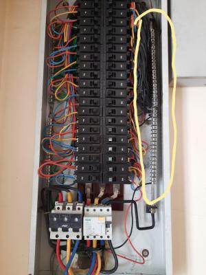

Hi
I have asked my developer to change my wiring from single phase to 3 phase. I was charged RM3200 for below job.
SUB-MAIN 3 PHASE
3PHASE DB
METER BOX AT GATE
SUB-MAIN FIRST FLOOR
Now they finish the installation of the DB Box. But I don't know if they use the good DB box or not.
The MCB brand is Wynex.
And it only have 15 fuse.
Can anyone experienced in this area help me? Is the price reasonable and is the material used is a good one.
Thanks...
weikee
post Mar 22 2012, 10:35 AM
10k Club
12,019 posts
Wow, 15 fused with 3 phases. I feel is over kill.

My parent house also using 3 phase (12 years old house), but the DB Box is much bigger using metal cover (schupa brand - from German)
But my DB box seems to be quite small with plastic fitting outside. looks cheapo to me... hmm.gif

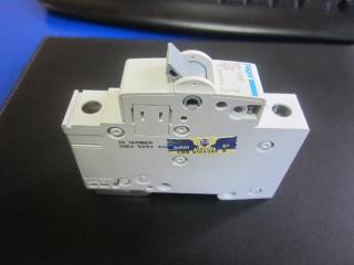

Eng_Tat
post Mar 22 2012, 09:28 PM
2,215 posts
Joined: Nov 2007
From: Cheras, KL.
this is the picture of the mcb, any way to know is clone?
Attached Image Attached Image
skng03
post Mar 22 2012, 11:39 PM
1,450 posts
Joined: Oct 2008
QUOTE(Eng_Tat @ Mar 22 2012, 04:18 PM)
just starting to survey for products... hager 20A mcb is rm7.80 each. is the correct price? while eps/maxguard or amber is just rm4. hager can be used in sg but eps brand is not approve in sg.
Its about there, cheap one eps/ABB pice @ 4.x-5.0
weikee
post Mar 22 2012, 11:50 PM
10k Club
12,019 posts
I know brand like ABB, Hager have difference made, price is also varied. So when buy ask where it was made.

Eng_Tat
post Mar 23 2012, 08:38 PM
2,215 posts
Joined: Nov 2007
From: Cheras, KL.
have no idea where is that hager made from, not written any where on the mcb, accept written made by hager. btw one inch white pipe can insert how many 4mm wires ideally. i know can the pipe sure can fit up to 12-15 wires. what is the different with grey pvc pipes?

I am currently thinking of renovating my house in USJ. one of the things i am thinking of doing is upgrading the electrical wiring from single phase to 3 phase, but not too sure whether i should do it or not.
I am looking to put in 1 (1.5hp) air con, 2 (1hp) inverter air con and 1 (1hp) air con plus a joven 50 liter water heater, plus a clothes dryer plus 1 electric oven.

what about 3 air con, 2 water heater and 1 oven? Do i need 1 or 3 phase? Does TV and air purifier takes into account as well?
Depend your Ac power. If 3 units of 2hp default is on the limit for single phase.

i think 2 of it will be 1hp unit and 1 2hp unit. But not all will be on at the same time. so 1 phase should be sufficient i supposed?
1 HP say 4 amps each, 2HP say 8 amps, heater say 15 amps each, fridge say 2 amps but only run short hours per day. Oven I can't recall think is about 10 amps.
So in total if you switches on concurrent is about 56 amps. Lights and TV maybe 3 amps. You are about there of single phases if you switch all the same time.

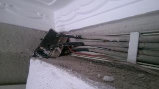

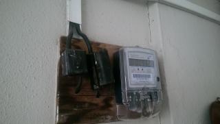

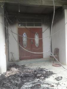

My house was caught in fire 3 days ago because of newly install TNB meter. Luckily there was no one injuired in this incident and only my shoe rack were burn completely,heavy duty tiles are crack, my ceiling turns black, fortunately I didn't park my car near there but I am really really angry and frustrated with TNB and contractor "Tai Chi" style working attitude. First this TNB blame us of overloading the meter. Come on lah...my husband and I were not around. Nobody was in the house. How to overload?
Then wireman contractor saying that not his fault, definitely can ask TNB for compensation. What he did? He took some photos, collect evidence and so on.....
Then he ask TNB come to discuss with us. You know what the TNB guy saying?
He said it caused by internal problem 'malapetaka' or is 'natural disaster'.
"The spark came from the TNB meter ..but... because of the shoe rack underneath then cause the fire happen." Then the contractor added:"might because of some papers and other flammable material putting on top of the rack."
Their negligence is jeopardizing our safety.

Have you ask what is the actual cause? The wire loose connection and cause sparking. Or the meter is fault. Try make a claim at the TNB office.
My friend sis house got surge and spoil some electrical applicance. Go TNB claim. First deny their problem. After point to some neighbour also have same problem, than start to admit. Probably they already know after many complain from same area. Now enjoying new TV, fridge etc..
When repairing, try to place the meter at the side of the gate. That will put the meter far away from the house. Most of the new house meter is beside the gate now.

That also one of the reason why I enggage TNB to relocate the front 4 black wires. In case of such incident, they don't have excuse that is my illegal modding.
mccool. sorry to hear this, most important no one was hurt and damage is on small area (hopefully). My mom distance neighbor had this issue lucky the damage saw low because it was discover earlier and the entire row of house power trip. They just came replace the burned wires and did not say anything at all.

It happen to my beside neighbour too. 1 night of nowhere, the wire joint connecting box catch fire and burn out. Just beside the house front door. Lucky a small burn out. This joint is extend by TNB when neigbour do renovation.
It is the connecting oxidise/loose. It will get hot and eventually melt and burn.
Normally a high voltage cable joint need to seal it properly with somekind of potting material.

Think also need to see where the supply is. If the house is first half of the entire row of the house it need proper "solder" or sealing material. If after that the supply current have drop, proper tight screw to join both the cables are good already. But they have to measure the heat for safety.
I have test using the laser heat measurement tool (borrow from my friend workshop), few round test the measurement on the join box look reasonable. hopefully stay like that.

It is the beginning wire come from the pole.
The measurement have to conduct at night to get the max result. Which is the highest load.

QUOTE(ozak @ Dec 13 2012, 09:11 AM)
Thanks for concerning. We will write a letter to TNB and our contractor, the spark started from the meter box. But I think we will loose since the TNB guy just came to look see look see and claim it's not their fault. He said we can claim but taking longer time. But we don't care, we will keep on pressuring the contractor and TNB.
My heavy duty floor tiles also cracked because of the temperature was too high.
For them, they can push everything. But they never think of our safety.

enriquelee
post Dec 16 2012, 01:25 PM
Don't ask for more, ask for COKE
10,510 posts
From: Atlanta
mccool, i feel sorry for you.
Have you find out the cause of fire? If really TNB fault, i think better go TNB by yourself rather than serving letter.

The wiring from the ceiling light got only 2 cable connecting to a plastic connector but the ceiling got 4 wiring, 2 others in green and black which I never touch when dismantle the old ceiling light. Can I just leave it there or could these 2 wires came out from somewer ?
Any idea what went wrong ? Thank in advance all sifus here.
Sorry, no pictures b'cos it is kinda dark and I go to work before the sun rise and reach home after sunset.
This post has been edited by madcow1: Jan 17 2013, 10:37 AM

This is the wiring problem I have now > http://postimage.org/image/4nbkuaojf/
Any sifu can help ?
The blue & black attached to the plastic connector and connected to both white wires for the old lights. So why now cannot turn on the power again ? Anything need to be done with the idle green wire and black copper wire?
Any if my new ceiling lights have this wiring, http://postimage.org/image/hjx3aakyf/72614645/ can I just simply plug to any of the blue & black wires attached to the plastic connector ?
Thank in advance for the help.
This post has been edited by madcow1: Jan 17 2013, 11:33 PM

Use connector to joint the black wire (neutral ) and green wire(earth), the other lights / fans not working because all these points r in same circuit, these 2 wire loop and link to each other

QUOTE(madcow1 @ Jan 18 2013, 09:07 AM)
Hi Sifu, thanks but I am noob in this, do you mean connecting the black copper wire with the green one ? There is 2 black wires there, one is fine wire and another one is copper type.
These is like asking a normal person do surgery. Very scary.
Please don't short the green with black. Your ELCB will trip.
Green with green
Black with black.
madcow1

Light and fan usually are looping, taking out the wires mean you have break the loop. Reconnect the loop.
Black to black
green to green

Thank Master Wei Kee for the info.
Actually I did not touch the other 2 wires not connected to the plastic connector, meaning there is no connector for the green & black copper.
You can see here both the green wires is connected > http://postimage.org/image/3s791gqzv/.
So where I need to connect the black copper wire ?

Pair the black wire together but first remember to off the main switch at DB or risk being electrocuted.
Green wire just attached to any bare metal at equipment.
The existing connection is correct except both black wire must be added together..

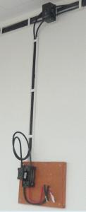

post Nov 11 2013, 01:57 AM
120 posts
Hi i am new in this wiring thing. May I know if the above pic the wiring is single phase or 3 phase? Thank you.

QUOTE(ryan3721 @ Nov 11 2013, 01:57 AM)
Not sure on this, but I guess it's Single Phase.
Cos mine is 3 Phase, I have 3 black box thingy, instead of 1
Single phase

QUOTE(l3iTi @ Nov 11 2013, 09:58 AM)
You are right, 3 phase will have 3 cut off fuse (Black box thingy), while single phase has only 1.
