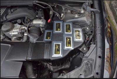

QUOTE(THE CLASS OF 13 @ Dec 23 2014, 10:10 PM)
Maybe the engine itself is sensitive to outside air temperature thats why we can feel the noticable difference between hot afternoon air and cold night air? But as you said seem like there is nothing wrong with our intake system as it is designed to suck cold air right?
If we're talking about ambient temperature affecting the engine itself, remember during normal driving the engine temperature is regulated at 80c-90c via water cooling, this is the most optimum operating temperature for the engine.
Therefore,ambient temperature will have little to no effect on the engine itself.
Engine oil temperature is different and is indicative of the engine's internal temperature, nothing to do with ambient temperature.
The gaga's intake is designed to suck in whatever air in front of it. It is definitely not a cold air intake.
QUOTE(davidke20 @ Dec 23 2014, 10:21 PM)
Hot air from surface to 4ft above are around 60'C mixing with exhaust heat blown by. So your car literally breathing atleast 50'C and above in the afternoon. Having heat wrapped the intake funnel/airbox is not a bad idea.
But then, does the insulation/wrap cool the air down in the intake funnel/airbox?
Like I was asking, isn't the air passing the intake system too fast to be affected by the temperature of the materials?
There is also the question of where is the ambient temp sensor located.
Yep, I think this would be much more effective than insulating the intake system.
Cooler air has a higher density, thus containing more oxygen per volume unit than warmer air(from WIKI). If the intake air is already HOT, given enough time to chill the air, the density wouldn't increase because that's the amount of air taken into the intake funnel whistling.gif So, basically you nailed it whistling.gif Heat wrapping doesn't change the combustion, but actual air intake temperature before the intake funnel does. In other word, make the atmosphere cold before you drive out, or plonk NOS whistling.gif To answer on behalf of cikgu CLASS OF tigabelas, water coolant is meant for cooling the engine down, has nothing to do with intake temperature. Older vehicle has a intake design of directing a funnel to exhaust manifold to suck hot air in the winter, whereas another intake funnel pointed between headlamp and radiator for cooler air intake during the summer laugh.gif On a general consensus, cooler the better but NOT freezing cold.
Have answered Quazacolt with honeycomb philosophy, not sure whether that will help. The trouble is, honeycomb structure will create more air restriction.

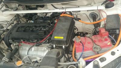

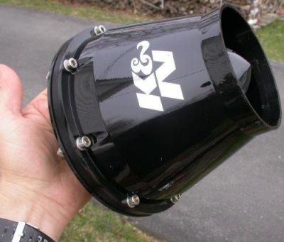

frm my car observe stock airbox - idling during traffic highest it goes is 69c lowest also ard 60-65c, while driving highest ard 60-62c lowest can get ard 52-55c.
Open Pod (my setup - without custom heatshield) - idling can go as high as 80c, lowest also ard 75c, while driving highest ard 65-70c lowest ard 58-60c.
Open Pod (my setup - with custom heatshield) - idling highest 70-75c, lowest 60-65c, while driving highest 60-65c, lowest ard 45-50c
Open Pod (my setup - with custom heatshield + CAI) - idling highest 70-75c, lowest 60-65c, while driving highest 50-55c, lowest 38-40c
Thts all base on the OBD readings...
TQ
P/S : will plonk back stock airbox and will try to do sumthing on it... dunno can be done or not... hmm.gif
This post has been edited by r3apers: Dec 23 2014, 11:57 PM

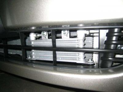

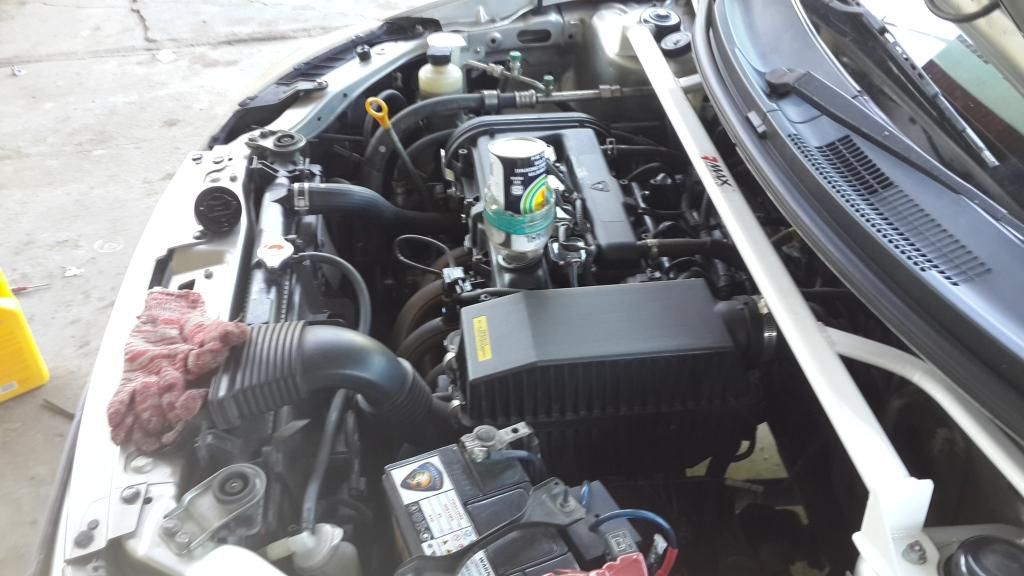

Guys, other than Intake temp, you can also add a cooler to your EO & Transmission Oil. You will notice the difference in a long run.

QUOTE(n3w @ Dec 24 2014, 09:59 AM)
What you mean by cooler?
Something similar to thisss
Got for Engine Oil and ATF
Engine Oil Cooler and ATF Cooler
Most Newer Versions of Proton Cars have this (ATF Cooler) like FLX, Preve, Suprimas.
But not in Gaga.
This post has been edited by dagreatdzul: Dec 24 2014, 10:21 AM
ATF cooler...like those CVT has...between the radiator and the bumper... iinm...
QUOTE(dagreatdzul @ Dec 24 2014, 10:19 AM)
But not in Gaga.
QUOTE(r3apers @ Dec 24 2014, 10:43 AM)
davidke20 remember the time u drove my car and u mentioned to me that my car transmission is smoother if compared to others? i guess this is the reason? my car ada CVT ATF cooler... whistling.gif

last time i bought brand Hayden for RM350. and that was like 3 years back rolleyes.gif
*p/s: looks like intercooler wooo tongue.gif

QUOTE(dares @ Dec 24 2014, 10:51 AM)
[QUOTE]
This one sure beng one but saw one gaga blm with front mount cooler look very geng leh sumore body color is white and contra with blue cooler

QUOTE(dagreatdzul @ Dec 24 2014, 11:16 AM)
haha dont put in front of bumper. put it inside bumper.
There are a lot of brands and sizes&thickness of the cooler,
Oic, dunno i think price nowadays sure increase by rm50 rggit ..saw one ad about rm400 dunno include installation or not..Where you located the cooler? Same place where flx cvtf cooler is mounted?

THE CLASS OF 13
post Dec 24 2014, 11:28 AM
171 posts
Joined: Nov 2009
QUOTE(Ziyad Iskandar @ Dec 24 2014, 11:23 AM)
Ecu firmware related problem i think..wait for otai to answer hehe

Edit: Starter motor PW812050 : RM431.41, pokai lo...  blink.gif  cry.gif

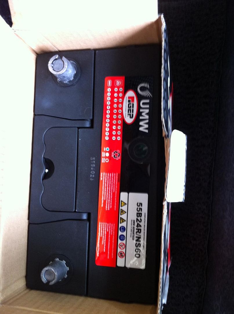

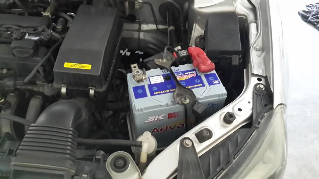

change battery... mine non cranking 12.4V but during crank 9.7V... after changing battery then ok adi...

although it is a Proton, but starter usually very very rarely will rosak one leh... hmm.gif
coolkwc
post Dec 25 2014, 11:57 PM
Fall in love with audio again.
3,112 posts
Joined: Jul 2006
Ok, tmr jump start 1st...from what i understand if battery flat, mostly the starter only emit 'click' once or 'wukeekekek' very slowly and u can see the light almost dead during crank, this is what i experienced 2 years ago. unsure.gif
davidke20
post Dec 26 2014, 12:12 AM
3 posts
Joined: Mar 2012
QUOTE(coolkwc @ Dec 25 2014, 11:57 PM)
It's a dual layer double bearing solenoid starter(compatible with Mits Gallant - Perdana). The symptoms as you described got 3 causes.
1) Battery not enough power. To rectify this, change battery. But according to you, volt meter during cranking is 11V++, by right shouldn't have this issue, so it goes to...below
2) Earth(grounding) weakness. Add an extra grounding cable can solve this.
3) If the wuataktaktaktaktak very fast, meaning starter solenoid didn't get actuate out properly. The sign of DYING carbon brush IN the solenoid. Experienced magician will pull an extra power wire from battery positive pole, plonk a relay and use the original kick start wire as trigger. Draw power from battery directly when you switch your key to START. Relay wiring and relay module + labor is about RM40.
Lastly, if the solenoid is totally gone, the carbon brush no longer usable... well you're outta luck. Get a new starter. Still, I think a jump start is necessarily just to test out whether it is really battery KO yawn.gif
coolkwc
post Dec 26 2014, 12:30 AM
3,112 posts
Joined: Jul 2006
QUOTE(davidke20 @ Dec 26 2014, 12:12 AM)
1. Yup, shouldn't be battery problem. Anyway, tmr jump start 1st.
2. Car adi have aftermarket grounding cable, quite low possibility caused by it.
3. No 'wua', only tak tak tak, not really fast, around 2 times/second, as long as i hold the key, it will 'tak' forever. Anyway, i believe this method is just for temporary right? If the carbon brush is start to die, means it will die eventually right?
Just now quite embarrassing, my house parking is slightly decline, today i reverse without start car 1st becos dun want my baby rouse from sleep, just reverse by released handbrake and start after that, only find out can't start, the car stuck in the middle of the road. Have to ask neighbor to push my car back to home. blush.gif
Hopefully is just battery problem, if not jialat.
This post has been edited by coolkwc: Dec 26 2014, 12:36 AM

davidke20

The "temporary" measure of putting relay on a dying starter, lasted me another 3 years(probably until today, another 2 years after car sold to unker choy) whistling.gif So..... yes it's still temporary measure whistling.gif

Ok, add one more symptom to battery KO.

ADD MORE for troubleshooting steps : make sure test JUMP START first. and you should drive around long distance without aircond to fully recharge it, just like unker davidke20 last time teach us. if problem again, might as well change it. OR can just straight away change for your peace of mind.
i also suspect your battery kong because last time me when last time noob try to jumps start with a gancil car. got TAK TAK TAK loud noise. last some fellow in satria said gancil not enough power to jump start a Gaga.
i also got experience cannot start car with TAK TAK sound. jumps start then ok.
btw, iinm yuasa battery is not shitty. 2 years for a battery is good enough i would say. i remember last time someone here got 1 year only use car ady kong. my CENTURY battery with RAMCAR technology now serve 1 year 3 months now.
now you got other options. why not tru use other brand e.g CENTURY MARATHONER, CENTURY ULTRAMAX, and summore got YOKOHAMA etc.
woofwoof a.k.a ruby1288 currently use CENTURY ULTRAMAX then later can read his comments about his battery when his battery failed later.
i know la your previous RAMCAR ori battery hold the longest record for more than 3 years geh, you so proud of it. whistling.gif
later will use CENTURY battery also because i know other battery such as YOKOHAMA, YUASA can also performed as good as CENTURY, only have doubt on unfamiliar/unknown brands.

i got two scenarios regarding battery weak/kong. first because my son switched on the headlamp before. that time iinm when crank silent only so it's totally flat.
second cannot start got TAK TAK TAK loud sound. that time parking at AEON AU2 again suspect battery kong. jumpstart car then ok. tomorrow morning check car can start. but due to thinking problem could occurred again, immediately change battery. but that time not thinking of drive around long distance to fully recharge it because battery already used up to 2 years and 4 months ady since first owned the car, so might as well change it.
so far century battery is my choice because CENTURY got battery assist so easier to find CENTURY battery than other brands.

I won't consider Ultramax, too expensive for that only 21 months warranty, battery <2years i would say is very bad luck, not to say that 21 months not even reach 2 years. I will buy Century Marathoner, this battery used in my Kenari, adi 3 years still running strong.

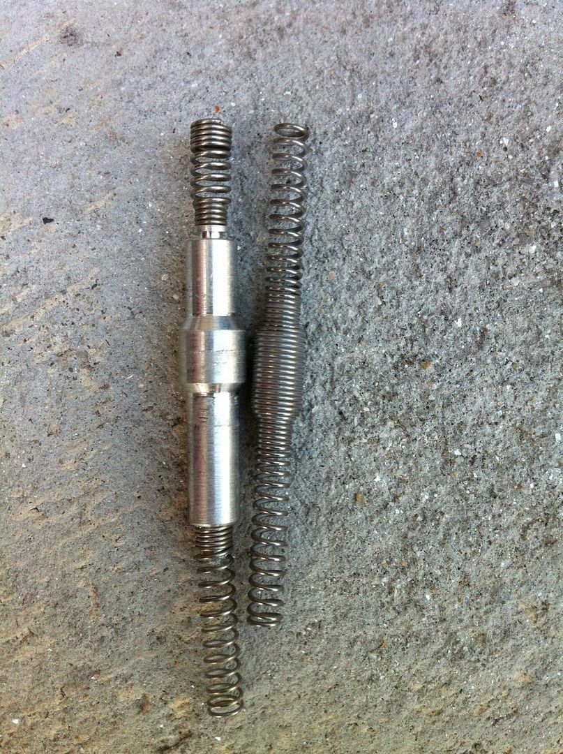

Ok question. Should do BEFORE koyaked or UPON koyaked?

before will be better. BUT, if koyaked oledi, need to see first whether can still be save or not.

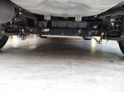

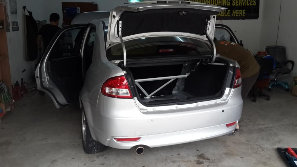

QUOTE
Review from dares,
I felt the opposite when I installed the bars on my FLX (well except the wallet part). I believe after installing the FSB and RSB, going thru bumps was actually MORE comfortable. Comfortable may not be the right word....the feeling is that you don't feel the rear end bouncing and twisting over the bump, instead it moves as one solid body. The nett effect is that the passengers don't get thrown left and right when going over bumps.
Or maybe the FLX chassis+suspension was not very comfortable like the BLM to begin with unsure.gif
Anyway for all new and old Gaga owners, if you haven't still, I'd consider strut bars to be one of the most essential mod for your car.
Late di, still typing this short review on the 3Max front & rear strut bars installed on my car this morning at Mahihi's place. yawn.gif
Great item! I second dares review that my car moves more solid'ly' over bumps and corners. I took a day trip up to Shah Alam, Klang, head to Mid Valley and lastly Petaling Jaya for makan makan and jalan jalan, pretty much cover 400kms of different types of road. Bumps and corners - high and low speed pretty much absorbed nicely with my stock FLX suspension and 15 inch tyres. Even my passenger for the day complimented on how solid the car moves over the first few bumps outside his workshop. brows.gif
Thanks for the good stuff! And to r3apers,dares,V12Kompressor who helped me & Mahihi with the installation, TQ too, you all are the funny buggers. flex.gif
n3w
post Dec 27 2014, 01:53 AM
350 posts
Joined: Nov 2009

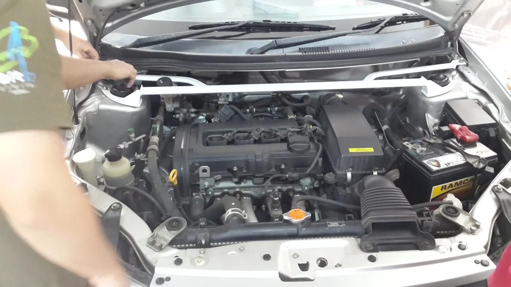

n3w

QUOTE(n3w @ Dec 27 2014, 01:53 AM)
ahahahaaha,sorry,was in the toilet making cake....glad dat u like it! thumbup.gif thumbup.gif
