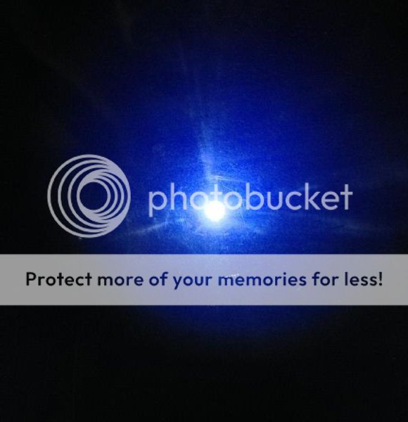

I apply with pad and remove w/ microfibre cloth but the swirl marks follows on how I remove the polish, if i do circular motion then swirld marks, if i do up down then up down scratches appear :/ I tried many different techniques but somehow still the same is it the polish? FYI i used turtle wax polishing compound, clayed and washed before polish too, just very puzzled here

Can share what car, year and color please.

Blue saga 1.6 FLX 2013

Possible the product that i highlighted might have worsen the surface since 'compound' is very abrasive product. As for your swirl might, could be due to product is not fully breakdown and you buff off thats why the swirl 'follow' your movement....

You mentioned the swirls followed the directions you wipe. Does the direction of the swirl change if you wipe in another direction WITHOUT polishing again? If so, then it could just be that you didn't remove the polish properly and they're just streaks from the residual polish. It could also be that the mf cloth you're using was saturated with the polish. Have you tried changing to another clean cloth and see whether it makes any difference? You can also try wiping them off with the help of a quick detailer or water or even a *very* weak mix of dishwashing detergent+water.
Not sure which TW polishing compound you're using, but it could also be that it's a very coarse compound and if you're using too much of it, the access compound would be picked up by the mf cloth and acts as though you're 'polishing' instead of removing.
And btw, the mf cloth could also be the cause. The mf cloth comes in many grades and quality. I find that those that are commonly found in shopping centre aren't that 'friendly' with cars clear coat - can easily induce some swirls.
Another question I need to ask: did you apply any pressure while buffing off/removing the polish? You're not suppose to need much pressure. Not sure about the TW that you're using, but normally, if done correctly, most polishes just needed a gentle wipe to remove.
If you want to DIY, try doing some troubleshooting as above. Hopefully it's not because the paint is very soft and easily damaged. I haven't heard of Proton's paintwork to be that soft though....

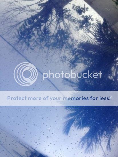

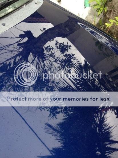

recently just started my diy detailing and found it is very interesting. bought black and decker kp600 polisher, because it is more gentle for a beginner like me? cause i read a lot review saying rotary polisher might damage car paint so i dont want to take the risk.
so my materials are Permanon Platinum pro pack, with brilliantshine shampoo and fusion x3, meguairs quik detailer, meguairs ultimate polish. my process goes like this (wash-clay-wash-polish-platinum coat first layer-fusion x3-platinum coat another layer.
i took 7 hours non-stop for an accord laugh.gif without realizing the time pass so fast.
but actually what i wanted to achieve is the mirror shine effect, and i am not achieving. is this because of the polishing part? i not dare to go too much for polishing yet because scare it will cause more scratchess.

i tried put the pictures in pc to compare but really not much different. maybe because the car paint still quite new? or the polishing not deep enough to create mirror shine? read a lot about orange peel leveling but seems too risky trying it.

I do something similar few weeks back but by hand and different products. Before start, it is a bit dull, swirls and scratches mark can be easily pick up by naked eye. After compound, the original color is back and most of the defects are not so visible. The shine will appeared after the coating and wax. You can separate the panel into half and compare the before and after.

Slowly bro...slowly. In order to achieve the 'mirror-like' shine, you'd need to remove as much defects as possible. Megs Ultimate Polish and the B&D is a good start. That is quite a safe combination, but it's also a very mild one. Maybe you should try a few more rounds on a small section of the car and see whether you can improve or not. Again, the more defects you remove the flatter the clear coat would become and the shinier it would be. Don't worry about harming the paint. If the car is new or had never been polished/compounded before, you should be safe using that combination for quite a few more rounds.
QUOTE(yuan415 @ Dec 4 2013, 03:59 PM)
You're quite right about removing orange peel. Only start thinking about that when you're confident that you are able to remove sanding marks.

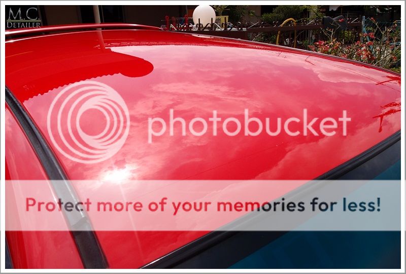

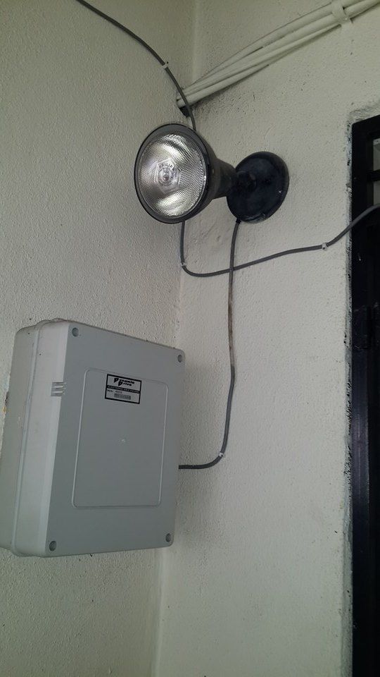

Lights finally done. Ample of shine even during night time detailing sessions biggrin.gif http://twitpic.com/dnkk31

QUOTE(Quazacolt @ Dec 5 2013, 01:10 AM)
Look 'shining' for the reflection but is it swirl free (try park your car under street (yellow) light) and check it out.
Detailing is not only talking about how 'shining' - layman term...we will talked about how GLOSSY, WET Gloss is it tongue.gif + how good is the water beading/sheeting the surface and how long the protection can last. icon_rolleyes.gif

oh no that car has not been washed for more than 2 months.
it's actually very dirty and there's nothing worth mentioning about.
just showing pictures of my new house lighting as house renovation is just done.
it is to prepare for my new car and of course i'll be using that parking lot for my detailing sessions smile.gif

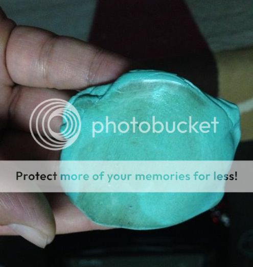

QUOTE(Brijesh @ Dec 5 2013, 09:18 AM)
Thank you for your advise. the compound i am using is the Polishing compound by Turtle wax. How you suggest i use the compound ?
I am really not sure how to handle the liquid clay bar. Do you know where i can buy a normal clay bar ?
I believe you are using this. If i were you i will stop using this since i have experience long ago with my previous car with this product (that time zero knowledge of detailing) somehow its left the paintwork a severe damage. I was using it with hand.
For clay, you can get it easily from Aeon or Aeon Big at normal price Rm29.90, sales time usually around Rm26.90
* There is Clay No.1 , 2, and 3 according to paintwork condition and colour.
Hope this help

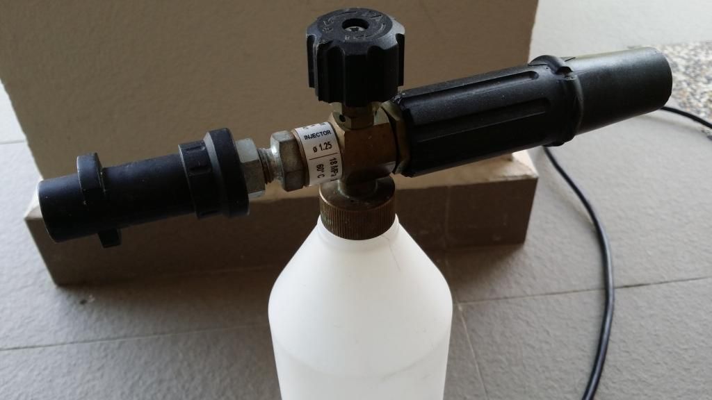

QUOTE(colinwong89 @ Dec 5 2013, 04:21 AM)
Guys, any reviews of the foam gun sold at Duragloss' website? This one operates with your hose pressure and not with a PW but will it create thick nice suds? Looking to expand the arsenal a bit... tongue.gif
http://estore.duragloss.com.my/webapp/wcs/...isplayErrorView
You won't get suds as thick as a 'foam lance' used with a pressure washer:
FOAM GUN WITH GARDEN HOSE
FOAM LANCE WITH A PRESSURE WASHER
But remember though, both has their own pros and cons.
For example, the foam lance would give thicker foam and cling better. Also uses lesser product. But expensive and takes more time to set up.
Foam gun gives out thinner foam, uses more products but less expensive and easier (can just use normal quick coupler).
I can list out a few more differences but, in general, the foam gun is more practical for 'normal' use. FYI, nowadays I seldom use my foam lance anymore.....
Oh...take note though...my house water supply pressure is very high. Even with normal sprayer on jet setting, I can shoot the water all the way onto the roof of my 2-storey house and can easily reach a horizontal distance of 50' ~ 60'. You'd get lesser foam than the picture I posted above if the pressure is lower.

QUOTE(Quazacolt @ Dec 5 2013, 09:15 AM)
Black car....hehehe....are those LEDs or normal ones? SO BRIGHT!!!
Anyway, a couple of suggestions.
1. Looks like the lighting is just at one side. You might want to consider setting one up on a tripod/stand for mobility sake so that you can carry it around the car. Also for working at the lower panels. Also good to have one for outdoor activities like barbeques, etc.... tongue.gif
2. I think it's time to get yourself a decent torch light for inspections. They're good for emergency situations too, like during black-outs, night time travels, temporary blinding 'unwanted' visitors, etc. Or maybe even a headlamp.

QUOTE(KrisMas @ Dec 5 2013, 09:58 AM)
eh i told you my car color during proton bola event? or you reading my mind? XD
and nah, they are just normal Philips Fluorescent lifemax with brightboost tubes at highest color temperature 6500k:
http://www.ecat.lighting.philips.com.my/l/...27982286536_eu/
so far should suffice... then there's the "xtreme" versions rofl:
http://www.ecat.lighting.philips.com.my/l/...27982386514_eu/
i think the brightness is due to phone cam not able to capture light properly and just glare the whole thing up sweat.gif
the only missing lightining are on the gate direction past the awning.
theres 1 left of the car (middle pillar, hiding behind the drain pipe) and 1 right of car underneath a covered/weather proof enclosure
2 on the back, 1 on the edge of the top awning (that round one)
so if i want to focus on the hood, generally i'll go in hood first, else the ass first as i got a lot more space to work with.
but yea the whole place lights up like a chrismas tree compared to neighbors so it's kinda attention grabbing in a way; more so i only turn em on during night detailing session and my house would be the only xtra bright one lol
2) ah good reminder, gonna start shopping for one from amazon or something. that famous damn bright one? iinm also not using conventional batteries? i remember we talked about it, just can't recall it at the moment on the brand name...

metaloid
post Dec 5 2013, 03:36 PM
konpeko~
1,972 posts
Joined: Jan 2008
i find it soo hard to take care of my solid red paint even when new :/ theres already swirl marks and i also find it hard to dry properly (water marks)...thinking of doing coating.
TSKrisMas
post Dec 5 2013, 04:41 PM
Joined: Jul 2010
QUOTE(metaloid @ Dec 5 2013, 03:36 PM)
If you're up to it (financially) go for it. But just remember one thing, as far as I know coating won't prevent re-occurrence of what you've mentioned. It's all actually come down to PROPER MAINTENANCE - eg. washing, drying, etc., which include products, tools and method/techniques. Even the best coating would require maintenance and that's why most of the places that do coating would sell you packages which include maintenance, of which you'd need to abide else the warranty would be void.

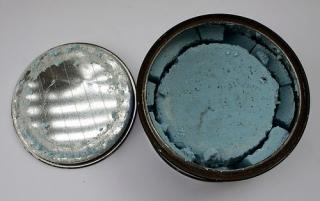

I'm using the 2nd polish, only 1 I see on the shelf at Ace hardware and Aeon Big. I usually let it dry and a white haze appears on it before i remove doh.gif maybe thats the problem, I'll try removing it straight away the next time i do, should be next year though, wont want to over-polish my paint biggrin.gif noted and thanks for advice smile.gif greatly appreciated
g88
post Dec 5 2013, 05:49 PM
1,631 posts
QUOTE(xffght5829 @ Dec 5 2013, 05:41 PM)
Look like you use too much of product until it 'cake up' and dried - harden. If too much of product apply, you would remove it while its still wet or use a damp cloth to move it - least pressure the better
xffght5829
post Dec 5 2013, 07:21 PM
16 posts
Joined: Dec 2013
QUOTE(g88 @ Dec 5 2013, 05:49 PM)
notworthy.gif notworthy.gif nod.gif nod.gif Got it, thank you all for advice smile.gif biggrin.gif biggrin.gif thumbup.gif thumbup.gif

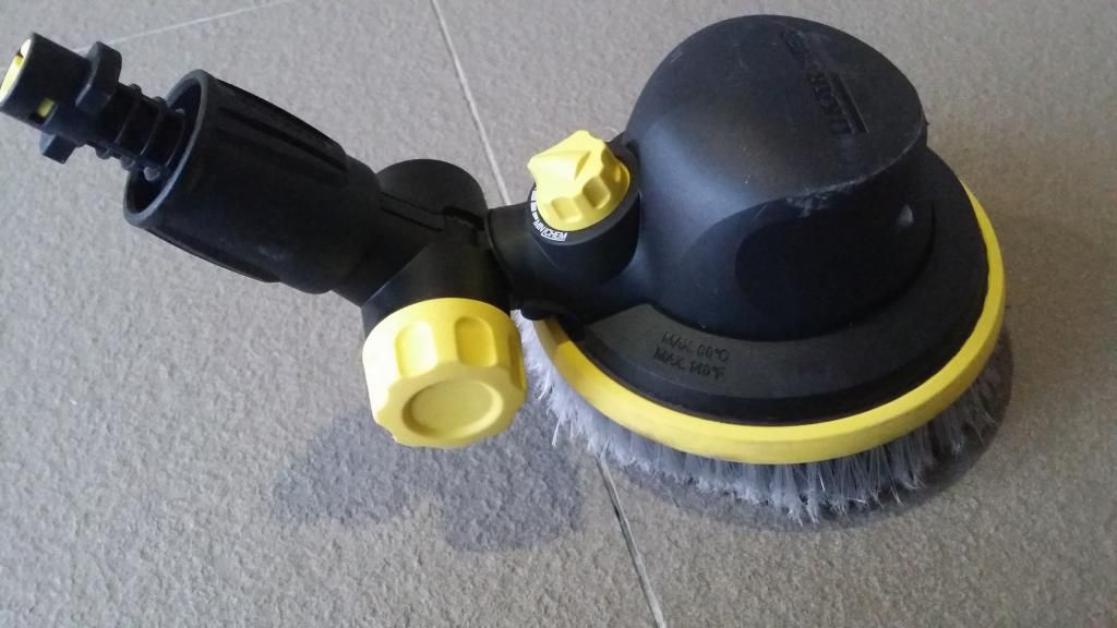

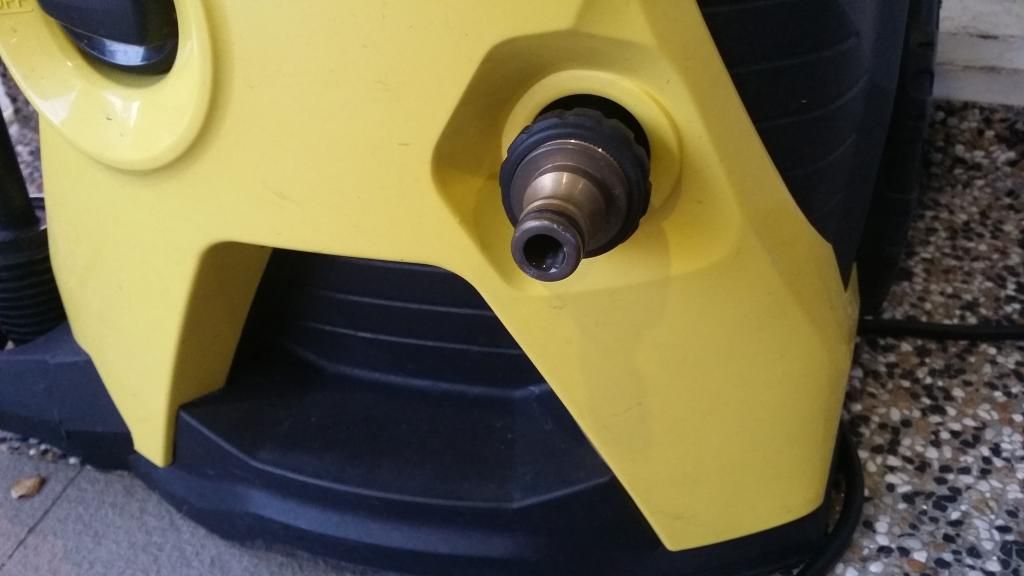

QUOTE(ikan_semilang @ Dec 10 2013, 01:18 PM)
I think I've seen this (or something like this) at ACE Midvalley before....

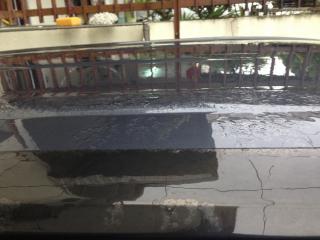

Wednesday was Selangor holiday, wash the car and evening raining, Thursday also raining. This morning have a close look at the car's roof and found out a layer of dark oil stain is on the it. I rub it with my finger and here is the picture.

looks like tar/road film that etched into the clear coat...

It is not into clear coat yet. I can rub it off easily with finger. I guess it is air pollution that being down by rain.

Normal...for this situation I'd normally start with normal wash with double the shampoo dilution...or mix 1oz of APC into the shampoo mix. I'd also have my spray wax in hand to top up afterwards.

I have a car that is park outdoor most of the time. I do wash it regularly , but the window and door rubber trims is drying and hardening. I tried dressing it with normal silicon spray that found at supermarket, but it didn't last long. Is there a better product or solution you know? Thanks.

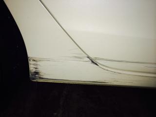

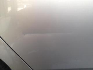

Guys, i got a slight dent on my city at the back seat door. Any place recommended to fix it at a cheap price?

QUOTE(kww @ Dec 15 2013, 09:38 AM)
There might be....but unfortunately not readily available here....1z Einzatt Gummy Pfledge (not sure if i spelled it correctly). I think Swissvax has something also but can't remember what.

QUOTE(stupid_cupid23 @ Dec 15 2013, 05:33 PM)
That looks like an expensive 'dent' to repair....all I can say is good luck...

Currently I'm using Meguiars White Wax (carnauba wax). I just waxed my car last Sunday. 2 days later, on Tuesday, it was a very heavy downpour at the place I park my car when I work. Then when I went to collect my car, I noticed that there are a lot of dark water lines washed down my whole car. It seems the wax is not working well in protection at all. Those looks like the wax melted and mixed with dirt from the rain water.
And today I washed my car. It seems to be those dirt are sticking to my paint. @_@ Washed but cannot help much. After washing, I used Meguiars UQD trying to clean up those stains. Took SO MUCH of effort to clear those dirt marks.
I wonder, is the "carnauba wax" can be melted and become even a dirt magnet? Or it is supposed to be melted and washed away, and those dirt marks are due to no more wax protection on my car?

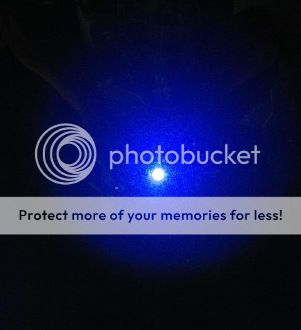

Have a question to consult all the sifus.
Today I was working on a friend's car - Toyota Corolla. Using Meguair's Ultimate Compound with a hand applicator pad. I tried to remove the swirl marks but I failed to do so even with 4-5 passes.
Is it my technique incorrect or the swirl marks are too deep to be polished by hand? (The car has not been polished for like more than 3 years I guess)
TSKrisMas
post Dec 16 2013, 09:08 AM
Joined: Jul 2010
When you say 'failed', do you mean the swirls are not budging at all or only slightly improved?
If there is improvement it could be that the swirls are too deep and would be tedious to do by hand.
Of if there's no improvement or just slightly improved only, it could be that the swirl is deep AND the paint is hard and it would need a more aggressive approach with a machine.....

QUOTE(KrisMas @ Dec 16 2013, 09:08 AM)
I guess this was my case...i tried 3-4 passes with different pad..but the swirls and scratch are still there..there was only a minimal improvement...my shoulder feels like wanna tercabut edi..guess the cc is hard and need to correct it using machine..unfortunately i dont have one..and so rugi when i cannot join dit yesterday..if not can consult our sifoo during the dit wink.gif
www.dent.com.my look for Jerry - he did my door PDR well, 99% dent vanished

Did it for a car of mine too - a bit expensive but a good job done.

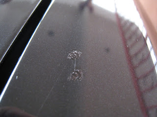

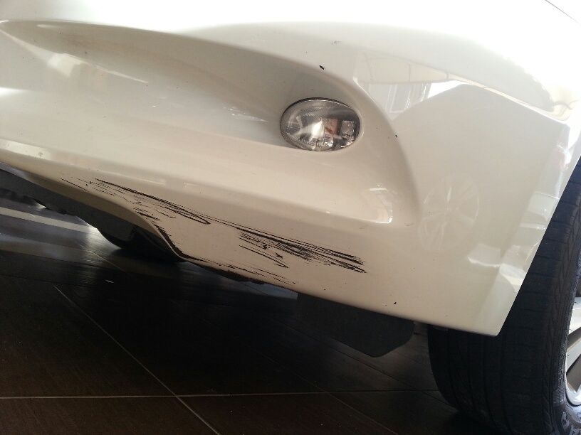

Need help...
izzit correct way - paint basecoat 2-3 layer -> clear -> wetsand -> compound -> polish?

QUOTE(ikan_semilang @ Dec 16 2013, 02:02 PM)
Need help...
I am bit confuse with your statement "paint basecoat 2-3 layer -> clear -> wetsand -> compound -> polish?"
Your first image already touched primer = mean paint already gone.
2nd image look still fix-able.

respray whole car LOL
don't fret, my car got tens of those stone chip, petrol pump, and motorcycle scuff marks

1. Did you perform a good surface preparation prior to apply wax ?
2. Carnauba wax 'only' look good - product deep gloss by naturally it doesn't last long moreover we are in acid rain climate.
3. Due to Point 2 alot of ppl have choose to use synthetic wax compare to Carnauba as there last much longer and easy (apply) and easy (buff) off
4. For your case, i believe your protection layer has been washed off my the heavy downpour and left with watermark.
5. In order to move water mark, usually you would clay or polish off after a wash, UQD is to mostly use to remove light dust and finger print only.

Solid white paint?

I just polished with Meguiars Ultimate Polish last month by hand. Never clay before. First time buying, and after finishing this carnauba wax I will change to sealant already. Now just don't want to waste, thus wax every 2 weeks as I noticed the protection is easily washed off.
QUOTE(KrisMas @ Dec 16 2013, 08:00 PM)
Solid white paint?
Pearl white.

There's a slight improvement. Some significant swirl marks are gone after polish.
Okay, I will try more aggressive approach next time and see the result. Thanks rclxms.gif rclxms.gif

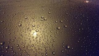

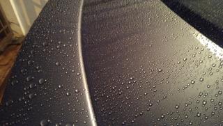

Just sharing the result of CQUK. Spent morning and evening detailing car. biggrin.gif

QUOTE(MyWifeCar @ Dec 23 2013, 04:41 PM)
So....how easy was the application?

This morning saw a cat climb on my car roof than jump on my front hood, sexily walking down.... And it slips, sliding and tumbling down. I was RLOF and WTF.
I wax it last week, I guess it is still very slick. Here is the picture showing the skid mark. It leave some scratch on my car, damn....

Karcher K2.050 RM279 it's good bargain?

Sifus,is this fixable by using clay+polish?
My mom's car got scratched by a lorry before this

Your damage has already gone until the primer.
You'll need to paint touch up first.

U mean need to spray paint?

For your case I suggest you bring to a shop to repair.
You can actually get touch up paint and apply it very gently using a very very small brush (some people use toothpick sweat.gif ).
After applying touch up paint (may need a few applications) you'll need to wet sand the area and then use compound on it.
This is quite challenging if you are new to detailing.
Niceyyyy......
Looks more like a job for paintshop....the paint had been scrapped & need to put some new one on. Could do some touch-ups but it'll still look obvious....

QUOTE(carl90 @ Dec 25 2013, 02:39 PM)
Dun think its possible...as paint has gone

QUOTE(g88 @ Dec 25 2013, 09:38 PM)
Thanks biggrin.gif will do

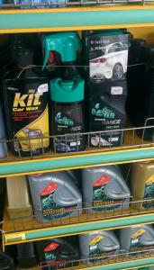

QUOTE(efan @ Dec 30 2013, 03:41 PM)
i see.. i tot only got at hardware and car acc shop.
no wonder i cudnt find it.
Saw a few at Aeon outlet at car acc section

post Jan 2 2014, 10:15 AM
1,609 posts
Yesterday I washed my car.
About a 1 week after polishing it.

omg -.- am got myself some duragloss products from Pasaraya Megaherbs in Taman Megah lol.... wtf mang Pasaraya XDXD

QUOTE(acefreakz @ Jan 3 2014, 01:51 PM)
Just last weekend I was there looking for some stuff but could not find any.
Is it the same location where they put Kit Car wax and shampoo near the front entrance opposite the cashier?

QUOTE(jchue73 @ Jan 3 2014, 05:28 PM)
They don't carry much stock the last time I checked - I would try ordering online.

post Jan 4 2014, 10:02 PM
1,609 posts
Want to ask the experts here about water beading
Is this considered lousy, poor, average, good, execellent?
This post has been edited by CoffeeDude: Jan 4 2014, 10:03 PM

TSKrisMas
post Jan 4 2014, 10:31 PM
Joined: Jul 2010
I'd rate that as 4/5. Nice one.
CoffeeDude
post Jan 4 2014, 10:45 PM
1,609 posts
Thanks since I'm still new at this at least I'm satisfied with the end results.
The water beading with this product is definitely better than the Meguiars Carnuba Wax I've tried last time.

QUOTE(windskill @ Jan 5 2014, 09:59 PM)
Seems like Opti-glass sheets water faster than Dodo Juice Supernatural Infinity Sealant. Or perhaps they use more water so it gives an "illusionary" effect? hmm.gif
What CoffeeDude says is right, this is just video and not a proper test environment. Like most people say, don't believe everything you read/see on internet.
There are other very good sheeting example from others, try and search for krismas video in v2 thread.
But I did make a mistake when apply this coating, my last clean process was done using DG501 before coating. You learn something new everyday...
