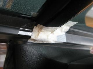

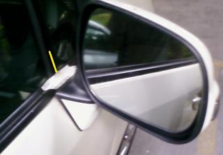

Wind Noise on Driver Side/Front Left Passenger Windows
Cause: <80km/j - improper rubber lining at windows/door; >110km/j - aerodynamic problem
Solution: complaint to P2 SC, or DIY refer HERE
Cost: If under warranty - FOC from P2

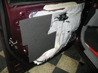

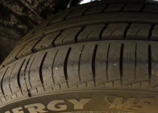

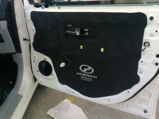

Noisy Cabin
Cause: Bad Soundproofing and Noisy Stock Tyre
Solution: Change Tyre and Install Sound proof
Cost: For tyre, can try Continental CC5 195/55/R15, RM200+/pcs; Soundproof starting from hundreds to thousands depending on material and the area covered.
Other Comment: Effectiveness: (1) Tyre (2) Soundproof 4 doors>roof>front bonnet/back trunk door>flooring

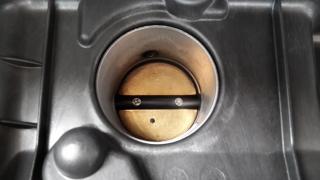

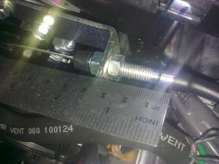

Underpower/Slow Pick Up (Cause 1)
Cause: Loosen/Too Long Throttle Cable
Solution: Tighten the throttle cable, DIYers please refer below
Cost: File complaint to P2, no charge

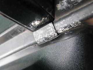

@wtm0325: Thank you for consolidating the common problems from this car...
my rattling sounds came from the side of the front passenger seat's door pillar sad.gif it's freaking annoying... I knw it's a hopeless battle if it is being rectified at our SC, but I will try...
by the way, our car is just less than a month...

Curious though... I read from here that more torque can be achieve by increasing the height of the gas pedal.
Has anyone else done this minor mod before...?
I did notice my sister's myvi is so torquey that it accelerates like a 2l engine with a somewhat heightened pedal - everytime I drive her car, my foot goes AWOL after extended drive...
PS: Apologise if you guys cannot reach the link, only for registered MAOC members only... sweat.gif

QUOTE(satanas @ Sep 5 2011, 12:07 AM)
common problem... B-pillar rattling sound... I practically had someone from a workshop who was kinda enough to spare some Insulflex to dampened the friction between the entire length of the plastic cover and the metal frame.
This post has been edited by Eithanius: Sep 5 2011, 12:15 AM

Yes, it's a common problem sad.gif I will try to find some accessory shops that can help us... it's kinda hard to find some decent shop if your a stranger sad.gif
Thank you for the input Eithanius, I do hope that your problem with this car will be ok... I did read almost all of your posts...

QUOTE(satanas @ Sep 5 2011, 12:19 AM)
Btw, if you're the DIY type, you can get some Insulflex and dampened the B-pilar yourself... I've seen them did it, it's not so difficult actually...
At the same time you can also refer to some pics posted by wtm0325 on the previous thread, use some of the Insulflex material and fill some of the gaps that may cause rattling noises.
runemastertan

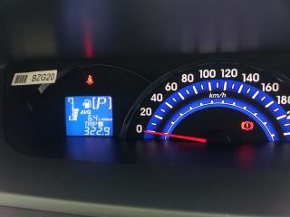

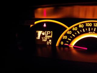

I got a questions about the Alarm System.
Normally, when we lock our car it will shut down the lock &
there is a Lights blinking that shows the car is armed.
I saw there is only 1 light in the meter blinking (red), is this the indicator of my alarm is armed?
Buy my concern is, even I just switch Off the engine (while I'm still in the car), the light already start blinking. I was thinking, I'm not even press my alarm to shut the door, it already start blinking.
So, is this the Alarm Armed indicator? If not, where is the indicator?
or this car has no indicator at all?
Then, what is this light blinking about ???!!!

QUOTE(Eithanius @ Sep 5 2011, 12:07 AM)
This can be done, suggest you ask foreman, but I can teach you oso if you want to brows.gif brows.gif brows.gif

QUOTE(zsnipes @ Sep 8 2011, 12:25 AM)
Mine only blinks when lock, double confirm later

Just tested.
Once Switch Off the Engine Key, the ALARM LED Armed (inside the meter area) indicator started to blinking. Then move outside the car & press the Alarm remote, it is also blinking the same speed.
So, is the Alarm Indicator faulty ?

QUOTE(zsnipes @ Sep 10 2011, 03:24 PM)
Just tested.

Some of the Alza are underpower becoz the string that connects to engine (I dunno wat u guys called) are too long. It is not meant to increase the torque from the specification, but to make the car more responsive. tongue.gif tongue.gif tongue.gif

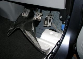

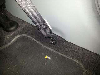

11 Rattling sound of loose part near driver seatbelts on B-pillar = Problem recurs. Fixed outside
If I am not wrong, the red light usually indicate that the immobiliser part of the alarm is on. Do check if your car has an immobiliser.
For Honda cars, you will get this red light blinking due to the arming of the immobiliser. You do not need to turn on the alarm.

2 - not sure how it loose, can snap some pic?

25 - quite curious how and where it sounds?

25 - i'll take pics

BTW, how is the average FC for alza? I'm looking between this and the Myvi 1.5.
My wife Myvi EZI now is going to be 6yrs old soon and FC is about 9-10KM/L or RM50 for 250km. 90% for residential area drive ie to/from school and lots of idle and waiting time. Everyday almost 45m to 1hr waiting. If I drive it to highway, it get pretty decent about 12km/l.
So if the Alza able to hit above 12km/l on normal city drive, at least it should be better than Myvi 1.3 otherwise I will get the Myvi 1.5
Eithanius,
As for all the problem listed for Alza, I say a lot of them you having wrong expectation....You will most of the problem even for 200-300k car...
mine around RM50 for 300km-350km
350km use more in highway
300km mainly in KL city drive
if special jam (concert/soccer times) case & wait till nuts, i think around 250km

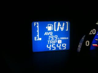

Baru first time try. Before filling with BHP, was with Esso. Previous tank did 420km with 106km range left. Just refill, did 386km with 186km range left. Not a good comparison yet coz 80% city drive, 20% highway. Previous tank 95% and 5% respectively. Have to wait until the car comes back, refill a few round baru tau... brows.gif Car masuk kilang again tomorrow... doh.gif

QUOTE(Eithanius @ Sep 25 2011, 12:09 PM)
Ur Alza is very petrol saving, mine average only 450km nowadays, always drive like bull brows.gif

How you guys measure...? Refill to refill...? How much of range left...? blink.gif
Me average 420km city drive if range down to about 100km, and I don't think it will go for another 100km. I've tried asking P2 guys to see how far can they go, they don't even know... My max was 463km...

is rite this
When u pump full oledi, reset the meter and run. On the second pump, use the mileage and divide with petrol you just pump. E.g. Ur mileage recorded for the first pump is 400km. On second pump you fill 35 litre. Use this 400km divide by 35 litre and times 42 litre. Why? Becoz you just use this 35 litre to run 400km. Times 42 litre shall be the full tank petrol consumption. brows.gif
= Yup, I also got
== NIL

13 Rattling sound from rear seatbelts when going over uneven roads
= Yup, I also got
== NIL
= Yup, I also got
== NIL
+++ Solved it with some Insulflex...

17 Noisy tyres
= Acceptable, cannot compare with good one
== I must find the budget to change this, not acceptable but it is silverstone.
+++ So bila mau tukar donut, kita gi sama k...?

You better ask service centre to adjust the throttle cable for you rather you do it yourself.

QUOTE(pciericagp @ Oct 6 2011, 02:18 PM)
Tried before, adjustment by Perodua SC no improvement one...

I adjusted to max, not sure about you but mine got different after adjusted.

I'm getting that stupid jerky acceleration again. Either Perodua f***ers screwed up on the throttle cable adjustment, or they gave me some Denso Iridium duds.... vmad.gif

just finish the MAOC DIY fire protection sound proof today ..

QUOTE(Eithanius @ Oct 9 2011, 10:52 PM)
eh .. this thing really personal feel loh. RM230 DIY how to compare few grand or more professional material and workmanship sweat.gif
BUT! it really better than before, coz my case not that worst compare to others. and engine noise less jor smile.gif
some car owner say got BIG different after the DIY.
and knowing how to dismantle how install the 4 doors is important to me.

QUOTE(tyenfei @ Oct 10 2011, 08:44 AM)
few grands or more professional material and workmanship is becoz ppl like me really crap on DIY mah, so have to rely on others lor, and pay a heavy price for that... doh.gif
result is still the same...

QUOTE(Eithanius @ Oct 10 2011, 09:53 AM)
I'm still waiting to change my 4 donuts before deciding whether I should proceed with SP'ing the firewall and floor...
got different lah, but may be not for people like u work in audio section.
right now, motorcycle pass by no need turn my head to check the window brows.gif

QUOTE(Eithanius @ Oct 10 2011, 02:53 PM)
How does the DIY SP stack up on the noise from big-ass heavy vehicles...? Especially lorries and busses...?
I feel like adding more on mine, but the experts say better not, else cannot gauge what's outside, and may amplify certain frequencies inside the cabin...
To be frank, I've spent grands, the result is there, external noise is less... but somehow I feel it's still not as quiet as my dad's Camry... the tyres are killing me...
aiyo, camry mah sure boleh then alza
i'm sure u apply SP on the floorboard. but still if using this silverstone .. the "stone" knocking sound very clear loh laugh.gif
and doesn't mean apply full body will get good result, different material to absorb low, medium , high sound then it will be very nice. brows.gif

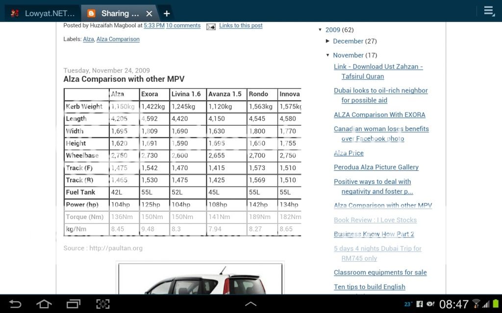

Engine Code: 1NZ-FE (Used in Toyota models only!)
http://en.wikipedia.org/wiki/Toyota_NZ_engine
Engine Code: 3SZ-VE w/Toyota VVT-i and Daihatsu DVVT
Toyota Passo Sette / Daihatsu Boon Luminas / Perodua Alza
Toyota Rush / Perodua Nautica / Daihatsu Terios / Toyota Bego
Toyota Avanza
Toyota bB
Daihatsu Materia / Coo
Daihatsu Boon / Perodua Myvi SE
Daihatsu Luxio
Daihatsu Gran Max All Series Pickup / Van (You can saw it was running around Malaysia)
http://www.daihatsu.com.my/html/vehicles_panelvan.html
3SZ-VE, DOHC EFI 16V DVVT, Timing Chain
Capacity = 1.5L, 1495 cc
Bore = 72 mm
Stroke is 91.8 mm
Compression ratio = 10.0:1
Output = Max 80 kW (109 PS), 6000 rpm
Alza and Myvi detuned to 104ps
Torque = 141 Nm, 4400 rpm.
Featuring VVT-i / DVVT

post Oct 18 2011, 11:57 PM
74 posts
The best figure shown when trip to penang
pciericagp
post Oct 18 2011, 11:59 PM
74 posts
Current figure after RM 62.00 filled

Added on October 20, 2011, 12:26 ambefore service 20,000km 8.2 L/100km
after service 20,000km 8.7 L/100km
city drive only....
This post has been edited by jackielee: Oct 20 2011, 12:27 AM
n8210
post Oct 20 2011, 07:33 AM
2,678 posts
Joined: Mar 2005
If I go on long distance within the city like KL-Klang using highway, I can get 8.2
If I go on long distance within peninsular like KL-Kuantan, I can get 7.6
Mostly city drive where there is a lot of cars and traffic lights, I get only 8.8
tyenfei
post Oct 20 2011, 08:16 AM
A Ku La Ma Tata
2,230 posts
Joined: Jan 2006
From: K. L.
I don't think that AVG accurate ... my range from (7.7 to 9.1)
So I only count by amount of Fuel I pump full. Then divide by KM I used.
Latest 2 time get
1. RM0.14/KM (4 adult 2 kids, OTW back + 1 more adult) ( 80% highway, with VS + GC )
2. RM0.142 /KM (3 adult ) (80% highway, GC without VS )
Just for reference, I believe that road condition, Tyre pressure, weather all should count into it but ...susah lah .
This post has been edited by tyenfei: Oct 20 2011, 08:16 AM

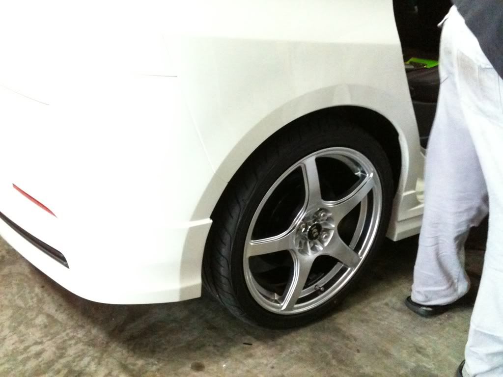

http://www.kouki.co.uk/utilities/visual-tyre-size-calculator
Added on October 20, 2011, 7:17 pmXM2 or CC5?
I want quiet and durable. They last more than 20k each?
Added on October 20, 2011, 7:46 pmStatic loaded radius, outer diameter and rolling circumference

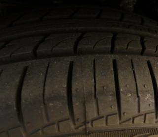

These three measurements are all important to consider when talking about wheels and tyres. They're all interlinked. Straight from the manufacturer, a tyre is circular and it's outer diameter (OD) is based on this unladen, perfectly circular condition. Because tyres deform under load (flatter on the bottom than they are on the top when taking the weight of a car), the vertical radius of a tyre under load is not half the diameter. It's typically about 44% of it (from the centre of the wheel to the road). In addition, a tyre doesn't roll like a solid wheel; the steel or fabric belt 'rolls along the ground' like a caterpillar tank tread does. Because of this, the rolling circumference of the tyre isn't quite what you'd expect. The closest approximation for this value can be calculated by taking the outer diameter, subtracting twice the tread depth and multiplying by PI. Roughly speaking, that's 0.96 x OD x PI.
Now why is this magical value so important? If the rolling circumference changes because you've mismatched your new wheels and tyres, then your speedo will lose accuracy and the fuel consumption might go up. The latter reason is because the manufacturer built the engine/gearbox combo for a specific rolling circumference. Mess with this and the whole thing could start to fall down around you.
Read more: http://www.carbibles.com/tyre_bible_pg4.html#ixzz1bK0Lyyc6
Added on October 21, 2011, 2:28 pmWell, changed to Xm2 already. And the shop immediately show me alignment got problem. Need to adjust chamber screws.
This post has been edited by n8210: Oct 21 2011, 02:28 PM

I've always get the impression that Alza have serious alignment problems... Does that mean chamber screws are a must...?
n8210
post Oct 21 2011, 07:32 PM
2,678 posts
Joined: Mar 2005
Altogether is RM225 x 4 donuts lor. I didn't do the chamber screw. I recall another forummer say no need, no such thing. Anyone can confirm?
Added on October 21, 2011, 7:33 pm***DO NOT LET THOSE GUY TO ADD CHAMBER SCREW TO IT, NO SUCH THING THAT CHAMBER RUN CAUSE JAPANESE ENGINEER NEVER USE IT AT THE WHEEL!!!***

A bit cacat liao i think my average...compared to my normal driving...i get around 9.2 ltr / 100km...dunno how i get this...but was in a shock...but my feet also heavy...haha...iridium and K&N does give abit of a difference...
What app u use that liao?

9.2L/100km is a bit on the high side. Auto Transmission?

QUOTE(angelbratz @ Oct 22 2011, 02:33 AM)
RoadTrip...

QUOTE(n8210 @ Oct 22 2011, 09:32 AM)
Yup...auto transmission...

I think any new tyres would give you less noise. But in my personal experience, pursuing this path is meaningless. It is, in the end, a lower quality car priced wrongly. We can add materials such as insuflex to cover (half) of the whole side doors. What about the windows?
So first, it was very noisy. We can hear motorcycles, lorries, etc... after added insuflex, then we can clearly hear the tyre/uneven road noise. So I change the tyres. Now, without the tyre noise, I start to hear the motorcycles, lorries, etc again, because the window sides are still not properly "patched".
To expect a premium quality car's experience while driving Alza is not impossible, but definitely need a lot of investment in terms of money and effort, just to make all the short comings less irritating.
I may look into adding foam, getting a VS, or swap both of those expenses for a soft-turbo kit. But that is all I would invest in this darn car. Any more investment is meaningless, cos I might as well look at a decent second hand WV.

make some effort to reduce noise, sure get some results. actually insuflex is not the best, cos it is soft. you need more than one layer of material, meaning a combination of soft and harder materials to counter the noise. But don't forget, this is just half the door! A lot of noise comes in from the window too.

tyenfei, take pictures of your tyre and show us. See your bunga.

QUOTE(n8210 @ Oct 24 2011, 05:48 PM)
blink.gif so interested with my tyre's grid ?
ok post tomorrow. but after nearly 6 month use .. sweat.gif about 10k mileage not much lah

post Oct 28 2011, 07:39 AM
1,796 posts
Joined: Jan 2005

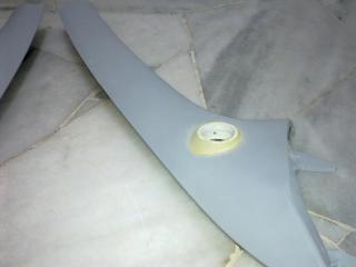

Attached Image Attached Image
The culprit is the rubber line near the side mirror pops up a gap for the wind to flow in. I seal it with masking tape and so far no wind noise when speeding at 140kph brows.gif

post Oct 28 2011, 09:17 AM
2,678 posts
Joined: Mar 2005
That's something engineers could not find and solve? Pathetic.
tyenfei
post Oct 28 2011, 04:59 PM
A Ku La Ma Tata
2,230 posts
Joined: Jan 2006
From: K. L.
QUOTE(wtm0325 @ Oct 28 2011, 07:39 AM)
LE from MAOC told me the same thing. He gave me the black sticker for 2 weeks already ... still keep it inside my compartment sweat.gif
