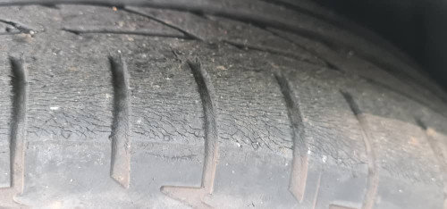

is 3-5 years old unused tyres kept in warehouse away from sunlight still safe to use on road?

QUOTE(amduser @ Jul 10 2022, 07:57 PM)

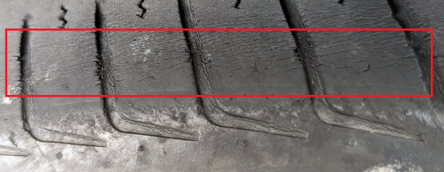

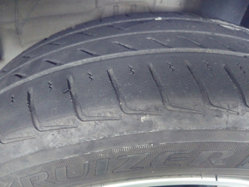

In general yes, it should be safe to use. 2 points here
1st
The compound usually gets harder over time but this is usually not relevant for summer tires as their wet/dry braking distance do not differ much relative to the age of the tire. Winter tires are a different story as the compound softness plays a big role on ice/snow braking.
2nd
As you keep your tires in a high humidity condition there is a chance that you might see this phenomena "wax blooming". The rubber compound usually contains anti-ozonant to protect tires from oxidation. Depending on your storage conditions migration could be triggered and you will see brown or waxy surfaces on your tire surface after keeping them for 1-2years in a hot & humid warehouse. This could lead to complaints and so on but this is perfectly safe and does not have an impact on perforamnces.
Hopefully this answers your questions.

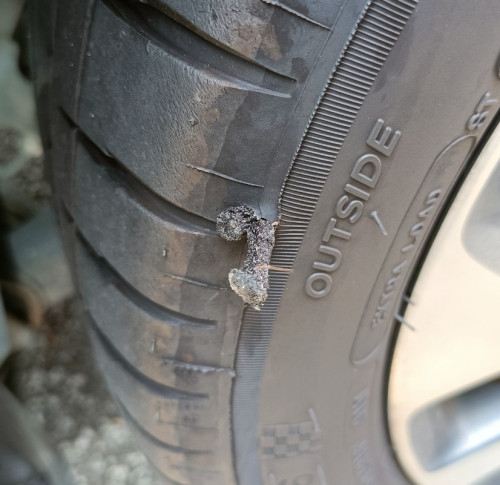

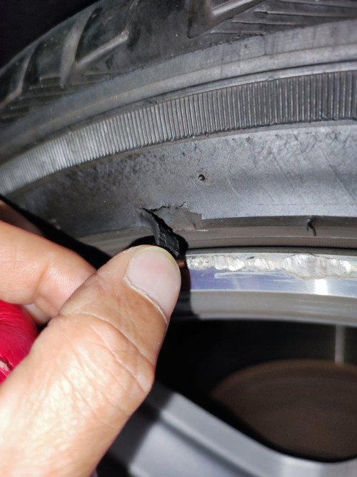

When a tyre punctured with a 3 cm hole, the mechanic patched it with a round patch on the inside tyre wall. How long can this type of patching last?
What do you mean by "tyre wall"? You mean sidewall? --> patching sidewall is super no no as stresses is the highest on the sidewall. Chances of failure is relatively high.
If its on the tread & done properly & properly inflated , tire should be able to withstand till its end of life.

QUOTE(epjx31 @ Jul 10 2022, 10:08 PM)
Thank you for your reply.
Not the side wall. Wall behind the thread.
Will the glue get dried up and leaks again?

QUOTE(cucubud @ Jul 10 2022, 10:45 PM)
Sorry, I do not really understand what is the "wall behind the tread"
But anyhow usually glue should last at least 3-5 years. Hence you should always make sure you check and maintain proper tire pressure.

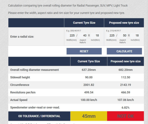

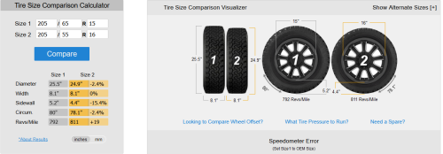

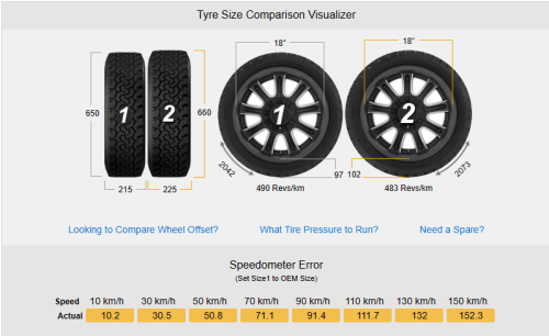

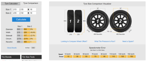

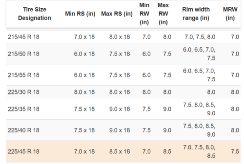

Will upsizing from 185/55 R16 to 205/50 R16 affect in fuel economy and car acceleration assuming using the same wheels
I believe this is due to larger size but from online calculator it was way below (seems like the perfect size to upsize to) the 3 percent threshold (+0.25%) over 185/55 tires.
This post has been edited by minizian: Jul 11 2022, 03:21 PM

QUOTE(minizian @ Jul 11 2022, 03:18 PM)
In terms of size effects, there is no big difference in terms of rolling resistance coefficient of your 2 sizes. <3%. If you somehow fit this on your vehicle assuming you have +20mm more space width, you are ok. Outer diameter only differs 2.5mm.
Regarding car acceleration, you have a wider front contact patch (205 vs 185) this is helpful in wet braking. But in terms of dry it should not matter.

minizian
post Jul 12 2022, 09:37 AM
1,074 posts
From: Verdun
QUOTE(epjx31 @ Jul 11 2022, 06:51 PM)
Thanks for the reply, I am not sure if my 6.5J wheel will be able to fit 205/50 wheels or not.
Tire shop person said cant fit while checking online the minimum width is 5.5J. Not sure who is correct who is wrong, they say its okay to fit 195/50R16 inside but the speedo will be off quite a bit icon_question.gif
Hard to find good fitting third wheels since the stock wheels are not common offset unless go full custom which is not cheap.
Not sure if this is under your field or not.
Also, not sure which tire co your are in but I noticed some of tire brand model have different country of origin. Eg Pilot Sport 4 was made in France while the ST model was made Thailand. Likewise the same goes to Falken which certain model was made in Turkey while SEA model were made in Thailand. I believe Goodyear & Pirelli also hade made in China model & European made.

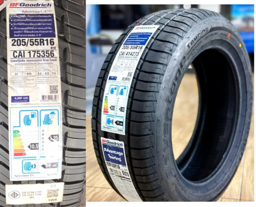

QUOTE(minizian @ Jul 12 2022, 09:37 AM)
Are the quality same between country of origin for the same model of tires?
Michelin have a different product strategy when it comes to global product line. They have the European lines which forms their core, these are the Pilot Sport 4/5, Primacy 4 and then they add a ST for those in APAC. I am pretty sure they are using different construction + compound for their APAC counterparts as the local requirements are also different. They looks the same as the pattern which is what normal users see its the same between the 2 products. So to answer your question, there is a difference between these 2 products not only because they were made in different plants but its tune to the local demands. Of course if you are staying in APAC its wise to get the ST version because it is specifically tuned to our weather climate instead of a European version.

1) How long do tyres are really safe to be use. Is 5 years the max?
2) so im using an old rwd car which its stock wheels are wider in the rear. Right now i have 205/50/16 in front and 225/50/16 in rear. Problem is the rear tyre size is quite difficult to find. The one im using ps3. Which size do you suggest i change to or just stick to Michelline ps3/4..other brands didn't have this size😢
TSepjx31
post Jul 12 2022, 11:24 PM
21 posts
Joined: Jun 2012
QUOTE(faizrajaie @ Jul 12 2022, 09:06 PM)
1) There are 2 main concerns here, one would be performance as the tread compound tends to harden over time you might get worse wet performances but the margins are quite low. I would say not more than 10 years if everything is normal. 2nd point is the storage conditions. Is the tire loaded ? how's the humidity and temperature in storage? these things affects the compound state but as long you are not killing it it should be fine smile.gif
2) Regarding your tire size, the easiest solution is to change to 205/55R16. They have the size outer diameter and its widely available. Handling would be worse but I dont think you will feel a difference.

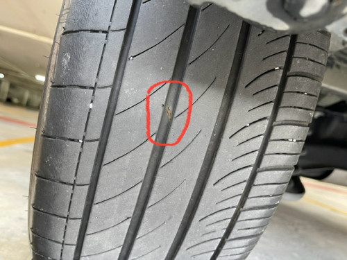

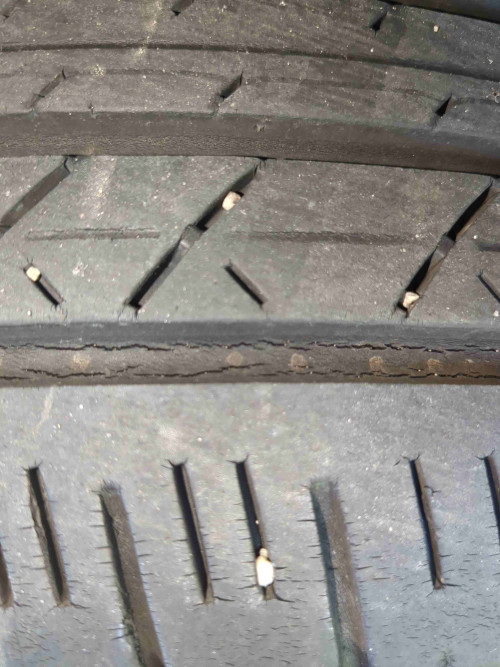

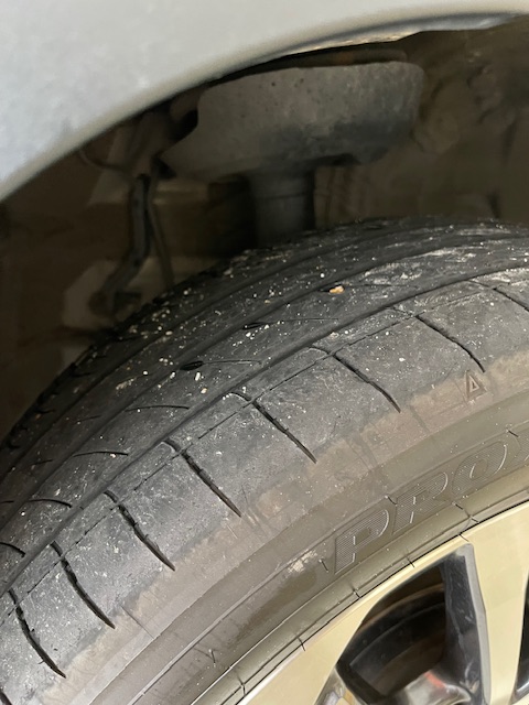

post Jul 17 2022, 07:48 PM
735 posts
Joined: May 2010
Any issues if i keep seeing road pebbles or small stones lodged on my tyre threads? Leave it as it is?
TSepjx31
post Jul 18 2022, 12:56 AM
21 posts
Joined: Jun 2012
QUOTE(frontierzone @ Jul 17 2022, 07:48 PM)
These are usually fine as they tend to come out naturally. If you are hardworking of course it would be nice to pick them out but i predict the influence is very minimal.

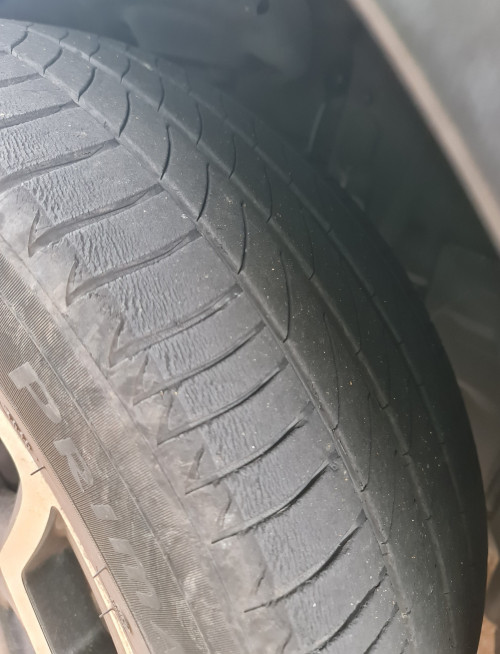

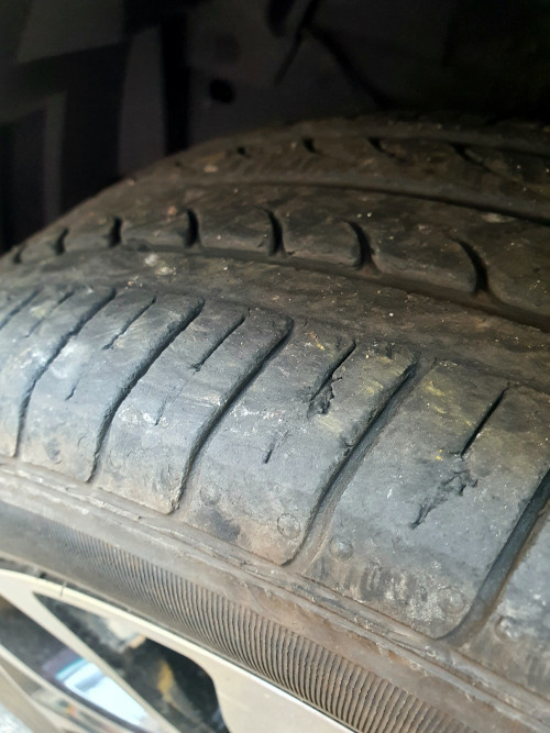

post Jul 25 2022, 03:10 PM
124 posts

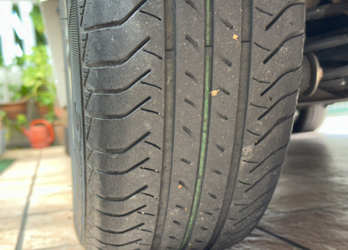

bro i am using a subaru forester mileage only 28k but the side of the tires already makan and the middle thread is almost 50%. what could be the reason?
i rotate tires every 10k mileage.
tire size is 225/55/r18 current one is bridgestone

QUOTE(matkewl @ Jul 25 2022, 03:10 PM)
Hello, when you say makan do you mean there is no more tread depth? (1.6mm) ? Would be nice if you can either take a picture or measure the tread depth in all sides (shoulder center shoulder)
When I look into Subaru Forester, it seems that it is a AWD configuration. Do let me know if this is the same for your car. If its a AWD setup, rotating your tires does help at all. For your shoulder wear issues, this is quite common in SUV configuration but not as extreme as you said (1.6mm on shoulder and still have 50% in the center) So you might want to check your car camber setup to see if anything is wrong.

Can you recommend comfort tyres for 235/50/R17 and 235/45/R18? Does downsizing from 18" to 17" have huge difference in term of comfort and pricing? Which size is more common?

QUOTE(cwyapp @ Aug 2 2022, 10:14 PM)
We know that the higher your rim size the more expensive your tire will be. Check out this table here. So you can expect a cheaper price.
I explain the effects when you inch up your tire here. The comfort level of your tire is related to the tire's construction. So different products with different target requirements will vary. But if we are just talking about size differences, in general the higher the sidewall the better your comfort level as you are able to flex more as the tire is going through obstacles. the good thing about down sizing is that your sidewall height has to increase to compensate the outer diameter. So you are effectively having a higher sidewall height which is good for comfort.
I had a quick look on my price table & your sizes are mostly the UHP or touring segment tire where comfort is not the main target. I would go with Michelin Primacy 4st as the best bet. There might be cheaper options where comfort is indirectly better as a by product of being non competitive in wet or wear. I hope this helps.

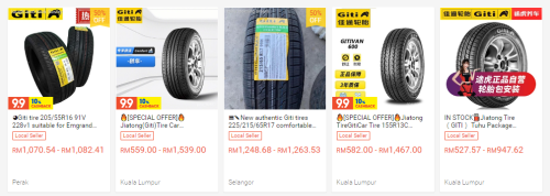

what do you think about china branded tyres? made in thailand ones
TSepjx31
post Aug 4 2022, 10:19 PM
21 posts
Joined: Jun 2012
QUOTE(zstan @ Aug 4 2022, 02:48 PM)
depending on which tire company are you talking about. Ling Long & Double Coin are quite solid but of course they do not solve target conflict at a high level compared to the premium brands. If budget is a concern, you would rather the by tier 2 brands from the premium manufacturer like Dunlop which Continental owns for Malaysia.

QUOTE(usop8290 @ Aug 8 2022, 12:20 PM)
torn between nexen ru1 and toyo proxes cr1 size 225/65/17. which one is better ?
Could not find any label indication for Toyo CR1. For Nexen RU1 , it is label A for wet and RR D.
Based on this RU1 would be my choice .

Hello tire sifu, would like to know can a 185/55 r15 fit on my current rim that hold a 195/50/r15???

I'm driving proton x50 (currently using continental UC6 215/55/18). I had replace aftermarket wheels (spec :18x8.5JJ Et+42 PCD5HX114.3). Currently I planning to change my 4 tyres. I'm looking for tyres that more grip in wet/dry. I had ask few tyres shop. They recommend me use 235/50/18. Kindly please advise what size of tyre should i get and any recommended for which tyre to get.
usop8290
post Aug 9 2022, 12:04 PM
998 posts
Joined: May 2009
From: Bangi & Kuala Terengganu
QUOTE(oldkidzai @ Aug 9 2022, 10:01 AM)
235 profile more wider more grip. suitable for your new 8.5jj rims. then all you need is UHP tyre like michelin PS4 SUV for better wet/dry conditions.

QUOTE(RiriRuruRara @ Aug 9 2022, 12:02 AM)
Can fit since it is much narrower than original size. However, the tire sidewall will looked a bit stretched.
oldkidzai
post Aug 9 2022, 01:48 PM
Joined: Apr 2013
QUOTE(usop8290 @ Aug 9 2022, 12:04 PM)
Beside PS4 SUV, what else suitable?

QUOTE(oldkidzai @ Aug 9 2022, 01:48 PM)
get all rounder michelin primacy suv or goodyear efficientgrip2 performance suv..both recommended by tyresreview youtube. but sadly goodyear malaysia dont bring that anymore. others can try hankook s1 evo3 SUV but rarely available or newly released pirelli rosso.
other mainstream suv tyre such as goodyear maxguard suv, conti uc6, toyo proxes cr1, yokohama bluearth xt, nexen ru1.
since my budget kecik, i want to try nexen ru1 after this. price is cheaper compared to other brand with AA traction rating. brows.gif

QUOTE(amscouzach57 @ Aug 9 2022, 12:31 PM)
Will there be any safety issue if force it like this? Bcs I be doing a trip from Penang>KL>Genting>penang soon.

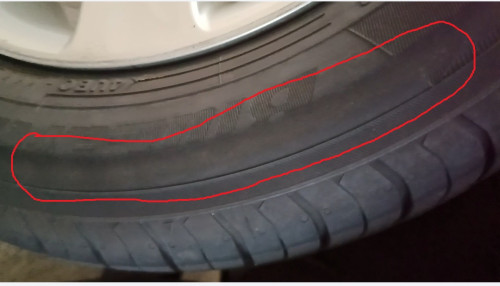

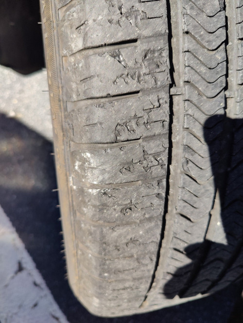

Hi, i wanted to ask, few month ago i bought 2 Michelin PS3 for me ecobox, after few weeks, i realized that that 2 tyre is relatively not even, so need to put extra balancing when balancing the tyre, however i doesn't help much on high speed, it will vibrate quite badly.
Is this type of defect common? or that seller is selling defect/rejected tyre from factory?

post Aug 10 2022, 02:39 PM
2,702 posts
Joined: Jun 2009
From: Penang
QUOTE(babisotong @ Aug 10 2022, 02:03 PM)
Your absorber, lower arm bush, driveshalf everything in good condition or not? Before you claim tire problem, your car condition confirm is good & no problem?

babisotong
post Aug 10 2022, 02:46 PM
653 posts
Joined: Feb 2013
QUOTE(littlefire @ Aug 10 2022, 02:39 PM)
yes, i brought my car to certified/professional suspension tuner, he tested it and show what the tyre problem, when u do balancing(put tyre on the rotate mechine thingy) can see tyre is a bit uneven.. quite sad since i realize it tad a bit late.
littlefire
post Aug 10 2022, 02:51 PM
2,702 posts
Joined: Jun 2009
From: Penang
QUOTE(babisotong @ Aug 10 2022, 03:46 PM)
Sport rim no bengkok? Did the tire shop take out the tires and check your sport rim condition?

babisotong
post Aug 10 2022, 02:56 PM
653 posts
Joined: Feb 2013
QUOTE(littlefire @ Aug 10 2022, 02:51 PM)
yup, it doesn't happen with my previous Kumho PS31, only after i changed to Michelin PS3..

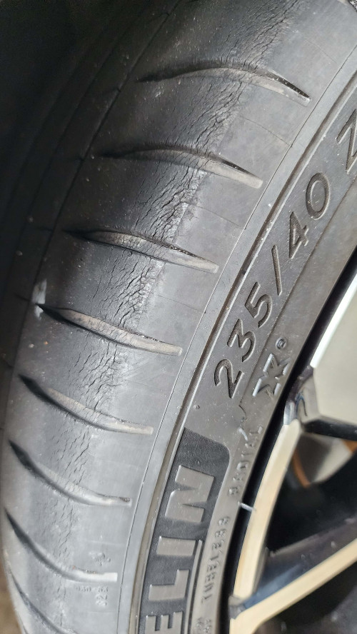

alexei
post Aug 12 2022, 03:51 PM
Biker Mice from Mars
1,878 posts
From: Medan, ID

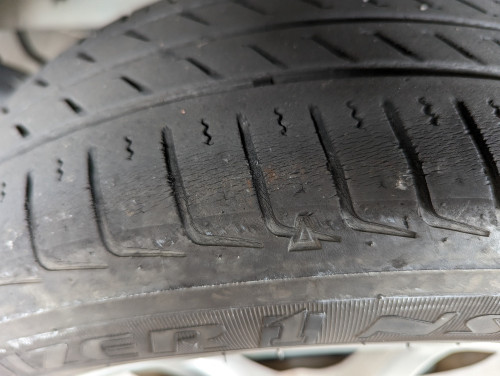

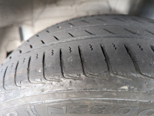

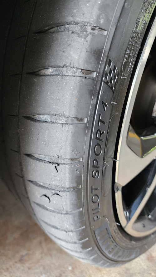

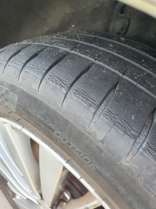

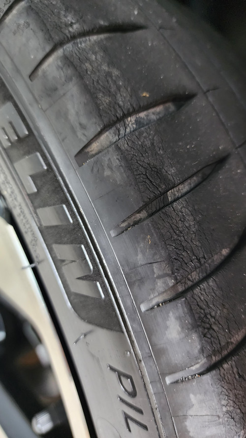

epjx31what's the compound difference between XM2 and Primacy4ST, or rather, what are their relative strength/weakness in terms of conflict addressing?
2. Michelin tread compound cracking, seems common. Is that a problem?
This post has been edited by alexei: Aug 12 2022, 03:53 PM
TSepjx31
post Aug 13 2022, 01:07 AM
21 posts
Joined: Jun 2012
QUOTE(alexei @ Aug 12 2022, 03:51 PM)
Quite a tough question you have there. I can only say looking at their performances.
XM2+ and Primacy 4st are both wet braking focus tire line with different wear targets. XM2+ has a much higher wear requirement than Primacy 4st being the comfort segment. The wet braking vs wear conflict is the biggest here from a compound point of view as the Asia market do not really care about rolling resistance. This is a very general overview without going into deeper context.
I would not worry too much about cracking which happens on the surface and does not propagate down to the core. These are mostly because of the high amount of silica they are using to achieve a high wet braking level.
alexei
post Aug 13 2022, 10:48 AM
1,878 posts
From: Medan, ID
QUOTE(epjx31 @ Aug 13 2022, 01:07 AM)
Thanks a lot.
My un-educated guess, based mostly on my experience, is that the cracking is wear nature of silica rich compound tyres.
Why is it that certain tyres have good grip throughout wear, while some will give perceived lesser grip once worn >60%, or some worse just >30% will have significantly lesser grip perceived?
zeng
post Aug 13 2022, 11:42 AM
1,810 posts
QUOTE(alexei @ Aug 13 2022, 10:48 AM)
Thanks a lot.

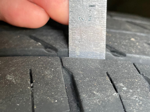

My 2 sen is silica or sand in itself is highly abrasive in material property and hence tire compound with silica can withstand better/stronger from being 'worn down' by the highly abrasive asphalt/pre-mixed road surface .... thus increasing tyre longevity in particular during hard braking.
Besides, silica has a very high hardness property at the expense of brittleness property like a glass ..... easily gets cracked or scratch while preserving the 'mother material' of rubber tyre compound.
The cracks in a typically hardened tyre rubber in operational service over a period of time especially in a Michelin does not normally propagate to the next protective layer (right below the tread rubber compound), hence the structural integrity of hardened and used tyres are still intact offering maximum level of protection as designed or as intended.
Replacement of used tyres (after 3-5 years of usage) on believing it being hardened and/or observing (hairline) cracks on tread compound is imho unfounded and baseless as is commonly practised in lowyat/locally.
This post has been edited by zeng: Aug 13 2022, 11:44 AM
Thanks a lot.
I think this is a misconception. If you are talking about wet conditions, the ability to disperse water is greatly reduced as you are losing tread depth creating less channels to let the water flow out. This is one of the main reasons why you are loosing so much grip compare to new tires. The opposite is true for dry braking. The lower your tread depth, the better your dry braking as your top part of the tire gets stiffer. You can see this in most of Michelin's advertisement.

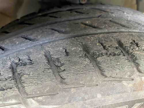

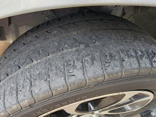

Hi, may I know is it still safe to use tyres like this ? DOT2018 with good tread depth.
What is the reason for these cracks? Is it because they are seldom used? Since covid mileage about 6k per annum.
This post has been edited by profdra: Aug 27 2022, 08:49 PM

post Aug 27 2022, 09:09 PM
1,810 posts
QUOTE(profdra @ Aug 27 2022, 08:48 PM)
It is safe to continue its service as these hairline cracks are cosmetic and not structural/strength in nature, according to tyre manufacturers.
Cracks is related to hardening of rubber tyre compound with oxidation/sunlight as a catalysts.
profdra
post Aug 27 2022, 11:24 PM
38 posts
Joined: Aug 2007
QUOTE(zeng @ Aug 27 2022, 09:09 PM)
isn't this dry rot which is recommended to replace tyres ?
It's been asked before, see below.
dudester

Hi, Like to ask if anyone has experience with the brand Giti
My googling tells me
- Made in China
- Bobby Ang made video
- Shopee sells around 1k each for size 17!
- Seen their logo in UK tyre reviewer
Are they any good? really at 1k?
profdra
post Aug 29 2022, 01:39 PM
38 posts
Joined: Aug 2007
QUOTE(alexei @ Aug 29 2022, 10:19 AM)
ok I've read them. Thanks.
The reason I asked the question is because I have 1 tyre with was patched recently due to screw puncture which is leaking. Its about 1cm. Definitely less than 2cm. If it can't be used then I would just change them.
Now my question, is 1-2cm hole still patchable?
Its runflat Potenza S001.
zeng
post Aug 29 2022, 01:40 PM
1,810 posts
QUOTE(profdra @ Aug 27 2022, 11:24 PM)
I'm not aware tyre manufacturers recommend tyre replacement on the basis of socalled 'dry rot', whose meaning/definition is not spelled out clearly.
In a way, I don't consider the hairline cracks on this 2018 tyre as dry not , as the structural strength of the tyre is not compromised and is intact.
profdra
38 posts
Joined: Aug 2007
Thanks
profdra
post Aug 29 2022, 01:50 PM
38 posts
Joined: Aug 2007
QUOTE(zeng @ Aug 29 2022, 01:40 PM)
Sorry I don't know much about tyres that's why I came here.
Its runflat S001 & I asked the car salesman & he said that I should change it & I also asked my regular tyre shop HupSoon in Subang who has been servicing me for more than 10years & he told me better change it. I also asked Hin Leong which I get my tyres from also recommended me to change for long distance driving. I'm a fast driver sometimes up to 180km/hr on long distance.
I'm thinking maybe the cracks are due to not being driven often since the pandemic & still usable. So I came here to get some opinions.
But now that I have a screw puncture about 1cm patched a month ago leaking, what is your opinion?
Thanks.
This post has been edited by profdra: Aug 29 2022, 04:51 PM

QUOTE(profdra @ Aug 29 2022, 01:50 PM)
Thanks.
1cm and patched from inside, won't last long even under normal driving becoz tyre flexes.. especially if patched and put as front tyre within 100km also leaked (a few frens cases)
one totally lost tyre pressure instantly while driving, so it's not worth the risk
I think better change
Thanks.
Patching of a 1 cm puncture in a normal radial ply tyre is NOT recommended by tyre manufacturers.
Maximum allowable by manufacturers is 0.6 cm though there are owners who got away with it without encountering any problem for punctures exceeding 0.6 cm.
As for run flats, IDK but I suspect the same rule of max allowable 0.6 cm may apply here. In this context patching of 1 cm puncture may not comply with manufacturers recommendation hence replacing the one punctured tyre may make sense whilst retaining the other three.

QUOTE(zeng @ Aug 30 2022, 01:27 PM)
Hey Zeng is right here. 1 cm patching does not make sense here. Let's put it this way, if the hole penetrates pass your innerliner (the rubber part which protects air from leaking out) it means you have some kind of structural damage. We know that the main stress happens in the sidewall, however heats build up on the tread after prolong usage for example if you are doing a highway stretch.
From my point of view, you have to think about the downside. The worse thing that can happen is that your tread gives way during when you are travelling at 110 km/h on the highway as you already have structural weakness which can propagate over time. Your crown area will crumble and you will not be able to control your steering at all. This is highly dangerous and from my point of view not a risk you can ever take. I guess this is the same as everything in life, you got to have a safety margin in case anything happens and if you can not endure the downside, the risk is not worth taking at all.

QUOTE(dudester @ Aug 29 2022, 12:05 PM)
- Made in China
Giti is a well known brand in the tire circles. It had a big plant in Indonesia but of course like every manufacturer it also has a china factory.
To be honest, Giti is a mid-budget brand. Tire performances are always somewhere lacking behind the top 6.
If the price suits you, maybe its worth a try but expectation wise should be tailored to the bottom end.

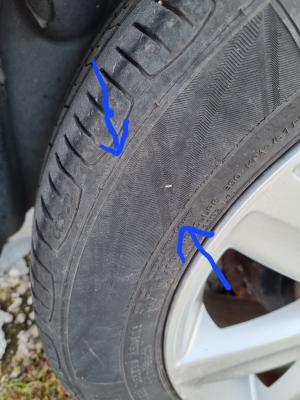

From: underneath the grove of sycamore
Hello.
My front Tyre develops a bulge. Is this safe to drive?
Just noticed it this morning. 🙁
mdziaf
post Sep 3 2022, 07:12 PM
93 posts
Joined: Oct 2009
QUOTE(Sycamore @ Sep 3 2022, 02:40 PM)
Hello.
You need to replace your tires. A buldge is an indicator that the carcass has a tear. Since the carcass is what carries the load of the tire its best to change your tires.

Sycamore
post Sep 3 2022, 07:23 PM
334 posts
Joined: Jun 2015
QUOTE(mdziaf @ Sep 3 2022, 07:12 PM)
Curious tho what tire you are using? Not often to see a UNECE R117 marked tires made in Malaysia unless its a new tire you got with the car from the factory.
Silverstone.
This is Tyre comes with the car out of factory.
Been 2yrs 9mths, but rarely drive during covid. So all in good condition (I think? ) except for this bulge.

TSepjx31
post Sep 3 2022, 09:56 PM
21 posts
Joined: Jun 2012
Yes, you should replace the tire immediately. It is not safe to drive !

Hey TS,
I have a few questions which I hope you can assist with.
Background: Std Saga VVT using stock Silverstone M3 175/70/13 upgraded to PS3 195/50/15.
Issues: experiencing tramlining, higher body roll (likely due to softer side walls?), car isnt as composed when breaking hard either.
Only plus points seems to be grip and rather low noise, whereas with the Silverstones it was opposite (ie: higher noise, lower grip especially in the wet but the rest were fine). What gives?
Different unrelated one: 3/4 tires had a small bulge on the side wall, barely visible with naked eye but can be felt when you run your fingers over them.
Likely kena con by tire shop on the pretext of "safety". Brought the tires for inspection since they were still under warranty, rejected claim as to them they were all fine, functional and perfectly safe to be used.
I think they were referred to as sidewall indentations or undulations, due to manufacturing process, like the welds between each end.
Your take on this?
This post has been edited by Vsmh: Sep 6 2022, 09:39 AM

Hi there, thanks for asking such an interesting question. I will try my best to put on my engineering cap to answer you.
1. Changing from Silverstone M3 175/70R13 to PS3 195/50R15
Your sidewall height is reduced about 55mm which should naturally means loosing comfort as more rubber on the sidewall helps you flex, however the biggest difference is you are using a PS3 top notch wet braking tire and it is of course way better than the carbon based Silverstone M3. In my opinion the grip you got comes from the compound upgrade while you having a deficit in comfort due to sidewall height.
2. Bulge
When talking about bulges you have to be careful what bulge you are talking about. Bulges which blow up like a balloon is extremely dangerous as this means you have some damage as air can push through that area to form a bulge. However I'd the bulge is in the opposite direction, (intended inside) this is totally fine as this is caused by overlapping of the ply during production. Structurally your tire is in tact and there is not safety issues.
Hope this helps

2. Bulge
Hope this helps
Just to add on to this: there are tolerances for how much indentation is allowed. Although structurally fine and safe, if noticed by the consumer, it will cause undue concerns by the end user - such as what has happened to you Vsmh. Usually these indentation falls under QC issues, and would be grounds for claims. But each manufacturers have different requirements for what is allowed and what is not, so your mileage will vary. You could try to go to a different dealer to see if they would be willing to submit a complaint on your behalf. But if your tires have already been used, don’t expect a 1-to-1 replacement.
Interesting to note that there are tolerances acceptable in bulge/indentations and its size externally and/or internally(?) by QC .
Care to elaborate more on the QC tolerances in question or better still, if there are online resource on said acceptable tolerances?
mdziaf
post Sep 7 2022, 02:18 PM
93 posts
Joined: Oct 2009
QUOTE(zeng @ Sep 7 2022, 12:50 PM)
Well i can only give a general idea of it from my experience and to cover my butt incase i give too many details.
Imagine welding two pieces of iron together. If you put too much weld material you end up with two pieces that have a big buldge at the connecting point. If you put too little you have a joint that curves inwards on itself. And if you put just the right amount it will be almost perfect (smooth to the touch but if you zoom in closer it may still be too little or too much). The same can be said with the joining of rubber materials. And hence why there must be some QC checks to make sure its not going to be an issue - both in terms of safety and in terms of customer complaints.
To be honest I doubt you will find any online resources because these would be very company specific.

Hi TS, thank you for the response, however I think you might have gotten slightly confused here, my question on no.1 is actually not about grip or loss of comfort. More to tramlining and wobbly / squishy feel. Kindly see my original post (below for easier reference)
QUOTE(mdziaf @ Sep 6 2022, 11:48 PM)
Some times i wonder if the tire shop knew of such things (and thus took the opportunity to sell) or they really think its a safety issue.
Id agree on tolerances. Tire shop said no warranty one lah, Perodua said have but need to deal directly with manufacturer. Manufacturer (Silverstone) has kinda shut down (and they were pushing me back to Perodua), later found out they are now made and handled by Toyo tires, they were of the opinion that it was within spec and normal. All these created a perfect storm since i travel long distance and if 3/4 of my tires had a "bulge" as the tire shop called them, i was not willing to risk a single pop on the highway @ high speeds.
Just a bit of backstory, tires were within warranty period, ran for about 20K km. Now i have 4 extra tires because of this episode.
Yea in your case Silverstone has closed down and replaced by Toyo. Maybe the buldge we are talking about are different type of buldge - since you seem to imply that 3 of your tires that came with your car has this issue. To me that doesnt seem to be very likely. Tires going to a car manufacturer would need to pass through the tire manufacturer’s QC and then again through the car manufacturer’s receiving QC department before again another round of QC before the car leaves the car factory. So maybe thats why you arent gettng anywhere with your request.

Hi OP. Recently I've been introduced to this new German tyre GITi Sports S2.
There are little reviews on them but the individual reviews looks good.
Tire shop owner said the performance comparable to PS4/5 while being quieter and cheaper.
Wondering your expert input on the actual comparison between Giti sport s2 vs Michelin ps4/5?

QUOTE(devil86 @ Sep 22 2022, 12:28 AM)
Deleted
There is about 12mm less outer diameter for your new size. Usually the tolerance is about 4mm. The less sidewall hide would hinder your comfort theoretically but with the 265 widt you will have a wider foot print which helps in wet.
What is the motivation to change?

devil86
post Sep 22 2022, 07:01 PM
446 posts
Joined: Aug 2009
QUOTE(epjx31 @ Sep 22 2022, 04:26 PM)
Because it is very hard to find an all terrain tyre for my 4x4 with the size of 255/65R18.... 😅
TSepjx31
post Sep 23 2022, 08:10 AM
21 posts
Joined: Jun 2012
QUOTE(devil86 @ Sep 22 2022, 07:01 PM)
Should be fine just make sure the rims as mentioned by the previous user fits also the load index should be higher or the same
This post has been edited by epjx31: Sep 23 2022, 08:10 AM

e-lite
post Oct 23 2022, 10:11 PM
692 posts
Joined: Oct 2006
QUOTE(epjx31 @ Oct 22 2022, 02:20 PM)
To be honest, I don't see this. If you look at the top 4 premium brands (Michelin , Bridgestone, Goodyear and Continental) they are pushing all out with their flagship products. Especially Michelin.
Silica was a moon shot when it came to wet braking. While there has been improvements silica tech over the years to improve wet braking and mileage.
Hence I have a different option compared to you. If possible would like to know what brands and products that you are talking about.
Thanks
Looking at one example only as no time to do more research outside of what I want to buy. Tyre label shows significant drop in wet grip
LH - BFGoodrich (sister of Michelin) - Advantage T/A Drive (predecessor)
RH - BFGoodrich (sister of Michelin) - Advantage T/A Touring (successor)
Maybe they purposely made it worst so that not to compete with Michelin Primacy?

defanci
post Nov 1 2022, 01:58 PM
Joined: May 2014
QUOTE(epjx31 @ Jul 10 2022, 06:42 PM)
Hey guys,
As some of you have seen me posted before, I am a tire engineer working for one of the top 4 premium manufacturer. I write mostly about tires on my blog here https://toptirereview.com/. My ultimate goal is to enable consumers to make a more knowledgeable decision when it comes to buying tires and I hope I can do so by using my website as a medium of information.
Anyways, since I am bored and its Sunday, I would take questions related to tires.
Feel free to ask any questions in regards to tires and I will try to answer as good as I can.
Thanks!
Hi Pro,
Is it safe to drive with this tyre?
TSepjx31
post Nov 1 2022, 08:37 PM
21 posts
Joined: Jun 2012
QUOTE(defanci @ Nov 1 2022, 01:58 PM)
Hi Pro,
Looks like rim strip got peel off, with proper management you should be fine. Ensure you stay of any kerbs. Also regularly check your sidewall for damages. If you do the above, you should be fine.

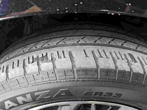

Hi, my tyre start to peel near the texture area. Is it still safe to use? Thanks
TSepjx31
post Nov 29 2022, 02:26 PM
21 posts
Joined: Jun 2012
QUOTE(chan01 @ Nov 29 2022, 07:33 AM)
Could you show us a picture? That would really help.
Usually you would not want to risk anything near the sidewall as this is where the tire flexes smile.gif
chan01
post Nov 30 2022, 11:46 AM
287 posts
Joined: Oct 2006
QUOTE(epjx31 @ Nov 29 2022, 02:26 PM)
Hi, thanks for the help. I already attach the picture. Thanks for your help and info. Appreaciate it 😀

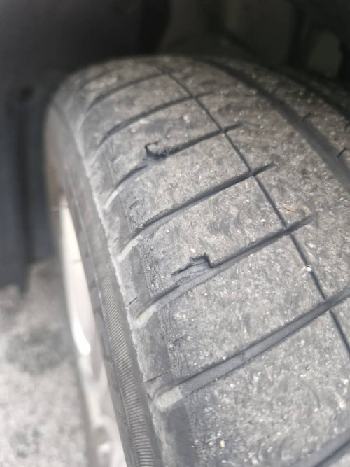

QUOTE(chan01 @ Nov 30 2022, 11:46 AM)
Hi thanks for your picture.
It seems like this is a cup and chip issue. and it is on the shoulder area.
Based on my opinion, it should be still safe to drive. Just ensure you check your tire more often both visually and also the air pressure.

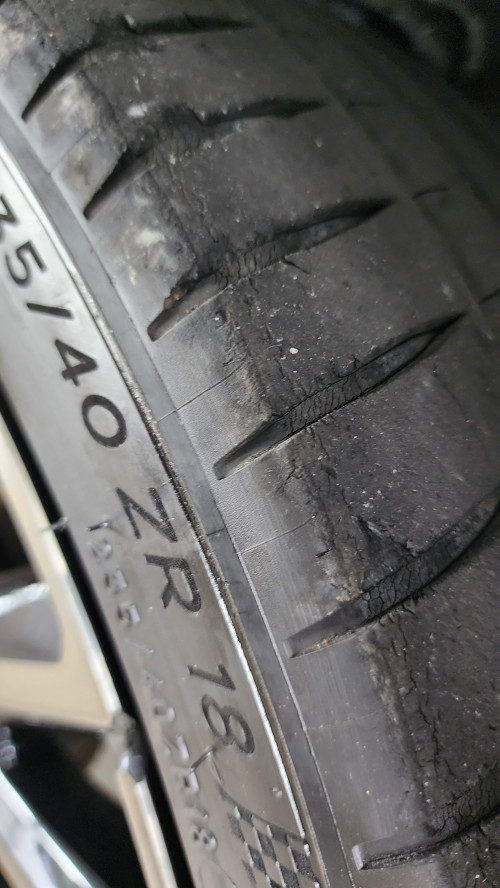

QUOTE(TheOnly @ Dec 4 2022, 11:26 PM)
I’ve been running semi-slicks on public road, and i think I can’t ever go back to normal tyres like pilot sport 5, as that tyre just cannot keep up with my big brake kit, and activates abs so early, really rendering some perks of my bbk useless.
Any unknown downsides on semi slick for public road? I only know
1.tire wear is extremely short (20k if don’t have too much aggressive weekend drives, or 1.5yr~ for tyre life).
2.shitty wet grip, well i take that as a good thing as i’ll slow the fk down when it’s raining, heck even before moving to semislick i already very prone to aquaplane with 275 wide tyre.
3.a need to always make sure/aware of tyre temp/ is warmed up before any huge cornering forces is applied.
4. Nvh? But hell I don’t care about nvh in a car, i got a proper house to properly appreciate a peaceful quiet time, a car is to drive not to live in.
5. Annoys the fuck outta your fellow friends behind you with the amount of sand/stones your sticky tyre will throw at them
less skill to learn. becos grip is adequate.
Hi thanks for your question. Seems like an interesting topic so i will try to answer you point by point.
1. the wear is optimized for track use, hence you cant compare it like this. But the tire is much softer hence suffer in wear performance. Usually you will only last 1-2 days of track usage.
2. Based on my article below which I compare Michelin Pilot Sport 4S vs Michelin Pilot Sport Cup 2 here , there is a 20% wet reduction. For sure the best way to avoid aquaplaning is to reduce your speed.
4. Based on the test results, there is no much difference. I even think that semi slick would be much better noise due to a lower void.

Roger that.
For awareness, does this tyre cracking bring safety concern? It's merely 4 years old tyre.
Also, new tyre shell life 1-2 years shouldn't be any performance lost right? Some even say it's better to have a 6 months shelf tyre than a fresh tyre. Your expert view ?
HalseyFrangipane
post Dec 14 2022, 09:01 AM
503 posts
Joined: Apr 2016
QUOTE(crixalisrox @ Dec 13 2022, 07:33 PM)
Roger that.
No issues with the tyres. Can still use.
TSepjx31
post Dec 14 2022, 02:09 PM
21 posts
Joined: Jun 2012
Roger that.
Tires can be still used. However just monitor your tire more frequently ( 2 weeks once ) for a more cautions approach. If there are chunks of material peeling off at a high rate, it needs to be look at once again.
Thanks.

For Vios 2022 stock 195/55R16 16*6J rim. Can upgrade to 205/55R16 tires? Will it be too donut? I saw City using this size looks ok.

QUOTE(free2d @ Dec 26 2022, 05:11 PM)
You can have a quick look on my inch up tool here.
Based on my check it's not really an option.

free2d
post Dec 27 2022, 08:56 PM
72 posts
Joined: Dec 2014
QUOTE(epjx31 @ Dec 27 2022, 12:50 PM)
I dont want inch up. still remain 16" but wider tire 195 to 205

Hi. I my tire (Michelin PS4 18 inch) that came stock with my civic FC, now clocked at 46K km. Should i change the tire now? Or still can use?
Should i remain with PS4, or go with PS5?
THANKS!

QUOTE(free2d @ Dec 27 2022, 08:56 PM)
Ok sorry but the principal holds the same.
you are shifting from 195/55R16 to 205/55R16 which means
current outer diameter: 620.9mm
Target size outer diameter: 631.9mm
= 1.74% difference.
usually the industry standard is <3%, so it should fit.
Do check you have 10 mm wide space and also extra 10mm clearance needed for your outer diameter.

QUOTE(hidayat14 @ Dec 28 2022, 01:17 PM)
THANKS!
First question: You should based on your tire tread depth to gauge whether you need to change tire & not based on mileage. Measure it via a ruler and it should be legally more than 1.6mm.
2nd question. If there is not price difference, fore sure you should got with PS5 with improved wet braking.
Thanks.

hidayat14
post Dec 28 2022, 09:57 PM
231 posts
Joined: Jun 2014
QUOTE(epjx31 @ Dec 28 2022, 02:13 PM)
Thanks.
Thank you so much! Will check the thread depth. However my tire now are now coming near to three years and theres a slight crack on the sidewall. Not much actually. Should i be concern of it?

21 posts
Joined: Jun 2012

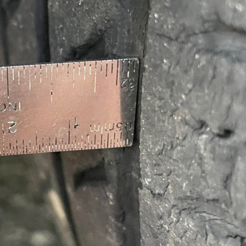

QUOTE(hidayat14 @ Dec 28 2022, 09:57 PM)
tire usually can last up to 10 years so 3 years is really no issues.
Regarding the sidewall crack this is a safety issue. Could you take a picture so that I can have a look? --> this is usually serious and could lead to accident in worse cases.
If you have significant tread depth, you could replace the one with sidewall crack first (depending on the seriousness) & keep the other 3 tires.

QUOTE(epjx31 @ Dec 29 2022, 11:45 AM)
Here are pictures from all of the tires.
andrekua2
post Dec 29 2022, 01:08 PM
10k Club
13,460 posts
Joined: Jan 2012
hidayat14
That's not the sidewall. It's just the edge of the tyres. That peeling is normal for Michelin tyres.
Sidewall is where those tyres details and branding were.
This post has been edited by andrekua2: Dec 29 2022, 01:10 PM
TSepjx31
post Dec 29 2022, 02:40 PM
21 posts
Joined: Jun 2012
QUOTE(andrekua2 @ Dec 29 2022, 01:08 PM)
hidayat14
Exactly right. Free free to use your Michelin's for a much longer time smile.gif
