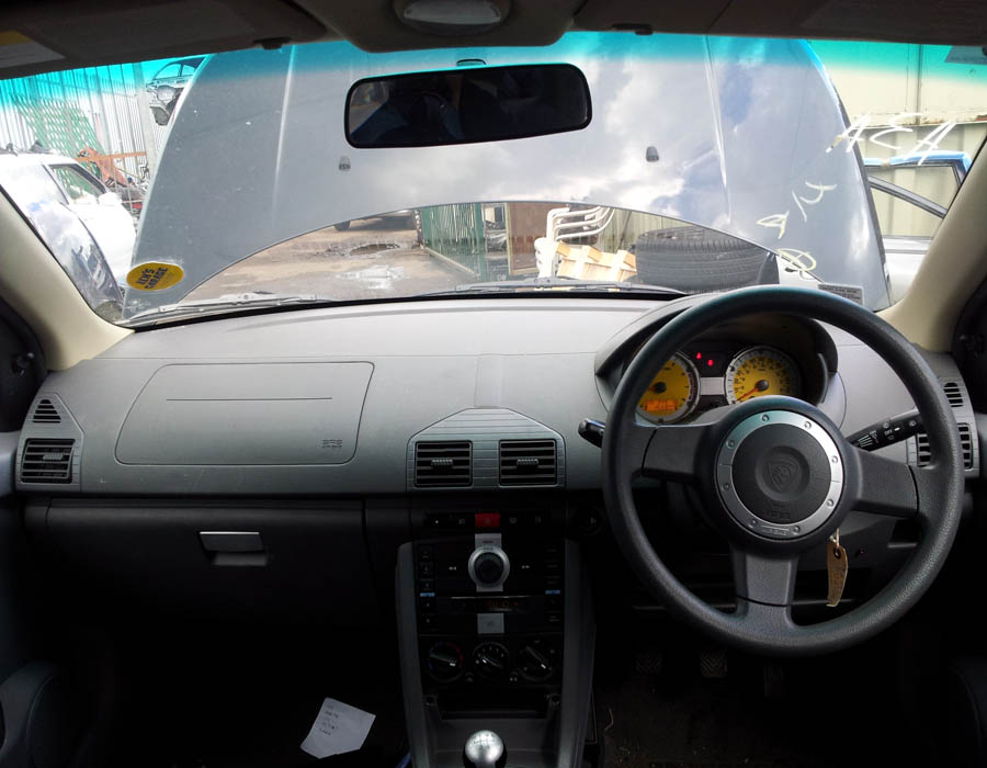

P.s engine wise typical way stick those hood solution doubt will reli reduce the noise lo
Wan do remove dashboard stick at the firewall situ.baru ada effect .
Me x bikin.
Blm member mahihi  got help ppl remove dashboard
sad.gif help me do , give me best price for it. Front Hood + 4 doors biggrin.gif

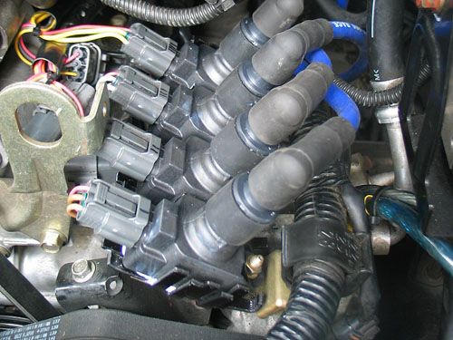

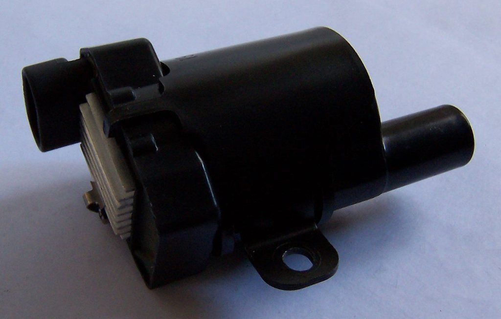

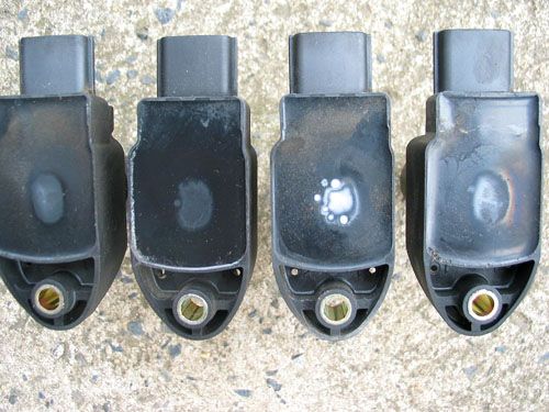

On the last TT I mentioned about the idea I have to put on heat sink on the COP. I got this idea after I saw the coils on Supra from AC Delco. They have a heat sink on top of the coil to help it dissipate heat. I've ordered some heat sink so waiting to get the suitable heat conductive adhesive.
On RX8 Notice the black finger like thing at the bottom.

thumbup.gif thumbup.gif Nice mod.

campro coils very hot ka?

You try to touch with hands after you drive and just shut off your engine..or when your car is idling

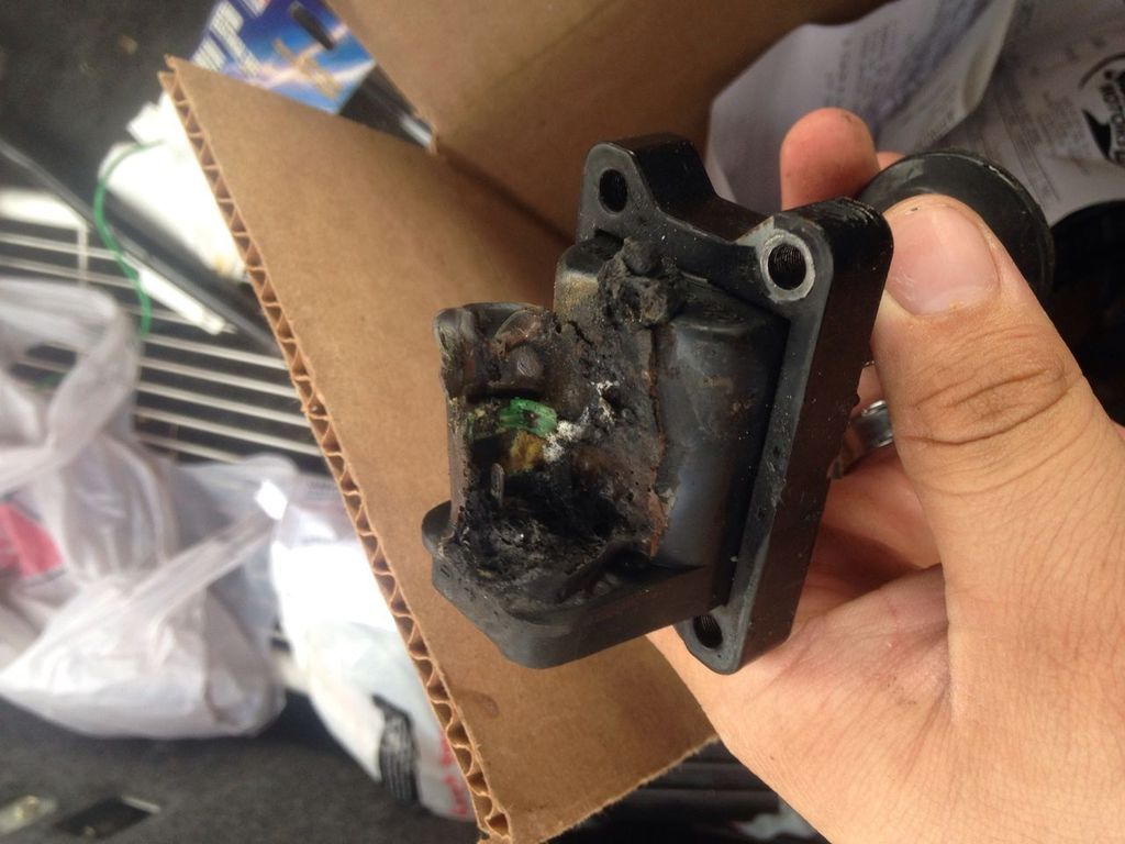

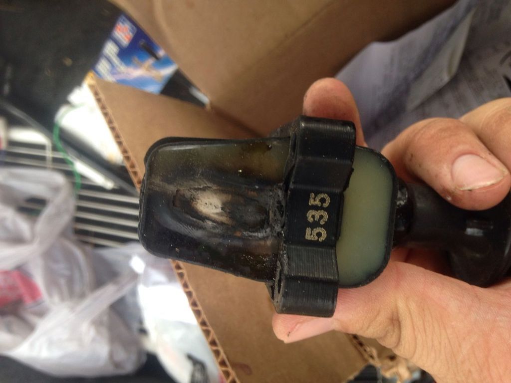

Having engine cover even worst....the heat all circulate under the cover. My previous 206 COP is whole assembly so if 1 spoil I need to change the whole COP assembly unit. 500 bucks...
See below pic

Coil On Plug fail can happen to any car as long they have COP....heat or the coil winding inside fail... then it will cause missfire.
Ya will remove it next service.

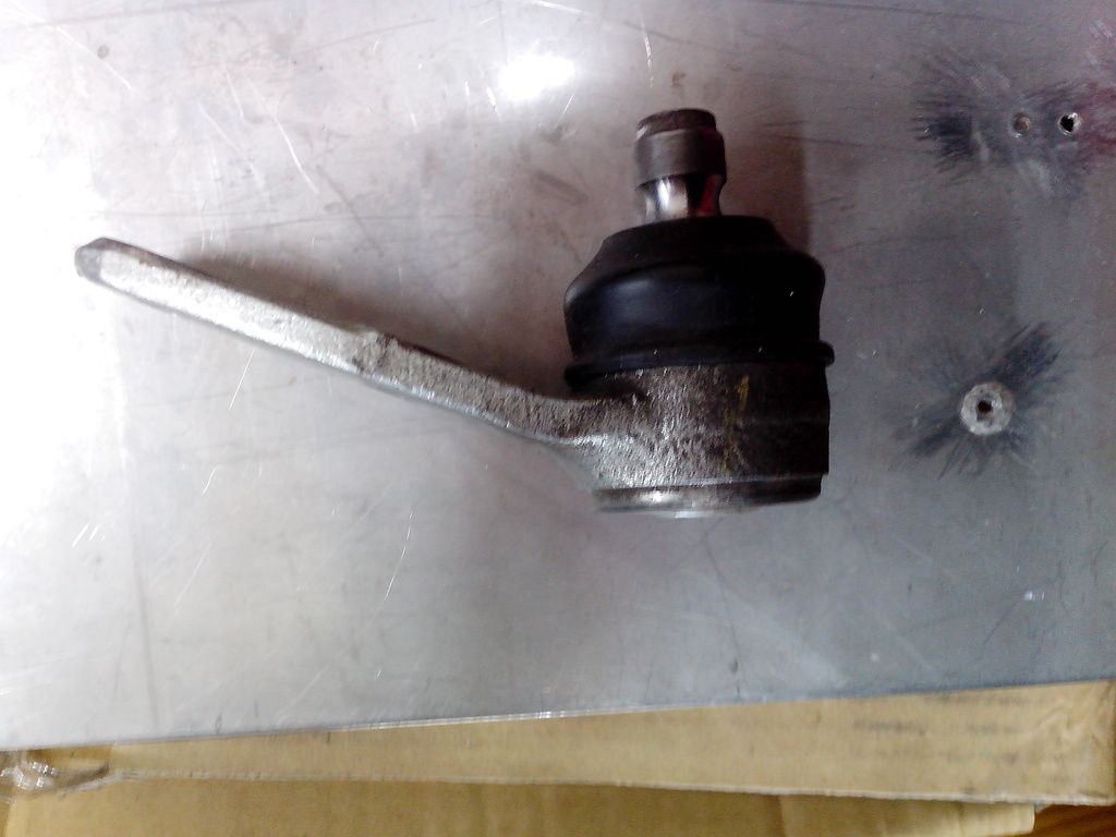

you may have developed a leaky shaft or the rubber could burst due to the vigorous actions thanks to our road condition, especially the area you stay. Those holes although is small but they are deep and there are multiple of them waiting to be filled.

Fuarkkkk this is serious. I actually dunno what happened to the car. I was just cincai blast here and there since the car is new. Then seeing the powersteering fluid consistently disappear, so I ask Jon what's going on, at the same time realized my temperature is getting hot. But rest assured, my stock coil mat is still in place notworthy.gif

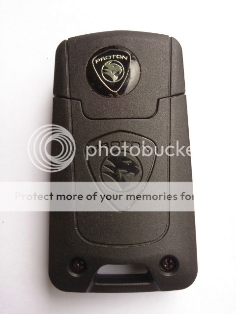

Just wanna share my Saga BLM 2010's experience.
Clocking 138k mileage now.. so far never had any major breakdown. I think the key is to never skip your service. But of course, having Proton cars is like russian roulette, u can have a non-problematic car or u will have a nightmare car. Now my issues with my car are as per below:
1) Main power window switch faulty. The main driver's power window switch is stuck and the passenger's side can only wind down but cannot wind up.
2) Mirror plastic thing to adjust up and down is broken. I dont know how the thing got broken!
3) My glove box already stucked for like more than a year. Not sure how to fix it. Do I need to replace the whole glove box or just the puller?
4) Key housing broken. Fell so many times. Lucky I got some dealer who sells the blank housing for cheap. (original).
All in all, besides all above issues, I think its a great car for its price. Not thinking of selling it at all. smile.gif

1. change switch lo, around 100 bucks only if not mistaken
3. change the lever only. around rm30 if not mistaken

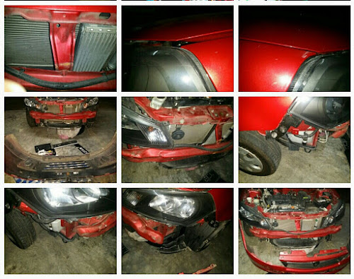

hi,
any idea how much does it cost to replace saga blm se back bumper?
rm350 included painting enough?
thanks.Attached Image Attached Image

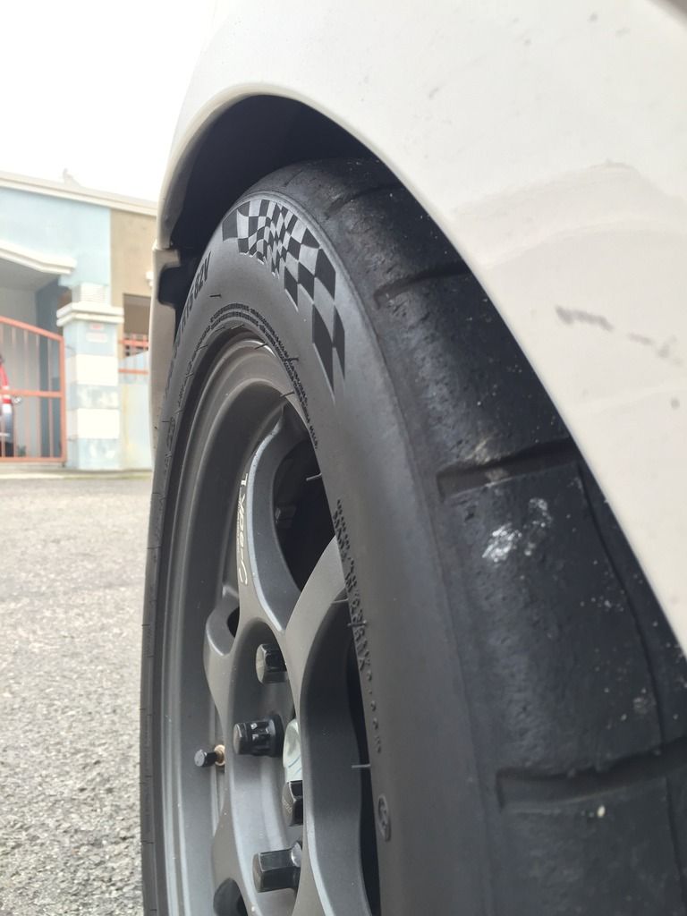

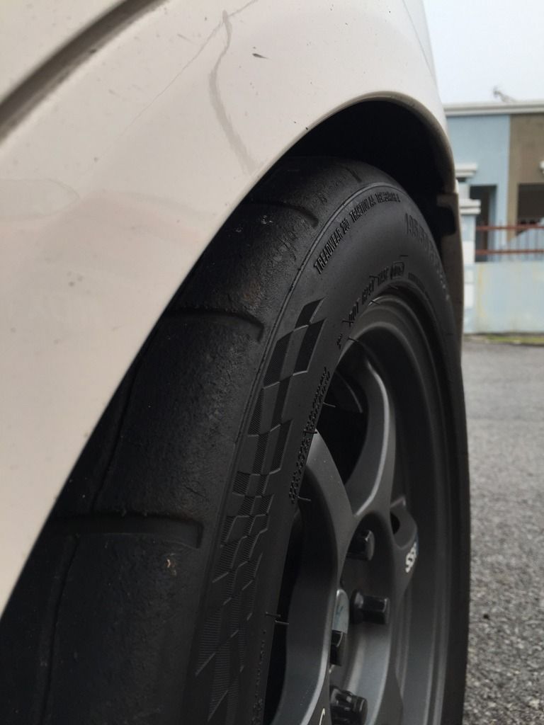

QUOTE(THE CLASS OF 13 @ Jul 11 2015, 03:51 AM)
nitto neogen bro, about 250ish, good for track day and street patern like prada sumore made in japan.. thinking to running 205 for front tyre only hehe
edited

tongue.gif thxs to one member who came last saturday to get the autolock installed
sudah lama punya benda . dah tak simpan stock
owner even u turn back to ask us if it has any special function
it seems someone here mention ada special function tongue.gif ( must be pulling his leg la ) laugh.gif

Ok tq everybody.. i settle my prob dur to smack down pasu by mom
I D.I.Y all the bumper.. and found out a frount bracket ra a lil bit damage..
I ask a cousin who work at P1 to do a magic work by heat and make good the bracket.. i still owe him one.. here r all the pic b4 n after

For me atleast it's way more better than Nexen Blue HD and Ducaro GA
I like a quiet tyre too and I'm now a bit peeved about the noise from the Ducaro that Daisy came with, oddly the tyres have gone from being as soft as butter for the first 1000 km to as hard as iron now with 7000 km up after a 4000 km trip over the last fortnight. their wear rate has slowed markedly but I'll be still avoiding Goodyear even though the tyre market here is very limited.
Daisy behaved herself splendidly on my trip, even managing to avoid all wildlife on her travels, of which there was less than expected.
On another issue my remote key lock has failed and I now feel David was right and it's best to avoid trying 2 x CR-2016 cells instead of 1 * CR-2032, yet another list of programming instructions posted here would be appreciated for when my replacement arrives.

QUOTE(wankel @ Jul 19 2015, 06:52 AM)
The remote need 6V to operate, that's why it needs 2XCR2016 stack in series to achieve 6V. 1XCR2032 only can provide 3V, i don think is enuf for operation.

Your door lock buzzer kena water....that's why you can remove to dry it then use hair dryer to dry the inside...happen to mine before...
Sorry late. Buzy raya-ing and all. It wasn't the buzzer but water caught on electrical connector somewhere near the ground. Anyway the problem kinda corrected itself. I just drove around for a day, and then next day it became okay. I ought to waterproof the connectors someday.

Door switch mod.
I've noticed Daisy's door switches are terribly unreliable, really Proton should upgrade the part but possibly they already have, anyway I wanted to solder a copper pad onto the steel body but it didn't like solder so I suppose it's stainless steel, so I soldered a strip onto the moveable contact.
I did all four and they work, for now.

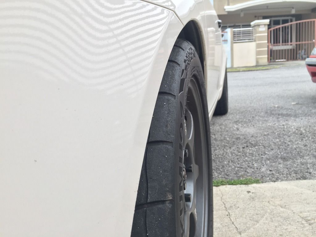

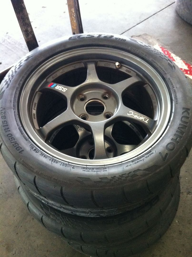

IINm is 12mm ID
Good tires to recommend for gaga owners...cheap and grippy.

QUOTE(TitanRev @ Jul 23 2015, 01:35 PM)
IINm is 12mm ID
for you cheap only...
IINm is 12mm ID
this one berapa cent per pieces? hahaha

QUOTE(THE CLASS OF 13 @ Jul 23 2015, 09:12 PM)

QUOTE(TitanRev @ Jul 23 2015, 09:26 PM)
not bad la the price but still couldnt afford 😂and tyre so tebal meh the sidewall? 50 series only look like 55 sumore this is semi slick right?
IINm is 12mm ID
expensib lo... i poorfag... and u say grippy ? try go parking lot and go thru a puddle of water...

QUOTE(kenjilew @ Jul 24 2015, 12:22 AM)
NMGH you also using this tire and u say poorfag lanjiao...hahaha parking lot bukan Tarmac... But water puddle yesterday sudah kena but better than my re002
