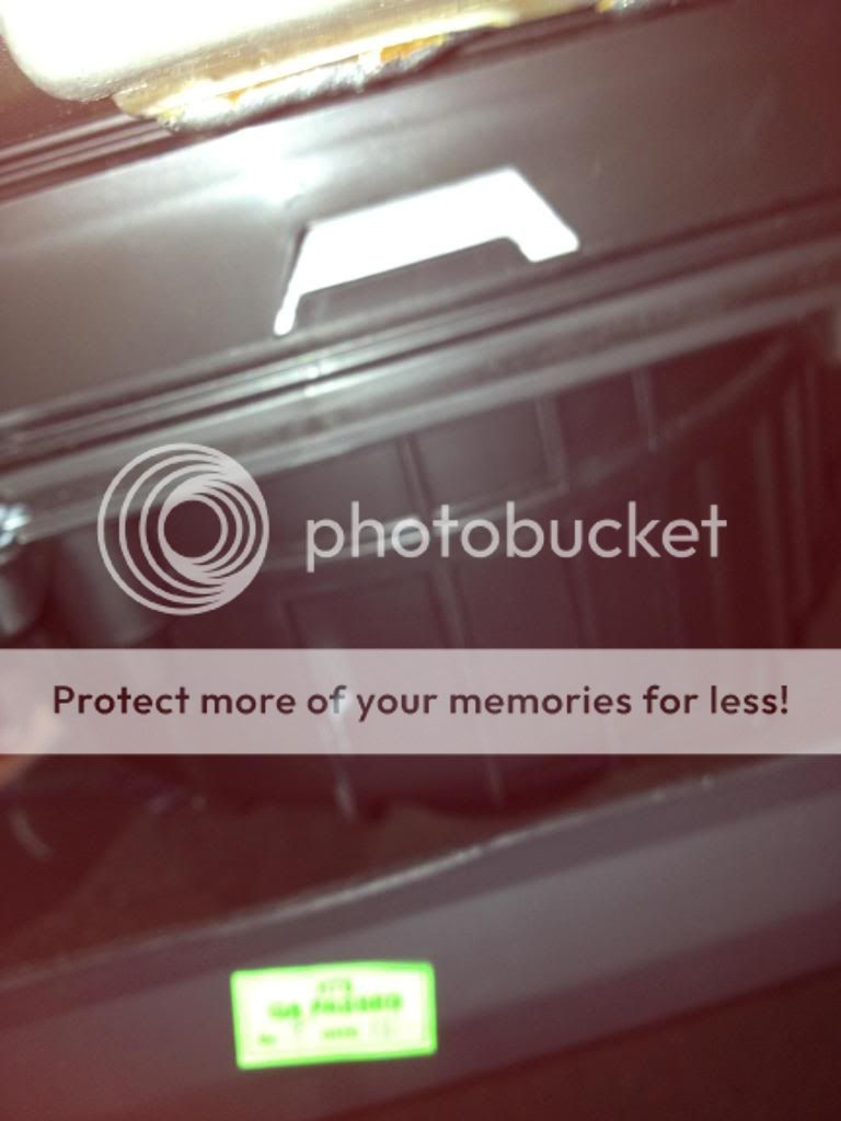

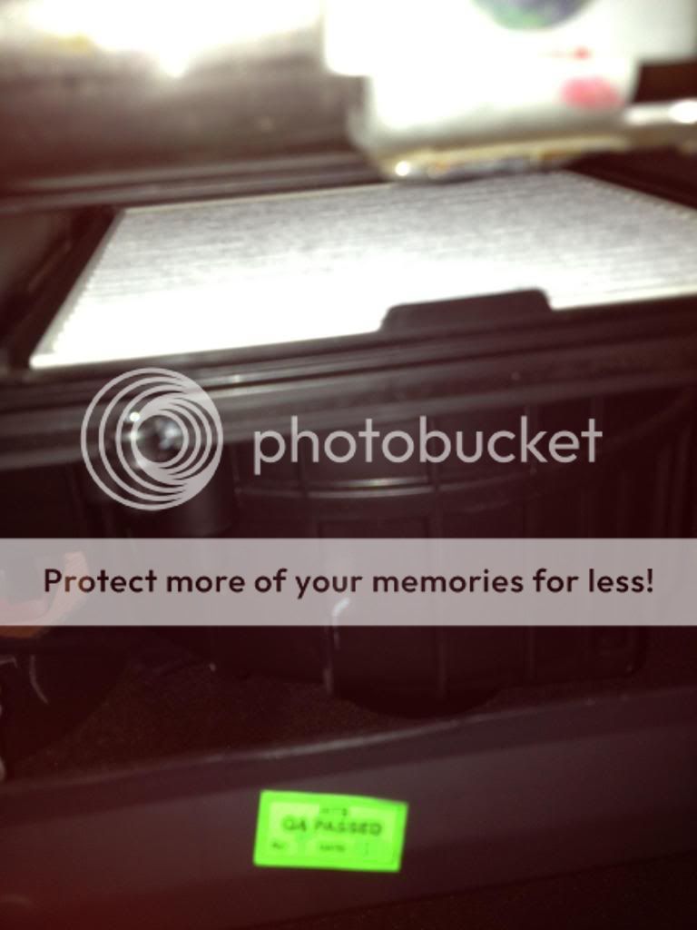

Makai! Bought the car less than a year, now aircon now more wind blow liao ar?
You may clean the pollen filter yourself, it will helps for sure.
Otherwise if you have a paper cabin filter, please make sure you change it if it's too dirty.

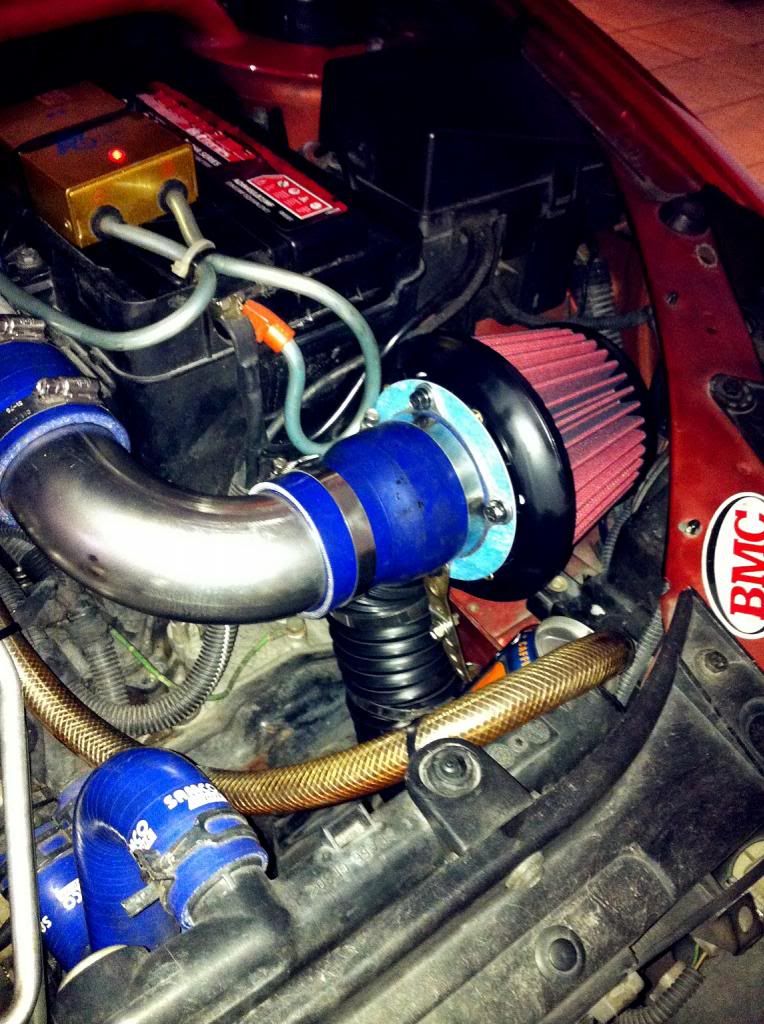

QUOTE(mengsuan @ Jul 22 2013, 11:38 PM)
For anyone who wonders what is BOT like without management on Saga BLM

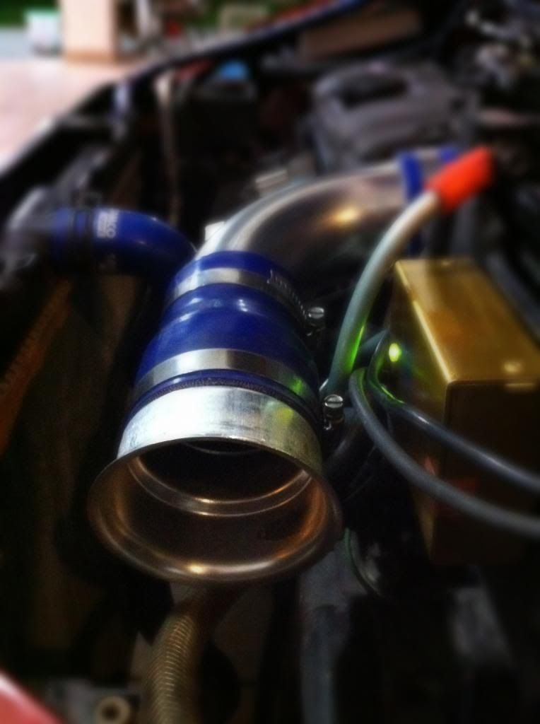

lol 0.3bar only...

QUOTE(TitanRev @ Jul 23 2013, 01:08 PM)
Once the MAP sensor detect boost, the light goes up. But 0.3 bar is really nothing. Too weak to give any siginificant gain or damage tongue.gif

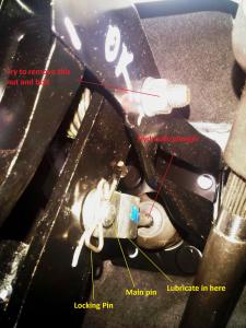

QUOTE(garddemmet @ Jul 23 2013, 01:15 AM)
Hi,
I just bought my gaga two weeks ago. Naw, i keep hearing "tik tik tik" sound from the driver seat door  mad.gif . looks like some loose plastic or someting  doh.gif . Anibadi know how to fix that?  icon_question.gif  icon_question.gif  icon_question.gif
2 weeks ago? Lol...
https://forum.lowyat.net/index.php?showtopi...post&p=28711525
Discovered 2nd day after got my car. FYI, almost 3 years ago, until now the new car still same problem, means no improvement over these years by Proton. Go SC just waste of time.
This post has been edited by coolkwc: Jul 23 2013, 01:48 PM

QUOTE(mengsuan @ Jul 23 2013, 01:43 PM)
so minimum how many bar to gain? 0.5? until how many bar can the campro internal withstand without modifications?

QUOTE(billy520 @ Jul 23 2013, 02:00 PM)
Stock internals safe boosting is 0.7 bar. 1 bar has been done before too, but this is if you're willing to take some risk. By changing to metal gasket, it decreases compression (because gasket is thick by 1mm), can boost more with less risk.

QUOTE(Noobdao @ Jul 23 2013, 02:15 PM)
QUOTE(mengsuan @ Jul 23 2013, 02:19 PM)
sos? i dont thin will be safe as well in 0.7 bar boost... sure sumthing will break... hmm.gif

QUOTE(dares @ Jul 23 2013, 02:06 PM)
Handle or lock linkage.
Can that be fixed in SC ?
another question, i see the service book got mention there 1k Km or 1 month for the first service, is it which ever come first? or wait untill 1K km rclxub.gif ?
dares
post Jul 23 2013, 03:53 PM
834 posts
Joined: Jul 2011
QUOTE(garddemmet @ Jul 23 2013, 03:52 PM)
You can try to get it fixed at the SC, but don't get your hopes high.
Whichever comes first.

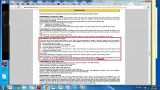

QUOTE(s@ni @ Jul 24 2013, 05:07 PM)
guys, those below 25yo, if u wanna renew insurance, etiqa will impose additional 10% on your insurance due to the age. they just implement it.
Where got 10% ... no la .... for car below 1400cc, sum insured 42000, age 25 above RM1310, age 24 and below RM1337 only ... so different RM27/1310 = 2% only

QUOTE(garybenjamin @ Jul 24 2013, 05:34 PM)
the CS calculated in front of me.. and it does not reflects on my insurance summary as well doh.gif they hide it very good
but anyway, i maybe have faceprob laugh.gif ... naik lrt je pergi renew insurance @ etiqa tower bangsar

QUOTE(drfeelgood @ Jul 24 2013, 05:48 PM)
then dun buy etiqa lor....
chiu! got so many insurance.... buta buta also can renew at pos office....
For your info actually it is not a new thing and every insurance do got this clause ... just age different ... kurnia is 23 years old and below
sauce ... this sause is since 2011 ~

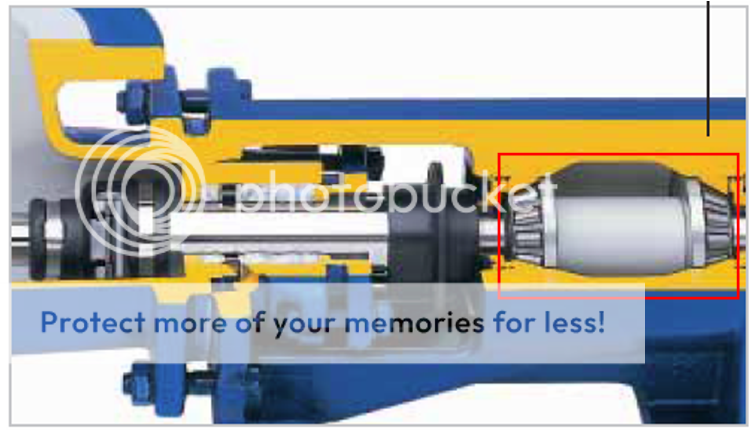

davidke20
post Jul 24 2013, 10:33 PM
3 posts
Joined: Mar 2012
QUOTE(Noobdao @ Jul 24 2013, 10:17 PM)
I cant see any different...LOL>...I means on features~
This 1 if rosaked... ... in case if you don't realize the left bearing is busted, the right is new
Become like this
The flat bedded rollers will deform, and the whole cone will detached from the housing, so as your wheel (my wheel in this case) yawn.gif It may give some sign/warning prior fully malfunction, but it usually a very short notice. Some can last few months, some 1 day. Mine was extreme condition, so the signal only managed to emit few seconds before the wheel fly off doh.gif
Added on
properly designed car
Picture below, is already a rosaked bearing. Pay attention to the ball seated at 9 o'clock. It has free play, meaning to say the steel ball already shrink due to wear & tear friction. As and when you wheel spin, the surface contact reaches this ball, the surface will knock on the contact and will emit humming sound, which will channel to your cabin. It can stay rosak for a very long time, atleast 5~6 years without the ball fly off.
The bearing structure is so strong, before it deform, some other thing already gave up whistling.gif
Get the picture?

QUOTE(davidke20 @ Jul 24 2013, 10:33 PM)
Become like this
Added on
Get the picture?
wah....when it broke....the effect...hmm....I know that myvi and vios is not the safe car btw...Honda?U know which type they use?
Become like this
Added on
Get the picture?
lucky you are safe.....
haiz.... small thing like this also so dangerous.... how are we to troubleshoot and be prepared for this defect?

Just to give my thoughts on the bearing type.
Ball bearings (BB) vs Tapered Roller bearings (TRB).
Actually, both has it cons and pros depending on how they are used and applied.
Ball bearings has a much lower surface contact area than tapered roller bearings which hence makes them less capable of absorbing the stress and load from the rotating shafts.
*Imagine a sphere and a cylinder on a flat surface, and you will notice the contact surface area difference.
As you can see in david's pic, TRB has a much wider and more surface contact area which makes them ideal for better stress and load transfer.
Ayam work for a German pump manufacturer company and our pumps uses such TRB as compared to our competitors which sticks to the BB which is of much lower manufacture price.
In fact, it is our HQ that insists they want to stick to this bearing design so that we have an upper hand to our competitors.
See below.
Like I said, both BB and TRB has its own pros and cons.
TRB is good for more efficient transfer / absorb of stress and load due to bigger surface contact area.
However, like david explained, they are not good for absorbing shocks.
This is true when it is used for our cars and in Malaysia.
With all the uneven roads, potholes, bumps, extreme speed breakers & etc., they are just too much for such TRB bearing type to work longer or comparable to BB.
Also not to mention the driver's driving style. Sudden pecut and hard braking. All these are not good stuffs for TRB.
In my company's pumps, they do not subject to shocks as much as our car wheels.
No uneven roads, potholes & etc.
We do not operate the pumps suddenly from slow shoot up to high speed and then from high speed, slow down again.
It's only the stress and load from a rotating shaft that the TRB needs to handle, hence, the service life of TRB will be much higher than BB in my case.
Hence, both TRB and BB has its own pros and cons depending on the application.
TRB may be good for my case but bad if used on cars.
Above are ayam theories based on my technical expertise that I have now on bearings.
Kindly correct / advise me if I'm wrong.
