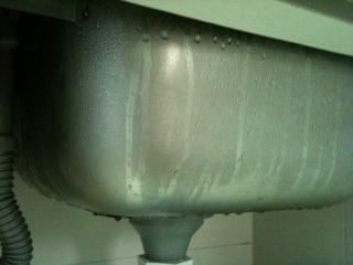

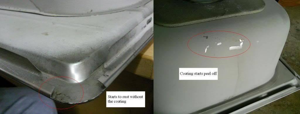

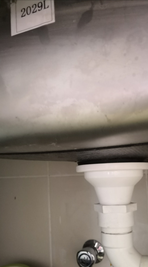

may i know what is the purpose of the coating at the bottom of the sink. some of the sink don't seal with the coating.. is't ok without it?
beware of one shop at kajang. Sorento sink model SRTKS 2029L (1 and 1/2 bowl), they claim with special promotion at RM550. they said 1.0 mm thickness, one piece sink and retail price RM950. but when i check with catalog, not 1.0mm but 0.9mm and retail price RM800. maybe someone can clear about this.. or is't different with 2029 and 2029L model...
This post has been edited by aerozs: Mar 27 2011, 11:56 PM
zheilwane
post Mar 28 2011, 12:06 AM
4,184 posts
Joined: Jan 2008
From: Builders Hardware Enterprise 0362572412
Sorento only have one model SRTKS2029 and the list price is RM 800, thickness is 0.9mm. What a wise consumer you are aerozs, that is why i keep on stressing, there are many shops out there using hanky panky tactics to cheat consumers. Another common trick, they sell u cheap but they exclude the accessories like the Sink Waste which would cause u another RM 30 each.
Coating at the bottom, there are a few kinds. Some TORA sinks have the coating below, like powder paint. Those will come off eventually. Sorento Sinks do not have those coating as it is not required.
A normal coating is actually for cosmetic use, to prevent the sink from rust. A good sink do not require such coating.
A good coating something like rubber is to prevent water condensing at the bottom of the sink. This seldom occur if u r getting a reasonably good kitchen sink. You can check ur old sink to see whether u have this problem.

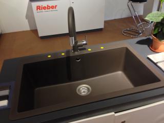

Are those granite sinks any good or are they a waste of money?
zheilwane
post Mar 28 2011, 12:51 AM
4,184 posts
Joined: Jan 2008
Granite sinks are beautiful and durable but very expensive, averagely around RM 1.5k
Here are the info u need
http://www.ehow.com/facts_7768922_advantag...nite-sinks.html
If you are looking for one, i do carry Elleci Granite Sinks. This model TEKNO 490 would look great in ur kitchen
Colour available :
1) AVENA 51
2) BIANCO 52
3) NERO 54
http://www.elleci.com/en/component/catalog...no/Tekno490/262
This post has been edited by zheilwane: Mar 30 2011, 11:51 PM

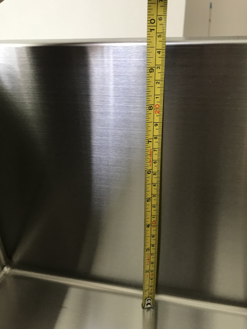

For under mount sink, what is a really good sealant or they call it silicone to seal the gap from water leaking from side?
secondly, saw most of the Sink Depth is about 22mm ~8.7inches. Once I saw a 10 inches depth sink. Would it be too deep until need to bend down to pick up a spoon/ folk for instance?
zheilwane
post Mar 28 2011, 01:21 AM
4,184 posts
Joined: Jan 2008
QUOTE(chanlman @ Mar 28 2011, 01:05 AM)
Hi All,
This, u can PM ryansia as he is using a 250mm(10 inches) depth undermount sink

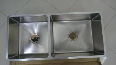

zheilwane , i've PM you. maybe you can share with us some nice picture of undermount sink u carrying now.
zheilwane
post Mar 30 2011, 10:23 PM
4,184 posts
Joined: Jan 2008

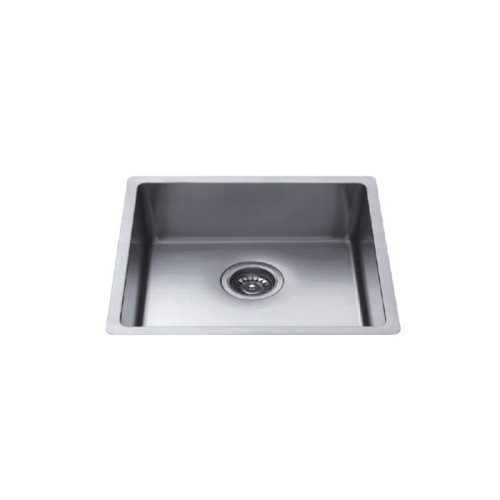

DOnt have much undermount sink model but this is my best seller.
Bought by Ryansia - http://forum.lowyat.net/index.php?showtopic=1761806&hl=
For Top Mount, can seriously consider SORENTO. THese are my best sellers
This post has been edited by zheilwane: Mar 30 2011, 10:26 PM

Joined: Mar 2009
QUOTE(zheilwane @ Mar 30 2011, 11:23 PM)
thanks, zheilwane.
btw, what is the brand of this sink?
what is the dimension?
zheilwane
post Apr 4 2011, 02:59 PM
4,184 posts
Joined: Jan 2008
The dimension is 820mm x 460mm x 250mm

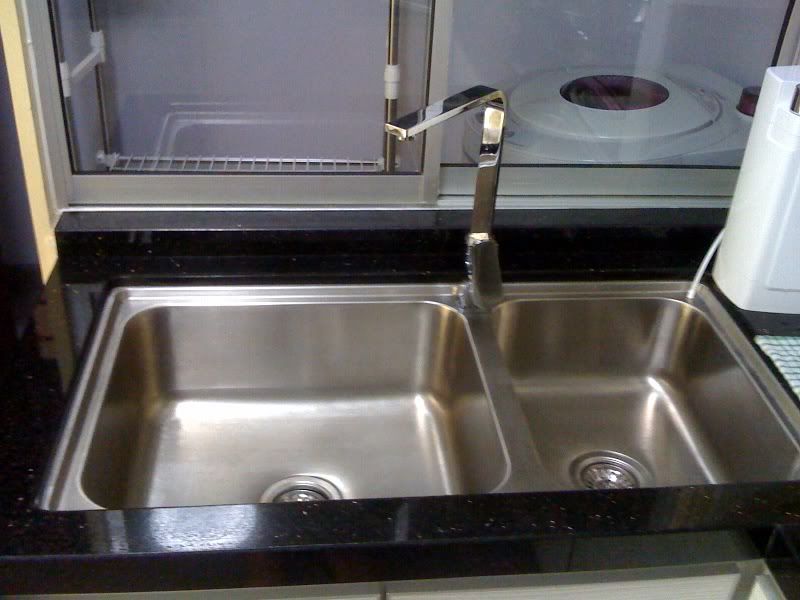

I have been using this Franke sink for over 12yrs. 1 big bowl and 1 small. Below got coating which i dont no what purpose till recently found out.
So far no rust, stain or whatever. Just use detergent to wash and it shine back.

Joined: Apr 2005
QUOTE(zheilwane @ Mar 28 2011, 12:06 AM)
the rubber coating under the sink is more for sound deadening purpose. our weather here (city water supply temperature) will not create condensation. water temp 15deg C may be yes....

zheilwane
post May 23 2011, 02:53 PM
4,184 posts
Joined: Jan 2008

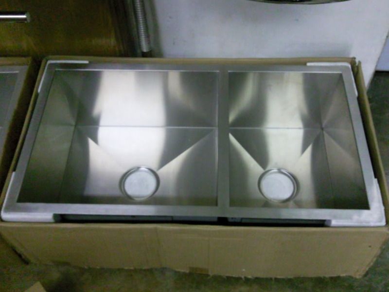

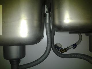

Just wanna share something we discussed previously. Here are some photos of a sink with so called "insulation coating"
This post has been edited by zheilwane: May 23 2011, 02:53 PM
weikee
post May 23 2011, 05:30 PM
10k Club
12,019 posts
Actually if you are a DIY person, you can apply the coat yourself. You can use the under coat for car. It stick like forever if use in the sink.

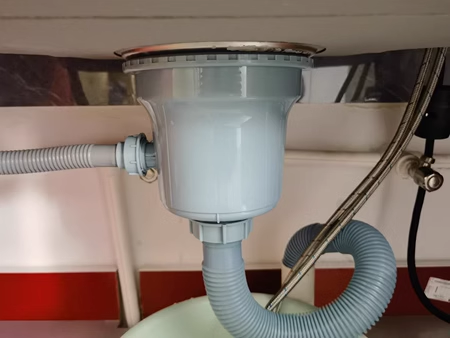

basin Yes, but for kitchen sink, it comes with waste.
ijan80
post Sep 10 2011, 12:04 AM
74 posts
QUOTE(zheilwane @ Sep 9 2011, 09:02 PM)
I bought sorento sink promo rm5xx from u but no waste. So how?
zheilwane
post Sep 10 2011, 12:33 AM
4,184 posts
Joined: Jan 2008

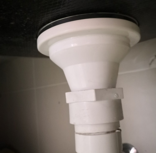

impossible bro, we will let our customer check the sink and waste.
This is a sink waste

Some basin cabinets or glass basin come with pop up waste but ceramic type like orin and johnson suisse do not have waste.
ijan80
post Sep 11 2011, 01:07 AM
74 posts
QUOTE(zheilwane @ Sep 10 2011, 12:33 AM)
Owh..sorry...got it..i thought the waste is the big bottle under the sink doh.gif notworthy.gif

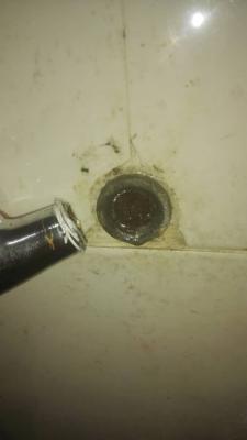

Please get better quality bidet. Else you will find puddles of water in your toilet. Notice the cheaper ones will leak after a while.
My bidet after using refuse to off, water spewing out still. Had to whack it against the wall only the handle will spring back. Whats the problem ? Can it be repaired ?
You can buy the items from those kitchen & bathroom shops.
Chances are your hand bidet has to be replaced. Nowadays these things can't be opened up and fixed.

Anyone has use Tuscani sinks & tap before? Any comment? They have the spray lacquer coating, sound guard undercoating, 10 years warranty for rust but I'm not sure how's the quality.

Hmm.. hmm.gif I'll re-phrase - any one had bad experience whether it rust and then have problem claiming the warranty? Easily dented? Sorento is in my list too. Just eliminating which ever I don't want and then buy the last surviving name.
When it comes to the lacquer coating, some people told me it's not important in our climate but when I think about it; my under cabinet smells damp even though the sink & pipes are not leaking. I tried putting a hypo thirsty in the cabinet and it turned all liquid only after a few days. I didn't put anything else inside it so my guess is the condensation from the sink? Current sink don't have any coatings.

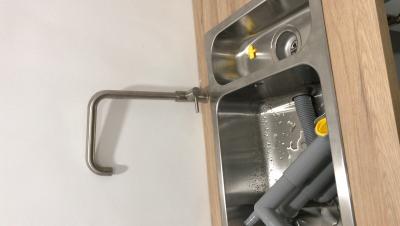

Today finally get the tab in place (D.I.Y) after purchased almost 6 months ago, where sink in place 5 months ago
Combination of Sorento Sink 2028F and Fetone TF-6

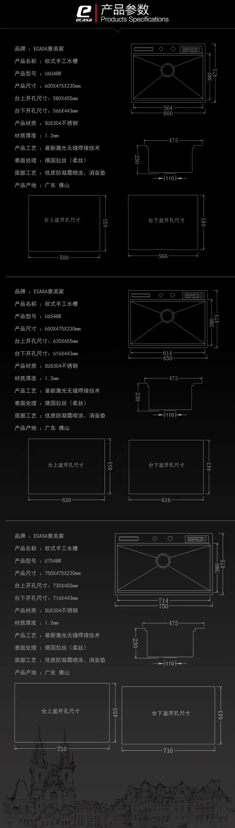

I have Promotion on hood + hob with this sink. THis sink is SORENTO model SRTKS2029. For more info n promo, jus join my facebook

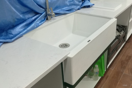

Technistone
post Jun 14 2012, 02:35 PM
4 posts
Joined: Jun 2012
Photo For POALGI (Quartz Sink)
This post has been edited by Technistone: Jun 14 2012, 02:37 PM

QUOTE(Technistone @ Jun 14 2012, 02:35 PM)
Something like the black one in the picture, how much would it cost me?

Hi, got one question here.
My plumber just install a tap to my effegi sink and put all the hose beneath the sink into places. When he tested it, it looks good and no leaking. But after sometimes, the KC floor gets wet and i found the leaking is at the small holes (the holes that prevent the overflow) at the side of the big bowl, as attached.
How to fix it? Can diy? Can glue or not? Or, really need to call the plumber again? And bear extra charge, if any.
Appreciate your comments.

QUOTE(nasyafiza @ Aug 13 2012, 11:35 PM)
The overflow piping should come with the rubber so if you tighten it should be good enough.

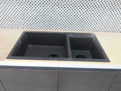

This granite sink is under mount or top mount? so my tap hole will open on granite sink( i dun see hole on sink) or open on my solid surface top?
Thanks

THis is a top mount sink but u can install it as under mount like this.

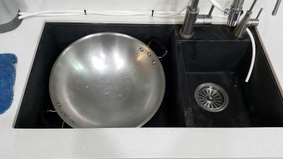

that is the size of the sink. the bowl size :
1) Big : 450x400mm
2) Small : 340 x 400mm

Hi need help here. I bought a sink and the hole is not in the center from front to back. From left to right the hole is in center. So sud the sink hole towards me or the wall when instal?
zheilwane
post Sep 19 2012, 08:56 AM
4,184 posts
Joined: Jan 2008
I guess u r trying to say, the discharge hole is not center? Usually the hole should b facing the wall.

post Sep 19 2012, 08:43 PM
239 posts
Joined: Dec 2007
QUOTE(zheilwane @ Sep 19 2012, 08:56 AM)
Any reason why ? Can it be away from the wall? There must hv been a reason for it to be not center.
zheilwane
post Sep 19 2012, 10:17 PM
4,184 posts
Joined: Jan 2008
herm, y u didnt ask the sales person when u purchase the sink? I think it is jus design, tatz all but u should contact the sales person to double check, usually u can c the brand on the sink, so the brand/logo should b facing you.

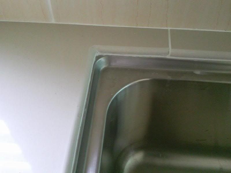

Off topic a bit, but it's still regarding sink. House just finish reno, sink (topmount type) just installed undermount style on concrete countertop with tiles. However, got leaking problem, water will seep through the connection between sink and tile/concrete countertop. Called the wet works contractor, he came and just applied 1 layer of glue around the sink perimeter (connected to the tiles). But said problem will occur again one...how come like that? How to make sure that it won't leak again and again in the future? Anyone can help advice?

QUOTE(cheekily @ Mar 6 2013, 10:31 AM)
Mine also using that setup. But so far no prob at all. Why so much water flowing to the sink perimeter until it leaks? Your sink is not deep enough ka?

QUOTE(platinum_12 @ Mar 7 2013, 01:03 AM)
Umm...how deep the sink need to be? The sink leaking at 1 side, water will drip down from there. Izit the sink need to attach to any glue first before they cement/join to the tiles? Mine not sure how the contractor did, coz was not around to watch when he installed the sink and tile it up...

QUOTE(cheekily @ Mar 7 2013, 09:27 AM)
What i mean is, if d water drips from d joints, there must be a lot of water flowing to d joints. Like my case i cant hardly see any water at d edge of d sink. Anyway, i just ask my contractor about how he install my sink. He actually glued my sink's perimeter with a special cement then he aslo increases d overlap of d sink n d tiled.

QUOTE(cheekily @ Mar 6 2013, 09:31 AM)
Hi ,
Topmount type sink is not suppose to install as undermount style because topmount sink normally come with water seal tape and clip to hold the sink with the table to prevent water seep in (but malaysia contractors are lazy normally they just put silicon to seal it and dun use those accessories provided and cause some seller also dun give these installation accessories).
For your case there are few reason to cause this either the sink is not flat or the table surface not flat enough ( this is normal bcos u r using top mount sink for under mount )
WAY to fix it
1. change the sink ( dun think is a good way bcos u need to hack everything )
2. Apply silicon bottom and above -double protection ( doesn't look nice but can save ur hassle , the contractor said is right .. it got a chance to leak again but if the silicon putting in good way , it can tahan for many years )

Anyone encountered this problem Attached Image
mygan
post Jan 10 2014, 01:08 PM
9 posts
no leakage from sink edge, it's sweating from bowl.
sovietmah
post Jan 10 2014, 02:09 PM
2,243 posts
Joined: Nov 2005
QUOTE(mygan @ Jan 10 2014, 01:08 PM)
This is common if you throw lot of ice into your sink.
halcyon27
post Jan 10 2014, 03:46 PM
2,140 posts
Joined: Nov 2010
QUOTE(sovietmah @ Jan 10 2014, 02:09 PM)
Condensation, common for a stainless steel sink when washing with hot water and then left overnight. Or exposed to sun and then left overnight or placed behind a sunshine-exposed brickwall that is west or southwest facing. Baked throughout the day, the air in the sink cabinet heats up like inside oven while the sink cools off fast such that condensation forms.
One method is to replace the doors with the type that is louvred so as it equalize temperature inside and outside the sink cabinet.

all stainless steel sinks will have this problem unless they are coated. However, u only have this problem if u put a lot of ice in ur sink which is rarely. Alternatively, u can get our granite sink which is scratch resistance and wont have condensation problem

Anyone heard of this sink? http://www.rieber.de/en/home/item/watersta...48%2C143%2C139/

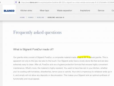

Am planning to use it in my home. Together with a KWC Luna faucet.
When they say granite sink, do they mean pure granite, or granite composite? Cos my understanding is granite can withstand high temperatures, but granite composite may not. Something like solid surface, but mixed with granite chips. So supposing I'm cooking, can I directly pour hot oil into the sink?
And will granite sinks have discolourations and staining too? Read some reviews about some granite sinks having hard to clean stains especially the light coloured ones

Granite sink of course is not 100% pure granite but is very close. It can with stand hot temperature of 100 degrees with no problem. It won't have discolourization. But the draw back is, it cannot withstand strong impact. If you have a heavy pot and drop on it very hard it can crack. Other than that I had been using for 3 years and is still like new

check this out by rieber. the tap same color as the granite. 2.7k i think whole set before nego.
So all the so called granite sinks are composite material right? So is it ok to pour hot oil into the sink? Cos hot oil will definitely have a temperature exceeding 100°c so will it deform the composite material? Also, I've heard that the cheaper made in China sinks do not have discolouration, but after some time, they tend to stain with blackish colour which is hard to scrub off. Is that true? Hmmm...easily cracked? Then I think I'm in trouble. Cos the sink I got has a drainer, and I was planning to use the drainer area as a prep surface if I need to. Without support from underneath, putting excessive pressure on the drainer eg:chopping up a whole chicken might damage it. God forbid if it breaks into two!!!
QUOTE(cstkl1 @ Apr 16 2014, 11:08 AM)
Wow! Looks pretty neat! The place I got my sink didn't offer that. Otherwise I would definitely have gone for this. But I think the KWC Luna should be ok...KWC had some pretty good reviews.
Yes china brand is possible to have quality material. The one I bought is Italian brand. Is quite costly but worth the money. Don't chop like chicken on the granite surface, you will regret later. Had a friend who break the surfaces into many pieces.

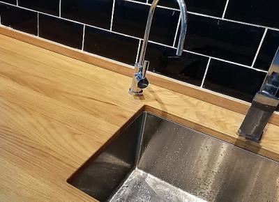

what is the pro & cons of top mount vs under mount sink?
Top mount: easy to replace if your sink stains or rusts.
Undermount sink: water is easily swept into the sink as your top will be one smooth surface up to the sink opening. Looks much better too IMHO. But must make sure proper sealant is applied, otherwise will be troublesome if it leaks from the undermounted edges

QUOTE(dreyvii @ May 1 2014, 12:43 PM)
I'm not a pro, but based on what I observed, the undermount sink sits on a grooved hole in the concrete. Then you just top it up with granite or quartz or solid surface, with an opening for the sink

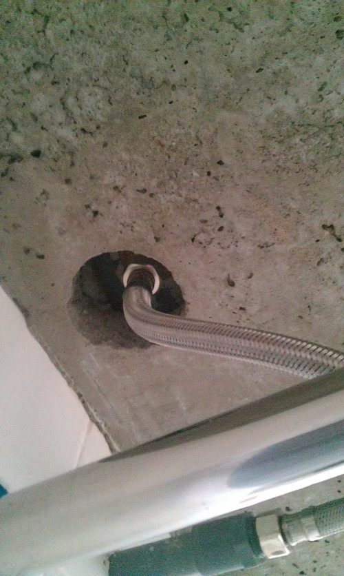

gingerman2408
post May 4 2014, 05:29 PM
102 posts
Joined: Apr 2011

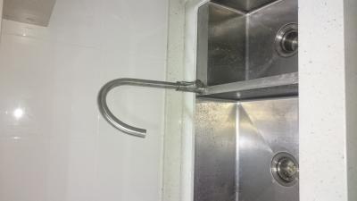

Hi guys..need some advice.
This is a picture of my tap and pipe opening for the sink below it. The distance between the tap and pipe opening is very small, around 30cm only (can roughly gauge using the tile size which is 1ft wide). Then the kitchen cabinet will be about 5cm below it So I was wondering if I can put a deep sink for my kitchen? I think the sink will be around 20-25cm already. Is it possible to connect to the pipe opening via a U-shape pipe or something?
I have asked my contractor to relocate the pipe opening but it is horizontal inside the wall so it will involve a lot of work to relocate it.
What is the best way to fit in a deep sink without relocating the pipe?

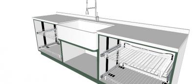

shonen2004
post May 17 2014, 05:54 PM
5 posts
Joined: May 2014
Hi....
I am looking for a white ceramic farmhouse kitchen sink...something like this picture
Anybody knows where to find it?

i have something similar (HCE) i installed it as undermount for my house as per photo
https://www.facebook.com/photo.php?fbid=244...&size=800%2C600

can granite sink install as undermount to my quartz top? can the quartz support the granite? if there is no concrete top, what need to be done in order for the granite sink to be stable? Thanks ya!
idoblu
post Jun 5 2014, 06:31 AM
stars for sale
11,308 posts
Joined: Feb 2008
QUOTE(carfieldfelix2014 @ Jun 5 2014, 12:30 AM)
dear sifus, need your advice here.
I'm researching on this as well but my main question is can it be easily removed in the future? I heard replacing an undermount is really troublesome

My plumber install the sink drainer and I found that it is not consistent and i can see black rubber beneath it as circle in RED compare to the BLACK circle. Did he install correctly? sweat.gif
actually i booked the granite sink dy...the seller told me it can be installed as undermount too. But after gave the measurement to Kitchen cabinet ID, she came back and told me the contractor said, this cant be doe due to too heavy wacko.gif and the quartz top cannot support u
unless make it as topmount. but the idea of putting as undermount is its advantage of easy to clean and dry the water stain....sigh...blink.gif
the one that i booked was Ausco...so now kena check with them if can have another option....but i really like the granite sink...cry.gif

QUOTE(carfieldfelix2014 @ Jun 6 2014, 10:28 PM)
how big is the sink?
does your cabinet have a plywood support for the quartz top?
if got plywood support i dont see why it cant be done. there are tons of others that had granite sinks with quartz counter top
This post has been edited by idoblu: Jun 6 2014, 10:41 PM

it is 1 and a half bowl. never think of plywood support. will it be expensive for that? hepefully the ID can assist la....blessed me...
MonsterPips
post Jun 6 2014, 11:56 PM
332 posts
Joined: Jun 2013
the plywood support come with the cabinet. they will put plywood on top of the cabinet,, do measurement again and you wait for the top to be t
ready.
once ready they will put the top on top of the plywood without removing it
wookp

Cherry.Lil
post Aug 22 2014, 04:25 PM
4 posts
Joined: Mar 2009
From: PJ
Wanted to ask for advice on the black rubber at the bottom of sink.. My old sink is starting to have water leak, I suspect it's leaking from the black rubber. Was told that the rubber is suppose to act as absorbent. Is the rubber replaceable or do i have to change the entire basin to fix my water leak issue?
N9484640
post Aug 22 2014, 04:53 PM
Chasing Electric
1,282 posts
Joined: Aug 2014
QUOTE(Cherry.Lil @ Aug 22 2014, 04:25 PM)
that rubber thing is just for sound deadening. yours is a stainless steel sink correct?
maybe its the drain fitting that is leaking
This post has been edited by N9484640: Aug 22 2014, 04:54 PM

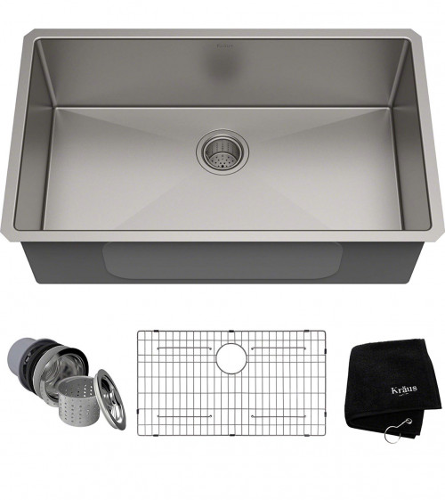

S'aimer

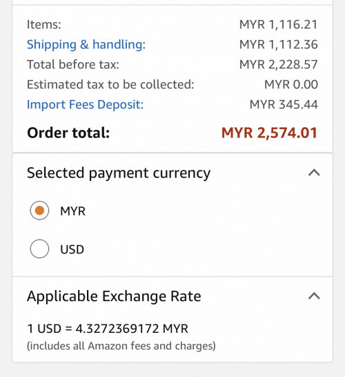

post Oct 3 2014, 06:55 PM
637 posts
Joined: Jul 2010
From: West Malaysia
Definitely expensive. Think will be around 1-2k for the sink alone from amazon. But if can get from TB should be cheaper
OneMoreDay
post Oct 3 2014, 07:03 PM
580 posts
Joined: Aug 2013
QUOTE(S'aimer @ Oct 3 2014, 06:55 PM)
TB?
S'aimer
post Oct 3 2014, 07:06 PM
637 posts
Joined: Jul 2010
From: West Malaysia
TaoBao.
I heard Kraus sink is actually called Sellena in TaoBao.
QUOTE(OneMoreDay @ Oct 3 2014, 08:03 PM)
TB?
OneMoreDay
post Oct 3 2014, 07:19 PM
580 posts
Joined: Aug 2013
QUOTE(S'aimer @ Oct 3 2014, 07:06 PM)
TaoBao.
Thanks,
idoblu
post Oct 3 2014, 10:52 PM
stars for sale
11,308 posts
Joined: Feb 2008
TaoBao.
Kraus and Kohler is the same?
S'aimer
post Oct 3 2014, 11:34 PM
637 posts
Joined: Jul 2010
From: West Malaysia
No. Kraus and Kohler different brands
I just cite kraus as an example in TaoBao because you won't be able to find that many related searches for Kraus sinks compared to Amazon. Saw a few forumers from another forum, mention Kraus is actually called Sellena in Taobao.
Believe can find Kohler sink if you look hard in Taobao or Tmall
