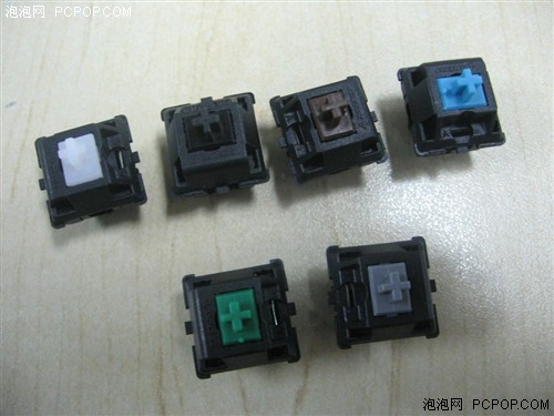

Mechanical Keyboard Switches
Introduction - A Switch is Not "Just a Switch"
    Many people ask for recommendations about switches without knowing exactly what they are looking for, but instead only with an idea of what their needs are. Fortunately, this is not always a problem because most mechanical switches will always feel nicer than rubber domes. However, the final choice is very important because a switch is not just a switch; it is the heart of what makes your keyboard have its feel and your personal tastes can make or break a keyboard for your uses. If you don't like the switch when you type on it, most likely, you won't ever like the keyboard.
    Switches are generally rated by force using the weight measurement of Grams (g). Although force is more accurately described using Centinewtons (cN) However, 1g of weight applies about 1cN of downward force, so we can use "55g" when describing a 55cN-rated switch because that is sometimes easier to understand. For this fact; we'll use Grams as a measurement of force; though either term is correct.
Cherry MX Black Switches
Type: Linear Switch
Link: Datasheet
Tactile: No
Clicky: No
Actuation Force: 60g (40g-80g overall) (Force Diagram)
Key Travel: 2mm to actuation, 4mm to bottom
    Cherry MX-Black switches are linear (non-tactile) switches, these are considered one of the best switch types for gaming. When gaming, having a tactile bump does absolutely nothing because you're going to be bottoming out anyway. So these give you a very smooth feel. The actuation and release points are at the exact same position as well. So games that require a lot of double tapping become easier than on any other keyswitch. However, most people don't enjoy typing on them that much do in part, to their linear nature.
    If you're a person who tends to hit a wrong key every so often while gaming, these will be beneficial in that the high actuation force will help prevent many of those accidental presses.
Cherry MX Brown Switches
Type: Tactile Switch
Link: DataSheet
Tactile: Yes
Clicky: No
Actuation Force: 45g (55g Peak Force) (Force Diagram)
    Cherry MX Brown switches are considered a middle ground between typing and "gaming" switches. They have a light, tactile feel half way through the key press that lets you know the switch has activated. This gives you an indication of what you can release the switch. The switch is considered a middle ground because the reset point & actuation point are close enough together than you can "float" at that point, enabling you to double tap faster.
    As a note: this switch actually has a peak force of 55G, it is 45G at the point of actuation. This is due to the design of the Cherry switch itself.
Cherry MX Blue Switches
Type: Tactile & Clicky Switch
Link: DataSheet
Tactile: Yes, precise
Clicky: Yes
Actuation Force: 50g (60g Peak Force) (Force Diagram)
    Cherry MX Blue switches are the best cherry switch for typing. The tactile bump can easily be felt, and the resistance is similar to your average keyboard.
    Although many people find them just fine for gaming, some don't like the fact that the release point is above the actuation point. This can cause some trouble with double-tapping. This is usually the case with someone who has experienced other mechanical switches before hand.
    As a note: this switch actually has a peak force of 60g, it is 50g at the point of actuation. This is due to the design of the Cherry switch itself.
Cherry MX Clear Switches
Link: DataSheet
Tactile: Yes
Clicky: No
Actuation Force: 55g (65G peak force) (Force Diagram)
    Cherry MX Clear switches have often been called "stiffer browns" though some users note that they have more of a tactile feel than browns do. This really can be a subjective topic, though this is another switch that could be considered "ballanced." The force required is comparable to most rubber dome keyboards, with a nice tactile feedback to tell you the key has actuated. These switches are harder to find on keyboards.
    As a note: this switch actually has a peak force of 65g, it is 55g at the point of actuation. This is due to the design of the Cherry switch itself.
Cherry MX Red Switches
Type: Linear Switch
Link: DataSheet
Tactile: No
Clicky: No
Actuation Force: 45g (Force Diagram)
    Cherry MX-Red's are another switch that can be considered a "gaming" switch. It's essentially a lighter version of the MX Black, requiring less force to actuate. Most people do not find this switch that good for typing or gaming because it is so light. This switch is hard to find; and was reported as obsolete. Though some board makers still use it for Special Edition keyboards.
Buckling Spring Keyswitches
Type: Tactile & Clicky Mechanical Switch
Link: Patent
Tactile: Yes, very precise
Clicky: Yes, loud
Actuation Force: 65g-70g (Force Diagram)
Key Travel: 2.3mm to actuation, 3.7mm to bottom
    Buckling springs are pretty straightforward once you see them in action. After pushing the key down a certain distance the spring buckles under pressure, causing the hammer at the bottom to hit a membrane sheet and create an electrical contact. The buckling of the spring also provides tactile feedback and a satisfying click as it hits the shaft wall. And you might also notice through the force diagrams that this is the only mechanical switch where the tactile and audible feedback correspond to the exact moment the switch actuates.
Black Alps
Type: Tactile Mechanical Switch
Tactile: Yes
Clicky: No
Actuation Force: Simplified 60g, Complicated 70g (Force Diagram)
Key Travel: 3.5mm
    Black Alps are one of the two most common Alps switch types. Many people do not like these switches due to the fact that they are stiff, bottom out hard, and tend to develop friction in the travel as they wear. Nonetheless, they are an improvement over most rubber dome keyboards.
    There are two different types of Black Alps switch - an older type known as the "Complicated" due to the large number of parts in the switch, and a newer type known as the "Simplified", which was manufactured by Alps and some other companies. Complicated switches are common in many older keyboards, particularly the Dell AT101W, which is a very common mechanical keyboard from the 1990s.
    The most well known Simplified Black switch is made by a company called Fukka, and was used in the ABS M1. The Fukka switch has less resistance, but many claim that it provides less solid tactility than the complicated switch.
White Alps
Type: Clicky & Tactile Mechanical Switch
Tactile: Yes
Clicky: Yes
Actuation Force: 60g-70g (Force Diagram)
Key Travel: 3.5mm
    White Alps are one of the most most common Alps switch types. These are far more popular than the Black switches due to more pronounced tactility, and the lower force requirements of some versions. Like the Black Alps, White Alps are much easier to bottom out on compared with other mechanical keyswitch designs.
    As with the Black switch. there are Complicated and Simplified White switches. The two most popular Simplified White switches are the Fukka and the XM. The XM is almost universally considered to be a terrible switch, it was used on some older Filco Zero models, and some vintage keyboards. The Fukka switch is quite popular, and some people prefer them over the Complicated switch. It is used on some current production Alps keyboards such as current production Filco Zeros, Matias keyboards and some others. Complicated White switches were used on some well made keyboards from the 90s such as the Northgate and Focus keyboards.
    There are also a variety of White Alps-like switches of varying quality. Some, like the SMK Monterey, are considered very pleasant to type on..
Topre Key Switches
Type: Tactile Capacitive Switch
Link: Patent
Tactile: Yes
Clicky: No
Actuation Force: 30g, 35g, 45g, 55g depending on model (Force Diagram)
Key Travel: 4mm
    Topre switches are somewhat of a hybrid switch, and are capacitive by nature. The Topre mechanism uses a spring underneath a rubber dome, and the depression of the spring causes a change in capacitance between the underlying capacitor pads. With this change in capacitance; the switch activates.
    Topre Switches are considered some of the finest switches available, as they offer a very enjoyable typing experience with a quieter experience compared to a Cherry MX, Alps, or Buckling Spring switch. The reason is Topre switches have the smoothest force gradient even compared to Linear switches like MX-Reds and MX-Blacks.

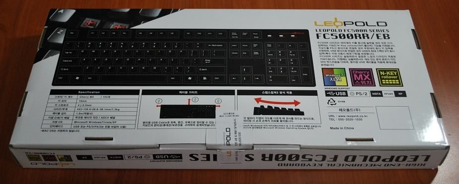

But some people might be quite confuse why Leopold Keyboard has multiple versions like FC300R, FC500R, so i'll make some explaination here.
The model number has something to do with the layout.
FC300R = Korea Layout(Possible to only have English Lettering as well as Blank)
FC500R = US Layout(Possible to have Blank)

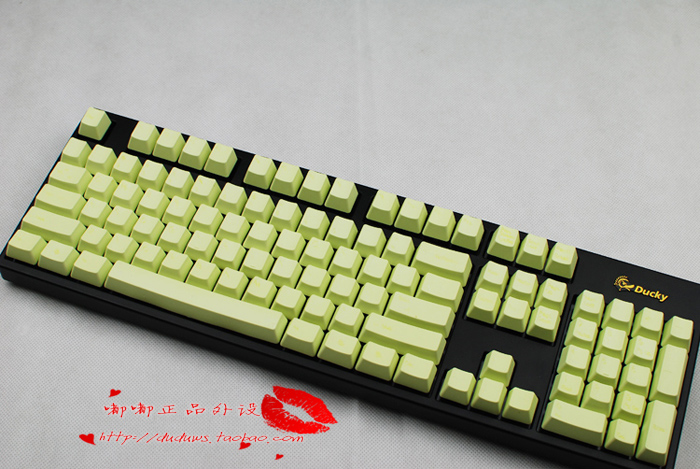

@cyclone , i prefer this. got?
黑同刻 (black word on black keycaps)
Added on March 21, 2011, 10:05 amthis also very nice

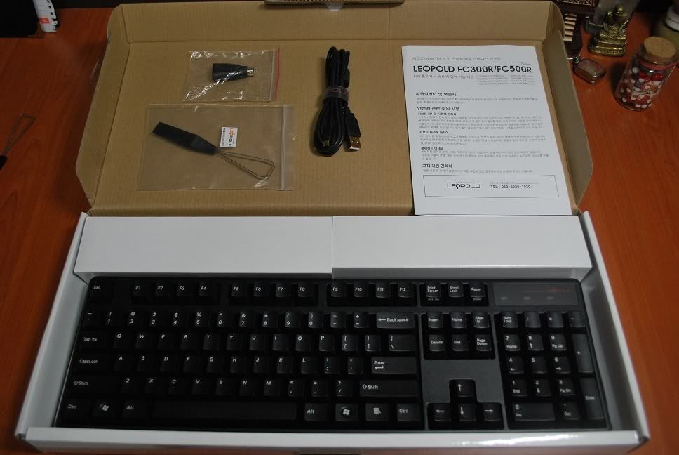

@zandara
Once i got a unit, i'll post a unboxing picture regarding of what will be included inside, since now i am not sure.

Those keycaps are Ducky Black on black Keycaps and White on white keycaps. So Leopold doesn't have them.
Currently my plan is getting a otaku version, and then purchase black on black PBT Keycaps 37 alphabet+Direction key from KBC Forum.(Should be under RM50)

btw, does anyone knows what's the difference between green switch & blue switch?
angelofro
post Mar 21 2011, 04:15 PM
385 posts
Joined: Nov 2007
green switch? u mean 青轴?

QUOTE(angelofro @ Mar 21 2011, 04:15 PM)
no, what i mean is 绿轴

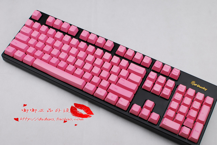

Added on March 21, 2011, 11:45 amJust found something that fits those with PINK FETISH
http://www.armygroup.com.tw/shop/goods.php?id=3604

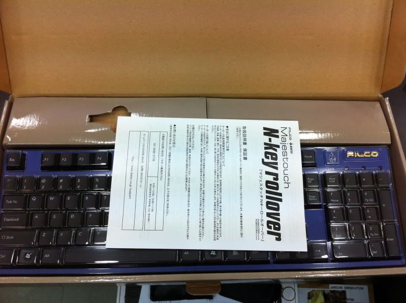

zandara
post Mar 21 2011, 11:15 PM
Ohio
1,203 posts
Joined: Mar 2007
From: 192.168.1.1

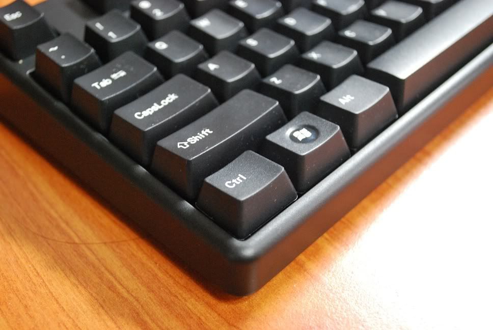

Attached Image Attached Image
kaiserreich
post Mar 21 2011, 11:17 PM
Pendekar Papan Kekunci
4,234 posts
Joined: Sep 2006
QUOTE(zandara @ Mar 21 2011, 11:15 PM)
Lelong @ RM330 is that you?
This post has been edited by kaiserreich: Mar 21 2011, 11:17 PM

You can get the extra PBT keycaps with english/chinese/blanks from taobao/PCHOME
or PBT engraved keycaps from taobao, and imsto in Geekhack. Imsto has a store in taobao and ships internationally.

3.Leopold FC300R/FC500R Cherry MX Red(multiple options, you can choose to have black or brown or blue, not just red). Estimated Price RM300~400

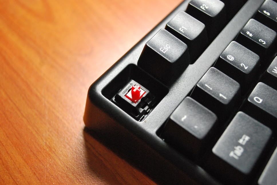

hey, you use your hand to pull the key cap out with force? if you're doign that, i would suggest avoid doing it. mana tahu satu hari POP! whole cherry being pluck out.
BlueBerry~
post Mar 22 2011, 11:11 PM
I play Dota 2
960 posts
Joined: Jun 2007
From: Miri.....
QUOTE(Cyclonechuah @ Mar 22 2011, 11:07 PM)
Done that a few times. And that was just to show you guys its a Red switch. I normally done.
TSCyclonechuah
post Mar 22 2011, 11:24 PM
(  ̄ c ̄)=c |。◕‿‿◕。|
1,726 posts
Joined: Oct 2007
From: Taiping Perak
QUOTE(BlueBerry~ @ Mar 22 2011, 11:11 PM)

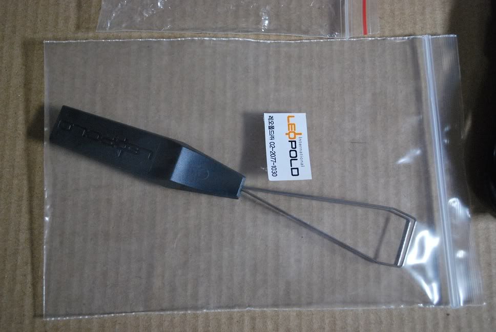

the correct way is to use the key cap puller, attach it under 2 corner of the key cap, and then slowly pull up by using increasing force, don't sekali gus UHHMPP!! pop keluar. i scare one day that will really happen. = =
Btw, currently if you still not yet know the proper to take keycaps off. i would suggest you avoid taking big key cap out, example of space, shift, enter. these key are very dangerous when pulling out.

Been reading much on more tactile brown switches, that is the Cherry clears.
Does anyone has any experience with it?

QUOTE(kaiserreich @ Mar 23 2011, 02:25 AM)
have you tried the cherry browns? clears are like browns in terms of noise level, but they have a more prominent bump at the halfpoint. it's more like the blue without the high-pitched sound.

QUOTE(kev da man @ Mar 23 2011, 09:58 AM)
Yes I have tried cherry browns.
Looks like clears might be the switch I am looking for, though i really want to research everything nicely before making a purchase.
I read too that Clears are rather stiff, almost like Blacks? I have never tried blacks before.
My primary usage is for typing. Would typing long time on clears tire the fingers easily?

QUOTE(kaiserreich @ Mar 23 2011, 10:53 AM)
i hate black because they tire my fingers out typing on them tongue.gif don't know bout the clears coz when i tried out the only one that was selling in cleverly it felt okay. in the end i chose brown to be safe.

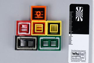

Because oh shit and damn it will not be able to installed into Cherry MX Switch.
Look at this picture, you'll understand why it cannot fit into Cherry MX Switch.
Picture Provided By Ripster. Source : http://geekhack.org/showwiki.php?title=Island:9617
The above Orange Key is Cherry MX Switch Keycap. while the key below aren't.
you can see why it cannot be fit into Cherry Mx Switch, but Ripster provided how to mod them into Cherry MX Switch Compatible, requires alot of work thou.

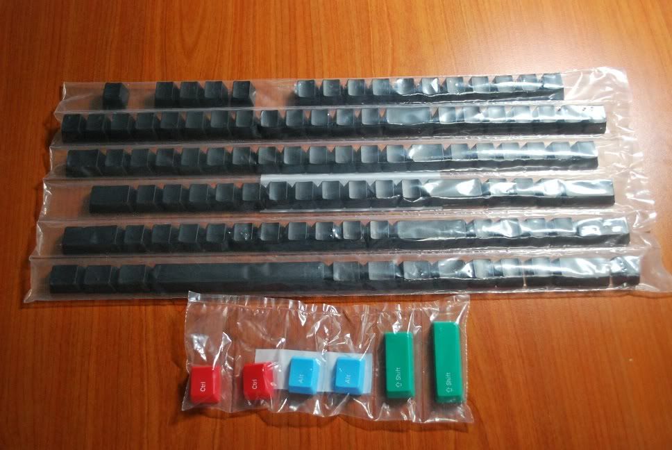

Source
I wonder if they sell doubleshots tongue.gif or would they like them black on black keys

rockccf
post Mar 29 2011, 01:28 PM
215 posts
Joined: Mar 2005
QUOTE(kaiserreich @ Mar 29 2011, 12:08 PM)
Congrats.
Friday order today reach? Its the version that comes with free black on black keycaps?
Actually I ordered on thursday evening.
Yeah that's the version.
This One
I bought a ducky wrist rest too.
QUOTE(Cyclonechuah @ Mar 29 2011, 12:12 PM)
Added, enjoy the keyboard!
Btw, did you get the black on black key caps? to be honest, i have one set as well. But for quality comparison, The quality on the Key caps between on Keyboard and another free key cap set has difference. Keyboard Key caps has higher quality, and silk screen printing has some minor difference which can be notice able.
Yeah I got the black on black key caps.
I did not really go and compare the keyboard keycaps to the free key caps so I did not see any difference.
My initial thought is that the free key caps will be better than the default key caps...
BTW, the keyboard default is black on black too, sometimes really hard to see the key letter lol.

angelofro
post Mar 30 2011, 06:48 PM
385 posts
Joined: Nov 2007

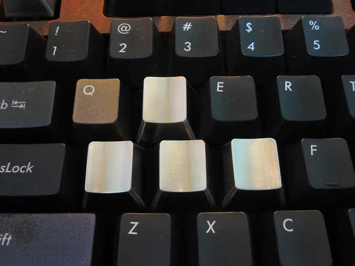

i just changed 4 key... because i use it to play sdo....
here the photo of my 6gv2
This post has been edited by angelofro: Mar 30 2011, 07:10 PM
lucidlts
post Mar 30 2011, 07:11 PM
brain powder
2,906 posts
Joined: Oct 2010
From: hurrr durrrrr?
QUOTE(angelofro @ Mar 30 2011, 06:48 PM)
angelofro
post Mar 30 2011, 07:14 PM
385 posts
Joined: Nov 2007
haha... ya.. just want to try the feel when playing sdo... got brown switch on it too... smile.gif
angelofro
post Mar 30 2011, 07:32 PM
385 posts
Joined: Nov 2007
don't want use the grey switch... if use it to play then will died in few months.... cry.gif

Getting some green blank keycaps soon. Woot.

must buy these keycap to bling it up more my blackwidow

可定制个性图案键帽(20元/颗)
Google Translate:Custom designs can be personalized Cap (20 yuan / pcs)
http://item.taobao.com/item.htm?id=7834736444
lets create our own logo. lol

Just received my switch try stuff from Taobao. Tried out blues, browns and clears. More to come, but that'll be another week or two for the black
Now i know why they say blues have a double tapping issue. Browns feels very light after trying out Blues and clears. And Clears definitely feel like theres something on the bottom preventing you from bottoming out.
And yet, I am still confused as ever on which one to get for the keyboard purchase.

Added some new keycaps to my BWU. If your wondering whats with the weird placement. Its cause of my dota hotkeys are all binded that way. lulz.

Its just plastic. Can see on the red ones as well if I have the backlit on to the max.

I cant see the backlit if I swap my 7G keycaps over. Probably due to it being black. lulz.
KepalaRadio
post Apr 6 2011, 12:52 PM
389 posts
Joined: Sep 2008
OMG lol that's neat! Are those doubleshots?
kaiserreich
post Apr 6 2011, 12:54 PM
4,234 posts
Joined: Sep 2006
I'd prefer the blank version. Plus it is cheaper.
@KepalaRadio, those are PBT caps

If it's the metal caps, i would probably consider to get myself a set. tongue.gif

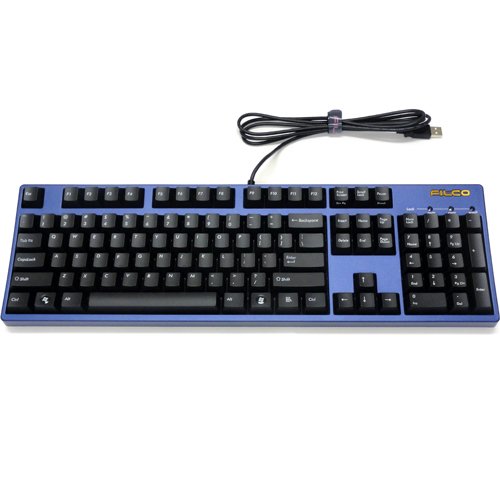

Filco is coming.

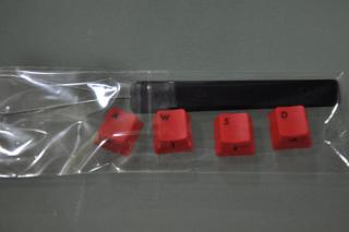

QUOTE(Edifier @ Apr 7 2011, 11:43 AM)
Filco is coming.
Price and ETA?

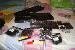

Hi guys, look what came in the mail today
My switch try set
Clears - element14.com
KBC red on red keycaps + Blues + browns from Taobao
Keypad with Mx Blacks from eBay
The keypad was shipped on 31st Mac, arrived ketam 1st Apr. 6 days from ketam to my house, must be a new record
After some soldering:
This post has been edited by kaiserreich: Apr 7 2011, 06:11 PM
