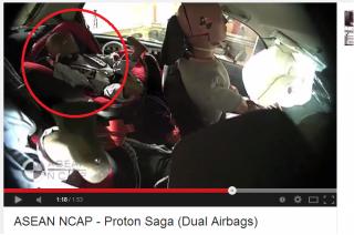

Proton S16 2010 ANCAP Crash Test

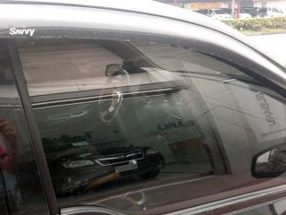

Stock Tint Measurement
Brand Safetint
UVR 99%
IRR 55%
VLT 60%
TSER tarak tau
Thickness 2 mil

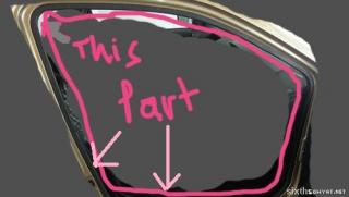

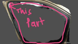

any has this problem?
I realized my rubber door trim
(the one around the hole not the physical door itself) is coming off.
i feel really disappointed as it is just a 1 yr + old car..

the hole after you open your door... for people to exit and go in. lol.

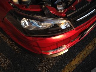

see the pink colour part. .

QUOTE(justinskj @ Apr 10 2014, 10:18 PM)
fall off by itself..
its like the rubber just lost its grip... i never touch that part of the car.. coz no wiring or anything there also..
Grip is provided for by the numerous metal "clips" embedded in the external rubber...
ps. Update: Is yrs an SV...? Hv not seen those in SV...but all cars me hv seen hv that kind of construction...
This post has been edited by zeone: Apr 10 2014, 10:27 PM

QUOTE(justinskj @ Apr 10 2014, 10:21 PM)
if you say the parts the easily to fall off...
is the upper left corner base on the pic...
it's happen to me once....
what i did is take out the panel the hold the strip
and try to rearrange back the rubber strip...
or else since your's still under warranty...and i assume you still doing your regular service in SC...

A car wash guy saw the foam strip on my car, and advise me to insert those aquarium hose into the hollow space of the door/frame rubberstrip instead to reinforce them and keep out wind noise hmm.gif
Re abv, feel it sounds like a feasible good icon_idea.gif ....
Wld make the door OEM rubber seal firmer...
No harm trying...
Hv yu tried it oledi?
Those aquarium tubing harden kinda fast...becoming like "solid rods" instead of flexible tubing... whistling.gif
Since adding the "Big D" rubber seals 2both front doors (where the replacement OEM rubber door seals dun cover...), they now close with an even more solid "Thud" kinda sound!
bumper kemek inside, the reinforcement bar bengkok in until left back 1 finger space before reach CVT cooler.
anybody can advise below ?
101 [All] Bumper Front Cover PW931962 255.26
105 [All] Bumper Front Reinforcement PW835596ED 58.52
1) Item #101 = new bumper ?
2) Item #105 = the reinforcement bar behind bumper ?
bonet still can open and close as normal.
the bar inside the yellow oval not so teruk yet. only let the reinforcement bar pull down abit only.
ketuk back or change new ?
what is the cost to spray back new bumper ?
can the already kemek in bumper still be used ?
Things like dat do happen wan...
Feel best 2leave repair to the Pros...after making known yr prefs...

Keep woranti? Send SC claim OD with your NCD + pay saman. Risk to lose NCD, kena 2 saman, settle with the bugger who u kissed, replace all with NEW, do not ketuk, otherwise woranti void. Dont wanto keep woranti? Ketuk back, bumper change to R3, CVT cooler extend further put at the lower air scope pretend intercooler wub.gif

Just realised ASEAN NCAP video uploaded. (sorry if I slowpoke blink.gif )
Saga FLX (1-star) vs Saga FLX+ 2013-onwards (3-star)
Saga FLX (Single Airbag)
Saga FLX (Dual Airbags)

and here the the best selling passenger car in malaysia
but seeing this video makes me wonder....
why in saga flx they put both child/baby seat were facing to the front..
p/s:

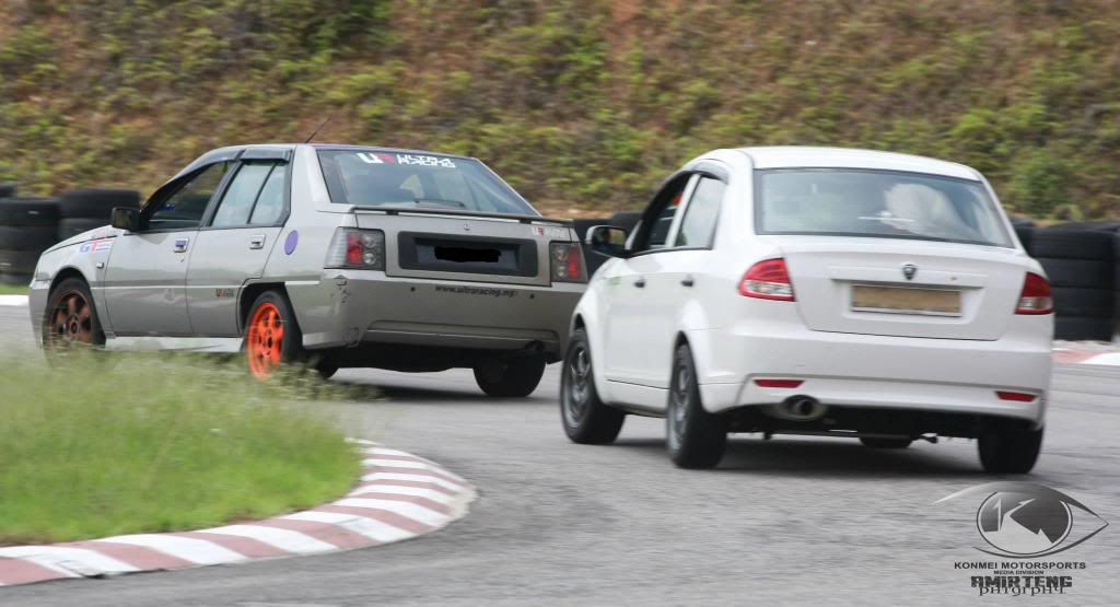

iskazulka
post Apr 14 2014, 09:04 AM
62 posts
Joined: May 2012
Sunday Drive

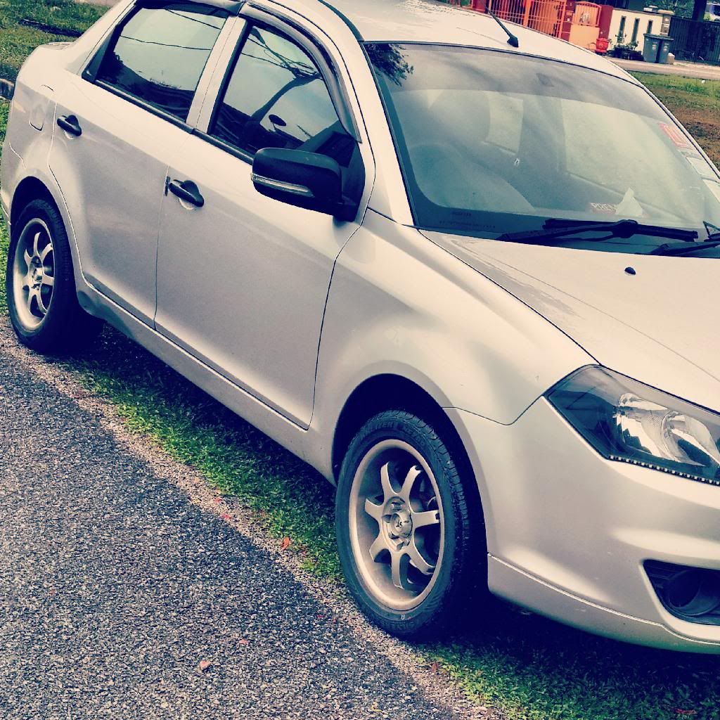

QUOTE(iskazulka @ Apr 14 2014, 09:04 AM)
Sunday Drive

here can see the bar with the bonnet hole oso let the reinforcement bar pull down slightly d.

it's only a bodyworks damage, not even damaging radiator.
for some reason, if they found out that I really did repair bawah pokok, then fark the warranty la. .
I am fully satisfied with my engine and cvt health now and am confident it will survive without issue with normal scheduled servicing.
p/s: just that I kiasi want keep the warranty nia laugh.gif
QUOTE(davidke20 @ Apr 15 2014, 12:03 AM)
knock confirm yes for the bar.
but why need putty ?
spray also spray back the bar only ma.
the bumper, if they can help me twist back and install back, I will use for the moment.
will determine to change new or aftermarket kits later.
btw, the bumper attachments at the bottom part is all unaffected. only the reinforcement bar kemek in.

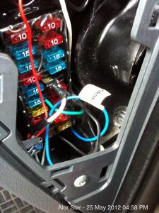

QUOTE(leymahn @ Apr 15 2014, 10:44 PM)
guys, wanna ask something. my car radiator fan won't stop spinning even though i turn off the engine. any solution to this? never happened before. i take off the fuse from the electronic box thingy to make it stop.
usually it is normal if engine too hot and the radiator fan trying to cool down the engine. if keep spining non stop like Beyonce_standard case...
QUOTE(Beyonce_standard @ Jan 6 2014, 01:19 PM)
Finally my NONE-stop spinning radiator fan problem solved. i m here to contribute by sharing my bad experience =p and hopefully if one fine day, any1 of u guys face the same issue, then u can settled with ease.
Btw, its lucky for me to try my luck with the proton dealer sc near taman mayang pj 2day. They only spent 5 mins for the whole process to settle my problem. The culprit of the problem is actually the "relay" as what abang YAB and Dares mention earlier. Thanks god that i dint wait and send my car for 2 days as mention by the SC in Section 13 and Glenmarie.
Although my car is under warranty,  the relay, fuse and bulbs are not covered. So i need to pay rm11.70 for the relay and YES!!!! its dxmn cheap!!!! RM11.70 and solved the irritating problem!! i paid happily and leave.
my car is going to service soon, i think i will stick to the taman mayang sc as they never disappoint me =) After renew road tax and insurance, gonna prepare to change new shoes for my ride^^ maybe 195 50 15?

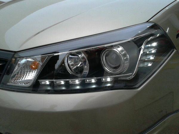

QUOTE(JIEZZ @ Apr 15 2014, 11:35 PM)
anybody know price for saga sv headlamp?

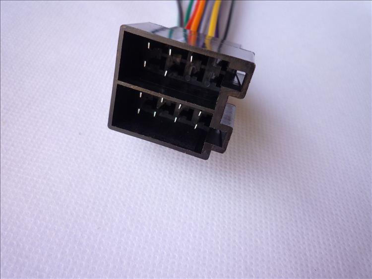

WHo know which type stock saga blm use for HU wire harness?

Can DIY, the hardest part is that your custom HU will almost certainly not have the plug in the picture above. What the shop did in my case was to cut away the above plug and rewire the plug to the new HU. This means the old HU can't be used any more unless you find another plug for it.

plug= ISO wire harness
can get aftermarket 1... this weekend i'll open the HU and check the wiring 1st..
clutch, still same..haha. will try with wd-40 later..haha

QUOTE(V12Kompressor @ Apr 16 2014, 10:10 AM)
RM 474.18

QUOTE(carrera_gt @ Apr 16 2014, 09:38 PM)
because it's led...saga blm one very cheap,lol..

DAP veteran leader Karpal Singh was killed in a road accident when the car he was travelling in rammed into the side of a lorry at the North South Expressway near Kampar, Perak early this morning. NSTP/Supian Ahmad -
even when u dogfight with a lorry behind ur car is very scary.

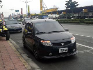

later ask dares go taiwan again. can become saga taiwan ambassador.
