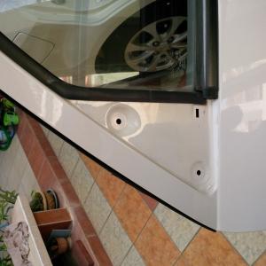

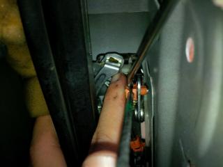

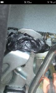

QUOTE(ericmaxman @ Dec 19 2013, 10:52 AM)
Sticky door sensor.
if you can DIY, check it. If not, send to SC.
My rear right door suffer. The rubber cover is the culprit, it become compressed and prevent the switch from fully extend after door opened. So i unplug the rubber cover and the switch work like charm...naked is the best... thumbup.gif

QUOTE(coolkwc @ Dec 19 2013, 11:50 AM)
All the doors except mine got that problem..

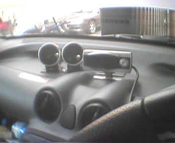

QUOTE(ericmaxman @ Dec 19 2013, 09:14 PM)
kasi adjust a bit
QUOTE(calvin_kenni @ Dec 19 2013, 09:25 PM)
oh ini apa model lai?
those cam that comes with rear view mirror punya? lol
yes. those that comes with built in rear view mirror. Best part is, even if the screen is turned off, it is completely invincible... unlike proton exora's rear view mirror where you can still see the reverse camera screen.

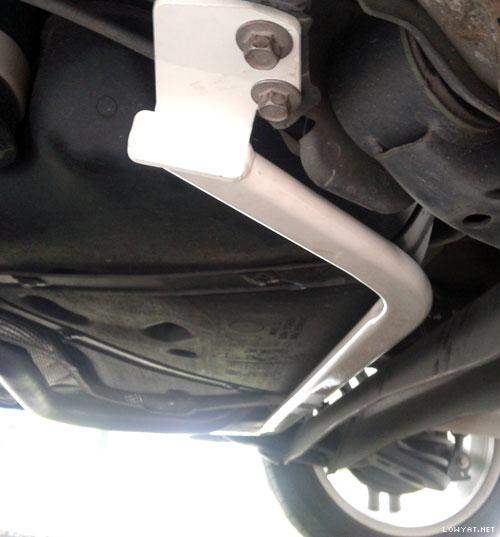

Finally finish install the 3max ARB 19mm haven't fully test yet...will see how it perform after road test...anyway those who using spring at the spring seat you need to remove your spring so not recommend to DIY unless u using HWL adjustable like mine which don't use the spring seat anymore then install will be much easy. Fitting on the bar and the bracket on torsion beam was easy. bracket at spring cup there my right side needed to grind a bit the triangle plate because was touching the lower spring seat only the right one have this problem left side fit straight on without any problem. Taking out the UR "ARB" was going smooth until 1 screw the Allen head loose, damn difficult to take out so weld a nut on top of the Allen screw and use another spanar to loosen the nut.
Wanted to I install my LCP DIY but time was getting late so send car to my usual shop for them to do...then go there kepoh other cars...saw a civic EG with K20A engine from DC5 nice car....Evo 9 with Tomei renesis complete engine pushing 500whp with dog box.
After fitted the LCP engine respond is quicker this mean u jab the throttle a bit you can hear the engine rev already. Before this rpm before 2000 the car felt a bit slow but now the rpm goes up quite fast before 2000 rpm and it climbs all the way up quicker. Engine was still smooth like stock and no vibration as the pulley is porperly balanced (I check with my own machining machine) will continue to notice further
r3apers
post Dec 21 2013, 06:10 PM
225 posts
Joined: Feb 2010
From: Subang Jaya
QUOTE(TitanRev @ Dec 21 2013, 05:54 PM)
OMG, thsn better let factory to install it...
LCP my next year target...lolx
hehehehe,if using ori suspension,will need to twist the spring bushing abit to allow the nut to go in....
btw if i bring my LCP in the future to your place can help me check on the balancing? (obviously at your convenience)
if no also nvm la
