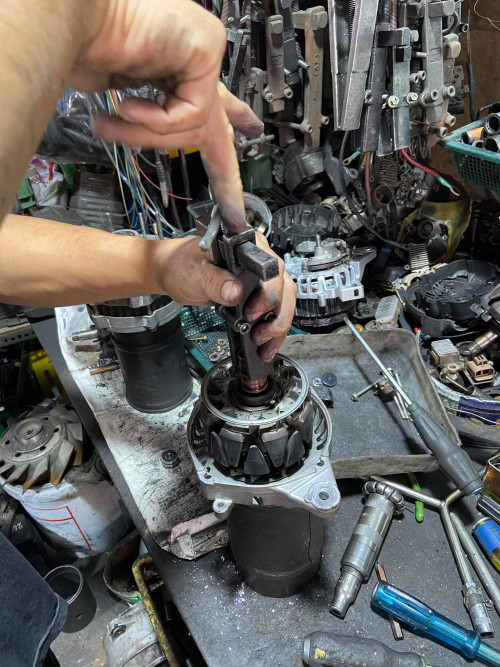

hi,
i recently had problems with my alternator not charging consistently and i wanted to save money from buying new one. I stumbled upon this workshop in Jalan Ipoh where they rebuilt and replace faulty alternator parts.
It is a good place to overhaul your old alternator and starter just the way we all overhaul our old engine
The boss is a silent old chap but very polite, i monitored his work and he was thorough and do things orderly, not very common in younger workshops we see these days where everything is about profit and fame, but working attitude kaput.
Due to his excellent work and experience, i decided to share his shop info here, FYI i am not taking any sort of commission, just a chap who praises a good old school workmanship and working attitude
The worker told me almost all alternators can be fixed without buying a new one as the fault is usually due to malfunctioning parts only, replacing it will make it as good as new.

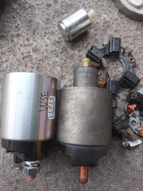

replacing old whining, squealing alternator bearing with new one:
the brushes of my 10 years alternator has worn off, no wonder it causes electrical inconsistency, compare below between new brushes and the worn ones:
i decided to refurbish my starter as well, the brushes was ok but the bush has worn out causing it to vibrate, u can see the scratch black marks on the plate due to scuffing from the starter body when it vibrates, this happens when we crank the engine, anyway they replaced it:
Cost was RM90 for alternator brushes and bearing including labour for removing and reinstalling the altenators, RM45 for starter bush including labour, not bad.

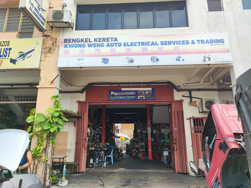

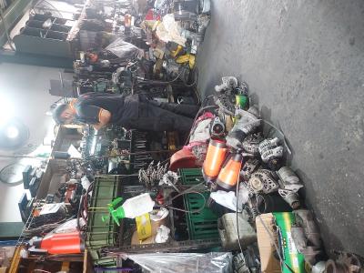

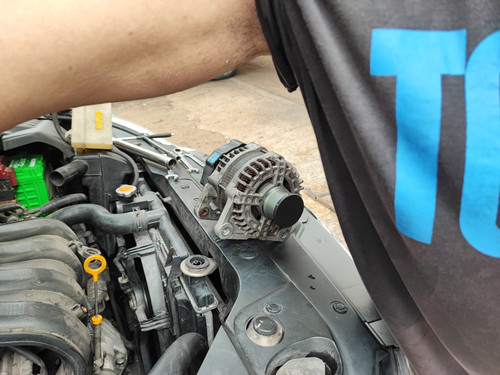

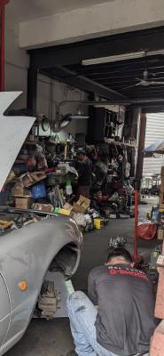

i'm at this shop now and wowow.....so many alternators! everything import from Japan, no OEM. Boss so good...fixing it for me now at RM300.00 rclxms.gif
save alot ler....
[attachmentid=4413661]
[attachmentid=4413662]
[attachmentid=4413663]
[attachmentid=4413664]

QUOTE(michlove @ Apr 16 2015, 02:21 PM)
save alot ler....
cannot replace yours with the Japan imported ones? Let us know the outcome after fix. Do they provide warranty?
michlove
post Apr 16 2015, 02:59 PM
233 posts
Joined: Sep 2009
QUOTE(ReVolVolution @ Apr 16 2015, 02:50 PM)
they are not replacing it. they are fixing it. actually alternator can fix one, you go the normal workshops they sure tell you replace a new or recon one.....this si tao po very nice too...
warranty, didnt say got but if any problem again, ask me to go back.

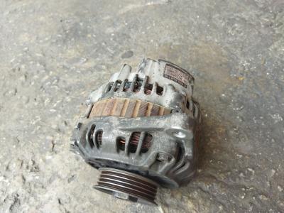

the alternator has like 6 biji fius. one of it burned d thats y my car battery not charging. so the boss changed all 6 fius, eventhough the other 5 is still ok. This is bcos when he import in the fius it is in a set of 6. So might as well changed all and price is still the same. I'm driving back now! woohoo!

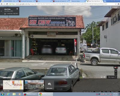

Like to share...this shop in Johor Bahru area, repair alternator, starters and wirings...
13 Jalan Dedap
Taman Melodies
80250 Johor Bahru
Johor
GPS Latitude 1.4903959 Longitude 103.7636188

The pulley, bearing and another small thing as per the picture. Alternator ok, starter also ok, all checked by thenthem

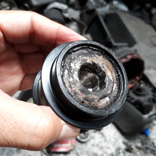

Went there last week (Loc: 3.195690, 101.679685) to change the broken alternator pulley/bearing (after it makes screeching sound). Arrived 10 minutes before 9.30am. When they open the shop, straight away check the car (since nobody else there), check the alternator, take it out & make the necessary repair. At 10.15am, everything's done. Cost : RM260. rclxms.gif

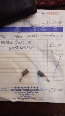

before fail service ur alternator.change 2 bearing&carbon only 120 at my place..carbon is critical component..starter is cheap,just change new.no need service..

Hi All,
Last saturday, I get help from my fren to push the car n jump start it. (Manual)
Drive it straight away to the alternator shop, too crowded!! left it there for 5 hours and ask the uncle to service anything about alternator n starter.
Damage: RM220
- 2 alternator bearings
- starter solenoid (got water coming in it, dunno how)
- bushings
- battery connector head
Turns out, my starter is really kong, I dun dare to test restarting my engine that day. tongue.gif
Uncle said battery still fine. hehe

QUOTE(ace_halo @ Mar 26 2016, 03:53 AM)
The work shop is moved to the place that u mentioned above?the shop name still remain the same?Thank you
Nope, it's still here in Jln Ipoh.
A picture I took just now LoL
https://waze.to/lr/hw2861vc49
Waze location

anyone know if there's such shop in jb?
I'm looking to replace my savvy alternator and starter, although it is still working well.
But been using for 10 years..
If not, can I have this 'uncle' number?
Hi Bro,
can try this shop..Attached Image

hey bro,
thanks for the great help, my perdana consume 3 alternator in 2 years..
each time, got to replace a halfcut, with this, it definitely helps a lot.

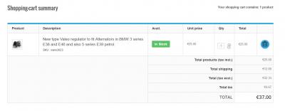

My alternator is Valeo brand, new original Valeo is quoted rm1250 & workmanship to fix it is rm50, just a 30min job. Not Auto Bavaria obviously.
I was given an alternative , fix a Recond Valeo [ same model with mine & the Wireman have stock on hand ] , paid rm650 which includes a 2 mth warranty . This Recond unit was refurbished by Shiling Enterprise , local company.
I was told that my "old" alternator Voltage Regulator behaved strangely & that if I am able to source for that part he will help me to replace/repair my "old" Valeo for rm60 , need grinding of the soldering.
My question is does KW stock the Voltage Regulator for this Valeo brand [ layman terms Alternator's Electronic ] I want to redo this alternator as a spare.

marcin.lad
post Nov 15 2016, 01:28 AM
Joined: Nov 2016
Good day guys.
I wanted to share with you a new website for ordering replacements parts and repair kits for your cars alternators or starter motors. You can buy all replacement parts for alternators and starter motor i.e regulators, rectifiers, brushes, brush holders, bearings, solenoids, gears, bendix, tools and many more all in one place at saverepair
You can easily find any part you looking for by entering your parts serial number in search box, this will bring up all the suitable parts for the part.
This post has been edited by marcin.lad: Nov 15 2016, 01:29 AM

QUOTE(marcin.lad @ Nov 15 2016, 01:28 AM)
Good day guys.
Good link and they ship to MY too,
Standard Delivery 2 to 10 Business Days
Price is good too [ atleast for my make & model ]

propusers
post Mar 7 2017, 05:52 PM
2,006 posts
Joined: May 2011
QUOTE(vsmseiko @ Mar 7 2017, 04:23 PM)
Yes old place. Have not moved to Kepong yet.
There is big used car showroom just next to KM. Separated by a small side Lane.  Easy to drive pass as it quite a small old shop lot.
is it this shop?
photo shared by other forumer.
vsmseiko
post Mar 7 2017, 06:22 PM
66 posts
Joined: Nov 2007
QUOTE(propusers @ Mar 7 2017, 05:52 PM)
is it this shop?
Yes. Best call first but old hp no. Sorry i dont hv old hp no...i just went straight to try my luck....had to wait my turn for over 40mins. Worth the waiting time 😆

Almost the entire alternator needs fixing:
Rotor
IC
regulator
Coil
What carbon brush? (Totally gone lol)

Went there this morning. Young dude did the checking. I said battery warning light goes on and off while driving.
Replaced carbon brush and cleaning the alternator. RM60 including labour.

Hey guys, today 30/10/2017, we are move to KEPONG new address already
KWONG WENG AUTO ELECTRICAL SERVICE AND TRADING
65, JALAN METRO PERDANA TIMUR 7,
KEPONG ENTREPRENEURS PARK,
7th, Mile, JALAN KEPONG,
KEPONG, 52100 Kuala Lumpur,
Wilayah Persekutuan Kuala Lumpur
The official phone number still pending by TM
Tel: 012-2913346
OPPOSITE AEON BIG, KEPONG,
or use Google map, key in KWONG WENG AUTO ELECTRICAL SERVICE AND TRADING

Joined: Feb 2018
yesterday i just had my vios alternator repair at one nice small electrical workshop near jalan loke yew.
people from cheras area can go there as alternative for near location.
it cost me rm250 for replacing 1 set of original fuse and carbon brush less than 1 hour.

For people in Klang and Shah Alam:
Hup Soon Auto & Electric
7, Lorong Selampit 18A, Taman Desa Utama, Klang
03-33238588
Reliable old uncle. Typical oltimer mechanic, so don't expect to be chatty and nice.
Vios alternator was the issue and everyone wanted to cheat by asking to change it.
I have some background knowledge but (big but) did not have the time to open and inspect so my father took the vios there.
Oltimer mechanic said this:
Carbon losak (worn out). Kapla manyak koto wo (dusty on the top)
He used blower and sand papered the coil bearing. Replaced carbon 1 set original Japan.
Voltmeter reading showed 13.9 with engine on and even touch 14.0. With load (lights and AC) it was 13.7.
He charged RM120.
p/s: FYI, I would advise old cars with grounding issues or even without grounding issues, please make sure to properly ground body and engine block to avoid future problems.
This post has been edited by NotTheOne: Nov 11 2018, 07:03 PM

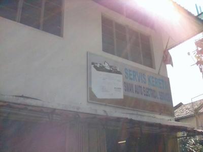

Swan Auto Electrical Services
150C, Jalan Loke Yew, 55200 Kuala Lumpur
+603-9222 1142
repaired car alternator
Tel: 012-2913346

QUOTE(NotTheOne @ Nov 11 2018, 06:58 PM)
03-33238588
He charged RM120.

QUOTE(JimmyChan77 @ Jun 1 2015, 06:56 PM)
13 Jalan Dedap
Taman Melodies
80250 Johor Bahru
Johor

Hi guys, due to excitement I decided to post.some. another picture here from the shop that serviced my alternator. Pic shown my 2009 Wish engine bay. Easy to bring out the alternator.coz of.the location in Wish 2009 is at the top of engine bay unlike some car at the bottom.
danial01
post Jul 27 2019, 12:31 AM
13 posts
Joined: Jul 2018
QUOTE(danial01 @ Jul 27 2019, 12:21 AM)
Actually there was 3 bearing for.the alternator. Mine was Denso alternator. 1 bearing was for the alternator pulley, another 2 bearings was inside the alternator. See that the bearing housing was already a bit exposed when the mechanic took out the pulley.
And there was rusted steel dust inside the bearing pulley. That explained the brown dust that I saw sticked on to d outer casing of.the alternator earlier.a few.days ago.

Pic shown above: So dirty inside the alternator pulley . The other end of the alternator pulley

3 person working here. The first chap, young man , i think he is the one who do the heavy & complicated job, taking out alternator from inside the engine- if d alternator is at the top then his job will be easy, if at the bottom then it is more difficult coz need to jack up the car and take out from bottom.
Above pic shown this uncle receive the alternator from the young chap and working on the alternator inside out.
When the other customer wanted to pay, the younger chap asked him to pay to this towkay. He is the one who wrote the receipt for me( I guest may be he is the share partner or longest time one working here.)
The other uncle, I think he is the one who is really d big boss here coz most of the time he only monitor the older guy and young chap do the job from his sitting place biggrin.gif

hyundai tucson 2013 new alternator cost 2k
today changed alternator carbon brush & service starter (since carbon brush still good) cost rm280
mileage 205k
This post has been edited by croydon: Aug 13 2019, 11:33 PM
Tel: 012-2913346

Finally got the starter on Lancer fixed. Kwong Weng Auto changed the solenoid and carbon on the starter. Since the car was left the almost whole day, told him to service and change the carbon on the alternator to.
All in cost $400 only. Accept credit card too but soon paid cash. Car starts just one click since more than a week back
Highly recommend those to go to him for this 2 issues

then saw this thread and went to kwong weng, i told the boss that the pulley is most likely the culprit and told him to take a look at my alternator, they took it out and confirmed that the pulley hav already failed and jammed thus causing all the noises and vibrations, he took out the pulley and replace it with a brand new pulley and also opened up the alternator n repaired some stuffs inside the alternator, making it work like new
and all of these for only rm260, after the alternator was repaired, all the noises n vibrations are gone now, super impressed at the results thumbup.gif thumbup.gif

Just came back from Kwong Weng..
Highly recommend this to others!
My myvi was having some weird sound..shrrett shrett sound.. every morning..and everytime i step on accelerator pedal.. feels like the V belt kena water..
changed V belt & waterpump recently.. never changed WP b4 for a car wif mileage 182,000 km & a 7 y.o car..
my trusted pomen said aircond compressor..but prolly not..
i was 1st customer of da day.. they check alternator 1st.. unker said yup got pobem.. dismantle alternator.. serviced & replaced karbon.. kawwtimm.. amazingly.. the shrett shrett sound vanished!
total damage: Rm120.
Satisfaction: Priceless.
thanks to all here in dis thread..especially TS..
(had sleepless nights almost a week for this)

Thank you so much for this post, though dated so long ago it helped me to save considerably.
I had got a quote from Toyota for RM 3000 to replace the alternator.
Before agreeing to proceed with the change, I got my car towed from Toyota service center to Kwang Wang Auto Electrical services in Kepong to see if it was recoverable, especially after reading this post. The uncle is very gentle soft spoken. He checked and told me there is some issue in the alternator and to cut the story short within 3 hours I was driving my car back happily after paying just RM 295.
I will highly recommend this shop in Kepong, if u have any electrical or alternator issue.
https://pictr.com/images/2020/12/08/7oEv2r.jpg

QUOTE(danial01 @ Jul 30 2019, 10:10 AM)
Nope, this one at Jalan Dedap, Taman Melodies, Johor Bahru.
Hi, if starter problem, drive the car to this workshop? They can remove d starter and fix it?

Car started abit weak today so went to my regular battery shop, was told that my charging system was abit weak so got recommended to this shop.. so went there, they weren't attending any cars at the moment when i arrived
Got the carbon brush thingy done in around half an hour.
Before the battery voltage was around 12.9v something with engine running, after done around 14v

Went to Kwong Weng today to get my starter fixed. Went early about 9am, I think probably their first customer today 😅
Show the problem to them, starter giving tik tik tik sound only and occasionally it will start after n numbers of tries. They say probably switch/solenoid kaput.
Took them a bit of time and additional labour to
figure out how dismantle the starter since this is first time they work on my car type.
Around 10:40 like that they manage to finally dismantle the starter and start working on it. I had an appointment with dentist nearby so walked there and 1 hour later I'm back and the car is ready 😁
Got charged RM 360 for replacement of switch/solenoid, changing carbon, brush and some servicing as they mentioned there were some friction and caused some rust in the motor. They clean those up. The price is slightly higher than what I was quoted for a half cut starter but I choose to repair as I wouldn't know what's the condition of the half cut starter .
Now the car starts everytime 😁. Would like to say thanks to this thread for sharing this workshop. Definitely one of the better and honest shop

Done mine today after 4 years tahan telinga with "Grok gok gok" soundtrack at lower rpm (2000 below), replacing pulley & carbon brush.

Is this a pic of the shop?
Seem different from other pics. Is it the same location?
47ronin
post May 30 2022, 04:01 PM
365 posts
QUOTE(kdr93 @ May 30 2022, 11:56 AM)
Same location.
You may try Google the company name to get the address & direction.
