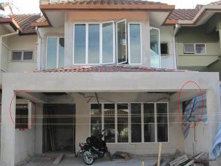

Hi there,
Are shifting the Car Porch column / tiang?

Yes. As you can see from the pictures, the columm is narrow.

If your pillar is 1ft 1ft, ask the contractor put 3" pipe inside the pillar. So you don't have to put outer pipe.

I guess you have consulted the Engineers in terms of the structure capacity... If not, maybe engage a Engineer to look into it... I not too sure what does your existing column supporting....

Err.Contractor only . Not building RC, just roof. No plans to extend the 2nd floor. blush.gif

If u intend to cast your RWDP into your column, please make sure is uPVC.. Not mistaken is Class E..
You mean car porch roof? If yes, your SC most know the concept of load transfer prior removing the old column...

Added on July 22, 2011, 1:30 pmRenovation Update:-
My future car porch columm base and My future back room....
How they lay a concrete floor:-
Lay wire mesh
Mix concreate and pour over the area

From the first pic, I think your SC has damaged one of the Pipe... did you get any Engineer to design your house Structure?

The pipes are from the existing roof pipe waterways outlet.
Going to re-do car porch roof so making a new water pipe outlet.
Going to do the whole house plumbing system.
Is a Engineer required in this circumstances?

I just kind of doubtful with the workmanship....

If your renovation work involves any structures (whether demolition or addition), the local authority, would have required a Structural Engineers' s design before they will give their approval. Go check and refer to your submitting consultant. biggrin.gif

Definitely, the construction would not comply to design requirements. No proper beam between columns. Base slab thickness looks too thin. In any case, don't think authority allows extension to the end of the boundary. There must be some setback. However, in Malaysia, nearly everyone extend their kitchen to the end of their boundary.

Added on August 7, 2011, 5:54 pmRenovation Update...
The front and car porch are going through major changes
Then . . . . . . . . . . .
MAJOR ISSUE. Si Tao Po complain !!

Y major design blooper?

i also think its a blooper + fengshui problem....

remove the conventional roof. Use RC slab. But you need to make sure you have another beam / supporting pillar around 12 to 15'
Added on August 7, 2011, 9:46 pmAhh, you remove 2 major pillars. Where you adding new one to support?

The major pillar/columm is still there, next to the door.
They are going to set up another 2 new corner pillar/columm at the new corner of the extended wall(Extreme left and right),
then put a new RC beam across joining the 2 new pillar and the existing pillar providing support. flex.gif

The columns are there for a reason. You may remove stiffeners BUT NOT columns without first propping up the supported beams. It is very dangerous as anything may happen. Would suggest that you get your contractor to prop back the beams without any further delay.
I would not stay under the structure until all the temporary props are properly in place.
Better get a structural Engineer to take a look on your proposed new supporting pillar & Beam.
Basically, you need to have the replacement supports in place before you can remove the existing ones.

I also dislike that design.....I also feel that design too "old".....you should research more for modern looking design...

My proposal, change to monopitch roof inclined at 5 Degree should be ok...
Minimize re-design and rectification works....

Renovation Update
The ground floor front wall is totally taken down, Waiting for new windows, similar to the master bedroom.
The new RC roof structure is up "again"- with the correct "longkang" cool2.gif
New Doors and Window frames installation.
13 Amp Power Point Installation

Hi phoenix69,
A bit curious on what did you do as replacement when you removed the 2 RC columns in your living room?
Did you construct any alternative supports?

Going to construct 2 additional corner RC column at the extreme edge.
Then will join them across via a RC beam joining the single column you see in the middle.
Hope you you don't mind me saying this.
I suggest that you quickly get your contractor to temporary prop up the bottom of the beams (at the 2 columns location)
Did you get any qualified person to look at the structures where you have removed the 2 columns.
Don't mean to frighten you... Better to be safe then sorry.

The term for this is called a load transfer, 2 pillars are built at opposing ends of the house's width together with a ceiling beam to support existing ceiling beam. This usually causes the ceiling clearance to be reduced by about 6" or so. Needs specifications from an engineer to get this done as you don't want your contractor to cut on cost for the metal bars used.
And i agree with kelvyn, get your contractor to prop up the area that the old pillars have been removed with scaffolding. Better to be safe than sorry.

Renovation update:-
Car Porch Entrance Front Gate column build-up
My future mail-box and its future housing
Car Porch Main Gate
My Big A&& windows

hi, jst opinion, this area here, not planning to brick it up? i think i will b nice..

It is against the MPSJ's regulation to brick them up.
Anyway, it will block off ventilation as well

oh, is it? cos in sarawak here, most of the new house now, the developer will cover that up with bricks.. more privasy lo.

Those two metal posts... are they to support the gate in the future?
TSphoenix69
post Oct 13 2011, 04:32 PM
1,836 posts
Joined: Sep 2007
QUOTE(kamion @ Oct 13 2011, 03:39 PM)
Yup. My contractor insisted that I choose the gate supplier to get these 2 metal post before building the columm. blush.gif
He says regular gate hinge that is supplied by hardware shop is just not strong enough for the type of gate I want.

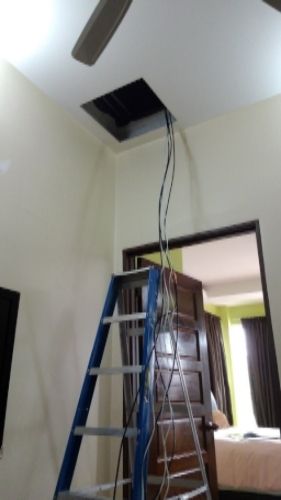

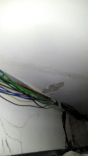

Renovation updates...
The Major Re-Do... Re done
Back Door "Shifted"
House wiring and air cond piping criss crossing all over the ceiling... to be concealed soon.
