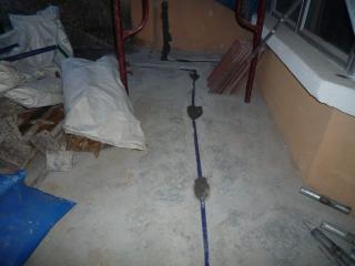

it's true that they have to drill & pump chemical every few years.. rclxub.gif  rclxub.gif thats why i run a set of pipes before i laid my tiles icon_rolleyes.gif
why do you need to run a set of pipes?

today i heard that my boss actually ask the contracter to do a piping for termite chemical method, before they lay down the new tile, they actual make a long pipe system from porch area to your middle of your living hall, the pipe will be plant underground ur tile, slightly more below and the move to all corner and have different spliting, what you need to do is on yearly basic go to the pipe mouth at porch area and pour in 1 can of the chemica and it's done.. the pipe thing cox less then 1k rclxub.gif rclxub.gif
i wonder if really got such thing ???

got, i did mine when reno.....

NLC termguard, cost a bomb. i have a bungalow project use their system.
the piping in my house reno was done by my indon, in fact any plumber also can do it, drill holes surrounding the house, insert perforated pvc piping with end cap, wrap with geo-textile and connect to each other from front to back.

the conceal piping buried under the floor tiles actually serve the same function as u mention above, only difference is my floor tiles not need to drill in future, and i won't have those chemical smell inside the house when i recharge it every 2 years.
yeah this is the exact thing i wanna do since i gonna change the whole floor tile in my house, might as well do this 1st.. how much does it cost actually ? i mean ur indo guy la hahaha ?

the material cost +-400, labour +-500, chemical 200

geo-textile? How and where could this get from?

u can google it mar.......the perforated pvc pipe wrap with geo-textile to avoid those small holes clog up by soil.
every 3 ft one pipe punch in to soil about 2ft depth. for existing slab, my worker drill the floor concrete with 32mm drill pit
