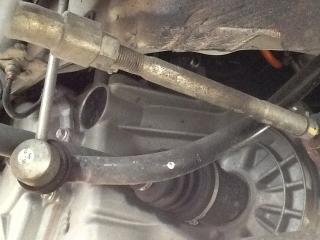

on my previous (forgot which) TT...consulted david and reapers for vacuum gauge installation stuff so i got the idea on how it is done though not DIY...
dis is d outcome done on my car by other people...
Kept the stock vacuum hose and replace with new vacuum hose...no cutting of the original hose (though can use bac the stock hose). But it looks much better with all using the same hose... biggrin.gif

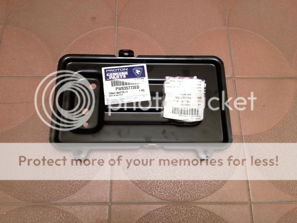

new tray
wanted to paint but only left back cheap sprays at home only.

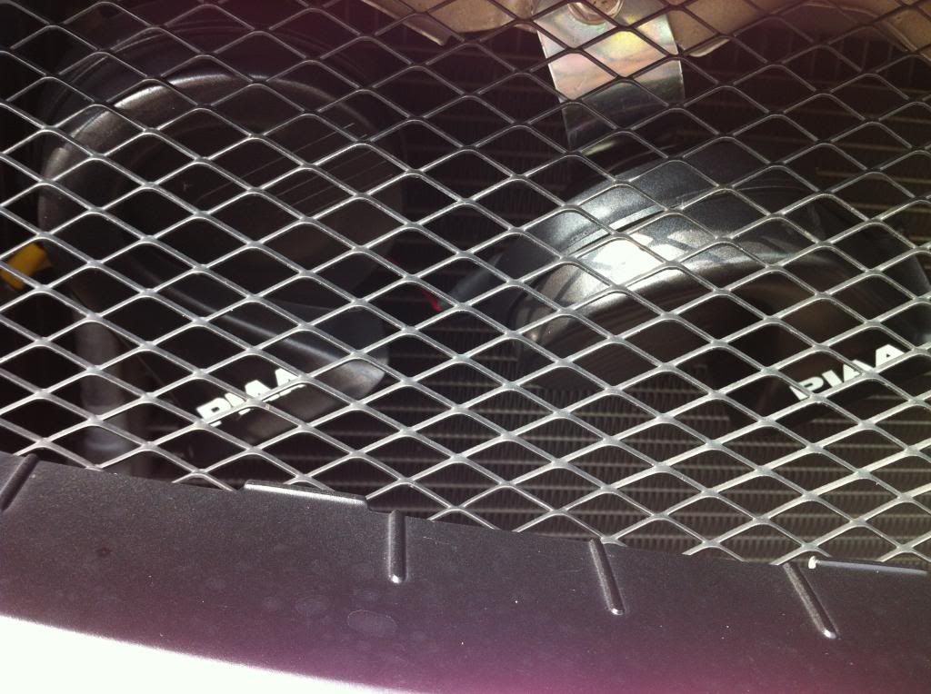

Kena kantoi from my dad. Apparently my engine needs to be running when cleaning the TB laugh.gif

Mahihi, need to inform you about the brake hose length. If you follow IMP hose length. If fit on lowered car the hose section from the caliper to the absorber mount when the steering is turned will cause the hose to rub against the hose bracket on the car body one. I think need to shorten the hose length more. I will need to measure the stock hose length and let u know.
I notice this after I put the car back on the road ad drive when the clear casing get tear it will rub the ss hose body and will make sound. In long run, the hose might bocor that's why yesterday I spend some time to modify the hose length ratio between the caliper to the absorber mount and to the chassis body mount. Now solve the rubbing problem.
Mahihi
post Oct 27 2013, 12:53 PM
37 posts
Joined: Mar 2006
QUOTE(TitanRev @ Oct 27 2013, 12:24 PM)
aduh,okok,coz i plan to get it done within this week ad...haha,thx..

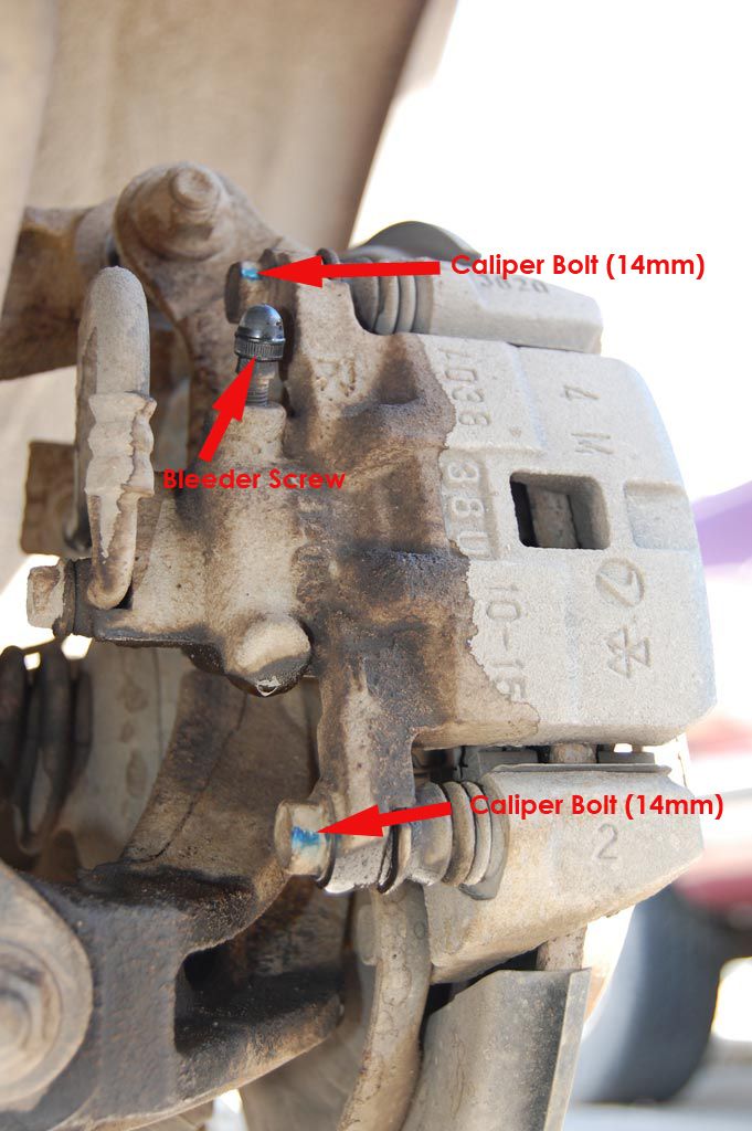

I've noticed a faint squeaky sound coming from my front left brakes. Now, before I send my car to the workshop, the pads has been changed recently, say for the past 2-3 months or so? And the sound was quite recent (2-3 weeks or so). Any idea? Sticky callipers? hmm.gif

Ericmaxman. Could be a sticky caliper or the metal shim on the brake pad didn't put back
Mahihi. Stock hose length 38cm only
ericmaxman
post Oct 27 2013, 01:44 PM
7,951 posts
QUOTE(TitanRev @ Oct 27 2013, 01:39 PM)
Means either way also got to take to mechanic for a check
ooo,so oni front kena gosok la??rear still the same??tqtq

Mahihi, yes front only rear no problem. But the gosok problem can be solved if hose length no reduce just need to change the length between caliper to absorber mount and from absorber mount to chassis mount.
Eric you can try open the wheel and check see got the backing plate on the pads

QUOTE(TitanRev @ Oct 27 2013, 05:06 PM)

QUOTE(davidke20 @ Oct 27 2013, 05:13 PM)
Spray oil?

QUOTE(ericmaxman @ Oct 27 2013, 05:42 PM)
Spray oil?
No need to do anything. Until next time you plan to change brake pad, bring along sand paper and high heat resistance aerosol canned paint spray gao dim. In order to add a bit of ricer feel, use Red/Yellow paint, that will make the metal sheet oustanding after plonk in to the boring caliper.

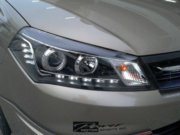

ericmaxman
post Oct 27 2013, 05:58 PM
7,951 posts
QUOTE(General_Nic @ Oct 27 2013, 05:56 PM)

QUOTE(TitanRev @ Oct 27 2013, 06:33 PM)
Nice headlights....sure add 25kw horse power....

QUOTE(ruby1288 @ Oct 28 2013, 09:55 AM)
QUOTE(ericmaxman @ Oct 28 2013, 09:59 AM)
If not ask ruby1288 to do also can
To end this contoversy/confusion over FLX SE hving thicker or same diameter front Stabiliser Bar as BLM/FL...
Cld yu pls measure & confirm if FLX SE one is 19mm or 21mm?

Anyway, juz 2pamper yr humble self, the Bar is like an ARB...and a simple string measurement of circumference of Said Bar wld do juz as well... tongue.gif

zeone
post Oct 28 2013, 10:25 AM
A Friend...
784 posts
From: Rice Bowl of Msia
QUOTE(ruby1288 @ Oct 28 2013, 10:14 AM)
got pic ?
next time I go serbis I measure unker style.
take rafia string rub around and unwrap, then use ruler measure string.  icon_rolleyes.gif
most probably by then someone would have already measured it.
Juz4yu, Bro...
Anyway, it's info/knowledge 4other Bros who might not kno...rite? icon_rolleyes.gif
got pic ?
When you use the rafia string, you'll be getting the CIRCUMFERENCE, while using the gauge will get you the DIAMETER.
Fubar20

QUOTE(ericmaxman @ Oct 28 2013, 10:29 AM)
maths sudah fail saya.
zeone
post Oct 28 2013, 10:32 AM
A Friend...
784 posts

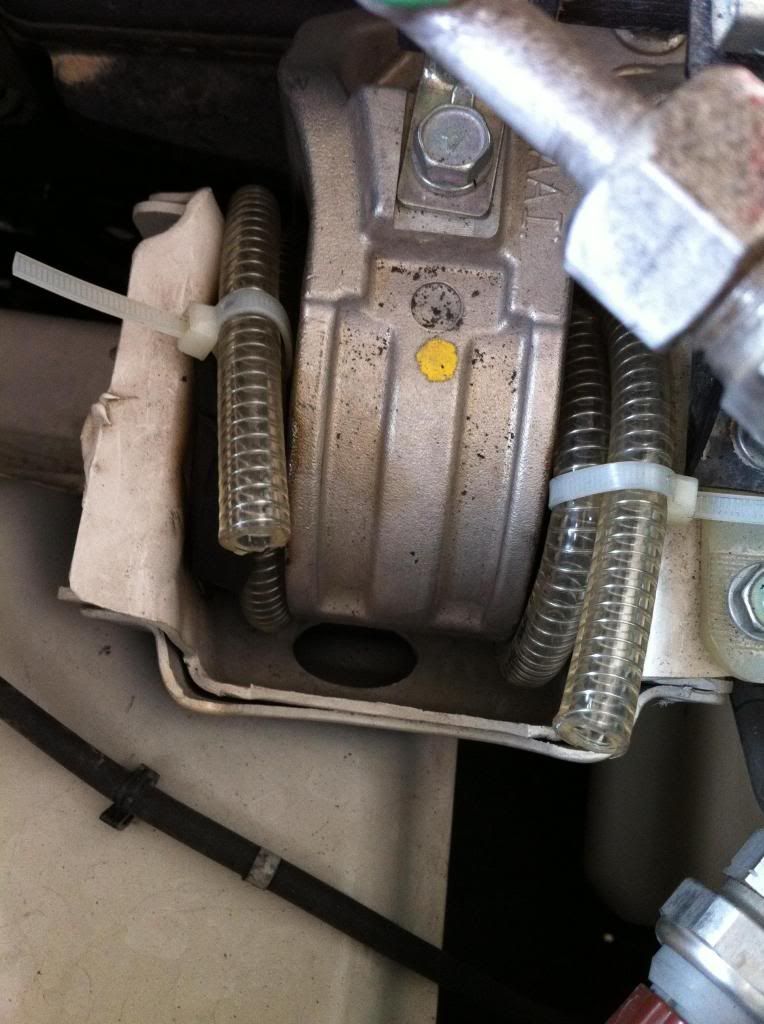

When I corner or go very fast over some slope my car don't roll is the things inside my car fly side to side (that's why my car inside I no keep any stuff only a payung actually want to take out that payung also but my wife sure nag....when go over slope my pasengers all fly up also.....
BTW, over the weekend, I did this as recommended by V12 and woof woof.....but my hose OD is 11mm ID 6mm I didn't put any lubrication when I slip the hose in....very difficult and painful to my hands and fingers....and need a lot of elbow power.....I wrap 1.5 rounds on the mounts....I know mine is MT don't have so much jerking compare to CVT but I put this also to reduce engine vibration on idle and the engine from moving too much during engine braking or hard acceleration. MY steering feels less vibration after put this and felt more solid....I wanted to do the other 2 mounts but hose not enough jor....since I jack the car up to mod the SS brake hose....Just to add, I found out that my car is very difficult to jack up now after using adjustable and with chassis bars...Now when I jack up the front using the OEM factory jack my whole left or right side will get lifted up both front and rear tire also up in the air....bugger...jack until my hand lembik....I think I need to go buy a good 2 ton jack....last time I borrow that one for installing adjustable already return to shop owner.....

QUOTE(TitanRev @ Oct 28 2013, 03:02 PM)
ini pun kaki kuat pick-up jugak...see mounting sudah senget towards one side... laugh.gif
This post has been edited by V12Kompressor: Oct 28 2013, 03:25 PM

QUOTE(V12Kompressor @ Oct 28 2013, 03:25 PM)
V12, no senget la....it was like that when I got the car...I got ask the SA why like this he say is built like this.... notworthy.gif I also speechless.....
i also wan to do liao like this, since i always pull to 3rd gear to decrease speed might harm the mounting also....
TSV12Kompressor
post Oct 28 2013, 03:57 PM
No carrots here
2,141 posts
Joined: Sep 2008
From: Muddy Banks
QUOTE(r3apers @ Oct 28 2013, 03:56 PM)
your mounting gap kecik, mana boleh buat...
Err....just like how V12 do it....my difference with him only how I loop the hose only still same method doing it. Can refer to V12

Actually I found that BLM engine mount gap much smaller than FLX. Kenji show me he's very small gap only...FLX mia...Niama macam the pacific rim kajuu under sea crack....

QUOTE(TitanRev @ Oct 28 2013, 04:11 PM)
u see satira neo one...
Ur engine mounting rubber can rotate? My BLM 1 out of 3 can rotate one...maybe tighten the mounting screw will do?

QUOTE(coolkwc @ Oct 28 2013, 04:27 PM)
Mine cannot rotate at all. When I install the hose it was really damn difficult as I not just wrap around the mount. I use a logo force to force the hose to go deeper into the mounting and keep pulling and holding so that there's totally 0 free play on the mounts. That's 1 of the reason why I do the mount until my belakang also sakit.
Just park beside a stock FLX find out my car not so low after all about the same height as stock. Maybe little bit lower

3,112 posts
Joined: Jul 2006
The place that u insert hose suppose filled with rubber, but ur is empty...is it only urs or BLM and FLX engine mounting is different?? unsure.gif
