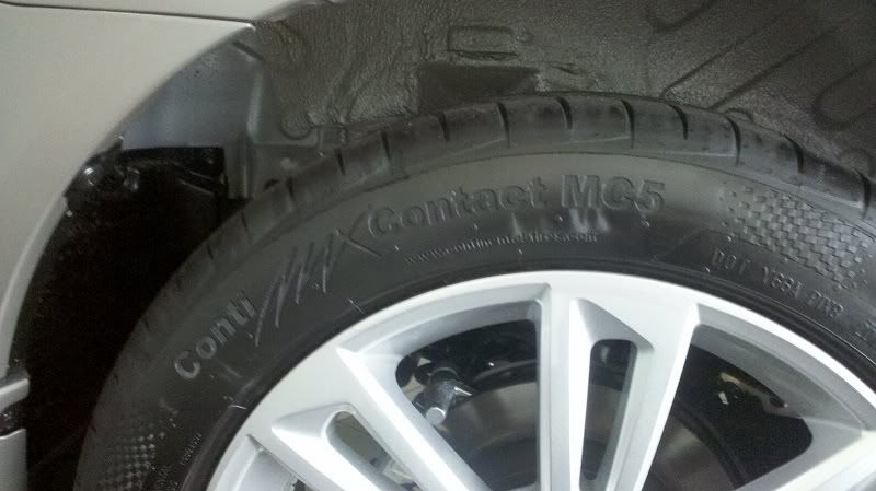

Hi guys,
I'm new to this forum. Also new to this car. Just received my SV last 2 days. Now planning to change the rims. I have few questions here. Hope u guys can help exspecially from those who owned this car for long long time ago.
1. If i go to the 15" sport rim, how many offset i need to just 'plug n play' installation ? Any recomandation for tyre ie. size, type and brand ?
2. How about 16" sport rim, how many offset for 'plug n play' installation ? Tyre recomandation ?
I have no plan to change the coil springs and adsober since i used this car for working and family proposed. Besides, also have no budject.. biggrin.gif

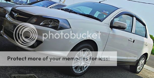

QUOTE(akuinsan @ Aug 29 2013, 10:55 AM)
mana side mirror dia???

15" offset is +38 IINM
16" how u do also will sagat... advise not to change this size. 15" is good enuff..

QUOTE(Noobdao @ Aug 29 2013, 10:56 AM)
r u blind??? fold already not so obvious but still can c where his side mirror at... doh.gif doh.gif
Welcome to the wonderful world where side mirrors can be folded.
This one is test drive vehicle.
dares
post Aug 29 2013, 11:15 AM
834 posts
Joined: Jul 2011
QUOTE(DonMe @ Aug 29 2013, 11:13 AM)
Trade plates are usually just temporarily hung on the car right? so they can be taken off and use on other cars as well. Never seen trade plates that are permanently mounted like that hmm.gif
I think it's either a legit new plate, or photochopped.

QUOTE(dares @ Aug 29 2013, 11:15 AM)
looks like photocopped as the line got a bit jagged...

offset +35 also can...just like mine...the tire and the fender ngma ngam flush...
the one i saw also have the W xxxx A plate mounted permanently.

QUOTE(jsnkok @ Aug 29 2013, 11:26 AM)
Then that showroom must have many tradeplates they can permanently affix to their cars hmm.gif
Reminds me of my test drive of the Satria Neo, I can't drive outside the compound coz no tradeplate vmad.gif

QUOTE(TitanRev @ Aug 29 2013, 11:22 AM)
the higher the +offset, the wider will be the tires from the fender, correct?

Tradeplates now follow the format WxxxxTP
WxxxxA are registered road vehicles.
Another FYI by our beloved unoehu

oh.. so +ve offset, rims sits deeper in the fender.. thanks!

actually 35 and 38 not much far different. But like other said maybe your suspension till no hard enough still will sagat?
