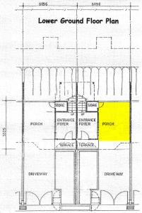

CuriOu5
post Aug 22 2011, 01:24 PM
380 posts
Joined: Apr 2007
From: Malaysia
QUOTE(kelvyn @ Aug 21 2011, 02:16 PM)
If you are planning to wall up the garage, then will need to check on compliance to Bomba. Better to check with DBKL or an Architect who is familiar with this matter.
Just to wall up the yellow area in the attachment.
kelvyn
post Aug 22 2011, 02:52 PM
3,173 posts
Joined: May 2007
QUOTE(CuriOu5 @ Aug 22 2011, 02:24 PM)
If existing in not walled up, it is considered as open space.
If you then walled up, than is is considered as enclosed space. There are requirements to complied with.
Of course, if you wish, you could just wall up without submitting to DBKL. Just the risk you have to take. smile.gif
