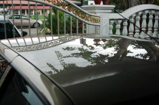

yesterday found a bird shit stain on my car roof, i drive my car to other location and park under hot sun for few hours... i wash the bird shit stain once i reach home, but what i found was the stain "watermark" unremoveable (when reflection from that part)  shocking.gif
i tired to polish and "wash&wax" shampoo several time but the "watermark" still retain there... just feel like the "watermark" printed on car paint... sad.gif
anyone experienced it before? any products can remove the "watermark" such as tar remover? thanks

Yep. Birdshit. Mango Juice etc etc. Must be wash IMMEDIATELY. If u put it under the hotsun, it'll leave a mark. There's nothing u can do about it. Unless you sand paper it and then re-paint it or something like that.

Well if you didn't leave it under the sun for too long, some tar remover might be able to get it off.
But typically once it's eaten into the paint, you'll have to live with it already. Hence, I never park under any fruit trees that might have sap drops (mango is one of the worst) and clean anything on your paint immediately like Matrix said. smile.gif

hurm..do some double layer polish..i have same prob like u..cow shit under my skirt and the car wash centre dont realize it for two weeks doh.gif ..but the owner give me discount on double layer polish and my car looks new drool.gif

it wont, last time got 1 bird drop to my car's boot, also under hot sun for long time before i realise, after i remove it still got 'water mark', but after a few car wash and heavy rain, the 'water mark' is gone....

sometime it depend on the wax you use......i own a white car so i know how blardy hard to clean it....especially birdy poo....currently using soft99 car wax which is worth the money you pay at RM14.90 or something biggrin.gif

polished and shampoo-ed, still have water mark...
not too obvious, but can see a tiny different the paint with / without shit...

It looks quite deep. But it still looks like polishing can still save your car's look without the need to repaint that part...
You just need a very good detailing shop which can help you polish off the watermark...

easy way to remove - buy soft99 tin can wax called cleaner wax. it comes in a chrome-like can, and is GREAT for road tar and grease as well. i use it to coat my car's lower panels although some elbow grease is needed....

washed and polished... used various type of polish... still have watermark...
i think the only choices was send to detailing shop to do polish only i think...

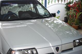

TSgkl83
post Jun 16 2007, 11:29 PM
8,377 posts
Joined: Nov 2004
Done car detailing at SS2 today... updated post #1 with picture... smile.gif
at least the stain look smoother and unnoticeable right now...
If you are paying for a full detailing and they can't get rid of the bird poo, I would not have paid them. What's the point of having a detailing that cost over RM500 and can't get the bird poo out.
Did you just go for a polish or was it a full detailing? I did my full detailing at Autospa and took them 6 hours of removing every single stain/mark/scratch on both inside and outside of the car, down to the rims and engine.

TSgkl83
post Jun 17 2007, 05:00 PM
8,377 posts
Joined: Nov 2004
QUOTE(sleepwalker @ Jun 17 2007, 12:15 PM)
RM2xx for full detailing with meguairs and klasse SG, wont expect the best result will be giving by them... just around 3 hrs on exterior only...
according to the boss and the SOURCE he found, the bird poo mostly caused by crow, he tried with polisher machines which he not recommended for new paint, it may take out the clear coat and harmed the paint... but at least "smoother" the stain now...
if want to get the best result, he recommended to optimize it during next 3 months... coat a layer for each months to get the maximum result...

QUOTE(gkl83 @ Jun 17 2007, 06:56 PM)
what is the autospa price if do the exterior detailing only?
You mean polish and wax? There is no exterior detailing. When you do detailing you do full interior/exterior treatment of the car, not just the outside. They don't have exterior detailing packages. For that you have to combine certain polish and wax services that they offer to make it look like an exterior 'detailing'.
You'd have to check with Autospa whether they can fix the problem or not. Tell them that you are not going to pay if they can't remove it. Hhahahaa.. Just don't tell them that I sent you there.
If you want to talk about reflection, the reflection on my car in my siggie is still there after 9 months of detailing (and monthly wax) and the car is 4.5 years old. That's what autospa has done to it and I'd rather not wash my car if I have to go somewhere else.

QUOTE(sleepwalker @ Jun 17 2007, 07:26 PM)
yeah... just polish and wax the exteriorl only...
not necessary to detailing the interior since all the interior parts wont effected by external environment except the sunshine...just the exterior is the most concern, rain lah, dust lah, stone lah, bird poo lah, mango juice lah, scratch lah, etc rclxub.gif so try to save the interior for exterior only...
if about the reflection, possible tat car detailing will make the car paint 99% same like mirror? i feel tat the original paint/coat made car paint reflection "uneven" bit like a tiny wave (the reflection should be a straight line)...
out of topic: is it ur car plate number was W?? 80? tongue.gif

QUOTE(gkl83 @ Jun 17 2007, 10:38 PM)
maybe is bcos the crow was black and they thought all of the black stuffs were their friends, try to go nearer with it...  tongue.gif
Added on June 18, 2007, 7:36 ami found a small bird poo again this morning, suspect bombed yesterday evening/night, allowed the bird poo overnight on my car... shocking.gif
i try with cotton clothes and water, surprise that it can clean easily... not need to use polisher or wipe it hardly which may scratch the car paint... feel like the bird poo floting on "oil surface"... tongue.gif
There's actually another Subaru with my colour and number plate very close to mine. Even my friends sometimes confuse themselves. Mine does not have '8' in the number plate.
As for the reflection, new car paint actually has the worse reflection, esp straight from factory. We always think that continental paints look so good when new, that's because they send it to detailing shops like Autospa to get a full detailing before selling to customers, even when the paint is new. I always see brand new BMW and Minis at Autospa getting a full detailing before they send the new car to customers.
In your case, if you want the mirror finish, you'd need to do a full polish and wax, even if your car is new.

Manufactured Oct 2001. Car on the road since Feb 2003. Pic taken May 2007. 4 year old paint and 105,000km mileage (so it's not a weekend car). So am I crying? No. The reflection on the bonnet is as clear as the one on the windscreen.

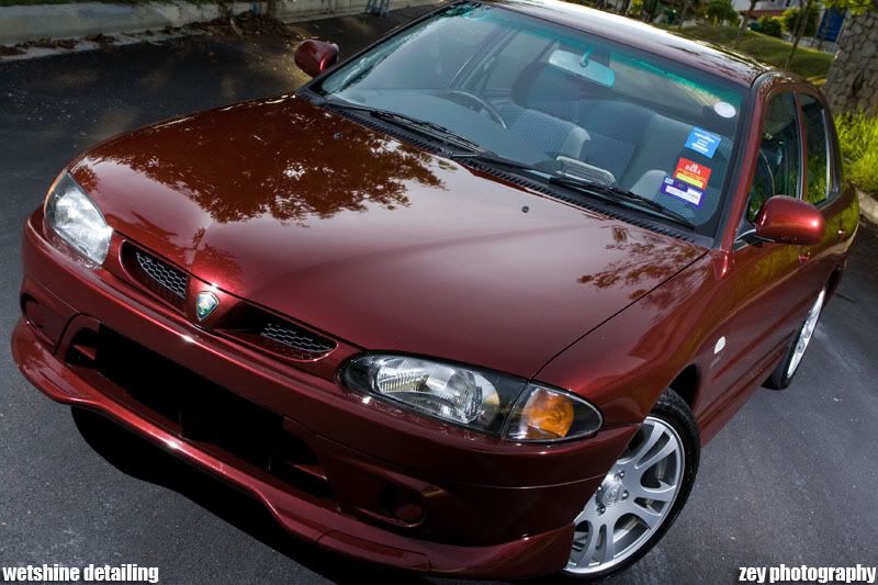

bitzboy
post Oct 6 2007, 02:41 AM
47 posts
Joined: Aug 2006
i don't really know much about detailing, but i got my car detailed a few months back from a very close friend of mine. I think it was a brilliant job rclxms.gif
Thats my car after it has been detailed, photo credits to zey photography...for more before and after pictures and how the detailing was done, visit my friends blog http://wetshinedetailing.blogspot.com/2007...01_archive.html
Note: not promoting the blog, just wanted to share with you guys in case you were interested in the steps on how the car was detailed as well as how other cars were done too. thumbup.gif
This post has been edited by bitzboy: Oct 6 2007, 02:51 AM
thom_chai
post Oct 18 2007, 04:41 PM
1,830 posts
Joined: Nov 2004
QUOTE(bitzboy @ Oct 6 2007, 02:41 AM)
Wonderful i must say. Really admire the shine on your ride. Hope i could achieve the same result too on my ride one day. Thanks for sharing the photo.

here my after detailing jobs... but dont know how good is the PG since i not yet use other brand...
but can confirm is after wax, the water beads can as small as the shown picture...

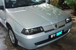

ralf
post Oct 21 2007, 05:45 PM
WYSIWYG
3,013 posts
From: Penang
Restoring a 10months old Saga Aeroback...
Tools used: Meguiars Step2 polisher, Meguiars ScratchX, Meguiars No.21 Synthetic Sealant, Meguiars NXT Techwax, Polygaze TyreFoam Spray, Polygaze Deep paint cleaner Car Wash...
Took me 2days to complete it..hand very tired sad.gif but looking at the end result..i m so satisfied.! tongue.gif
How i did mine...the paint still looks good and smooth, no bird sh1t and watermark etching below the clear coat...so i skip the ClaYying step, only do polish
1st: Wash using Polygaze Deep paint wash
2nd: Rinse and Dry
3rd: Polish using MG Step2 polish
4th: Some fine sracthes remove using MG ScratchX
5th: Wash again using Ploygaze Deep paint was
6th: Rinse and Dry
7th: Apply 2 thin coat of MG No.21 synthetic sealant( i did not wait so long..after 15minutes later, apply 2nd layer of the sealant
8th: 12hours later, Apply 2 thin coat of MG NXT Tech Wax
Done
2weeks later,i m going to clay and apply no.21 synthetic sealant on my Persona... rolleyes.gif
This post has been edited by ralf: Oct 21 2007, 06:00 PM

post Oct 14 2008, 04:33 PM
166 posts
Used Meguiar's clay bar kit on my old ride and this is the result of 3 hours of hard work:
This post has been edited by xTr3me: Oct 14 2008, 05:21 PM
SUSsoyaben86
post Oct 14 2008, 04:42 PM
blekkkkkkk...
2,886 posts
Joined: Jul 2008
From: Deep Down in the Valley
xTr3me
post Oct 14 2008, 05:20 PM
166 posts
QUOTE(soyaben86 @ Oct 14 2008, 04:42 PM)
