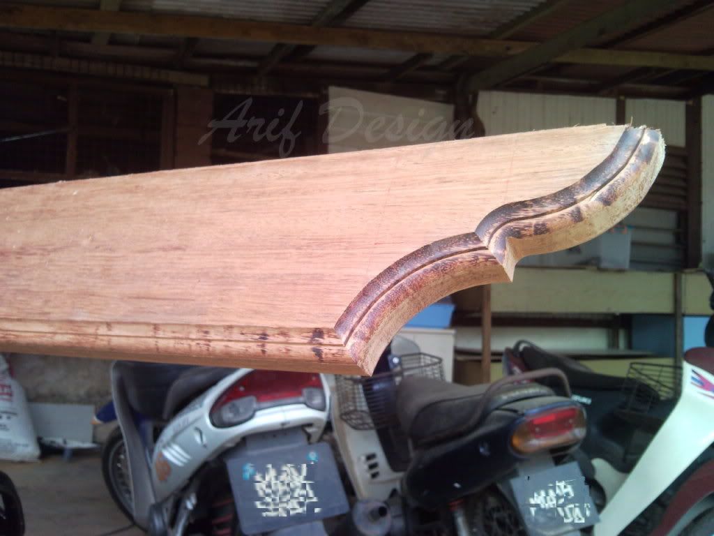

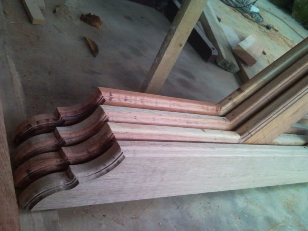

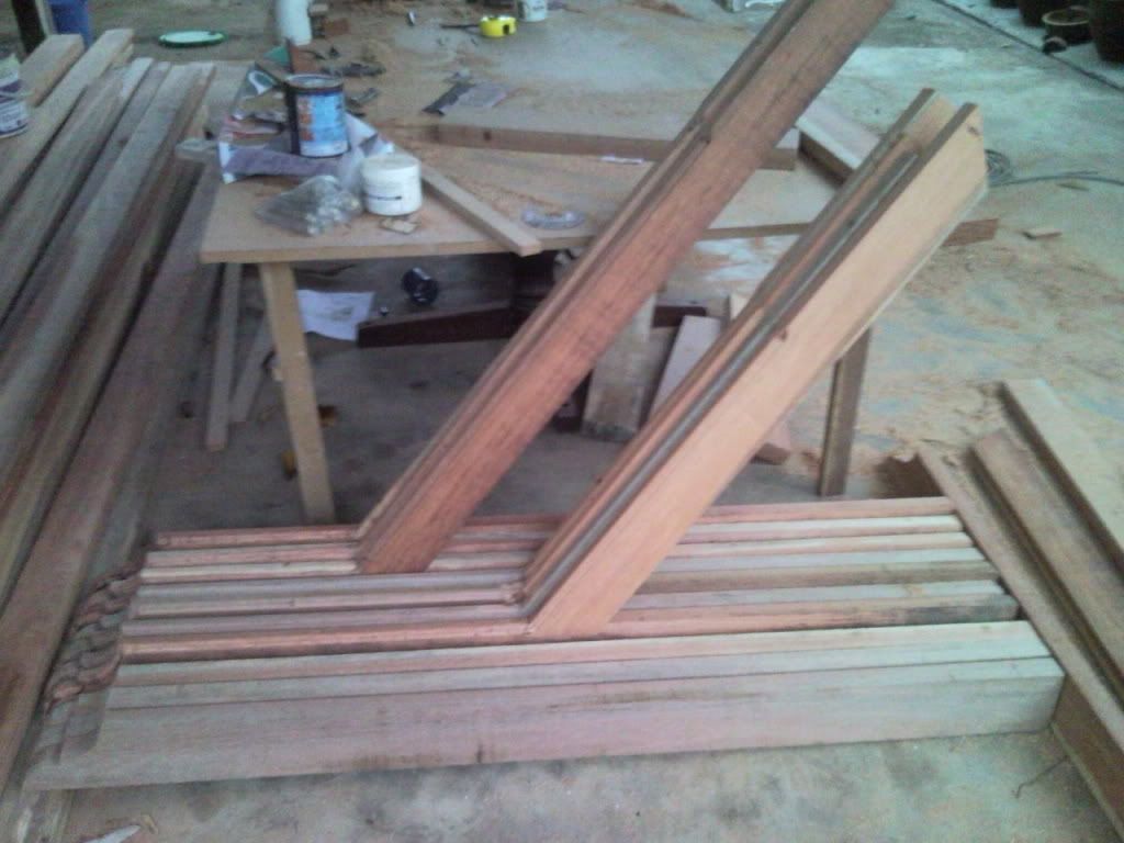

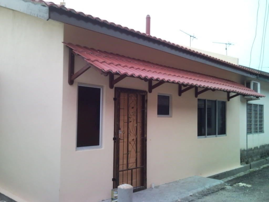

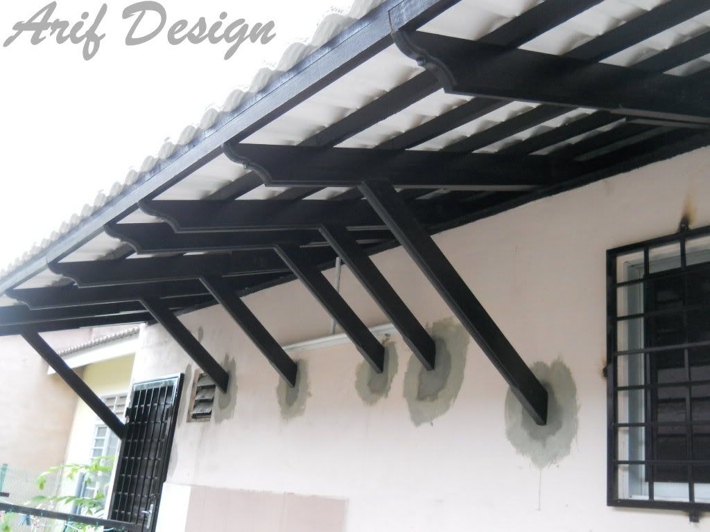

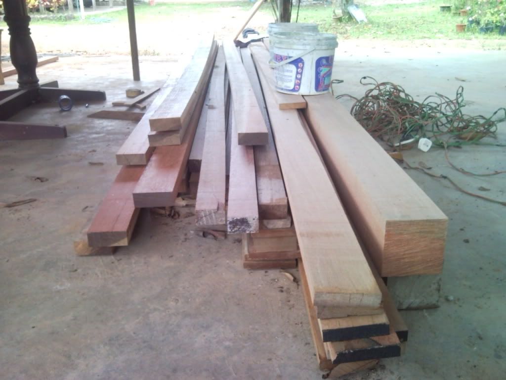

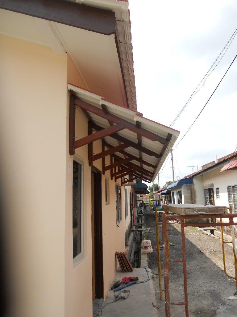

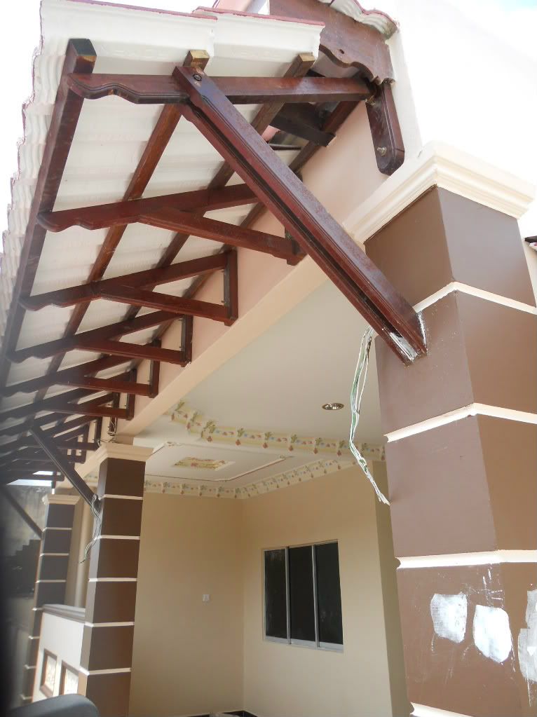

I need advise for awning design.. (ideas) -will be great if you post the photo-
for my house, i build the awning myself... yes DIY..
i more into classic looking (wood awning) than modern style or steel awning..
my house.

Not bad considering you did yourself. Are you in construction line? I'm thinking of doing awning for the back of my house too. Don't know which one is suitable.

roughly calculation.. (for item cost me for front awning)
for roof tiles, wood, wallplugs, paint (wood varnish & jotashield white), bla.. bla.. bla... yawn.gif ( nails, sand paper, putty piller and so on...)
(since i did it myself hahaha)
usually installation and labour wood work for single storey house around rm1600-rm2000> (may diffrent for 2storey) notworthy.gif
(yes.. cost for hacking, cement the gutter, water proofing.. paint back... bla bla bla until finish..) notworthy.gif
lololo.. any other patern for wood awning? i came here for review others member awning.. sweat.gif blush.gif

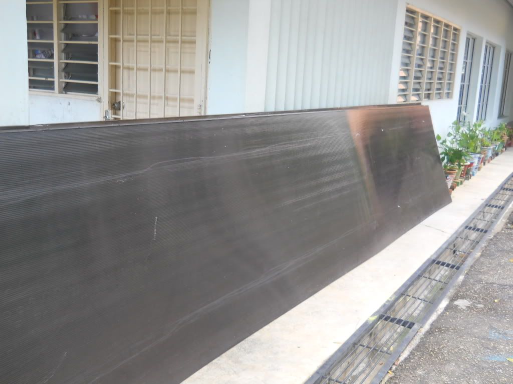

i am considering doing polycarbonate awning...still donno which type of material used for frame..balau,resak or metal steel?
My whole house is using polycarbonate. Noisy when raining.

QUOTE(tiensong @ Feb 28 2012, 10:23 AM)
very thick? how thick? normally market is using 3mm thick solid poly.....
3mm? My poly thickness more than 3mm. It is green semi transparent. 1 surface smooth and another surface is rough.

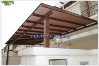

Should be like this...no transparent because can't see through....
By the way, I signed up with this company..
http://www.supercool.com.my
This post has been edited by tiensong: Feb 29 2012, 11:58 AM

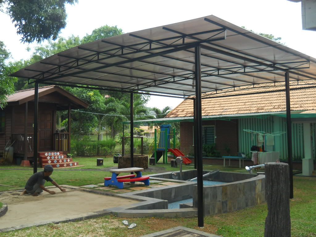

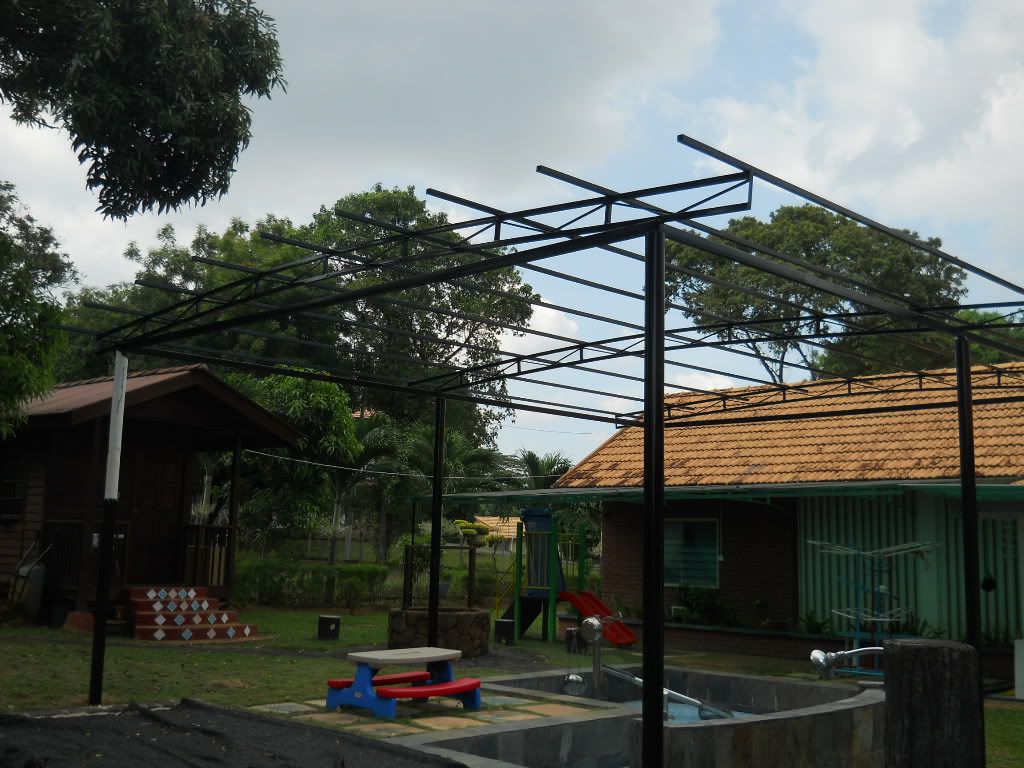

my boss just finished build normal awning to cover kids swimming pool.. just normal bumbung like khemah orang kawin punya.. hahaha biggrin.gif i will post pic later.. its using hollow PC... tongue.gif

QUOTE(tiensong @ Feb 29 2012, 11:58 AM)
Surely expensive this one....but very nice.....

QUOTE(omels @ Feb 29 2012, 11:53 PM)
this called timber pergola...if using balau/resak wood, market price around rm27 per sq ft

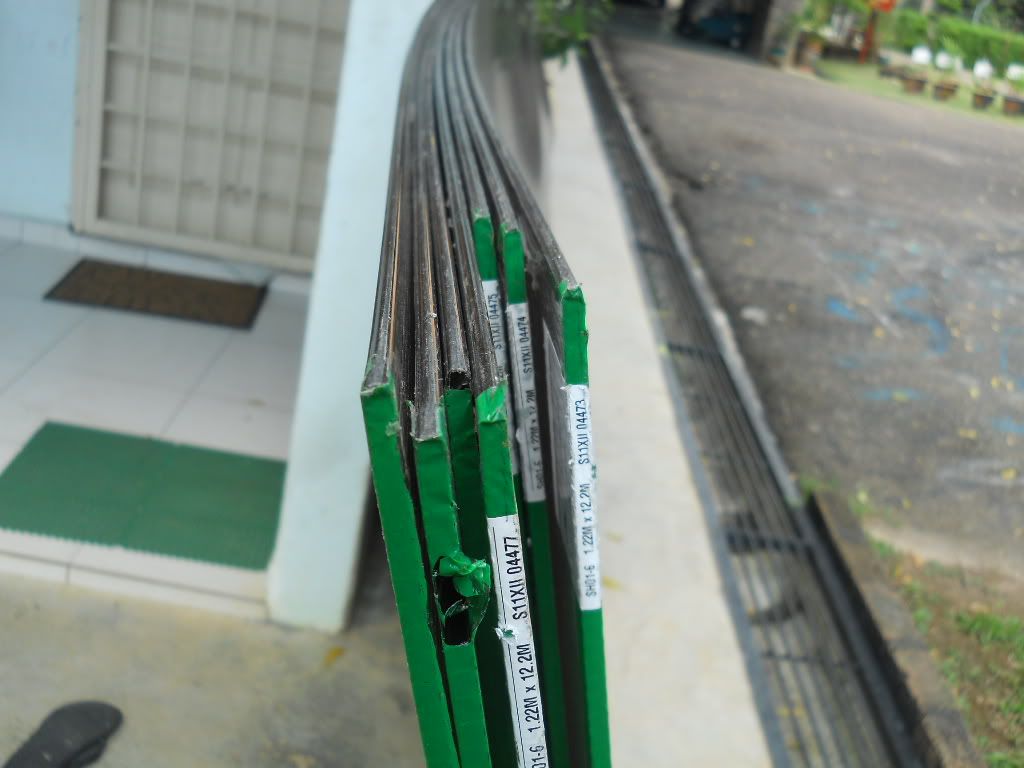

TSmav_850
post Mar 1 2012, 11:52 PM
287 posts
Joined: Jun 2007
From: KuaLa LumPuR
Rangka Besi.. for cover kids swimming pool
hollow polycarbonate 1.22M x 12.2M
Color: Dark Chocolate/Grey

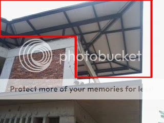

ozak
post Mar 15 2012, 04:18 PM
10k Club
17,023 posts
Joined: Jan 2005

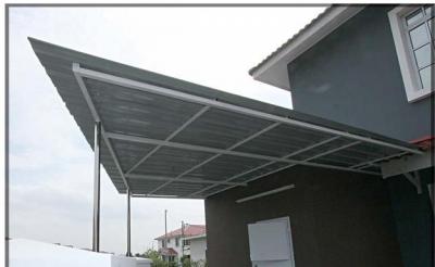

Where can I find this kind of awning? In other world, it call stand seam metal roof. The flat surface min is 15" width. Either flat or a bump but curve in.
TSmav_850
post Mar 19 2012, 06:29 PM
287 posts
Joined: Jun 2007
From: KuaLa LumPuR
QUOTE(ozak @ Mar 15 2012, 04:18 PM)
this type still bising when raining bro... blush.gif hehehe
ozak
post Mar 19 2012, 06:49 PM
10k Club
17,023 posts
Joined: Jan 2005
QUOTE(mav_850 @ Mar 19 2012, 06:29 PM)
No problem bro. Actually I m not using for shading. Use for others purpose. smile.gif
ozak
post Mar 25 2012, 11:06 AM
10k Club
17,023 posts
Joined: Jan 2005
QUOTE(mav_850 @ Mar 25 2012, 10:53 AM)
Nice design. But if this swimming for kid, look abit dangerous. As it look many sharp corner and edge. Once fall and kena head sweat.gif
TSmav_850
post Mar 25 2012, 12:35 PM
287 posts
Joined: Jun 2007
From: KuaLa LumPuR
yup.. i feel it too.. sad.gif this is existing swimming pool... for kids > 4Y.O...

TSmav_850
post Apr 17 2012, 01:07 AM
287 posts
Joined: Jun 2007
From: KuaLa LumPuR

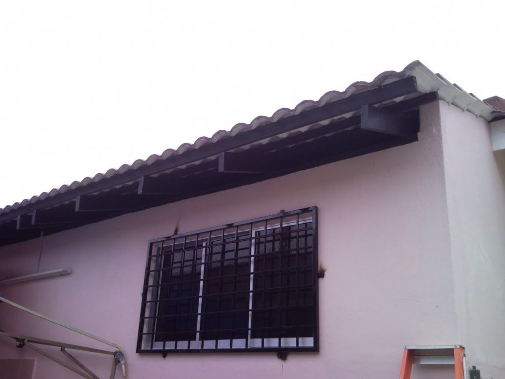

belakang rumah...
open that spoiler
Added on April 17, 2012, 1:08 am
QUOTE(netcrawler @ Apr 16 2012, 08:56 PM)
Can PM the price for timber pergola? I wanna do one with roof tiles. Thanks
This post has been edited by mav_850: Apr 17 2012, 01:08 AM

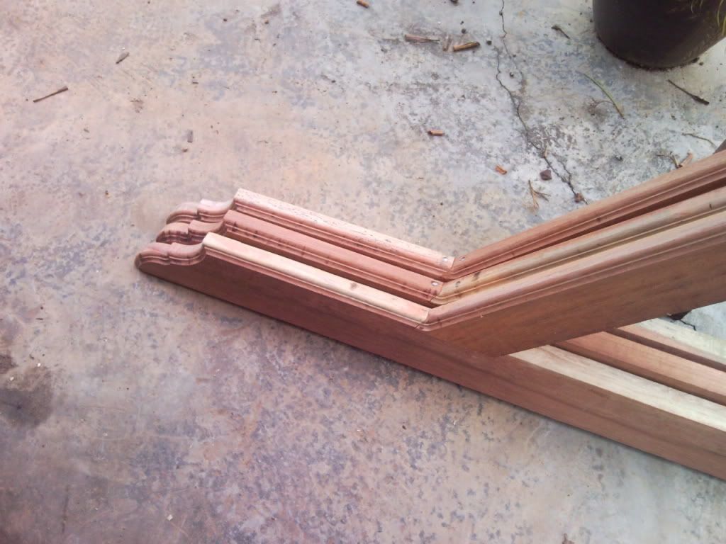

Part Time? if i build wooden awning like this, anyone want to order? tongue.gif
you mean, i just supply the wooden triangle or include installation? hmm.gif
or
or

I just done my timber pergola (polycarbonate) awning two weeks ago with supercool.....how you get to know them?...hehehe..Mr Jeff is so nice...
And I tot their price already very low and competitive.....I can't get any lower than supercool.....overall, satisfy with their workmanship (currently)....hope can tahan for 10 years~!
Can share the price, together with measurements? Thanks!!

today work...
color: timber care, Charcoal black.. nod.gif
using roof tiles..

QUOTE(tiensong @ Apr 16 2012, 02:21 PM)
Can PM me the price coz m think to install awning for my car porch, size will be 22ft x 4ft ....

i installed polycarbonate skylight at my back yard, but result is not as expected. My back yard is 5 feet and the skylight is only 6 feet.. thus rain water comes in easily..
are there any solution for this? adding something like curtain? or I have to cover my grill with some plastic/glass? icon_question.gif
here the photo:

QUOTE(tiensong @ Apr 16 2012, 03:21 PM)
Hi Can PM me your supplier? I asked for a quotation recently...it is about RM27 psf and each column is RM350..so expensive

QUOTE(mav_850 @ Apr 23 2012, 08:11 PM)
today work...
using roof tiles..
Wow, you hack your wall with hole. The hole is not very deep right, I could see the red brick inside the wall. Is the deep on the hole same tick as per the cement that cover the red brick ?
TSmav_850
post May 1 2012, 07:50 PM
287 posts
Joined: Jun 2007
From: KuaLa LumPuR
QUOTE(hahagang @ May 1 2012, 05:30 PM)
i hack the wall around 1.5inch deep bro.... not only the plaster.. smile.gif

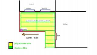

post May 13 2012, 03:53 PM
19 posts
Joined: Jan 2012
QUOTE(mav_850 @ Mar 1 2012, 11:52 PM)

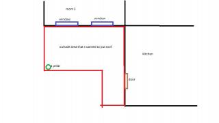

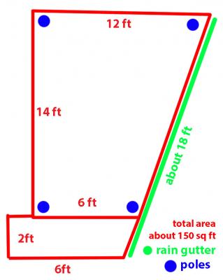

to all friends, i'm planing to built roof totally like this picture polycarbonate plus rangka besi, the different is i want to attached direct to wall
how much price for this hollow polycarbonate?how they quote the price? the purpose is i wanted to put the washing machine and clothes hangar outside my home .
need advice
thanks
Added on May 13, 2012, 4:01 pmdont know you guys can understand or not this drawing tongue.gif
This post has been edited by trulap: May 13 2012, 04:02 PM

QUOTE(trulap @ May 13 2012, 03:53 PM)
need advice
thanks
understand that... you dont like wooden + PC awning?
eg like this but using Polycarbonate..
This post has been edited by mav_850: May 16 2012, 10:54 PM
wall not painted yet...

Added on November 3, 2012, 11:03 am[quote=trulap,May 13 2012, 03:53 PM]
need advice
thanks
From your design, i think its better that u use lightweight steel truss rather than welding coz less expensive. Just use a half truss and plug it to the wall then either use polycarbonate or roof tiles as roof covering. Roughly cost around RM15/sqft for PC roof & RM8 - RM9/sqft for trusses + roof tiles. I've been working in roof trade B4 this & thats y i know about this. brows.gif
This post has been edited by eeezal: Nov 3 2012, 11:03 AM

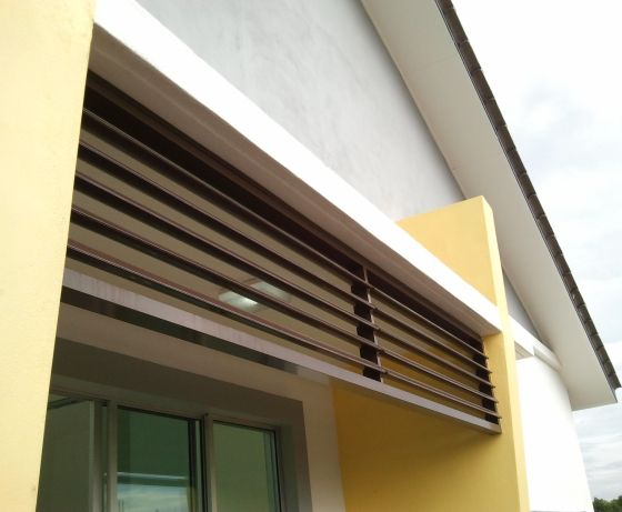

I saw this kind of Louvres (not really an awning) that help to block the sun in one of the show house, i was wondering how much is it? and did anyone install this in their house and can share their opinion?
This post has been edited by Hornsen: Nov 4 2012, 12:15 PM

QUOTE(Hornsen @ Nov 4 2012, 11:42 AM)
Yup bro, this type of louvers really can help block the sun & can give a good shading. But there are some disadvantage of using this :
1) U cannot get a clear view outside & sky from inside of your house.
2) If raining heavily, the raindrop can easily come in compare to using awning. Especially when it rains wt heavy wind.
3) The airflow coming in & out from your hse will not be good compare to using awning.

QUOTE(~Curious~ @ Jan 26 2013, 01:21 AM)
LOL  thumbup.gif  but wanna let cool air when raining to enter d house mah
During raining where got cool air lah. All the hot moisture raise. After raining than open the door. It damn noisy till I can't watch tv.
Another problem is, after longtime it will britter abit. Some damn cat always jump down and like to land on my poly sheet. After sometime some poly sheet brick and fall down.

QUOTE(ozak @ Jan 26 2013, 11:16 AM)
Hi Ozak,
I think you purchased an Un-Coated Polycarbonate ( Which is NOT Chemical Resistant)
Transparent Plastics allow Light, UV & IR to pass through ( Your Car Dash Board is NOT Transparent, therefore, with UV Retardant, it will not spoils after many years)
However, UV Retardant will not work with Transparent Plastics
UV will Damage all material, even your White Shirt will turn yellow
Your Case is like below Photos right?
Breakage?
Yellowing?
You need to replace that.
Replace with a 10mm Twin-Wall, Better Heat Insulation, More Beautiful & Less Noise compare to 6mm
Advise : 10 mm Lexan Solar Control IR ( Hollow Type)

QUOTE(jerryng75 @ Jan 26 2013, 12:28 PM)
Hi Ozak,
Breakage?
Yellowing?
It already 14yrs. Don't expect it to last long. As long as nobody touch the sheet, it is still ok.
But the idiot cat like to land on it. That cause the sheet to crack and fall down.

Choose Lexan 10 mm Solar Control IR Twin Wall
Reason : See video below ( Yes price also Cheaper Compare to solid 3 mm)

Now, below show why 6 mm is better than 3 mm For Roofing

QUOTE(timelime @ Sep 25 2013, 01:11 PM)
hi, does any sifu here know anything about this type of roof? what is it name? Is it expensive(around how much per square foot)?
It seems to me slick and simple, I would like to install this for my balcony if the price is affordable for me.
Anyone here can introduce contractor who can do this?
thanks in advance, cheers.
Bro, when you do yours, go for simplicity.
The Design is more than what you need
But...Your the boss, you decide
Please refer to SABIC SFS

jerryng75
post Sep 28 2013, 12:24 PM
76 posts
Joined: Jan 2013
QUOTE(ericlaiys @ Sep 27 2013, 11:09 PM)
Your The Boss.
Do you need light into your house?
Go For Lexan Solar Control IR, which reduce 30% Heat Compare to other Grade in the Market, with Warranty
Check out the Old Posting
If you need NOT Light, go for Metal Type, As thick as possible ( You may need to climb up there one day)
I'm using Metal for my Wet Kitchen.
Emboss Polycarbonate is one Layer, 2.6 mm thick only
If you choose Solid Type, better go for 6 mm, which is Un-Breakable with Axe
Twin-Wall is 2 layer ( which Insulate Heat better) and Lower Cost.

My material price was RM 7.50 per Sq Ft ( For Coated + Reduce Heat Grade & about 60% Light Transmission). Since it's Brand is good, I'm need not Worry
You can get Cheaper Type, but Make Sure you get a Written 10 years warranty ( You can claim them when they turn yellow, break for natural cause & Blurr Out)

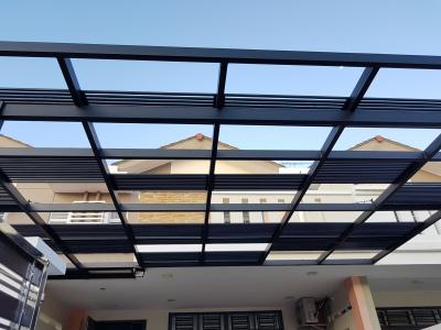

cliffe
post Oct 3 2013, 03:22 PM
219 posts
Joined: Jul 2008
How much if 20feets x 5 feets?
Include the frame and installation.
I think that is glass right?
Any experience?
Attached image(s)

Hi, I plan to install awning behind my house (wet kitchen). Anyone can tell me what you called this type of awning?
Will it noisy when rains?

wa1k3r
post Feb 20 2014, 02:46 PM
96 posts
Joined: Dec 2012
what do you call this type of 'awning'?
i'm looking at similar design for side of my house (approx 35ft-40ft length) and probably 2.5ft from the wall (e.g. 2.5ft x 40ft)
what is the rough cost estimate? i don't know what are the materials normally used, laminated glass, poly etc...
glass cheaper compared to the lexan poly?
thanks!
sabic.sfs
post Feb 20 2014, 04:07 PM
36 posts
Joined: Jan 2014
From: Suite 3B-11-3, Plaza Sentral T: + 603 2274 6198
QUOTE(wa1k3r @ Feb 20 2014, 02:46 PM)
thanks!
That is Steel with Glass. The Glass offered would be laminated.
You need to verify it Tempered + Tempered or Sometime they offer Tempered+Float Glass( Lower cost)
Also must get Warranty. Usually They Warrant 6 months.
Spontaneous breaking happen to Glass
You can use our Lexan* Sheet instead of Glass.
10 years Warranty Against Yellowing, Breaking( except from Screw Holes) & Loss of Light Transmission
Cost wise, we guess contractors would be the right person to advise.
With Lexan* 6 mm Exell D Solid Polycarbonate , the Weight is 25% of the Laminated Glass, therefore in theory, the cost may be par due to the structural ( steel) cost.
Available in Clear or Tinted Green(similar to glass tinted green)
This post has been edited by sabic.sfs: Feb 20 2014, 04:28 PM

if i want to put awning at the backyard, want to use it as clothes drying area,but want to cover the perimeter between the awning and the wall.
i saw some houses put grillles, thats make looks like a store. need something that allows air and sunlight to go through. yet secure from break in
my idea is brick wall at the bottom and a transparent awning at the top. but missing the material in between.
any suggestion?a picture will be nice

I did Wet Kitchen for my house.
Used Metal Deck( roof) with 4 feet Transparent Plastic for Sunlight( already Turned Yellow )
I had 5 feet of Brick Wall and Grille to allow Ventilation
Biggest Reason to do that is that this way, NO NEED BOMBA Approval.
1) Must used Thick & Bigger Structure Metal. Sooner or later you must climb up to do repair in the future. Must be strong for you to stand on.
2) Very hot underneath. End up use Ceiling Board which I installed myself. But It Failed as it adsorb Moisture.
3) So, Replace The Ceiling Board with the Lexan* Twin Wall( A Lot of Work). Now I have 3 Layer of Insulation.
4) That very clear Instruction on the Wall. After 3 years, the Silicone Contractor used will harden and water Sips in. I repaired it with a Grinder, Aluminum Foil & Silicone. A lot of Work, but a permanent Solution.
I think those Insulated Metal Deck material is not Environment Friendly. Over the years, they may become dust and not good for health when breath into your lung. That is why I did not choose those.

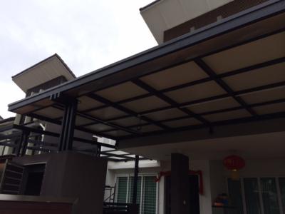

Finally i have done my awning..just to share since i ask a few question here...
Now thinking of tinting it..anyone done this b4...
This post has been edited by jagjag: Feb 26 2014, 09:53 AM

QUOTE(jagjag @ Feb 26 2014, 09:52 AM)
Yes, I believe you can add tinted film.
However, Noted that tinted film are not made for outdoor
They will come off after a couple of years. 3M warranty 7 years, therefore, I guess, Outdoor, 3 years plus/minus they will come off.

The layer of tint should be below the glass so it sud not much expose to weather,hence not so 'outdoor'..i guess..
For my case which is ard 150 sqft..i guess it will cost me ard 3-4K for the tint and i will only last 3 yrs....do you think it is not so worth it??????? sad.gif

its almost 160 sqft and price less than 10K for this. I get the frame ie the steel works and the glass separately. Think my rate is a bit lower than what normally quoted by those awning contractor..i guess

Maybe you can try doing a pergolas with my ceiling wood composite. This ceiling wood composite is fiber, pvc, resin and others. My products are produced by Dayham. Dayham is associated with green building index which are GreenTag, MARDI, SIRIM and TUV.
Or you can add ceiling on your awning
This post has been edited by y00ng: Jul 8 2014, 11:47 AM

Here are some awnings design for anyone who is looking to install awnings.

Did my polycarbonate Pegola awning with Supercool and two thumbs up for them.
Dimension is 31x12 ft and cost me 10k .The beam material used is thicker than normal due to the width of my car porch.
Experience workers and toke them 3 days + to complete . Can be complete faster ,due to rainy days lately.
Have quoted from one of the Lexan contractor and the damage is 14+k. Besides pricing the other downside from Lexan is the design is not as good as Supercool can provide. Also 1 of the limitations from Lexan contractor is that more beams will be used thereofore affected the overall design.
Supercool provides many choices on polycarbonate (10 years warranty) and most importantly the advice they gave is really good.
Contact number for reference: www.supercool2u.com.my / Kenny - 0124288990

can a wooden pergola be made with a width of 24ft? without column support in the middle?

Metal Roofing with PU metal
Metal Ceiling with woodgrain finishing

firstly done the Structure will the PU metal with white ceiling underneath, price about RM17.00/ft2
After that install the woodgrain ceiling panel, about RM13.00/ft2

This type cannot find here.
The only way is special manufacturing. (they have the die) Than sure require project qty la. Factory in shah alam.
I want to use for solar panel ontop the tile roof.
Not like it to use as awning. Sunlight can't go through. Create more dark in the house.

I am planning to construct a window out of an empty wall to get more natural light into the house and to get a view to the outside. The window is at the first floor. I don't need to open the window as there are other opening for ventilation.
My contractor suggests to use tempered glass for the window, then build awning with roof tiles and metal frame outside to reduce glare from the sun (window is facing north) and cover it from rainwater. Please give opinion for this type of design. The materials suggested is OK? I wonder if wooden frame is better. What if it is without awning.

I use Lexan 2 Walls for my awning and it's been 6 years. There is no problem, no yellowing, no algae, no water and no dust in the awning.
I paid high price for the material but unfortunately, the Contractor that Installed it sucks.
There is also 7 Walls and 9 Walls Polycarbonate for awning too. Not sure if Malaysia have this
There is 15 mm Solid Polycarbonate too costly for me
Cheers Bro

I using polycarbonate for 20yrs. I like it because it allow the sunlight in while provide shade to rain.
But it also bad when rain. The noise. I m not like blocking you guys from using it. But proceed with caution the bad point.
The polycarbonate material that I use is solid type. With 6mm thick if not mistaken. I didn't use the hollow type because of mold grow inside. That is the technology at that time which probably still new and yet to improve. Like ar188 said, now come with more thicker material.

When I was playing Golf in Tropicana many months back, I notice the Buggy Area is using the Same Lexan Sheet as I am.
Same Case like me, The Lousy and Failed Contractor did not do a good job.
Algae, Water, Dust & Dirt are inside the Twin wall.
I have to think that the Tropicana Purchaser also play a role on the Failure of the Roof. You pay peanuts, you get monkeys
Mr Pucca&Garu, if you know the management, ask them to contact me. Maybe I', still able to repair it and earn some income
My House same product as Tropicana but No Algae, No Water, No Dust & No Dirt inside the Twin wall.
I purchased some accessories myself, Repaired and Solve it long long time ago.

As far I know that connection still using self driven fastener at the aluminium channel then seal with the gasket. Probably with your knowledge with polycarbonate material, what is the expansion on daytime and contraction during nighttime in our country.
I read from Internet, Europe and USA site, you are not recommended to Drill holes through the Sheet.
This Happen to me. That's why I mention many many time I Dislike Contractor ( There are less that 7 Good Contractors, electrical, tiles, pipe,etc in my list, Honest, Reliable, Integrity, etc)
My House has many creaking sound as the bottom has nothing whatsoever to allow Contraction and Expansion.
So I conclude that the contractor who did my house is Idiotic " Hit n Run " Type
You need to clamp with Rubber top & Bottom
or new technology like double sided tapes ( expensive).
Europe weather has higher temperature in the summer and lower temperature than us in Malaysia.

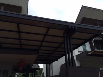

Just to share the glass awning of my house, frame with louver installed, left glass to be installed this week...can't wait to see the final.outcome.

It's gonna be very hot since all glasses.

QUOTE(coolkwc @ Jul 4 2017, 08:59 PM)
I was thinking glass but if tiles from upper roof slid off and hit the glass sad.gif
How much per sqft ? What type of glass use?

QUOTE(Zot @ Jul 5 2017, 10:42 AM)
[/spoiler]
Very rare case. Use tempered glass.
Just once or twice a yrs, jet spray clean will do.

QUOTE(ozak @ Jul 5 2017, 11:16 AM)
Just using 10mm laminated glass only, becos thats fit my budget for that. They quote 58/square ft without louver, additional 11/sqft for louver. I add 50% louver coverage, total price 23.5k after 5% discount when i give full payment at once. Anyway, i stay in JB which i believe the price is higher than KL, but this is by far the cheapest i found here.

QUOTE(etan26 @ Jul 5 2017, 10:37 AM)
The main reason i insist on glass is becos i hate noise during rain (poly) and indoor.too dark (non poly or glass). My main purpose just for rain shade, not care about hot issue.
Anyway, the 50% louver coverage can reduce the sun heat considerably.

QUOTE(coolkwc @ Jul 5 2017, 01:47 PM)
Price a bit high side.
Base on the picture, the frame installation is quite nice. Additional secure by the steel rope.
You can use green tinted glass to shade abit. Quite nice when your whole car posh look green when sun shine down.

QUOTE(ozak @ Jul 5 2017, 04:43 PM)
Yes, i had been quoted by othes for 50k+ with.aluminium i beam plain design and 70k+ with louver. You can see how bad in JB. The things here like electrical appliances and renovation are higher than KL due to adjacent singapore. I surveyed for almost a year before i found this.
The laminated glass i used is light green in colour, which is similar to the glass on my SS gate (you can see in the picture)

post Jul 8 2017, 03:13 PM
Fall in love with audio again.
3,112 posts
Joined: Jul 2006
Installation in progress...

How much does it cost to build such awning (as shown in photo below)?
Kindly recommend reliable contractor in Selangor state for this job.

QUOTE(Skylinestar @ Nov 20 2017, 10:11 AM)
usually the people who make this, the wood cincai prepare wan. dunno what paint they paint over the wood also. sweat.gif
Skylinestar
post Nov 24 2017, 12:58 PM
Mega Duck
10,479 posts
From: Sarawak
QUOTE(ar188 @ Nov 24 2017, 12:16 AM)
That's metal, not wood
ar188
post Nov 24 2017, 01:00 PM
9,206 posts
Joined: Jun 2006
QUOTE(Skylinestar @ Nov 24 2017, 12:58 PM)
lol ya hor..
why make it look like wood frame design? rclxub.gif metal awning no need make like this kind of frame lo
Skylinestar
post Nov 24 2017, 01:01 PM
Mega Duck
10,479 posts
From: Sarawak
QUOTE(ar188 @ Nov 24 2017, 01:00 PM)
lol ya hor..
For the look actually.
ar188
post Nov 24 2017, 01:03 PM
9,206 posts
Joined: Jun 2006
QUOTE(Skylinestar @ Nov 24 2017, 01:01 PM)
get a properly made wood frame nicer lo. if really want to go for look.

From: the muddy banks of the wishkah!!
QUOTE(afoka @ Mar 20 2018, 06:19 PM)
steel frame and poly awning...only last 6 years... recently heavy rain and strong wind took this awning down...
this is serious shit.
How come can collapsed?
How that steel trusses fixed with your porch beam before?
ozak
post Mar 21 2018, 08:40 AM
10k Club
17,023 posts
Joined: Jan 2005
Sunday ?
The shoddy work of the joint and the attachment to the concrete.

Just wanted to share pictures of my sky roof, laminated glass 12 mm green tint with steel structure and steel hinge support (no pillars) and 50% aluminium louvers.
