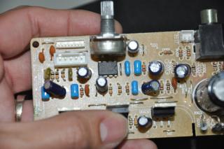

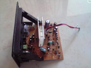

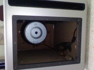

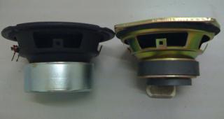

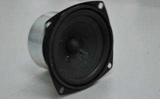

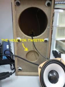

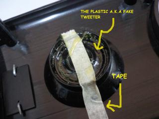

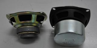

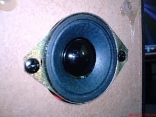

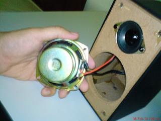

I got this thought after my 13 months old SG Evo3 spoilt.
I decided to dismantle it since it's not workingand no warranty. I discover some interesting stuff after i dismantle it and want to share with all the forumer.
SG Evo 3 spec - Sonic Gear Evo 3

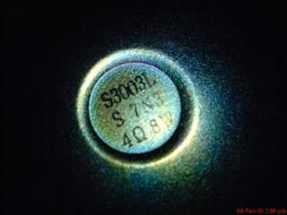

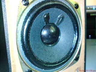

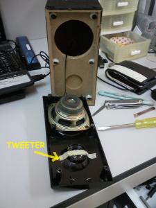

For the spec, they claim that this speaker come with 2 x 1" Tweeter
A tweeter without magnet , how it sound?????? I just realize, this is why i can't hear any sound fr the tweeter when i closed my ear to it. Damn..
This post has been edited by 7Eleven: Jan 17 2010, 01:39 AM

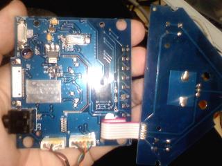

TS7Eleven
post Jan 17 2010, 01:34 AM
197 posts

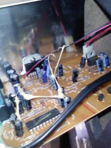

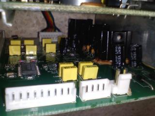

Reserved for the Evo 3 PCB part

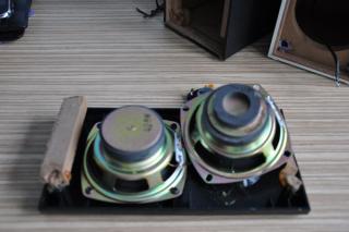

I will dismantle my Altec, Edifier and Eacan speaker soon.

QUOTE(7Eleven @ Jan 17 2010, 01:32 AM)
if i am not mistaken.
that are infact drivers too
remember old timer ATARI game machine (tetris, Donkey Kong,) were using this kind of tranducer to produce some high pitch sound.
if i am not mistaken too. my Gshock watch actually uses same type of driver to produce the BEEP sound.
PS: i am not sure. because i though it was a buzzer. hm... high pitch buzzer?
EDIT : found the name of this kind of driver.
it's called Piezoelectric driver.
This post has been edited by PcWork: Jan 17 2010, 02:11 AM
TS7Eleven
post Jan 17 2010, 02:34 AM
197 posts

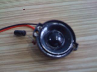

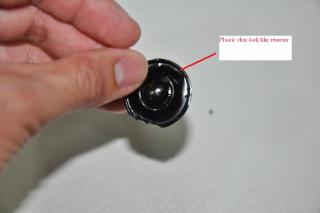

Bro Pcwork,

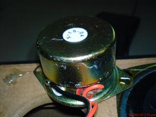

No, confirm not infact driver, it's a fake tweeter - a plastic and a metal mad.gif
see the pic below u will know, i think the evo3, 5 and 7 also using the same fake tweeter

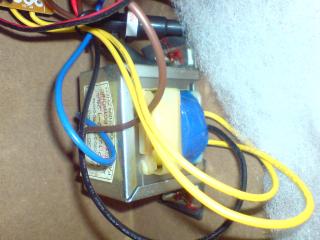

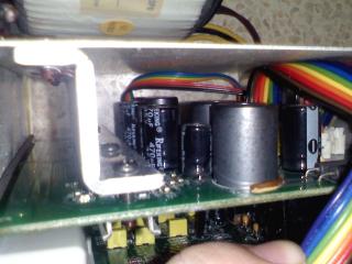

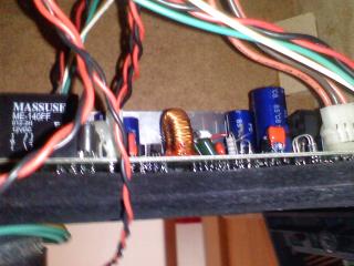

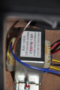

i like this kind of stuffs... please also post the picture of PCB and the power supply / transformer rating.. see if it match the spec..

power911
post Jan 17 2010, 04:17 PM
Misguided Angel of Death
6,513 posts
Joined: May 2009
From: I'll follow wherever Tira goes
sweet
I love pics of dismantled speakers
btw those are piezoelectric buzzers
those buzzers are tweeters that doesn't need a crossover to protect them.
can't wait to see other speakers dismantled
PcWork
post Jan 17 2010, 04:32 PM
Audio Phreak
6,489 posts
Joined: Mar 2005
From: Serdang
QUOTE(power911 @ Jan 17 2010, 04:17 PM)
sweet
i oso keep thinking. if it is fake tweeter. why they so borther to solder cable on it. it waste 2 wire and worker time too.
could it be a peizo tweeter covered by plastic infront to mimic normal tweeter out look?
hm..

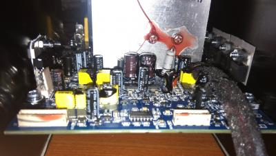

TS7Eleven
post Jan 17 2010, 11:10 PM
197 posts
QUOTE(PcWork @ Jan 17 2010, 04:32 PM)
hm..

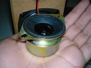

haha... the cable is to make it look like real, anyway i already dismantle the metal part of the tweeter so i will show u all the items i get after i dismantle it.
The SG boss will tell u " it look like peizo tweeter, made like peizo tweeter but it is not peizo tweeter" smile.gif

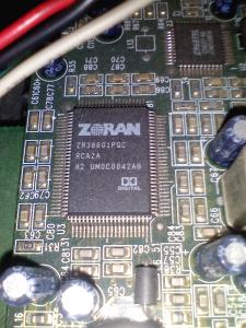

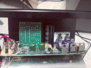

Beside that, i also find out the IC for the sub is TDA2030 which max RMS is 14w (Correct me if i m wrong), but the RMS stated by SG is 18w for the woofer. How the extra 4w RMS came fr???
I m think a way to take the picture of the IC, anyone can help?
This post has been edited by 7Eleven: Jan 17 2010, 11:11 PM

TS7Eleven
post Jan 17 2010, 11:23 PM
197 posts
I can confirm this is fake tweeter, because b4 i dismantle the speaker i can't even hear any sound fr the tweeter even i higher up the main volume and treble.
If u planning to visit the computer shop, u can try it out yourself.

post Jan 17 2010, 11:33 PM
Fall in love with audio again.
3,112 posts
Joined: Jul 2006
This thing call buzzer rather than 'speaker'. Well, only those poor speaker use those unit, really nothing to said, because the power handling is small like mosquito, without any housing, useless...
power911
post Jan 17 2010, 11:39 PM
6,513 posts
Joined: May 2009
QUOTE(7Eleven @ Jan 17 2010, 11:23 PM)
that's because this type of tweeter needs a LOT of power to get as loud as a normal tweeter would need.
unless you are giving pure sine wave like most digital watches have in their beepers
trust me
they may sound nothing at all but they actually sounded extremely soft till it's inaudible anymore
QUOTE(coolkwc @ Jan 17 2010, 11:33 PM)
more like very big
This post has been edited by power911: Jan 17 2010, 11:43 PM
coolkwc
post Jan 17 2010, 11:43 PM
3,112 posts
Joined: Jul 2006
Yup, especially it connected parallel with the 'real' driver, the signal was drawn by the midrange driver adi, if u only connects the cable to the so called 'tweeter', it will gives some kind of 'mosquito' treble sound...lol...
Anyway, u can get this thing in everywhere, example ur digital watch which got alarm buzz, exactly the same thing...
TS7Eleven
post Jan 17 2010, 11:44 PM
197 posts
QUOTE(power911 @ Jan 17 2010, 11:39 PM)
unless you are giving pure sine wave like most watches have in their beepers
trust me

since it is inaudible for human ear, what is the point of having it there?
jazzy939
post Jan 17 2010, 11:57 PM
reel is real
8,186 posts
Joined: May 2005
From: Beaumont, Baile Ath Cliath, EIRE.
PcWork
post Jan 18 2010, 12:02 AM
Audio Phreak
6,489 posts
Joined: Mar 2005
From: Serdang
QUOTE(chicaman @ Jan 17 2010, 11:55 PM)
lol
so that ppl trust their ear. instead of eye..
that's why sonic gear said :trust your ear..
because what your eye see. can fool you. u see a tweeter, but it is not.. lol.
trust ur ear. if it is crap . it's crap. no matter they got tweeter or not.

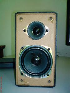

So did u lodge a report to tribunal?? about the fake tweeter and fake RMS rating??

TS7Eleven
post Jan 18 2010, 09:40 AM
197 posts
Just try it with an external amp, the tweeter will provide a very very low sound like bro coolkwc mention - 'mosquito' treble sound

Mosquito type sound ar? So when play this speaker you will have the illusion that there are mosquito flying around? laugh.gif

TS7Eleven
post Jan 19 2010, 10:22 PM
197 posts
Just took 2 more pic of the driver used by EVO3. this is definitely not a magnetically shielded spk because the magnet is expose and not cover.
Left is woofer driver and right is the sat driver.
This post has been edited by 7Eleven: Jan 19 2010, 10:23 PM
Attached Image Attached Image
danny_sp15
post Jan 19 2010, 10:23 PM
3,045 posts
Joined: Dec 2007
From: Canterlot
QUOTE(PcWork @ Jan 19 2010, 03:43 PM)
haiyo
u ppl salah blame Sonic Gear already..
i think that is mosquito repellent lah... it will repel mosquito away when u on the speaker..
because it communicate with nyamuk.. "go away go away~!"
they shall put in box there big big "with EXTRA function - Repel annoying mosquito"
hmm... maybe i should buy a sonic gear speaker soon... cos i cannot tahan ridsect's smell.. tongue.gif
anyway, TS has been dismantling his SG speakers. anyone ever dismantled their SG IEMs or earbuds? kinda curious about the insides too. hmm.gif

TS7Eleven
post Jan 19 2010, 10:36 PM
197 posts

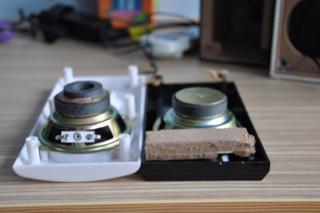

See this, how cheapskate it is, by using 1 finger only i can remove the center plastic fr the woofer's front panel.
For your info, their IC even worst, cannot find any info from the net, all making by China factory. will post up the photo once is ready.
danny_sp15
3,045 posts
Joined: Dec 2007
From: Canterlot
QUOTE(7Eleven @ Jan 19 2010, 10:22 PM)
why is there another piece of magnet on top of the drivers? is that the way they shield the drivers? and the woofer driver looks similar to the sats driver... anyway, i dont know anything about a speaker's internal component... hope someone can explain. notworthy.gif
This post has been edited by danny_sp15: Jan 21 2010, 12:23 AM

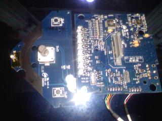

TS7Eleven
post Jan 20 2010, 11:57 PM
197 posts
More pic coming

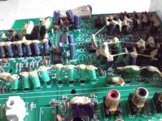

The SG is using alot of China make low quality IC, fr the pic u can see they use the F4558 and D2030A IC. I read some article from China wed, this IC's price is 1/5 of the original IC and this IC will produce very bad sound quality. You can't even find the data sheet on the web.
For the power pad, i'm not sure the power output cause no data provided.
nismo91
post Jan 21 2010, 12:59 AM
foobar2000
2,193 posts
OMG! cant u see that? its an incomplete board!

SG not worth the money =.= better just spend Rm100 buy ksc75
nismo91
post Jan 21 2010, 06:58 PM
foobar2000
2,193 posts
QUOTE(PcWork @ Jan 21 2010, 05:23 PM)
design, performance, quality and price?? research?? development ??
research how to get max profit out of users? or research to develope the best looking highest end mosquito repelent?
it is still OEM now. but sadly. after 3 years. they choosen worse quality OEM. lol.. profit come first eh..
improvement are keep in mind???? or mooooney? after this case. sonic gear is indeed NOTHING to me. lol
lol
just quote back several post of this from sonis gear fans club.. since compro is their representative as he claim.
it seems very ironic to see what they wrote, and compare to the al'cheapo tweeter. lol.

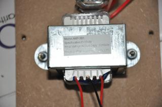

design ? i say half copy
performance ? how to achieve with incomplete board?
quality? good material? i don't think so
price? its not very cheap also. competing with altec creative and edifier.
research and development? i dont even see something special they came up with.
even the Sonic Gear Armageddon A5 is also using "incomplete" board.
claimed to have 75W RMS while the transformer only supply max 65VA and i doubt it has 100% efficiency.
source
no offense guys... but i'd rather have something complete. so no wonder they have high failure rate...

QUOTE(nismo91 @ Jan 21 2010, 06:58 PM)
source
So they actually took a circuit, cut out some components to save cost, and used it instead of a custom designed low cost circuit.
Dont see what's wrong with that - so long as the components are ok...but they're not tongue.gif

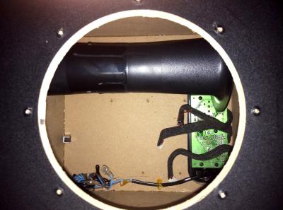

Just snap the sat photo of my poor M1310, same price range with the evo3 and already used for 4 years.
U will notice that the component they used is value for your money if compare to my poor evo3. For the pic, u can see even the screw Edi is 10x better than evo.
I will take the sat comparison photo later when i free smile.gif stay tune.
This post has been edited by 7Eleven: Jan 22 2010, 12:56 PM
TS7Eleven
post Jan 22 2010, 02:34 PM
197 posts
Comparison between the evo3 mid and M1310 mid - same league.
The Edifier M1310 mid driver also 2x the weight of the evo3.
For the built quality - evo3 cannot compete to Edifier at all, i think alot of China brnad can do better than SG.
The evo3 mid got very funny sound when u press on it smile.gif i will take a video later

TS7Eleven
post Jan 25 2010, 12:11 PM
197 posts
Just snap some photo of wooer driver of Edifier M1310 and Evo3.
The secret i discover between the 2 brands.
For Edifier, parts installed according to their spec.
1. 5" woofer driver with metal cover to avoid electromagnetic fields. Why spk driver need shielded. During playback, to generate sound, an electromagnet uses the current from the amplifier to pull the cone forward, and the permanent magnet pulls the cone back. Placing speaker close to a television or computer monitor can cause serious picture distortion. Speakers with very strong magnets can cause data loss when placed close to computer hard drives, magnetic disks, and magnetic tape.
For Evo3, low end parts installed and not shielded.
1. Component that cannot see from eye, usually SG will purposely installed very low end component - check the tweeter drive i post previously
2. Driver not shielded, save the metal cost
3. using 4" driver - even the Edifier at the same price using 5". That y, they don't mention the woofer driver size in their box.
4. using cheap material on their driver
Below are some pic of M1310 & Evo3 woofer driver photos, hope u guy like it
Attached Image Attached Image Attached Image Attached Image Attached Image Attached Image Attached Image
nismo91
post Jan 25 2010, 07:53 PM
foobar2000
2,193 posts
^ the sonic gear speakers are also magnetically shielded. notice the ferrite rings bonded on them. higher end edifier like S550 also use those kind of shielding.
more info
TS7Eleven
post Jan 25 2010, 10:03 PM
197 posts
QUOTE(nismo91 @ Jan 25 2010, 07:53 PM)
more info
Bro Nismo91, thanks for the guide. notworthy.gif really learn alot of new things after open this topic and i just snap photo of M1310 PCB, hope u guy like it.
What i discover fr M1310 PCB r:
1. Use TDA2030 fr Italy for the woofer (search result fr Google)
2. Use 2 UTC2030A (Fr Taiwan) for sat (search result fr google)
3. Use CBB from Panasonic or Tan capacitors, not like the SG use polyester film capacitors to save cost, The polyester film capacitors generate large noise, and easily be damaged. Users usually will not notice this, but the service people will get over payed on this. (My engineer friend told me)
4. Using NE4558 from Texas compare to SG's F4558 - domestic made. (search reult fr Google)
Just wondering the the total RMS should be 18w + 2 x 14w= 46w, but Edifier just state their RMS is 30w only?? any brother can tell me this??

QUOTE(7Eleven @ Jan 25 2010, 12:11 PM)
1. 5" woofer driver with metal cover to avoid electromagnetic fields. Why spk driver need shielded. During playback, to generate sound, an electromagnet uses the current from the amplifier to pull the cone forward, and the permanent magnet pulls the cone back. Placing speaker close to a television or computer monitor can cause serious picture distortion.Ā  Speakers with very strong magnets can cause data loss when placed close to computer hard drives, magnetic disks, and magnetic tape.
when current pass through voice coil. then the coil will creates magnetic field.
the permenant magnet is there to pull and push the coil. hence converting current -> magnetic -> kinetic.
if the coil creates N pole. while the permenant magnet has N pole. it will push each other away. while the permenant magnet is fixed to the basket of the speaker. so the only things can move is voice coil.
while if the current pass through the coil creastes S pole, then the magnet will pull the coil nearer.
not that the current pull driver and magnet pull it back.

nismo91
post Jan 26 2010, 12:15 AM
foobar2000
2,193 posts
QUOTE(7Eleven @ Jan 25 2010, 10:03 PM)
no problem.. i also have some pictures of X300 and M3300 internal. in case you're interested i can share the link...

TS7Eleven
post Jan 26 2010, 11:29 PM
197 posts
Just took the photo of M1310 power pack and the Evo3's plastic sat cover. The material look like recycle plastic, very low quality compare to Edifier Sat.
Can anyone tell whether the M1310 power pack enough to drive the M1310's 28w rms? does it give any fake info?
terradrive
post Jan 26 2010, 11:33 PM
RRAAAWWRRRRR
1,943 posts
Joined: Apr 2005
is it 12V X 2 - 1.25A?
TS7Eleven
post Jan 26 2010, 11:49 PM
197 posts
QUOTE(terradrive @ Jan 26 2010, 11:33 PM)
Yes, bro terradrive

nismo91
post Jan 27 2010, 01:15 AM
foobar2000
2,193 posts
QUOTE(7Eleven @ Jan 26 2010, 11:29 PM)
1.2V x 2 ~ 1.25A means : 2 rails of 12V supplying 1.25A each. so total would be ~ 30W.

But to answer TS observation - that is a capacitance driver, not an inductance driver.
ITs not uncommon for tweeters to be based on capacitance as it can be more efficient.
If you really suspect its fake or not working, try to measure the capacitance at the tweeter leads with a multimeter.
The reason you may not hear anything from it doesnt have to be that its fake, several valid reasons below:
1. Your sound source (file or signal, including DAC/ Soundcard) does not have high freq. sound. YOu can check by trying a sine wave generator at 10kHz and above.
2. That tweeter / driver itself is not very efficient or sensitive.

TS7Eleven
post Jan 28 2010, 09:58 AM
197 posts
QUOTE(lee82gx @ Jan 28 2010, 09:20 AM)
didnt have time to read through all the posts.
I dont work for any multimedia speaker company.
In the end you get what you pay for.
Bro lee82gx,
Thanks for the info.
Yes, SG did provide a tweeter, a so called mosquito repellent tweeter.
Why i said that, i did compare side by side with another tweeter - same sound, same volume level and same player and same amp, the result i get is the sound produce by SG tweeter is very low until i need to put the SG tweeter close to my ear only i can hear it but the another tweeter doesn't need that. why?
Another things i discover is beside the low quality tweeter, the component they used to built the EVO3 is damn low grade and this brand is trying to cheat the users, that y i decided to create this topic to disclose their trick. I just don't want other forumer make the same mistakes like me, attract by the look and fooled by them.
The reason i create this topic is for educate purpose, if u guy don't like it i can close this topic.
Some of the facts i give might not correct cause i m still new to the speaker.
U can also provide info if u discover any brand or any things giving fake info, this thread is not anti SG, this thread is for discover the brand giving fake info and deceive people.
I will take a video and show u guy about the comparison later when i free.
I dont work for any multimedia speaker company too, i used to be a fan of SG. tongue.gif

QUOTE(7Eleven @ Jan 28 2010, 09:58 AM)
Bro lee82gx,
So, you found out that there is indeed a real tweeter and not a fake one. flex.gif
As for the sensitivity of the tweeter, you need to listen to the overall spectrum of sound, as speakers (woofers + midrange + tweeters) are design to be in combination to produce a flat response. This fact, even ah beng or ah seng speaker company knows.
So, if you listen from your normal position and find that the speaker does not produce as much high range as you'd like, then next is to see whether you are the type likes bright highs or not. If not, then only check the response of the whole speaker, and maybe in that case it could be that the speaker you are auditioning is performing poorly in high range.
Its also good you do a blind test from normal listening position to audition both speakers and see which one you still prefer.
Sometimes, the mid range driver is good enough to cover even the high frequencies, that the tweeter is cross-overed only to produce small amount of pressure at certain cross points, which makes it difficult for you to hear from the tweeter even at close range.
I don't support any brand in particular, but if you are smart enough to do listening tests / auditions, I'm sure you'd bought a set of speakers that suit your budget vs performance. If you blindly bought a product due to "support" then caveat emptor.
FYI, my edifier C2 performs well for my judgement, but I'm also quite sure the tweeter is very low response.
Every manufacturer has its right to use 'cheap' material, to maximize profit. As long as its reliable and performs to your listening needs, why check each component inside?

Tweeter is made to output high frequencies. If the tweeter have super low output (as mosquito's noise), then it doesn't server any purpose at all, other than to make the customer think "oh it's 3 way tweeter, midrange, subwoofer speaker so it should be nice". When you look at that viewpoint, we have a serious problem here especially as potential customers.

TS7Eleven
post Jan 29 2010, 11:28 PM
197 posts
Pass by Pasar road today and went to 1 of the electronic shop to bought 1 RM5 tweeter for comparison
Test it in very quiet enviroment, otherwise i i can't hear the sound from SG tweeter at all. using M1310 amp to boost it at higher volume.
My RM5 tweeter from Pasar Road
http://www.youtube.com/watch?v=YEjv0LN0ano
Sonic Gear Tweeter
Sonic Gear Tweeter
This post has been edited by 7Eleven: Jan 29 2010, 11:31 PM

QUOTE(7Eleven @ Jan 29 2010, 11:28 PM)
Test it in very quiet enviroment, otherwise iĀ  i can't hear the sound from SG tweeter at all. using M1310 amp to boost it at higher volume.
Sonic Gear Tweeter
Sonic Gear Tweeter
hmm. the RM5 tweeter have a plastic case.
try removing it so that it is fair to compare with the sonic gear tweeter that doesn't have a plastic case
EDIT: is the RM5 tweeter a piezoelectric tweeter?
if not don't remove it lol
you'll destroy it
This post has been edited by power911: Jan 30 2010, 12:19 AM

dear all, just manage to take a video to compare the quality of Sonic Gear Evo3 with Edifier M1335 mid range driver. I found some funny sound when i press on the Sonic Gear's mid range driver and this doesn't not happen on Edifier mid Range driver, can someone tell me why the Sonic Gear Driver got the sound when i press it?
Comparison between Sonic Gear Evo3 and Edifier M1335 mid range driver

That RM5 tweeter from Jalan Pasar doesn't look like a piezo based to me.
Piezo ones that I used to buy have horn like enclosure to radiate the 'noises' biggrin.gif , and they're 3 bucks each! LOL! laugh.gif
This post has been edited by jazzy939: Feb 21 2010, 12:33 AM

nismo91
post Mar 13 2010, 10:25 PM
foobar2000
2,193 posts
up this thread.. encourage more people to participate in this channel. laugh.gif
Attached pictures shows Edifier X300.

I can confirm the 1 in the middle (in Pic) is a piezo tweeter, you try un-screw the back and see' you will find the same round piece of flat metal attached to a tiny paper cone without any magnets.
The plastic thing is just the housing.
It can go very loud and sharp, and it's not fake.
I used to play with these piezo tweeters when i was young because they are cheap and allmost impossible to burn.

nismo91
post Mar 17 2010, 02:33 AM
foobar2000
2,193 posts
QUOTE(power911 @ Mar 16 2010, 11:49 PM)
this post makes me wanna take photos of my sis edifier e3100
come on, do not hesitate to take. there are some internal pic of E3100 in the net but none shows the details of the items inside.
here i will motivate you with some picture of my old M3300. laugh.gif laugh.gif
Edifier M3300 pic on attachment.

i have to agree with all of you here with all the new SG models... None of them sounds good at all, especially the Evo series!! Either they have too much treble or bass are too hard.. EXCEPT for the Bluethunder Series which you mentioned above.. I was shopping for new pc speaker 3 years ago and the Bluethunder series caught my attention with it's low price and professional look. I purchased a Bluethunder I for RM140 as it was the best of all among it's price range.. It has a very clean mids and highs, bass is ok except when it goes really low... This system is comparable to the famous Altec Lansing v4121 and believe me, the bluethuner I have better mids and highs than the vs4121!!!! After reading this forum, i was wondering if my Bluethunder I's tweeters were fake, and so i open it up... Thank god they are not!! haha.. They do produce trebles but at a very high frequency while the midrange driver handles all the mids and highs, so the tweeters work like supertweeters which sounds very crisp to make the sound more crystal clear... But one thing i found when i open the satellite speakers up, THEY LOOK CHEAP OMG!!! But who cares? as long as they sound good and cannot be seen from outside... Just have a look of my system with the link below;
Here is my system with the drivers inside...
The woofer driver:
______________________
With the amplifier:
The Satellite speaker:
Notice the cheap workmanship of the speaker..
The Mid-range driver:
The Tweeter driver:
Notice the poor workmanship?? It's not even screwed properly and i still see holes and the wire inside!!!
The back side of the mid range driver:
Details of the mid-range driver:
The tweeter driver:
Apart from the built quality of this model, I'm glad that this model is quipped with REAL tweeters instead of fake ones... The tweeter produces really high frequency of treble.. When you're listening to lossless music, you can really hear the details of the singer's voice as well as the string of a guitar which is really amazing.. Not too sharp and just nice...
This post has been edited by Qibai: Mar 6 2012, 01:04 AM

juz found out...my EVO5 do nt even has a workable(unlike evo3) tweeter!!! it juz a piece of plastic..you cheap SONIC GEAR
power911
post May 1 2010, 04:02 PM
6,513 posts
Joined: May 2009
QUOTE(jammerlee711 @ May 1 2010, 03:38 PM)
got wires connected to it?
if got then it's a working one even if you can't hear sound coming from it lol
still,a cheapo speaker
jammerlee711
post May 1 2010, 04:09 PM
395 posts
Joined: Apr 2010
QUOTE(power911 @ May 1 2010, 04:02 PM)
nope...there isn't any..wanna upload the pic here...which size are rite for the pics??

jammerlee711
post May 1 2010, 05:06 PM
395 posts
Joined: Apr 2010
picture of my EVO 5...the build ..cheaper than EVO 3 ...lol...dun even has a tweeter on it although it said so
This post has been edited by jammerlee711: May 1 2010, 05:17 PM
Sop.qiqi
post May 1 2010, 05:18 PM
374 posts
Joined: Dec 2009
Why dont they remove the tweeter and cut cost?
jammerlee711
395 posts
Joined: Apr 2010
wonder if tis is cheating...mayb we can sue sonic gear for this
Added on May 1, 2010, 5:20 pm
QUOTE(Sop.qiqi @ May 1 2010, 05:18 PM)
even the tape i use to stick my engineering drawing paper is thicker than theirs...haiz~really feel sad about that ..i hate sonic gear~
This post has been edited by jammerlee711: May 1 2010, 05:20 PM
power911
post May 1 2010, 10:12 PM
6,513 posts
Joined: May 2009
QUOTE(jammerlee711 @ May 1 2010, 05:06 PM)
better than TS posted tweeters hahahahahhahaha
mega fail!
jammerlee711
post May 1 2010, 11:32 PM
395 posts
Joined: Apr 2010
haha..yeah...evo 3=cheap tweeter,evo5= plastic tweeter,i wonder what material they used to make evo 7 & 8's...A4 paper or toilet paper roller?? haha ;-)

TS7Eleven
post Jul 28 2010, 09:40 AM
197 posts
Yesterday nite, go Lowyat to find some parts and saw this babe Sonic Gear Evo3 Platinum (MSRP RM119). Suddenly hand feel itchy, feel like want to dismantle sometime so decide to buy a unit.
This time they r smart, they glue the front plastic of the sat so user cannot open it. I manage to dismantle it but the sat gone, check the pic below cry.gif
How SG cut the cost this time
1. They remove the front wooden part of sat, So they got to glue the front plastic cover to hide the secret smile.gif
2. The magnet at the back of the sat have been remove
3. The size of the sat smaller so they can use less Chipboard
4. The Evo3 Platinum sat is lighter than the Evo3, they use lower density chipboard for the sat.
6. Price higher but built quality lower, found out the dimension of the MDF slimmer than before.
Attached Image Attached Image Attached Image Attached Image Attached Image Attached Image Attached Image Attached Image

Wow,salute to 7Eleven.
Paid your own money to do experiment.

QUOTE(7Eleven @ Jul 28 2010, 09:40 AM)
awesome job done there...
your RM119 is very well spent as it shows how bad sonic gear is notworthy.gif notworthy.gif notworthy.gif

TS7Eleven
post Aug 5 2010, 10:03 AM
197 posts
The Tweeter of Evo3 Platinum, photo quality not very good cause using handphone to capture the pic. sad.gif
power911
post Aug 5 2010, 02:35 PM
6,513 posts
Joined: May 2009
QUOTE(7Eleven @ Aug 5 2010, 10:03 AM)

post Oct 8 2010, 01:32 AM
foobar2000
2,193 posts
got my klipsch ifi used, noticed there is small thing added next to the fuse. everything else seems to be stock.
Attached Image Attached Image Attached Image Attached Image Attached Image Attached Image Attached Image Attached Image Attached Image Attached Image Attached Image Attached Image Attached Image Attached Image

nismo91
post Oct 8 2010, 02:26 PM
foobar2000
2,193 posts
quite beefy for an ipod speaker i think. btw ADA885 still got more complex gut with its dual voicecoil sub and dual amp compartment, but i dare not open up mine since i tend to screw up.
still, you can enjoy the pic from someone's ADA885.

use a dry, soft brush? btw now i put a 80mm 12V fan blowing to the side of the digital decoder which get warm on even idle. just blutack it to the side and my ADA885 has been much cooler than before. not sure if the inner amp is 'burning' already or not. laugh.gif
btw here is the image:

QUOTE(cubicle @ Oct 12 2010, 09:07 AM)
Will try by using a soft brush, a few ppl suggested me to do the same. Thanks a lot.  smile.gif
My sub is not that hot although i idle or play songs with it, yours is hot maybe because u in the space that is too small for air to circulate?
yup, mine also quite hot when i place both in my room or outside below the dvd player (picture). that's why i thought a simple fan would help. haha thanks, i hate the plain empty looks, so there it goes... laugh.gif

Altec Lansing VS4121 (blue led). cable from transformer and woofer are very short. uses particle board, very light. power caps are below transformer itself. it appears the the front is only covered by the plastic fascia, makes it even lighter than it suppose to.
power911
post Nov 9 2010, 02:18 PM
6,513 posts
Joined: May 2009
any plans of adding acoustic foamies into it?
nismo91
post Nov 9 2010, 02:37 PM
foobar2000
2,193 posts
QUOTE(power911 @ Nov 9 2010, 02:18 PM)
i don't think so... i don't like the sound from the beginning. well, my friend donated to me one. laugh.gif

Altec Lansing ADA885. as mentioned above, quite complex, plenty of capacitors here there. dual amp, inside and outside the box, plus a DD decoder. dual voice-coil sub and one big toroidal transformer. slot port reflex design.
i think this will be the last of my collection, sold the R501 and VS4121 already.
UPDATE: more pics here. Replaced heatsink and no more port chuffing sound.
This post has been edited by nismo91: Feb 27 2011, 01:06 AM
Attached Image Attached Image Attached Image Attached Image Attached Image Attached Image Attached Image Attached Image Attached Image Attached Image Attached Image Attached Image Attached Image Attached Image Attached Image Attached Image Attached Image Attached Image

Edifier
post Dec 14 2010, 01:36 PM
Store Representative
9,148 posts
From: Edifier, Stax, Noctua and AirPulse
fake tweeter
power911
post Dec 14 2010, 04:17 PM
6,513 posts
Joined: May 2009
QUOTE(Edifier @ Dec 14 2010, 01:36 PM)
fake tweeter

2,193 posts
Cambridge SoundWorks (Creative) Megaworks 550
i got this speaker from forumer as slightly spoilt set. popping and crackling every few seconds but everything else is fine. finally managed to repair it with the help of other forumer. turns out the glue has corroded and short some components. remove the glue and repair broken PCB track, everything is as good as new. this is the fault of Creative of spamming the glue everywhere including at the bottom of the PCB.
first board on top (with 2 black heatsink and coils) is the switching power supply. the middle one is the BASH amplifier, also with 2 black heatsink.
This post has been edited by nismo91: Apr 19 2011, 01:56 AM
boomber
post Apr 20 2011, 01:00 AM
447 posts
Joined: Jan 2009
The glue really look messy..
power911
post Apr 20 2011, 02:14 PM
6,513 posts
Joined: May 2009
QUOTE(boomber @ Apr 20 2011, 01:00 AM)
forgot what but I think is those electronic noise
Cosef
post Apr 20 2011, 03:19 PM
Kampung Style
2,293 posts
Joined: Feb 2006
From: Sarawak
QUOTE(power911 @ Apr 20 2011, 02:14 PM)
I work for ceramic cap, but electrolytic i'm not sure.
Spamming glue on PCB tracks or conductive places are risky, might get short circuit same like soldering flux which i experienced before, unless you are very sure that glue is purely non conductive even on sensitive device.
nismo91
post Apr 20 2011, 09:28 PM
foobar2000
2,193 posts
yeah well they spam it everywhere on their megaworks - gigaworks model, especially the one with 8" sub. the glue become corrosive and short-circuit the parts in the PCB. together with very hot amp many megaworks and gigaworks died very quickly. i now used 2x 80mm 12V fan to blow the backplate, still, when i put my finger into the subwoofer port i can still feel the warmth.

ssyycc
post Apr 30 2011, 03:10 PM
Mr.
920 posts
Really have no idea why people put so much glue everywhere. The only reason i can think of is to prevent the movement of their components as those speakers travel far in shipping.

That said I just wanted to say I purchase this Creative I-Trigue 2300 (was a display set) for just only RM100.00 the other day. I took it apart the other day just to see what was inside (before I saw this tread so sorry no picts) and was very happy that inside all four speakers were from Cambridge Soundworks. It even has serial numbers and all (sometimes u just have to love em Brits).
Sound wise, it doesn't have great bass (no woofer ma) but mids and highs are reproduce well. Sounds better than the RM100 I paid for it.
Just though I share (maybe the next time I take it apart I will post the internal picts) .
good stuffs by cambridge soundworks. i also happen to dismantle a Creative Inspire 2400 which is made by CSW. good workmanship. subwoofer cable is quite thick, even thicker than my M3300. no offense but it's true.
EDIT: just realized i think i got some busted caps over there... well it probably explains why i got blown subwoofer. either the driver voicecoil is blown or the capacitors also gone bad.
This post has been edited by nismo91: May 23 2011, 10:39 PM
musica22
post May 23 2011, 10:41 PM
352 posts
Joined: Mar 2008
QUOTE(ssyycc @ Apr 30 2011, 04:10 PM)
my opinion is because of the vibration this loose components causes when sound is produced out/from within the speaker
it'll become abnormal noise and its annoying, you wont enjoy your music
but there might be other purpose, although electrical components usually they will use hotmelt
slimfox
post May 24 2011, 09:34 PM
392 posts
Joined: Dec 2010
QUOTE(musica22 @ May 23 2011, 10:41 PM)
Yes I agree. The amount of vibration inside a sub-woofer is great therefor if all the components are not secure, soon they will become loose.

Accidentally found this in Youtube
w.j0102
post Jul 26 2011, 06:30 PM
194 posts
I hope the small tweeter on the M3300SF is really working (it does, i felt some vibrations)
Cosef
post Jul 26 2011, 08:51 PM
Kampung Style
2,293 posts
Joined: Feb 2006
From: Sarawak
QUOTE(w.j0102 @ Jul 26 2011, 06:30 PM)
Don't worry about that, it is real working tweeters there....

nismo91
post Jul 27 2011, 06:32 PM
foobar2000
2,193 posts
well if one of them fail sometimes they are just in parallel, so it might still works but you can hear loss of power, or even crackles etc.
i did mentioned here before that i bought a used megaworks 550 in light faulty condition, that it pops every few seconds randomly. turns out the glue have corroded and shorts few small capacitors (lucky it's the small one) in the switching power supply board. after few cleanup it works perfectly again now... (pic is in this thread)
another problem with my speaker is the iFi, which one capacitor (responsible for the dock) fails and causes system to shutdown and pops itself. after replacement it works perfectly for 3 mths, then this time it doesn't shutdown, just pops. re-cap the whole board but still pops. lol i gave up and just send to technician.
actually, don't only judge the amplifier. but also the speaker driver. one can look very small and light, but actually produce better sound than the bigger one. not to mention some other added value such as speaker cabinet tuning. logitech have quite powerful subwoofer, but it quits around 35hz, which is a shame, just because it's not tuned to achieve lower bass.

QUOTE(nismo91 @ Jul 27 2011, 10:49 PM)
what's an Atmel microcontroller doing inside a 2.1 speaker set? shocking.gif
Max
post Apr 20 2012, 09:31 PM
1,705 posts
From: Sepang - Putrajaya - Cyberjaya
QUOTE(TOROBO @ Apr 16 2012, 09:23 AM)
what's an Atmel microcontroller doing inside a 2.1 speaker set?Ā  shocking.gif
that 1 must be for control system like volume adjustment.. or display digit..

i have one more 2.1 speaker from Sony to show you. it's a VAIO VGP-SP100. specification says total power 3.6W but it sounds pretty loud and clear for something that is USB powered. external power supply is also available with greater power rating. some china drivers with pretty neat PCB. what's interesting is how they design the bass reflex port.
lex
post May 7 2012, 11:55 AM
Old Am I?
VIP
18,182 posts
Joined: Jan 2005
From: Dagobah
QUOTE(nismo91 @ May 6 2012, 08:19 PM)
No biggie. I've tried pumping a 2W+2W DIY mini-amplifier into a pair of 20WRMS+20WRMS speakers before, and they do sound loud. All depends on the speakers efficiency (dB/W) and speaker enclosure/box (especially bigger size ones). Considering that the USB port can supply up to 2.5W (standard is 5V @ 500mA), its possible to push at least 1W+ per speaker. Most of the time lots of people are used to listening tiny/weak sounding USB speakers with low wattage drivers and small size enclosure/boxes. hmm.gif
Talk about "pipes", methinks its tuned for certain low frequencies (somewhat like a "trumpeteer"). wink.gif
This post has been edited by lex: May 7 2012, 11:56 AM
nismo91
post May 7 2012, 12:29 PM
foobar2000
2,193 posts
wow, if 2W amplifiers can drive 20W speakers easily that speaker is very efficient. sure the pipe is probably tuned for certain bass frequencies. quite surprised they even bother to put it. some other USB speakers are simply sealed.
Yups, kudos to the designer who spent time on it. Anyway it was long ago playing around with some power amplifier I.Cs such as LM1877 as well as the common TEA2025 and TDA1517 on old soundcards. icon_idea.gif
QUOTE(nismo91 @ May 7 2012, 12:29 PM)
That makes the speakers unable to "breathe" and sound hollow. Also some of those el-cheapo USB speakers were found using headphone amplifier I.Cs such as LM386. icon_rolleyes.gif

Tested today the sonic gear evo 9 speaker in Tesco. More or less can confirm the tweeter is also just for show only - can't hear any sound from the tweeter. doh.gif doh.gif

- Logitech Z-623 board... Opened it recently for capacitor upgrades.
- The glue used is pretty hardened even after I opened it after a few hours of blasting. Hope they don't cause trouble in the future.
- It wasn't egg-cooking hot in there, just luke-warm.
- All connections were secured with glue and wrapped with some kind of sponge to reduce vibrations.
- Capacitors are all TEAPO rated @ 105'C. They are average capacitors from my research, slightly better than other generic or low cost brands.
- Board designed / manufactured by Audera Acoustics. PCB seems to be of professional quality. Quite hard to desolder parts at times.
- Power supply, DSP, amp in a single board. Not sure how that does for audio though. I know nuts about electronics sweat.gif
- Separate I/O board.
- No stuffing or damping in the woofer enclosure, plan to add some later. Hmm polyfill in middle or wool around the 'walls'?
- All in all, good build & reasonable workmanship in a world of competitive cost savings.
SQ after mods
This post has been edited by andrew9292: Nov 16 2014, 01:31 AM
TS7Eleven
post Jan 16 2018, 05:33 PM
197 posts
At first, i thought it is a real tweeter, when i go closer only i found out it actually a plastic mould.
