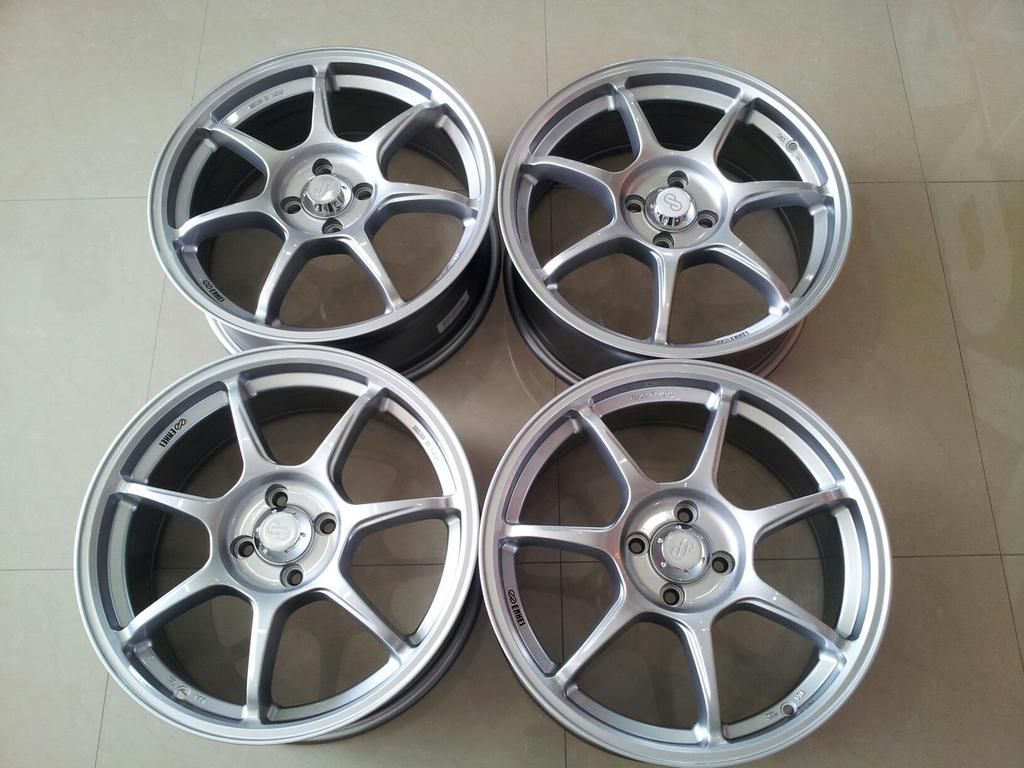

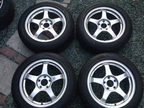

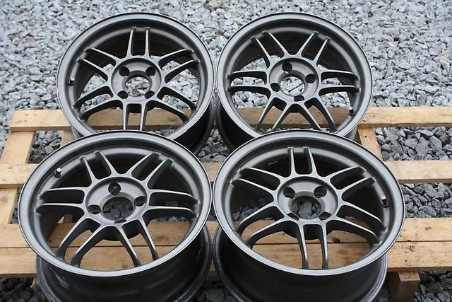

post Nov 22 2015, 02:25 PM
Ninetwenty2
628 posts
Joined: Aug 2007

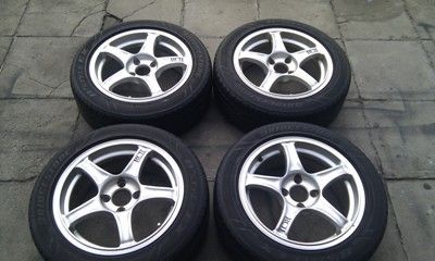

Hi guys jz asking...anyone looking for saga flx se rims? Heh heh
Ive got one set of flx se rims staying in my store wanna get rid of it lol

QUOTE(carcraze66 @ Nov 22 2015, 02:25 PM)
Gib me the price.. Currently im using alza sport Rim.. I stay at wangsa maju kl
FerozFLX
post Nov 22 2015, 05:59 PM
1 posts
Joined: Sep 2015
From: wangsa maju kl
QUOTE(davidke20 @ Nov 22 2015, 11:23 AM)
Nice one sifoo
n3w
post Nov 22 2015, 07:35 PM
350 posts
Joined: Nov 2009

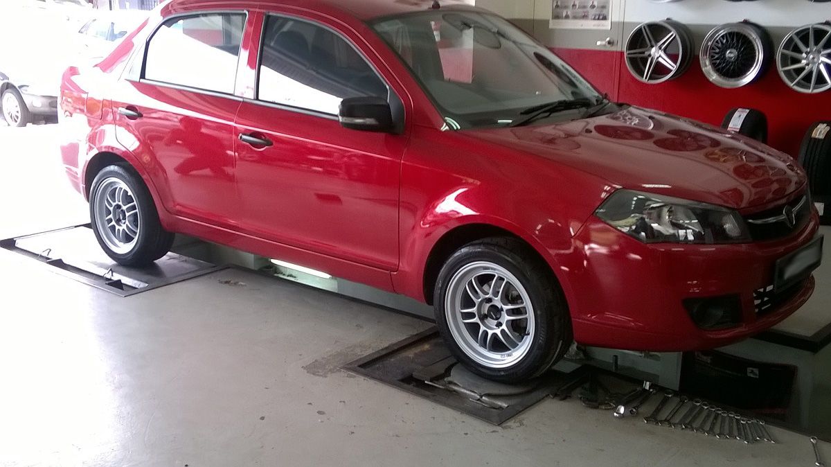

QUOTE(FerozFLX @ Nov 22 2015, 05:56 PM)
davidke20
post Nov 22 2015, 08:38 PM
3 posts
Joined: Mar 2012
QUOTE(n3w @ Nov 22 2015, 07:35 PM)
n3w
post Nov 22 2015, 10:50 PM
350 posts
Joined: Nov 2009
QUOTE(davidke20 @ Nov 22 2015, 08:38 PM)
LOL wana take back? Hideous di la... quite worn and some burn marks due to my tyre shop incompetency, stuck nut so kena burn.
Offered me to restore the rims at a slightly cheaper price. But sayang la the rims ehehe.
akmalrosli
post Nov 22 2015, 11:01 PM
187 posts
Joined: Nov 2010
Alza is 15" 6JJ ET45 if I'm not mistaken
n3w
post Nov 22 2015, 11:31 PM
350 posts
Joined: Nov 2009
QUOTE(akmalrosli @ Nov 22 2015, 11:01 PM)
Can fit our saga right? I've seen those on saga BLMs.
Normal 195/50 would fit right. hmm.gif

QUOTE(n3w @ Nov 22 2015, 11:31 PM)
Boleh masuk.. For flx.. I hav to put spacer.. Bocoz knuckle not fit. I already use for 2 years.. No problm at all.. I already spray the rim .. White colour... U Wan bos 😃??

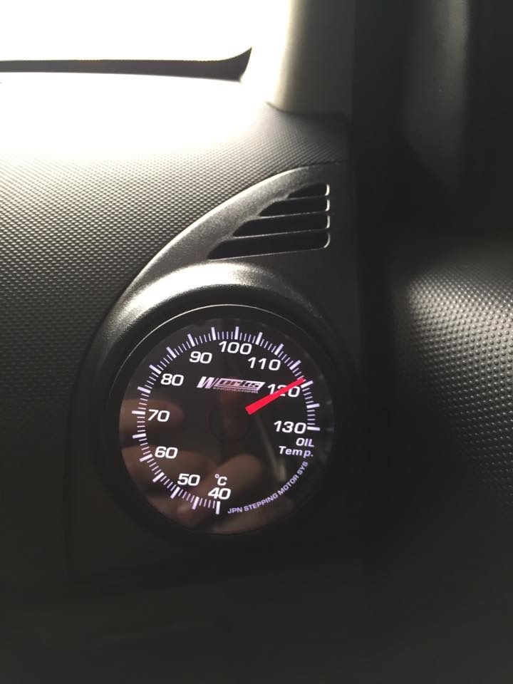

QUOTE(JunJun04035 @ Nov 24 2015, 11:05 AM)
I'm boy boy leh wet as in air liuh kah

QUOTE(davidke20 @ Nov 24 2015, 12:31 PM)
his thread ady stated saga blm not sapporked.

QUOTE(V12Kompressor @ Nov 24 2015, 02:53 PM)
Damn jibai Proton make outdated stuff make OBD kenot suppork

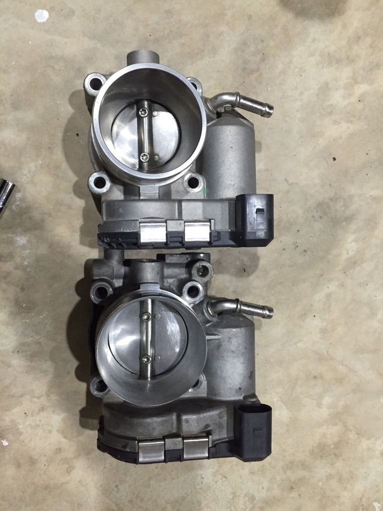

What's the size of the 1.3 Throttle body? How big of a difference is the 1.6 TB?

QUOTE(akmalrosli @ Nov 24 2015, 04:40 PM)
the tunnel opening is the same size with 1.6, just that the butterfly valve for 1.3 is smaller than the butterfly valve on the 1.6TB

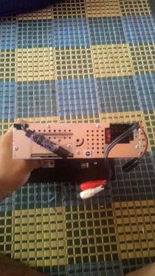

hey guys am new here. just wan share u guys mod dat I did today for my saga blm auto tongue.gif

QUOTE(sky03 @ Nov 24 2015, 07:52 PM)
What brand is that intake?

looks like K&N Apollo C.A.I.

QUOTE(n3w @ Nov 24 2015, 09:42 PM)

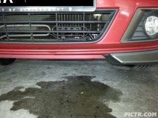

Eugene91
post Nov 24 2015, 10:47 PM
6,109 posts
From: Mike India Romeo India
Was driving through some flash flooded road , the water wasn't that high I suppose? and my engine light macam ni.. I suspect sensor or what kena. Need to wait tomorrow to see if its gone after engine bay dry blink.gif

post Nov 24 2015, 10:53 PM
350 posts
Joined: Nov 2009
QUOTE(Eugene91 @ Nov 24 2015, 10:47 PM)
Leave your car overnight. Seems often happened to those who waded through flood areas with their cars.

post Nov 25 2015, 09:15 AM
12 posts
Joined: Nov 2014
From: Land of the Hornbills
Sensor saja. Scared the hell out of me once. Sorry for the late reply biggrin.gif

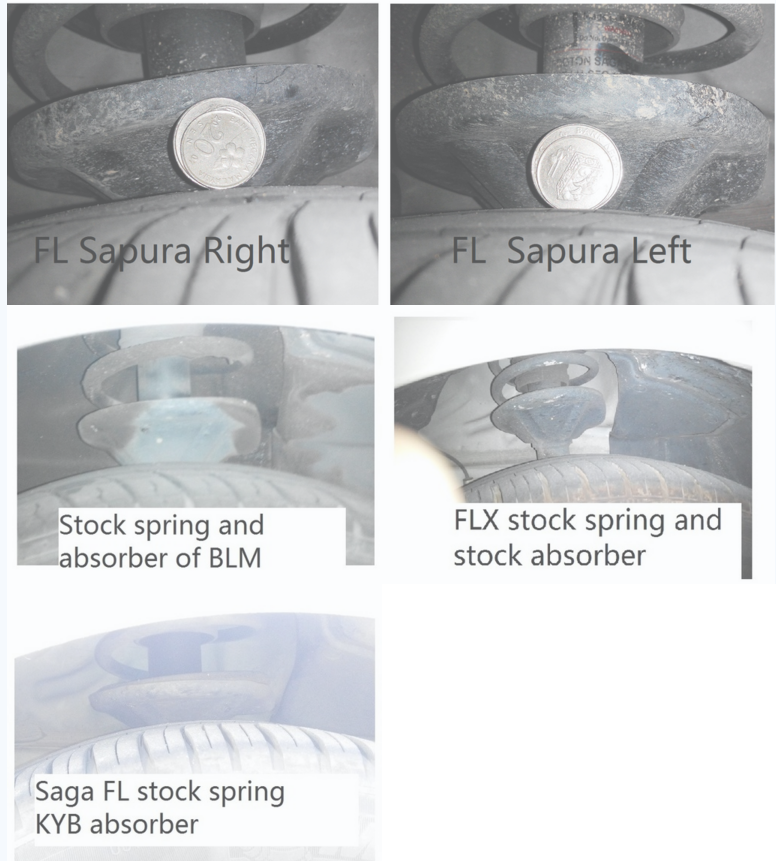

Finally changed flx spring. now can insert 5 fingers oh..haha.

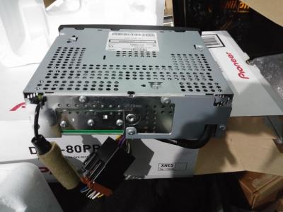

post Nov 26 2015, 12:29 AM
337 posts
Joined: Nov 2009
From: Perak
What is the best bang for buck head unit in your opinion? Suggest some. Mine's saga plus, bought Sept this year. (I don't know if it's blm or flx haha)
P/S: looking for head unit which can play songs from USB. I want to play songs from my phone (Spotify) or if can't I just plug in my USB drive lah
P/S #2: if no best bang for buck, cheapest also can. Me just wanna play songs from USB instead of CD or DVD. Don't really care about the audio quality

NeneBubu
1,171 posts
Joined: Oct 2010
QUOTE(lOrDjAbU @ Nov 26 2015, 12:29 AM)
https://forum.lowyat.net/index.php?showtopic=3434985
lOrDjAbU
post Nov 26 2015, 12:44 AM
337 posts
Joined: Nov 2009
From: Perak
QUOTE(wkwong91 @ Nov 26 2015, 12:35 AM)
Thanks! That's nice! Very cheap and lots of features
BTW, changing head unit will void the warranty right?

post Nov 26 2015, 08:08 AM
171 posts
Joined: Nov 2009
QUOTE(davidke20 @ Nov 26 2015, 06:02 AM)
I thought you posted some 500km distance on 28litre consumption by driving 160kph on your saga few years back? To me that's pretty darn good ady. haha
sorry kacau weh got tt kah? ingat u mau urgent if want then come collect from me unker if not then wait tt but cannot confirm can come or not
athrunzaru
post Nov 26 2015, 09:39 AM
12 posts
Joined: Nov 2014
QUOTE(Eugene91 @ Nov 25 2015, 10:26 PM)
blink.gif  overnight engine oil light still on. But during afternoon hot sun sudah kering maybe so no more light up  whistling.gif
Scared the heck out of me athrunzaru
did u notice the light slowly fade? mine after the rain stop the light slowly fades away
athrunzaru
post Nov 26 2015, 09:45 AM
12 posts
Joined: Nov 2014
talking about head units, this or the stock one?
wkwong91
post Nov 26 2015, 10:32 AM
NeneBubu
1,171 posts
Joined: Oct 2010
QUOTE(lOrDjAbU @ Nov 26 2015, 12:44 AM)
iinm void ur player warranty. if u scare to void any warranty then u can use this. laugh.gif
QUOTE(athrunzaru @ Nov 26 2015, 09:45 AM)

lOrDjAbU
post Nov 26 2015, 11:47 AM
337 posts
Joined: Nov 2009
From: Perak
QUOTE(iskazulka @ Nov 26 2015, 07:54 AM)
Urs is saga blm facelifted extra super value plus. Or saga blm flx sv plus. In short saga plus. I called it saga Projek lebuhraya utara selatan.
Nice explanation bruh
QUOTE(wkwong91 @ Nov 26 2015, 10:32 AM)
iinm void ur player warranty. if u start void any warranty then u can use this.  laugh.gif
What's that thing bro? Where do I put it? In the cigarette something something burner? How does it work though?
Anyway I asked the proton car dealer, he said if I change head unit, warranty for all wiring voided. I thought only head unit warranty voided. Dang it.
Then I asked him what if I ask that service centre people to install the head unit I bought myself. He said I have to kaotim with them lah
Then I go fetch manual and read the ICE manual, it said there are 2 models one with Bluetooth and one without. Mine's without. So I asked him what if I go SC and ask them I want to upgrade to that model he said can lah no problem.
What do sifu sifu here think?
wkwong91
post Nov 26 2015, 01:20 PM
NeneBubu
1,171 posts
Joined: Oct 2010
QUOTE(n3w @ Nov 26 2015, 11:11 AM)
That mp3 modulator sounds ok la. I'm using redfox before i switch to proper usb player. Used it for almost 3 years before switching, and i listen to instrumentals with it lagi on stock speakers! biggrin.gif
QUOTE(athrunzaru @ Nov 26 2015, 11:44 AM)
still considering since many acc shop doing christmas sale.
plan to replace the ori head unit to something better, i can ditch the steering controls for a while since the convertor/intepreter for it is around rm250  brows.gif
LOL. Please tell me if u found a head unit that compatible with the steering control. brows.gif
QUOTE(lOrDjAbU @ Nov 26 2015, 11:47 AM)
It just a FM modulator. Plug in USB and tune into the FM channel which is showing on the modulator. Is done and u can listen to the songs in ur pendrive.
Is depend on yourself and ur budget. If u doesn't want to void the warranty then choose stock bluetooth head unit else go for JVC/others. U can ask those ICE sifus at here coz i am still using stock head unit. laugh.gif

Decided to port and polish my TB. Then, I thought I didn't want to kacau my original part just incase I sell off my car in the next 1 or 2 years
So, I went ahead and bought a 2nd hand 1.6 Persona throttle body. I'm gonna port and polish the shit out of that TB. Receiving it tomorrow. drool.gif

QUOTE(akmalrosli @ Nov 26 2015, 08:16 PM)
sendiri pnp? would appreciate it u take photo step by step thumbup.gif thumbup.gif
akmalrosli
post Nov 26 2015, 08:36 PM
187 posts
Joined: Nov 2010
QUOTE(Bazinga! @ Nov 26 2015, 08:34 PM)
Persona/neo TB all plug and play, if I'm not mistaken. Will take pictures along the process.

TitanRev
post Nov 27 2015, 03:51 PM
9 posts
Joined: Nov 2012
Here's a reference of a 1.3 (lightly ported and fully polished) Throttle body and a 1.6 (Ported and semi polished) Throttle body. The 1.6 TB can be ported to a maximum of 67mm if I still remember the figures correctly. Also on the side of the TB where the black plastic cover, you can open it up and clean the contact grid and do some minor adjustment to butterfly valve. The adjustment is similar to adjusting the pedal copper contact grid. I won't recommend those who are new to DIY open the plastic cover.
Just some extra information, CPS Throttle body is different from IAFM+ so are they compatible to our non CPS engine...this I'm not sure but Persona TB will fit our saga without any issue.
Happy modding.
akmalrosli
post Nov 27 2015, 08:19 PM
187 posts
Joined: Nov 2010
Just changed to the 1.6 TB. Using stock 1.6 mouth right now, no port and polish nothing cause can't wait to try already.
My initial first impression was, holy fak davidke20 is right. I noticed a notable increase in lag for the throttle response. But nothing too significant. But can feel the torque a bit earlier. Pedal also a bit lighter liao. Don't know placebo effect or what. Probably is.
Easy mod. Even plasti dipping my front grill also takes longer.
This post has been edited by akmalrosli: Nov 27 2015, 09:02 PM

QUOTE(TitanRev @ Nov 27 2015, 03:51 PM)
Happy modding.
one question, using a bigger totobody and totobody spacer; does it give a near similar effect? cause iinm the spacer is to increase amount of air going in from butterfly valve onwards right?
Bazinga!

QUOTE(Bazinga! @ Nov 27 2015, 09:09 PM)
Totally different thing whistling.gif Big toto allowed fast and more air flow. The spacer is just 1 extra spacer to allow you buffer more air IN the intake manifold. Theoretically, space will make you gain some edge on the low end rpm due to IAFM modulated airflow for longer pass to counter torque dip. With a spacer, you allowed the IAFM to go further to gain access to atmosphere, so your low end will be running richer. On high end...
Seriously, I don't know where the theory came from when people came up with all sort of dyno results that claims their car after add spacer gain 1 horse powah. Professionals N/A engine tuners doing all their best to cut short their intake manifold just to gain 5~10whp on high RPM. Our Kampro IAFM uses the multi channel intake module to shorten the intake funnel at 4krpm just to maintain maximum power output. I can't brain how a longer/further intake will make them gain power yawn.gif
Before and after spacer installation, on dyno test. Take note, we're talking about reputable brand, the Sentra SER angmo spec on test is running on an XTRAIL 2.5 engine

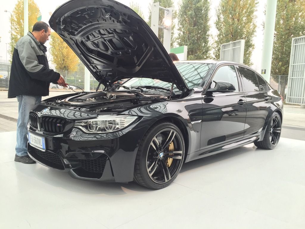

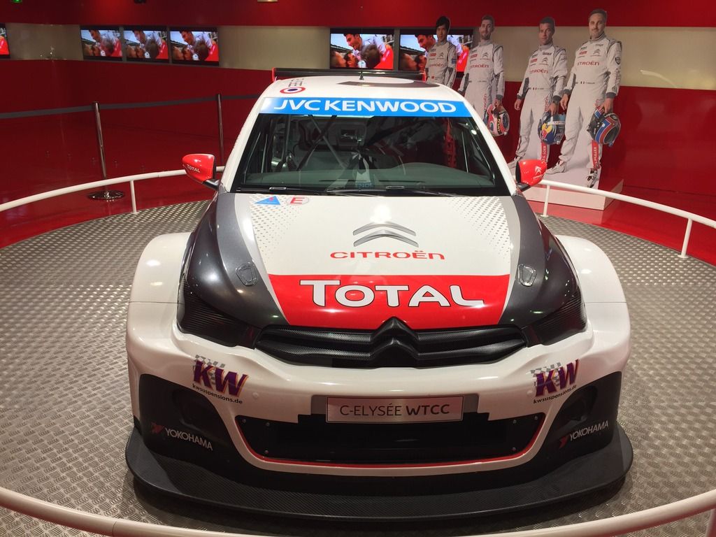

Sharing some car pics I took in Paris during my very recent trip to Italy, Belgium and France. Been there close to 2 weeks, for work and honeymoon...kesian MYR value really so small there so I use SGD most of the time there...

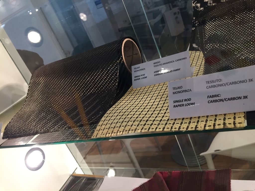

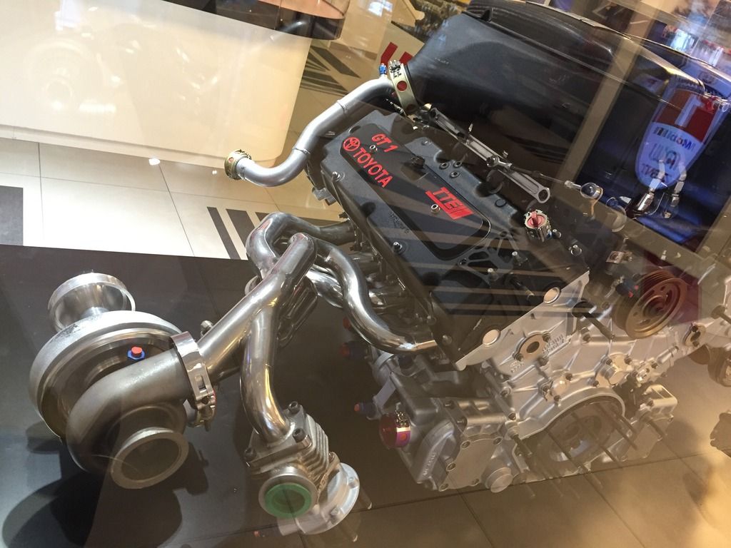

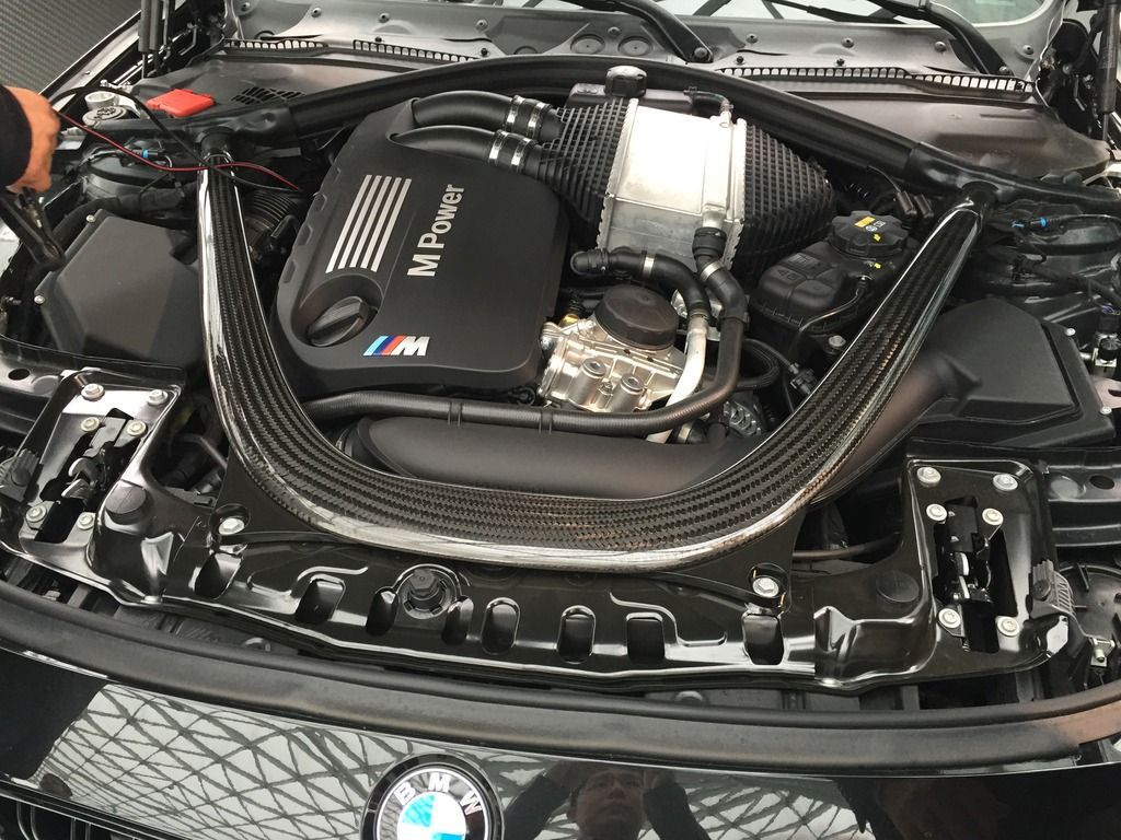

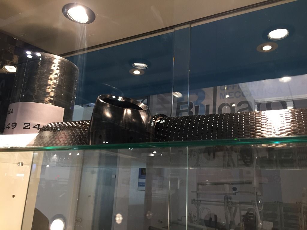

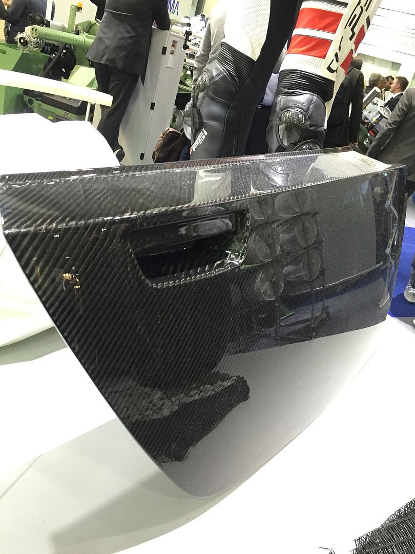

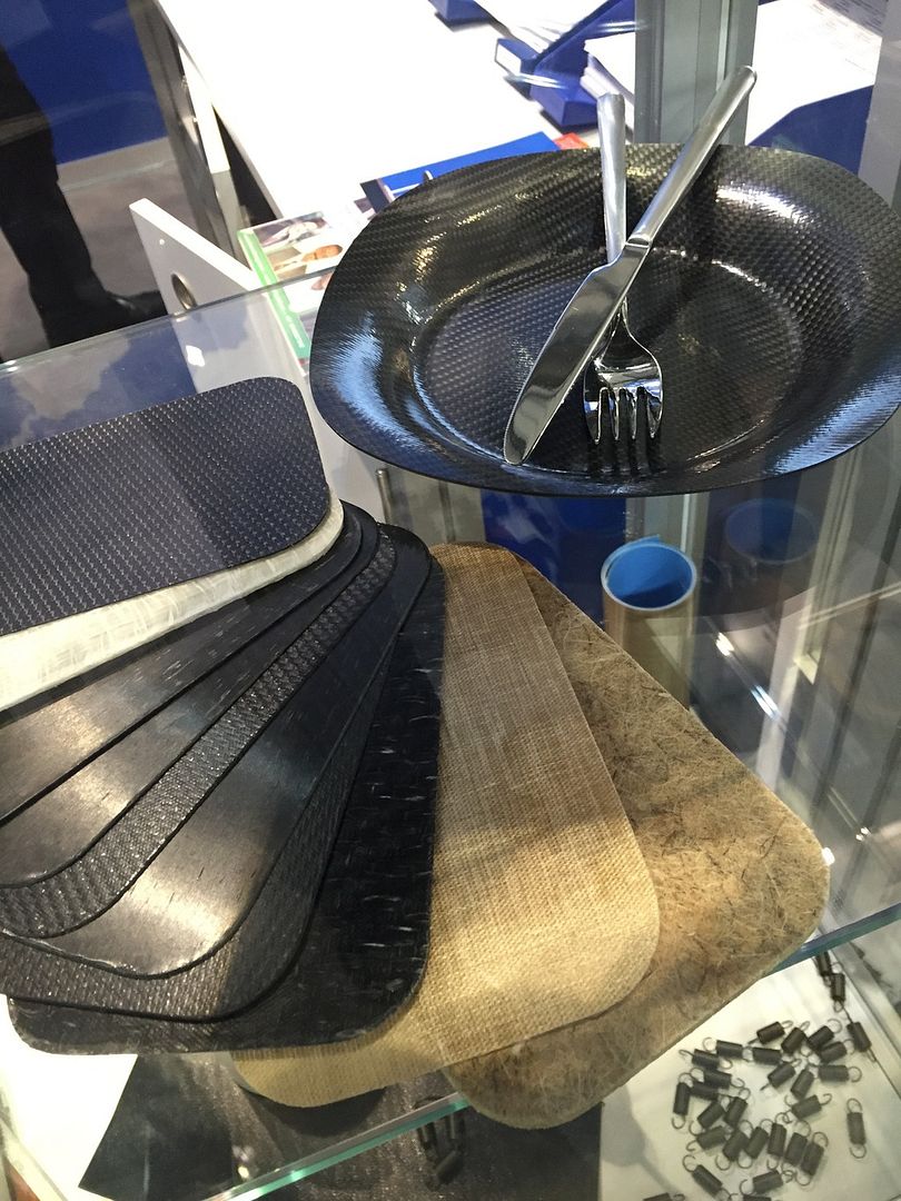

Some pictures from my business related stuff.
Yep, this is the Toyota you know making cars. They are also making weaving machines from fabrics to CF. Things like seat fabrics, airbag, Carbon Fiber..etc..
Some different grades and combinations of weaved Carbon Fiber. Which determine it's strength and weight.
Carbon Fiber itself a rigid fabric which most people didn't know before it is shape into something. It can be made into any shapes. Here's an exhaust cowl for Akaprovic exhaust.
CF plate anyone?

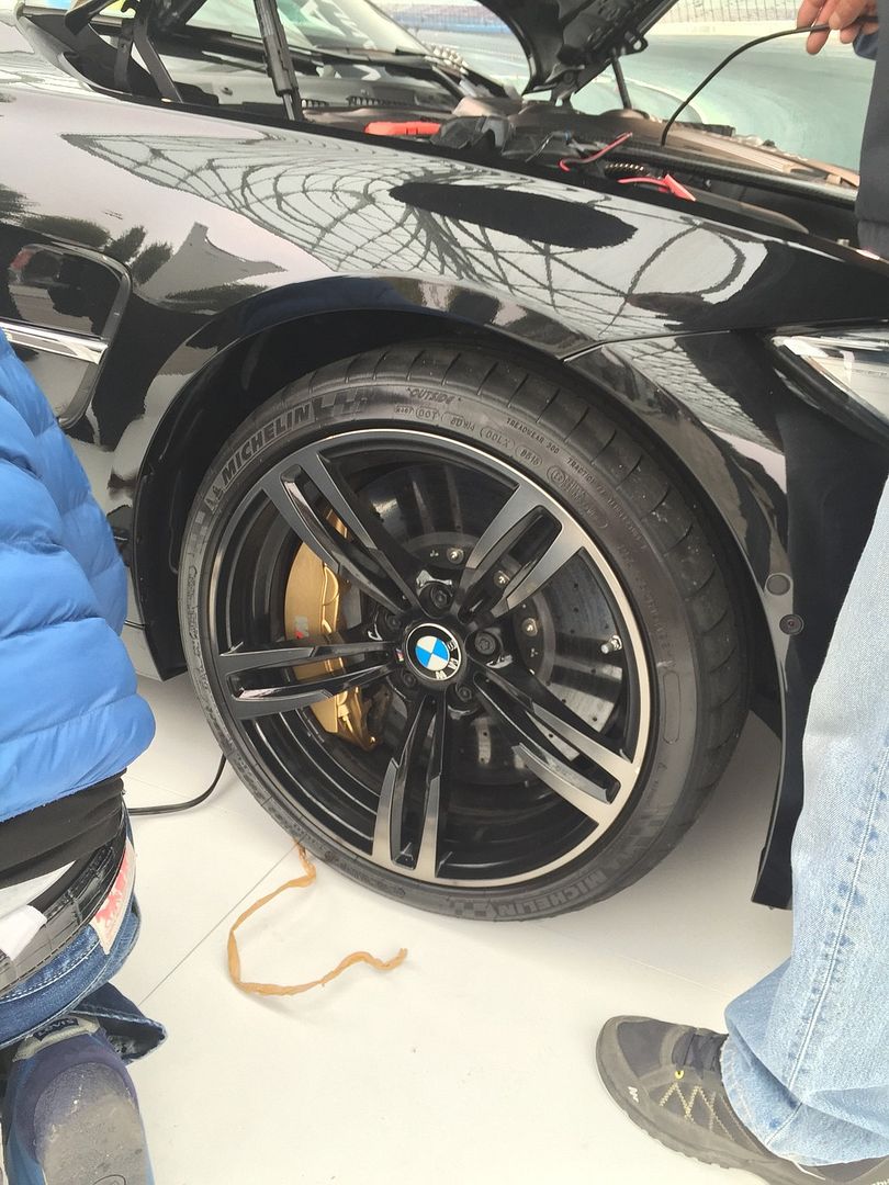

A Bimmer M3 was showcased outside the expo as they are 1 of the main exhibitor for EICMA

QUOTE(athrunzaru @ Nov 30 2015, 12:39 PM)
yes the ones under the cap. the bolt also got rust together with the nut. ill upload a picture when i get home
change to stainless steel as in change the whole absorber or just the bolt?
titanrev here
TitanRev
post Dec 1 2015, 08:48 PM
9 posts
Joined: Nov 2012
QUOTE(athrunzaru @ Dec 1 2015, 07:32 PM)
titanrev here
That's kinda more rust than I expected. Try to ask Sc for replacement under warranty. How old is UR car and u wash engine bay a lot?
This post has been edited by TitanRev: Dec 1 2015, 08:49 PM
athrunzaru
post Dec 1 2015, 09:12 PM
12 posts
Joined: Nov 2014
QUOTE(TitanRev @ Dec 1 2015, 08:48 PM)
drive thru puddles alot. maybe this is what causing the kok noise i got many times? almost 3 years, lately no, too much hassle to wash. way back then, yes laugh.gif
This post has been edited by athrunzaru: Dec 1 2015, 09:13 PM
TitanRev
post Dec 2 2015, 02:32 AM
9 posts
Joined: Nov 2012
QUOTE(athrunzaru @ Dec 1 2015, 09:12 PM)
I see your pic the absorber top screw thread also can't see already. Maybe try use WD40 remove the rust and see if still got the screw thread.
athrunzaru
post Dec 2 2015, 09:52 AM
12 posts
Joined: Nov 2014
QUOTE(TitanRev @ Dec 2 2015, 02:32 AM)
alright, will try soon. thanks

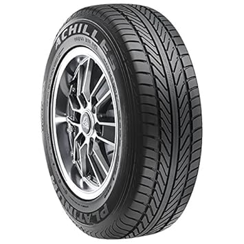

Hi guys, any recommendation for 13" tyre for saga fl?

QUOTE(wkc @ Dec 4 2015, 03:01 PM)
Currently using stock tyre. Plan to change to Yoko or Michelin.
http://www.achillesradial.com/tire/passenger/5/Platinum-7
wkc
post Dec 4 2015, 03:21 PM
190 posts
Joined: Aug 2010
QUOTE(davidke20 @ Dec 4 2015, 03:16 PM)
This tyre good? Got size in 13"?

hi guys want to ask how much does the gasket cost(roughly about)? my blm seems to have some oily surface like leak abit outside the engine(duno how to describe)~ and i heard my fren said could be gasket need to be replaced?
er i check thru google, that thing is called seal cam cover instead of gasket? or they are referring to the same thing? icon_question.gif
tq

Your car makan minyak hitam or not? If tak makan leave it je.

hey guys... being driving my saga flx for abt 3k clocks 55k km edi..
Now thinking of slightly improve my car handling and comfort.
got some ideas in my head.. hope can get u guys opinion.
Tyre: Planning to change to some low noise tyre for exp dunlop SP Sport J5 since its review is quite good and price reasonable
Rim: Plan to change to 15" but what size can improve the handling and comfort ?
Bar: Plan to install front strut and anti roll bar.. rear bar already preinstalled in my stock car
VS and Ground Cable: Going to book some chinese forumer DIY product.
Do you guys have any other things in mind to enlighten me to improve the handling and comfort of my car ?

mine changed last week. rm75 include labour at gombak. worried kne timing belt lorr...

Your current size 13 kah? Want comfort maintain stock lo. Bars, yes highly recommended. Consult mahihi if you're in KL. 3max brand. VS can consult erictioh. I'm currently using all their products.
