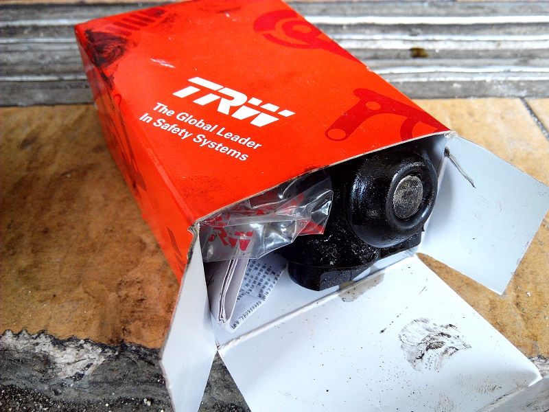

sai_is
post Sep 7 2014, 10:55 PM
16 posts
Joined: Sep 2012
update.. got my bearing replaced today & no more whining noise ..
this is the story... went to a spare parts shop and asked the tauke to bring out bearings for saga blm/fl and flx (with hub), then compared & measured the inner diameter of both bearings.. got different.. he said flx mmg lain.. confused!! malas mo panjang cerita just bought the ntn bearing for rm200 + labour charge rm31.60 & asked the mechanic to replace..
next, to solve the mysterious "tik tik" sound of my clutch pedal...
davidke20
post Sep 7 2014, 11:02 PM
3 posts
Joined: Mar 2012
QUOTE(sai_is @ Sep 7 2014, 10:55 PM)
U sure he bring the correct bering and let you measure anot? Shawie bearing different with GaGa I know lar whistling.gif Rgardless lar, ady paid apo mau ceita lagi yawn.gif
sai_is
post Sep 7 2014, 11:09 PM
16 posts
Joined: Sep 2012
QUOTE(davidke20 @ Sep 7 2014, 11:02 PM)
yes.. the box got 'saga blm/fl' written on it... another one got saga flx.. he let me measure using vernier calliper..
yup, already paid & problem pun da solved.. yang penting drive aman damai walaupun dompet makin kempis.. cry.gif
