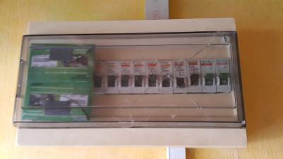

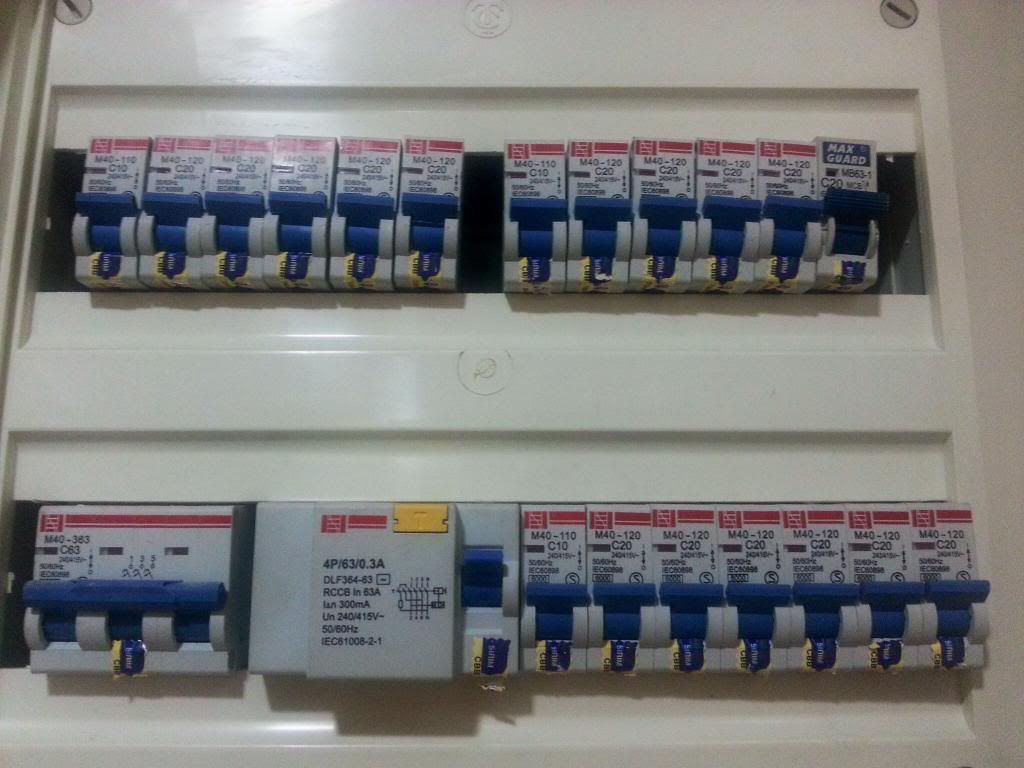

Anyone knows how to size MCB of our home?
Got B,C,D type and different Amperage. How and what to choose?
Attached Image Attached Image

QUOTE(stevie8 @ Oct 9 2013, 02:02 PM)
varies on electrical appliances, lights usually fitted with 6 ~ 10A, airconditioner and fridge to 30A ...

QUOTE(Xploit Machine @ Oct 9 2013, 02:49 PM)
Common is 6, 10, and 15.
30A make sure you have thick cables minimal 4mm.

My house MCB most of it harden already, stuck, so difficult to pull down or push up. My electrician advised me to change all even though some are still good. And he suggested all change to 32A. I have 10, 20 and 32A. I am worry about his advice to change all to 32a and if the cable/wire can take load and what is the danger of doing so.
It is time to get some advice from others like you and be sure and if I can diy or just let him do it. See picture of my DB and the 3 types of MCB.

all change to 32? what for
if the device only suppose to run 5A, and connect to a 8A breaker. anything more than 8 it will trip to protect the device
unless you expect it to shoot up to 32, no point to up the amp by so much. 100 percent still reasonable, few hundred sweat.gif

First thing you need to do is terminate your electrician....change all to 32A??? doh.gif
The big one with black handle is the Main Switch - If you ON/OFF this, it will ON/OFF whole house
The blue handle is the ELCB (Earth Leakage Circuit Breaker) - This is the protective device to protect your electrical system if there is a current leakage.
The other are MCB (Miniature Circuit Breaker) - This is the circuit breaker of each wiring circuit.
My suggestion....replace according to existing rating.....

QUOTE(stevie8 @ Oct 9 2013, 10:32 PM)
Your electrician want you to change house is it? All 32Amp, if wires are 1.5mm, use until wires burn the MCB won't trip. Usually they will put 20A for socket, and some will use 32A for a/c and heater, but 20A is good enough because 2.5mm can't supply 32A load for long period, and now a/c don't have such high spike.
Light, use back 6A or 10A.
Best check the old MCB, and do direct replace.

But the problem is few socket/power point to one MCB. So, if on all together total load could be more than 20A.
Let me check one by one and post here again.

QUOTE(weikee @ Oct 9 2013, 10:54 PM)
This is not the original, he changed it 12 yrs ago when i reno my house so direct replace also may not be correct. rclxub.gif
I will test out all how it is all connected how the MCB are shared and post the table here for your further advice. Now at night cannot test, cannot see in the dark. sad.gif
Also, that is why i am asking about the wire, how to identify the wire rating.

QUOTE(stevie8 @ Oct 9 2013, 10:58 PM)
Thanks for the replies.
1) The solution to this particular problem is to add more MCB and split some of the socket to the extra MCB.
2) As others have mentioned using 32A MCB with writing only meant for 10, 15 or 20A MCB will lead to fire when there is an overload.
3) fire you electrician and get one that gives good advice.

QUOTE(weikee @ Oct 10 2013, 07:58 AM)
Not easy to guide you identify wire type. Best go to the electric shop ask sample. Alternative, take out your power point faceplate see the wire, hope your contractor use the correct wire size.
You better get a qualified electrician - make sure he is registered with TNB before you engage. Wire-cable thickness is very important ... if the load more than wire can handle then it will overload which leads to wire becomes heated up which leads to electrical fire.
Each wall power socket should not be more than 13A which means your fuse should be 15A. And depending on how your electrician wired up your sockets previously ... some electricians do short cut ... they put multiple wall socket on one wire example one room you ask 3 sockets ... that may be shared with 1 wire 1 MCB ... thus it is no better than an extension bar ... maximum load combined is only 13A.
Kitchen appliances such fridge, washing machines, microwave, electric stove, etc. usually will require its own dedicated socket and MCB ... that would be around 20A each. This especially true if you use very old appliances. New modern appliances nowadays use a lot smaller amps - so a standard 13A can support.
You better check your appliance power draw requirements and count ... to be safe make sure total amp to 1 wall socket is no more than 13A. If you are overloading ... you have inefficient electric wiring which leads to high power loss which leads to a higher power bill.
So when it comes to electric wiring ... don't play-play ... be penny wise pound foolish.
Hope that helps.

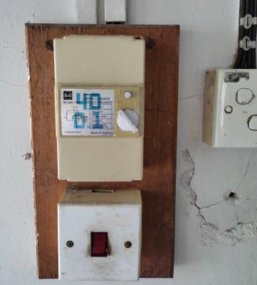

Guys,
This is the power table of my house (see attached files).
As you can see from the picture post earlier, there is no more space for MCB, how to add?

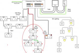

Lighting Load
6-10A (cable use 1.5mm)
Power Load
20A -30A (cable radial or ring circuit)

Thanks....but how this thing look like? What is cable radial or ring circuit?
You can't see it by visual inspection. Ring circuit is from MCB to socket/power point and back to MCB. This is good design circuit but not common practice here.

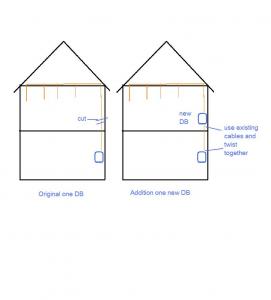

How man? The existing DB Box is full and I have so many power points and dont know how it was connected if one wire shares many points. rclxub.gif

QUOTE(stevie8 @ Oct 10 2013, 07:44 PM)
You can get electrician to add an extra sub-board, either next to the existing one or some other place in your house then run 60A or 100A cable from that sub-DB back to your main DB.
But I expect that will cost something like RM1-2k including hardware (RM700-1200).
Cheers.

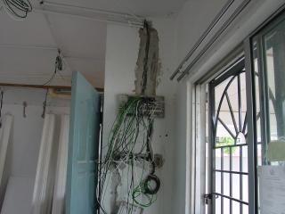

Also, the wires now terminated at the DB box and how to connect to another place without major re-wiring? Even next to it still need to connect and lengthen the wire one by one? rclxub.gif
This time i want to make sure i know what is to be done before getting electrician to do what he wants or easy cincai job.

QUOTE(Xccess @ Oct 10 2013, 08:01 PM)
Bro, please check your PM.
Thanks. Can show a picture of your DB kah? Just want to know how many MCB you have and how complicated it is.
Xccess
post Oct 10 2013, 08:11 PM
Twinkle lil Stars
2,768 posts
Joined: Feb 2012
QUOTE(stevie8 @ Oct 10 2013, 08:10 PM)
Ok wait, I try to take a photo then post it here.
Xccess
post Oct 10 2013, 08:23 PM
Twinkle lil Stars
2,768 posts
Joined: Feb 2012
Here you go.

QUOTE(stevie8 @ Oct 10 2013, 08:07 PM)
l.
Yeap, sorry to say it wont be a simple job.
If you have usstairs and downstairs then most of the wires will run from upstairs to downstairs at the same place, somewhere near the DB, most likeley just above it.
Then the easiest solution is to put a sub-BD upstairs near that common location and connect all those wires from upstairs into that DB, then run one big wire downstairs to the main DB. now your upstairs sub-DB should have several spare CB slot, and you will have freed up several CB slot in the downstairs DB. then can add in extra DB as required.
In Australia most of our internal and even most external walls are cavity walls, so its very easy to run extra wires.
Here in Malaysia the wires usually plastered into the brick wall so have to hack the wall to run new wires. If your super lucky the electrician will have placed some conduit in the birck/concrete wall and you can pull a new wire through that without hacking the wall, but from what ive seen that is very very very rare case in Malaysia.
Cheers
TSstevie8
post Oct 10 2013, 08:47 PM
1,365 posts
Joined: Jun 2009
QUOTE(Xccess @ Oct 10 2013, 08:23 PM)
Here you go.
Thanks bro.
Look like you got no 32A. Mine many of it and I think the wire cannot take load of 32A. Before it trips the wire burned first.
By the way your RCCB is 0.3A (300mA). Mine is 0.1A more sensitive.
weikee
post Oct 10 2013, 09:01 PM
10k Club
12,019 posts
Cost is not so much of a problem. The problem is under the existing box below are a row of switches sure got wire running in the wall.
Cost really depend on the aesthetic, it need to be hack and conceal again. When I renovate my house, I insist minimal looping, and identify every single point that go direct. I have 2 DB Box, one per floor, even separate the ELCB.
My ground floor
My first floor

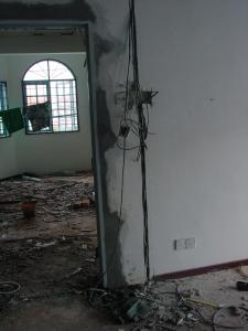

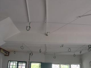

Good idea to have the sub DB upstairs. But I have to find from photos taken last time. Below pic is the massive wires at DB photo taken during reno 12 yrs ago.
This is where the wire from G floor to 1st floor and up to ceiling, i think. Got to go up to ceiling to check this week end.
As you can see no conduit in wall. Conduit only on those above plaster ceiling. So have to drill a hole thru the 1st flr slap down to plaster ceiling for the thick cable

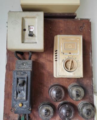

Here is the photo taken from ground floor. The wire from DB far end near door, drilled thru the beam and up to 1st floor. But only for new cable. The old cable not sure how it goes up.

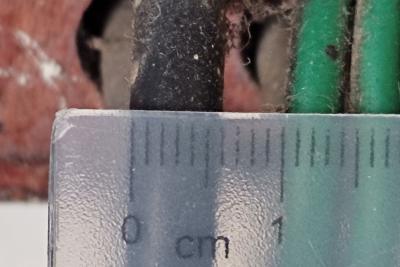

QUOTE(kickent @ Oct 10 2013, 09:10 PM)
Can't understand the table. mine showing me which are for 10A, 20A and 32A from the table?

QUOTE(stevie8 @ Oct 10 2013, 09:25 PM)
It show the cable thickness and its properties. A more layman site http://www.epanorama.net/index.php?index=calc_cable It give you very general guideline if room temperature are 20c, if you have bad quality cable or long run cable the guideline won't apply.
This post has been edited by weikee: Oct 10 2013, 09:35 PM
Sydneguy
post Oct 10 2013, 09:48 PM
383 posts
Joined: Jul 2013
Look at the Column called "NEC copper wire ampacity with 60/75/90 °C insulation (A)[7]"
NEC in USA means National Electrical Code which is the rules for wiring etc.
This Column has 3 numbers which correspond respectively to whether the wire has 60 or 75 or 90 Deg C insulation.
In that column find the maximum Amps you need to carry, and then look across to the the Wire Diameter in mm2.
BTW unless you are sure best to always assume your wire is the lowest rated insulation ie 60degC
eg Lets say you want to caryy 32A, there is no 32 A for 60degC, only 30 or 40 A, so select 40A then look across and you will see you need 8.37mm2 wire.
Now 8.37mm2 wire sounds a little bit big to me for 32 A, which I seem to recall (assuming my memory is working correctly) 32A usually needs about 4mm2. Now from the table you can see that 4.17mm2 wire can carry something between 30 and 40 A if it is 90deg C insulated (but like i said always better to oversize wires and be safe than sorry).
BTW I'm an Aerospace, Mechanical and Industrial Engineer, NOT an Electrical Engineer so take the about as friendly advice only. Best to consult an Electrical Engineer or licensed Electrician.
Cheers

Just to confirm one more question.
Diagram below refers:
In the radial circuit as circled in red. The circuit is protected by a 20a CB.
Question:
Am I right to say the amperage of the wire(denoted in red) it carries in the radial circuit is the sum of all the 10 power points? If each point consuming 1a, the total amperage of the "red" wire is 10a?
Similarly, The "green colour" wire is the sum of 7,8,9 and 10?
weikee
post Oct 11 2013, 11:14 AM
10k Club
12,019 posts
Yes, but 10 is way too much. If the circuit break for whatever reason you lost 10 points. And if got flyback say from lighting strik to one equipment you may loose all the connected equipment.

One more question comes to mind. Look like never ending...
If I get to locate the bunch of wires run up to the first floor and cut them and fix a new DB at the 1st floor, I then need to run a thick cable from the new DB to the main DB at the ground floor right?
Question:
Instead of pulling a new thick cable (live, neutral and earth), can I twist a few or all of the existing "cut" cables (become a big thick cable) that I cut (for making the new DB) which connect down to the ground floor DB, same twist them together? See drawing below:
This post has been edited by stevie8: Oct 11 2013, 12:37 PM
amberglow
post Oct 11 2013, 12:37 PM
103 posts
From: PJ
QUOTE(stevie8 @ Oct 11 2013, 10:23 AM)
Question:
Ewwww ... really bad design .. your power sockets are no better than a RM30 extension bar since they all share the same fuse. One blow all blow ... and you have a high chance of overloading unless you are consciously remembering how many devices you are putting on that circuit.
TSstevie8
post Oct 11 2013, 01:21 PM
1,365 posts
Joined: Jun 2009
QUOTE(amberglow @ Oct 11 2013, 12:37 PM)
This is not my house wiring la. This is from wikipedia just use it to illustrating and asking a question.
Sydneguy
post Oct 11 2013, 01:45 PM
383 posts
Joined: Jul 2013
QUOTE(stevie8 @ Oct 11 2013, 12:35 PM)
Question:
You could but its not really the right way to do it for a few reasons.
1) after cutting the old wires probably be to short by a few inches to go from Main DB to sub-Db. remember you want to cut the upstairs wires from sockets a bit longer so its easy to connect into Sub-DB and you are not trying to stretch wires.
2) joined parallel wires don't really have the same capacity in practice as they do in theory. Also its easy for 1 or 2 wires of a twisted set to come loose from the crew point, then youve got loose wires and reduced capacity and remaining wires are now free to come loose also.
3) It will be very hard to join those several wires into the DB and sub Db.
4) its just plain messy.
5) AFAIK its probably against the wiring rules/codes.
6) the 2-3 mtrs of big wire from sub to main will only cost less than RM50, so its not a bifg cost
the only real reason to do what you suggested is to save $ and time inconvenience on hacking and plaster back, but this is easly out voted by reasons 1-5 above.
Cheers

hmmm.... thanks, have to be super careful. I think the way to find out is to switch off the MCB how it is linked and double check.
TSstevie8
post Oct 11 2013, 03:05 PM
1,365 posts
Joined: Jun 2009
QUOTE(weikee @ Oct 11 2013, 02:57 PM)
You old house wiring come with 4mm wiring too?
Not sure, I did not take notice of the old DB before the reno if there was any 32A MCB. But during reno the electrician could have use 4 mm since he put so many 32A MCBs.
This post has been edited by stevie8: Oct 11 2013, 03:06 PM
TSstevie8
post Oct 11 2013, 03:15 PM
1,365 posts
Joined: Jun 2009
QUOTE(weikee @ Oct 11 2013, 02:21 PM)
Add on to that; How sure the existing cables not tap to other place? If it was tapped you risk sending live current to unknown place.
OK, found it. Of the 32A MCBs, the no. 4,5 and 6 are used only for 1st floor. These could be 4mm wires not shared else where with down stair.
weikee
post Oct 11 2013, 03:48 PM
10k Club
12,019 posts
QUOTE(stevie8 @ Oct 11 2013, 03:05 PM)
Don't assume, need to confirm. Put 32amp some can put 2.5mm because then amps for starting load only.
Sydneguy
post Oct 11 2013, 04:41 PM
383 posts
Joined: Jul 2013
QUOTE(stevie8 @ Oct 11 2013, 02:53 PM)
Thanks for the input. You got me, "the only real reason to do what you suggested is to save $ and time inconvenience on hacking and plaster back"
Anyway, hacking is unavoidable for the installation of sub DB where I need to hack out the cable long enough to get all of them one by one into the MCBs in the sub DB. The problem is to hack thru the slab and beam. I do not want another hole thru the beam which is at the middle of the house, it only weaken the beam.
I just need to find two 4mm wires each and twist them together which will support 60A, right? Below is the potential load up-stair:
1 x 2 1/2 hp aircond
2 x 1 hp aircond
1 x iron
5 x fans (not on when use aircond)
30 x downlight, wall light and table lamp.
1 x vacuum cleaner (not use when ironing), my wife cannot be doing 2 things at a time
Many power sockets but seldom use other than mentioned above for ironing, vacuuming, also for charging handphone, hair dryer, no water heater (I use solar heater), TV, Audio, PS2 games.
Therefore, one 4mm for 32A could be enough, but 2 x 4mm definitely more than enough. Then need to connect 2 x 4mm wire to one 8mm wire to the sub-DB.
What do you think if I use lead soldering to join the 2 4mm wire together instead of twisting them together for terminating at the sub-DB and the down stair DB? How good is the lead joint conducting electricity compare to bear copper wire?
Cheers
Once you pull all the old wires that went upstairs out there will be a big hole in the floor/beam for you to put the new thick wire through , Problem Solved. thumbup.gif
TSstevie8
post Oct 11 2013, 08:40 PM
1,365 posts
Joined: Jun 2009
QUOTE(Sydneguy @ Oct 11 2013, 04:41 PM)
1. There are floor tiles at first floor, the hole could have been sealed during tiling.
2. Plaster ceiling at ground ceiling where the cables going thru the beam except that the hole at the beam was not sealed.
3. Then on top of the main DB where the new thick cable coming down from plaster ceiling the wall is concealed with many wires from all over the house, cannot hack but to run externally with plastic casing.
3 obstacles that is why am considering using the existing cables, otherwise, I will not hesitate using one thick cable. Anyway got to consult electrician and plaster ceiling guy and tile rclxub.gif I do not think can find same pattern tile. 12 yrs already.
This post has been edited by stevie8: Oct 11 2013, 08:42 PM

Hello. I have a situation where a fuse keep kicking back. The pic of the db is attached. The one that always kicking back is the 20A one. So the question is, can I change the fuse directly or i should change the wire first to 4mm?
Current wire size is 1.5mm. I think.
B, C, D types are for the inrush current.. Domestic uses type B
Ampere rating are for current overload protection of the cable. Size the amps according to the cabl's current carrying capacity..
Scroll to the btm of the page, the link at the btm.. Read it.
Suruhanjaya Tenaga - Guidelines for Electrical Wiring in Residential Building 2008
Richard
post May 9 2016, 05:55 PM
1,083 posts
From: Kota Kinabalu
QUOTE(firdaruddin @ May 9 2016, 01:57 PM)
Is this a new installation and is it a new mcb?
If yes then its probably this circuit is overloaded causing a thermal trip.. Get a clamp ammeter and cheack the load and compare it to the mcb's rating.. If overloaded then remove part of the load to another circuit (If it's more that one load on the circuit)
If no (meaning it was working well previously) then listen carefully to this particular mcb.. If you hear small crackling sounds before tripping then replace the mcb. The mcb has pitted contacts, that means the contact area has reduced to the point where it itself causes the thermal overload.. The device is faulty..
You only replace wiring if the insulation is damaged and you test with an insulation tester (Meggar).. Hire an electrician for this.. He has the equipment and competency to use it.. You cannot use a multimeter..
Richard
post May 9 2016, 06:07 PM
1,083 posts
From: Kota Kinabalu
Here you go.
This picture shows a Three phase Distribution board (DB)..
It's protection device ia a 4 pole Residual Current device (the one with the yellow trip button)
QUOTE(stevie8 @ Oct 10 2013, 08:47 PM)
The RCD is for 3 phases that's 100mA trip per phase..
Whether yours (0.1A) more sensitive depends if you have 3 Phase supply ..
meaning is your RCCB 2P or 4P?
If 2P then i think it is not more sensitive..
firdaruddin
post May 9 2016, 10:33 PM
76 posts
Joined: Nov 2005
QUOTE(Richard @ May 9 2016, 05:55 PM)
Hi. It was an old thing. It happened whether i switch on my computer or nothing while I'm not switch anything at all. It kicked back like ikut suka dia. So my plan maybe upgrading the 20A fuse by changing it to 32A fuse. Is it possible the problem will still occur after changing the fuse directly? Also that fuse goes to one 3-pin point and then loop for two more 3 pin point outside the room for washing machine use.
fireballs
post May 9 2016, 10:36 PM
10101
5,646 posts
Joined: Mar 2012
get a new one. this time dun buy fanban multi9
fireballs
post May 9 2016, 10:38 PM
10101
5,646 posts
Joined: Mar 2012
QUOTE(firdaruddin @ May 9 2016, 10:33 PM)
the normal washing machine should be fine, as long as you dont use iron and hairdryer all at the same time.
as said, most likely its a busted mcb. just change but change to better brand.
Richard
post May 10 2016, 03:16 AM
1,083 posts
From: Kota Kinabalu
Firstly, use the correct terms for the components, it helps avoid confusion..
A fuse cannot kick back.. It is a fusible link.. It blows (meaning gets hot, melts thus disconnect) when over rated current flows through..
A miniature circuit breaker (mcb) trips (meaning there's a bimetal contact which trips a spring) when over rated current flows ..
You replace a fuse.. You reset an mcb (only replace if faulty)..
Yes, it is possible.. This is a forum and I'm just giving my opinion. You need an actual competent person to repair it.. (An electrician)
However the fuse or mcb function is to protect the wire.. It blows/trips before the wire gets hot.. A 1.5mm wire is rated at 23Amps..
A 32A fuse/mcb cannot protect a 1.5mm wire.. The wire will melt and burn anything combustible close to it..
It might burn down your house.. Pls understand your risk..
Hire an electrician if you don't know what I'm talking about.. It will save you more..
ok..
Standard domestic wiring regulation requires you use 2.5mm2 or higher size wire for sockets..
When new the metal within the wire is pure .. An older wire oxidizes and its insulation degrades.. It cannot carry rated current and heats up when over current..
Regulation states you must completely rewire after 30 years.. I rewired my house after 20 years.. It's my insurance..
Good luck..
This post has been edited by Richard: May 10 2016, 03:42 AM
firdaruddin
post May 10 2016, 02:12 PM
76 posts
Joined: Nov 2005
Another question. Is there any way for me to determine which wire go to that particular point etc.? I mean if i want to change the whole box with the fuse everything. So that i can reconnect the wire to the box correctly. 1 seperate fuse for a/c etc.
Richard
post May 10 2016, 10:05 PM
1,083 posts
From: Kota Kinabalu
QUOTE(firdaruddin @ May 10 2016, 02:12 PM)
Yes.. Switch off all your miniature circuit breakers (mcb)..
Standard wiring mcb's all type B's except motor (if nuisance tripping then use type C or D for higher inrush(start) current)
6A & 10A are lighting mcb's
16A & 20A are socket/aircon/water heater mcb's
32A are cooker/large freezer/3HP & above motor mcb's
- Switch on only one mcb
- Visually check which one has power and record on the mcb
- Switch off
- Repeat next mcb..
Seriously..? I myself am certified with ST but i get an electrician to do the work.. For me it's a matter of cost and speed.. I can talk the talk but crawl the walk if you get what I mean..
For you I think it will be an additional safety issue.. Wiring a whole house with 20-40 points is not an amateur DIY..
One point is ok.. Not whole house.. you're crazy to think you can do it..

guys help take a look.
red-C10, blue C-20 and bottom most row C-32
C-32 i use for AC, Water Heater and Oven..using 4mm wire for all C-32.
SUSceo684
post Apr 13 2023, 12:07 AM
Component Burner
11,667 posts
From: Klang/Subang
QUOTE(Ichighost @ Apr 12 2023, 11:07 AM)
where is the 10mA RCD for WH?
PowerGadget
post Apr 14 2023, 09:55 AM
821 posts
Joined: Apr 2012
Hello all the kind souls and sifu, wondering whether anybody could give me good advise accordingly? My double storey house is about 30+ years old and the db is rather due to upgrade I think.
some of the mcb is not able to push it down anymore, the lever stuck at the position ON which is rather dangerous I think. Currently, I am thinking of adding more sockets to three of my rooms. two sockets to each room and total of 6 sockets.
Then, pulling 1 socket for kitchen hood and 2 for general sockets for kitchen usage.
Wondering what are the good steps for me to do as of my situation. I wanted to buy parts myself and ask electrician to do as I worry they might cheap out the part but I am not familiar with electric stuffs.
So I really appreciate any input from any sifus. thanks a lot in advanced.

QUOTE(PowerGadget @ Apr 14 2023, 09:55 AM)
Mullti9 macam fake breakers sia. Never heard of them. Even google images don’t seem to have mullti9
Plus the RCD 63A 0.01A sensitivity from Hager can't find anything on that P/N CB2642, for the fun of it I contacted Hager to see if they ever made it. I highly suspect it is fake.
For the parts u can buy from Official Store on shopee x
For replacement of existing MCB - U just need to buy 4pcs MCB each i.e.
4x 6A
4x 20A
4x 32A
https://shopee.com.my/ABB-6kA-MCB-SH201-6A-...113.12706623208
For existing RCD [suspect fake part]
1x 2P 63A 30mA
https://shopee.com.my/ABB-RCCB-ELCB-FH202-AC-63-0.03-(30mA)-2-POLE-(2P)-i.403384113.11846935209
--The "suck hot air" hood is only 300W or so at most so not a problem to tap on existing socket "looping"
--If its the "electric cooker top u cook on" this one pull a new line from DB box and add a 20A MCB

QUOTE(ceo684 @ Apr 24 2023, 12:10 PM)
4x 6A
4x 20A
4x 32A
1x 2P 63A 30mA

QUOTE(kirlcheah @ Dec 31 2020, 11:07 PM)
When you go to the shop to buy the 10mA to 30mA RCCB, this is designed for water heater. A single jolt of up to 50mA can actually kill us when there's a leakage from the water heater. When the 10mA or 30mA trip, it's designed to check for residual current so that anything over 10mA / 30mA will trip it to save your life.
Hence why only 10mA will be used for heater in case of water heater leakage. Mind you, installing a good RCCB would not save you if your house grounding wire is not good. You must remove the grounding cable from the electrode / grounding rod and  test to get less than 10 ohm. This is dictated by ST. Less or equal to zero is the best and this is done for factories. This can be tested with a grounding meter. Please make sure to connect the cable back to grounding rod after opening it. Also, grounding cable must be at least 10mm cable or best is 16mm cable. Why this is needed to be this thick is because the grounding cable will have lower resistance and all voltage when hits your house during a lightning will travel via this cable to the grounding rod to be absorbed by earth. If you have a 1.5mm or 2.5mm or even 4mm, it will not work as good as a 10mm cable as the resistance is high thus the voltage will not use it as the main cable to travel to earth and will flow elsewhere into your house circuit.
A lot of people don't understand and says that this will trip easily is because they do not know what it's designed for. If your house grounding is good and the 10mA RCCB trips, means there's issue with the circuit and require your attention. Either there's a lightning strike or the cable been damaged by mouse etc. You have to test the cables to make sure it's good.
For house, the main RCCB should be at 100mA. Not 300mA. Those electrician who tells you your house need a 300mA, you better ask them to go and fly kite. 100mA is the maximum dictated by ST. Best is 30mA but it will always trip if there's lightning but if you have a 65kV Surge Arrestor installed, you should be alright without any RCCB trip cause the surge arrestor will absorb the voltage from the lightning. 45k is around RM500 plus. 65kV is around RM1000. Go figure. Buy only good MCB or RCCB with Sirim. There's a lot of fakes out there. EPS is low cost range. Buy Hager / Schneider. Hager is around RM8 for a MCB while Schneider is around RM 13 each. More expensive means it's more sensitive. EPS only cost RM4 dollars. I won't put my life in danger by using a MCB costing dollars....
the electrician who came install EPS. how bad is this brand? hmm.gif i check shopee reviews not much bad reviews or not expert reviews anyway to say why downvoted.
