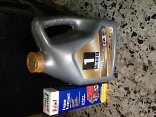

Q4: What engine oil should I take? Mineral? Semi synthetic? Synthetic? Minyak masak cap petai?
Please do no use minyak masak cap petai although minyak masak cap pisau has some nutty aroma. They could be useful if you wish to fry an egg or a fish during traffic jam to cure your hunger but your engine will not receive any sufficient protection after 100 yards you poured the oil in.
Normally, it is recommended to take semi-synthetic since it offers benefits of fully synthetic at a fraction of a price. If fully synthetic price isn't an issue for you, you may go ahead and opt for it.
Q5: Can I take fully synthetic during the first three service (1,000 km, 5,000 km & 10,000 km)?
Although you can opt for fully synthetic for the three initial service, it is recommended to stick with semi-synthetic for the first two service (1,000 km & 5,000km). Reason is, both intervals are relatively short and therefore it is wasted if one opt to pour in fully synthetic. From 10,000km onwards, you may opt to pour in fully synthetic if your budget permits.

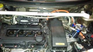

davidke20
post Jun 7 2013, 12:22 AM
3 posts
Joined: Mar 2012
QUOTE(r3apers @ Jun 6 2013, 11:38 PM)
Hmmm, weird eh. Maybe do extra gc. Lol
Before
After
Before
After
Walao so many ular purple ~

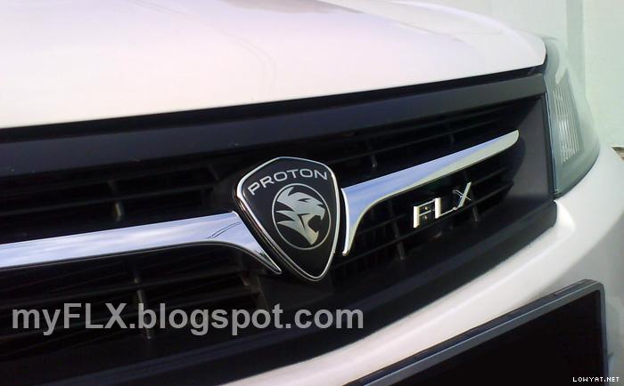

dares
post Jun 7 2013, 01:31 AM
834 posts
Joined: Jul 2011

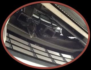

Was sharing how I did the FLX badge for the front grille with a forumer via PM. For anyone who's interest.
Tools needed:
3 small L-brackets
FLX badge bought from Proton RM18
double sided tape or screws
black paint or black stickers.
Time needed: 15 minutes (In fact, I went to Mr.DIY Kuchai Lama, parked in front, went inside to buy the brackets, walked out to my car and finished the job right there and then)

QUOTE(davidke20 @ Jun 7 2013, 12:22 AM)
Before
After
changed GCs routing? changed -ve terminal?

davidke20
post Jun 7 2013, 07:12 AM
3 posts
Joined: Mar 2012
QUOTE(jsnkok @ Jun 7 2013, 06:28 AM)
Before
After
I know ur engine bay veli clean. Mune dirty and banyak cacing. =="

QUOTE(dares @ Jun 7 2013, 01:31 AM)
Tools needed:
3 small L-brackets
drfeelgood
post Jun 7 2013, 07:43 PM
3,735 posts

dares
post Jun 7 2013, 07:46 PM
834 posts
Joined: Jul 2011
QUOTE(drfeelgood @ Jun 7 2013, 07:28 PM)
ChancellorBean
post Jun 7 2013, 07:50 PM
144 posts
Joined: Nov 2012
QUOTE(dares @ Jun 7 2013, 07:46 PM)
fuuh! very very nice!
just double sided tape? if i drive at 175km/h scared fly off, ha ha ha
dares
post Jun 7 2013, 08:21 PM
834 posts
Joined: Jul 2011
QUOTE(drfeelgood @ Jun 7 2013, 08:12 PM)
Yep. Just a layer of 2-sided tapes between the brackets and the horizontal members, then a strip of black single-side tape running across the top of the bracket securing it to the horizontal member. Just make sure the tape is wrapped as tight as possible without any possibility of water running in between the tapes and the surfaces.
Washed car countless times and it still sticks, it also helps that the brackets and the badge is quite lightweight.
If worried it fly off at highspeed, just add some gam gajah in between brows.gif

QUOTE(dares @ Jun 7 2013, 08:01 PM)

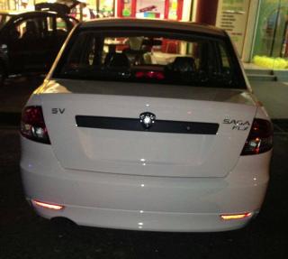

eh? you mean the tebu badge?

QUOTE(dares @ Jun 7 2013, 08:21 PM)
ha ha ha... ya, I know what you mean....
maybe some araldite will solve it. Gam gajah too many imitation... rclxub.gif

QUOTE(ChancellorBean @ Jun 7 2013, 08:49 PM)
the FLX word can get from any proton service center?
No guarantees. I have to go all the way to Proton Parts Center at Glenmarie to get it.
You can call up the nearest stockists or SCs and ask first.

If too lazy, just buy one of these grille badge from Mr.DIY
drfeelgood
post Jun 7 2013, 09:01 PM
3,735 posts
Joined: Nov 2012
QUOTE(dares @ Jun 7 2013, 08:56 PM)
oh no... you will "memperAHBENGkan" you car with those things......

QUOTE(drfeelgood @ Jun 7 2013, 09:01 PM)
No la, I mean rip out the "RS" wordings (grey and red), then stick the FLX badge on top.
Basically you are buying that ahbeng accessory for it's mounting only nod.gif But of course that ahbeng badge costs RM12 where as the L-brackets costs RM 1.80 laugh.gif
This post has been edited by dares: Jun 7 2013, 09:10 PM
Juz got these 2day from Tesco SP...
Stopped over on my way back fr Pg lo...
