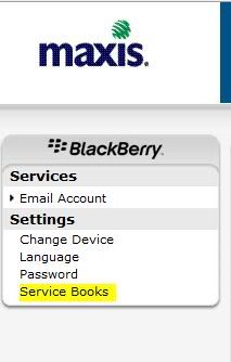

post Sep 4 2009, 11:39 AM
93 posts
Joined: Feb 2009
help me!! i've just upgraded the software for my storm, but now it could not connect to facebook.. it says 'a connection cannot be established to the facebook server'
how??

QUOTE(bettysr20 @ Sep 4 2009, 11:39 AM)
how??
resend your service books and see if it helps

bettysr20
post Sep 4 2009, 04:25 PM
93 posts
Joined: Feb 2009
QUOTE(jamezco @ Sep 4 2009, 04:07 PM)
jamezco

bettysr20
post Sep 8 2009, 08:40 AM
93 posts
Joined: Feb 2009
i'm using celcom.... how do i send this service book to my BB?

guys i need help here, Ever since i turn off my bis service. When I on it back, I no longer can find the " Internet browser

chialatz
post Nov 11 2009, 11:43 AM
198 posts
Joined: May 2009
check if u have the service book. eg MyMaxis MMS
