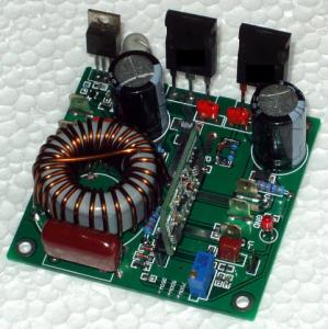

DIY T-Amp user/diyer come here :), TA2024 complete build board diy
TSxtorm
post Aug 11 2008, 12:08 PM, updated 18y ago
^O....OO.....ooo^
3,160 posts
From: KLANG!

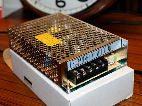

**very important that you guys dont mess up +VE and -VE terminal on the power supply, it will burn the chip!**
check out post no 3 for modding details, and pdf file to be donwloaded
t-amp? what izit?
its a type of amp produce by tripath, basically a much refine class-d amp.
there is ta2020, ta2024, ta2022, the 1 i brought in is ta2024, bang per buck you cant beat it smile.gif
some good reading abt the ta2024

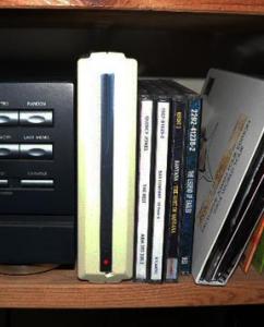

sonic impact T-amp which make this chip really famous!

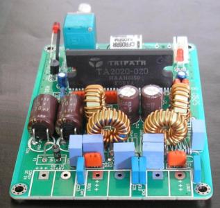

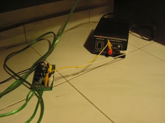

since most of you guys that ordered will be getitng thier parts by today, let me start off with some of my built 1st tongue.gif
doing it very slowy as this is my 1st built, altho simple but not femiliar with it.
i got 2 boards with me, 1 i will mod as i build the other completely stock nod.gif wana compare the difference, altho im planing to run active setup with 4 channel.

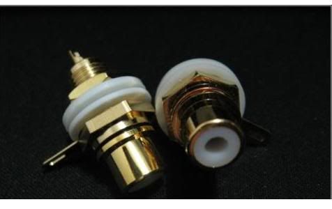

rca female x 2 (1 black 1 red)

RCA female
the middle pin will be the signal, side pin for ground.
so which is which?
middle pin is ground
right pin is the right pair
left pin is the left pair
left and right channel will share the same ground

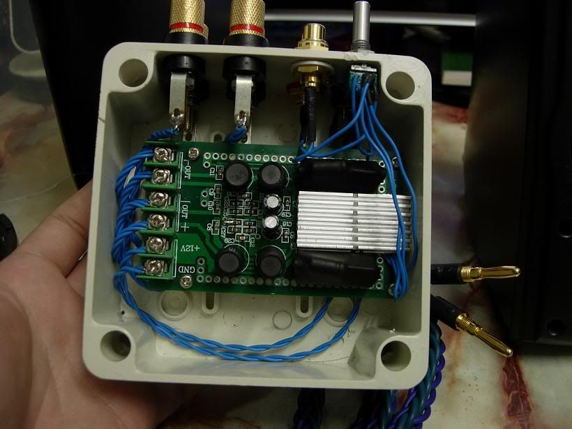

from RCA female to board input im using rs 485 data cable,
i gounded the shiled (connect it directly to 12v -ve)
the rs 485 cable

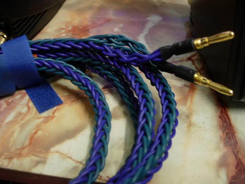

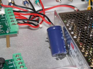

other then that it is cat6 for all the power supply wiring, and cat5e braided for speaker terminal, wanted cat6 but i dont have much sad.gif as you can see i remove all the terminal and solder directly.
capacitor power supply are cheapo jalan pasar stuff, 2x 10000uf and farnell 3 x 3,300uf.

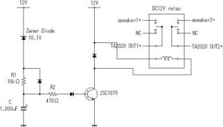

in the middle you can see a 40amp relay use in car. i believe those transfer voltage better then the switch alone.
Attached bellow is the evaluation board by tripath, our board follows tht design minus the input coil, most ta2024 amp follow this design

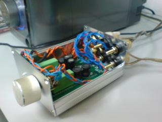

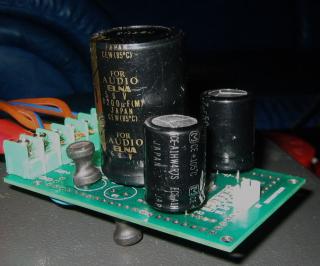

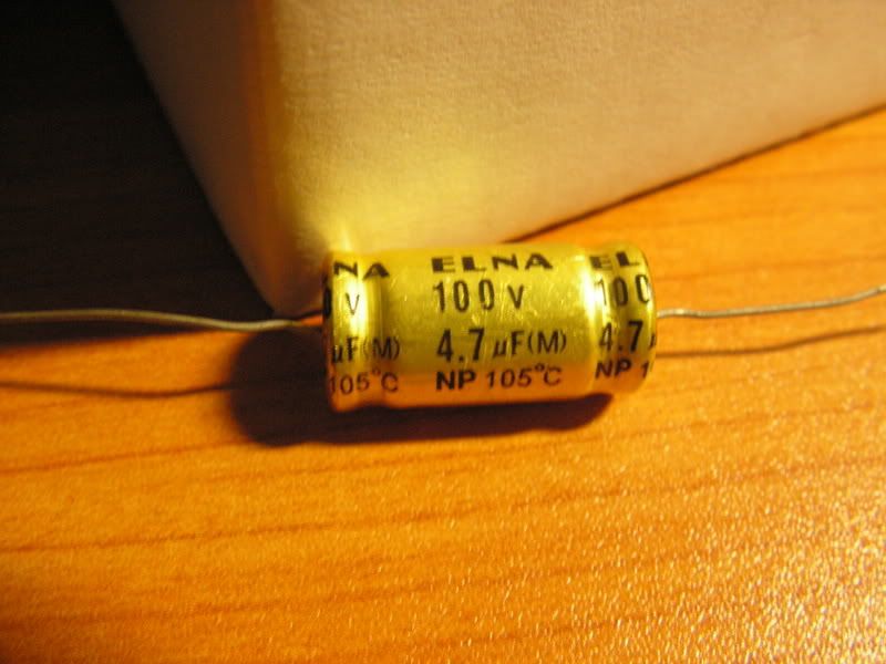

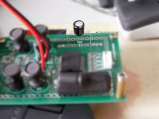

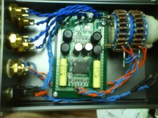

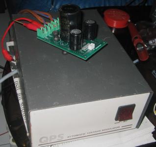

i have complete building mine with input voltage cap, seems like the unit is working hotter then before...hm...
1 of the board is modded with M-Cap 2.2uf input cap, elna for audio 1000uf on the power supply rail to the chip, the sound is quieter and not as ear piercing compare to stock unit. it sounded softer tho, should be bcos it is much quieter now. im running my mids free air, btw, the tweeter frequency seem like its been pull down. too tired to set it up in my car edi, only gona do it tomorrow, i got a bad headache today and took MC, ended up doing the amp tongue.gif
how should i measure the inductor impedance? just by using the multimeter? im measuring 1.3-1.5ohm for those inductor, will a lower impedance inductor improve the sound? it should right? found some nice 0.07ohm unit in farnell but ferite core tho...no air core to be found sad.gif
more listening, hmm some ape file sounded really nice while others crap, this amp really do relly alot on the source, garbage in garbage out smile.gif

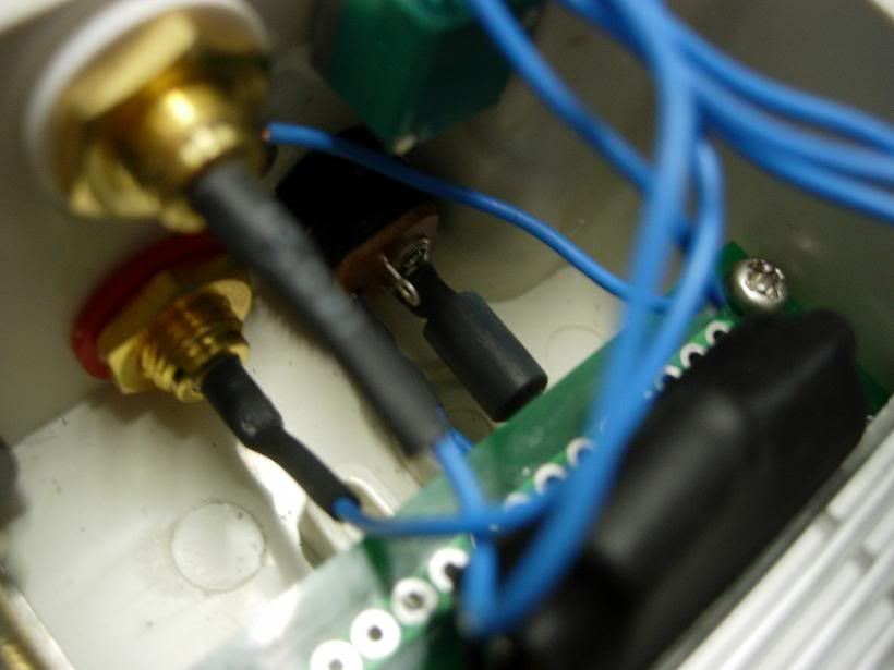

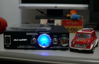

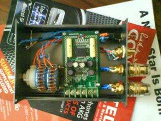

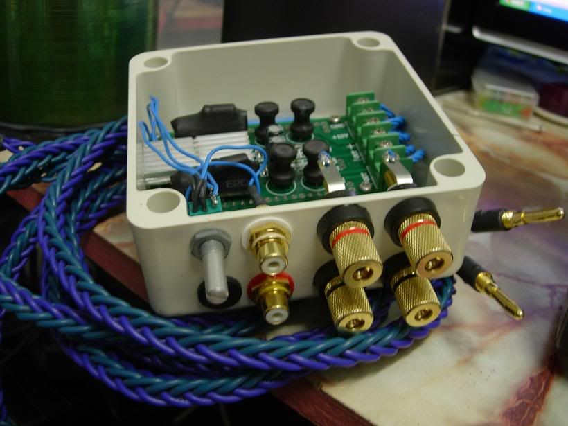

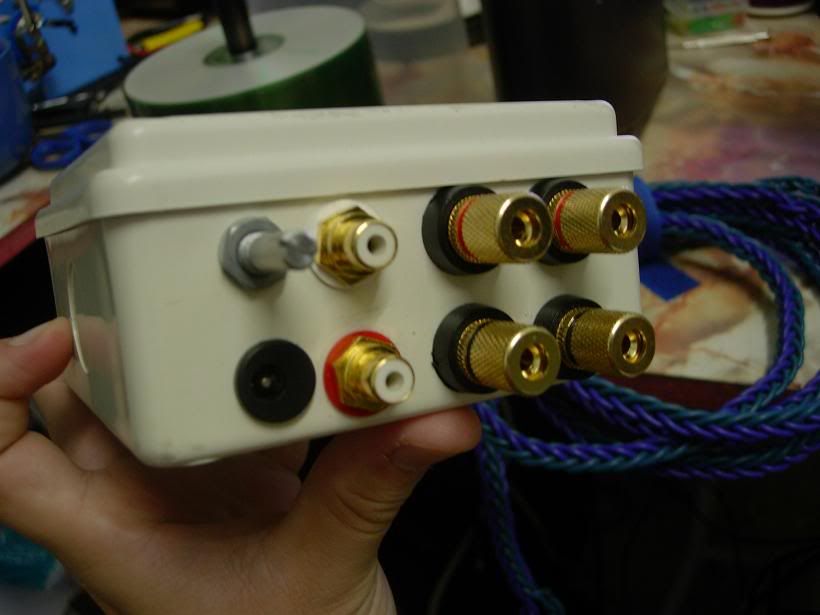

back of my amp
internal
left with tank cap and input cap modded, right stock.
initially i tot the box is so damn big, luckily im wrong, lots fo space for me to play with.
sorry abt the quality of the image, camera phone arent good with indoor lighting
This post has been edited by xtorm: Aug 16 2008, 08:19 PM

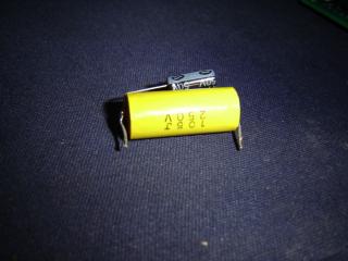

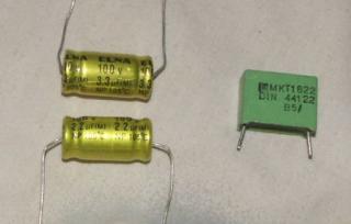

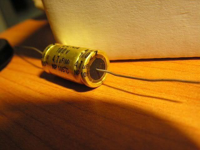

-the easiest modding and makes the most difference will be the input capacitors, those thing covered in black
get the best capacitor you can afford here, higher value will enhance the bass and roll off the highs, 2.2uf and 3.3uf are recomended here, non polarize.

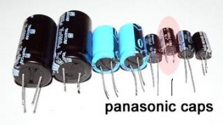

-change the supply capacitor, those 2 small caps in the middle just beside ta2024 chip, higher value will enhance the charity and bass, low esr caps are recomended here, panasonic FM seems to fit this job well, 3300uf 16v will be enough, change both of them ofcause...

I had the opportunity to compare my own T-amp against my colleague’s T-amp last night when we were troubleshooting some buzzing sound together.
As mentioned previously, I have changed the 4 stocked caps of my T-amp to Vishay/ERO MKT 1813 2.2uF 63V polycarbonates and Panasonic 1000uF 16V electrolytics whereas my colleague has only changed the input caps to the same Vishay/ERO MKT 1813 caps. My T-amp is with a 24-steps 50K ohm Dale resistors attenuator whereas his an Alpha 50K ohm carbon potentiometer. PSU used is a 12VDC 2.5A SMPS, source a Sansui CD-X310 and transducers Q Acoustics 1010.
I would report the difference in sound of our T-amps described above as very substantial and prefer the unit with Panasonic low ESR PSU caps. The overall tonal balance and scale of music is both more balanced and larger. The low frequencies have more weight and this adds to the foundation of music making. I would not describe sound as dry-sounding but contrary to this, we thought both T-amps sounded moist enough but we arrived at the conclusion that the stocked PSU caps must be replaced so as to attain a more balanced tonal back and a weighty foundation to low frequencies. There is no pop/thud sound to both our T-amps.

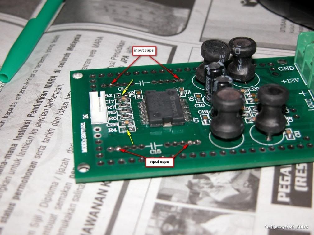

ADVANCE

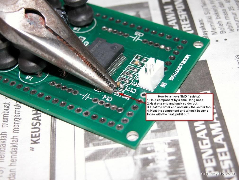

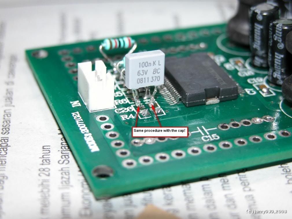

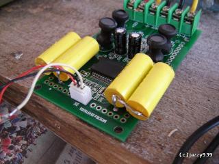

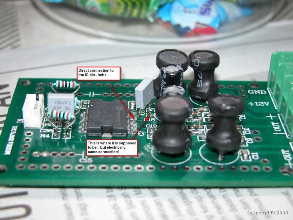

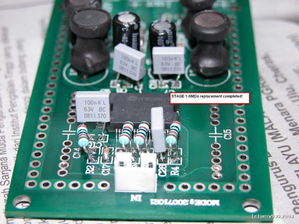

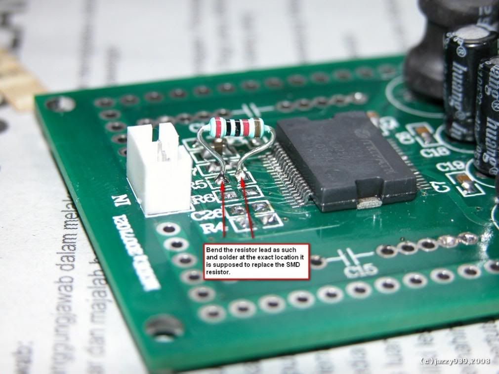

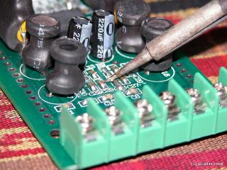

indetifying the component for input stage (image credit to jazzy939)
from here please refer post 1214 by jazzy939 for pictures, i cant seem to save the pics he posted
http://forum.lowyat.net/index.php?showtopi...post&p=19884882 <--direct link
-input resistor and gain resistor, smd component are never known for sounding good, the input resistor on the board are probably 5% tolerance, i measure 19.6xk to 19.8xk on them, changing to 1% metal film or better will improve the sound, espcially imaging.
-as you can see some biascap and others being change as well in the picture, not sure how much they effect the sound, jazzy939 did this mod in 1 shot and are quite surprise by it

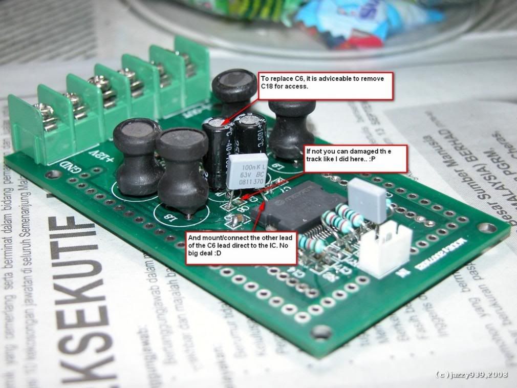

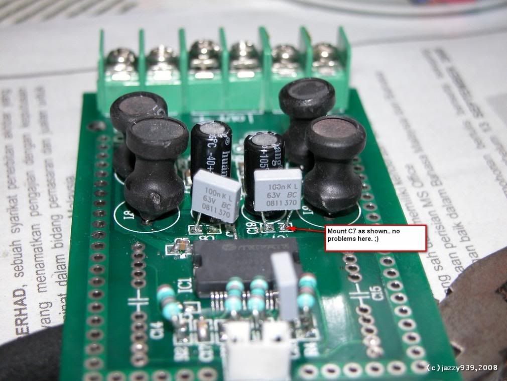

-bypass cap for power supply, just beside the power supply cap, c6 and c7. good power supply make a noticeably difference in t-amp
-soldering copper wire directly from 12v terminal to chip, again, a good power supply is important in any amp, since the original root is quite thin in size, soldering 2 copper wire to the ta2024 pin will let the chip have plenty of power to work with, espcially with bigger panasonic FM in. sorry for the lousy pic, it is solder to pin 25,26,29 and 30
-output filter capacitors, c22, c25, c27, c28 (sorry no pictures yet), some say these are as good as changing the input caps, polyester 5% or better are recomended here.

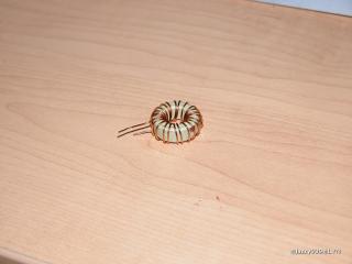

-output filter coil, those 4 black thing, ferite coil gives dynamic and vivid signature to the t-amp, while aircore gives smooth and relax feels to it, up to the listener. other then that shielding the coil will make the amp sounding clean, haven try it tho, but good feedback from those who has done it.

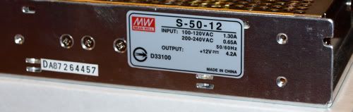

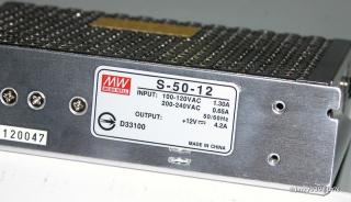

Anyway, an ample (huge?) PSU is very essential for lifting the T-amp (or any chip amplifier for that matter) to great potential. A 100kohm Alps blue log volume pot will do justice here too. Don't skimp too much if your expectations are high. Good luck!. icon_rolleyes.gif

btw for those who like open and lively sound mayb should lower value input cap, just a theory tho, mayb ill try it with the other amp smile.gif
my god that volume pot is nice! TA2022, other then bass some say there is not much different? how true is tht since you have both.

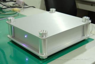

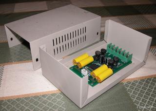

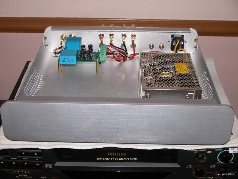

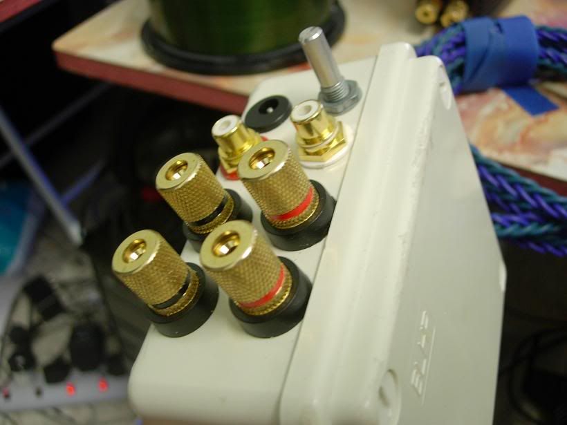

My package was delivered yesterday but won't be doing anywork on it till this weekend ler.. Need to go to JP to get the 'stuffs'! tongue.gif

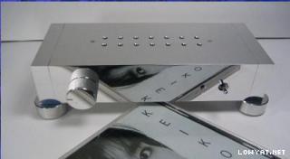

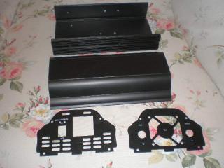

I'll post the pre-work done pix first.. I have set my mind on this cute 'lil casing... laugh.gif

Walau bro xtorm, u senyap-senyap then open a thread in Audiophile tongue.gif
Me still playing around with the T-amp, sound just great especially for its affordable price drool.gif
bro xtorm, i think the volume control can't works on this amp as it only got single pot, you need double for stereo right?

for those don't have casing, try find some kaput car amp casing, it will fit in nicely and look pro!
Just an Idea....
In this bolehland we do not have access locally to good casings..
we're limited to whatever that are being offered in the shops(JP), pricey, limited and pathetic designs. mad.gif
If you can afford it, can be custom made but, definitely 'costly'.
Only you can justify the extra cost over a chip/'cheap' amp. tongue.gif

Guys,
The computer switching power supply typically have a +12V DC rated anything from 12A to 16A! I think this would be a great power supply to the T-Amp, no? I have read somewhere switching power supply works well with the T-Amp.
I think the casing is big enough to house the T-Amp entirely! Of course, a separate housing for the amp is another option.

QUOTE(jazzy939 @ Aug 13 2008, 05:49 PM)
Guys,
Should be able to use the PC PSU, just worry if the board put inside, will it affect the SQ due to high switching frequency?
I am using external 12V 4A switching PS to drive my floor standing speakers, no noise/humming sound tongue.gif
This post has been edited by ongbs: Aug 14 2008, 07:31 AM
Guys,
get those with active pfc, put in a variable resistor to tune the voltage to 13v!! biggrin.gif
ongbs, you very shioklah....me wan listen to proper setup also canotler, can only listen in car which is noisy like hell, goto put back my firewall sound insulation edi, also my floor carpet biggrin.gif

I got a few higher uF caps now and gonna mod it soon, Nippon 16V 3300uF, ELNA 56V Audio cap 8200uF brows.gif
Wanna try out Panasonic audio NP cap but it is 4.7uF...
must be damn big cos mine 50v 1000uf edi damn big

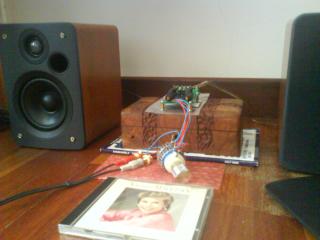

xtorm, your packing was excellent, thanx! Items arrived undamaged. rclxms.gif
I have a 0-30VDC 3A bench power supply so powering the T-Amp is a cinch wink.gif
Managed to listen for about 2 hours last nite!
Source was a SONY DVD Player connected to a YAMAHA pre-amp. Speakers are TDL's RTL3 Transmission Line speakers.
My speakers are rated 90dB at 1m for 1 watt.
This is my 2 hours of listening impression:
1. Upper frequencies from midrange and up; very accurate, vivid and detailed. I could picked up instruments so vividly. Vocals is the area where this T-Amp really shines, infact they are superb! I took out Diana Krall CD. She was singing and playing the piano right infront of me! biggrin.gif In fact it made my reference amp sounds a bit 'smeared' in this department.
2. Low frequencies are all there: tight, but somewhat shy although well controlled. Probably due needing further burn in, the lower extension just wasn't there. Kick drums wasn't kicking enough, bass were generally without any 'weight'and 'attack'..I am a bass head and my speakers are definite bass heavy. I guess in a 'normal' setup, the T-amp may sound a 'lil bit bright.
3. Soundstage, depth and ambience were all there, solid and precise. All this from a 'RM55'? rolleyes.gif
4. I managed to add a 10uF cap to the existing input cap.. this somewhat improved the low end extension, need further listening and burn in! whistling.gif
5. I tested it and it handled from 21.5 Hz to 16kHz pretty well, just like my Technics! I did tried 20kHz, too bad, I just can't hear that high! blush.gif
Initial conclusions:
1. For RM55 amp, this thing is hard to beat! This would be THE best Bang per Buck amp! Will give amps costings 100X over a run for the money!. I was comparing the T-Amp with my audiophile's Technics amplifier and a 40 W/ch DIY amp.
2. In it's stock configuration, very suitable for vocals and orchestral music, live recordings too! wow!

yes, the input caps does affect the sound. I did 'play' around with it last night. More experimentation to come! wink.gif
you reckon 6600uF will do the trick? I may have to consider that too. I'll wait for your further input on this!
the output filter, what is your direction? I have in hand a few ferrite rings that was meant for some other project but was put on hold, I guess it's the time now to utilised it! tongue.gif
What values of inductance (uH) are we dealing with? I could make one, well two in this case for one board! Just furnish me with the values, ya? Refer attached pic if that is what you/we can use?
anyway, keep us posted with your mods ya? pics if possible.. I will too as soon as I am done playing around with the input caps and output filters.
I have to decide whether to use a linear PSU or switched mode. I also have a DIN55 battery at home. May use that to see any worthwhile sonic improvement running on a car battery! rolleyes.gif

Wait till you guys see the casing that I am saving for the completed integrated T-Amp... whistling.gif

yea more is beter for power rail, those 220uf is recomended to change to better unit same value, and leave the 6600uf away nvrmind cos its kinda big smile.gif
the inductors are 10uh, low resistance and low capacitance will be great, eh you need 4ler tongue.gif for each board
smps sounded the best from what i see online
If thats the case, will give smps a shot. i have a few computer's psu laying around.. wink.gif 12V at 16A may do wonders!
BTW, I was running the PSU at 12.6VDC last nite. The TA2024 chip is just warm to the touch. I am impressed! rclxms.gif

I'll make the coils first and see how it performs, then I make some to you guys. Noproblemo! biggrin.gif

bro, please wind another 4 coils for me can? Like for xstorm bro one, he really recom me to replace the coils...pm me the cost, thx!  biggrin.gif

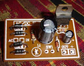

After much reading I have decided to go with a DC power supply using SLA or in my case, a DIN55 battery.
Have not done any sonic evaluation on this but I believe, the performance will be many times over a linear PSU. This is to the fact that there will be more than ample current from the battery to cater for transients requirement. No doubt, a linear PSU is able to do this but at a higher cost(better high quality circuits).
On top of that, it will be the cheapest way to power up the T-Amp... tongue.gif

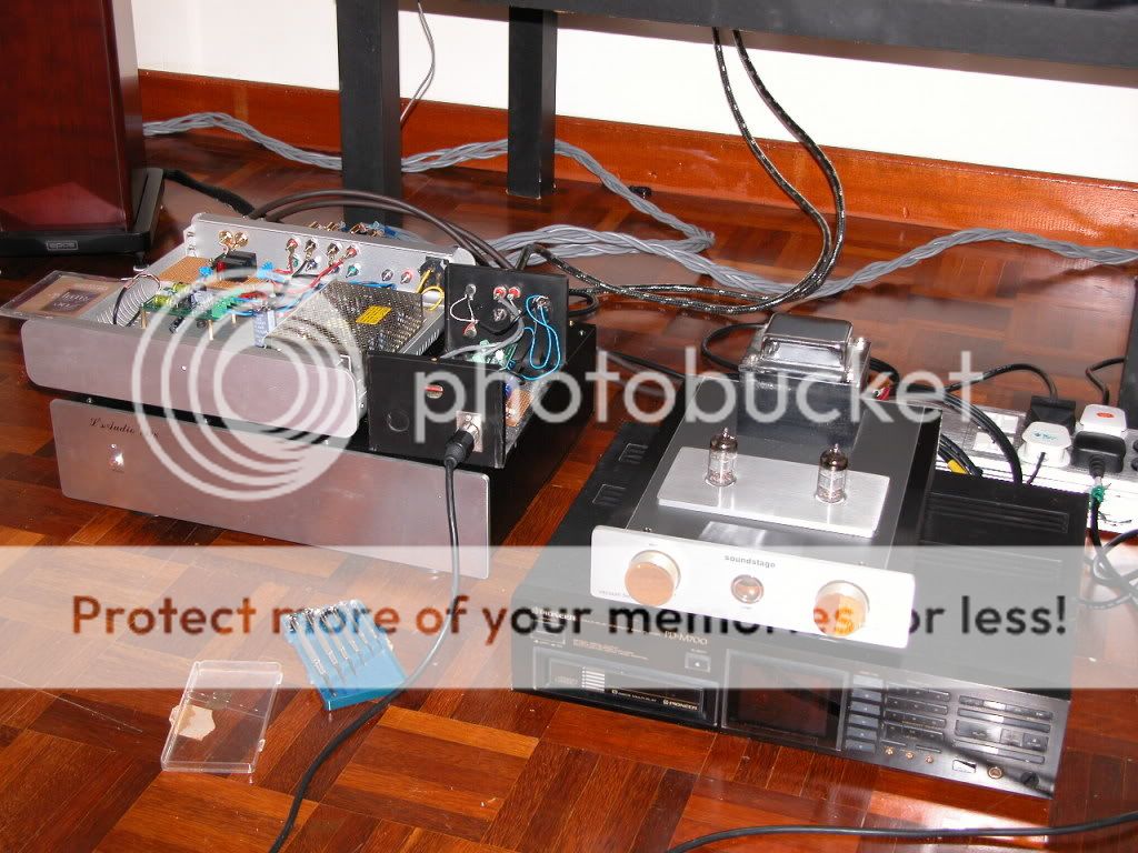

BTW below is my T-amp in current testing configuration. Waiting for more inspiration from you folks rclxms.gif rclxms.gif ...probably it'll go into a defunct but solid AKAI amp chassis for proper shielding, rip off the useless front facade/control panel, and voila, I guess it's something I can live with the next 10 years.
This post has been edited by March05: Aug 16 2008, 09:31 AM
jazzy939
post Aug 16 2008, 10:30 AM
reel is real
8,186 posts
Joined: May 2005
From: Beaumont, Baile Ath Cliath, EIRE.
Hey whats stopping you ler? Chassis/casing sudah ada...
But then again, looking at what you have.. I can live with that for quite awhile... long while even! brows.gif
Hopefully mine can last that long also.. unless something (better and cheaper) comes up! biggrin.gif
QUOTE(March05 @ Aug 16 2008, 09:30 AM)
It's the KISS principle, bro jazzy.
This post has been edited by jazzy939: Aug 16 2008, 10:31 AM
ermmm, what is KISS tongue.gif damn those trans are sexy, ta2024? i think its a 2022 right?

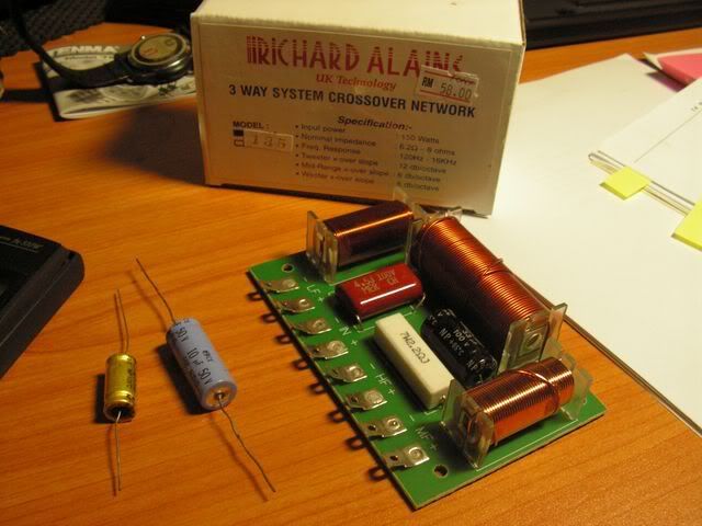

First pix here, showing the T-Amp on top of two 'massive' 10uF caps.. still process of burning in.

post Aug 16 2008, 01:15 PM
^O....OO.....ooo^
3,160 posts
From: KLANG!
QUOTE(jazzy939 @ Aug 16 2008, 12:30 PM)
xtorm,
Its' Keep It Simple, Stupid tongue.gif or
Keep It Short (&) Sweet or
wow...
you should take out those original caps, 10uf is kinda too much tho tongue.gif
jazzy939
post Aug 16 2008, 01:21 PM
reel is real
8,186 posts
Joined: May 2005
Let's see, the onboard caps (2 in parallel,) I measured to be 2uF plus my 10uF, total caps is now 12uF. Too much? ohmy.gif
As the burn in process is progressing.. it gets closer and closer to my preference sound...
Will removed the the existing caps after I am satisfied that the burn in process no longer make any improvements.. wink.gif See if there would be any/much difference..
This post has been edited by jazzy939: Aug 16 2008, 01:30 PM

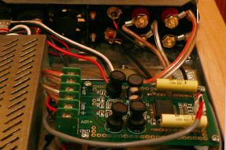

Further update:
I took xtorm advice and remove stock caps from the 'virgin' second T-Amp board...
Bear in mind, this second board has 0(zero hours) burn in..
My jaw kinda dropped! Now the low end frequencies are somewhat 'heavier' and almost full bodied.. it definitely sounds better than my first T-Amp that has clocked 11 hours of burn in... Is this the same T-Amp?
I think the problem is the polarised 1uF input caps that came with the T-Amp.
I will remove the polarised caps only on the 1st. T-Amp and re-connect the two big yellow unpolarised caps in parallel, we'll see whats gonna happen next... rolleyes.gif
Here's the moded second T-Amp:
This post has been edited by jazzy939: Aug 16 2008, 03:05 PM

walau bro, what is the brand/type of your little "cute" 10uF NP caps? sweat.gif
This post has been edited by ongbs: Aug 16 2008, 04:12 PM
jazzy939
post Aug 16 2008, 04:26 PM
reel is real
8,186 posts
Joined: May 2005
It's EPCOS. Taken from my Yulong's PCM58 DAC board. That board no longer have any input caps wink.gif

jazzy, all I could add after seeing the picture of your 2nd T-amp with gigantic caps is that I'm really excited and awaiting eagerly for my own T-amp to arrive.

Your patience will be worthwhile! tongue.gif The blue 'gigantic' EPCOS cap was recommended by my son as he says, that cap received rave reviews about it's sonic performance, and I concur!! thumbup.gif
Using premium parts will be worthwhile here as we're trying not to reduce a 'super duper' amp performance. laugh.gif
I'd say if you can afford it, BUY IT. Don't regret not buying it later.. wink.gif
I am running my PSU at 12.5 VDC max.. I did try 13VDC, there's a touch of graininess.. just. shakehead.gif 12VDC would be the absolute minimum!

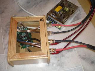

hi jazzy939 the EX5 battery got Red and black which one to connect to +12v and which one to connect to ground?
Red to 12V+ and black to GND, make sure your battery is fully charged tongue.gif
jazzy939
post Aug 16 2008, 06:21 PM
reel is real
8,186 posts
Joined: May 2005
See attached picture for reference.
The RED wire on the right is the positive, ie "+"
The BLACK wire on the LEFT is negative or GROUND, "-"
These will be clearly marked on the T-Amp board. Don't mess up, otherwise the board/chip will be permanently damage!

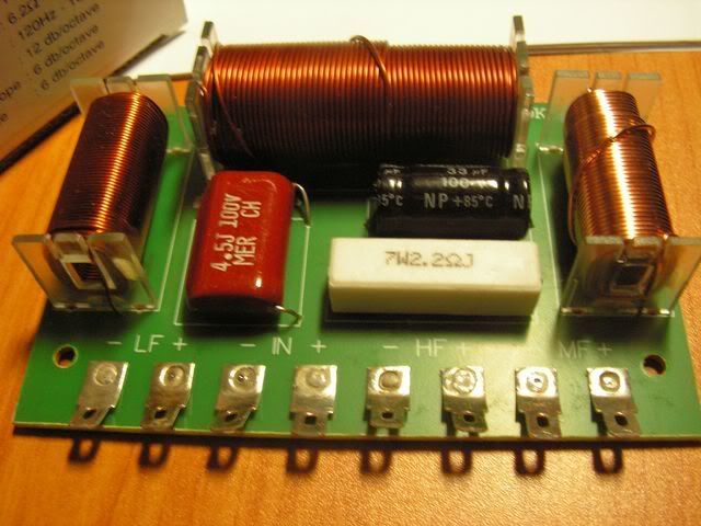

Attached, is the offending caps that came with the T-Amp...
Have removed the polarized 1uF from the assembly, will try connecting the two 1uF NP yellow caps in parallel which should give a total of 2uF for the input caps, dunno how the sound would be.. planning for late night operations... wink.gif

This also just came to my mind. Since the amp can be driven into clipping quite easily.. why not incorporate a 'clipping indicator'? This will help the user not to 'overdrive' the little fella... :
additional notes:
I found one circuit that uses 12VDC working voltage.. will update if found to be suitable for our purposes... need to scrutinized the circuit. tongue.gif
Found this instead. Simple and workable.
Audio Clipping Indicator
This post has been edited by jazzy939: Aug 16 2008, 08:49 PM

Just connect a Amp meter in series with the +12V supply, before going into the 12+ of the amp board.
My Fluke meter got "AVG" function as it will give out AVG current draw reading nod.gif
Without AVG function it is hard to get accurate reading as the current draw keep on changing reflecting the input/output condition.
Max A I got so far when blasting FS around 2A+, but just for a short duration, like heavy bass.
Higher value of power caps will reduce this current draw from power supply.
Pls check the TA2024 pdf, there is a "fault" pin #19, it will indicate thermal overload or output short to graound, but not sure will it indicate "clipping" status.
It can't drive LED directly, you need a transistor of buffer to "light-up" the LED smile.gif
For input signal overload there is another pin, #7.

That is good. I'll accept your current drain figures without doubt! Good work bro! thumbup.gif
The item highlighted is easily done! tongue.gif I'll try that out first! Remember KISS & KIC? biggrin.gif

was trying to solder direct 12v to the chip (those printed on board kinda tiny due to design) and i mess up ended with this
over view, change the input resistors too, 1% 12k. normal metal film
This post has been edited by xtorm: Aug 17 2008, 04:11 AM
Whats the outcome?

I was 'on call' and the 'patient' is under close observation, 18 hours have lapsed.
The good news is the 'patient' has shown an improvement, the 'operation' was a success rclxms.gif

Patient 1 was in surgery,
removed the suspected 'organ' and transplanted a similar organ from the donor (patient 2) biggrin.gif
Now Patient 2 is under close observation to see if this transplant will rejuvenate and make Patient 2 perform better wink.gif
This post has been edited by jazzy939: Aug 17 2008, 09:10 AM

TSxtorm
post Aug 17 2008, 01:08 PM
^O....OO.....ooo^
3,160 posts
From: KLANG!
the patient survive!!!
im so touch
he is now
stronger!
better at planing!
planing in much detials now!!
and he is sooo calm.
now all tht in normal terms
bass kick better now, and its abit louder
positioning of instrument is better now.
details.....
some song with peaks is now gone!!
all resistors measure 11.9X comparing to the ori 20k withmeasure 19.6x to 19.8x, i think tht helps alot in blancing the channel.

Surgeon General Department Warning: May Induced UDMS(Uncontrolled DIY Mod Syndrome) tongue.gif
Observation Report
5 hours burn in has lapsed, for a total of 7.
These are the findings:
Caution: References were made to original report, hence,
1. Feels like a thin 'veal' was removed from the soundstage.(probably due to the added burn in hours)
2. Cleaner, tighter, well controlled response esp. vocals and highs (added caps)
3. An impressive separations of instruments. (similar to ori)
4. Bass is a little bit defined, just a touch. A little too 'bland' for my taste. (almost no change)
Conclusions:
1. With 2uF NP there's just a touch of sonic differences from stock configuration.
2. Removal of the polarized 1uF cap is recommended.
3. Patient 2 is now in better shape and performance, will kick ass soon! laugh.gif
4. Will induce Patient 1 to carryout transformation as per Patient 2 or better! brows.gif
Details and informations are true at time of writing.
End of Report.
This post has been edited by jazzy939: Aug 17 2008, 02:30 PM

I have been reading (as usual) and this is what I found:
http://myweb.tiscali.co.uk/nuukspot/decdun/t_amps.html
Very important extract:
"...In order of preference, I preferred the SMPS best, the battery, the regulated supply and then the wallwart. The SMPS was clearly the best sounding supply and once I had tried it, I had no desire to use the other supplies!

I used Japan Panasonic NP 4.7uF and it sounds much better than original, especially the vocal part rclxm9.gif

I'd say 4.7uF would be midway between my 10uF and 2uF experimentation. 6uF would be perfect! wink.gif
Yes,quality is everything, that Panasonic caps would be just great! thumbup.gif
Where did you acquire it?

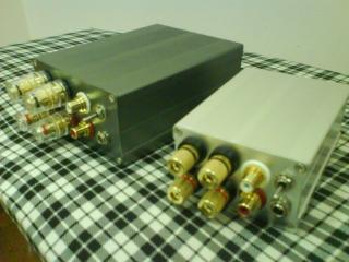

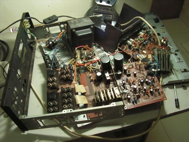

Attached Image Attached Image
I only try 1 ELNA 8200uf cap, with this big cap on, I tried to blast hard but the power supply draw current hardly >1A now, means the caps is functioning.
Previously with 2x1500uF when blasting the A draw may go close to 2A.
It got a [M] logo on it, does it Panasonic? I bought it from my friend.

Yes.. big caps you have there! tongue.gif I have to make a note of that! I have NOT gone into replacement of that existing caps yet.
Saw the [M] logo. Panasonic? No idea. Have never used them before. Expensive?
QUOTE(ongbs @ Aug 18 2008, 12:07 AM)

Me not sure does it Panasonic too but my friend said so.
RM7/pc only, as long as I happy, not really care about the brand, it sound better than my previous Elna 3.3uf NP cap icon_rolleyes.gif .

I am at this point of time running an SMPS rated at 12VDC 2.5A feeding my 'lil marvel... whistling.gif
As I earlier pasted from a website, I concur that SMPS is better than linear PSU! thumbup.gif

QUOTE(jazzy939 @ Aug 18 2008, 12:33 AM)
I bought it at 30 bucks from a friend, I do have two AVRs with me but one is too big (front panel plastic) and another one is fully plastic doh.gif

For RM30 its 'cheap'.. but it is not kinda huge housing for a small little thing? biggrin.gif
OH, you gonna house the PSU too right? I guess it should be okay..
On my side, after the listening session, I have to conclude that I love the T-Amp sounds with a linear PSU.
It has to be as good as my Bench PSU or better. I would NOT settle for any less.. tongue.gif
Actually the housing that I have is even bigger! It's supposed to housea pre-amp and it's PSU, a power amp and it's PSU and mains RFI board.
That project was on hold.. looks like I will use it for the T-Amp.. a definite overkill! brows.gif
QUOTE(ongbs @ Aug 18 2008, 01:48 AM)

QUOTE(jazzy939 @ Aug 18 2008, 01:56 AM)
30 consider OK lah since plastic one also >RM15 and I like the size, purposely looking for bigger casing but not too big tongue.gif

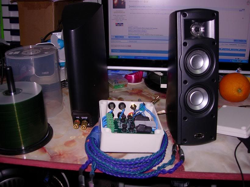

i think this is what he ment by balance amp
not sure tho, 1 stereo board per speaker
QUOTE(xtorm @ Aug 18 2008, 02:18 AM)

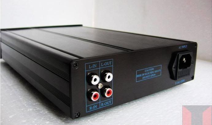

IF I can get that casing to be manufactured here, how much would you guys be willing to pay for it? wink.gif
