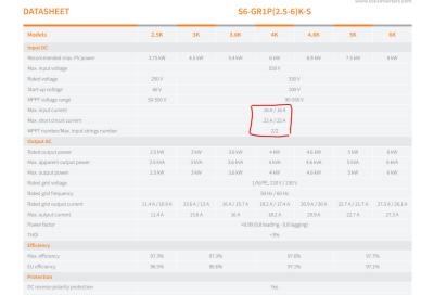

adamw
post Jun 4 2024, 12:56 PM
Back to serve justice to those PKHKC corrupted Ex-ministers!
3,355 posts
Joined: Dec 2006
QUOTE(slimguy @ Jun 4 2024, 11:24 AM)
found one with Solis Inverter and Canadian Panel, but Huawei Inverter need topup RM2K
Nice, this seems new model from Solis, 2 MPPT can support 16A each if I read their specifications correctly!

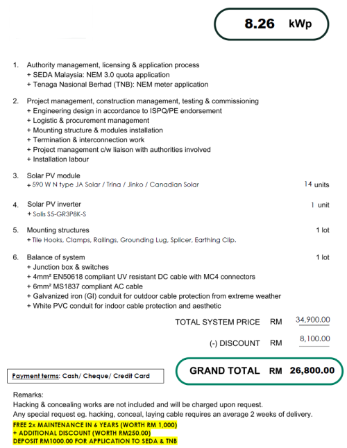

QUOTE(slimguy @ Jun 7 2024, 09:02 AM)
after discuss with the agent i upgrade to 14 panel for 8,26kWp and with Solis 3phase inverter with 5yrs 0% installment. Whole system RM27K.
Price ok?
Ask for Solis brochure. Cannot seems to find your model ending with S. Because there's a newer model that can accept higher current

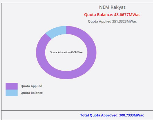

Jason
post Jun 25 2024, 09:12 PM
6,355 posts
https://services.seda.gov.my/nem/quota/dashboard
NEM rakyat quota 30% left… we are only in half of the year.. Solaris working its magic. I’m chilling because NEM agreement signed and allocated for me.
You guys better hurry up if you want to install this year.

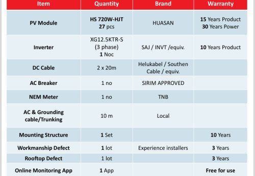

hi, want to ask. i got a proposal recently for 16kW system. However, the inverter is rated 15kW only. And under NEM 3.0 guidelines, capacity limit for 3 phase residential is max 12.5kW. Will this be illegal?

Technically 12.5kW inverter is non existent, next level is 15kW. If SEDA can approved your 15kW inverter it won't be illegal.

The solar panel is usually keep at 1.1 to 1.3 times of the inverter ratings. That is normal.
As for the capacity limit.... I think it is update
https://www.seda.gov.my/misc/frequently-ask...tering-nem-faq/
For domestic or residential consumers, the allowable maximum capacity of the PV system installed is 12 kWp for single phase system or 72 kWp for 3 phase system.

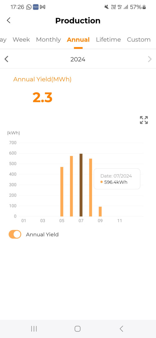

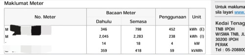

Got the first full month NEM bill.
App shows total electricity generated 575kwh but tnb actual is only 452kwh. We see the first row right? Anyone can confirm?
This post has been edited by rapple: Jul 6 2024, 12:54 PM
yuen300
post Jul 6 2024, 10:00 PM
163 posts
Joined: Nov 2008
QUOTE(rapple @ Jul 6 2024, 01:54 PM)
Same for me. But I was being told that the missing electricity is being consumed over the day.
Hoping someone here maybe can validate.

I asked around about > 12.5kW capacity. One solar co say can, another say cannot.
Anyone got approval for residential > 12.5kW so far?

Got another quote. 740w panels. 19.4kWp, but inverter 12.5kWp.

Wasting your panel energy, 20 panels enough & asked for catalog of this 12.5kW inverter & panels.

QUOTE(rapple @ Jul 6 2024, 12:54 PM)
Correct, it means that 123kwh is directly consume during the day.
QUOTE(yuen300 @ Jul 6 2024, 10:00 PM)
Yes it is correct. In the morning when your solar system generate electricity, it will first be consume by your appliances used during day time. These units is registered in your inverter but not registered to be exported to NEM meter. The extra will then be export and registered by NEM meter. So NEM meter will always have lower export value compare to inverter value.
Easier way is that you try to calculate in reserved to see if your usage make sense. For example previous month before solar, your usage is 600kwh, then after NEM, your export is 400 and your usage in your tnb bill is 450. So you will be paying for 50kwh. From your inverter the generation is 550. So in short. 150w is consume during the day. If you add up 450 from tnb and 150 difference from the missing inverter units. you should get about 600... which should be around your monthly tnb bill before solar installation.
But this type of back track calculation is only valid if there is no sudden increase of electricity usage. If you really want to monitor, then can install another meter to track total usage from both the solar and tnb.

Nope, it does not make sense at all. You can directly black list that agent as he don't seems to know what he is selling.
Try to keep the panel output to inverter capacity ratio between 1.1 to 1.3.
That will be the general guideline.
If you really need that much solar power, means that your usage is high and morning usage should be quite high as well. Why not get two inverter?
Even best, you don't need to go full NEM. 1 inverter to generate enough power for your day time usage, while the second to export out.
Just my thinking though, but of course cost is also increase but since you are getting such a high capacity > 15kw inverter, the price maybe is not too much different comparing to getting two 8 or 9kw inverter and you don't need to worry about unmatched solar generation and inverter capacity.

I also feel it’s a no go. Oversizing by too much.

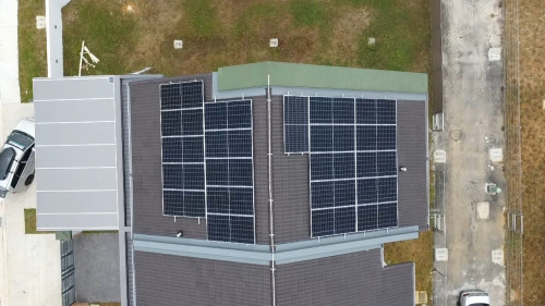

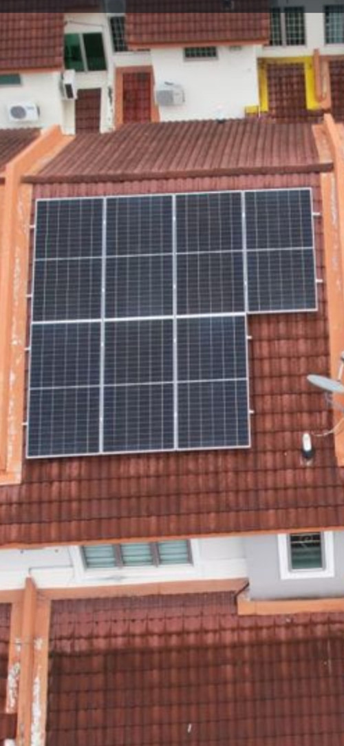

9am start work after some chit chat. 2pm all done.
Very happy with the installation of my inverter, decided to put it outside my porch with space right below it for batteries 10 years later.

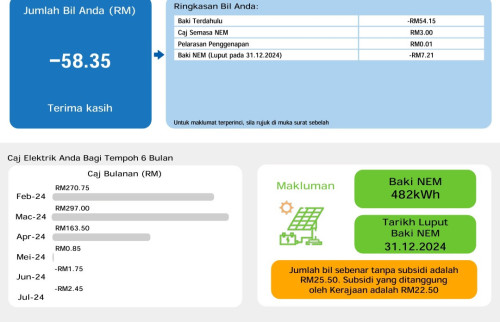

Looks like 4kwh solar system is a bit over.
May NEM credit 81
Jun NEM credit 214
Jul NEM credit 187
cdspins
post Aug 4 2024, 03:20 PM
2,714 posts
QUOTE(rapple @ Aug 3 2024, 11:39 AM)
May NEM credit 81
Jun NEM credit 214
Jul NEM credit 187
Over means generate too much? can either use it on air conds or juts let it rolll until end of the year.

Yes.. only 10% of the 350MW remaining.. I am aware of that.. So I am survey these few days and hopefully to finalize within these 2 weeks..

QUOTE(OrangeGrove @ Sep 13 2024, 11:33 AM)
This only 1.7kW will write off later.
OrangeGrove
post Sep 20 2024, 05:16 PM
643 posts
Joined: Feb 2014
Surprised surprised.. 50MWac just added and total 400MWac for the Rakyat

Quota Balance: 10.9360MWac

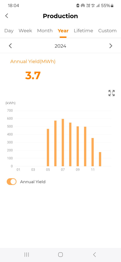

rapple
post Jan 1 2025, 06:07 PM
Y N W A
2,065 posts
Joined: Oct 2014
From: Ipoh,Perak
May to Dec 2024
3.7mwh generated. Should be more due to router issue mid Nov to mid Dec no data recorded.
Thinking to switch to BEV car soon since solar is generating more that what we used every month.

Mind asking what does the Solar Insurance cover?
I signed up 8kwh package at the Setia City CC Home Expo last month, 14 JA panels, Solargrow inverter, for 22.5k. Now awaiting SEDA approval. I don't think it comes with Solar Insurance.

QUOTE(swing123 @ Jan 9 2025, 07:35 PM)
swing123

QUOTE(adamw @ Jan 9 2025, 07:40 PM)
The coverage for NEM loss of savings sound interesting.
