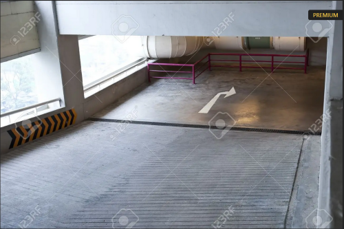

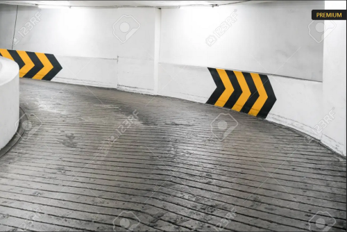

That ramp grove is wrong. The chevron patterns must point up on both sides. This to flow water from middle of the ramp down to the side.
If you look on the left ramp, the chevron pattern points down. This causes water to accumulate in the middle of the ramp, and create a cascading waterfall.
9m2w
I thought for this kidna design in parking complex need a longkang and water trap right??
Or is it not required to get CF approval?

They should have make a drain system at the bottom of the ramp.

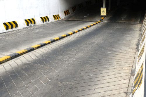

QUOTE(ye0073 @ Mar 16 2023, 01:13 PM)
basement parking need water pump one lar,.. it's underground,.. water can't flow against gravity without pump,..

Peaceful place n LRT nearby
cruel_boy86
post Mar 16 2023, 02:04 PM
12 posts
Joined: Dec 2021
QUOTE(azarimy @ Mar 16 2023, 01:09 PM)
and how does that changes the outcome? water still gonna flow DOWN to accumulate at the low end either way.

Ramp casting looks good
Divider kerb straight with yellow hazard
Yellow column guard/ hazard provided
Photo shows heavy drain outside.
Do a cut off drain with grating seatle lo

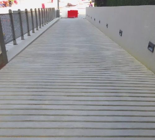

Regardless of the chevron pointing, water will still gush downwards. Of course if pointed upwards, flow channel to bothsides by the groove lines pointed middle upwards. Water still flowing downwards. Look at the top right photo, the pour
Either you do a cut off drain with grating top or bottom scupper/sump to dewater
This post has been edited by jojolicia: Mar 16 2023, 02:43 PM
I just learned what is Chevron pattern ramp
Thanks

azarimy
post Mar 16 2023, 02:35 PM
mister architect: the arrogant pr*ck
Elite
10,672 posts
Joined: Jul 2005
From: shah alam - skudai - shah alam
QUOTE(cruel_boy86 @ Mar 16 2023, 02:04 PM)
there should have been a bump or drain to stop water flowing from the road down the ramp into parking floor. cant see if its there
Actually, it needs cut-off drains on the upper side and lower side of the ramp. Just now I was looking on the smaller screen, didn't notice it didn't have those or even scupper drains on the sides.
So yes, many things are missing, plus the ramp chevrons on the wrong orientation.
From what i see, from driving in mall experience. Usually the ramp has this kind off cut off drain. Seem like this also missed out from construction. Not sure required or not
yhtan

QUOTE(Jazted @ Mar 16 2023, 02:41 PM)
Small drain like that will not be sufficient for heavy down pour
I learn something new.
The groove is indication of direction of traffic flow. If simply face the directions, nanti kena accident. I'm sure all levels are the same. Drainage is another issue but that is not the primary function of the grooves.

QUOTE(ceras @ Mar 18 2023, 11:43 AM)
I can tell you for certain it's NOT to show traffic flow. There are arrows painted yellow or white for that reason.

QUOTE(azarimy @ Mar 18 2023, 03:31 PM)
do you see painted arrows in all ramps at all condo's ? If there are no painted arrows, how would one decide which lane is going up or down?

QUOTE(ceras @ Mar 18 2023, 05:20 PM)
Painted arrows to indicate the flow of traffic are COMPULSORY in all developments.
The grooves, on the other hand, are not. I mean, have you seen these?

QUOTE(azarimy @ Mar 18 2023, 05:43 PM)
+1
sometimes I wonder these ppl never drive around kah? all WFH is it?
what you show are marked arrows that are necessary as they do not have directional grooves built into the design to indicate traffic flow direction. . No one will illogically have arrow like design if they do not have a directional purpose. Show me one ramp with directional arrow grooves which have painted arrows indicating in a completely opposite direction.

QUOTE(ceras @ Mar 19 2023, 12:56 PM)
ONE?
How about THREE?
Enough or not?
Yes, drainage is not primary function. It is like a secondary function as a result from the first. Its main function is for traction improvement. And no it is not for direction of traffic flow. Unfortunately i didn't ask him what will happens to traction if the direction is pointed downwards instead.
perhaps some /k arkitek mat enlighten on this.

QUOTE(azarimy @ Mar 19 2023, 06:48 PM)
ONE?
How about THREE?
Enough or not?
QUOTE(ceras @ Mar 19 2023, 09:21 PM)
ok, thanks for the postings. I stand corrected.
What Azari said is correct. The concrete ramp grooves line IS NOT FOR SHOWING direction. It is for dispersing the rain water to avoid slippery during rain / wet condition. It MUST be face upward so that when there’s rain water, it should direct the water to the left or right side of the longkang.
If you make the groove line facing downward, majoriry of the water will end up meet at the center of the concrete which will result hazard for a car going down or up.
This is basic engineering mate, if you know nothing, just shut up.

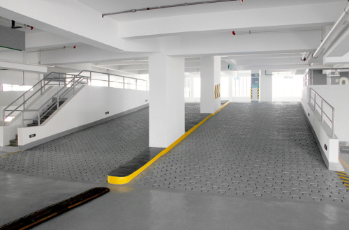

I'm no engineer but pretty sure grooves on ramps are for grip purposes
