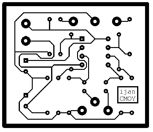

Neways, PCB diy punya will never be up to par with pro board with glass epoxy+silks creening and track pre-coating bla bla..
at USD10 was it for the mini cubed..its a good price (u can get cheaper if u make in bulk from the local store)..however, shipping for the mini cubed is a PHREAKING PIA!!
I can make DIY mini cubed, but single sided, anything else is wire jumpered, and maybe the option of DIP sockets..hmmm...but it wont be nice looking.

Can diy double side also ma..

Single sided, simpler but 'messy':P
Double-sided.. needs s/ware assistance to do the layout:D

I would imagine it harder as you must really plan well before attempting such feats. LOL. But the challange might be interesting.....NOT:P

double sided diy is based on ur material, but via connection between surfaces are almost impossible to DIY since u need perfect precision to align bottom n surface plane and not to mention via connection...aiyo..

Hi everyone. I usually just browse through what other people wrote in here. But I think I can share some knowledge here.
DIY double sided is possible and can be good enough if correct method is used. I did quite a number of double sided board using FR4 boards and acid bought from Pasar road. For alignment I usually used few reference points on the board. I would drill these 3 points and insert tiny pins into them. Using these pins, now you can align both side of the tracks. I used laser printer method where I would print my PCB design on a piece of glossy photo paper bought from Lowyat (careful of which type) and then iron these photo papers on the FR4 boards. After making sure they stick well to the FR4 boards, wash them with water (plus a little bit of soap powder). Then wash them with acid. The area without the black ink would be washed away by the acid. After all unwanted copper is washed away, use a sand paper to clean the board. Then start drilling using small drill bits for vias. Then use wrapping wires something like AWG30 thickness as your vias. Then you get yourself a cheap way of making home made PCB. I will post some pictures later if you guys want to see some samples.
Another way is sending them China. I don't know how much is UKM charging as I never used them before. There's a company in Jalan Klang Lama (cannot remember the name) that also provides the service but not pretty good. If send to China, for some boards size of approximately 7 cm x 7 cm double layer with silkscreen is about USD55 for 10 boards. Shipping is about USD20. If you can get few guys to share the shipping, it will be cheaper.

i use the toner transfer method before, result quite good but need experience to handle the process. sometime need trimming if transfer not perfect.
i usually use photo resist board nowadays but expensive. another good way is use press n' peel paper, they are available at jln pasar now, i know a shop got sell them. but again this special paper imported and expensive but result is very good.
PCB fabrication company usually charge quite expensive and need minimum order. if bulk buy definetly will go for their service as the quality is impressive.
just the matter of money, depends on how much u willing to pay and how good u want it to be.

Thank you for the info. I personally have not done any double sided board but it is not impossible, just require a little planning and work.
Let's see those pictures.. might get some people interested! You know what they say, a picture says a thousand words.. biggrin.gif
The China board maker, how's the quality of the workmanship?

I never had any problem with the China boards. The are great in quality and fast, about 7 working days.
I order up to 6 layer board before and the quality is just fine.
I saw the Mini Cubed schematic and PCB. IMHO, I think it will be ok for a home brewed PCB. I tried down to 10 mil tracks before using home brewed PCB. For audio circuits, it's best to make the tracks fat whenever possible.
Press and Peel used to be only available from their website. Used to be USD 40 for 20 piece. Now it went down to USD 33. I think if I'm not mistaken I saw them in Maplin or Nixie (or both I guess) in Pasar Road.

Heres a 10 min werk in Cadence on a simple 78XX voltage regulator with the tab bolted to the plane as heatsinks. Comments?
COuld haf been smaller and more organized..but rusty Cadence..

post Sep 13 2007, 12:51 AM
The one with a boring life...
3,448 posts
From: Sarawak
See what happens tomorrow then...
This post has been edited by jazzy939: Sep 13 2007, 12:58 AM

Wat board is that?

dont you see that?
ijan Cmoy
ijan
post Sep 13 2007, 07:18 AM
3,448 posts
From: Sarawak
that is like prototype, i dun think its good..i was rushing it so i can print it out at office and try to make one tonight (my home laser printer is rosak..demmit).
Nets are thin, they could haf been bigger, layout is not optimized, they could haf been shorter..much more can be done, item footsize could haf been more accurate, prototype nyiaa smile.gif 20mils track, see matte paper+toner transfer+laminating machine can do the werk or not..
LittleGhost
post Sep 13 2007, 07:58 AM
臭小鬼
4,234 posts
Joined: Nov 2004
ijan, what software did you used for the job? Thanks!
ijan
post Sep 13 2007, 09:38 AM
3,448 posts
From: Sarawak
Cadence Orcad Layout..i haf yet to learn the crook and nook and its far from perfect..i thin sum other sifu here pakai protel made much much better board design..
My home laser cannot print black..but nanti hantam try print yellow toner..hehe!

bsl555
post Sep 13 2007, 01:42 PM
8,046 posts
QUOTE(ijan @ Sep 13 2007, 07:18 AM)
Damn right its not optimized. Tracks should be at least 50mils and above, solder pads should be much bigger for obvious reasons. smile.gif
This post has been edited by bsl555: Sep 14 2007, 01:44 PM

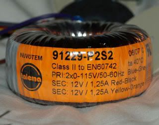

Which Toroidal Transformer should I get?
1. Multicomp for RM68.00 or
2. Nuvotem for RM96.00 ?
Both are 30VA, 2 x 12V
bsl555
post Sep 24 2007, 02:23 PM
8,046 posts
QUOTE(grandspy @ Sep 24 2007, 02:18 PM)
You should go for at least 80 to 120VA transformer.. trust me!..it costs only a fraction more..
Moreover, you can parallel the two 12V windings to obtain maximum current delivery.
BTW, you'd have to know the precaution when mounting a toroidal tranny..its not like as simply mounting the ordinary E-core transformer with 2 bolts.
Essentially, the toroidal must NOT have contact with the base of chassis (there's a rubber insulator at bottom and the center bolt (not tightened too hard either) should NOT be too near or have contact with the top or cover of chassis.
This post has been edited by bsl555: Sep 24 2007, 02:37 PM

QUOTE(bsl555 @ Sep 24 2007, 02:23 PM)
120VA? That's too much! shocking.gif I only need them to feed my X-DAC. For the Lab, I already have this:

QUOTE(grandspy @ Sep 24 2007, 03:00 PM)
Me have been using a 80VA model for years, now its powering 2 out of 3 MF X-series component. I've observed the 80VA quite effortless and hardly any heat. BTW..your X-DAC should be fed with AC voltage input..not DC I presume,.
grandspy
post Sep 24 2007, 03:33 PM
The Mothership is here!
1,339 posts
Joined: Oct 2005
QUOTE(bsl555 @ Sep 24 2007, 03:09 PM)
Hmm... 80VA huh? sweat.gif I though 30VA is more that enough as the current rating for my X-DAC is only 500mA. 30VA will give out max 1.25A. Yes, it's a 12VAC input. So output from the tranny will go directly to X-DAC power jack.
Now what I need is some kind of enclosure, IEC power inlet, power cable, and time to actually fix 'em up. rclxms.gif That settles the power part. sweat.gif

grandspy,
great looking toroidals.. for your DAC? How much does each cost?

QUOTE(jazzy939 @ Nov 15 2007, 09:54 AM)
grandspy,
yeah, for my DAC. I paid RM96+ for it.
