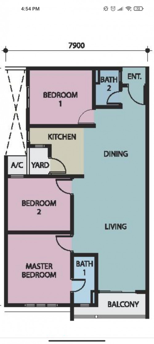

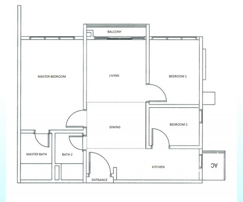

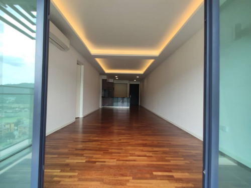

Hi Lefty,
Look for some idea for my new place.
Hope you can bump me with some ideas
https://pictr.com/images/2020/10/07/7hRwyX.md.jpg

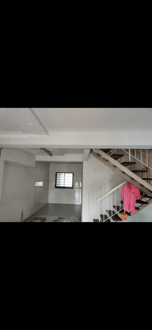

post Oct 8 2020, 12:58 PM
343 posts
Joined: Sep 2007

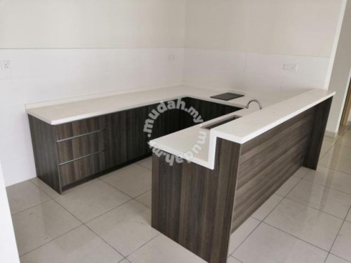

https://m.mudah.my/view?ad_id=86005121&shar...&share_to=other
Hi ts, any idea on how to renovate this house so that it will have more light going in and more airy?

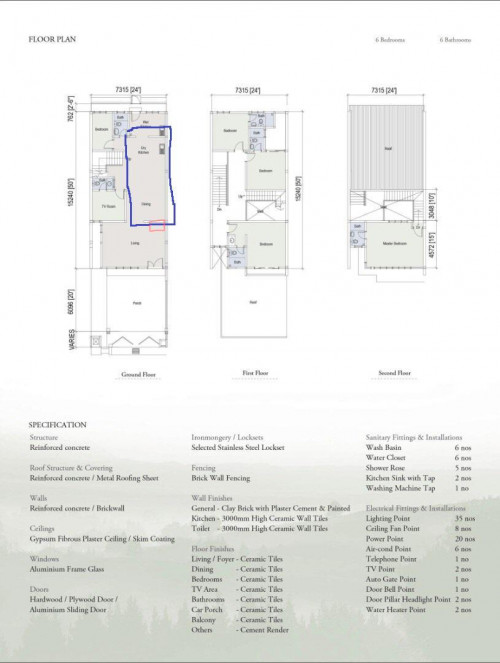

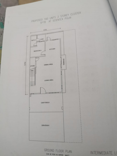

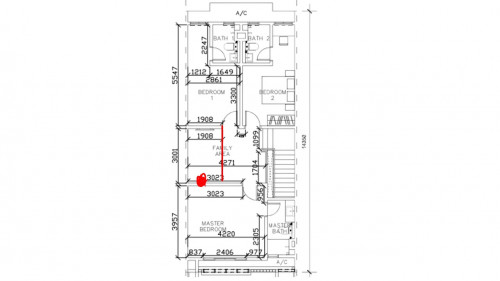

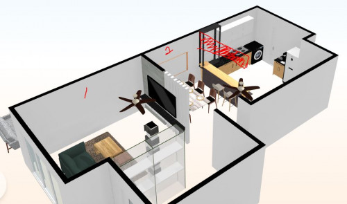

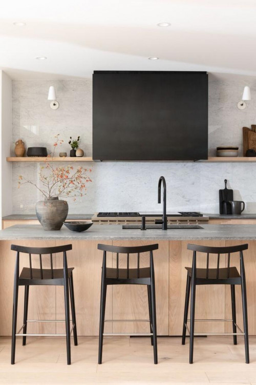

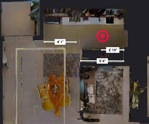

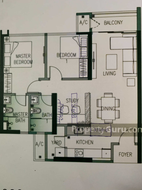

QUOTE(kohho @ Oct 7 2020, 08:05 AM)

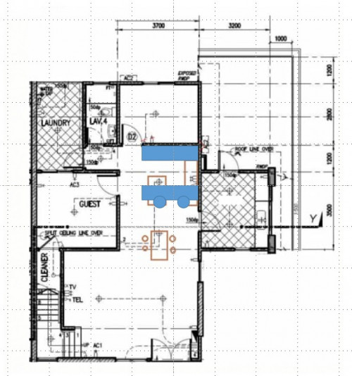

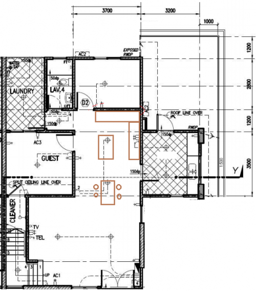

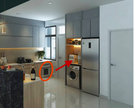

That's a very good point that you've brought up. I'll re-locate the washing machine accordingly.
While we're on the topic of painting tones, i would prefer a safer approach to this and try colour combinations that are less risky. So i'm trying to avoid brighter colours ( do you think that's a good idea?)
Here's a picture of my house layout that i drew:
For:
area 1 - living room : i would try to go light grey/ silver grey

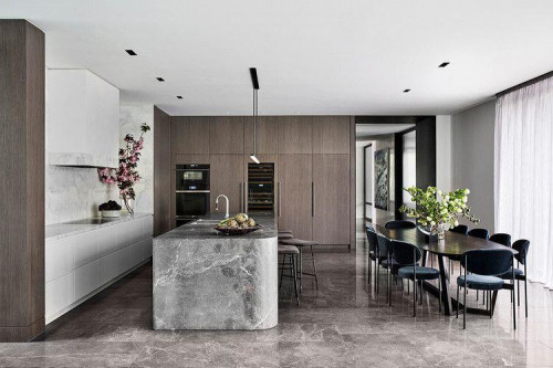

area 2 - dining area : i am thinking of this limestone grey as per :
area 3 - dry kitchen : there will be a block of low hanging ceiling(default developers design ) before entry to dry kitchen, around bar counter area. Based on my colour scheme, do you think that the vertical area ceiling should be colored to indicate different areas transitioning, or should i just leave it as white color?
What do you think of my colour blending, is it fine, or do you have other colour ideas to suggest?
note that the coffee tables, dining tables and cabinets are wooden, so i am thinking of a wooden theme to go with them.
*Think is fine, light warm grey would be nice*
*The limestone grey looks good while match with the bar counter design you have now*
*Just go for white color, as white color will not make the beam looks obvious*
*Overall color blending is fine, maybe sofa can go with grey or brown color to match with the color scheme tone you have now, so that overall interior looks blended in*
Happy renovating!

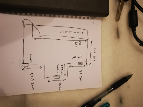

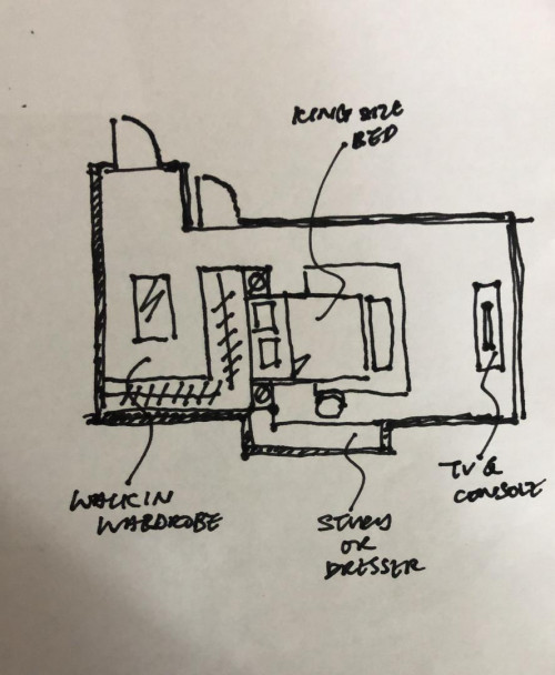

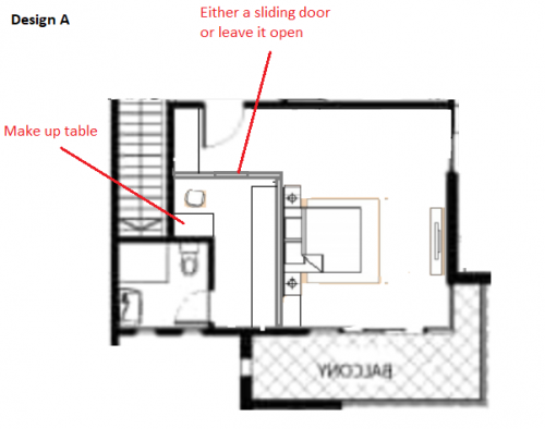

QUOTE(alex000 @ Oct 7 2020, 08:18 AM)
Thanks for the idea.
Would I have enough space to fit all those there? How much space would I need to allocate for the walk in wardrobe?
You are most welcome!
If you will have clearee actual dimension of the layout , I can help you out there.

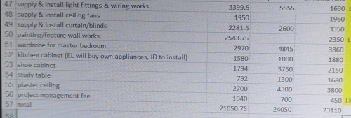

Hi Lefty, I've acquired quotations from three different companies for my 800sqft unit with the same requirements. However, as you can see from the screenshot below, the quotation for build-in items and plaster ceiling actually differ quite a lot between all three, making me a little skeptical on which to go with.
FYI, for the plaster ceiling I asked for just a flat plaster ceiling with nothing fancy. Appreciate your input on the quotations. Thanks in advance!

Hi,
the plaster ceiling price could start from RM4.80 per sqft, and its depends on ceiling height too. However, I suggest you to check with your contractor on the specs they given, for example the thickness of plaster board etc. Normally we will use for 9mm thickness for the plaster board.
For built-in item, the price will vary depending on the materials carpenter use, there are different type of timber and brands of laminates to use for built-in items. For wardrobe (base on height 3000mm), its RM800 - RM1050 per foot run, & depending on materials use too.

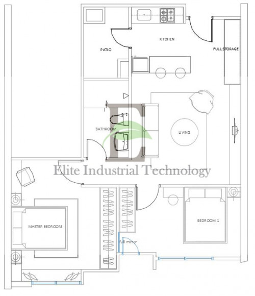

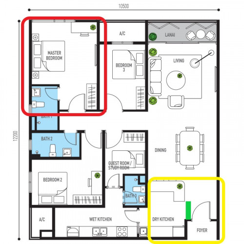

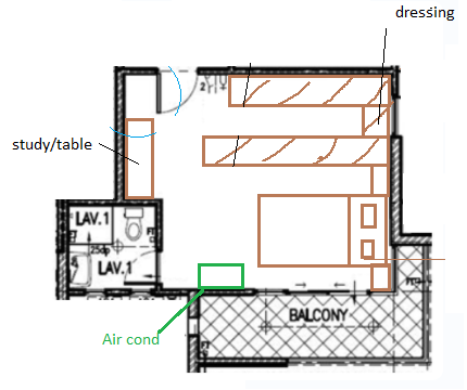

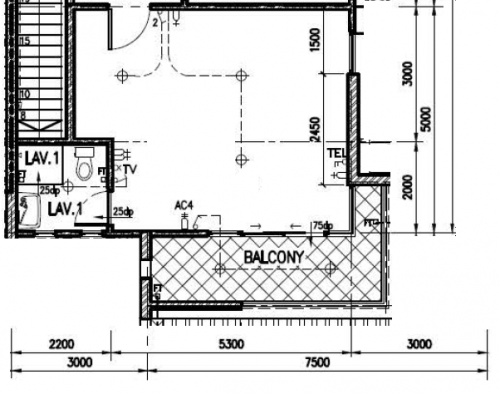

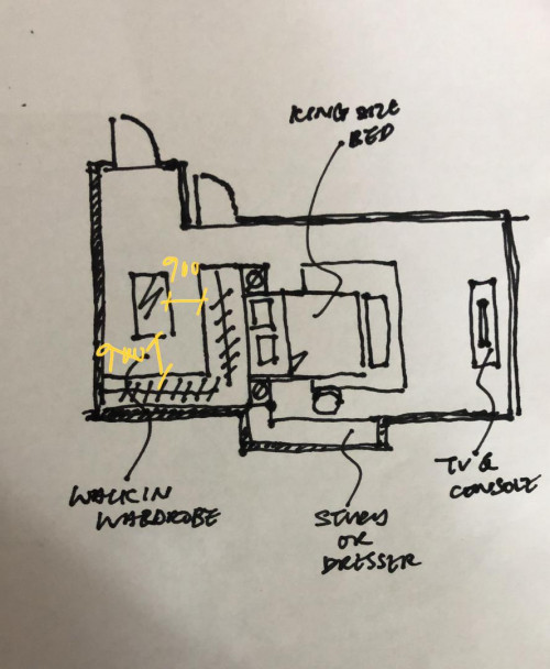

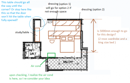

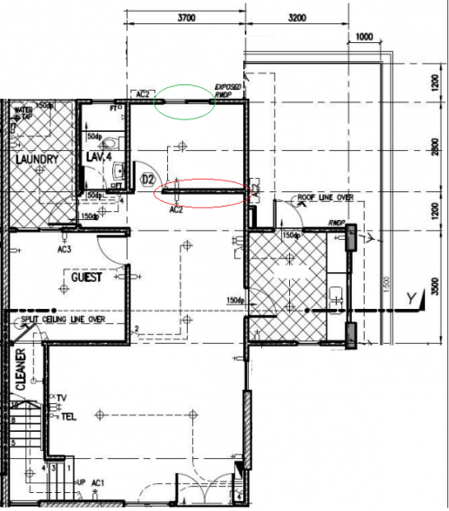

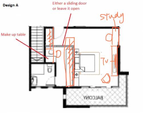

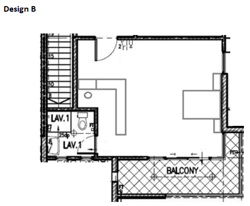

Hi, is best to have 900mm walkway (see highlight in yellow) or 750-850mm is fine. if is less than 750mm, is better to go for sliding door wardrobe.

Hi Lefty, thanks for the advice. For the built-in items, all of them are using melamine actually. May I know what is the price per foot run for this?
Personally i like your house layout, if i am the one who staying in, i will demolish the wall between 1 & 2 and make the whole space up. As i see in the pic, you are proposing a bookcase kinda cabinet as a divider to your foyer? I would do a TV console cabinet which come with a double side functional. This cabinet can work as tv console and storage at the meantime also can work as a shoes cabinet for your foyer since your entrance got a big space there. Secondly, you can always know who coming back when you are in the living room since you will seating facing that direction. You also can curve up the cabinet tip at the seat area so that it will give a directional sense for people as a guide to walk in your living room.
