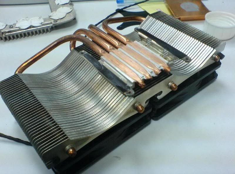

interesting looking hsf... nice idea.... performance is not bad...wat do u guys think?
http://www.techpowerup.com/reviews/Xigmatek/082Cooler/1

Hmm, another heatsink that uses the concept of direct contact of heatpipe to the processor. hmm.gif

doubt it will be that good because the surface will not be that flat no matter how well it is lapped.

Maybe they should at least put a thin layer of copper at the bottom?

ok lets get back to the discussion of this heatsink. not much point going around the same thing over and ovef again

This cooler has a lot of space between the heatpipes and the heatsink base (especially at the base). Would it help if these dead spaces were closed up? I mean solder it up or put thermal paste?
As with other heatsinks, I notice there is a flat surface at the base. Have been wondering whether cooling would be improved if one were to stick a heatsink over the base.... hmm.gif

The flatness probably does affect the heatsink's effectiveness. But contrary to most people's perception, thermal paste actually has very bad thermal conductivity compared to metal-so filling the gaps with thermal paste would probably have not much effect.
Filling it with solder however, might be a good idea as it would allow better heat transfer from the IHS to the heatpipes (more area). BUT, there's a huge risk...

One thing about this cooler is the uneven distribution of heat. I mean, since aluminium is different to copper in terms of heat conductivity and heat specific, this would create different temperature on the IHS.
You know, one stripe of hotter area and one stripe of cooler area.
Well, I guess not so much on the proc itself as the IHS is the one with differential temperature but would it be good for the proc?
Corrected the link..sorry, had too many tabs open, forgot what I last copied.
Yeah, that would be the case, alternating cool and hot strips of area on the IHS. But anyway heat production on the processor die is by no means uniform to start with, and the processor die is pretty small even when compared to the IHS. So I guess there would be no real effect of uneven cooling.
isn't the spaces between the heatpipes at the base filled with the aluminium ??

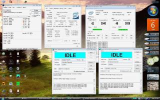

i found out that the Xigmatek perform much much betther if i open my side casing!!!!
Idle at 3040Ghz(E6400) at 36 to 39C
Orthos Load show at 50 to 55C......quite good as compared to my "modification HR-01" which show 60 to 65C..
all using thermal paste AS5.
kmarc
post Jul 9 2007, 04:13 PM
The future is here - Cryptocurrencies!
Elite
14,576 posts
Joined: May 2006
From: Sarawak
QUOTE(MakNok @ Jul 9 2007, 03:54 PM)
damn,
Wah! 10'c lower than the HR-01!!!
Where did you get your xigmatek? For how much? Is it the S1283 or the S983?

post Jul 9 2007, 09:28 PM
5,713 posts
ya...my air ventilation is not good...
open side casing immediately show idle temperature to 36C to 41C which is much much better than my HR-01.
who is selling this so call Evercool PC Air Conditioner
the link ;
http://www.cyberguys.com/templates/searchd...?productID=6423
i have fix back my 80mm Fan on my side casing...it did bring down the temperature.
Man...this heatsink is cool...
[[[[[[[[[[[Neon Crab Cooler with "Shawty Bling Bling"]]]]]]]]]]
((((((My Modified HR-01 with Ori Intel Fan Glue))))))
*********Tunnel Cooling System*******
Modified HR-01
At Load state....................................................................At Idle State
Attached Image Attached Image
My Humble PC;
Xigamatek S963 result
My conclusion;
For my casing,i need a small medium size heatsink where Xigmatek S963 fit nicely in my casing.
Maybe it is not fair to compared my "decaptivated" HR-01 heatsink brows.gif brows.gif but it a waste not to test it..!!! tongue.gif tongue.gif
All i can say...Xigmatek performed good for my O/C E6400 at 3Ghz..
The Xigmatek fan is damn noisy....so i use back the intel fan!!!!
MakNok
post Jul 9 2007, 10:22 PM
5,713 posts
Cannot close my side panel lo...
so i dismantle the fin one by one until the height just ngam ngam my slim casing..

That could be the reason your HR-01 isn't performing as expected.
Anyway the HR01 fins were soldered to the heatpipe. How did you manage to remove the fins?
MakNok
post Jul 9 2007, 10:35 PM
5,713 posts
Maybe my defective HR-01 isn't performing as expected but i remember clearly that the result doesn't differ much even if the original height for this HR-01 is still intact..
just taken a risk to dismantle some of the aluminium fins and i bend the the end rod as u can see.
Using longnose plier,,,i twist and turn and using cutter as well.

I can't tell how much of a difference but there would be loss in performance as less heat would get dissipated due to less number of fins.

Wahlioa! So brave aaa..... If you happen to rupture the heatpipes, then the heatsink would be so defective!!!

yalor ...not much difference and i have just broken one of the heatpipe to show that Polar_012 theory is wrong...!!
see the broken heatpipe....there goes my HR-01!!
now my heatsink really defective!!!!

The inner part of that heatpipe you broke is porous for the sole purpose of capilary function so that the fluid would flow back to it's original state despite gravity.

i will post some screenshot later ..
This post has been edited by likito: Aug 16 2007, 12:09 AM
likito
post Aug 16 2007, 12:14 AM
1,468 posts
Joined: Sep 2006
From: Taman Melati, KL
1.4v load 50c , 2.4ghz
1.45 load 56c , 2.47ghz
1.4v load 55c ,2.4ghz, orthos 12 hour
Added on August 16, 2007, 12:16 amgot one time achieve 58c , forgot to printscreen ..
This post has been edited by likito: Aug 16 2007, 12:18 AM

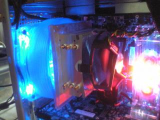

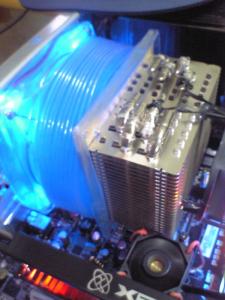

post Sep 4 2007, 12:32 PM
3,239 posts
Joined: Jun 2005
here my HSF setup. dual fan mode tongue.gif great cooling performance but noticed significant noise, probably due to air turbulence created between rear fan and exhaust fan... three fans almost in a row sweat.gif

QUOTE(toughnut @ Sep 4 2007, 12:32 PM)
How did u connect the rear 120mm to the Xigmatek? Im trying to do the same mod to my S1283. Any drop in temp? hmm.gif
This post has been edited by intune: Sep 4 2007, 10:43 PM
toughnut
post Sep 5 2007, 08:49 AM
3,239 posts
Joined: Jun 2005
@intune
just use flexible metal tie. u know, those usually comes with cables bundle. dont know it's proper name lol
actually just trying it out for temp usage but since it didnt fall off, i just left it there till now.
performance? i actually never use single fan mode on this heatsink lol. first time install it, already have dual fan set up in my mind haha

this is the latest product from Xigmatek.
it's ES though.
the heatpipes might have problem to get contact with gpu core which is getting smaller size these days. sad.gif
