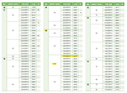

Original stock tyre = 175/65/R14 (14 x5J ET45)
What you guys recommended for upgrade but still maintaining the fuel efficiency. Any opinion please?
Based on few review and experience collected from various posts, it can be concluded that:
195/50/R15 with 15 x 6.5JJ + ET35
195/55/R15 with 15 x 6.5JJ + ET38 > will rub fender when overload at rear
185/55/R15 with 15 x 6.5JJ + ET38 > this would be perfect setup

If it is similar to AXIA, then we can follow this thread:
https://forum.lowyat.net/topic/3821265
why dont you try 185/60/14?
i may be wrong, it seems 14' dont have much choices for 185/55.
hence profile of 60 is the best, comfort and good handling.
FC wise, definitely will reduce but not significantly.
I like bezza too and also feel, 175 is totally insufficient.

that was my initial thoughts too, as the carexpert said bezza has no much diff than axia, and axia has been great with 185/60/r14
kurty
post Oct 5 2017, 09:55 AM
224 posts
Joined: Jun 2009
QUOTE(spreeeee @ Oct 5 2017, 09:30 AM)
if so, then go for 185/60/14, at least no need to spend extra of rim upgrade.
do share with me what are the available choices for 185/60.
i just saw CC6 got this size available, you may consider to try this.
quiet and comfort.

It's very easy to figure out alternative wheel tyre combinations. The objective is to get the same overall diameter of the pair. For 175/65/14, there are no alternative 14" tire sizes that will give exactly the same overall diameter. The closest is 225/50/14 (-0.4% overall diameter) or 195/60/14 (+0.9%)
If upgrade to 15" rims, can go for 185/55 (nice low profile) or 225/45 (boy racer low profile) both no effect on overall diameter
For fuel economy, they say if your new combi weighs more - then naturally FC will suffer. Hahaha go weigh your stock combi & when you shop for new rim & tires, bring a weighing scale ensure weight no increase
For handling, the boy racer 225/45 might seem better intuitively - but the engineer research says you have to make sure you don't alter the "scrub radius" too much - hahaha go google that - that has to do with the rim offset & the overall geometry of the suspension system. Also the research say wider tires will affect your pickup ie look nice but cannot run tongue.gif
For cost, of course change rim burn bigger hole in pocket la. Even those 14" combi mentioned, you definitely need to change rim for the 225/50, not sure about the 195/60
Me no genius - use this online tool . Have fun!

Should be negligible difference. The 195/50 is wider hence more traction/rolling resistance in general but the overall diameter is also a bit smaller than the 175/65 so they kinda negate each other, provided both are similar tires. You should use 205/50 though to maintain about the same diameter but the rims should also be wide enough for 205 tires (6-6.5jj wide).
You can check with this conversion calculator:
https://www.wheel-size.com/calc/?wheel1=175...wcl=30mm&sr=0mm

TSspreeeee
post Oct 29 2019, 01:43 PM
3,812 posts
Joined: Apr 2009
From: West Malaysia
QUOTE(vinnyming @ Oct 29 2019, 11:37 AM)
Are there 195 options for 14" ?? By the way, the second number on the wheel before the R14, that's the sidewall height right?
What are the difference between higher and lower number? Example higher like...70-80, lower like....55-60.
i dun think u can find 195 for 14" rim.. or i would say super rare..
see explanation as attached.

Guys, new bezza 1.3 2020 uses 175/60/R15 tyres.
Can I fit it with 185/55/R15 instead?

QUOTE(cloudstrife07 @ Feb 21 2020, 05:26 PM)
Can

QUOTE(spreeeee @ Feb 21 2020, 08:45 PM)
Can
Thanks. At least have more choice like Michelin XM2+, else I’m stuck with Hankook Kinergy
Which tyre brand have 175/60R15 size?

post Mar 6 2020, 09:14 AM
79 posts
Joined: Feb 2010
From: Autocity, Penang
i saw comment from youtube car review channel
FL ori 15' rim size is 5JJ, only can fit 175/60/15, but this tire rare found in the market and the price higher than 185
This post has been edited by island0806: Mar 6 2020, 09:15 AM

They stick with 175 width because the FC.. if using 185 width sure the FC is higher..

Hi I recently just received my Perodua Bezza 1.3 AV. I want to ask, if i can change bezza tyre from 175/60/15 to either 185/55/15 or 185/60/15 with the original rim came with bezza ??
Is the new tyre size will hit the fender or not ?
I'm not lower the car or change any absorber or the spring.
Because i wish to pick Michelin PS3 tyre, but bezza original tyre size 175/60/15 i can't even find a suitable brand. For 15" tyre every brand got size for 175/65/15 but not 175/60/15 😩
Thanks in advance.
TSspreeeee
post Mar 20 2023, 03:41 PM
3,812 posts
Joined: Apr 2009
From: West Malaysia
QUOTE(irvinehooi2022 @ Mar 18 2023, 06:38 PM)
Thanks in advance.
185/55/15 is OK

No, I'm not selling the bezza ori rim. I planning to change the tyre to 185/55/15 with using the bezza original rim.
Just can't really figure our the decision. Because some said cannot hit the fender and some said it will hit the fender during heavy load or go over bump when using 185/55/15.
So i got backup plan is to change to 175/65/15, because every tyre shop that i went don't have the size for 175/60/15.
Thanks.

QUOTE(irvinehooi2022 @ Apr 6 2023, 07:45 PM)
Thanks.
https://www.continental-tires.com/my/en/b2c...5&season=Summer
Yes, none for 175/60/15 save the Bridgestone Ecopia series ep150, which is quite difficult to obtain.
Attached File  EP150_snippets_malaysia.pdf ( 297.35k ) Number of downloads: 16
