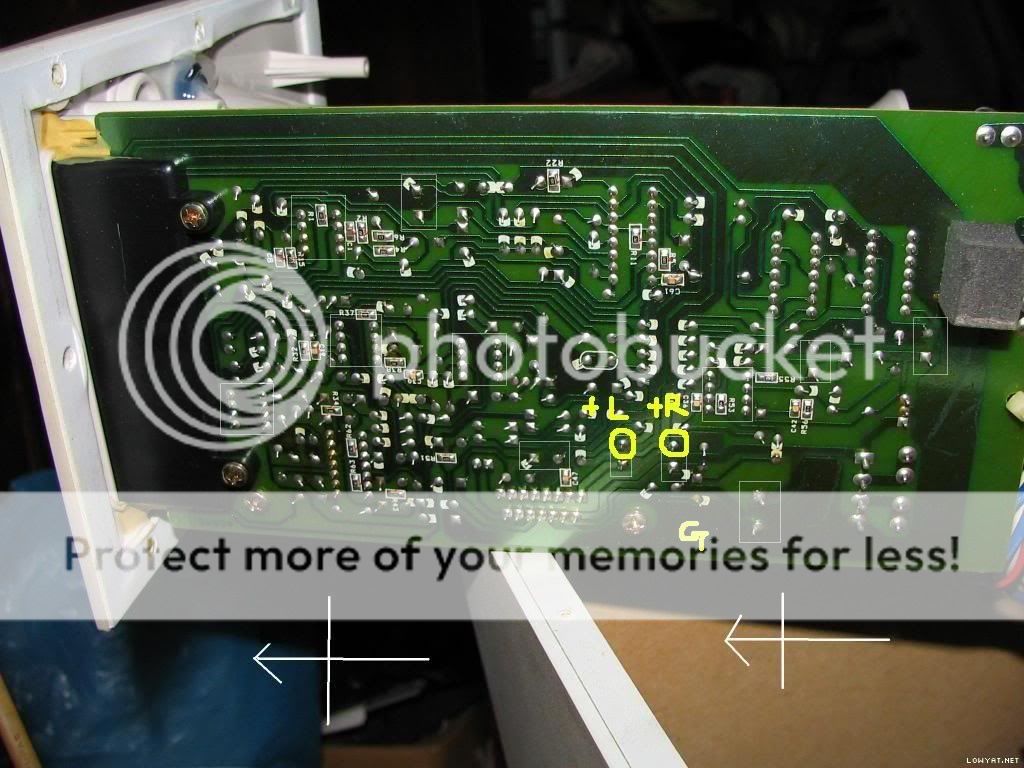

QUOTE(samosa @ Mar 12 2011, 10:39 AM)
hi, i have an altec lansing atp3, sadly the connection to the 7 pin wire to the right speaker is kinda loose.
so, i did take out the 7 pin connector and chopped the right speakers connector.
question is, where does this wire go to on the circuit board? i've been doing this for so long without a solution. help!
If you are asking for help, pls post some clear pictures of yr circuit board and the 7 pin wire you mentioned..
At times, words can't really explain what you are trying to ask..

ACS45.1 controls... trace the wires back to your board.. according to color
the thick RED, GREEN and BLACK is speaker right,left and ground
ATP3 has new version and old version, this is the new (cut cost) version.
yes, nao you just trace the wires back to the board using a multitester or batteries with led/lightbulb
Attached Image Attached Image
desolder the 7pin thingy out first, attach it back to the plug, cut the wires, trace each wire color to destination
heh, grumpy. needed to open my sets up for you all. get your own pics next time!! =D
This post has been edited by beggarmaster2000: Mar 14 2011, 03:05 PM

QUOTE(beggarmaster2000 @ Mar 14 2011, 02:05 PM)
heh, most of them are babies. they expect us to spoonfeed yhem  immediately witout doing homework.
=) most don't even turn up when after request filled
best part about it is not even a thank you 90% of the time haha
unless you are following thread, don't request =)
Here's my ACS 45.1
Sorry for bothering you again, since I've already taken out the whole set of stuff from the subwoofer and stepped into the no-return way to the modifications of my ACS 45.1!
Have you ever succeeded in detaching the "black plastic cover from the PCB board? I've found it quite difficult to detach it from the PCB board for having any work at the 5-pin connector.
As I'd mentioned before, I'd like to rebuild the independent R & L channels for the satellite speakers firstly. So, under such circumstance, would it possibly be the short cut to bybass it and just soldered wires onto the back of the PCB board as your picture shows?
Thanks in advance!
